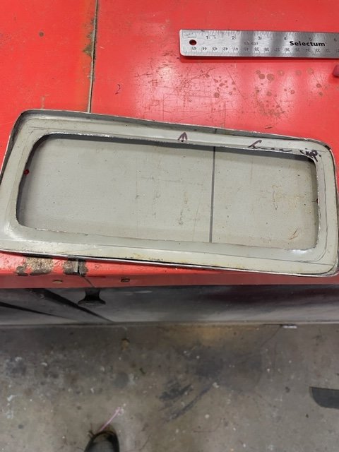

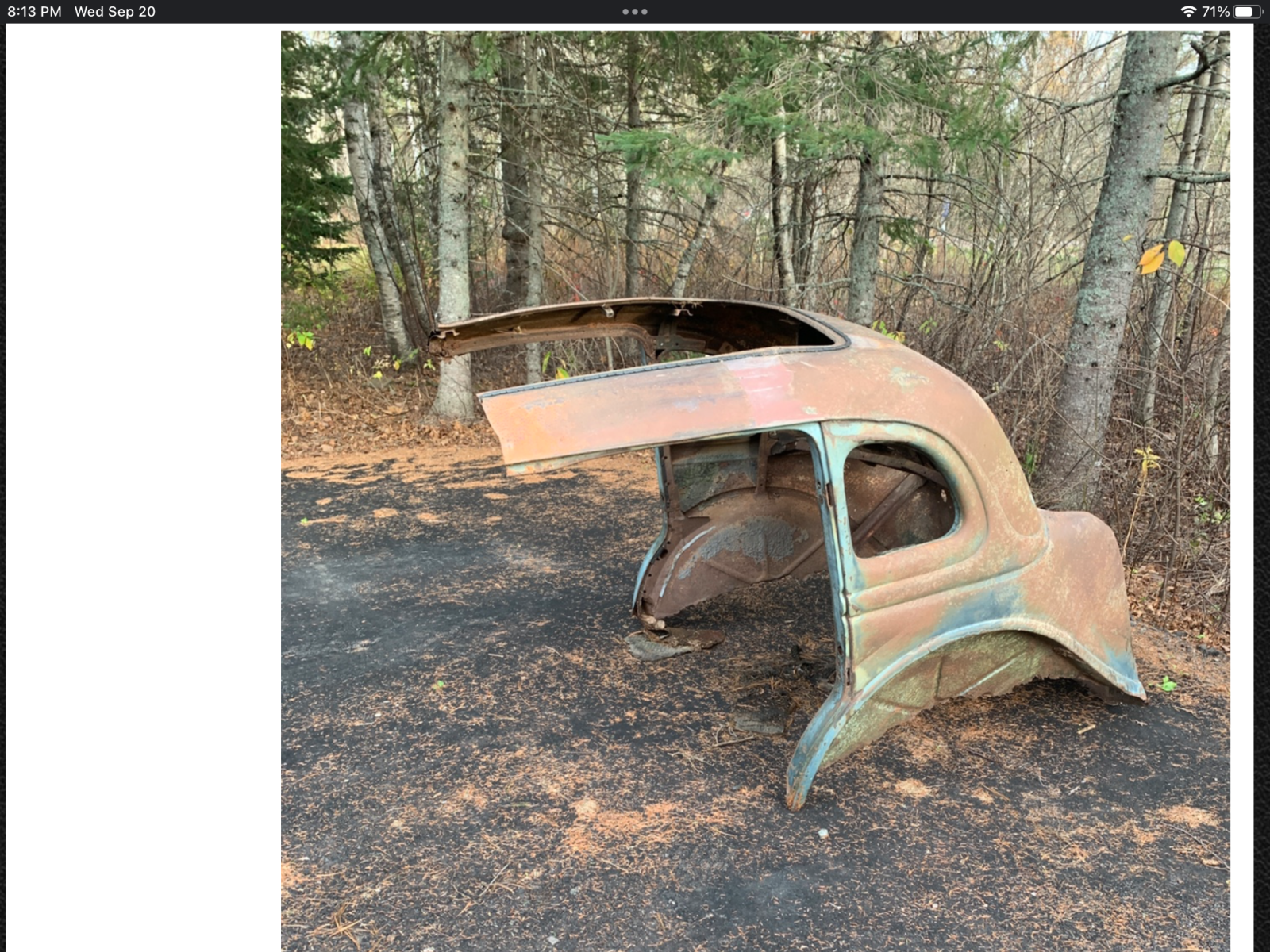

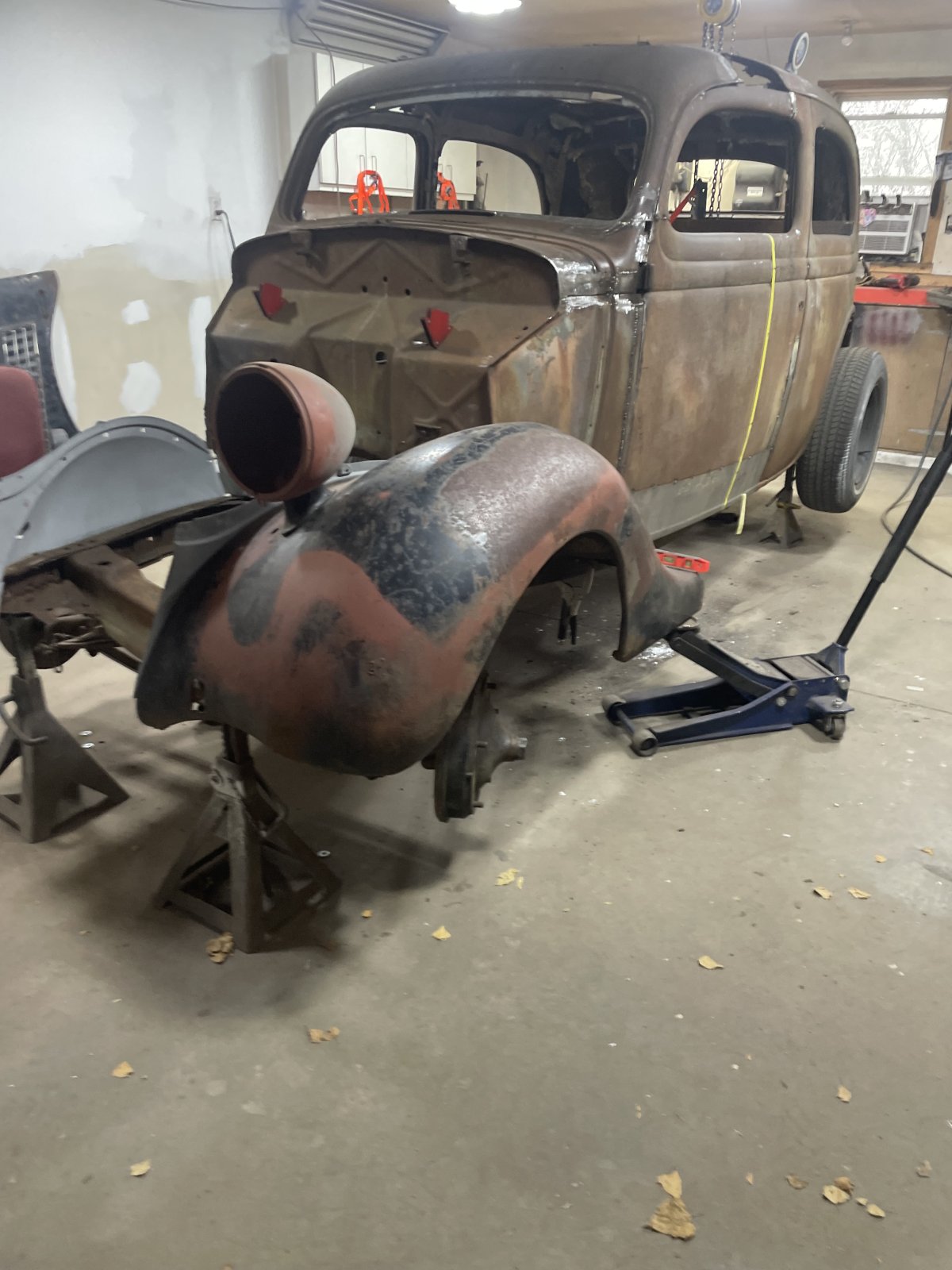

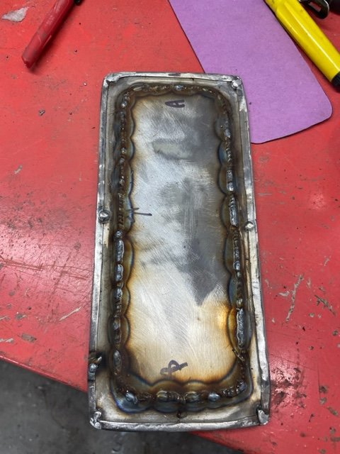

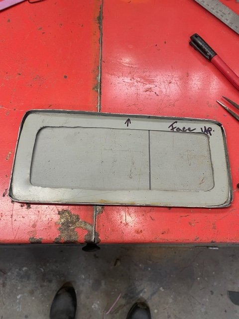

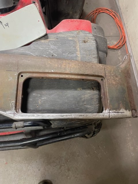

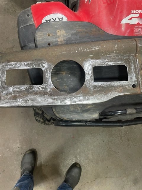

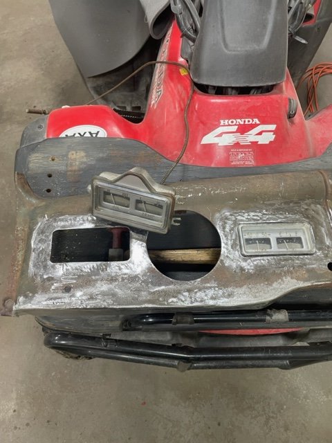

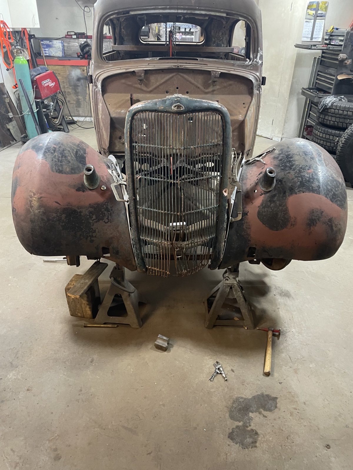

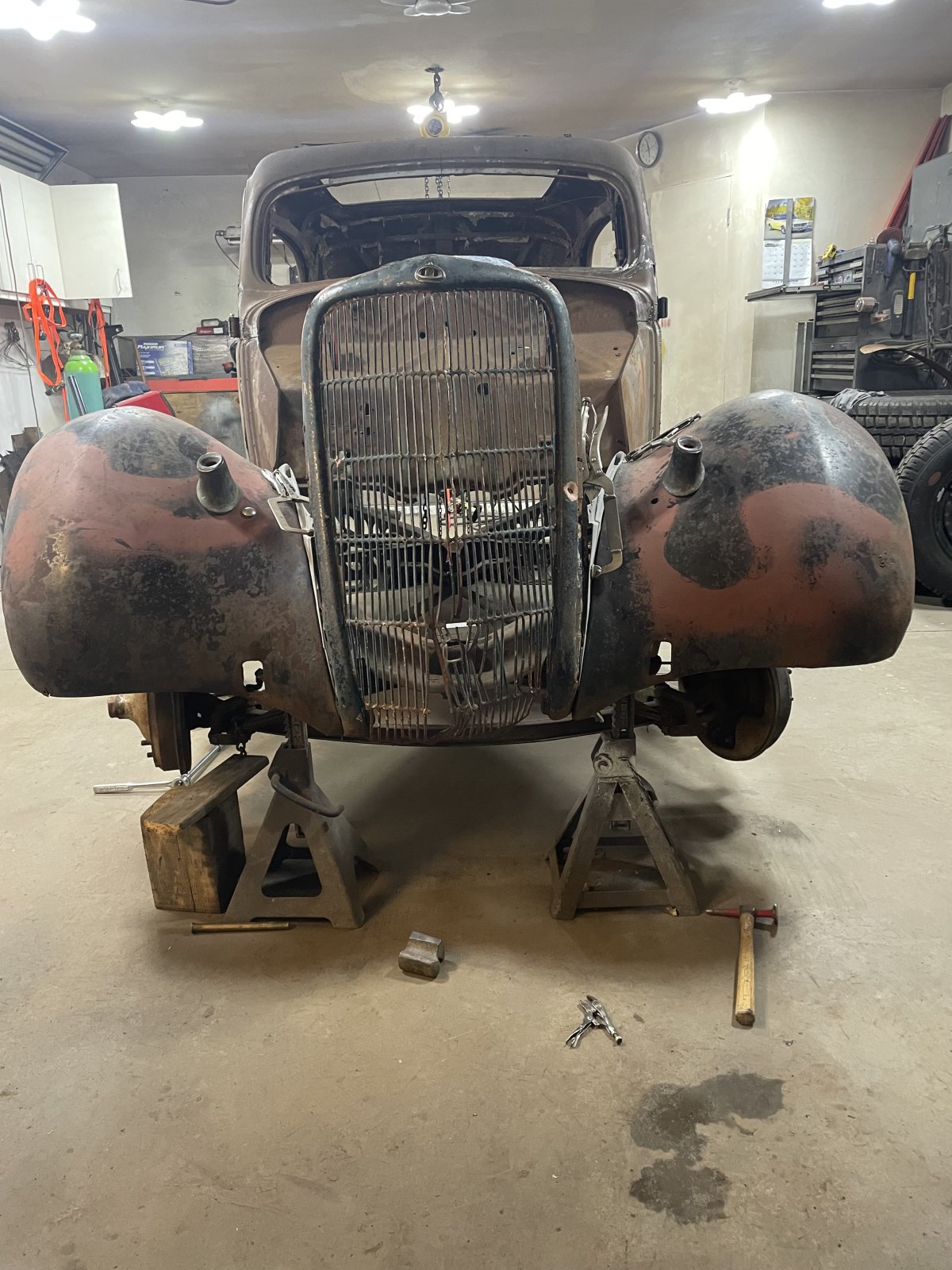

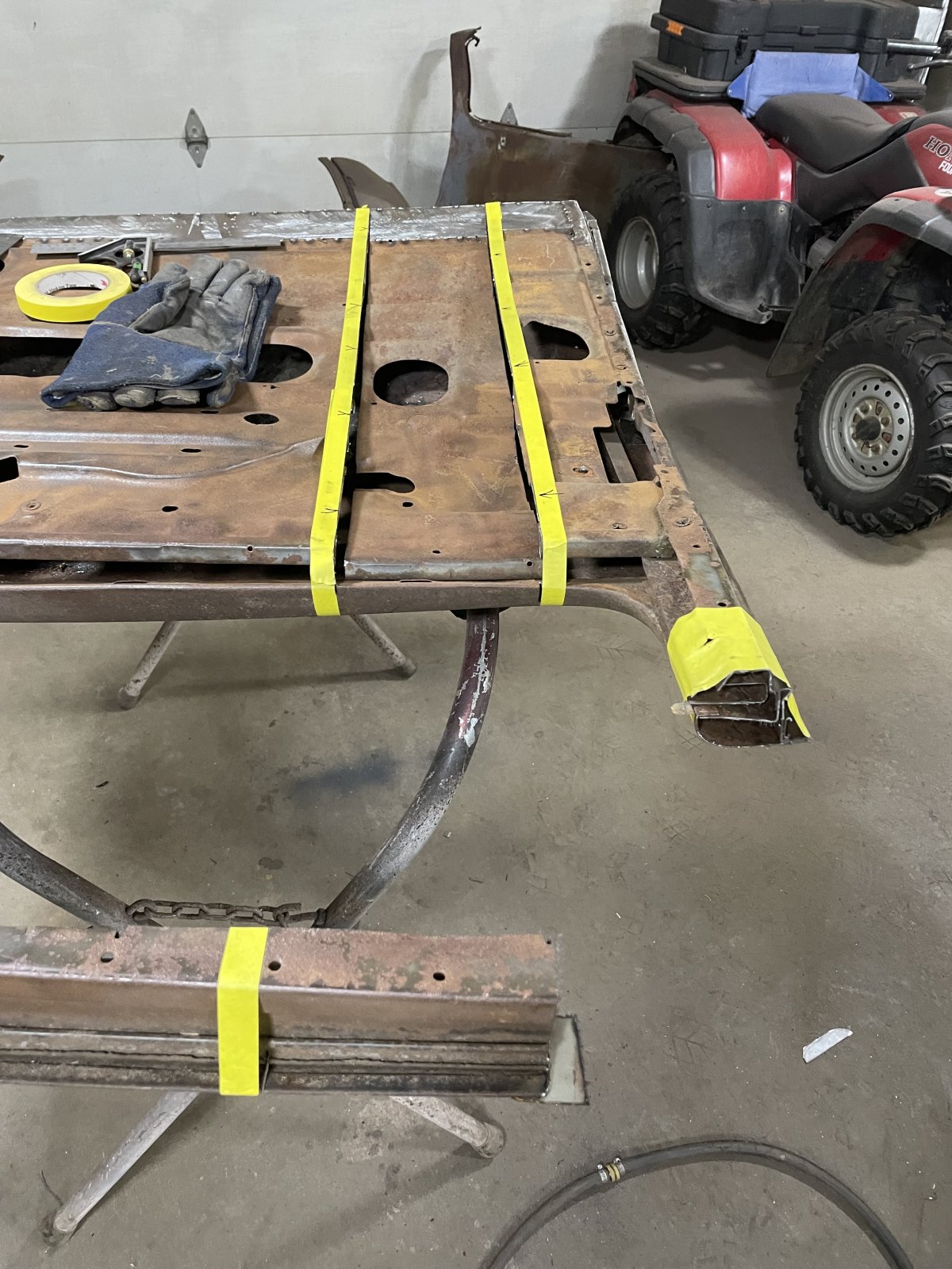

    New project thread . Last fall I purchased a 35 2 door humpback . And also the back half of a 35 four door sedan . This humpback will be transformed into a five window coupe this winter . Because the car is not in the shop yet I am fixing up some other issues that were in repair . The dash was butchered for its glove box door . They cut it out when they stole it . There were no gauges either but I did manage to find what I believe to be 46,47,48 gauges . I grafted them in as well . I had to make a glovebox door as well . Parts for this era car on eBay are ridiculous so it requires good old fashioned hot rod ingenuity. Use what ya got , it’s a hot rod . In the next two weeks I will be bringing home a donor 57 Meteor . It has a 302 , c4 and the correct width differential 9” and I will be running 4:10 ratio .
    I’ll get some pictures of the car and parts , in the meantime have a look at some of my progress .

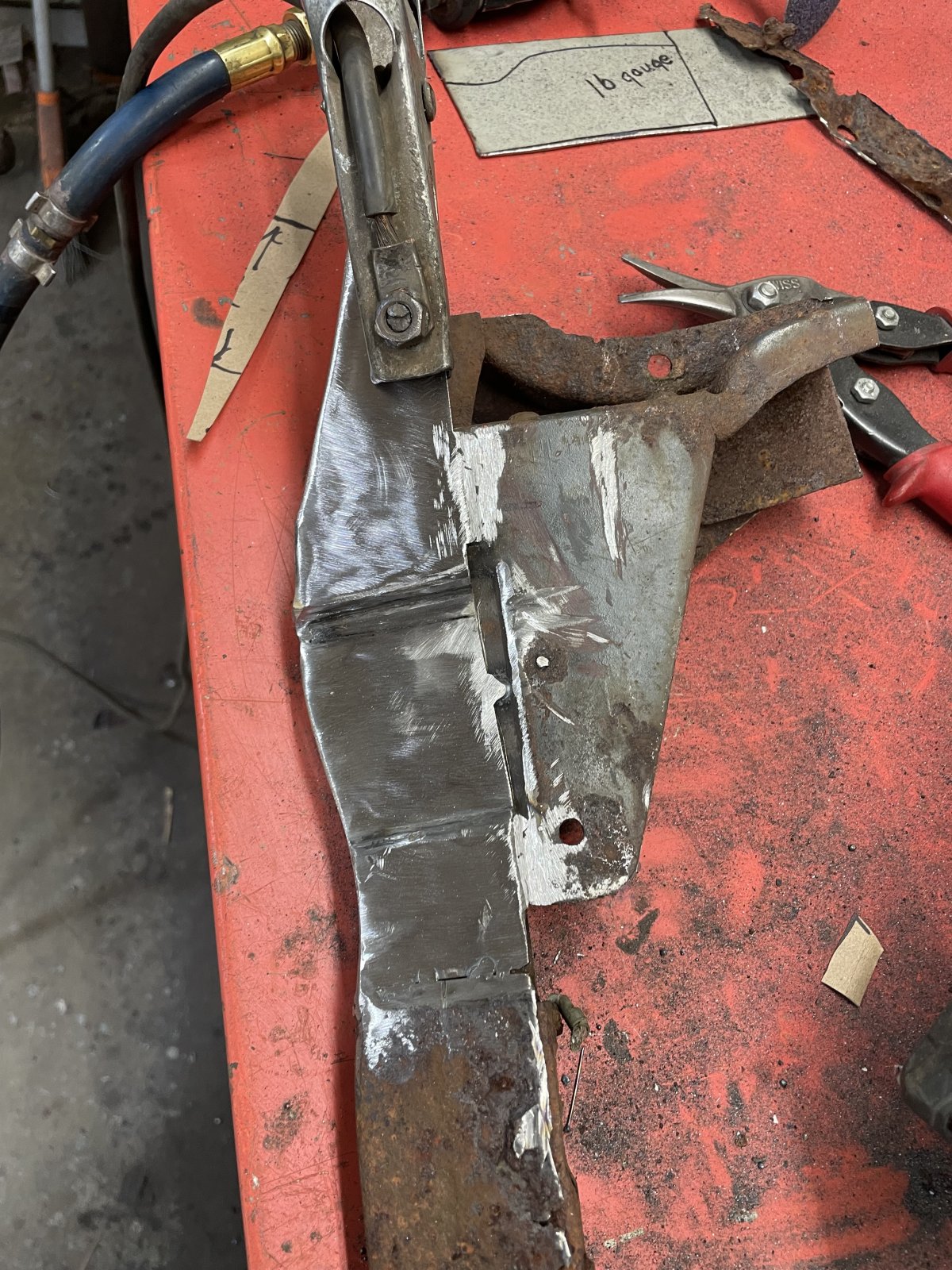

  2. aw1950
    Joined: Dec 21, 2008
    Posts: 1,523

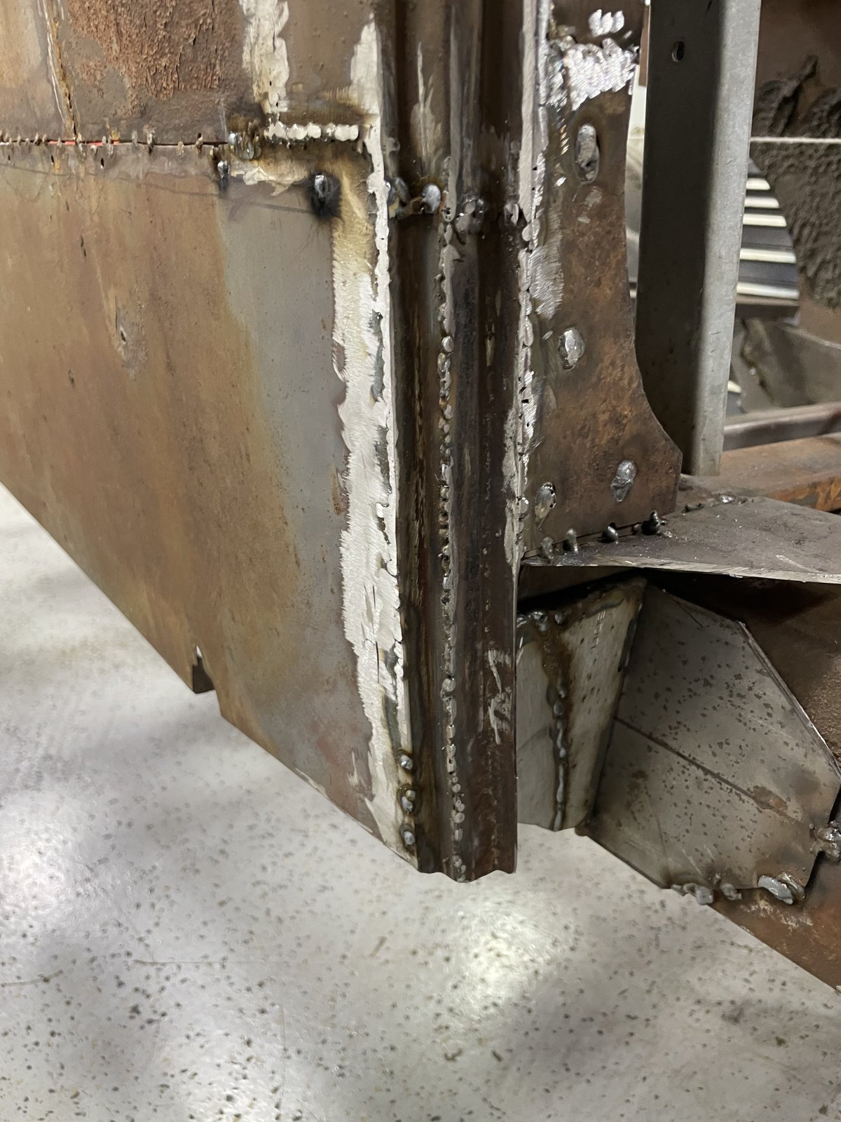

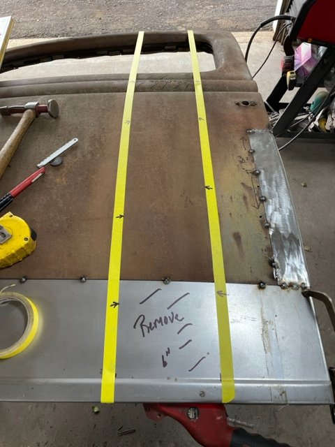

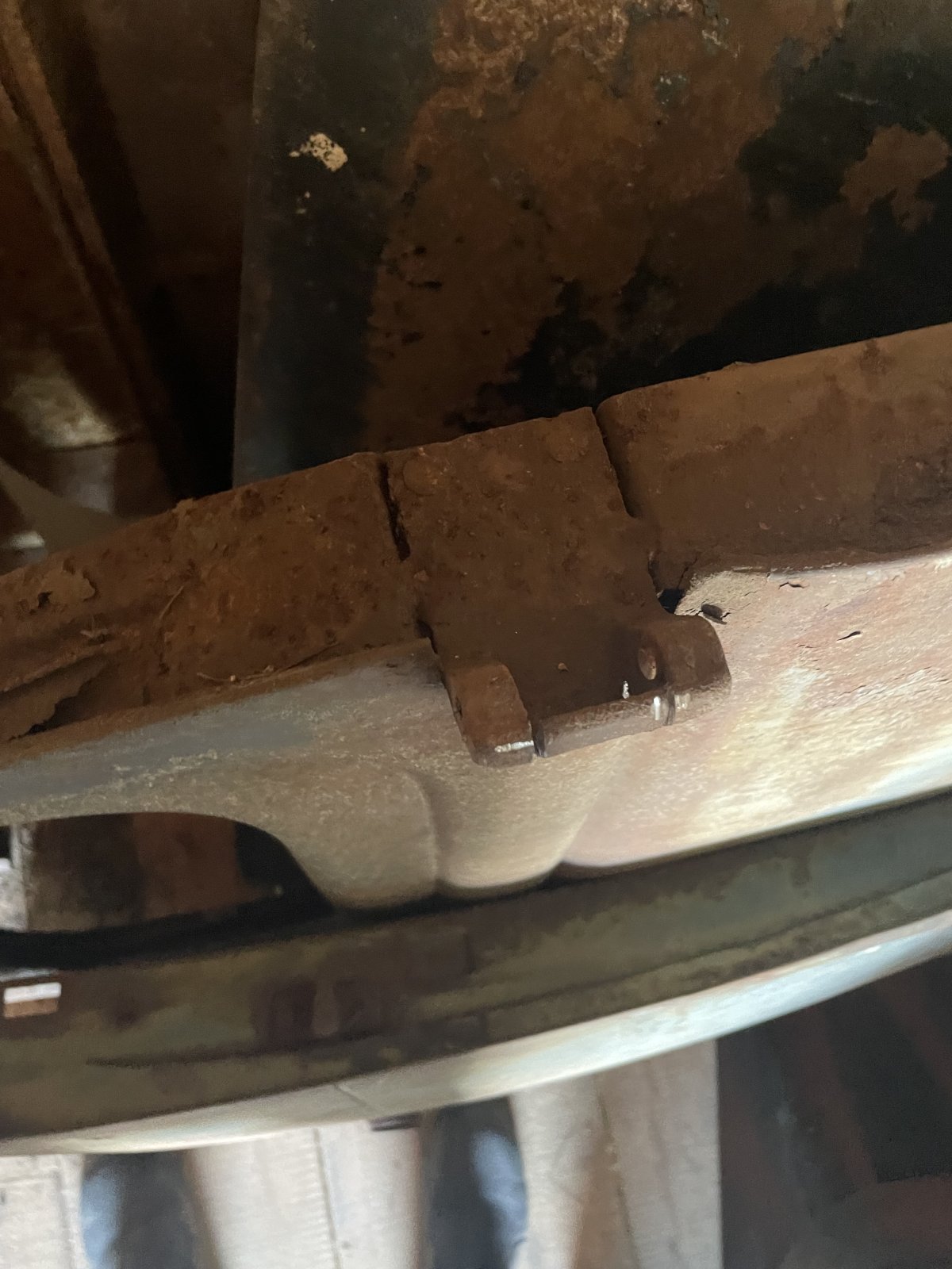

    aw1950

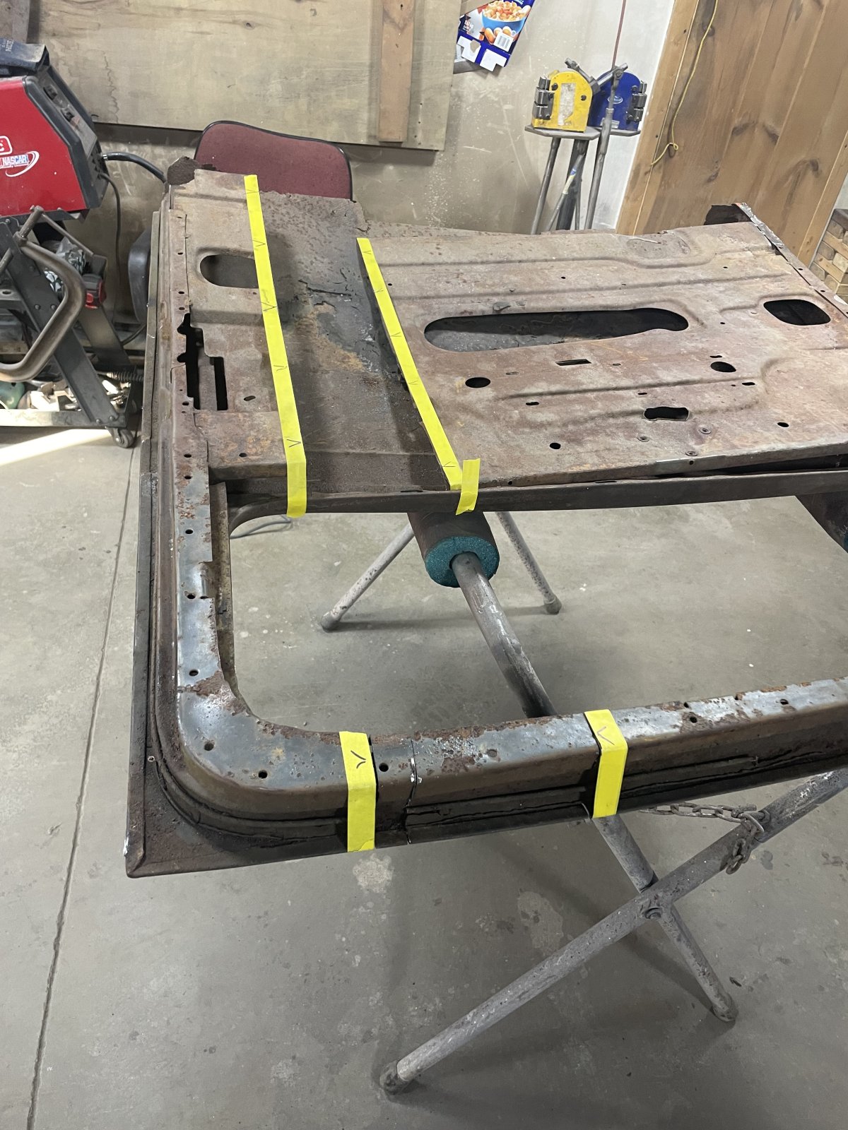

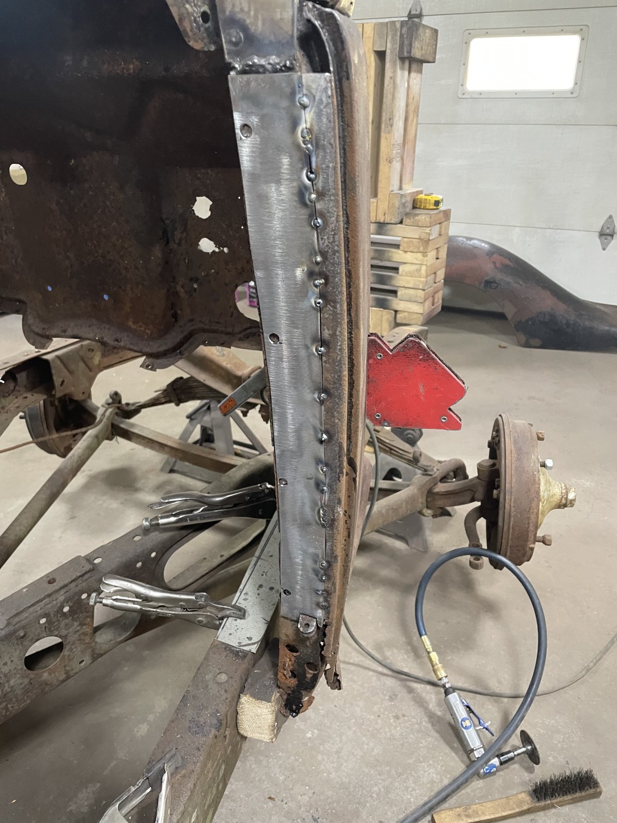

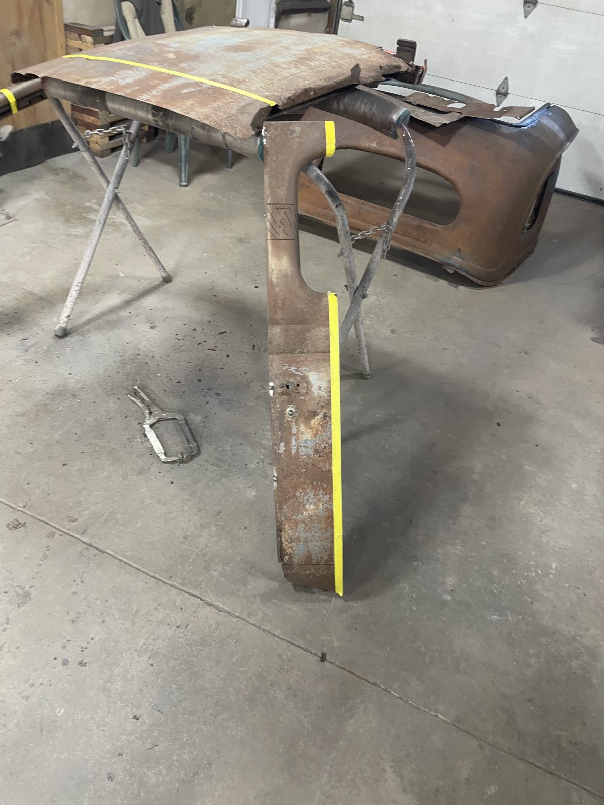

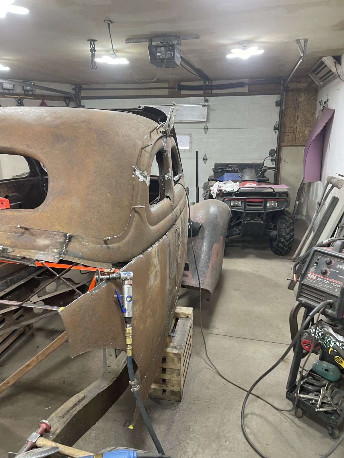

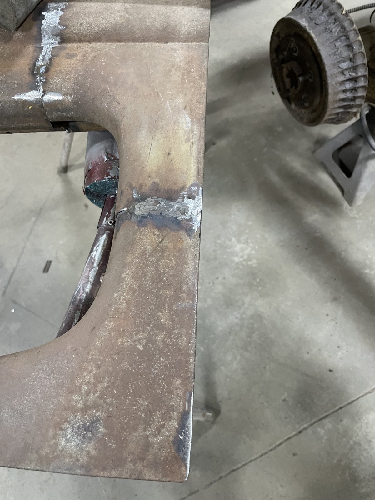

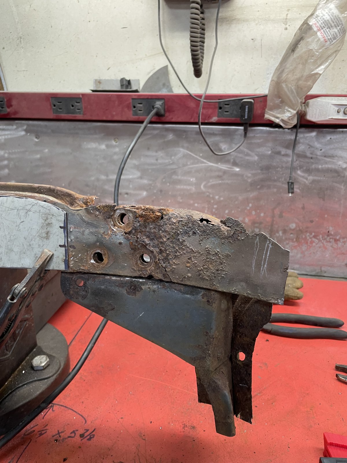

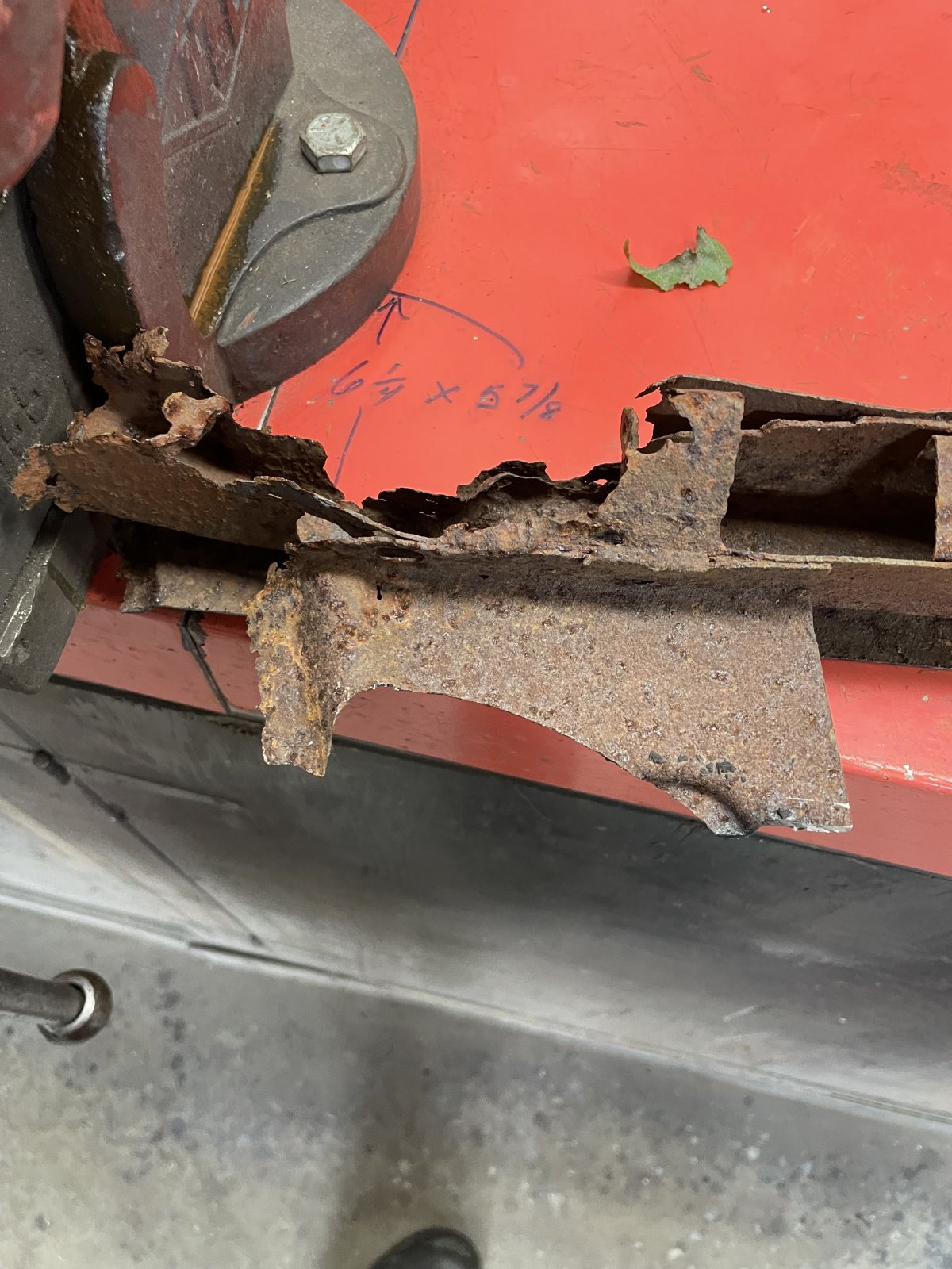

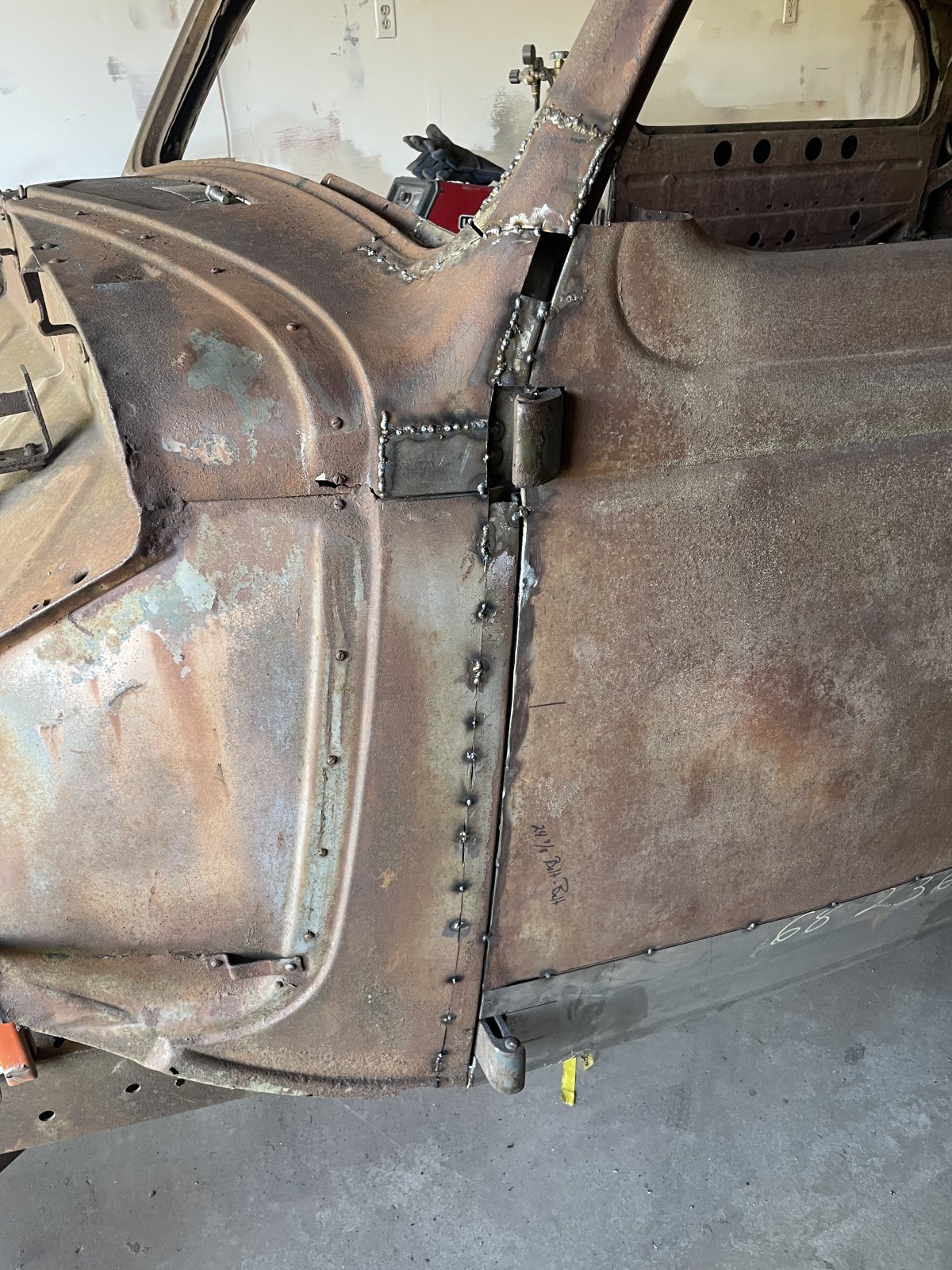

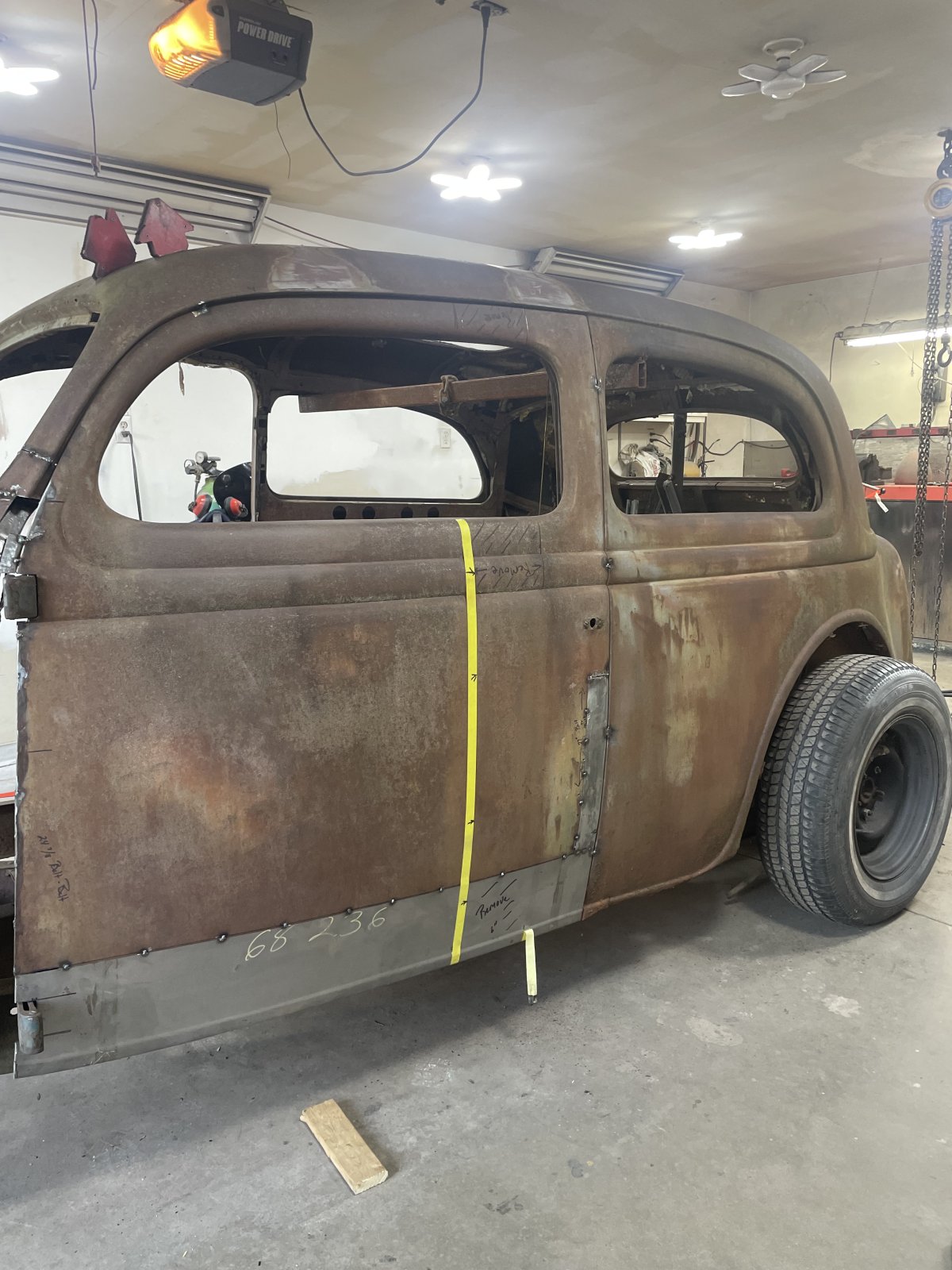

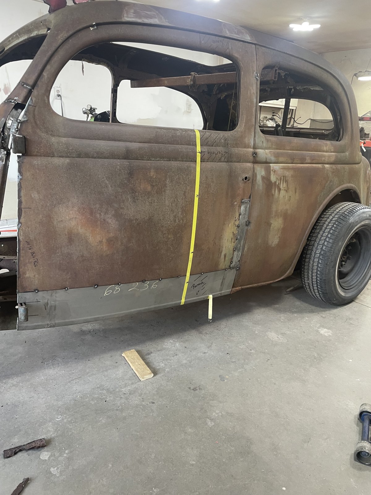

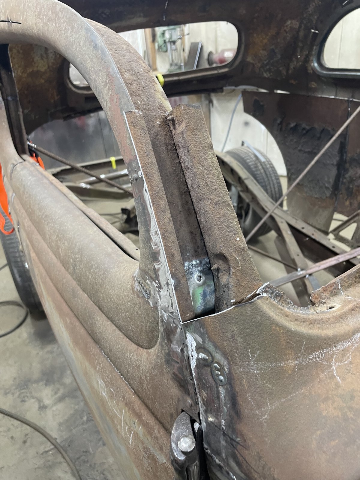

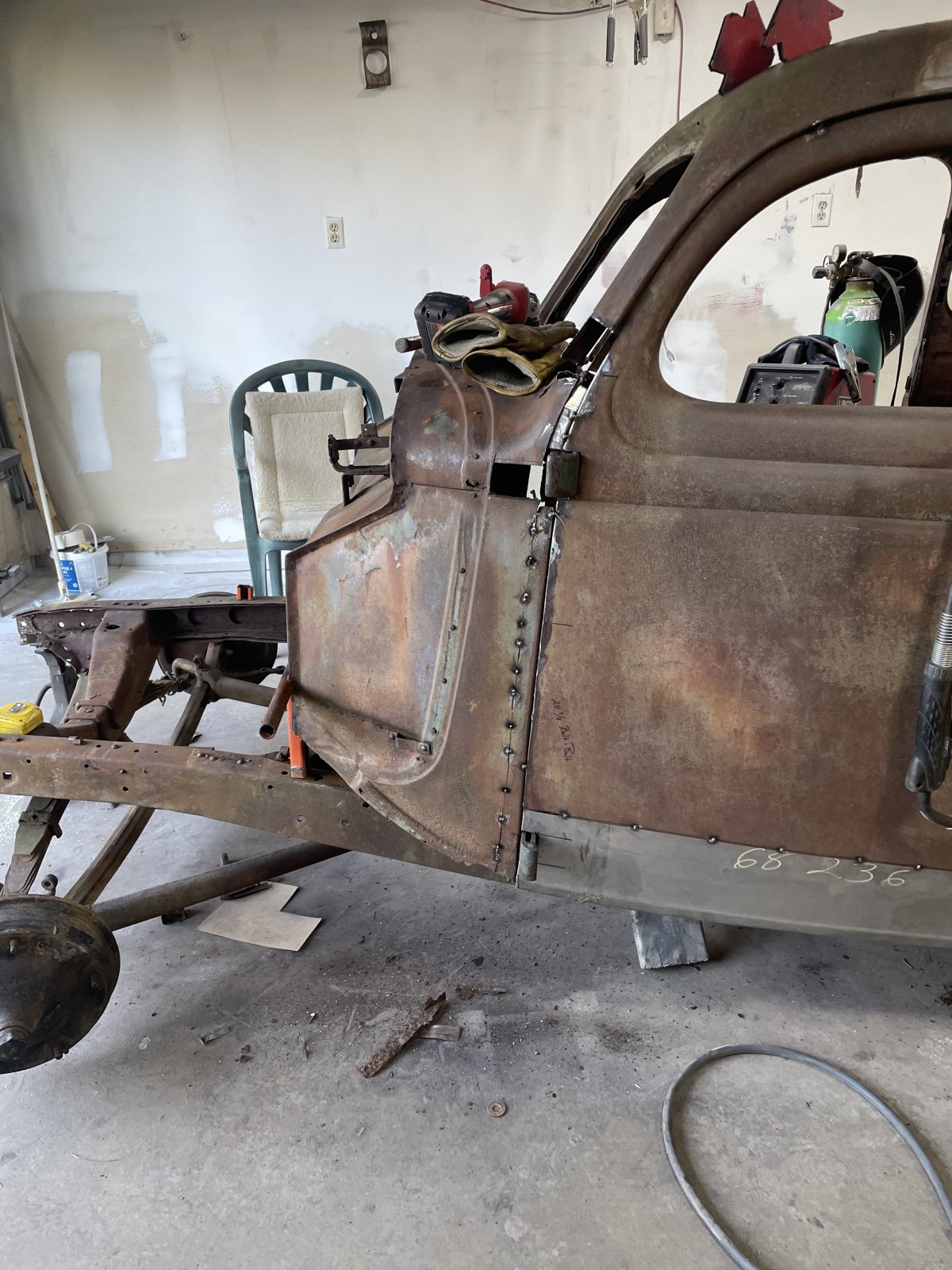

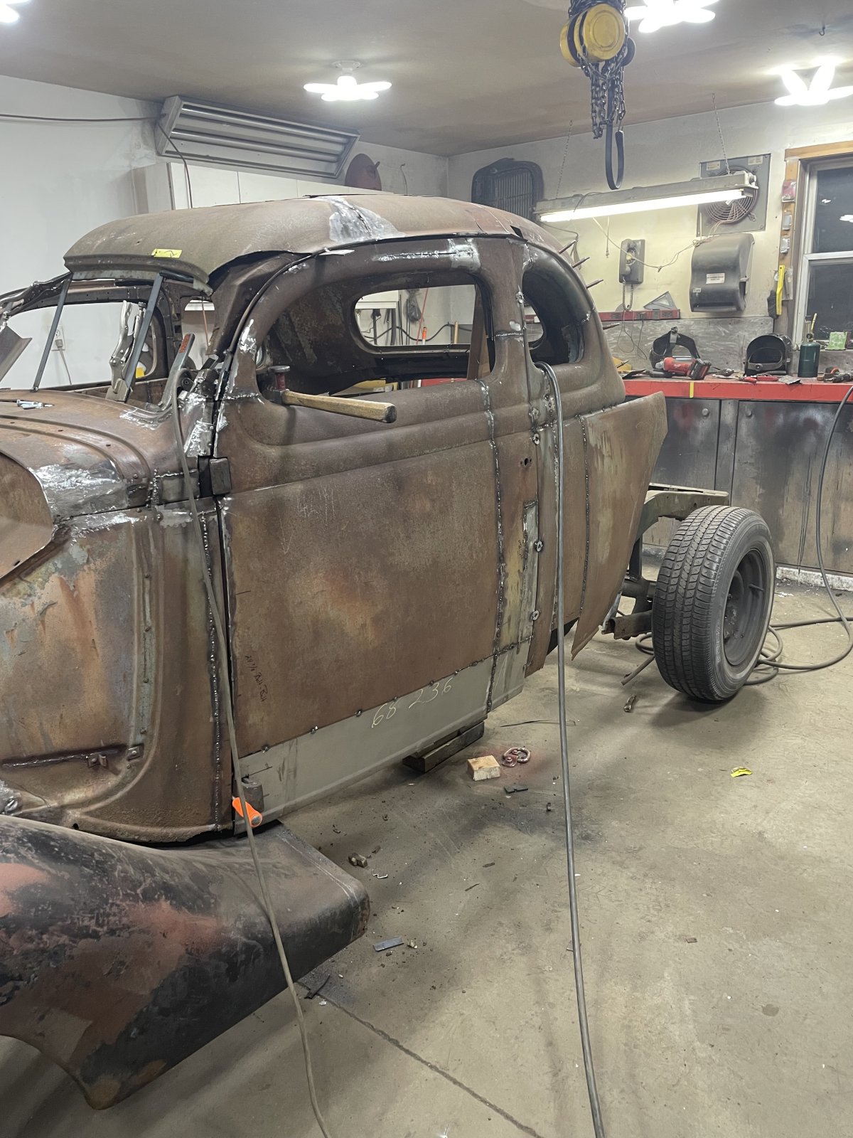

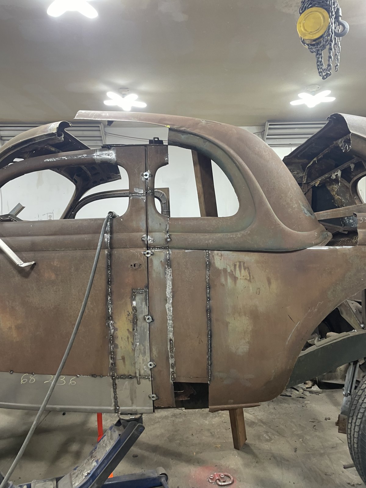

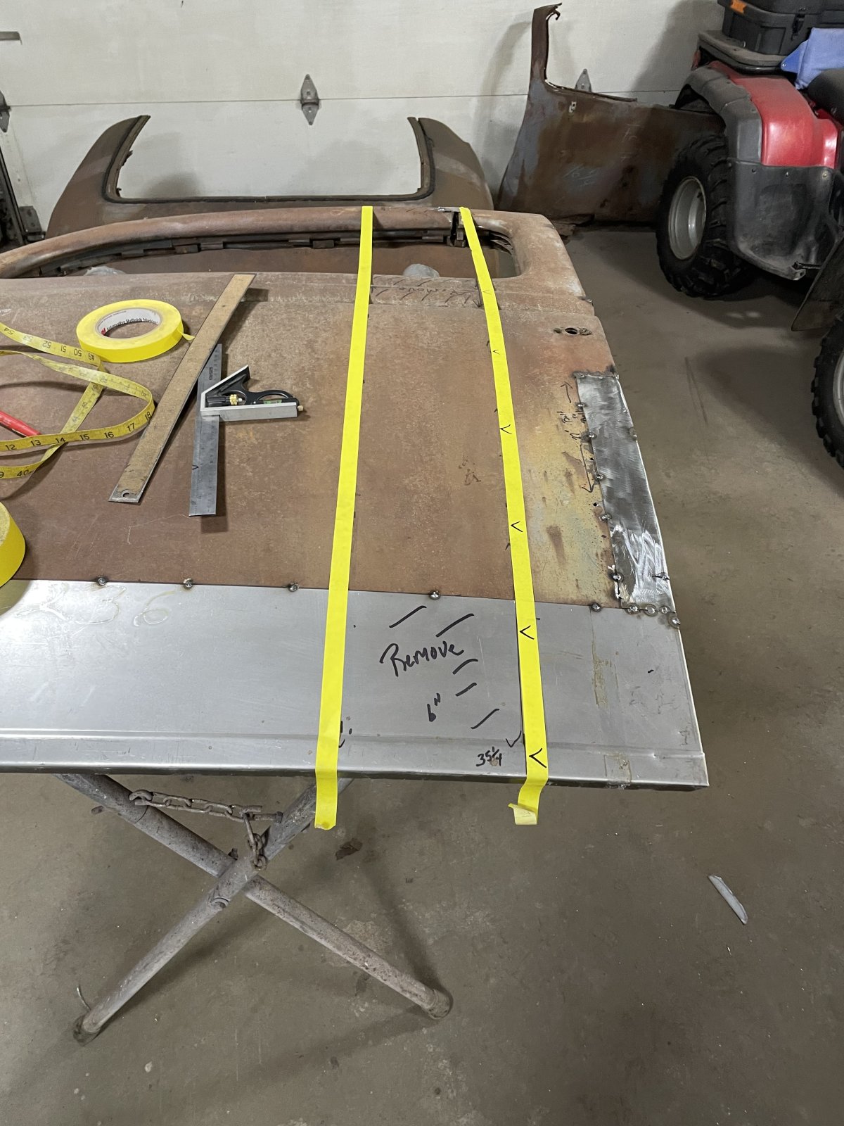

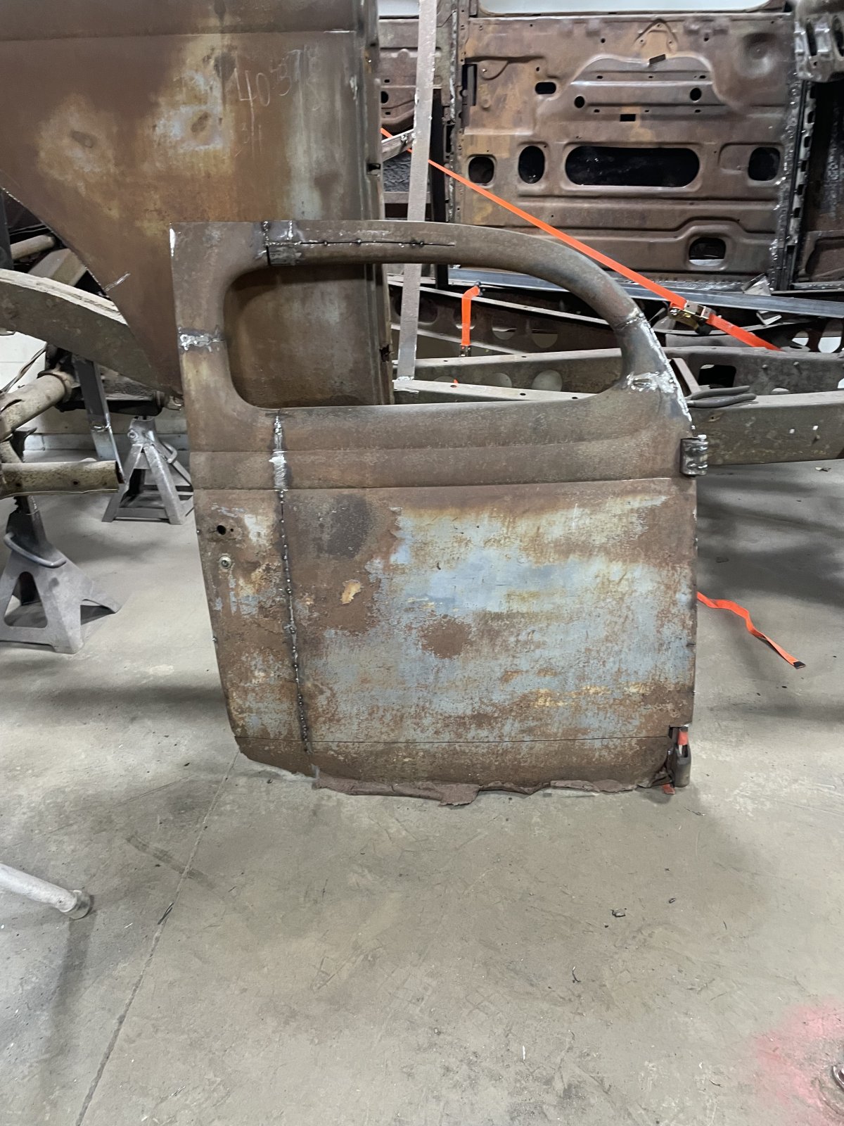

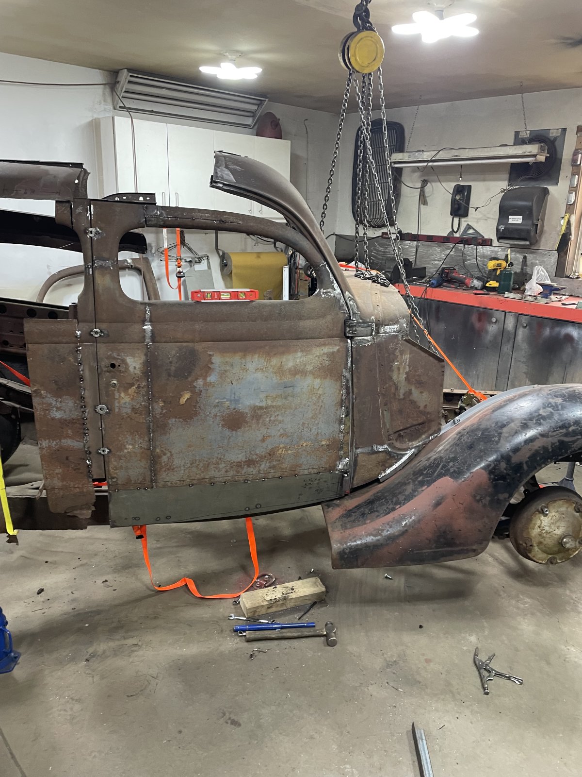

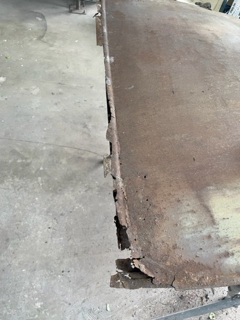

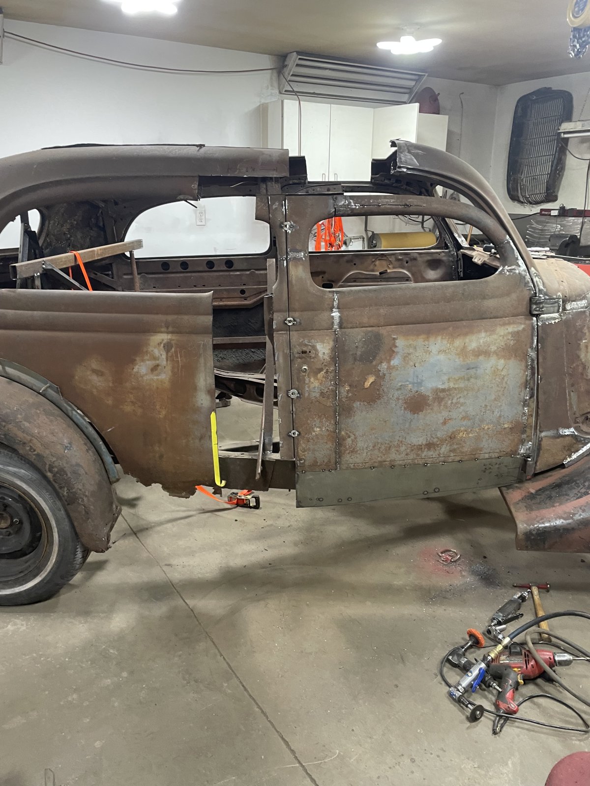

    Also the drive door was in serious need of help . I changed the hinge post completely as it had two good hinges . Bottom of door completely gone . And after all tacked together it will get six inches sectioned out as the sedan doors are to large for 5 window coupe conversion .

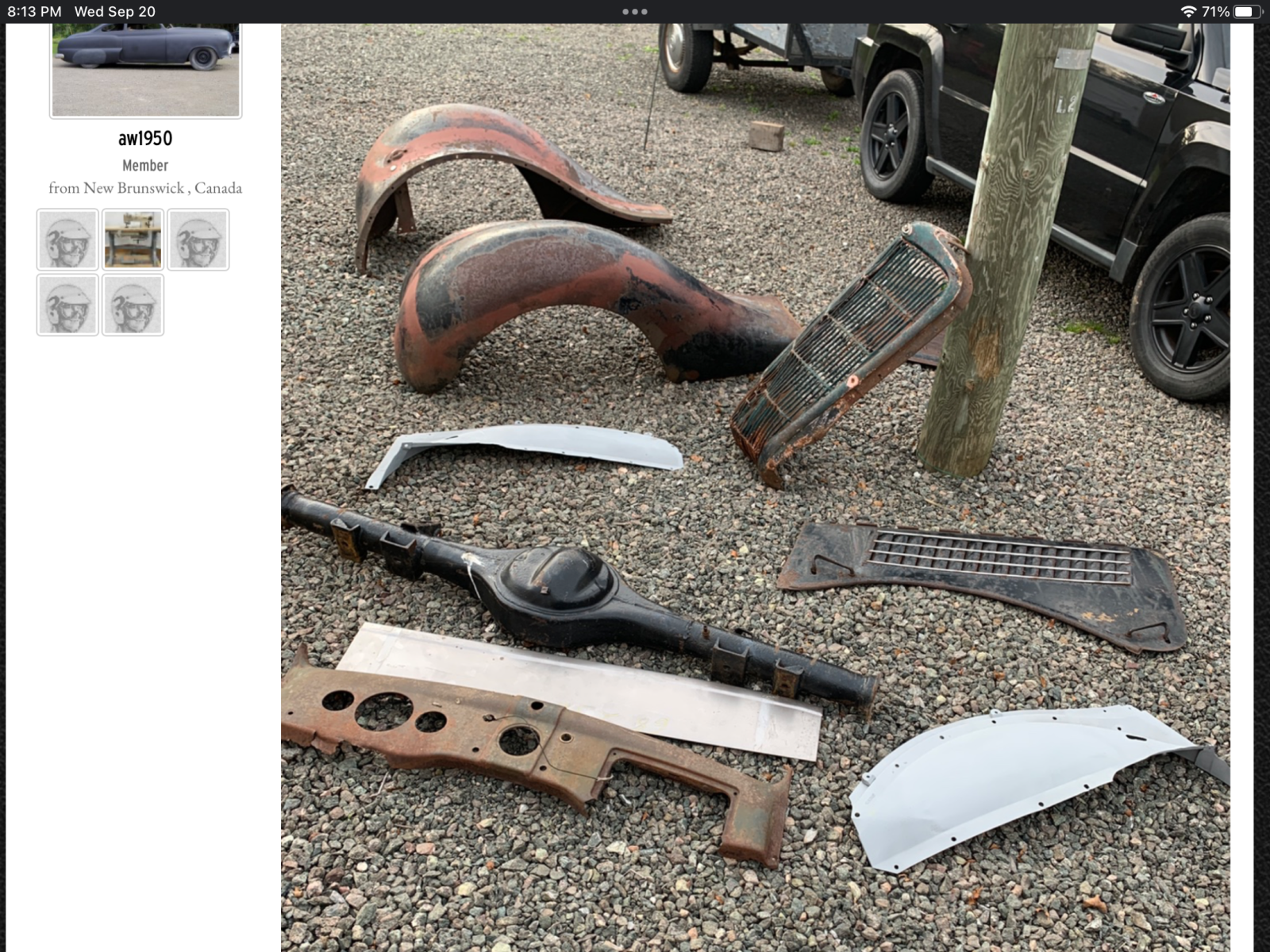

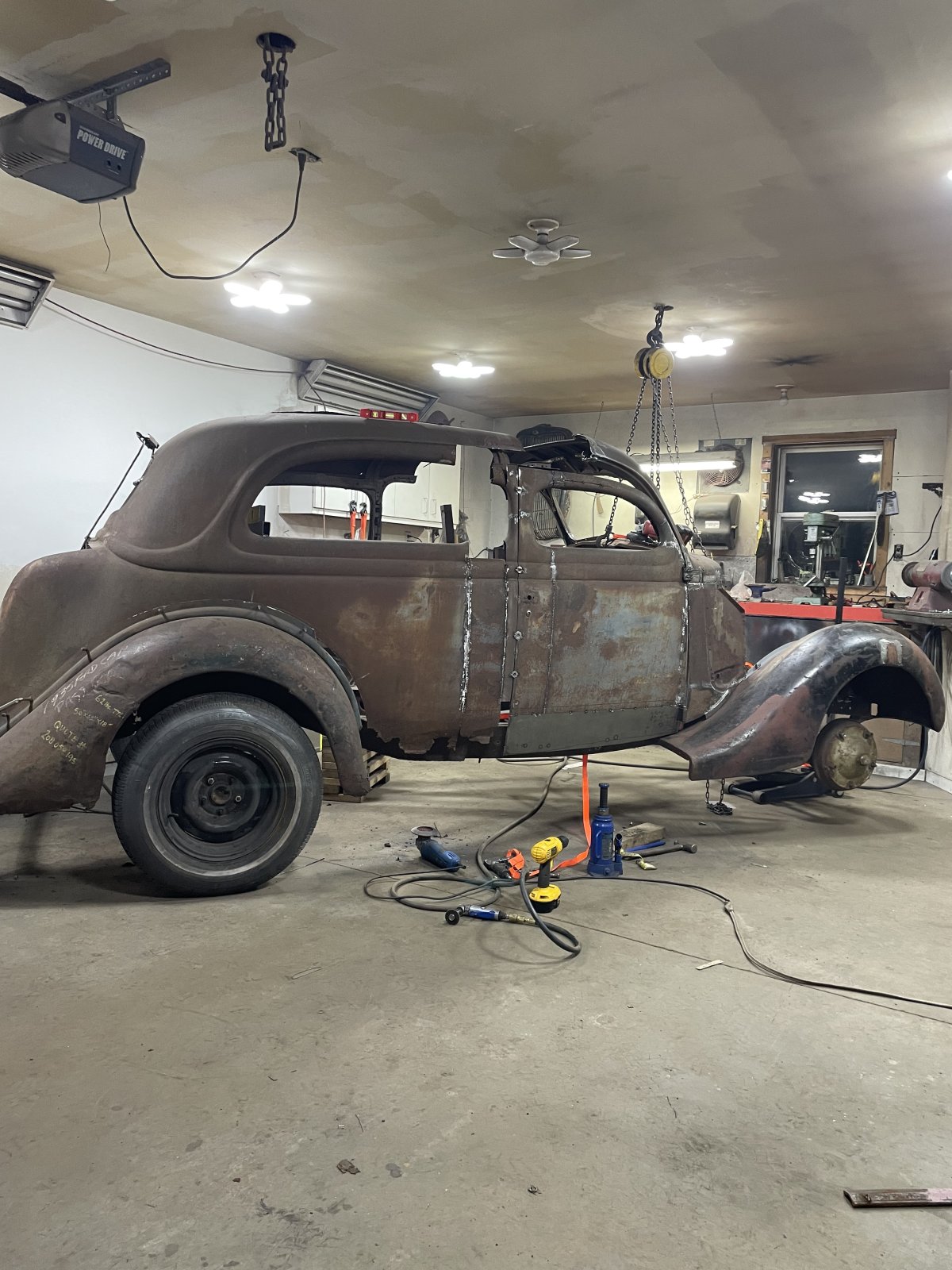

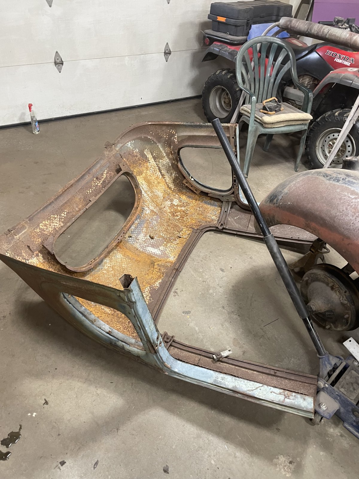

    aw1950

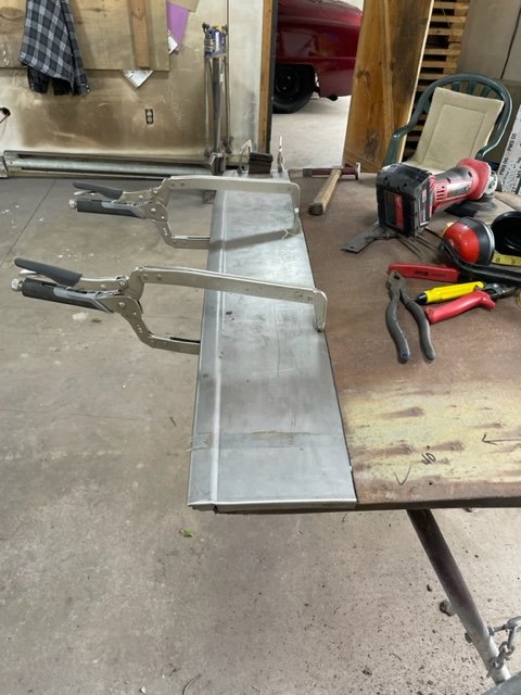

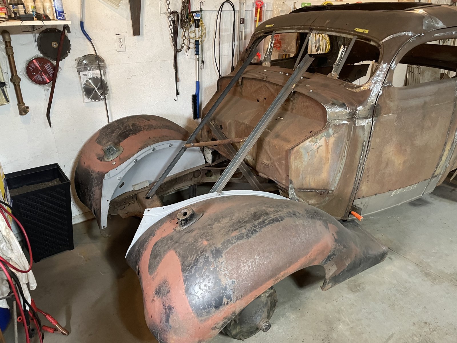

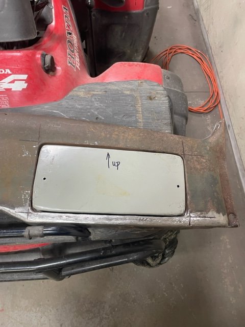

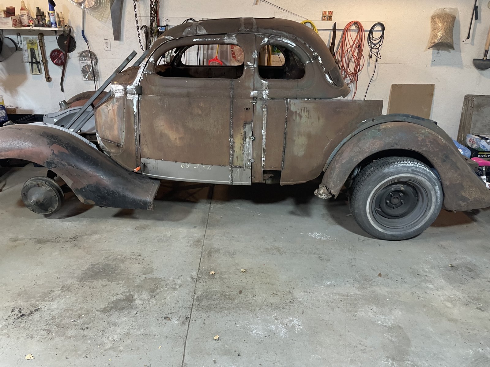

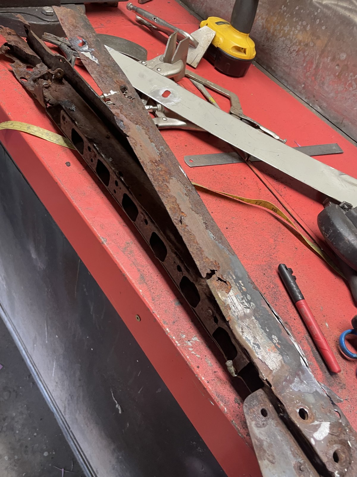

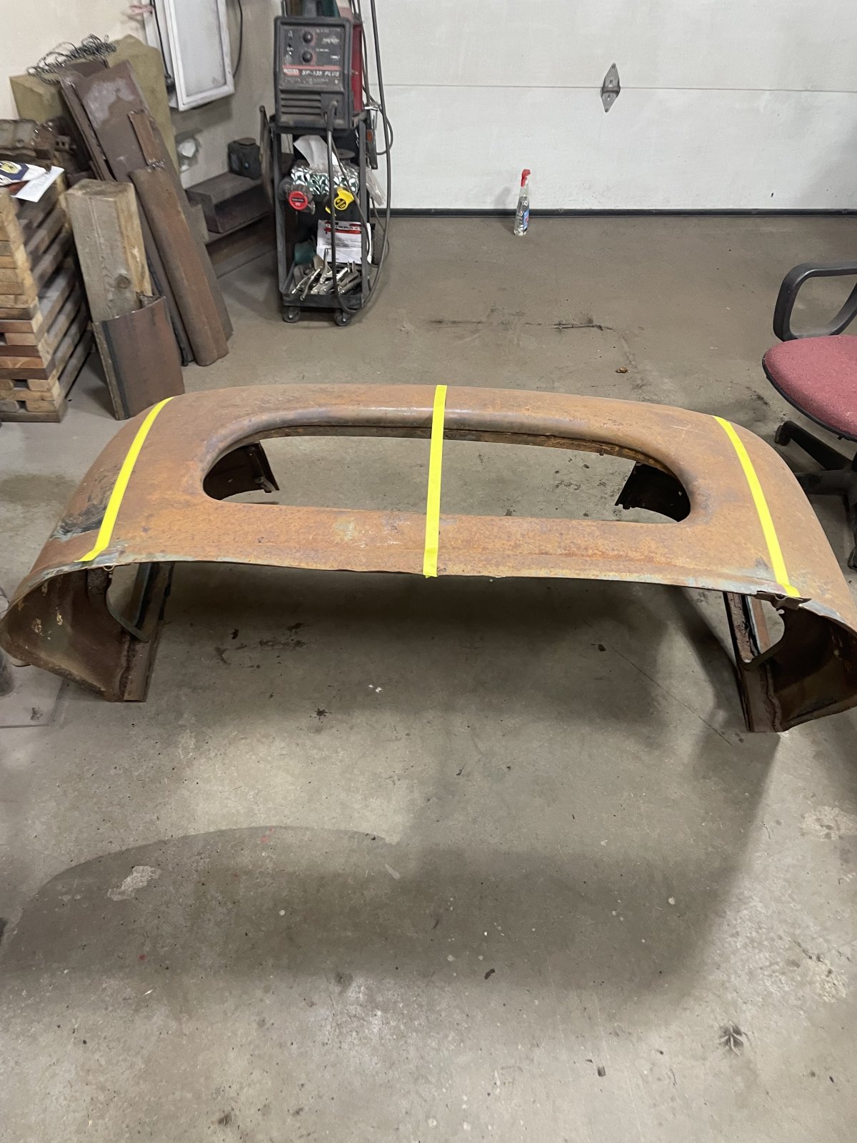

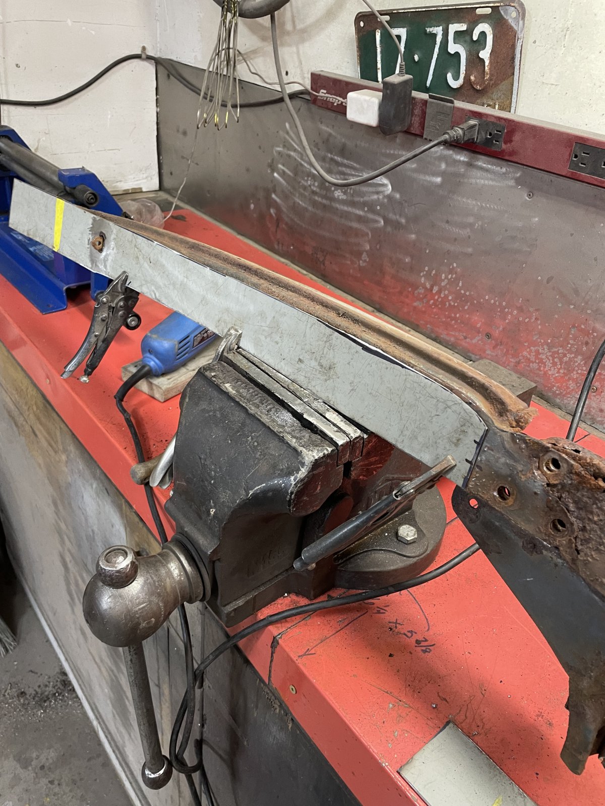

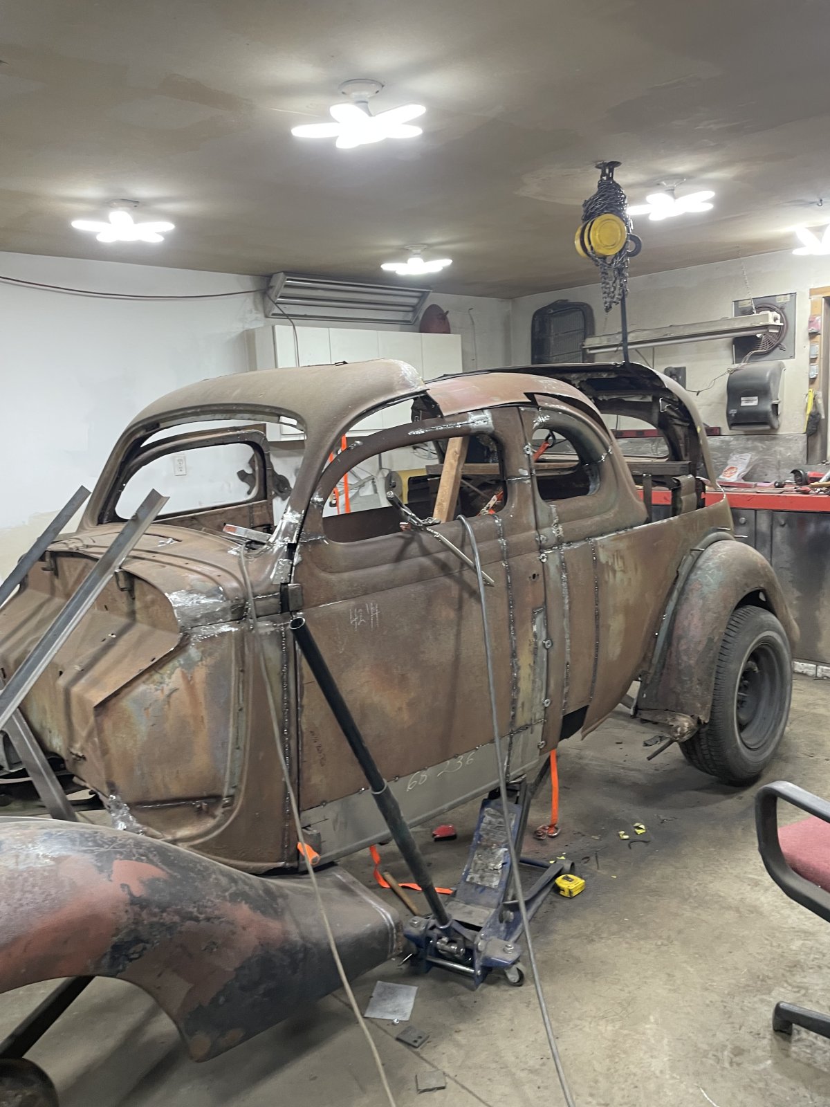

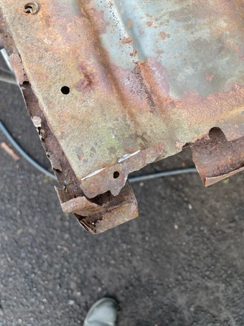

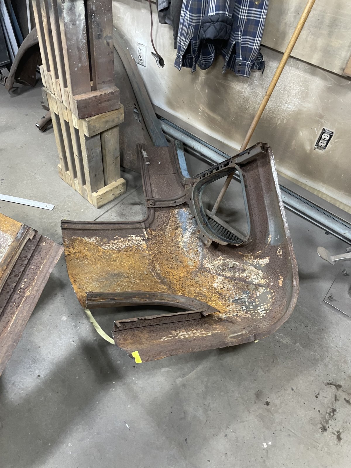

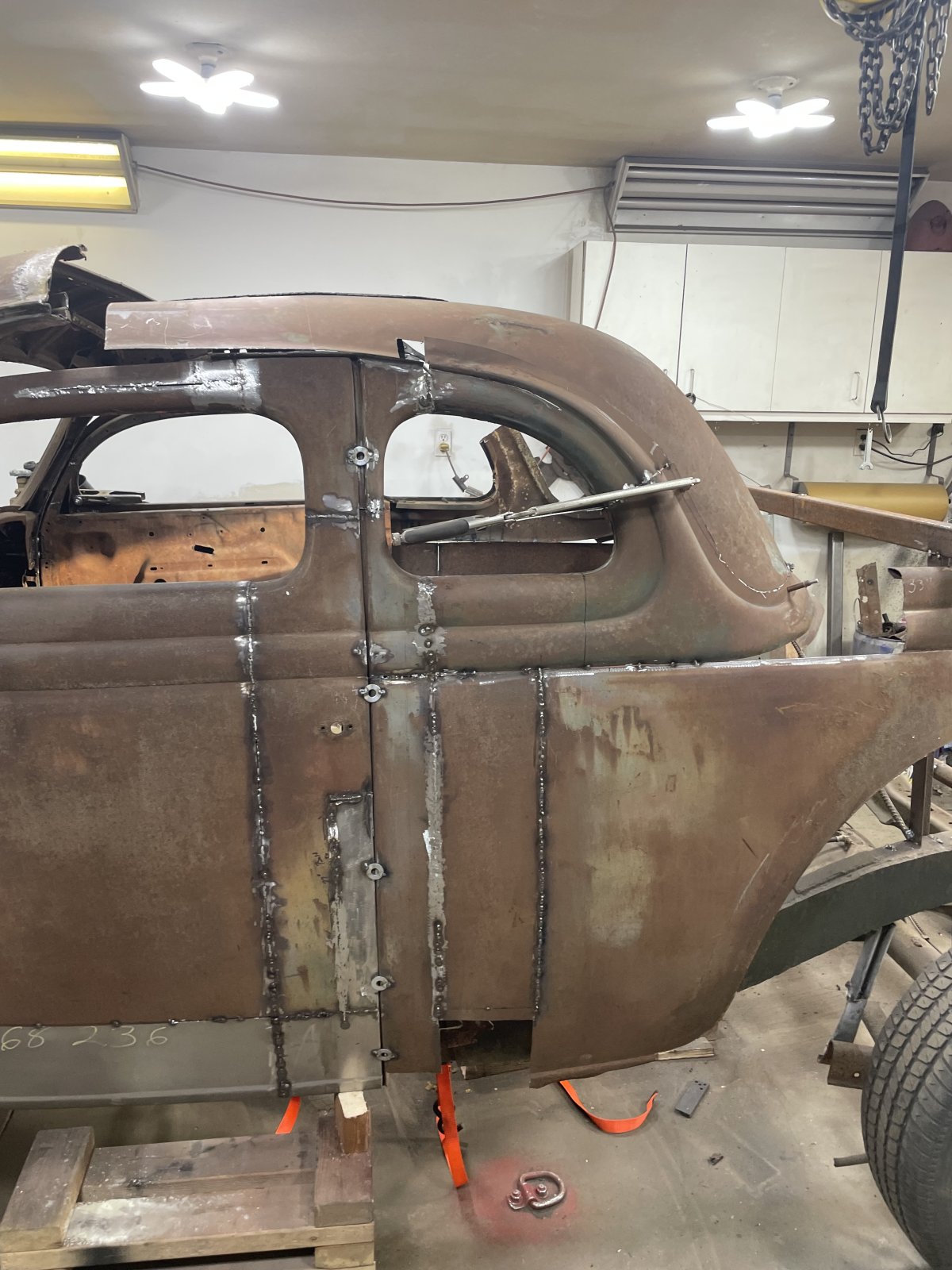

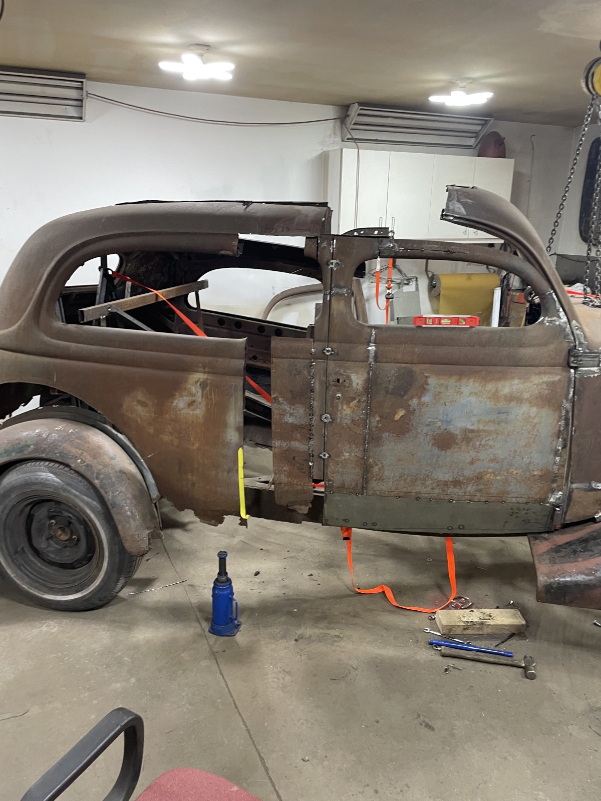

    So here’s some pictures and parts of my 35 conversion project .

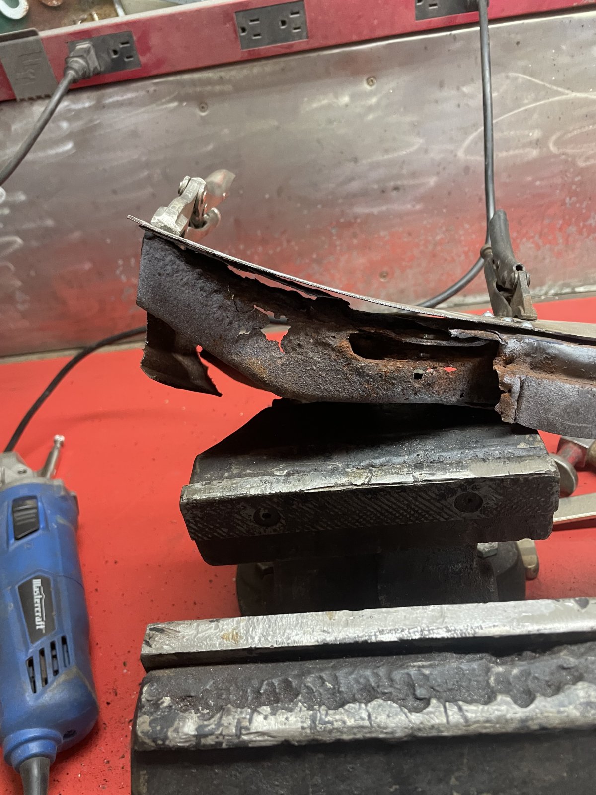

  4. aw1950
    Posts: 1,523

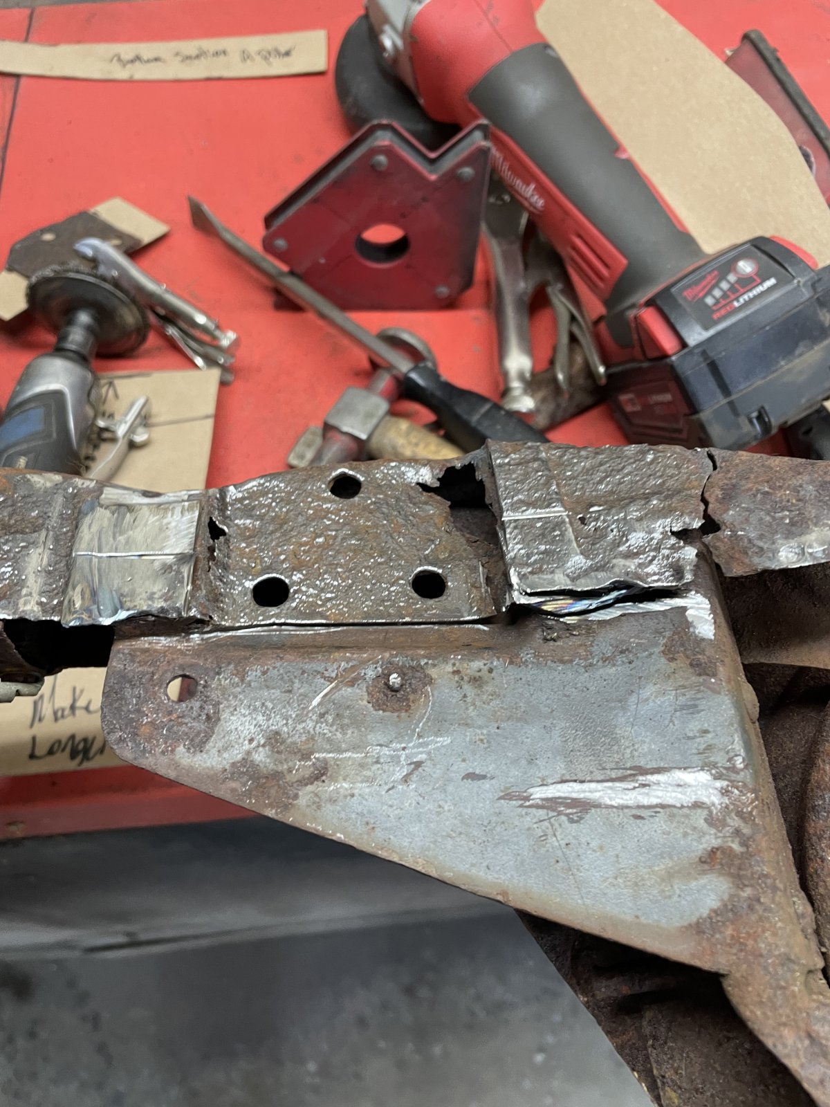

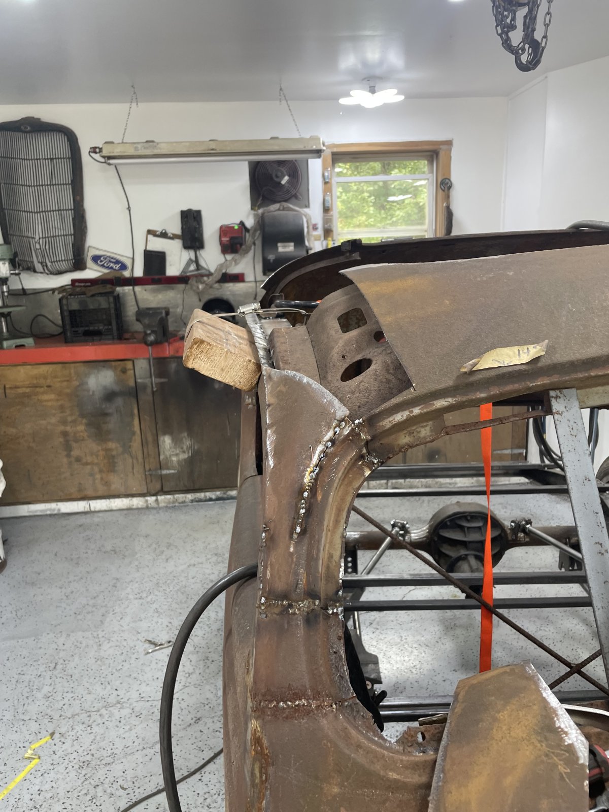

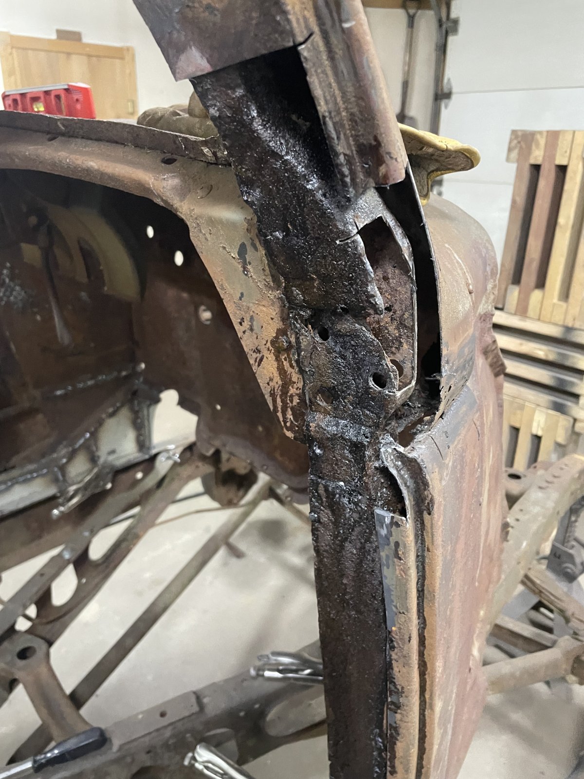

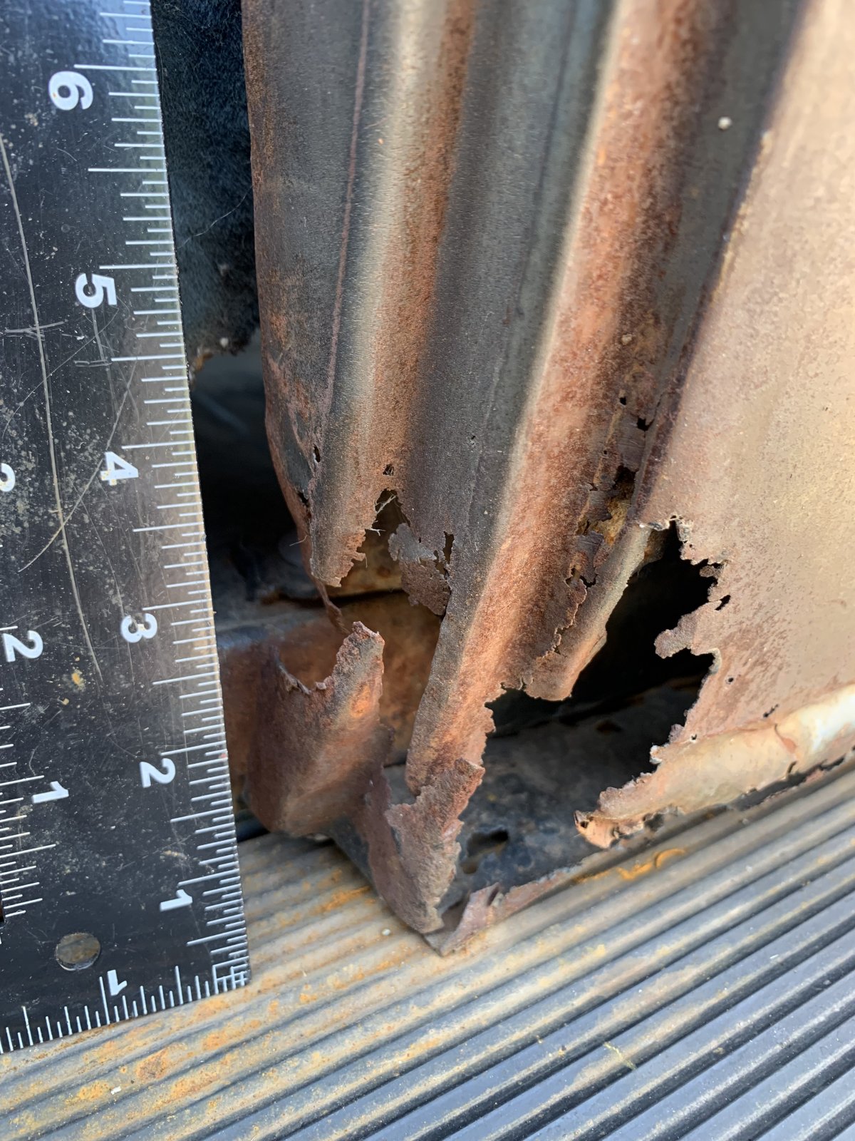

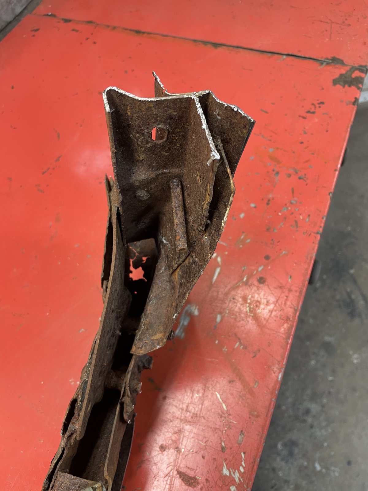

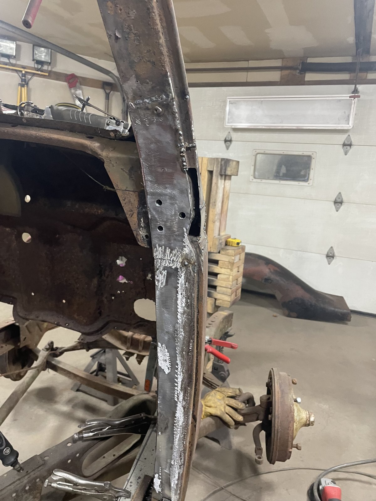

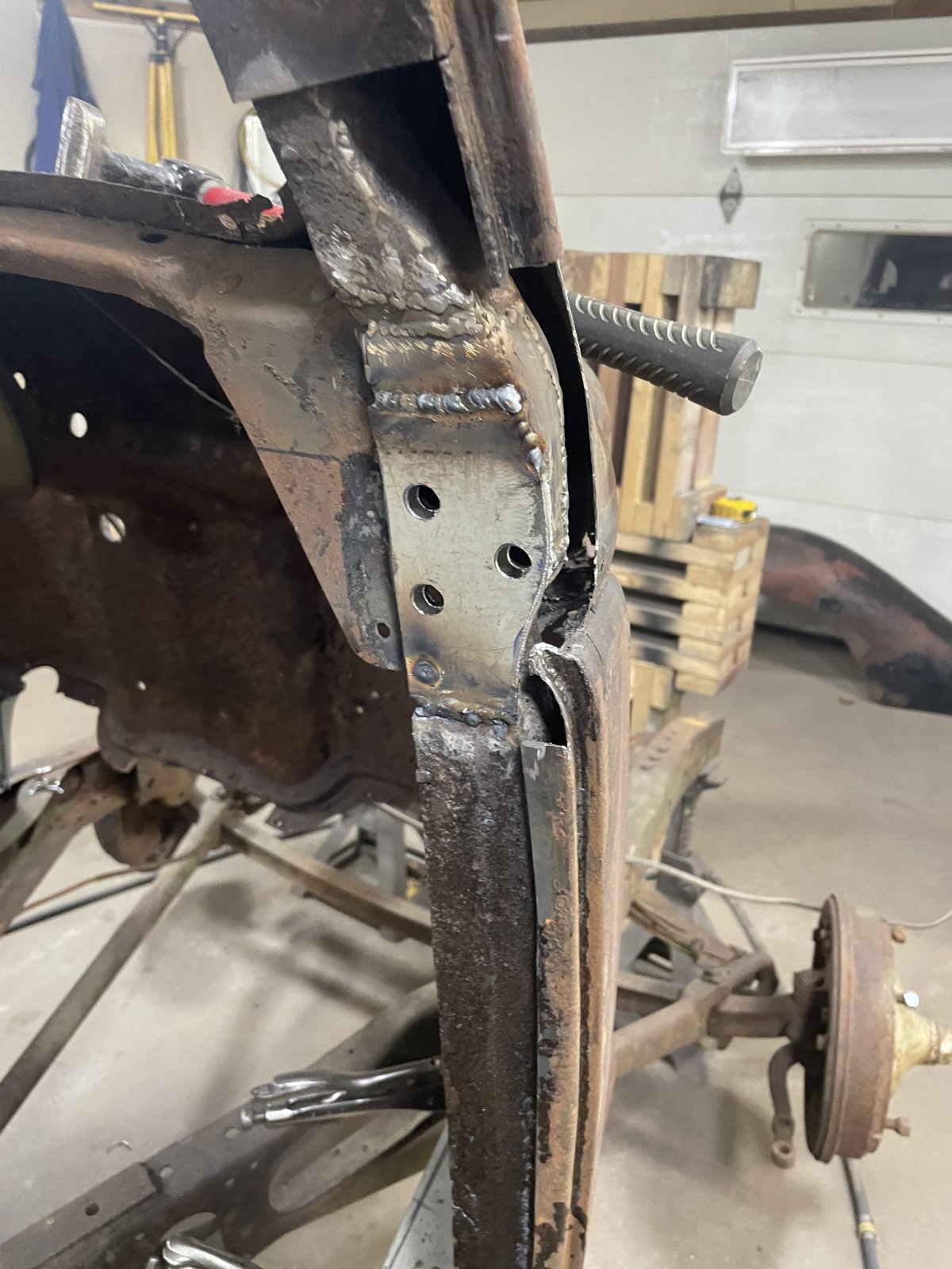

    aw1950

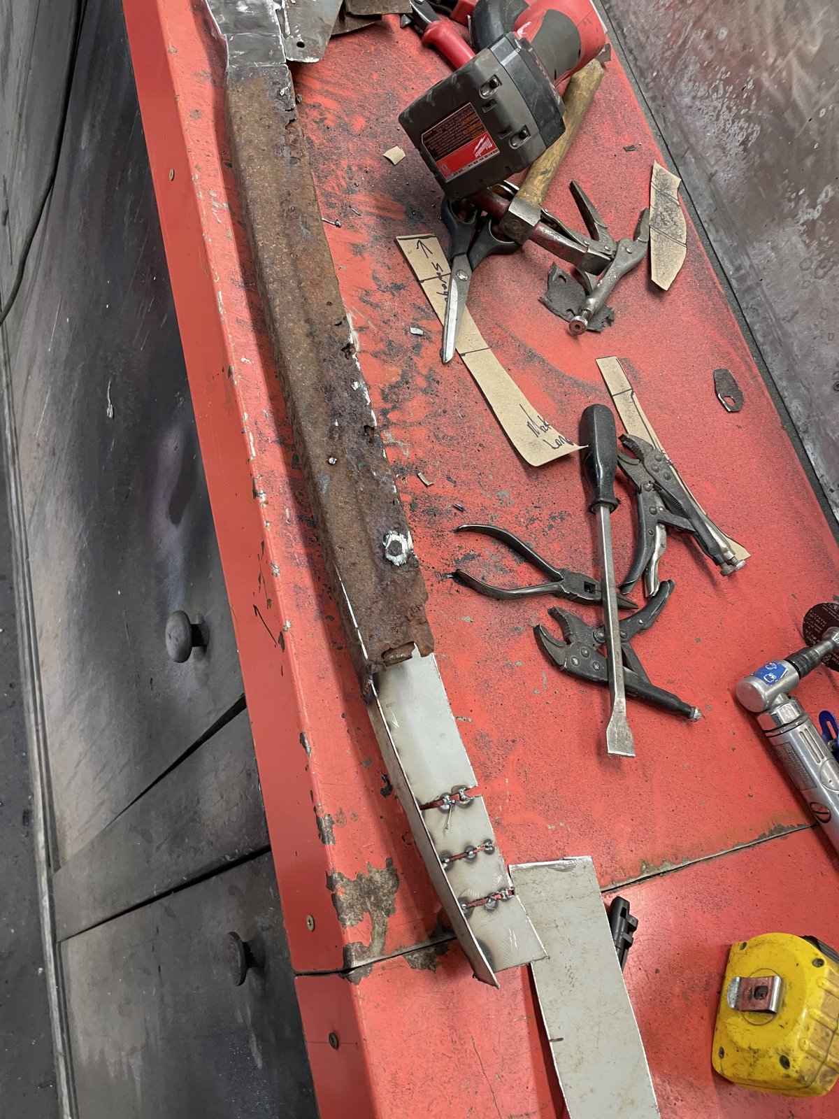

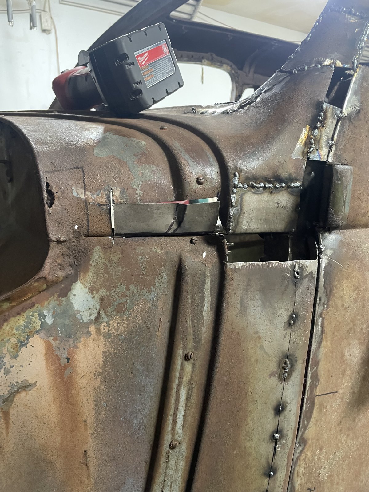

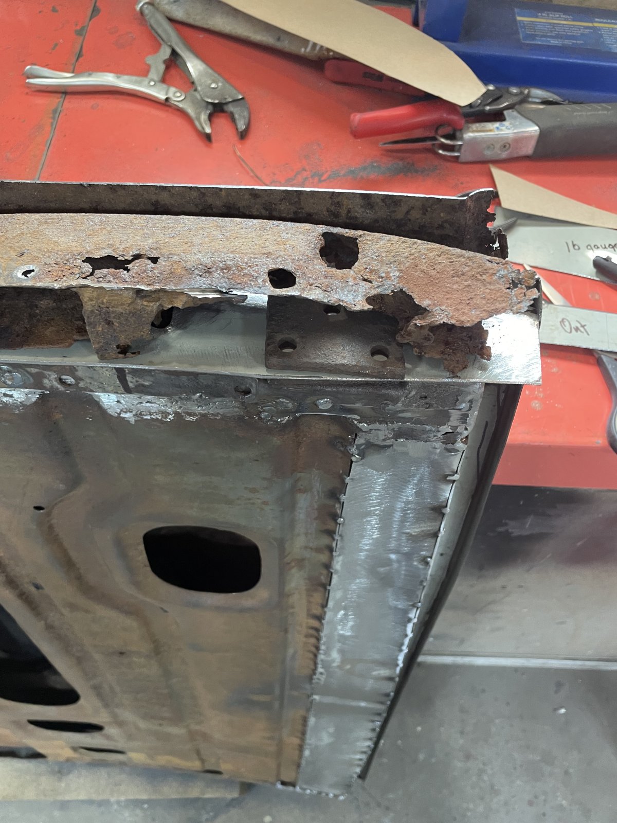

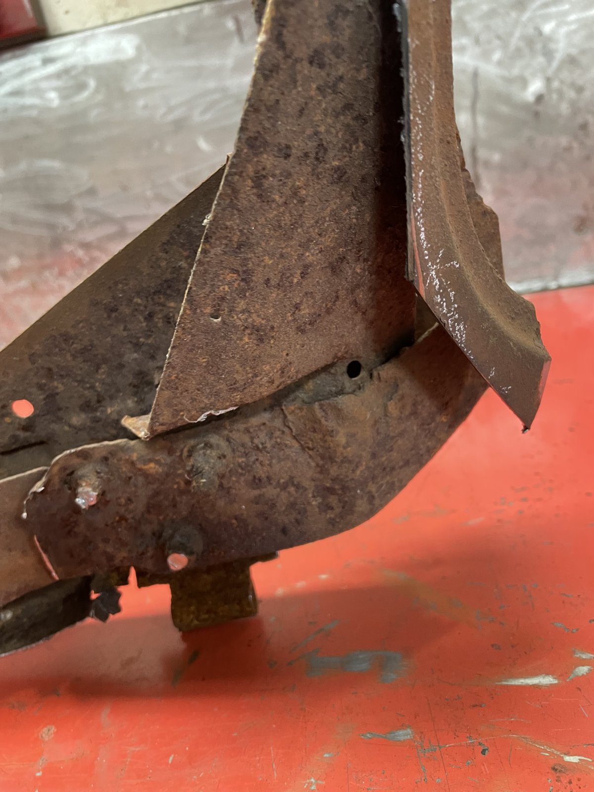

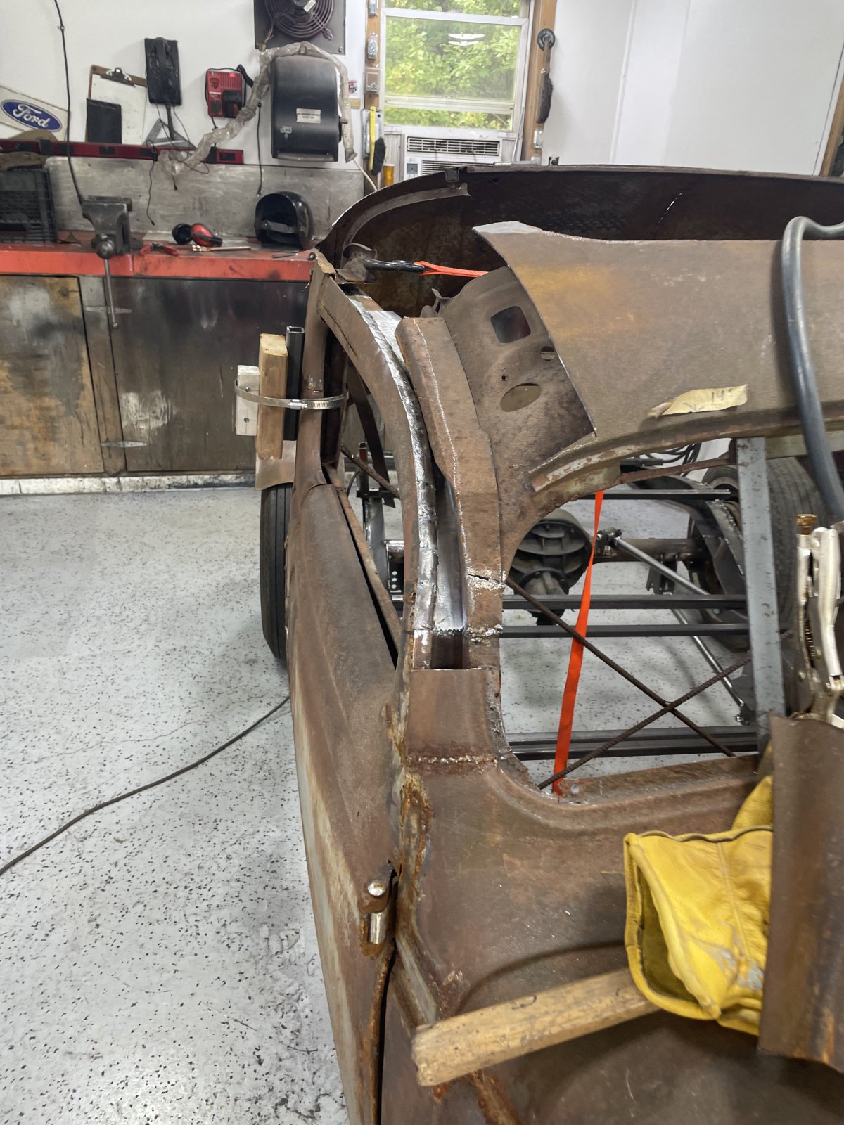

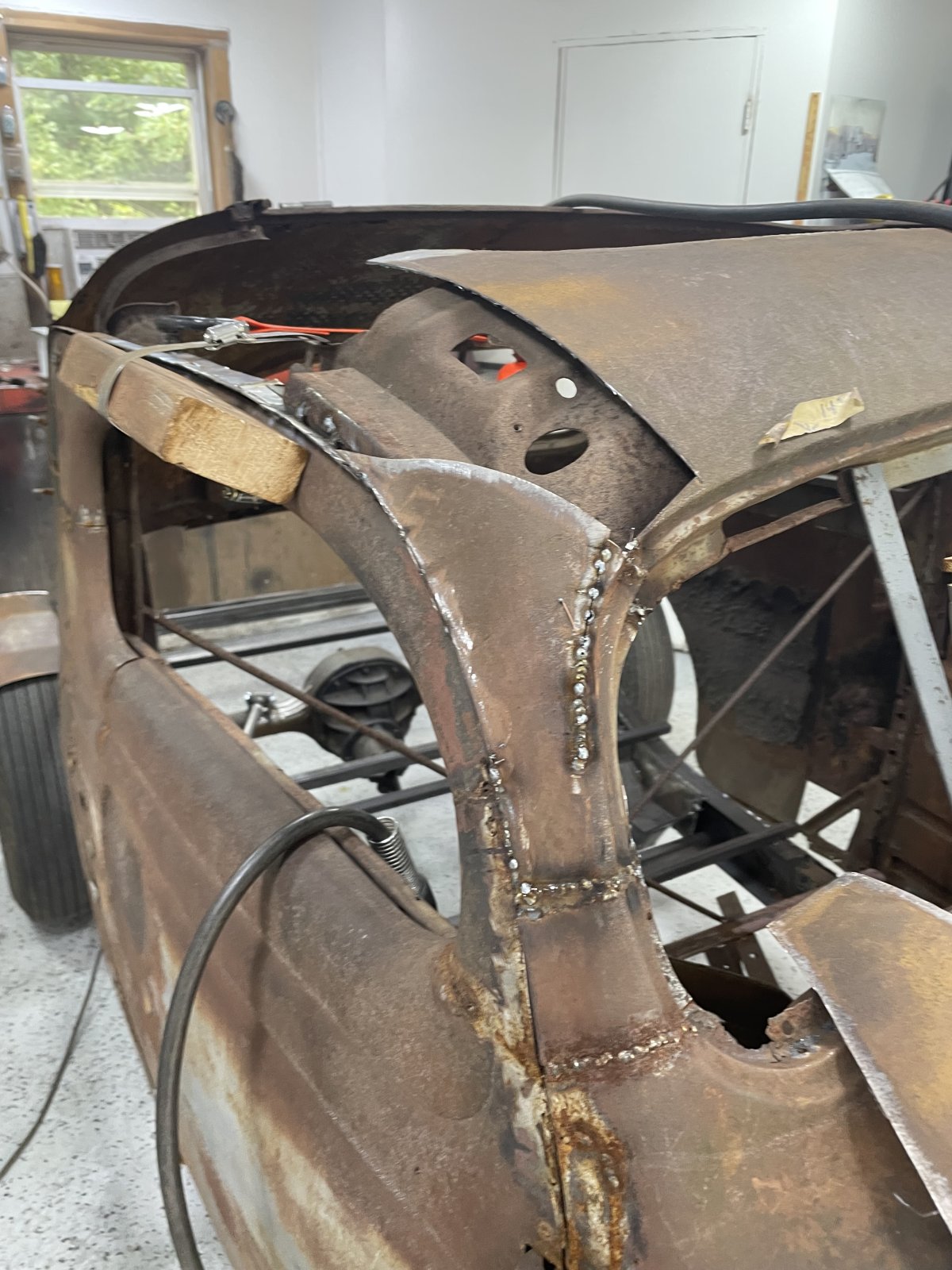

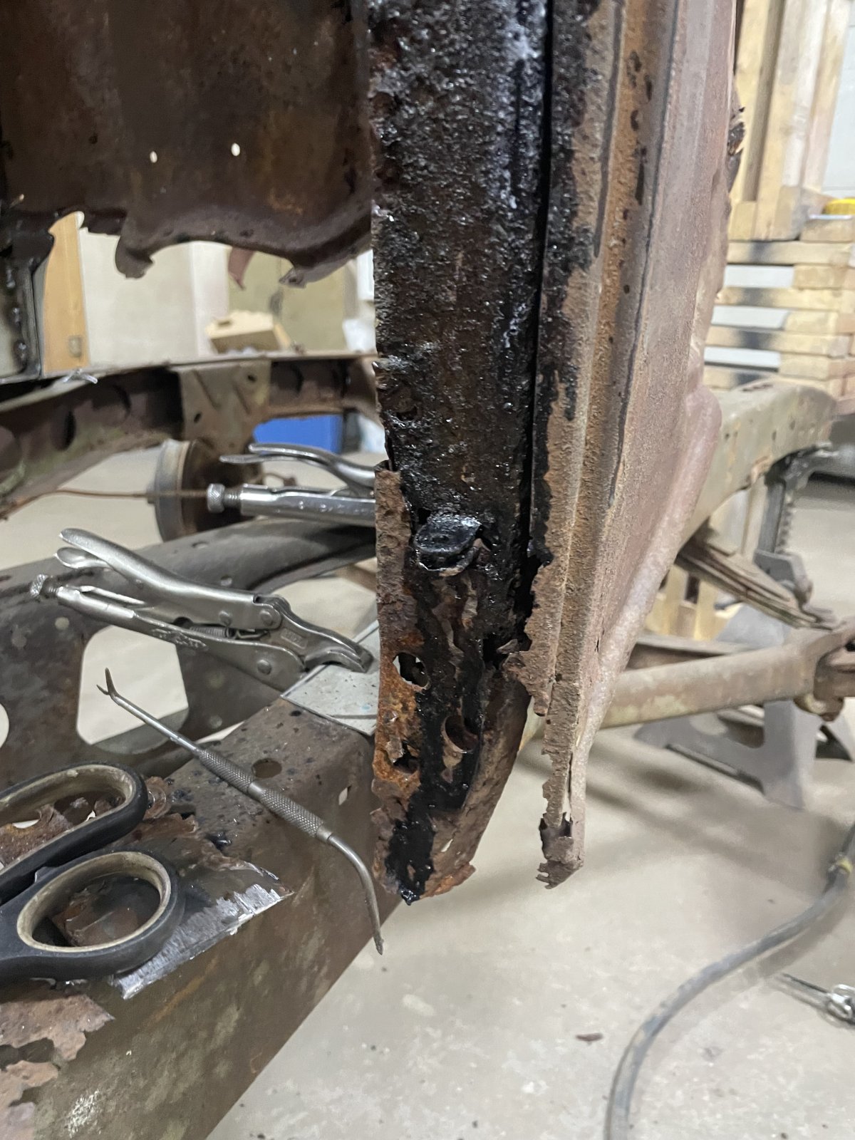

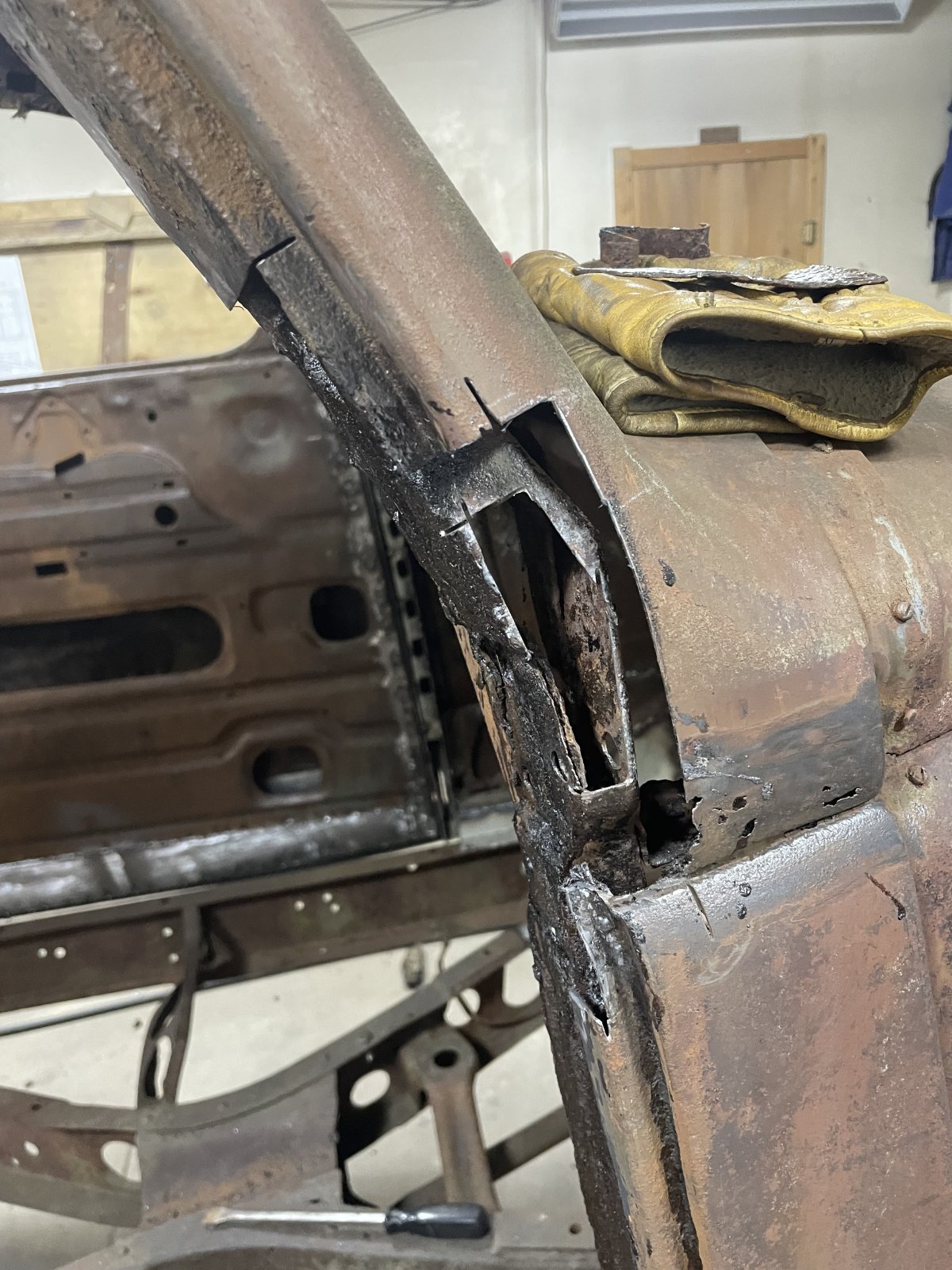

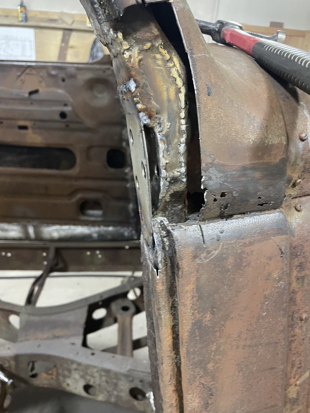

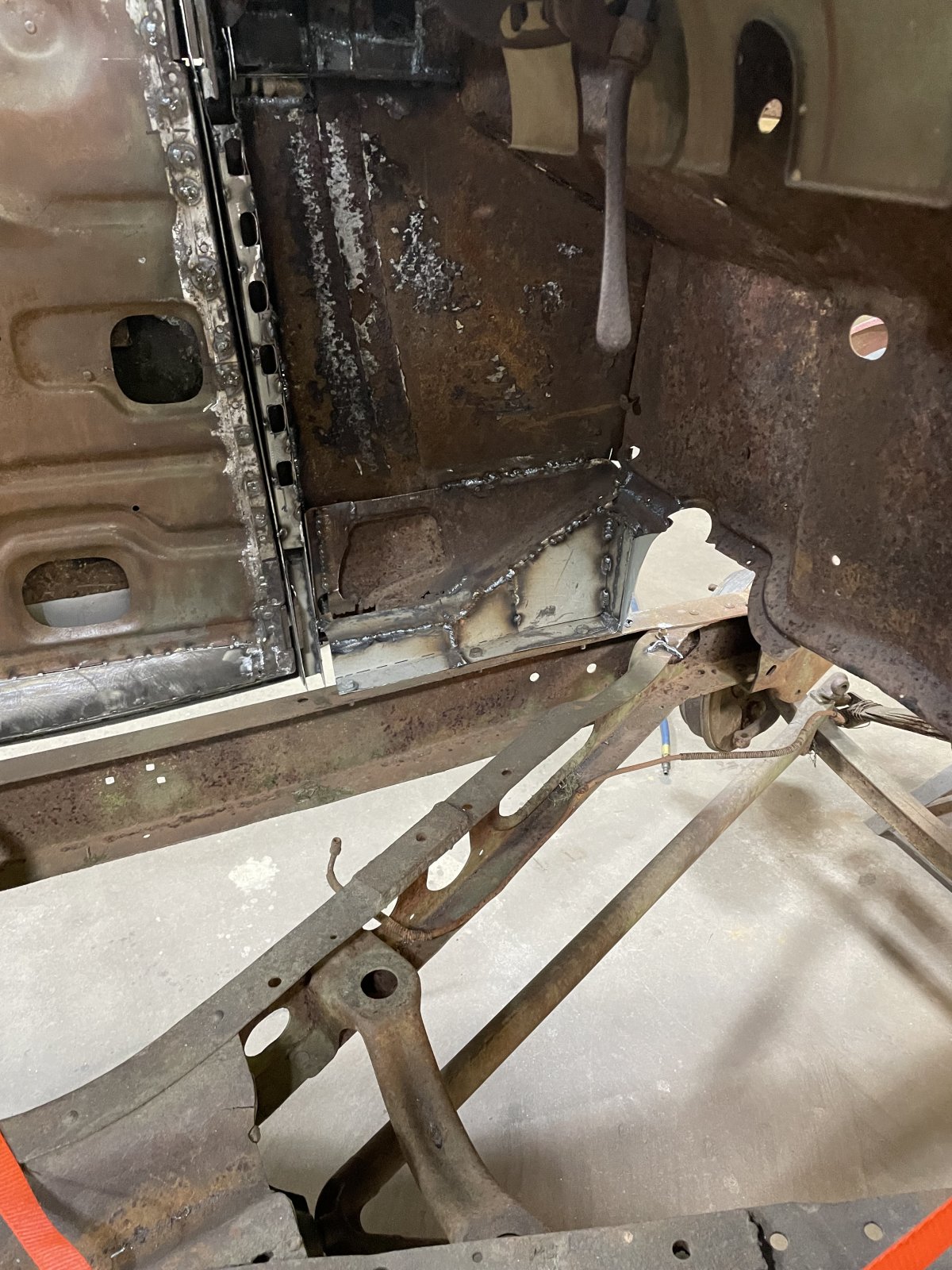

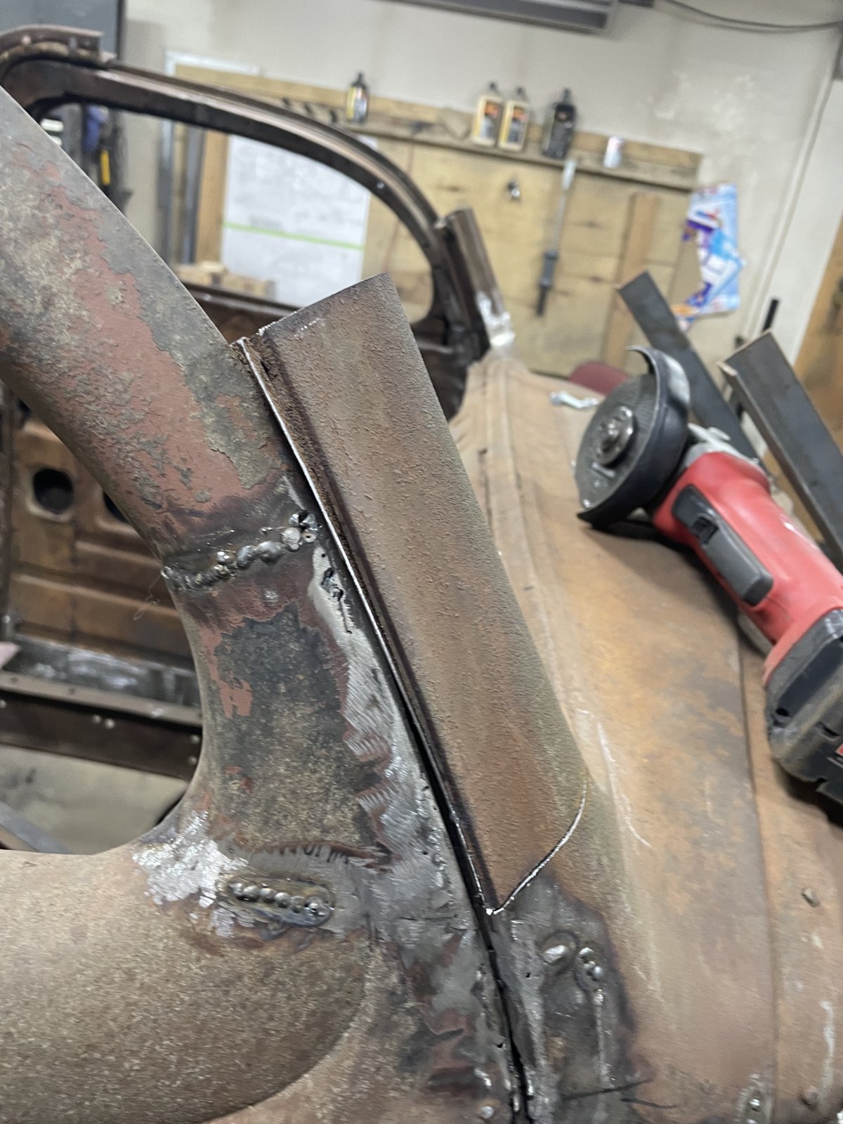

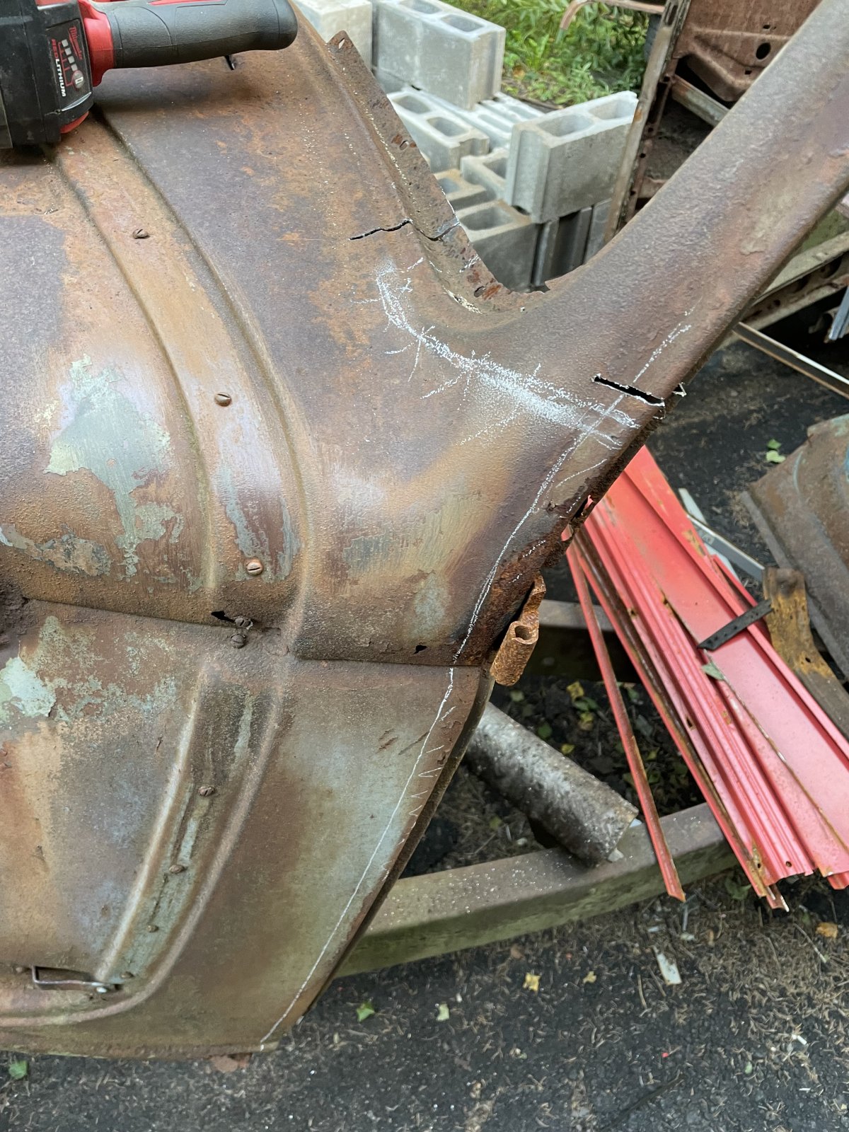

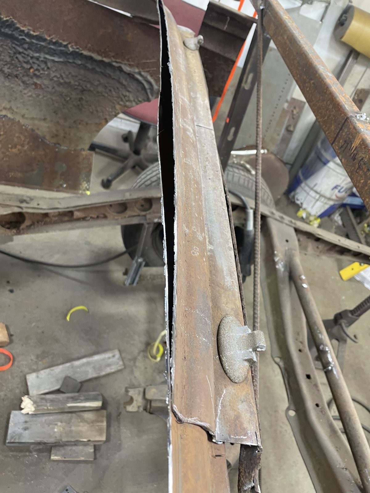

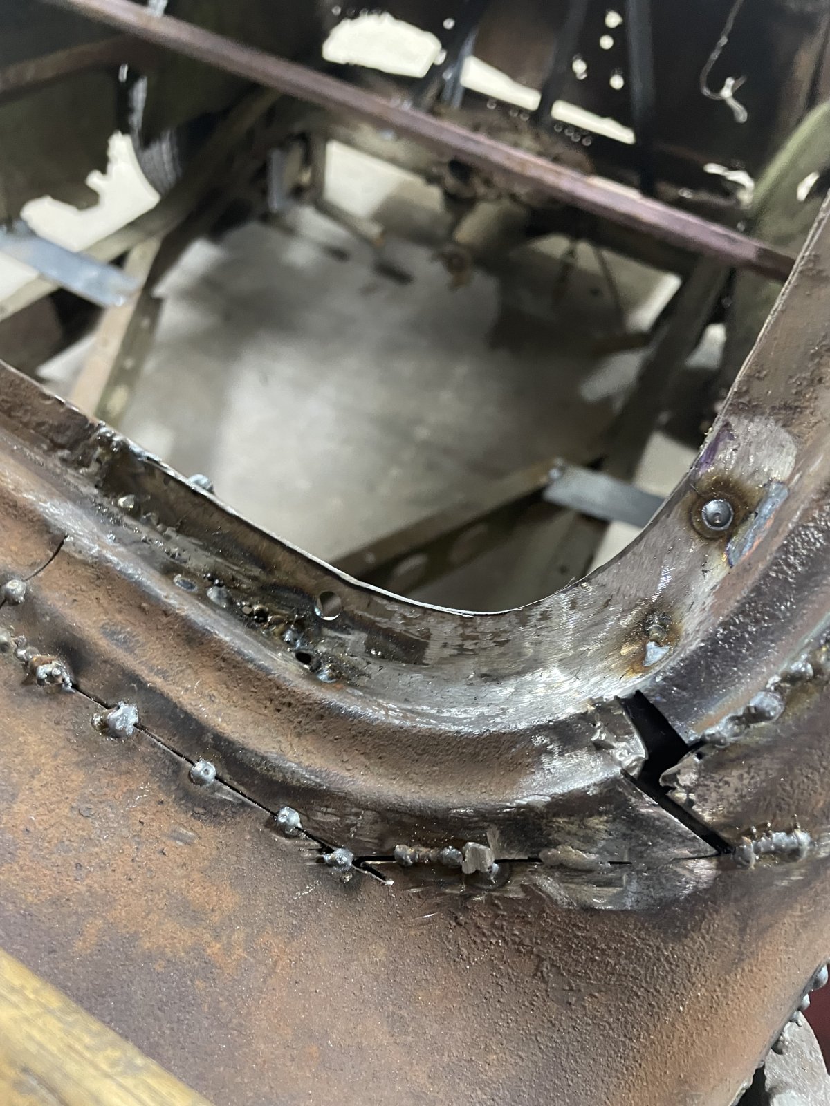

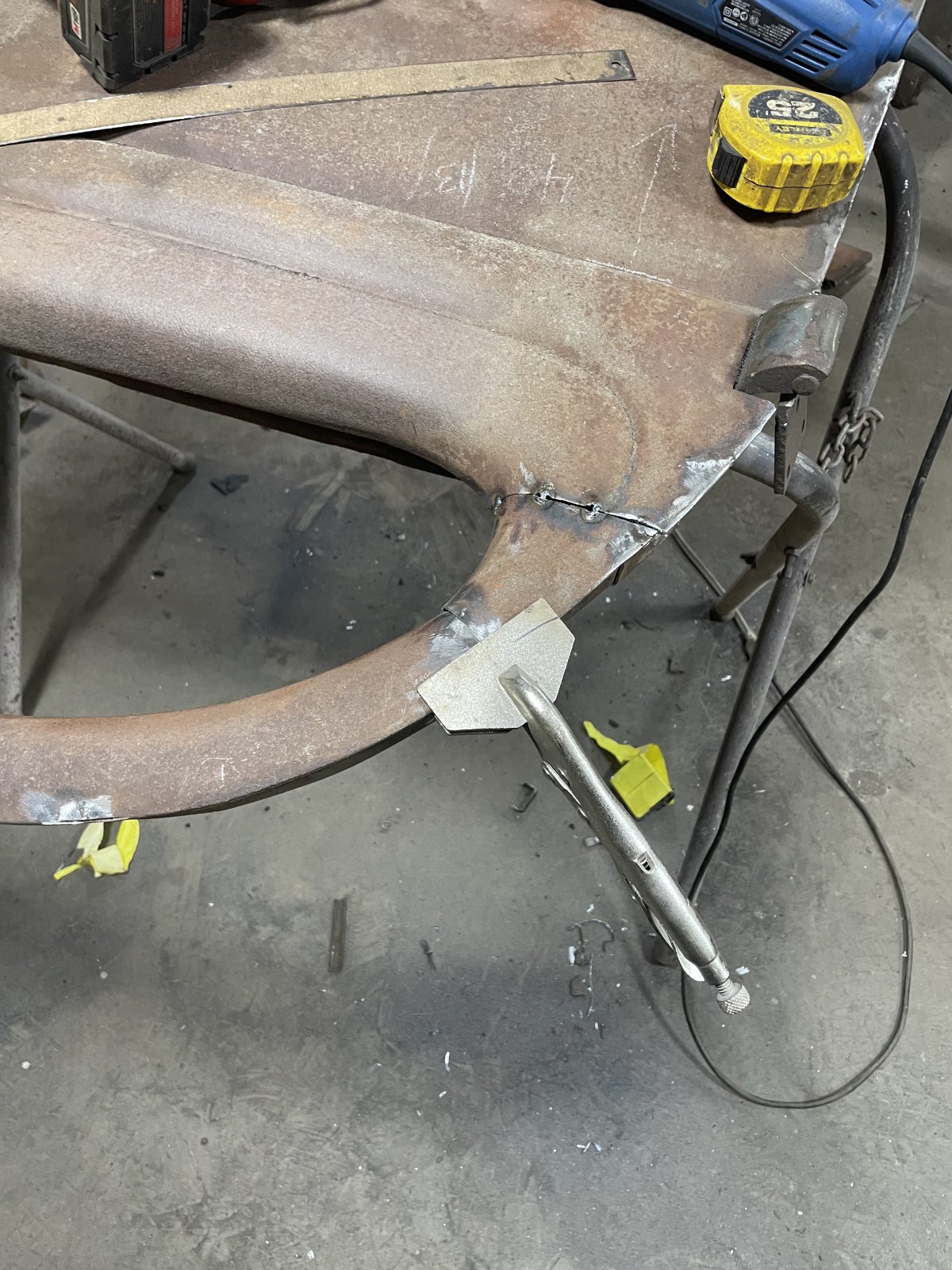

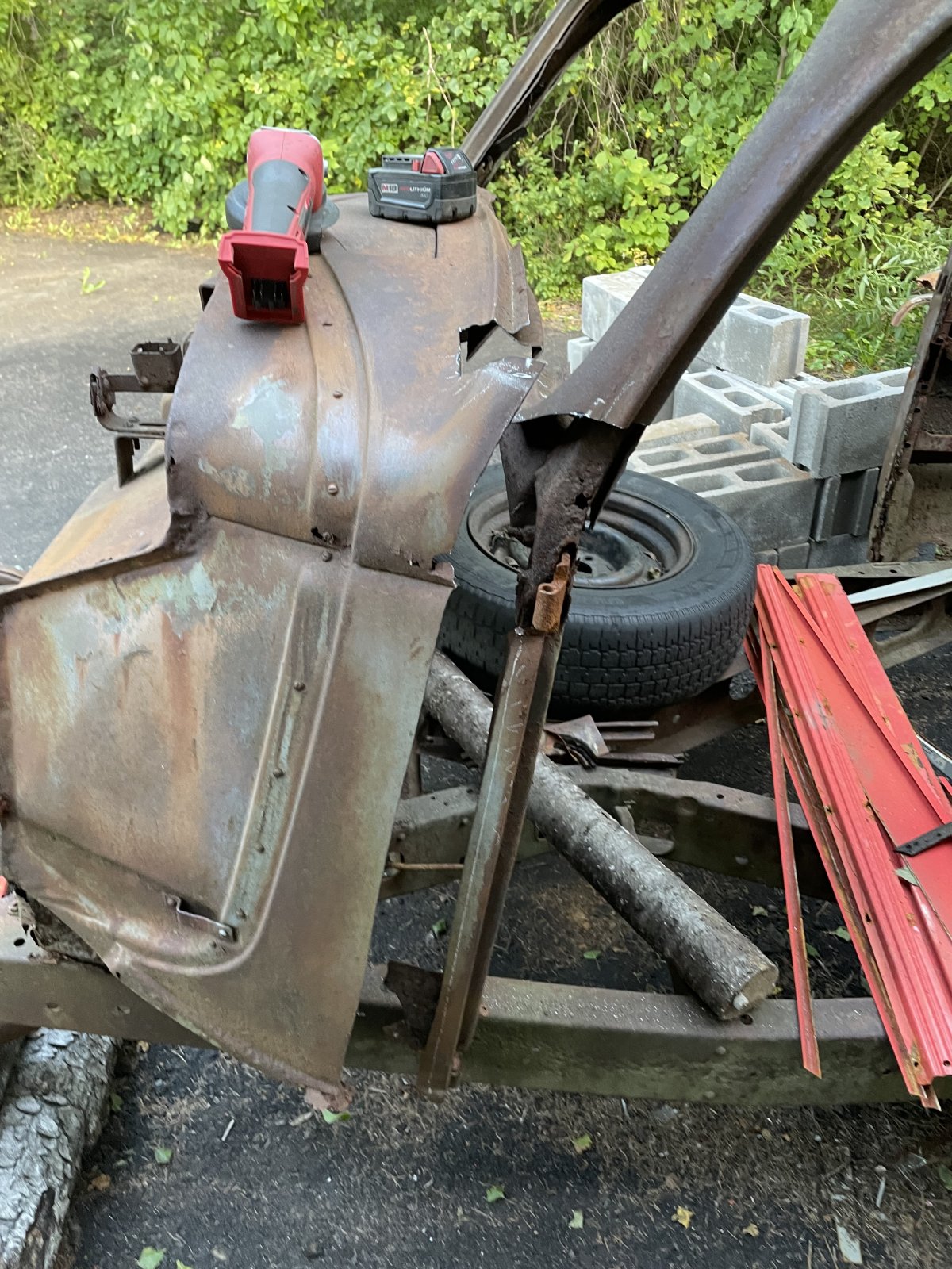

    So , the A pillar is somewhat pretty bad , we’ll , no it’s really bad LOL . Had to remove it from body along with outer skin . Lots of cutting , replacing, and fitment of new metal . Drill new hinge mount holes . This took off and on the last week approximately 30 hours . This stuff is not for the faint of heart for sure .

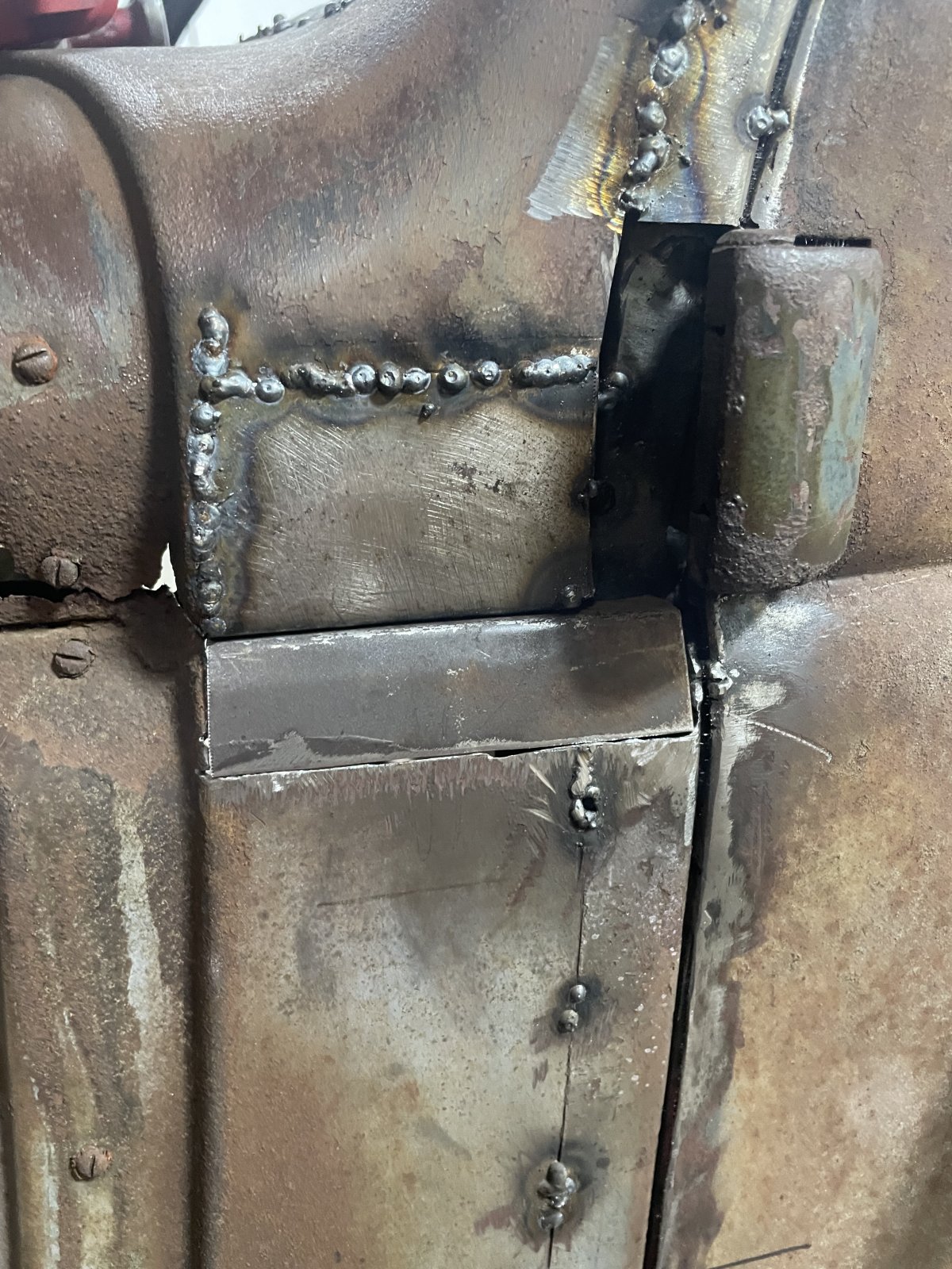

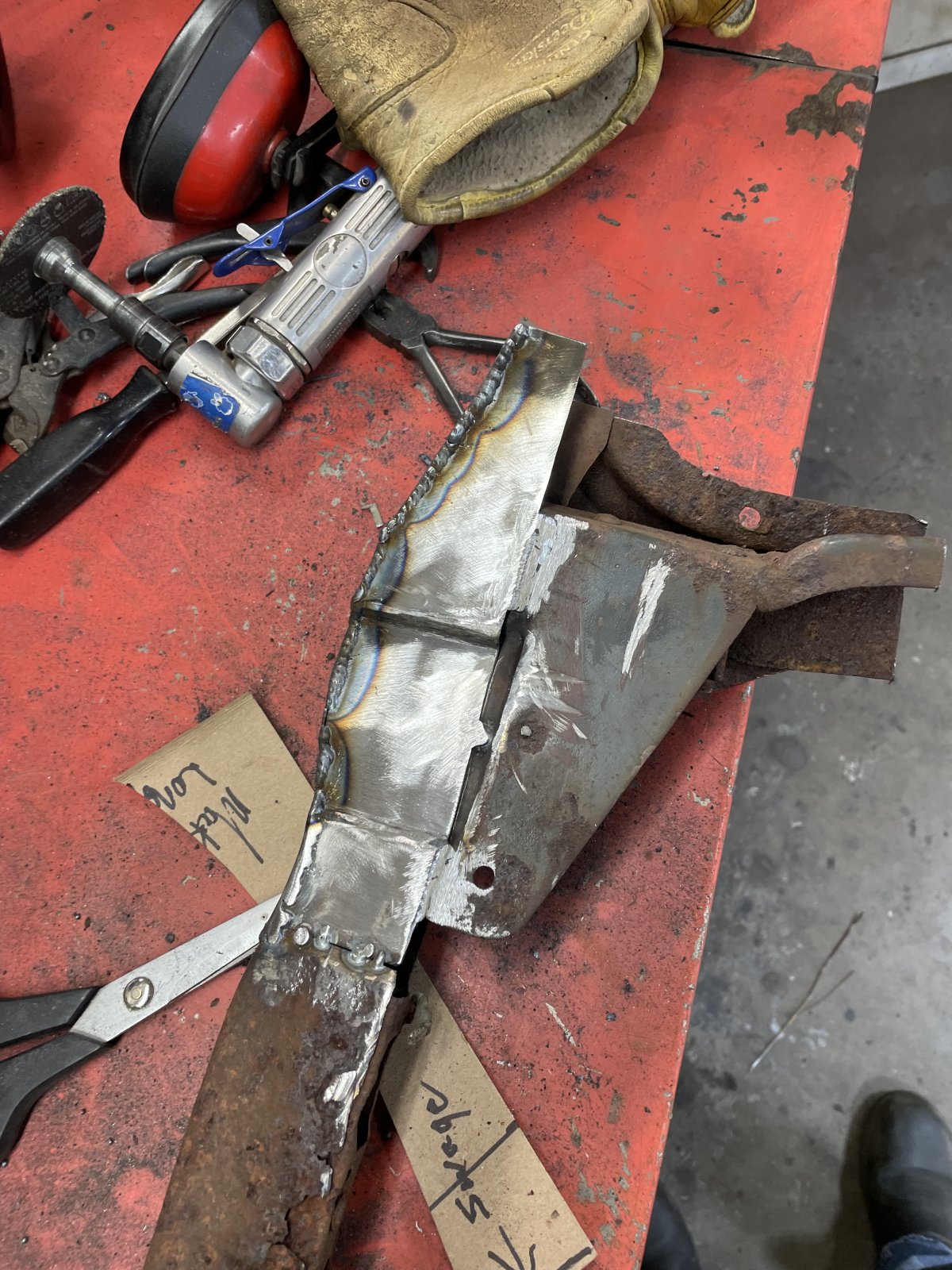

  5. aw1950
    Posts: 1,523

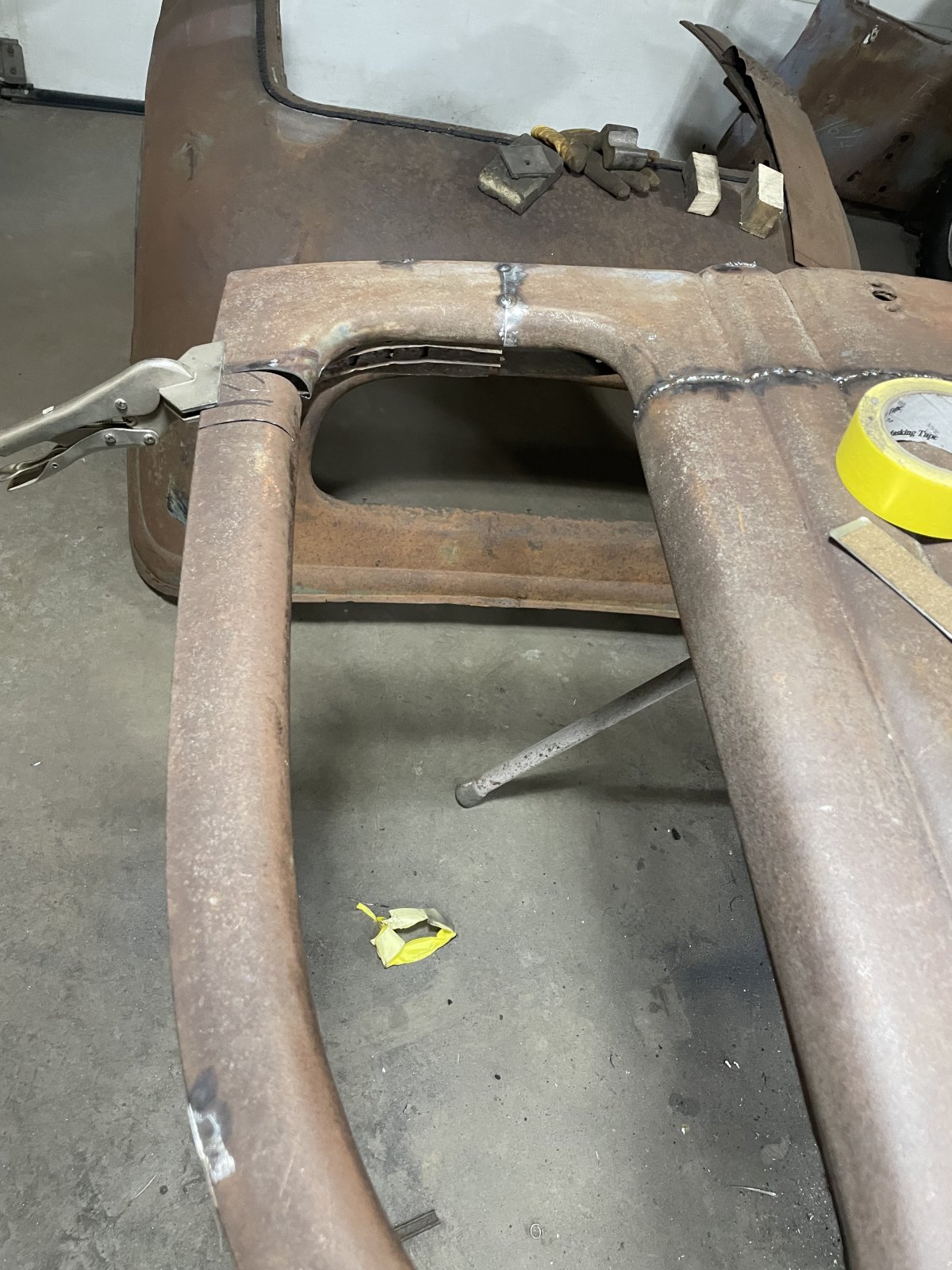

    aw1950

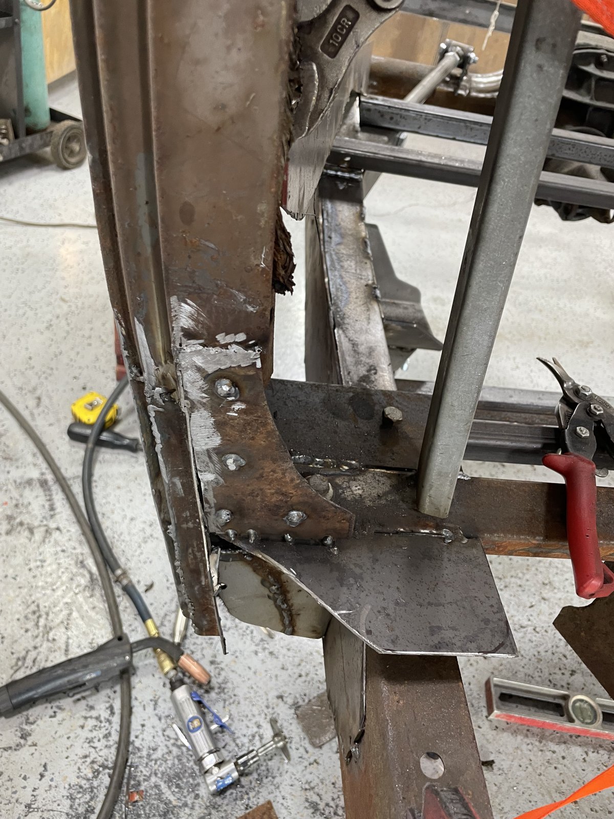

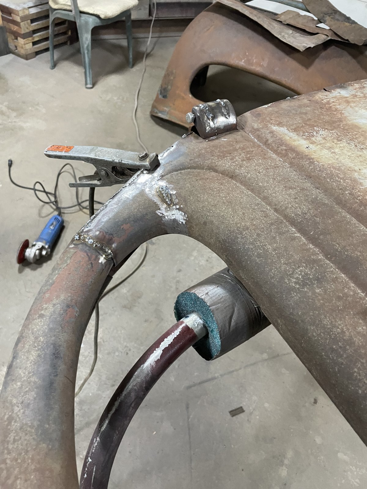

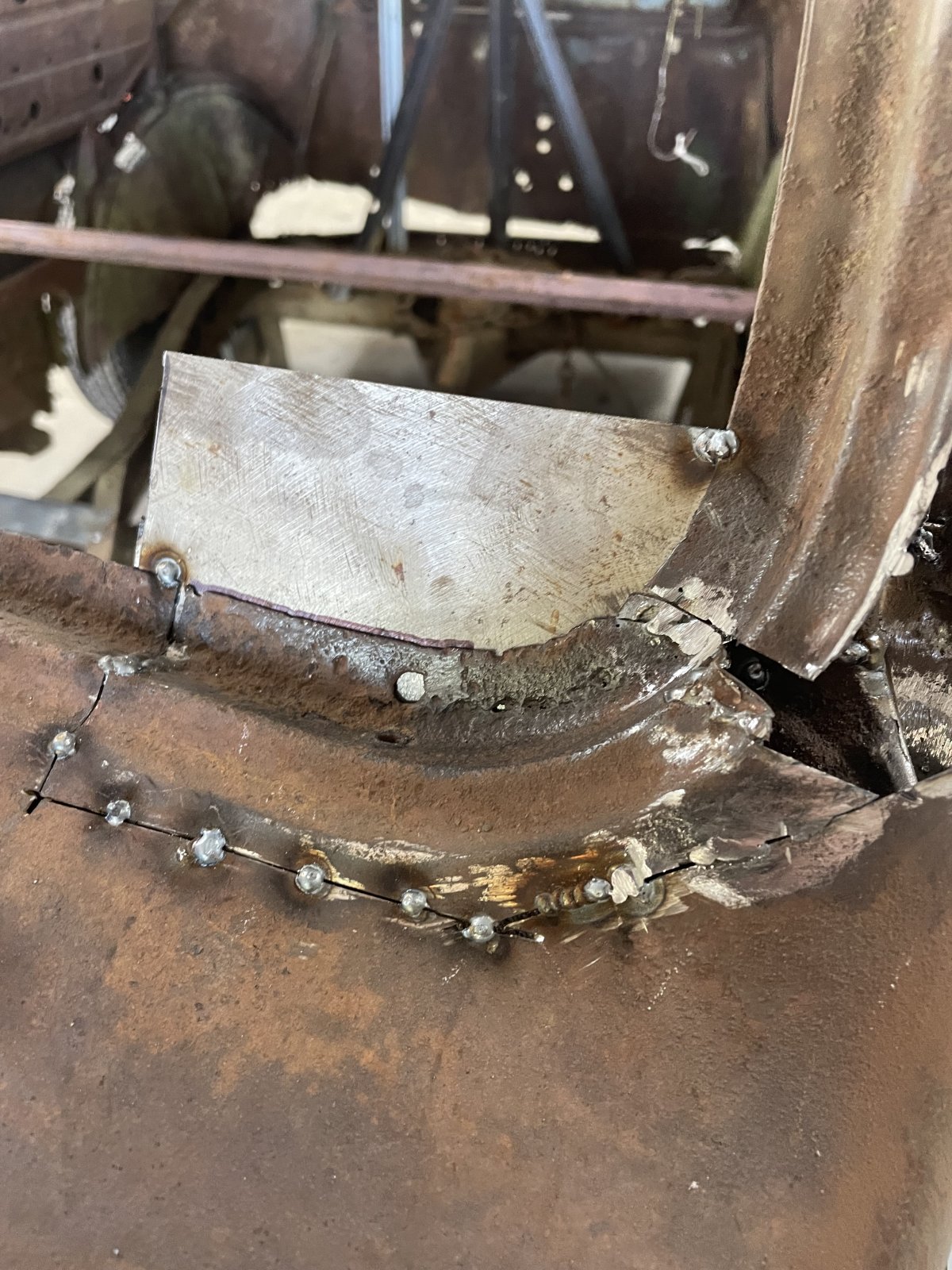

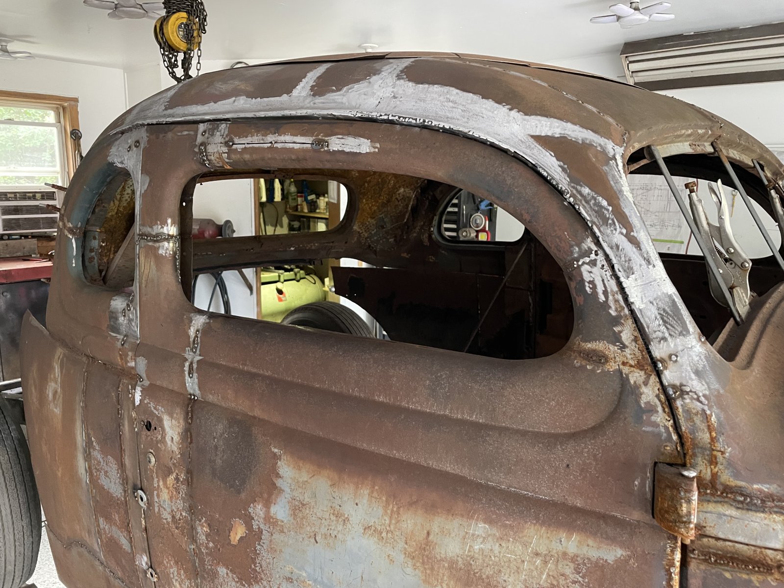

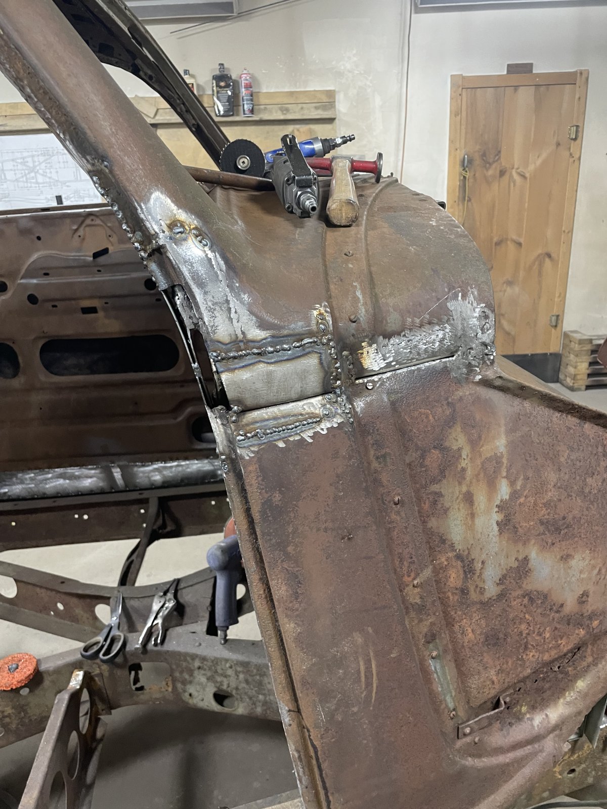

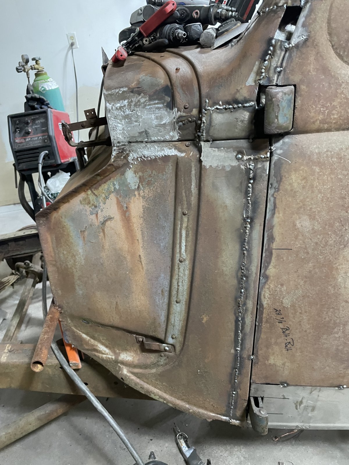

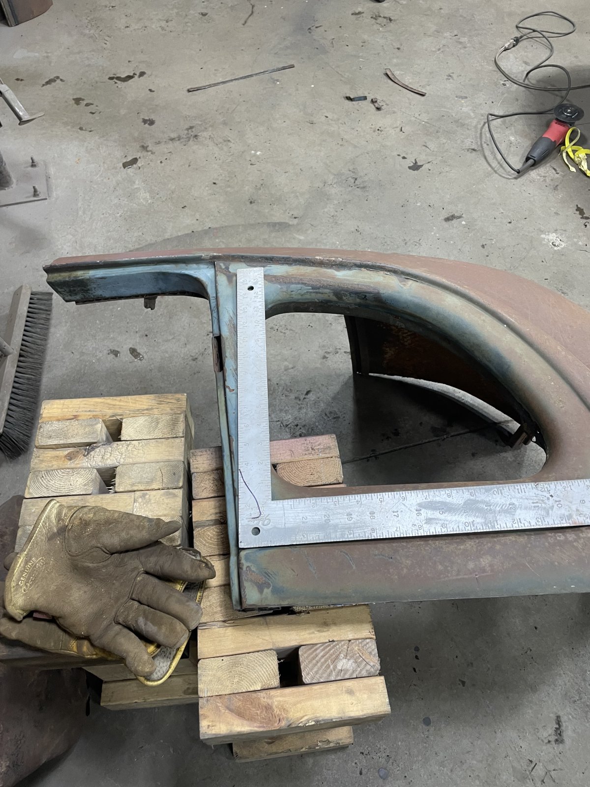

    So moving on I have got the A pillar spread figured out . ****oned back up , and fixing more rust at same time . Run out of welding wire so couldn’t get much else done . Made some more patches tonight so they’ll be ready when I get the wire .

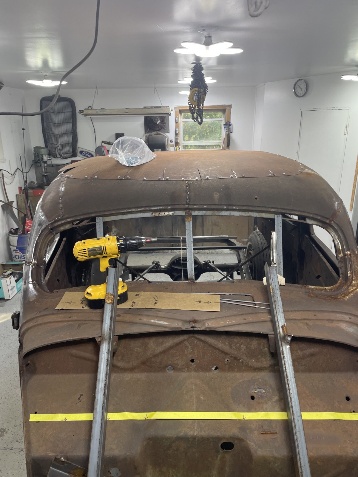

    So Since my last post well over a year ago, there’s been a lot happening with this car. Here are some pictures picking up from where the thread stopped.

    aw1950

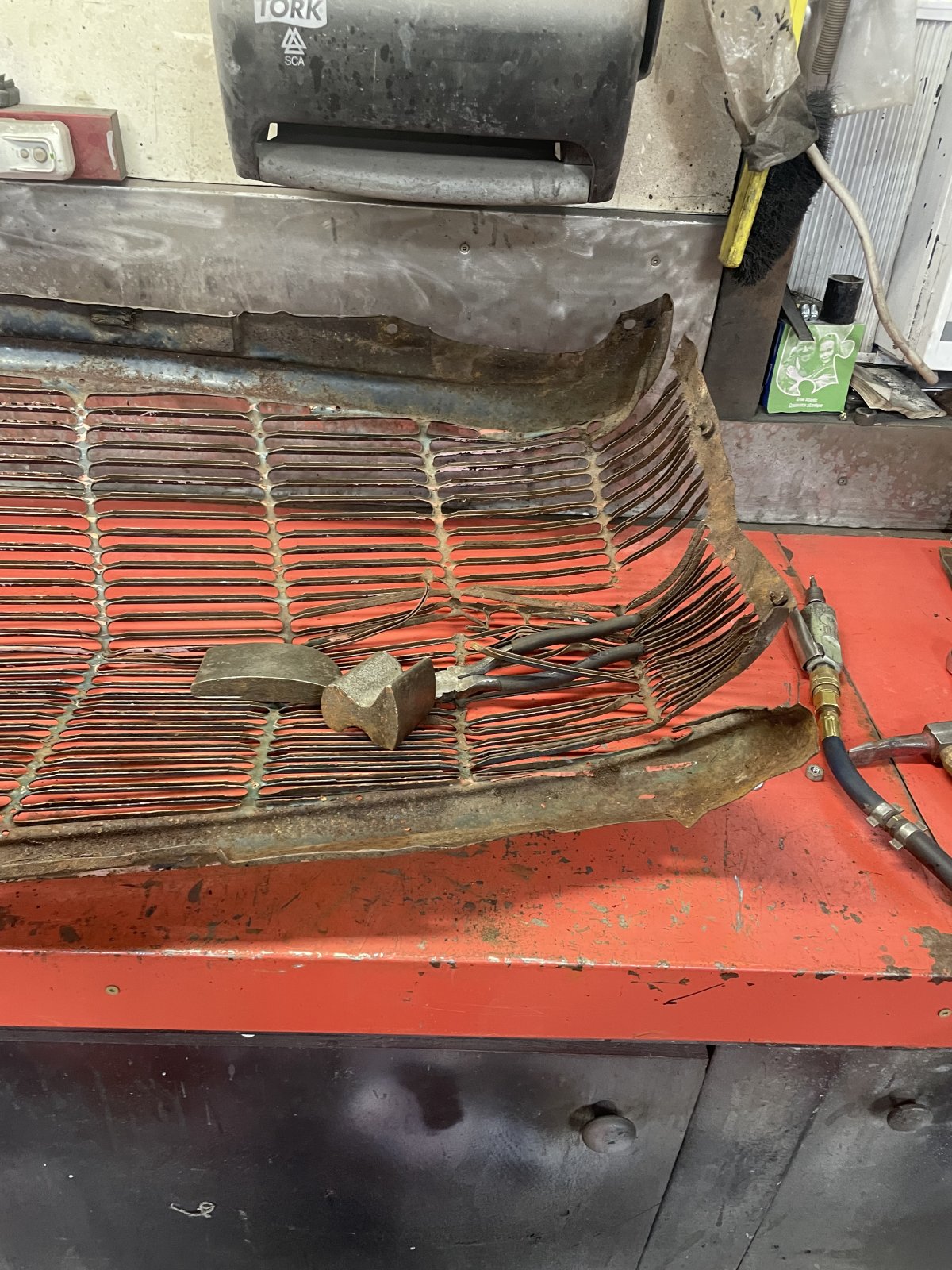

    A little mock up for visualization, grille is in need of some repair but not to bad

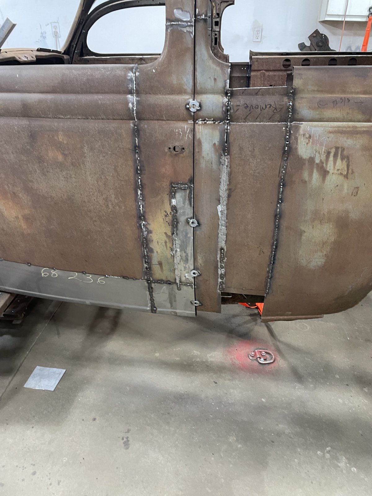

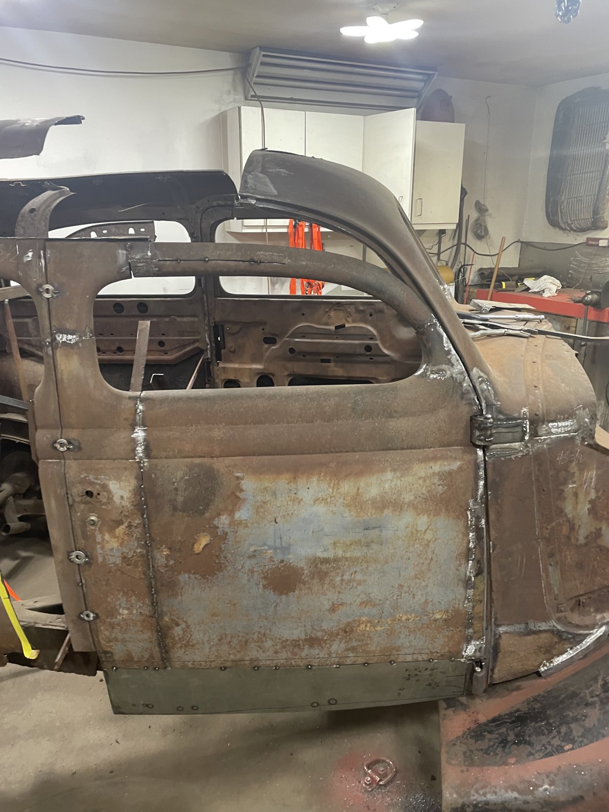

  8. aw1950
    Posts: 1,523
    aw1950

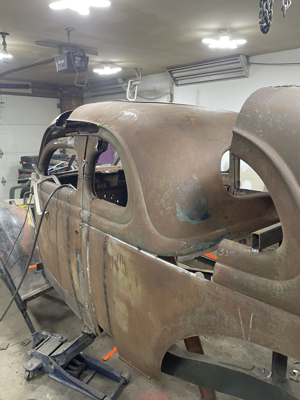

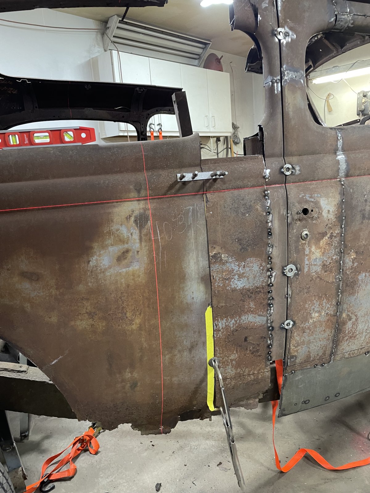

    Cutting with drastic changes evident . Quite a difference in the door dimensions

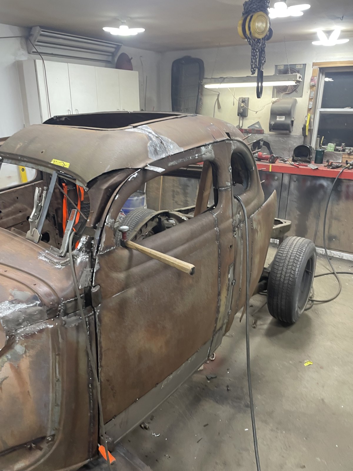

  11. aw1950
    Posts: 1,523
    aw1950

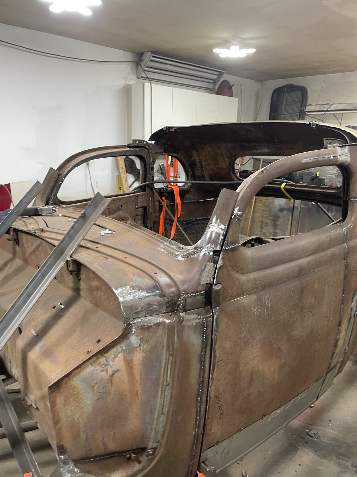

    Starting to look like something now . You see it coming together?

  13. aw1950
    Posts: 1,523
    aw1950

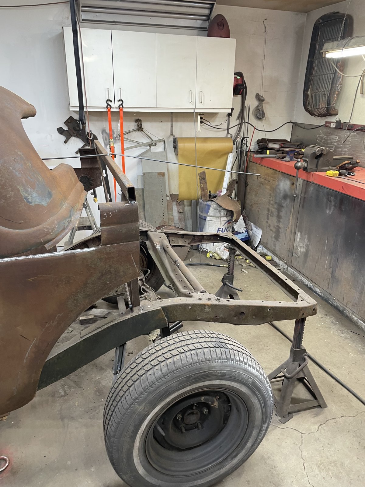

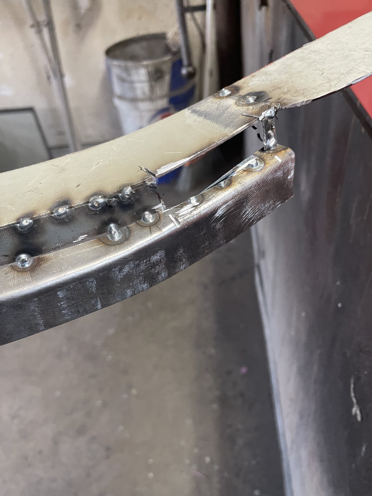

  15. aw1950
    Posts: 1,523

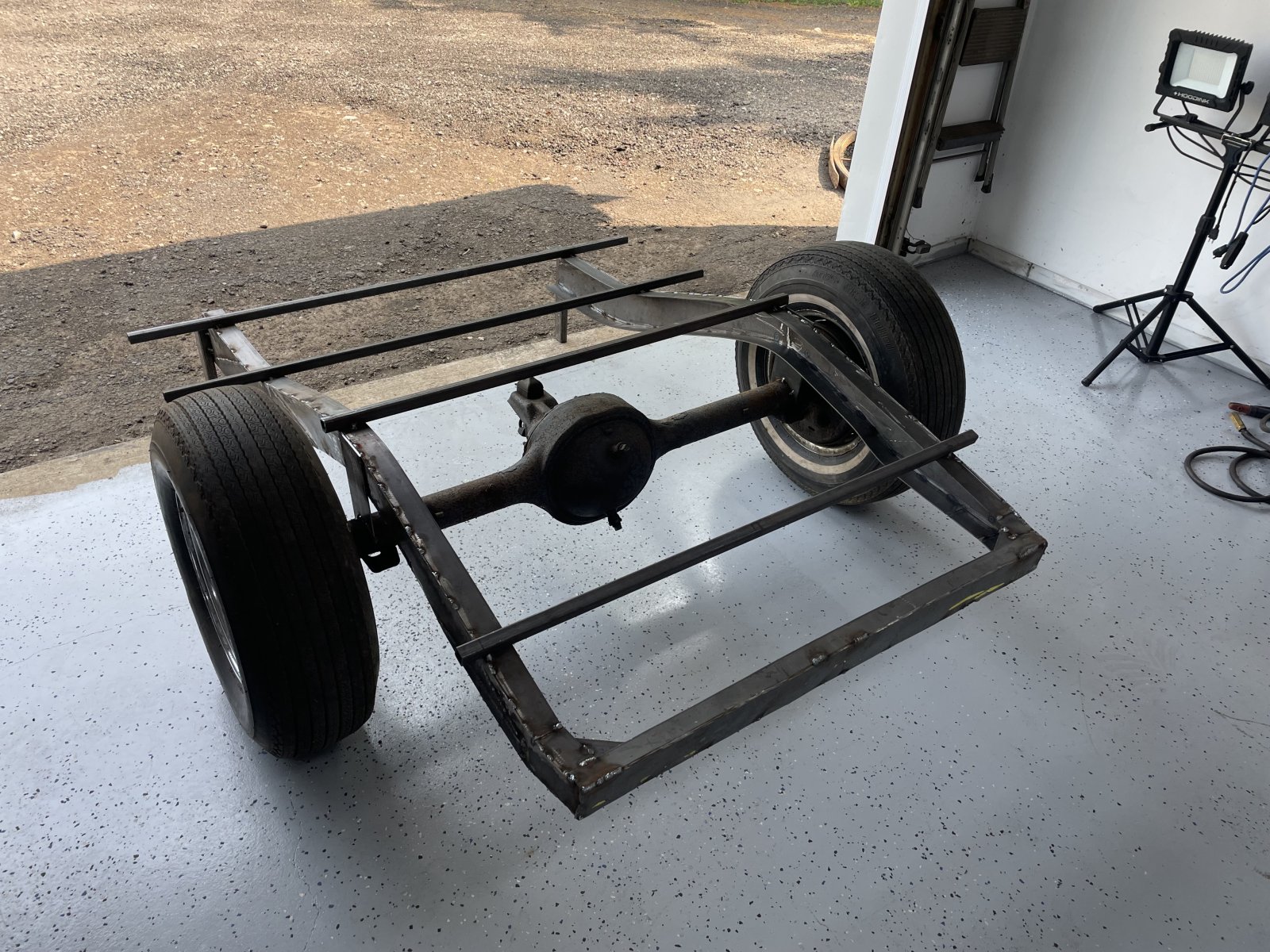

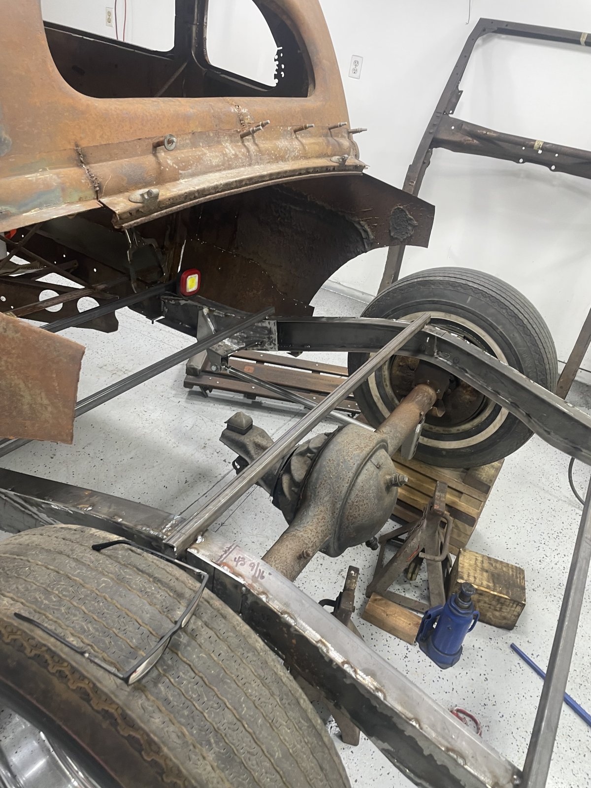

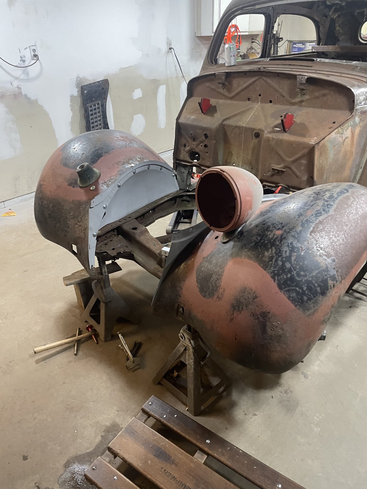

    aw1950

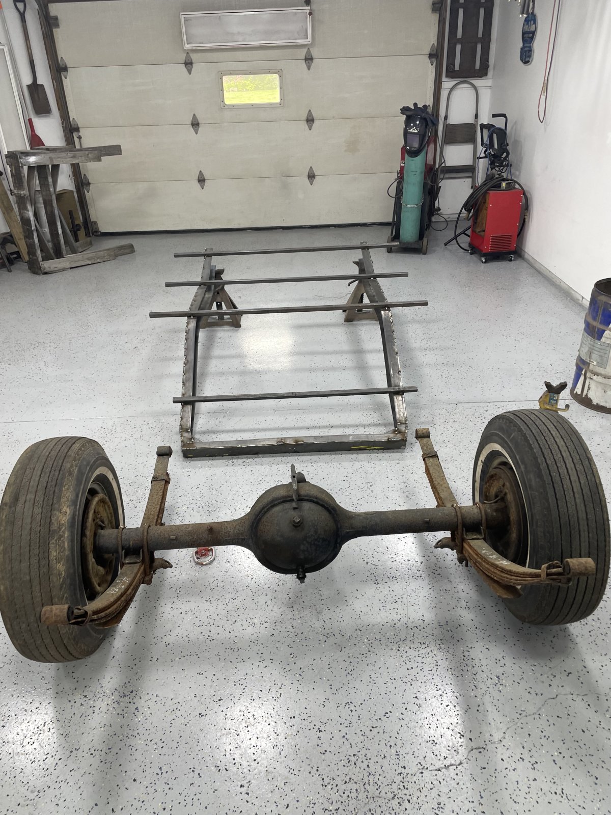

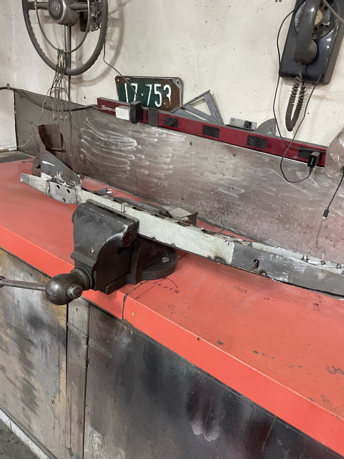

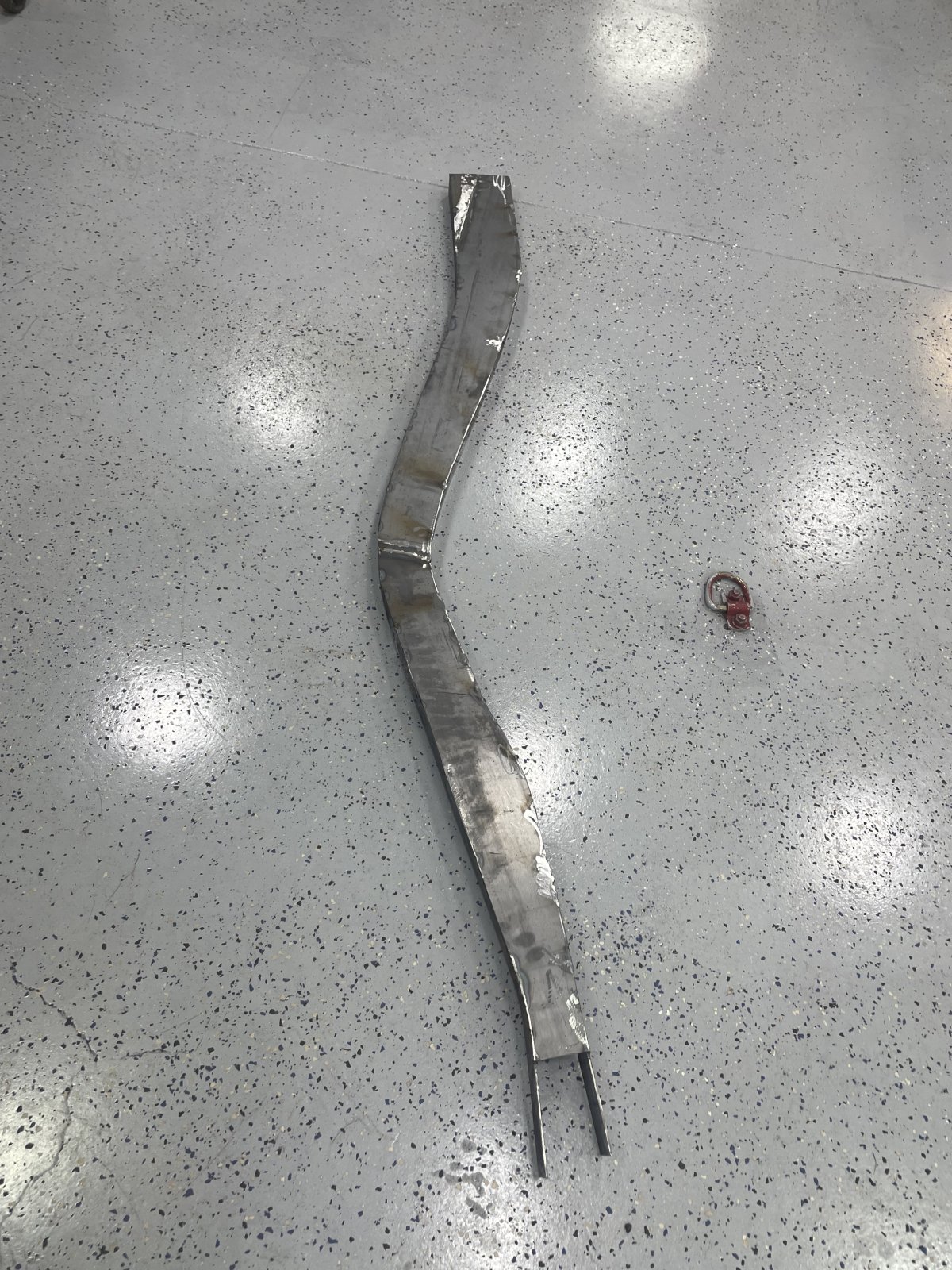

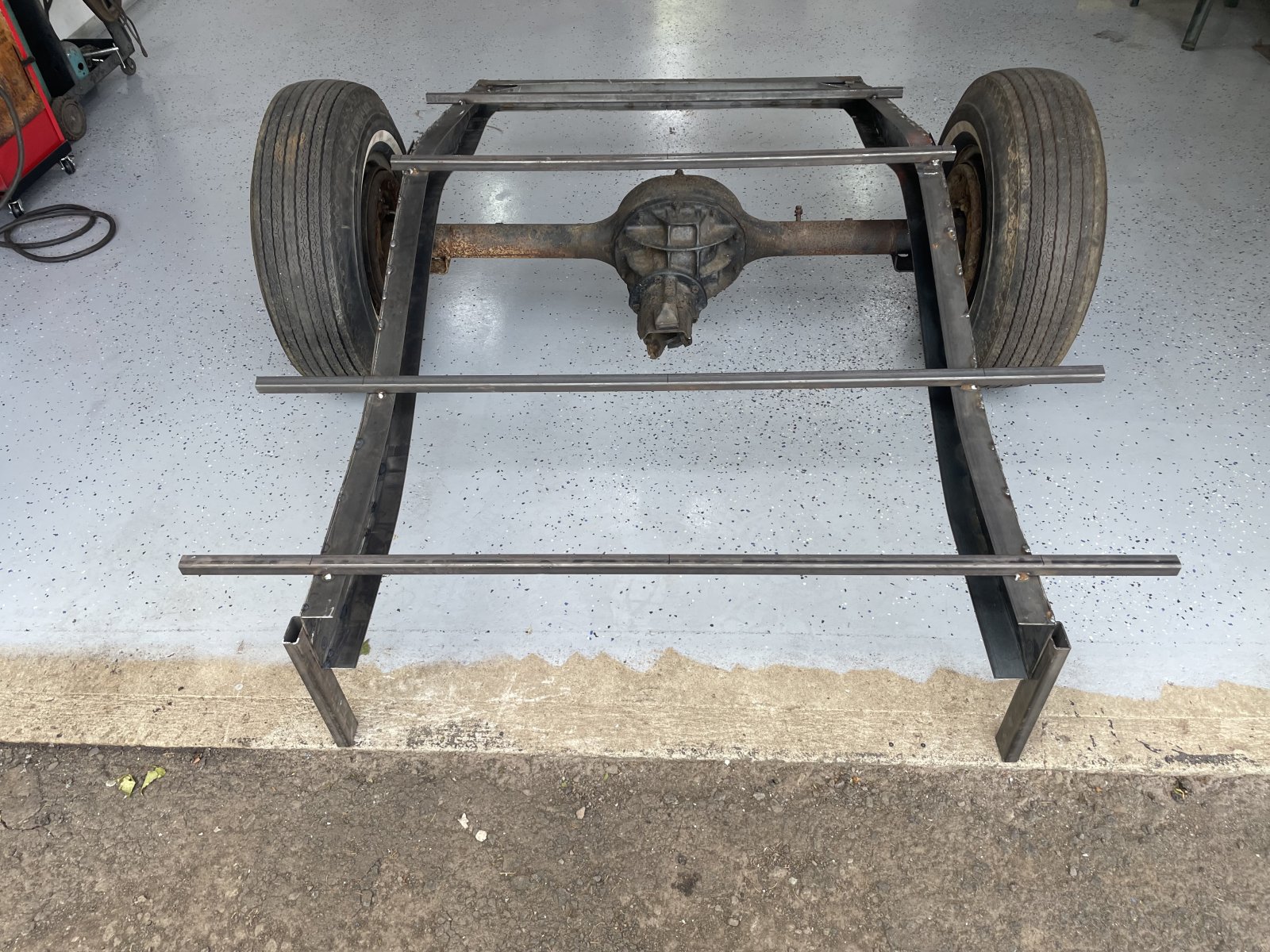

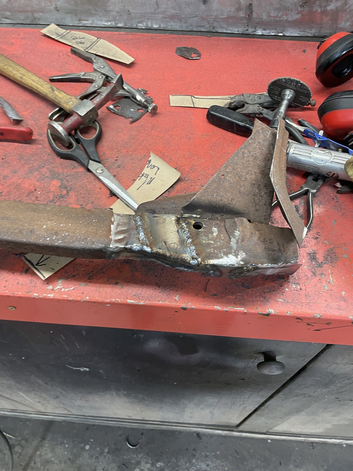

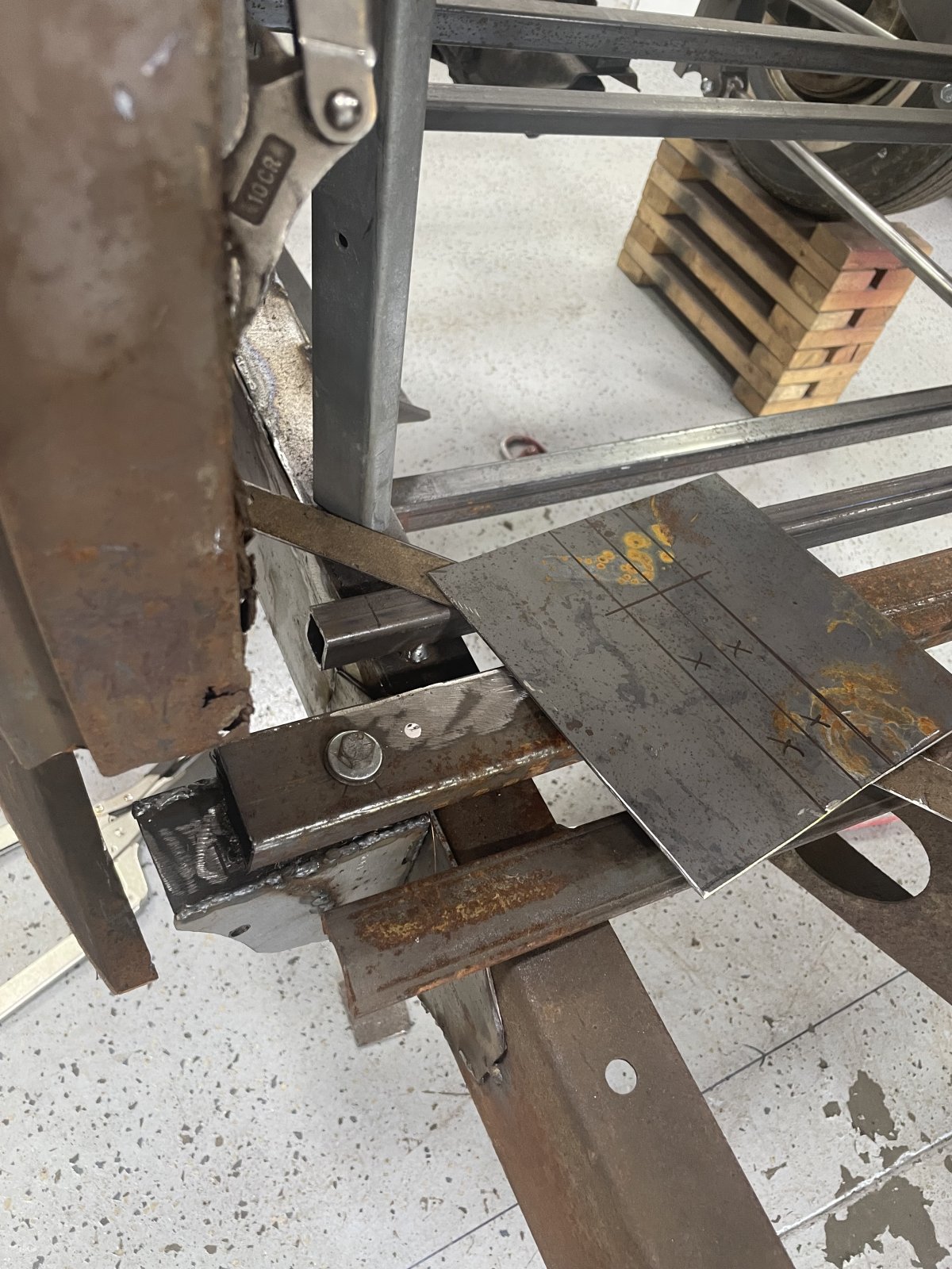

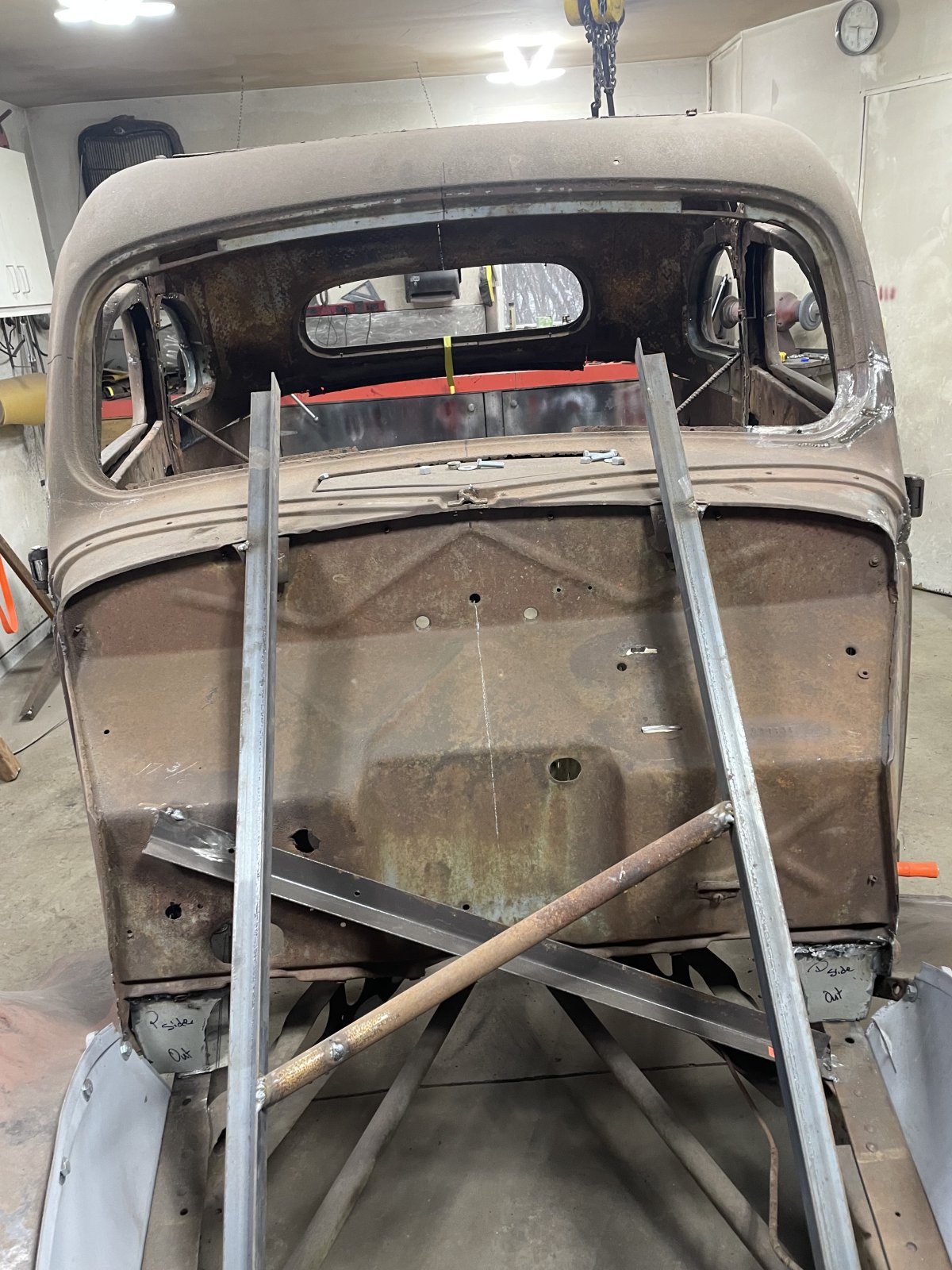

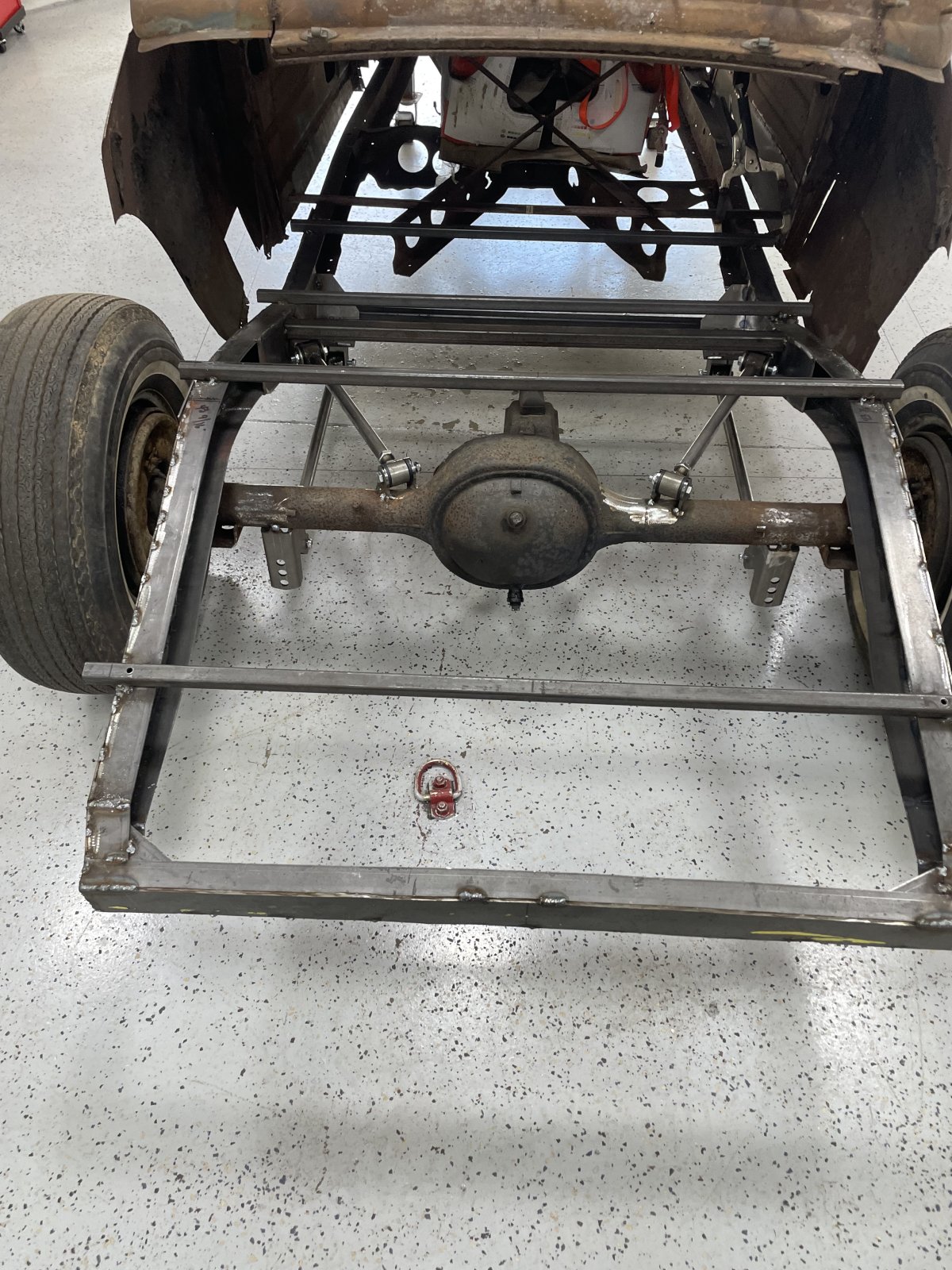

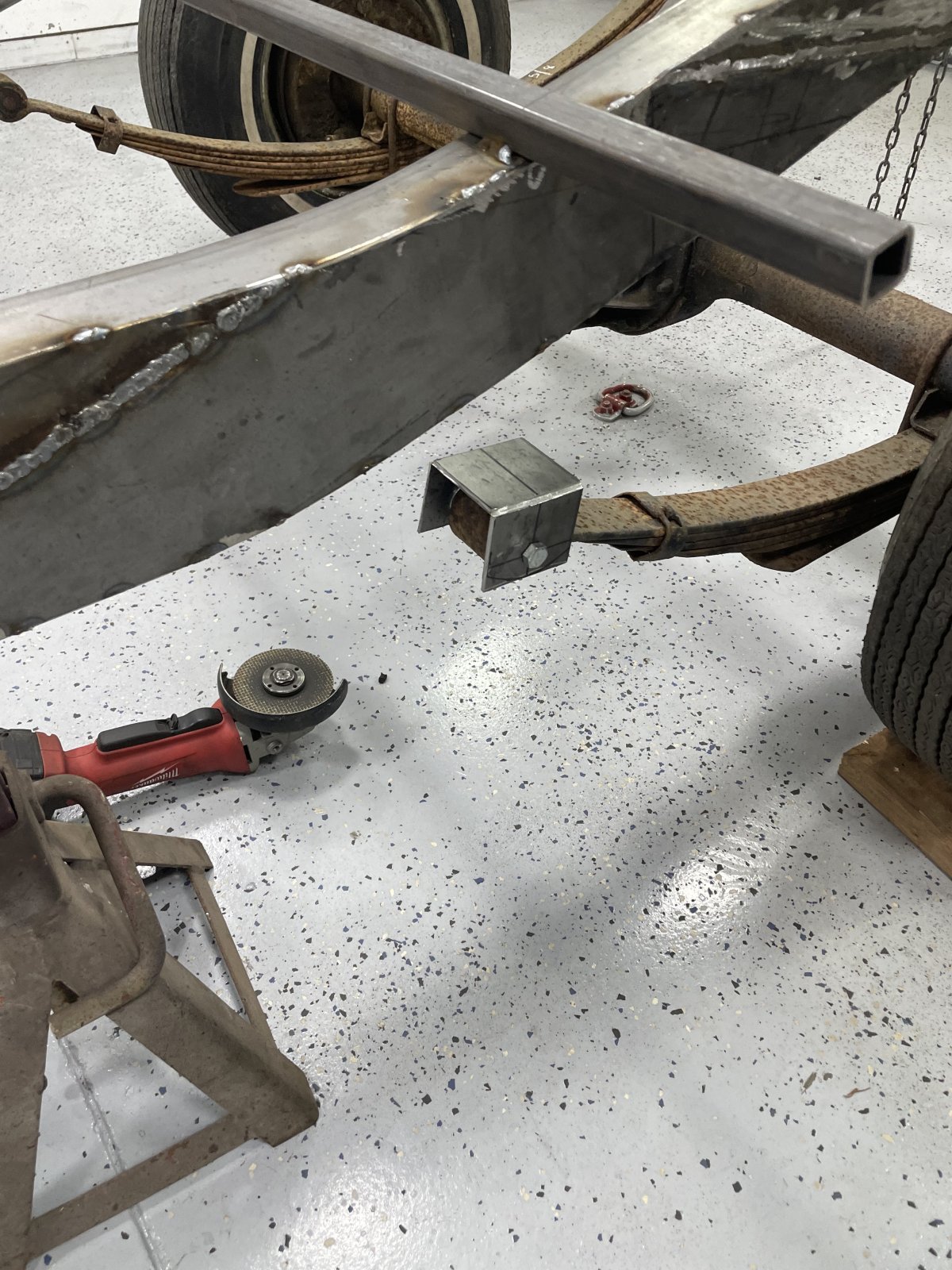

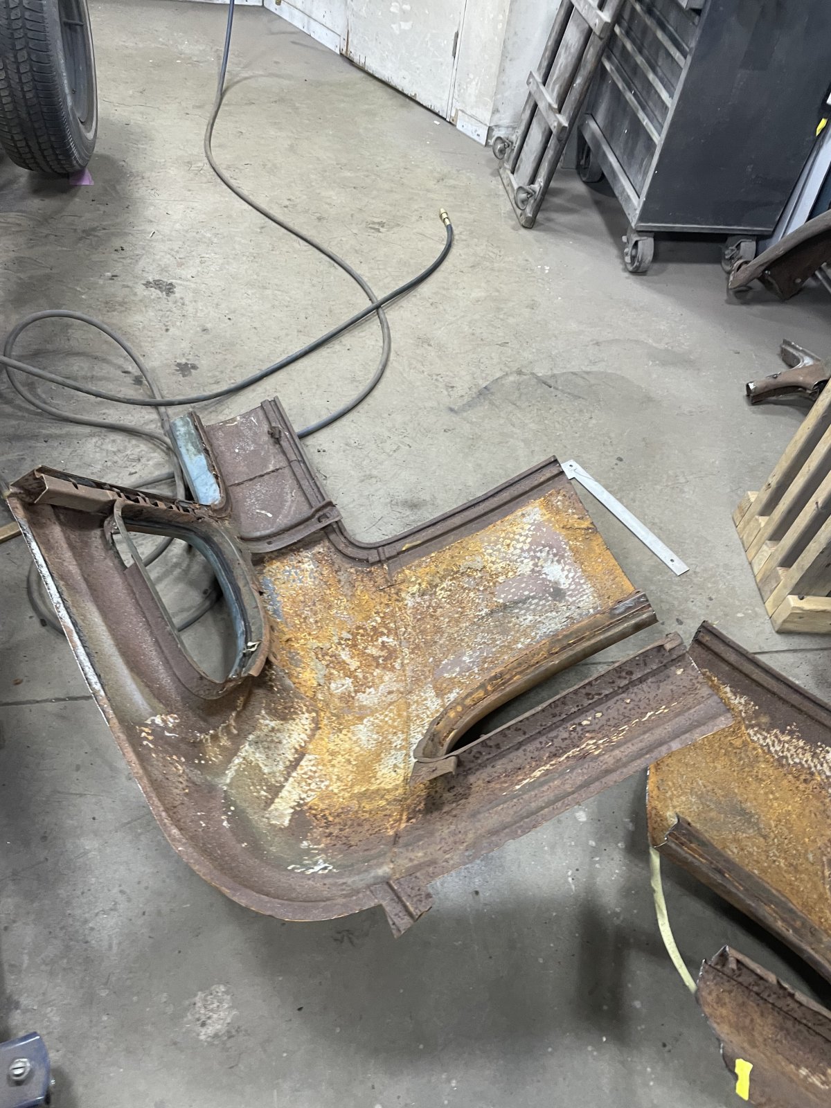

    Starting to build the rear frame section as the original was Swiss cheese . Front is still very solid
    Squablow, tb33anda3rd and BigRRR like this.

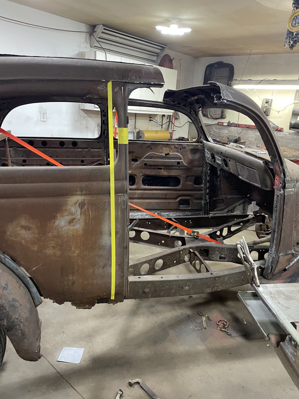

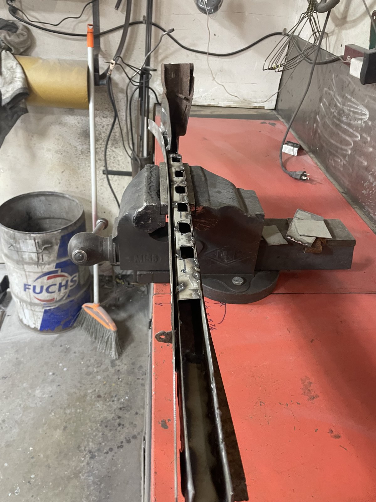

  16. aw1950
    Posts: 1,523

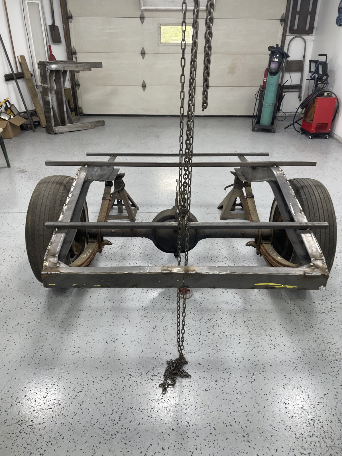

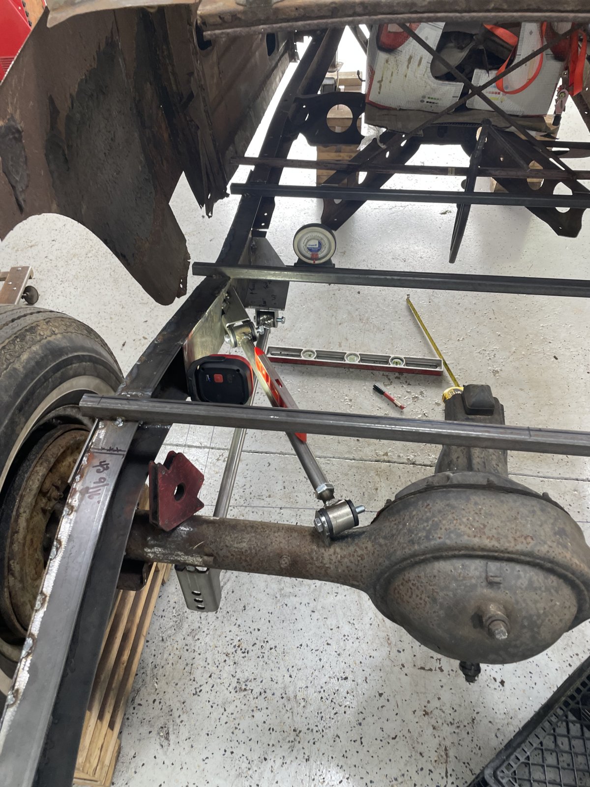

    aw1950

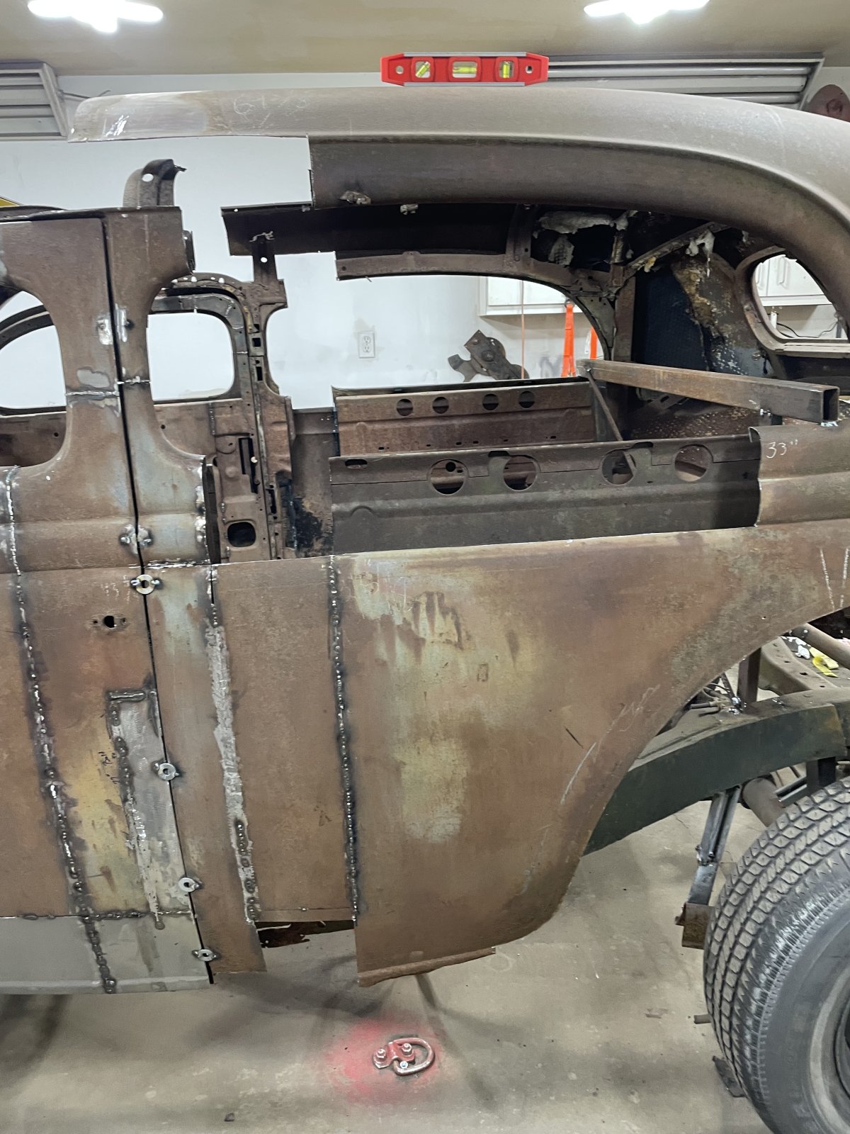

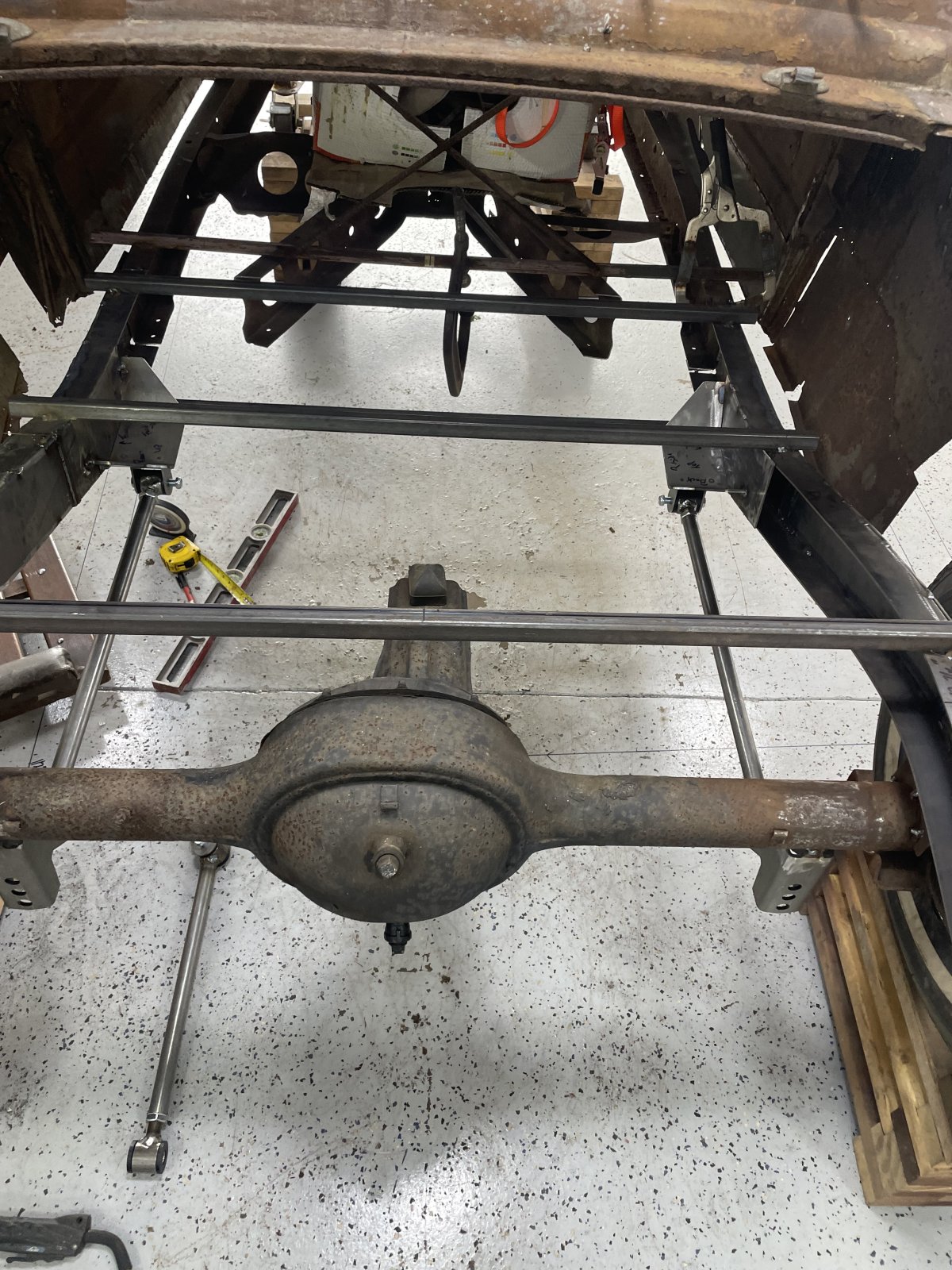

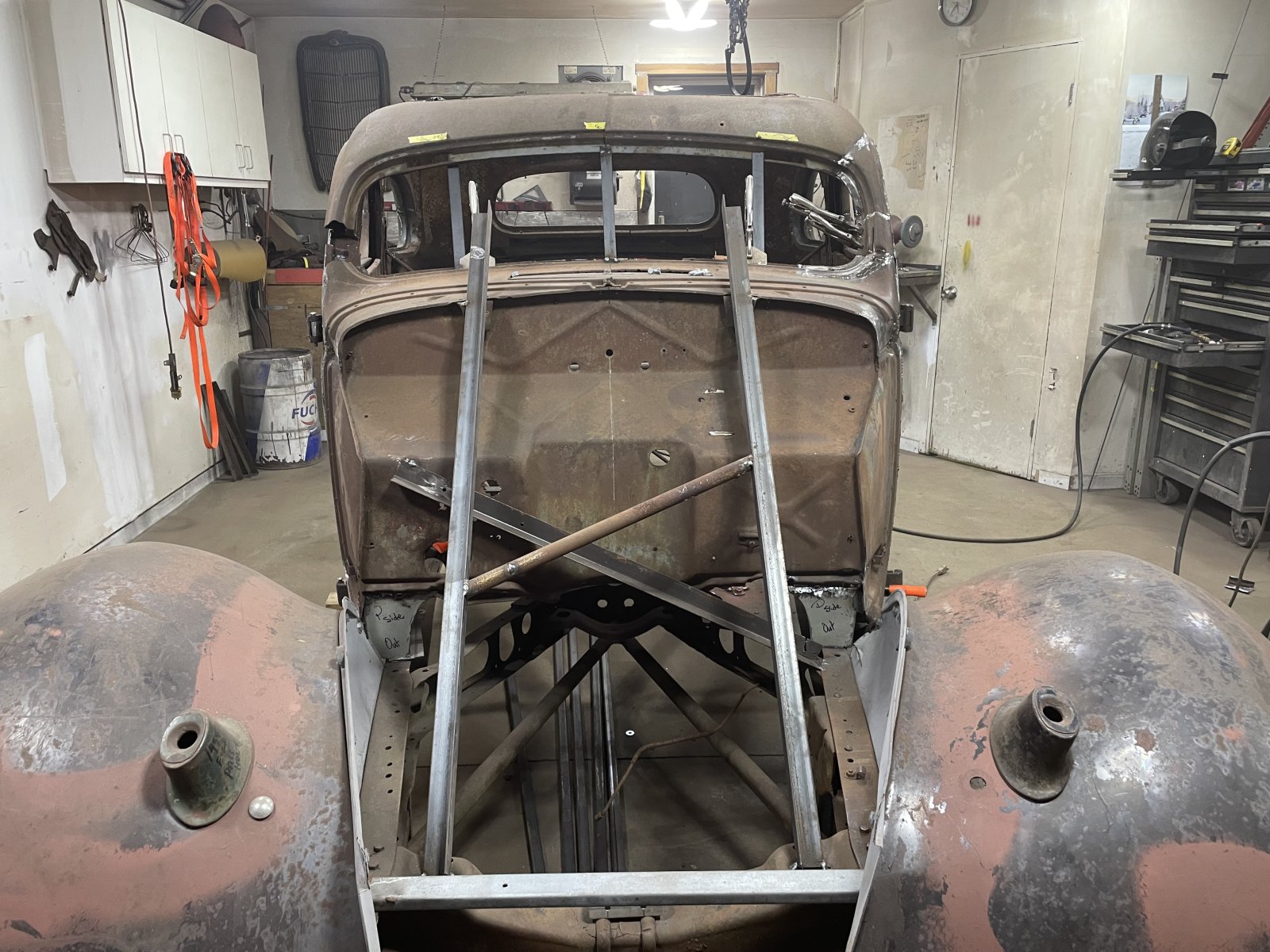

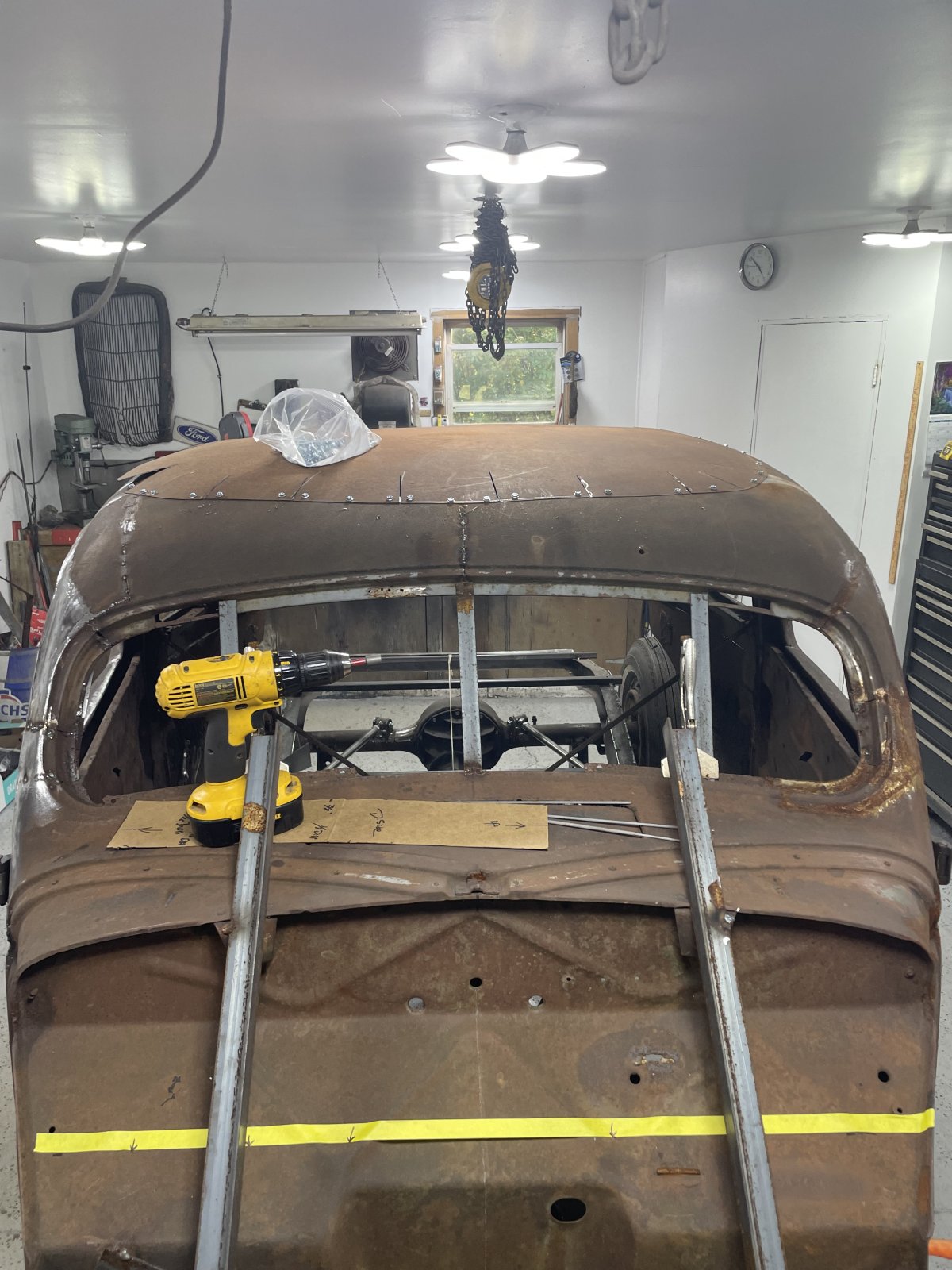

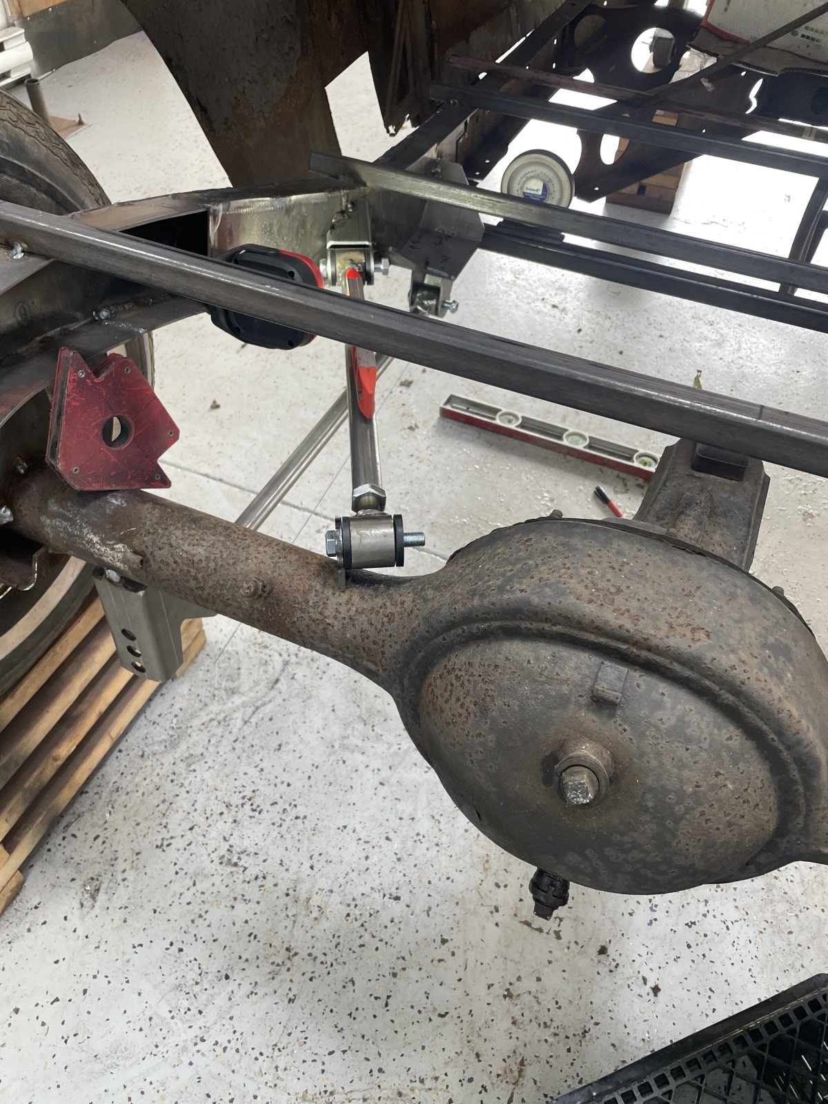

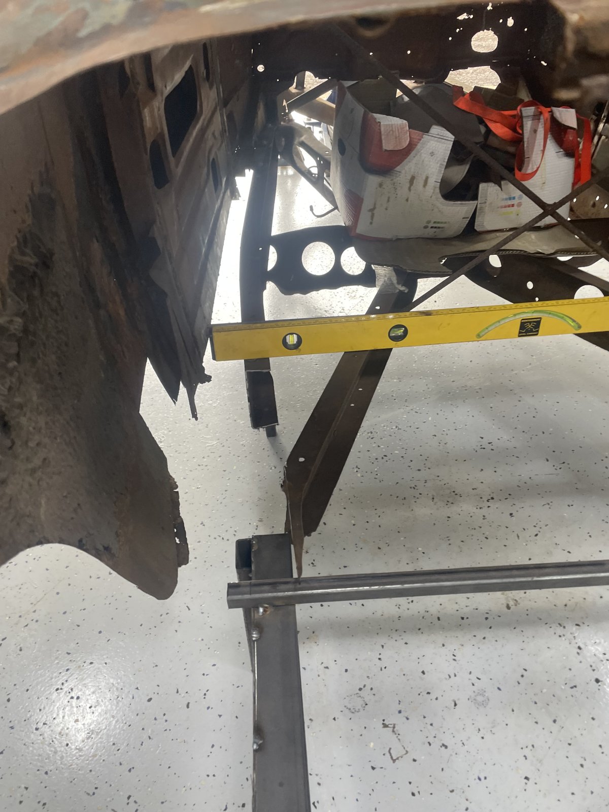

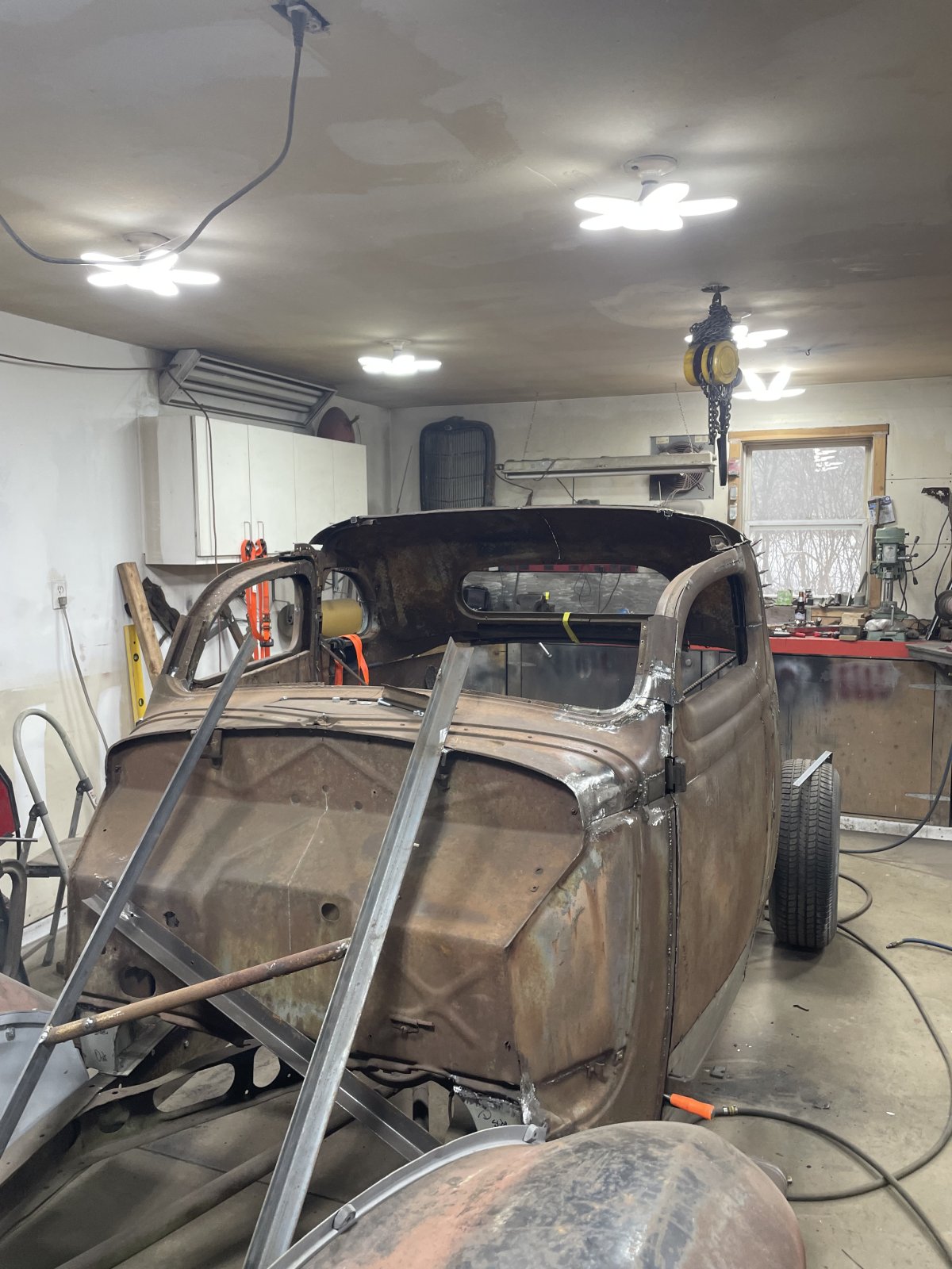

    Had to ditch running leaf springs and opted for triangulated 4link . The new frame is tacked in at this point and is square to body . 112” wheelbase marked out on the floor as is dead on

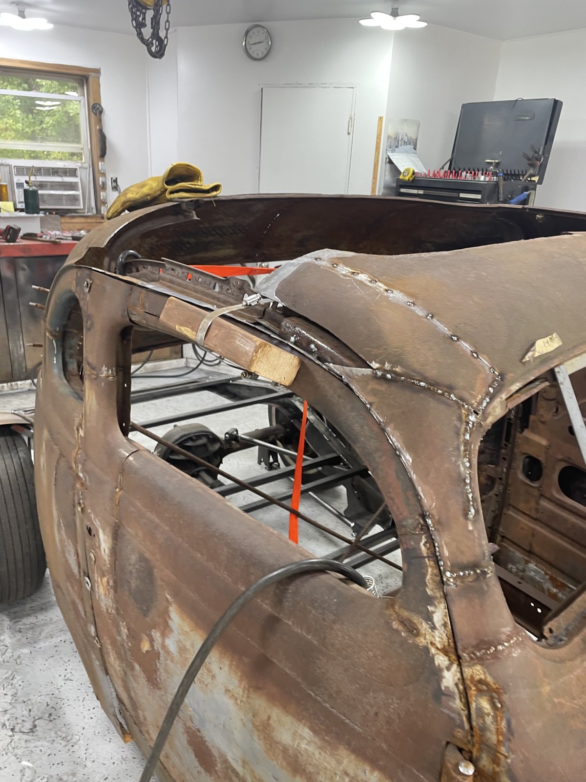

  17. aw1950
    Posts: 1,523

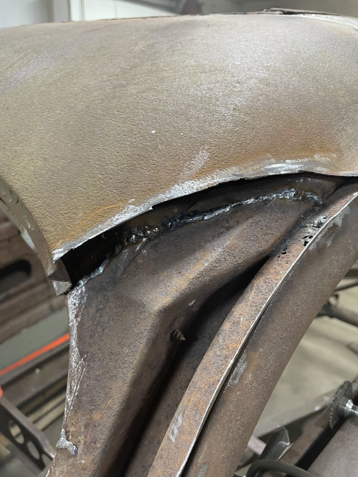

    aw1950

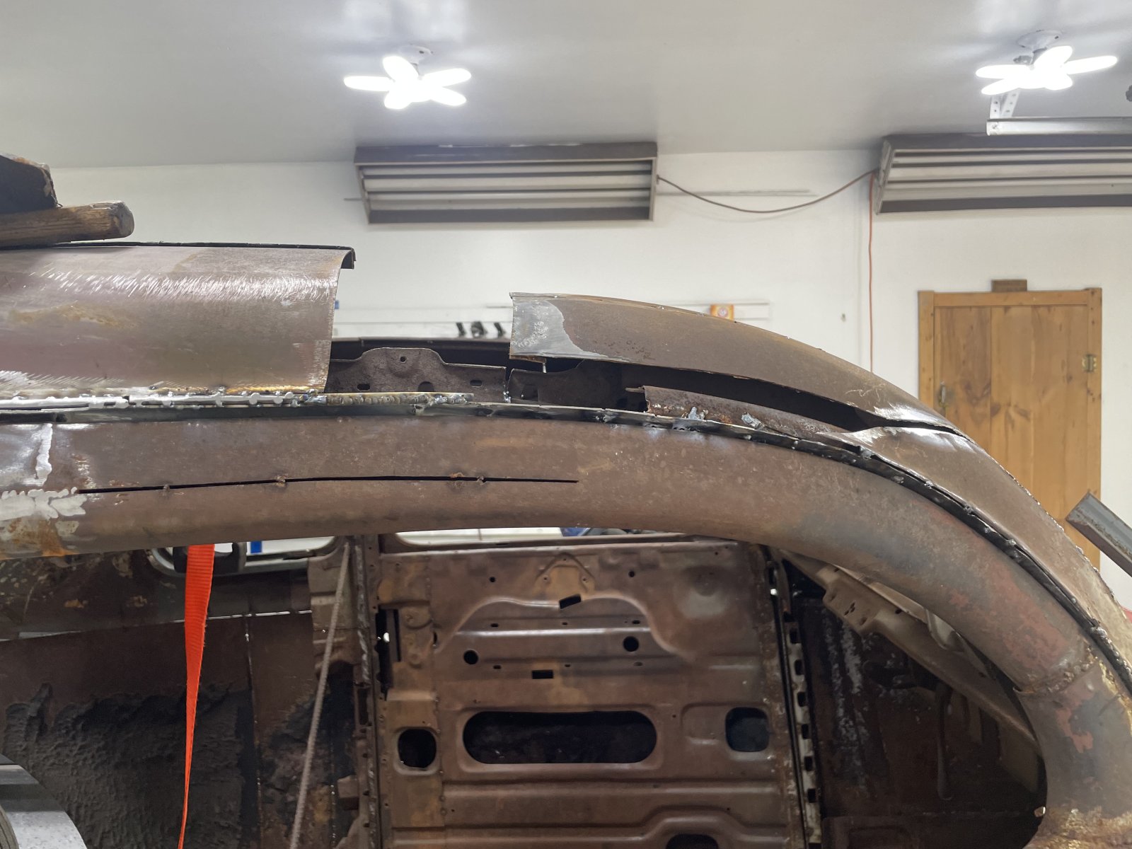

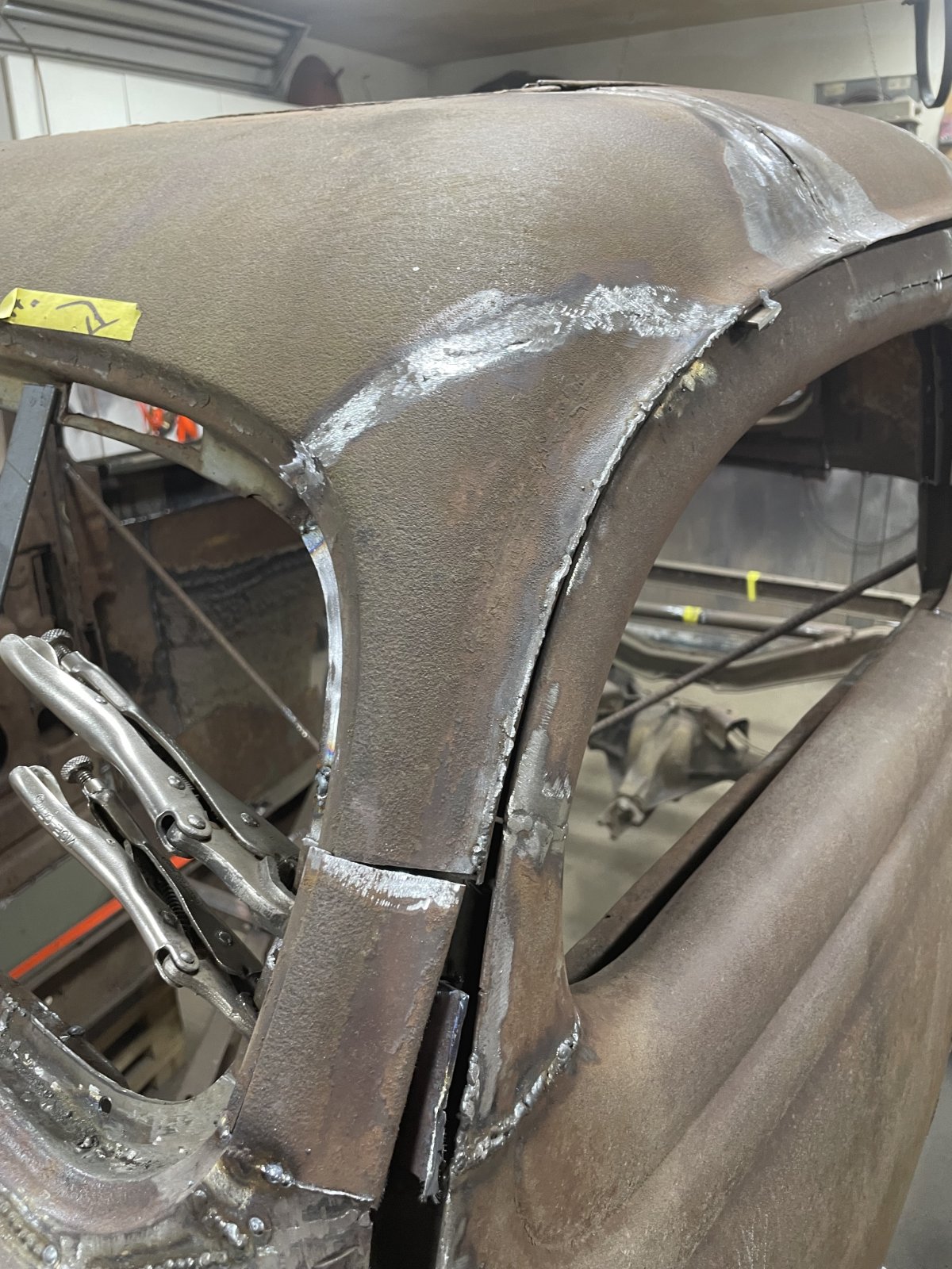

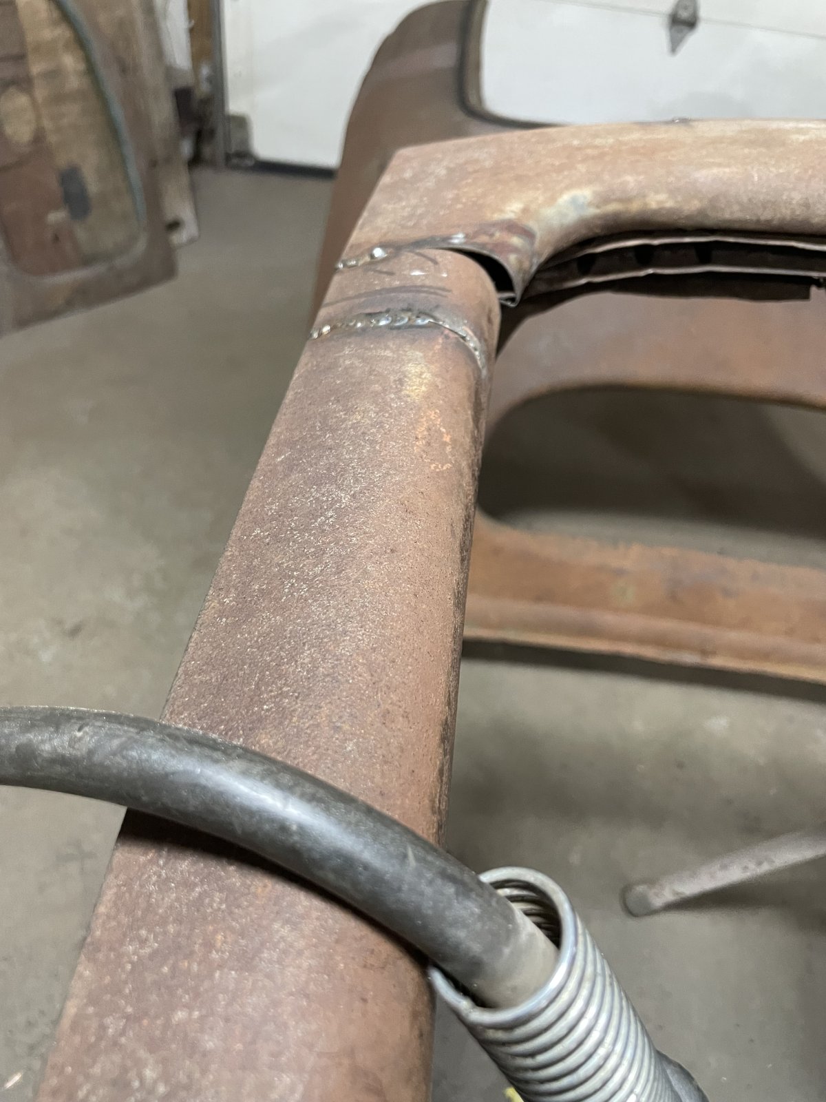

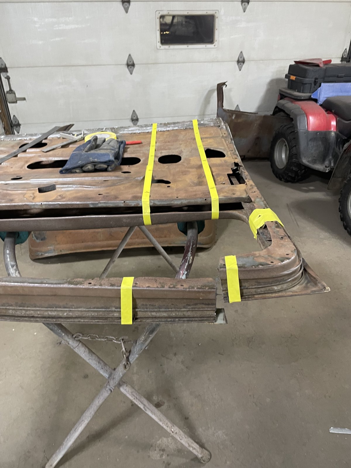

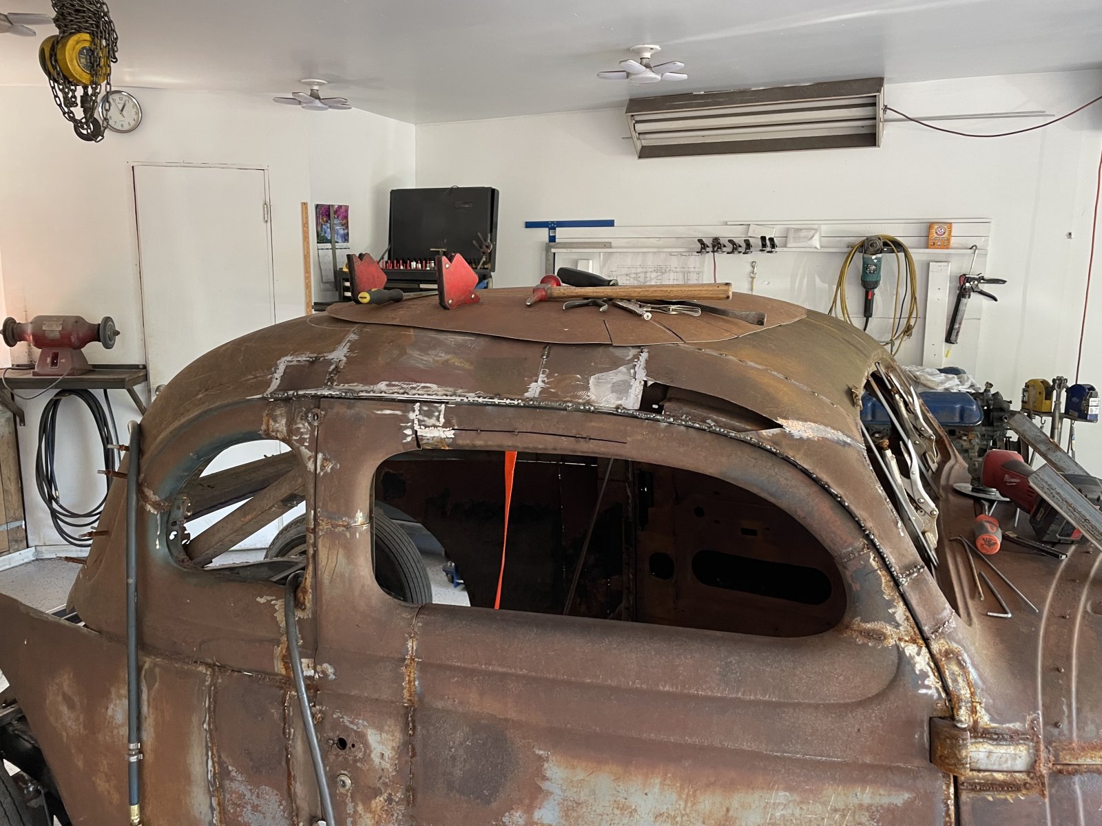

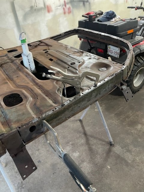

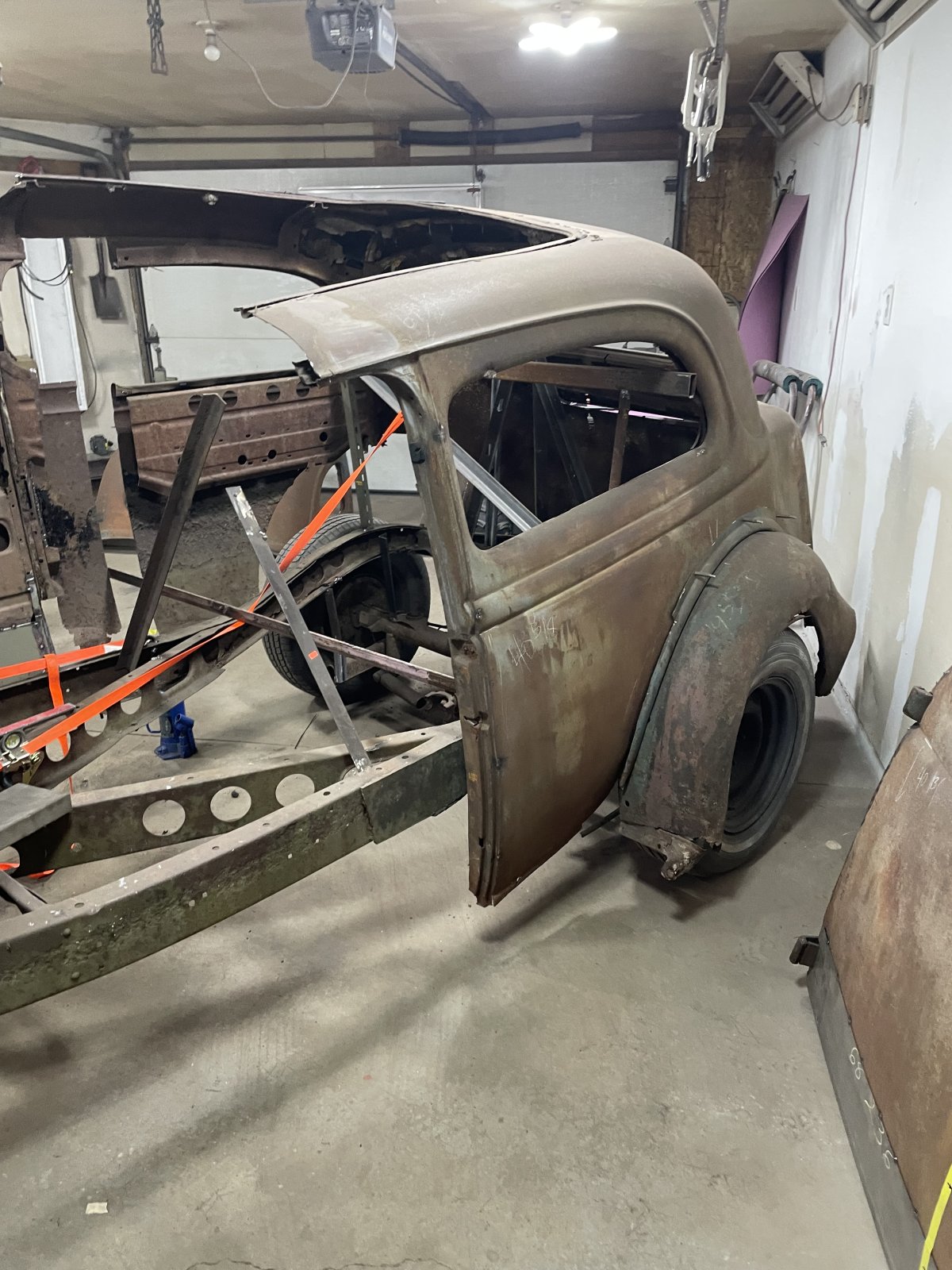

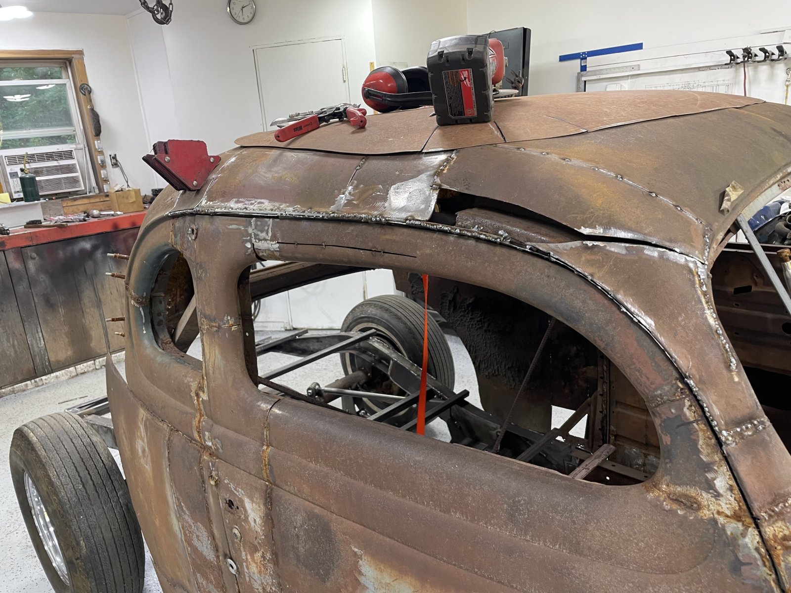

    Tying in the p*** side roof . Lots of fabrication and figuring to do to get this stuff correct

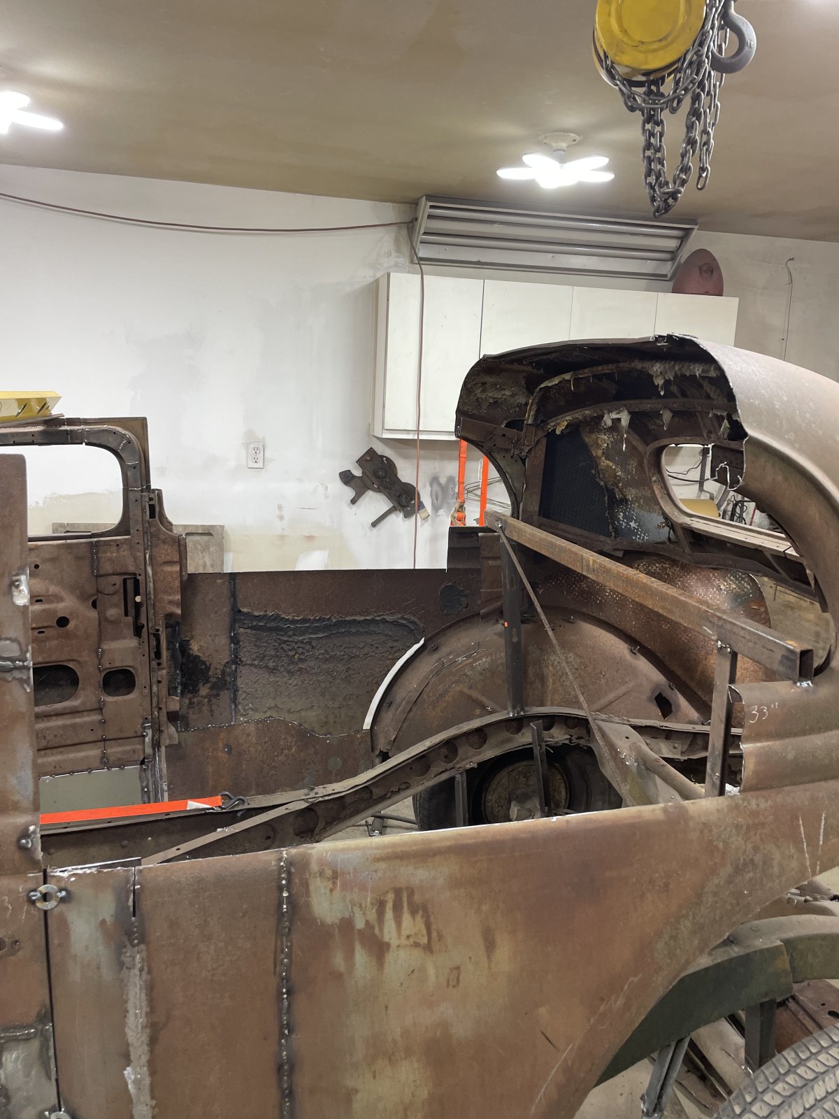

  18. aw1950
    Posts: 1,523

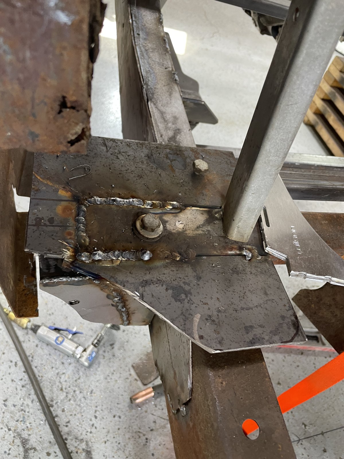

    aw1950

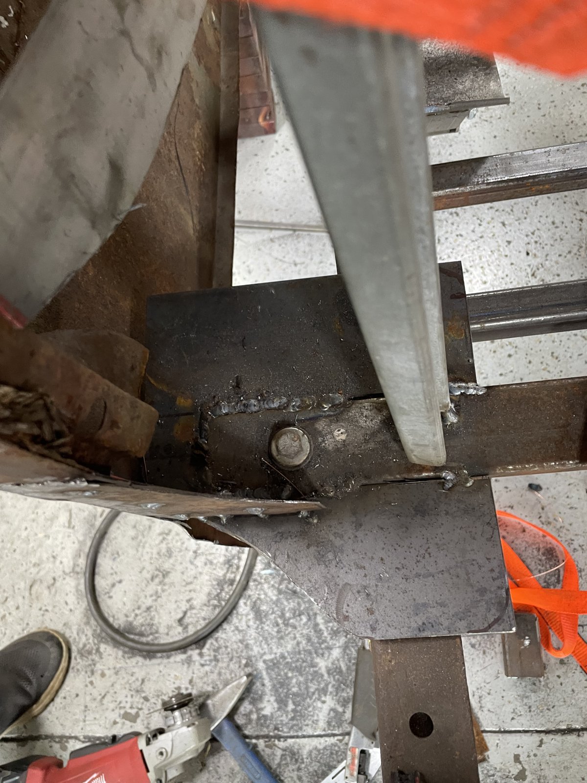

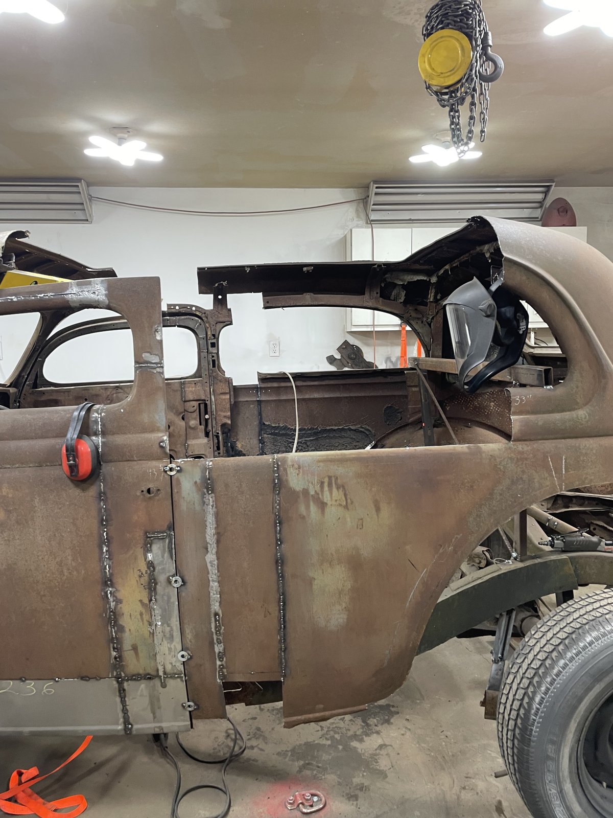

    Building my version of trying in the b pillar . So long as it holds secure and is solid who cares if it’s not how Ford built it .1/8” plate tied into the new floor framework . Overkill?

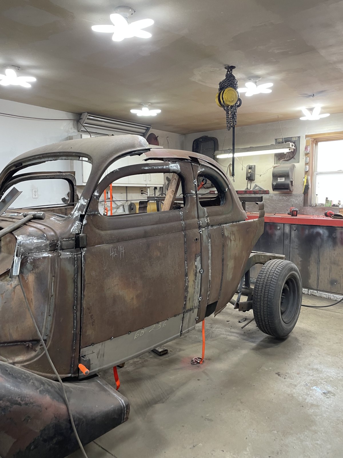

  19. aw1950
    Posts: 1,523

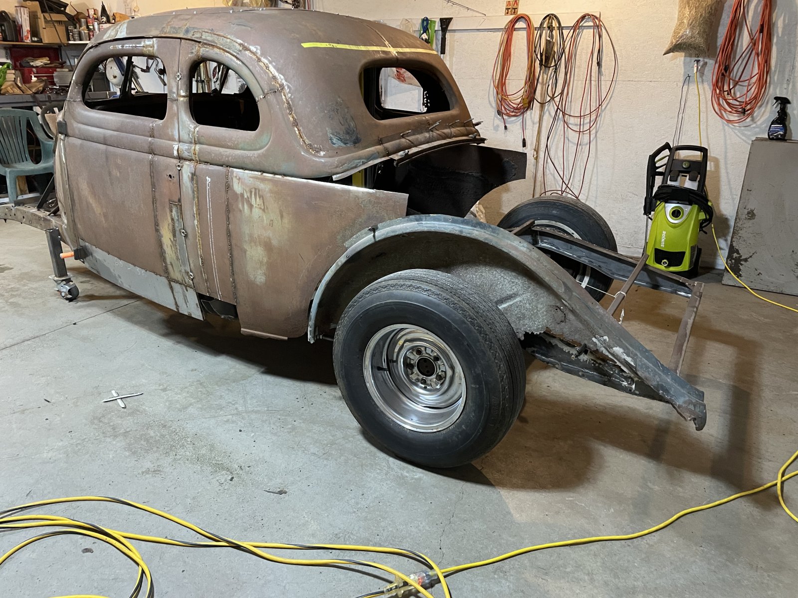

    aw1950

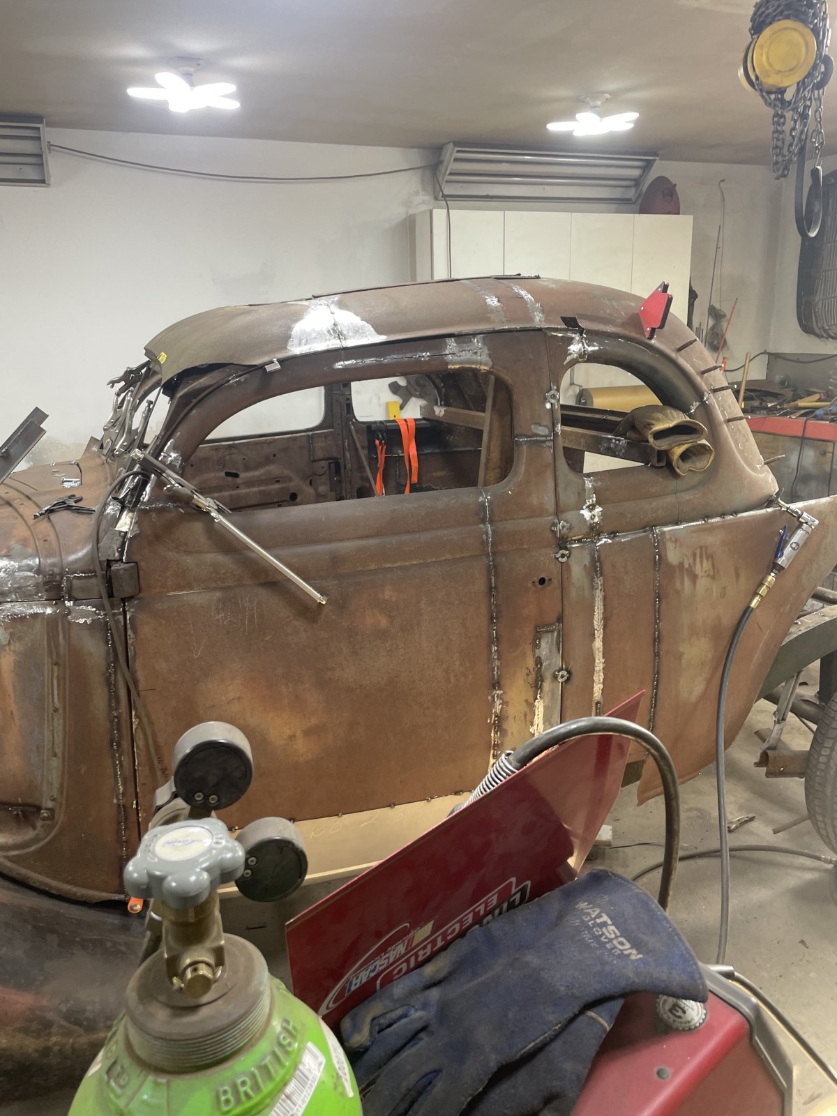

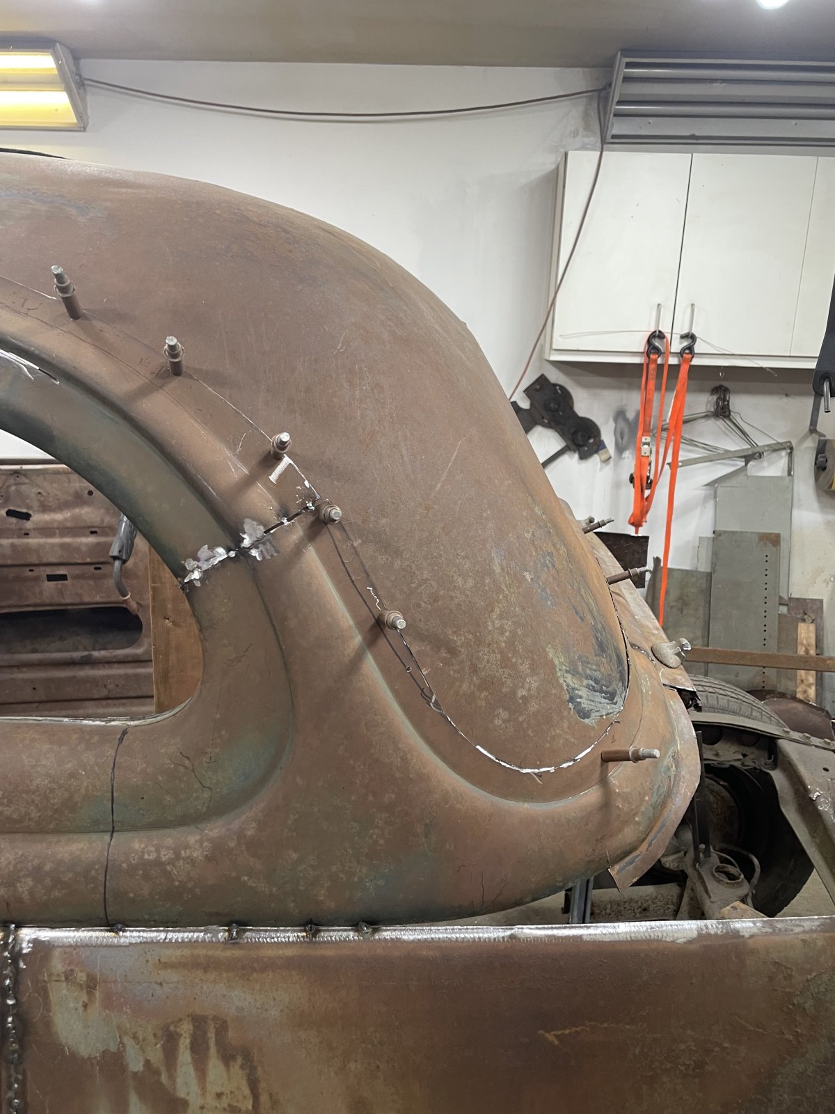

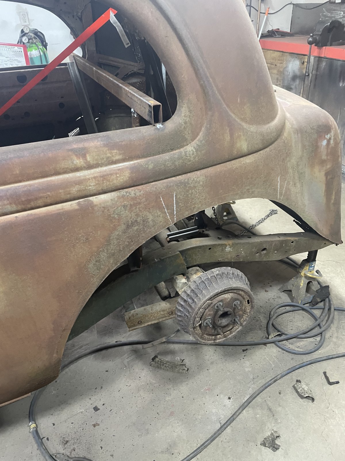

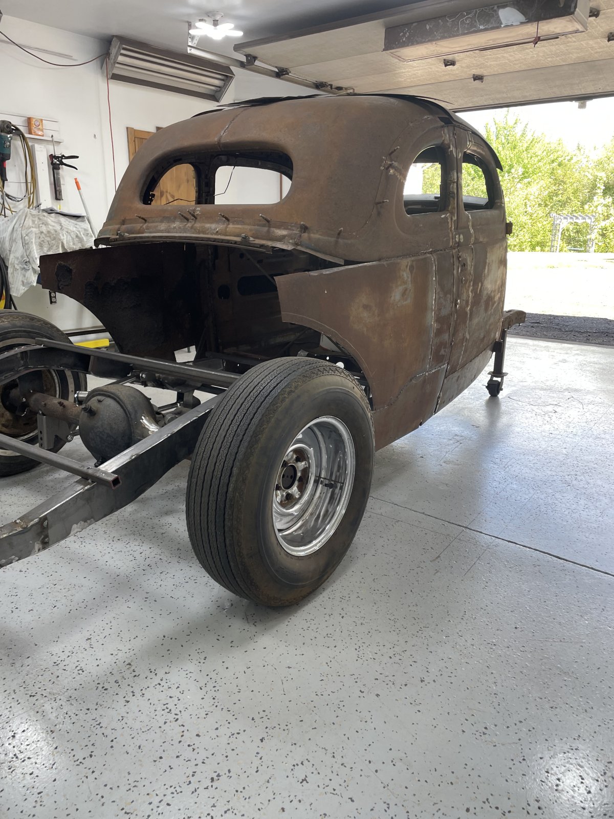

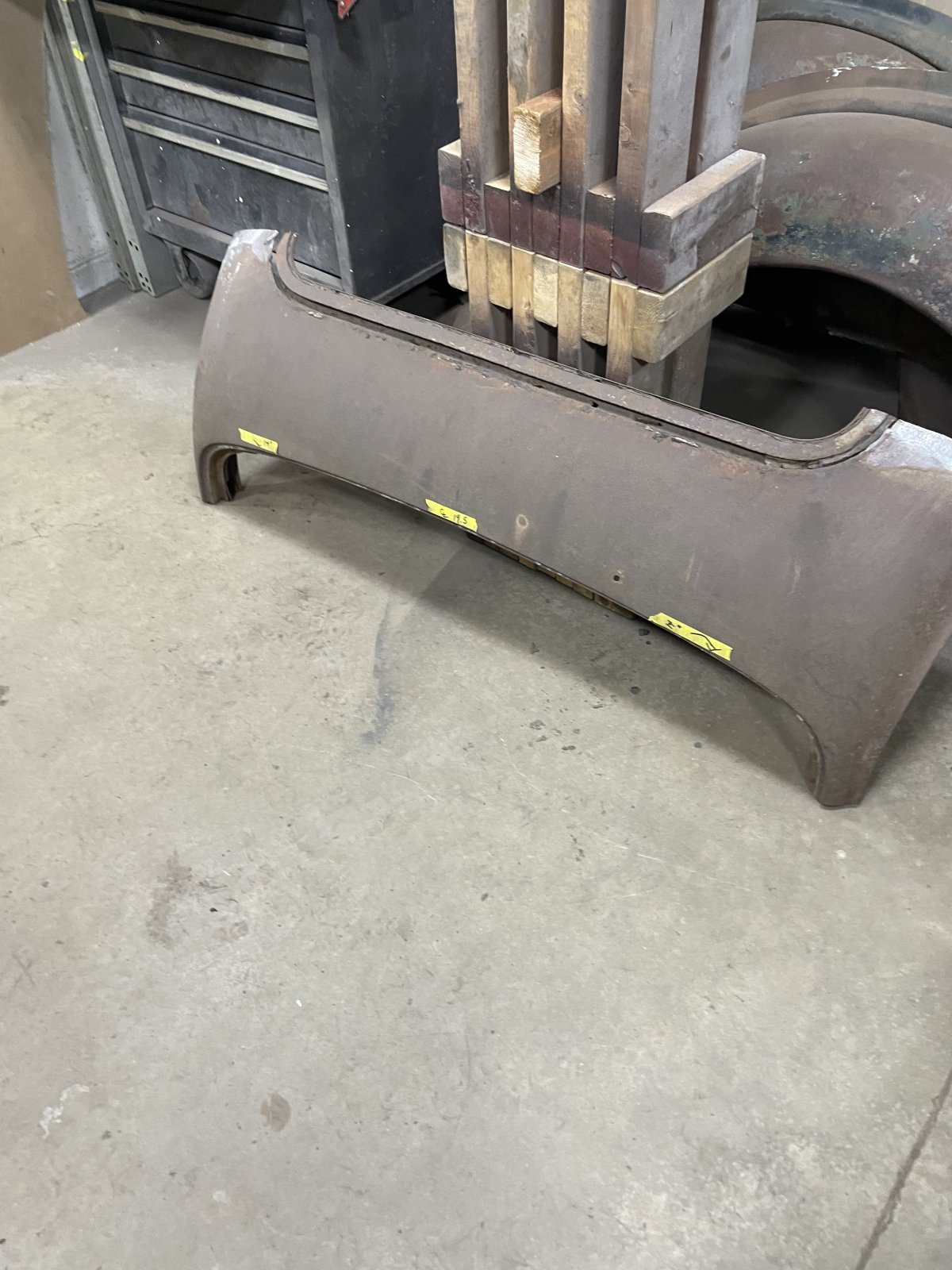

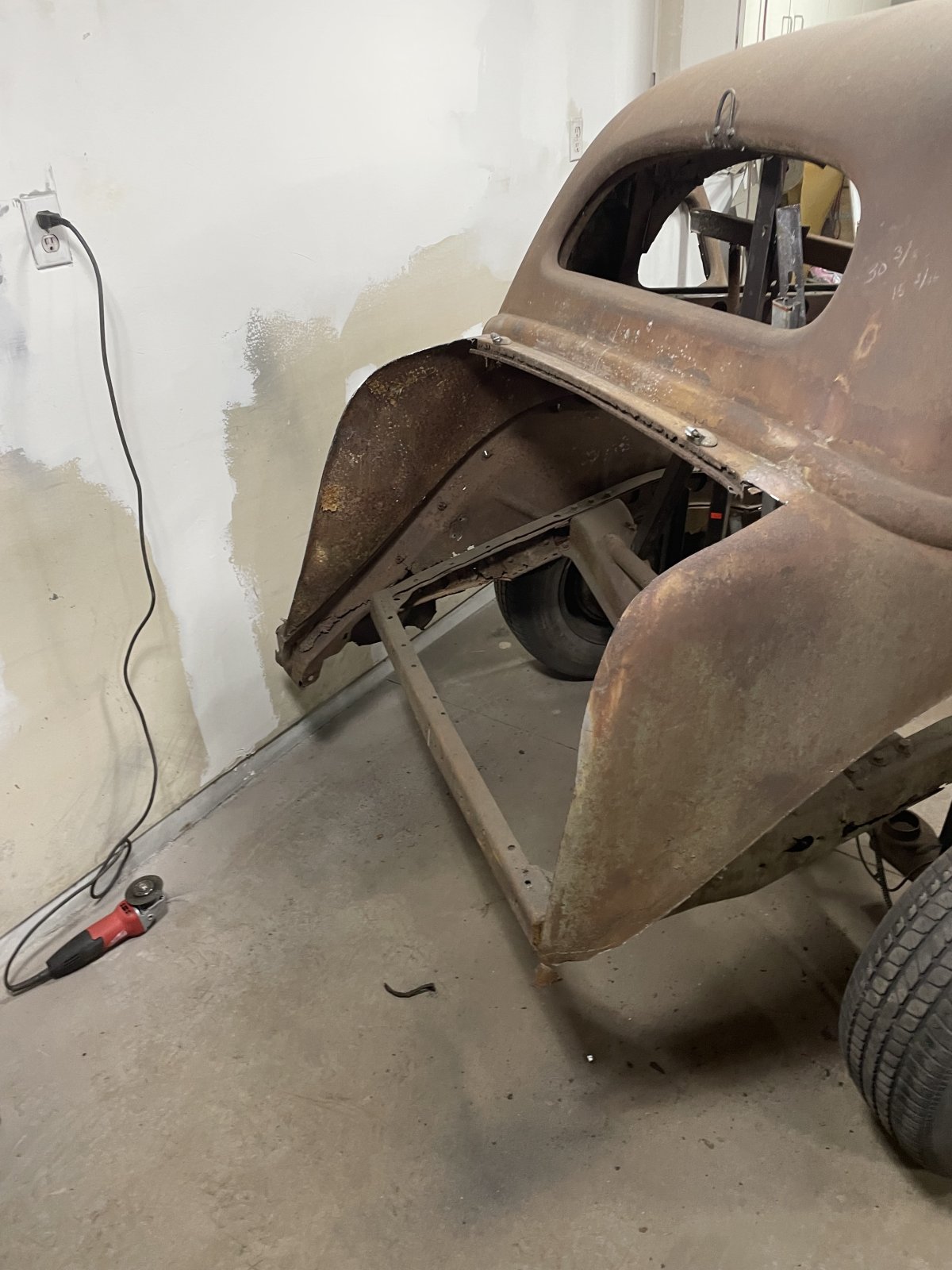

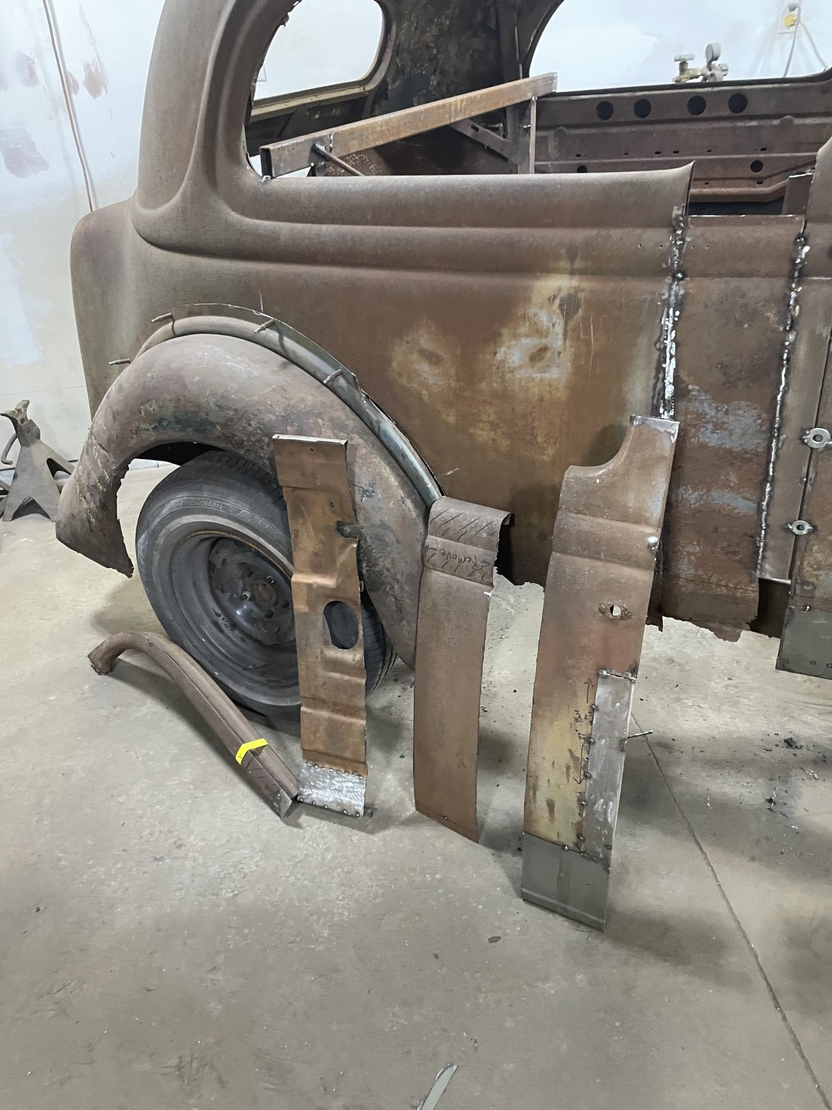

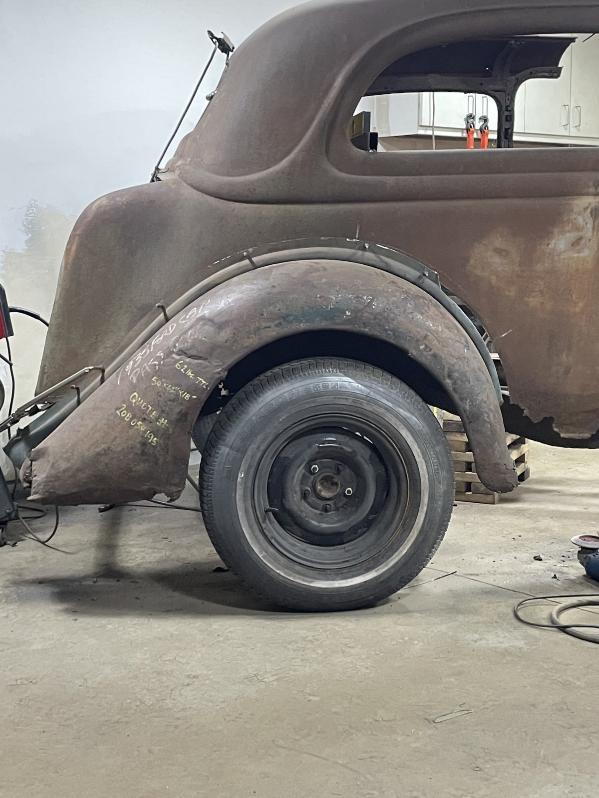

    Using a 1951 Chevrolet roof panel to fill in the opening in the roof of the coupe . Also starting to mock up the wheel openings of the coupe . This is as of Sept 26/24 . Lots of pictures to see , enjoy And I will endeavour to keep this file more up-to-date. Stay tuned.

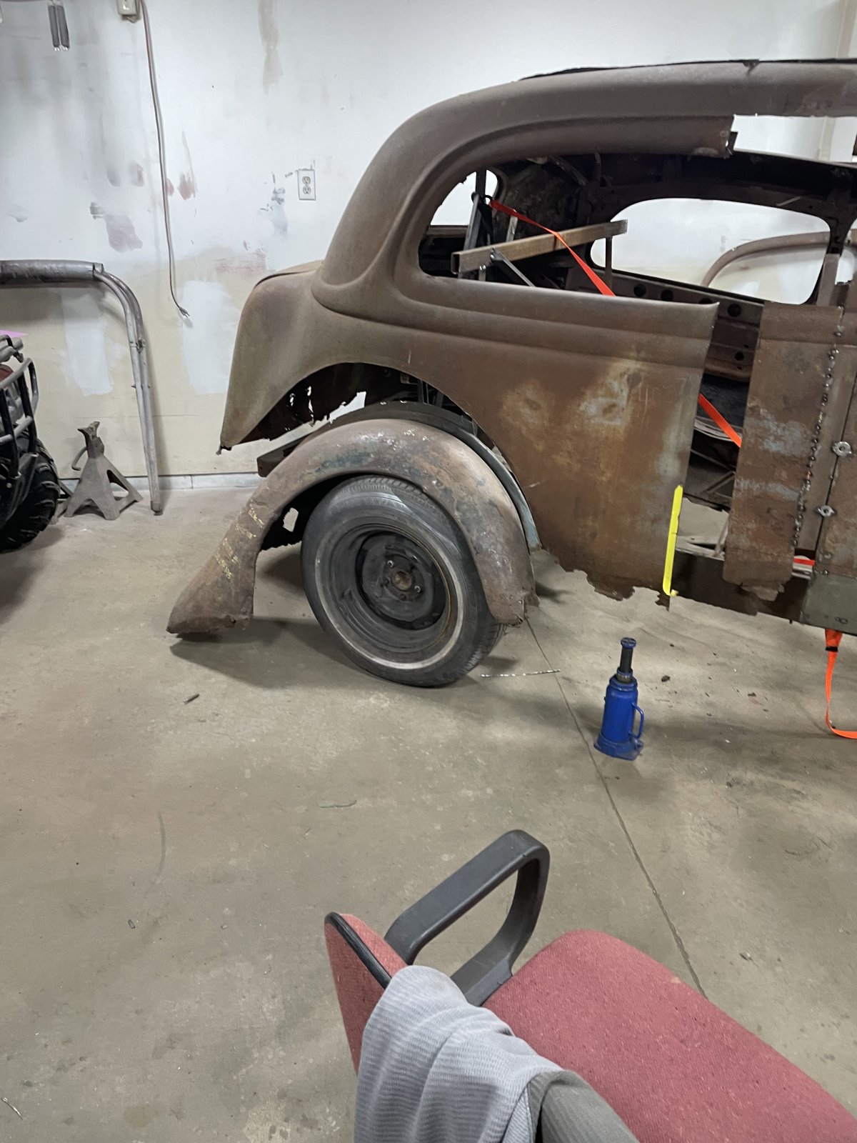

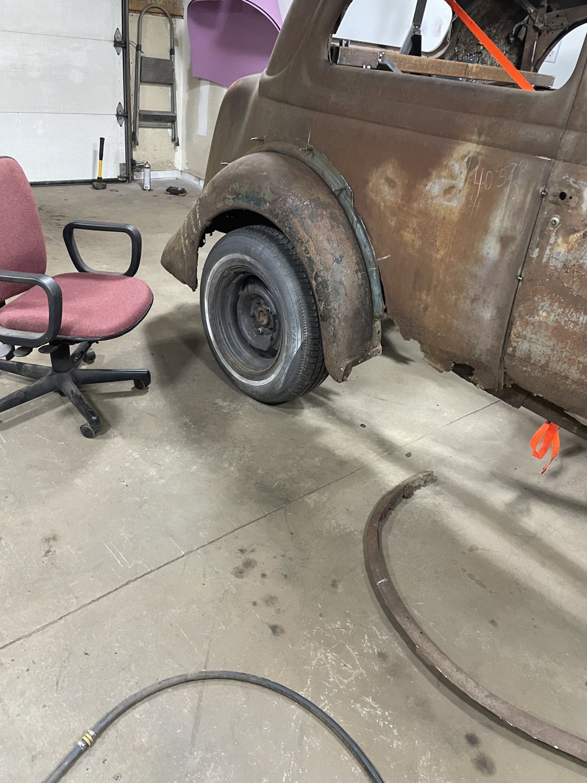

  20. insomniacshotrods
    Joined: Jan 27, 2009
    Posts: 195
    insomniacshotrods

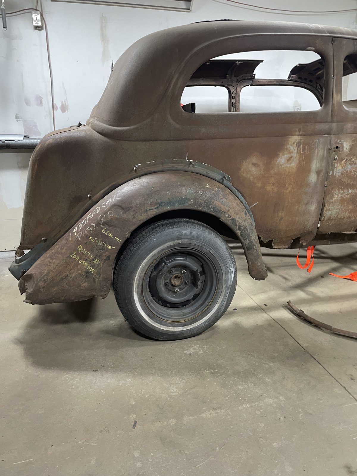

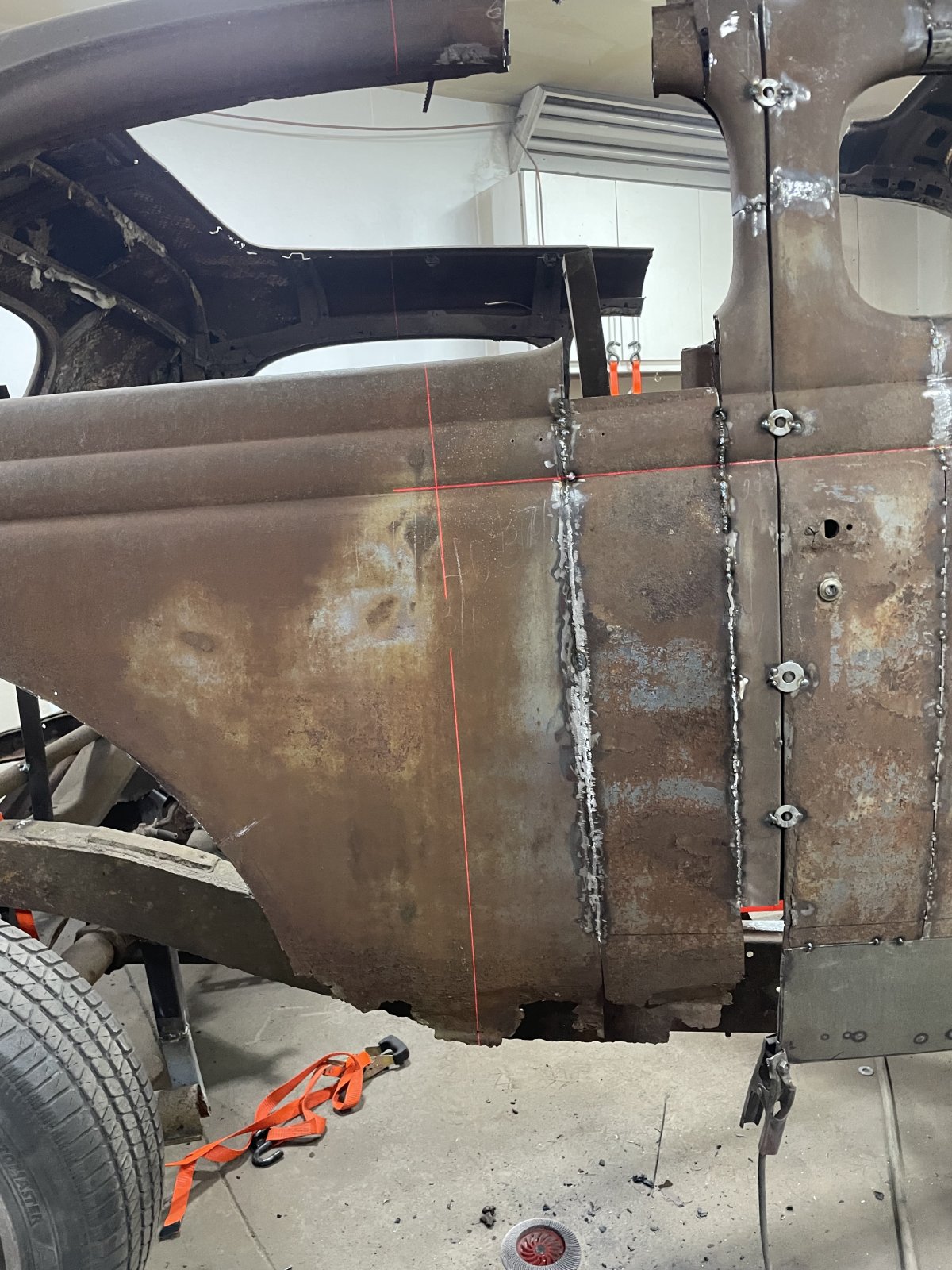

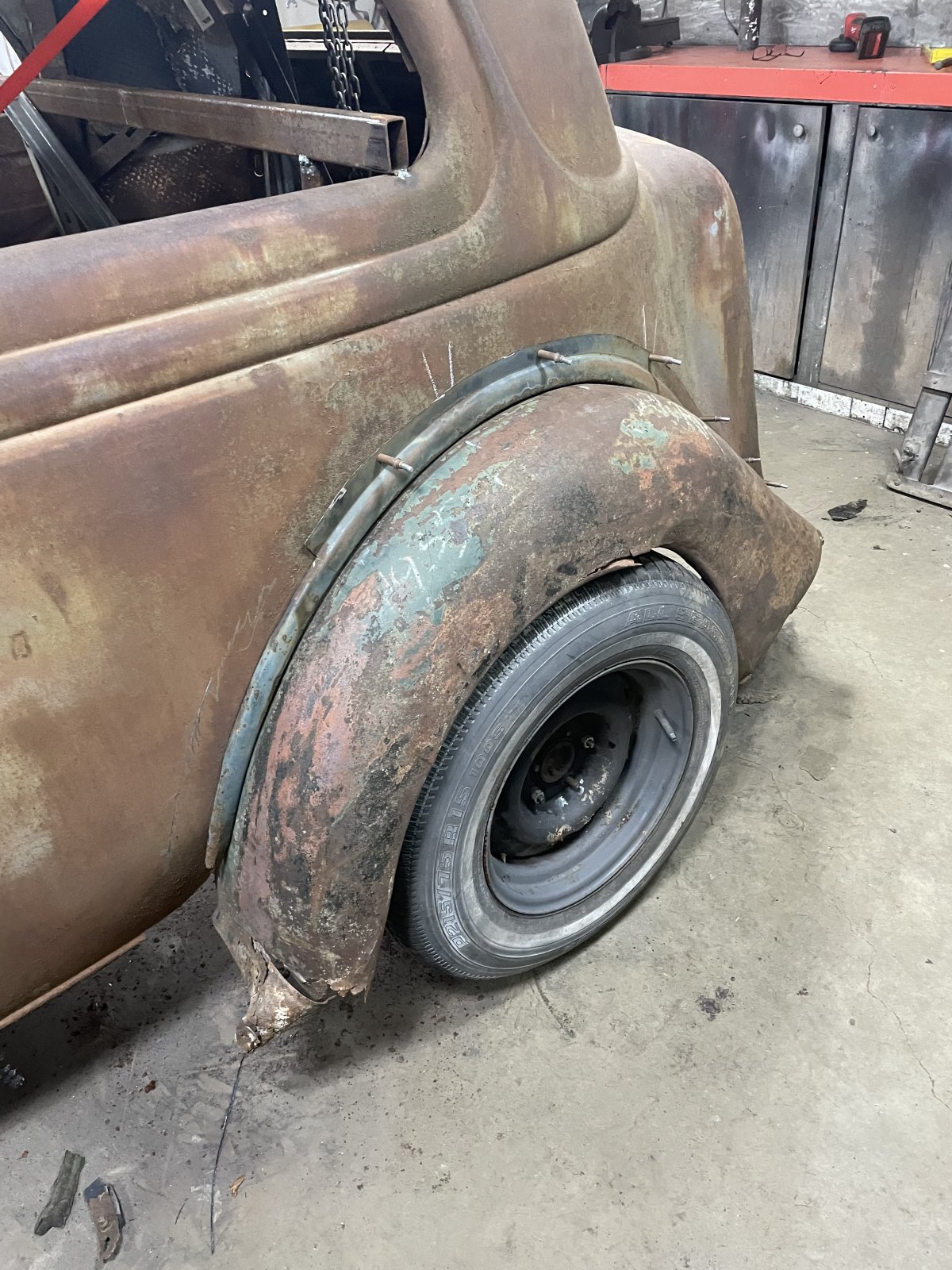

    Not to criticize your work, your doing one heck of a build, just a question about the rear quarter length and wheel well placement. Here is my 36 to compare, just wondering if your going to shorten the quarter? Man what a job, Id never have the balls to try that for sure. Great job so far.
    Squablow, BigRRR and aw1950 like this.
  21. aw1950
    Posts: 1,523
    aw1950
    Thanks for the positive feedback . My wheel arch is just clecoed on just for inspiration . I have no reference info at this point . Maybe you could give me some measurements . Door opening to the front of the bead that surrounds the fender once it’s mounted . I have to order a EMS tail pan section and start making sheet metal pieces from the new pan forward . With your dimension you could provide me will be a big help !!
    BigRRR, Squablow and vtx1800 like this.

    What would you say the chop is 3”? That in itself is an amazing feat. This can’t be your first car to dissect . Really is cool, you’ll be super proud when you get this accomplished.

    aw1950
    Yeah I’ve done lots of fabrication over the years LOL it’s a 3” wedged chop . Meaning that the cut in the front is the full 3 “ tapering off to 1” at the belt line in the back . Gives the roofline that wedge look side profile
