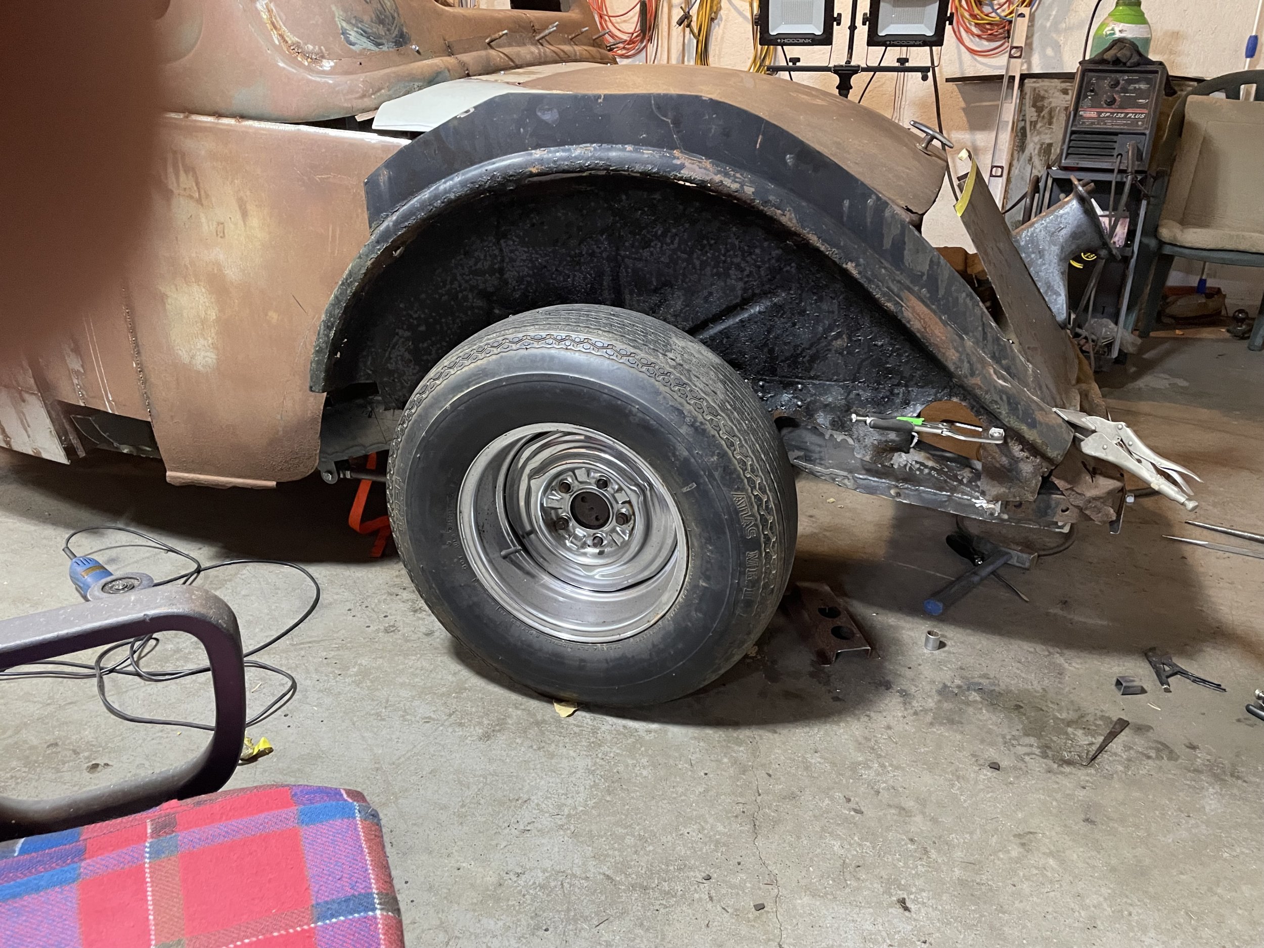

    Posts: 1,511
    aw1950

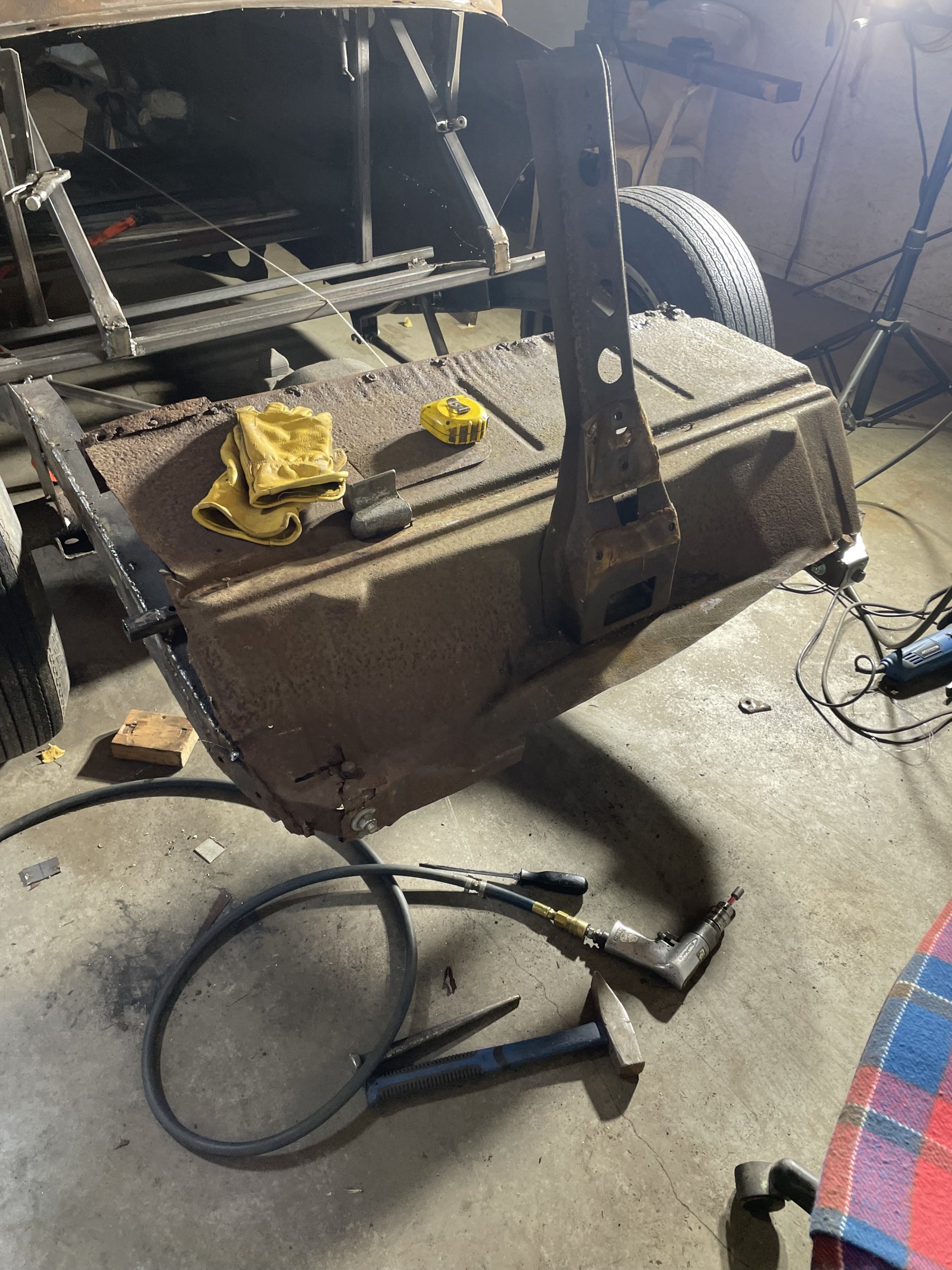

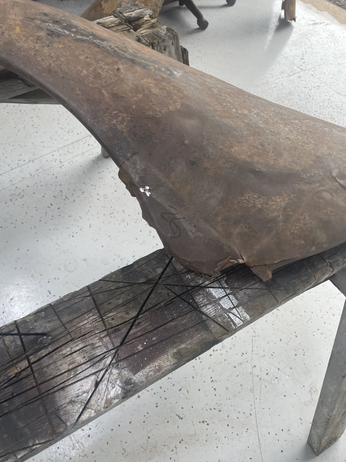

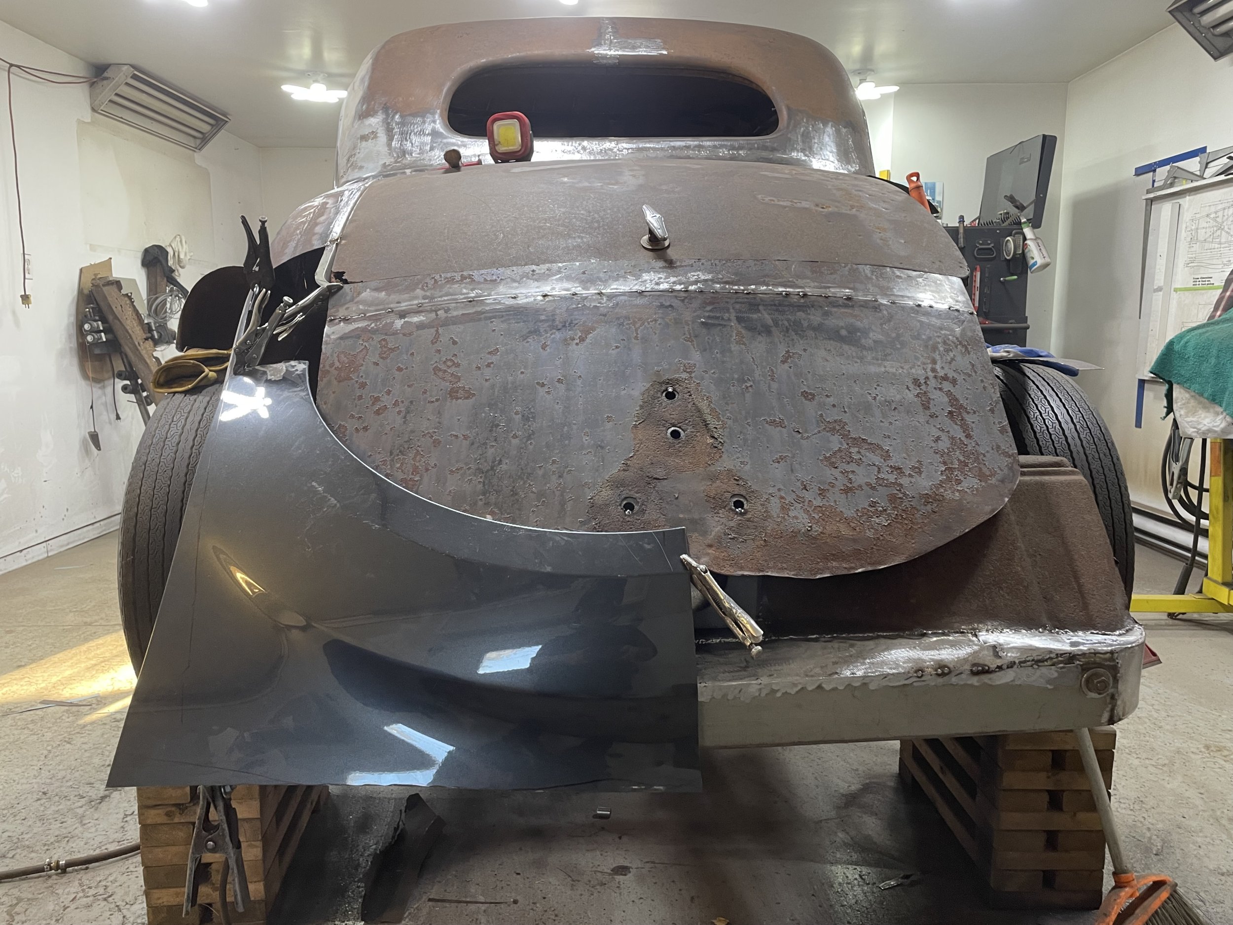

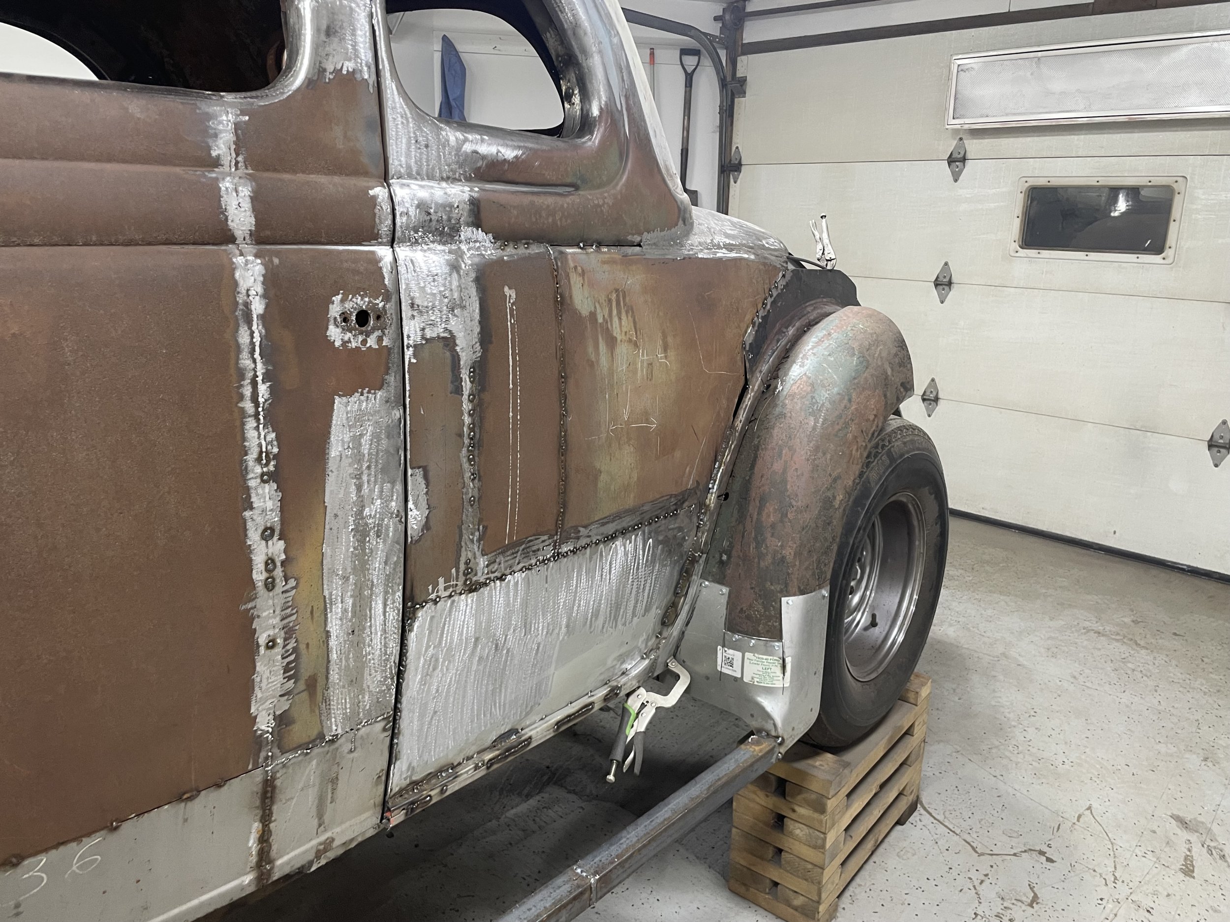

    Had a couple hours to kill this afternoon. Worked on the damaged left rear fender IMG_1170.jpeg

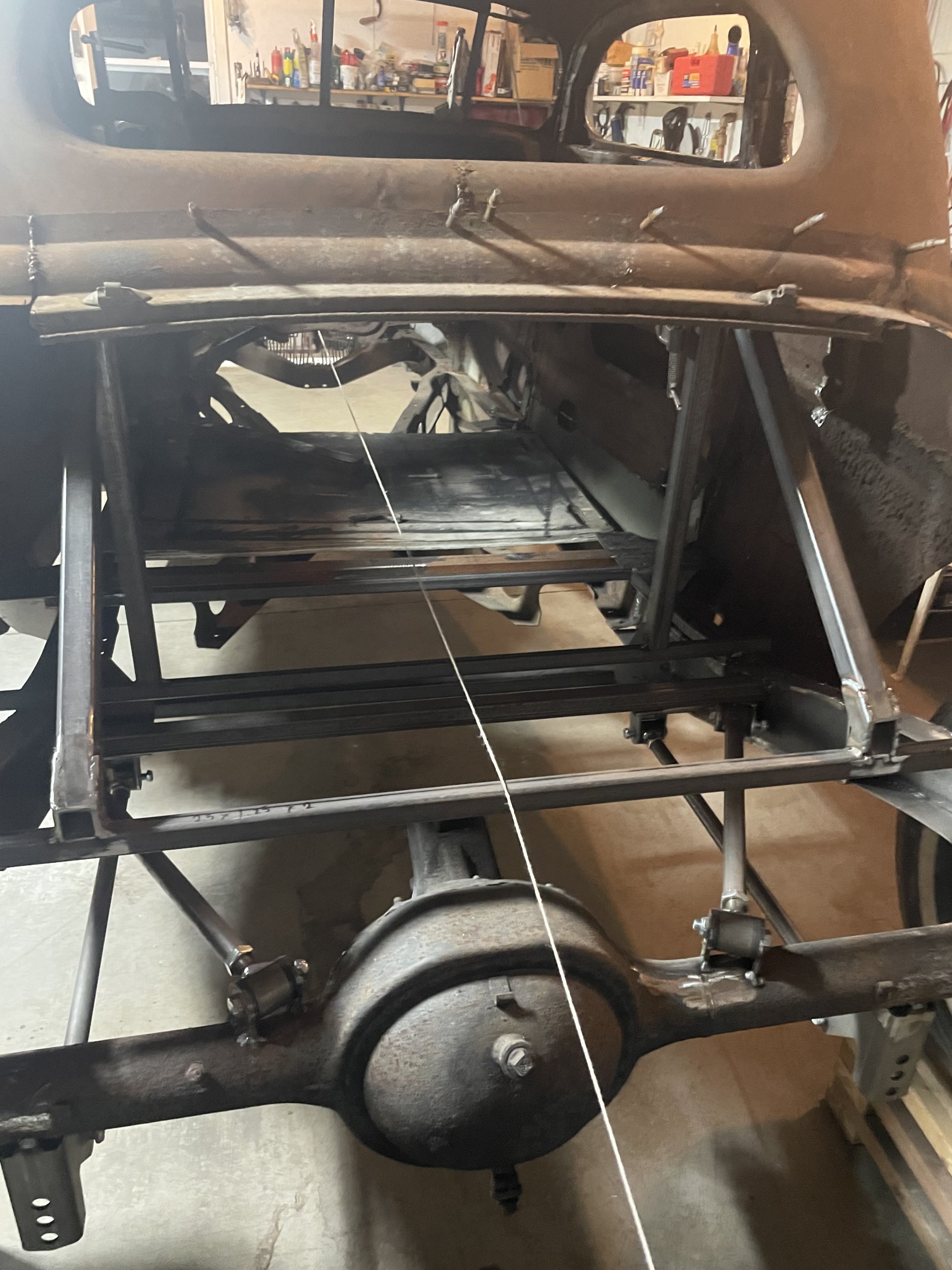

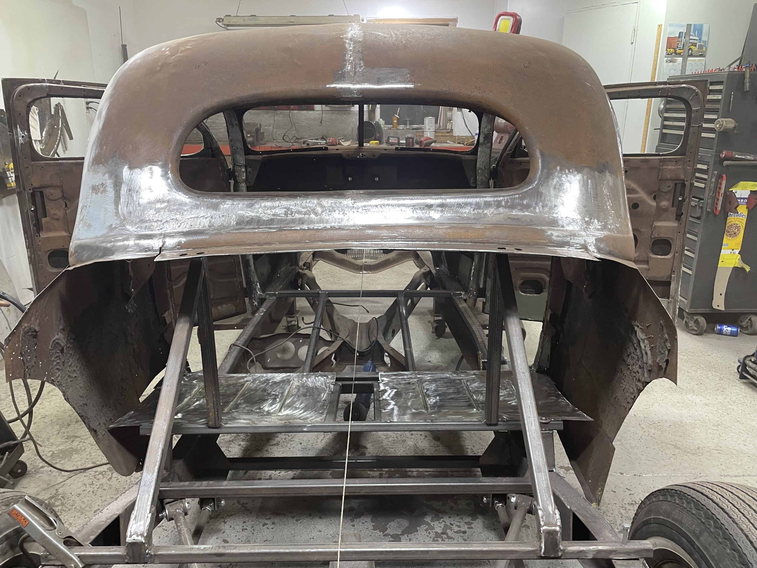

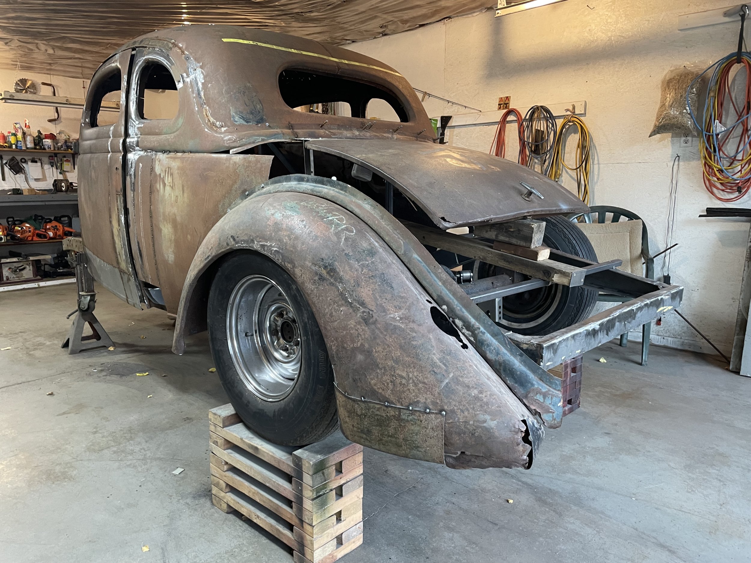

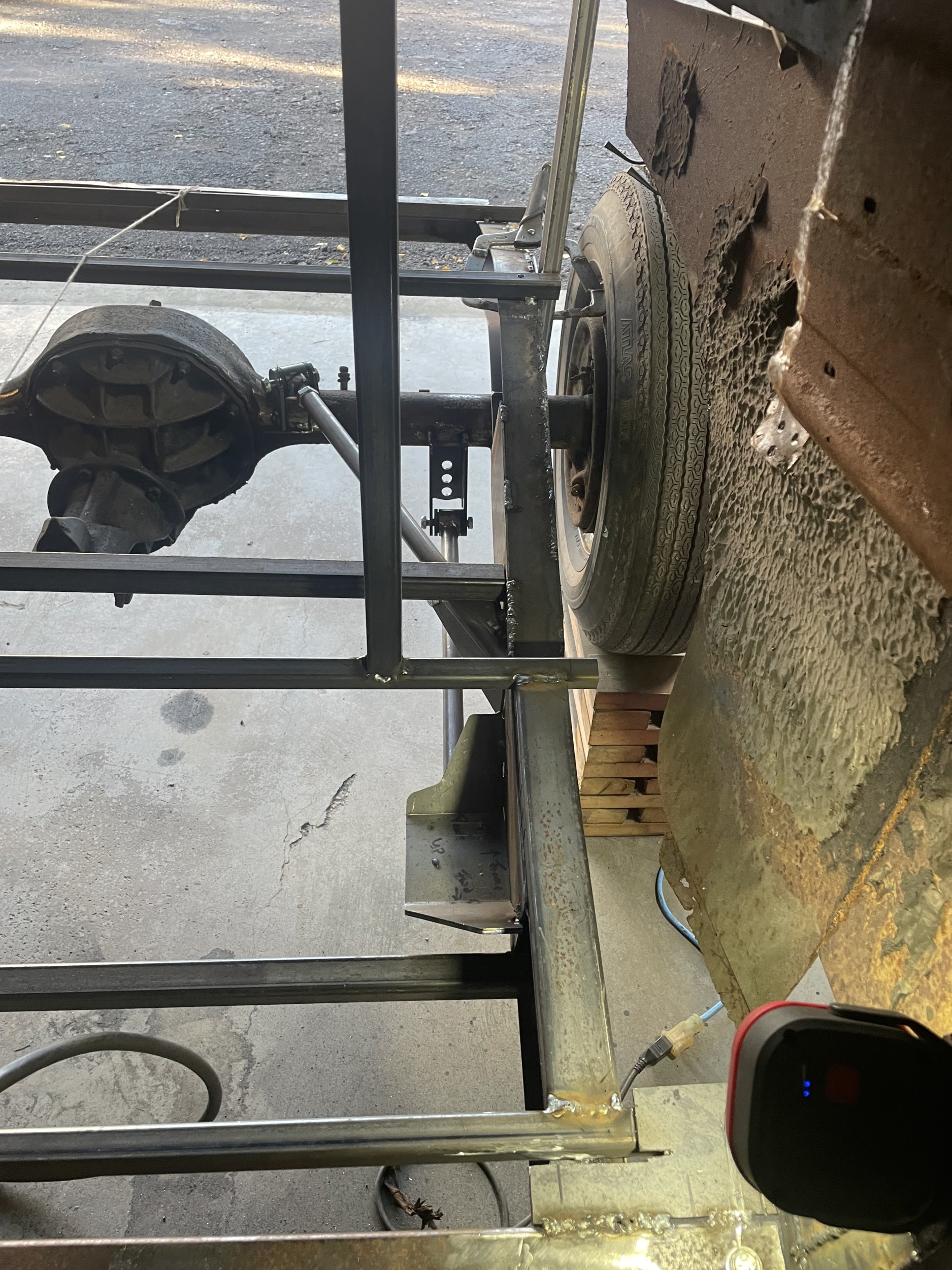

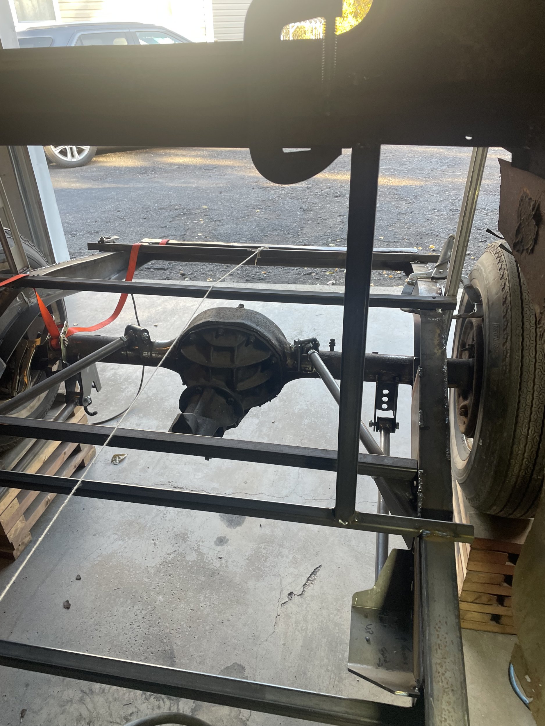

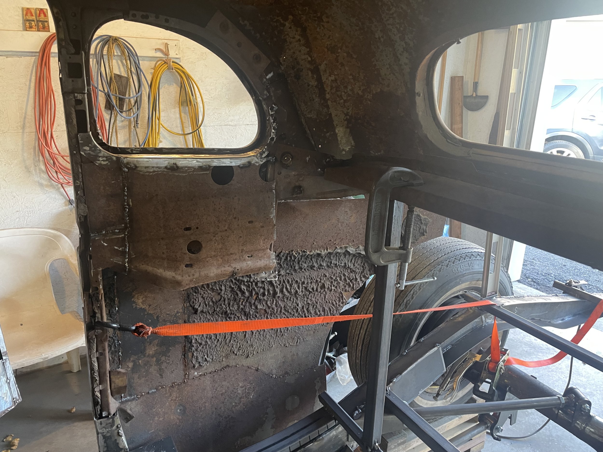

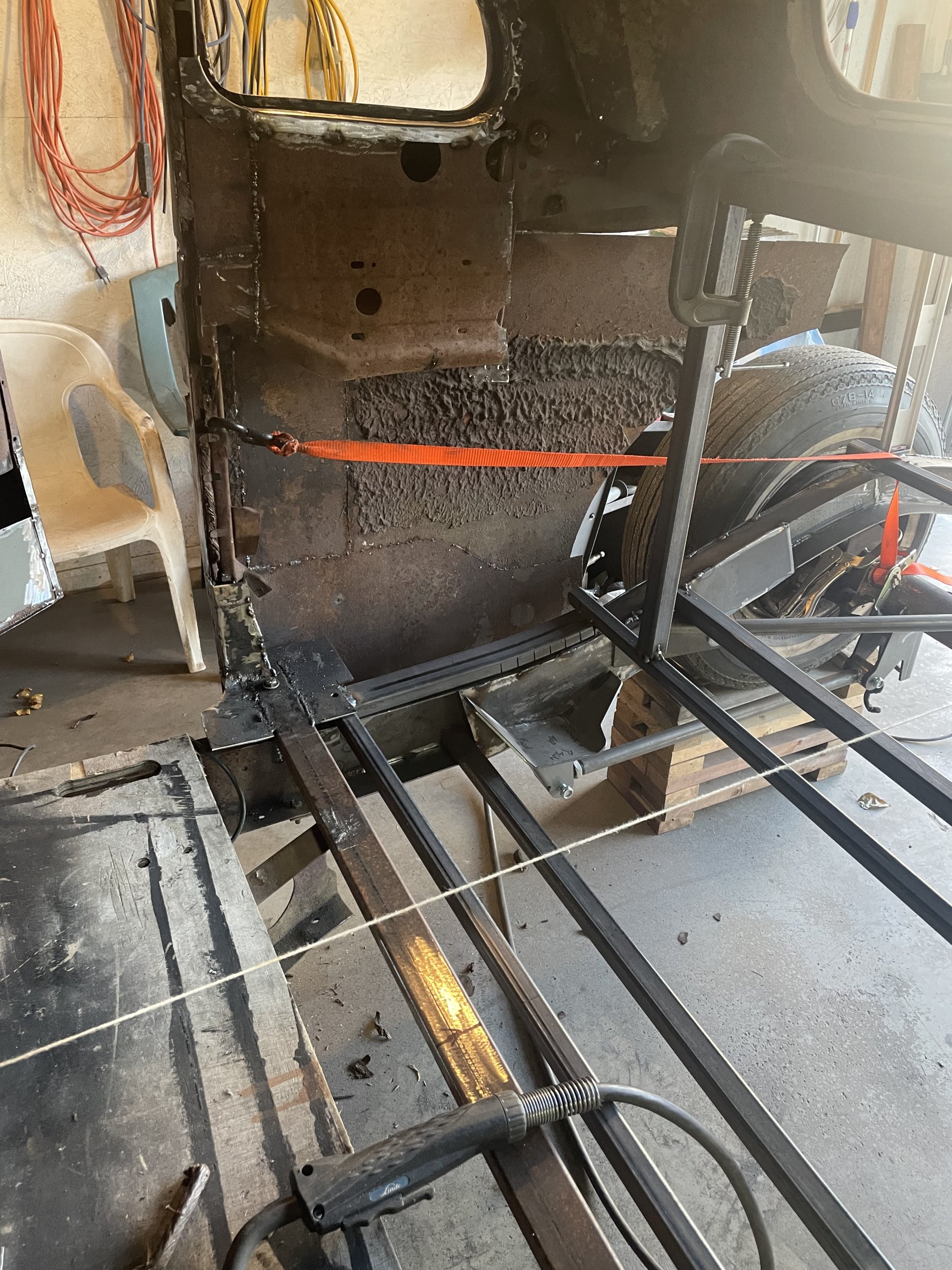

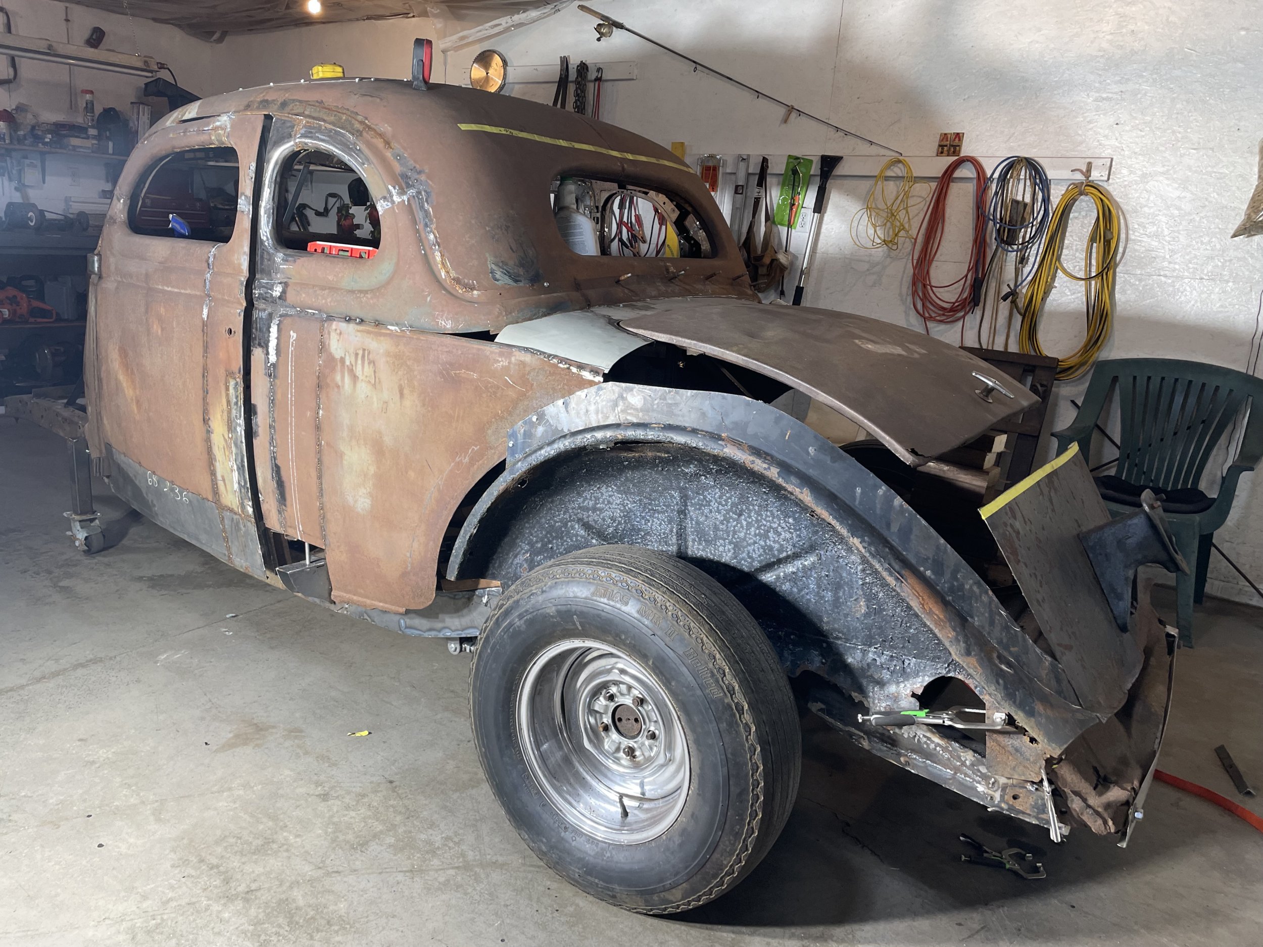

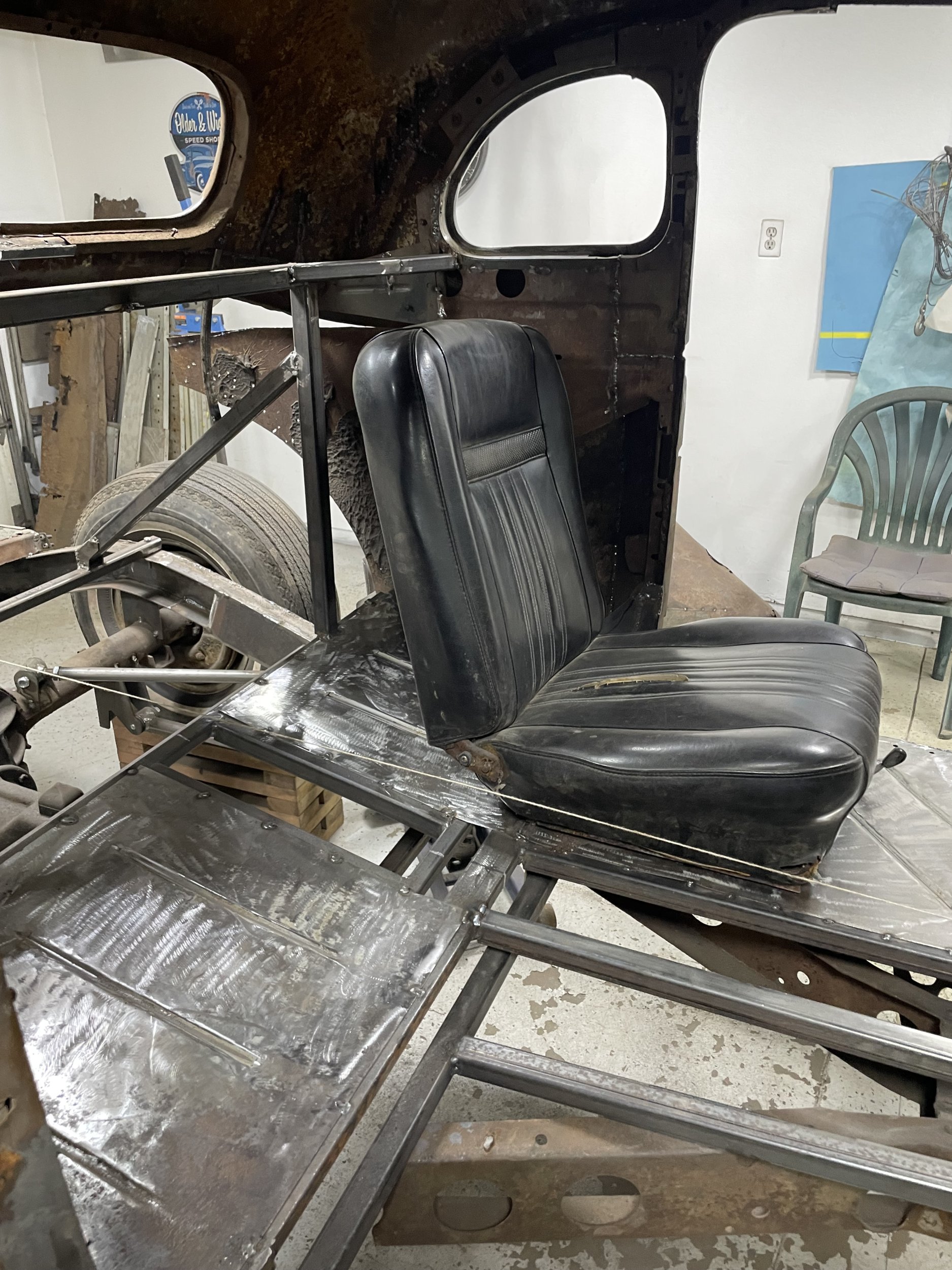

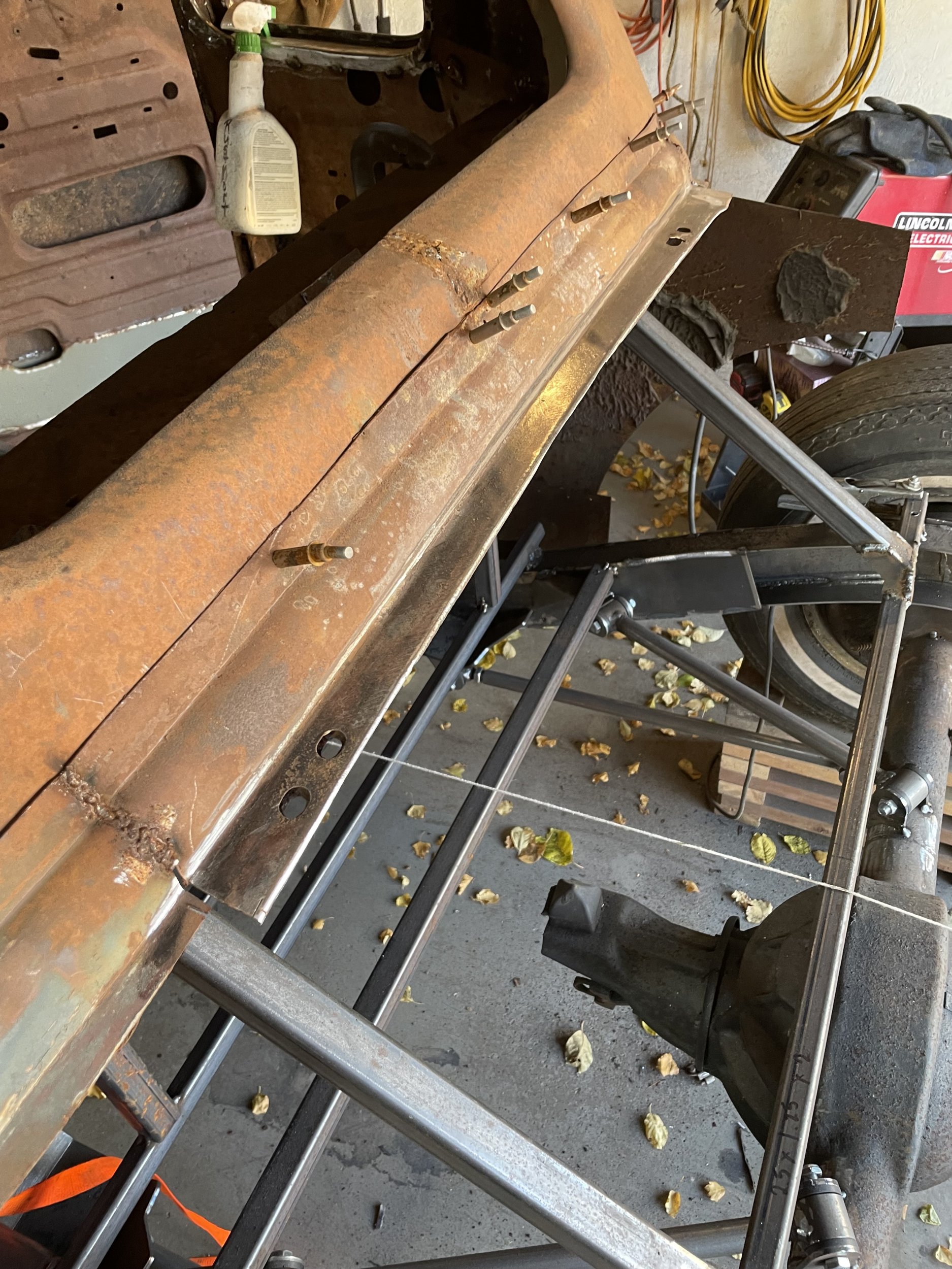

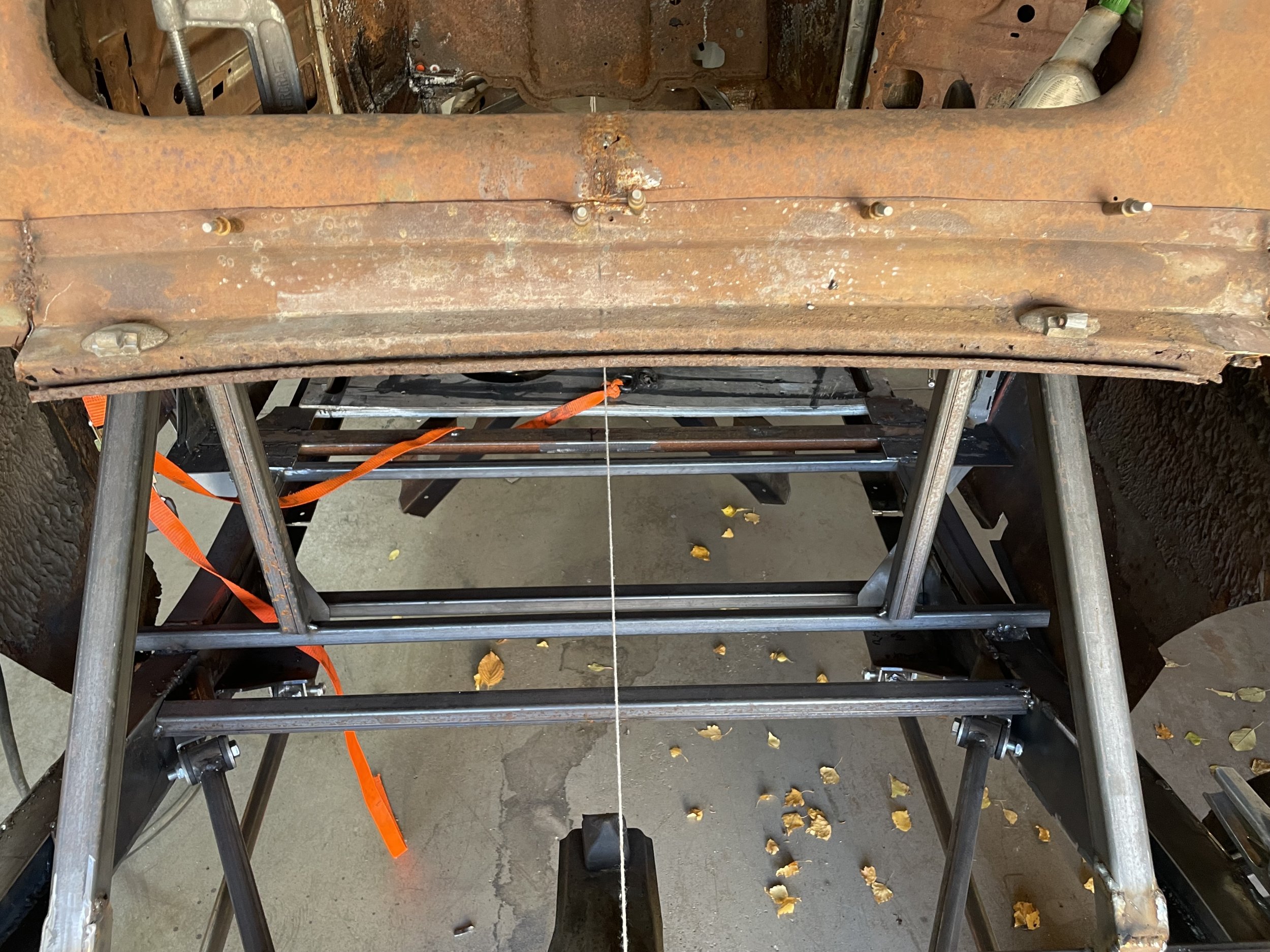

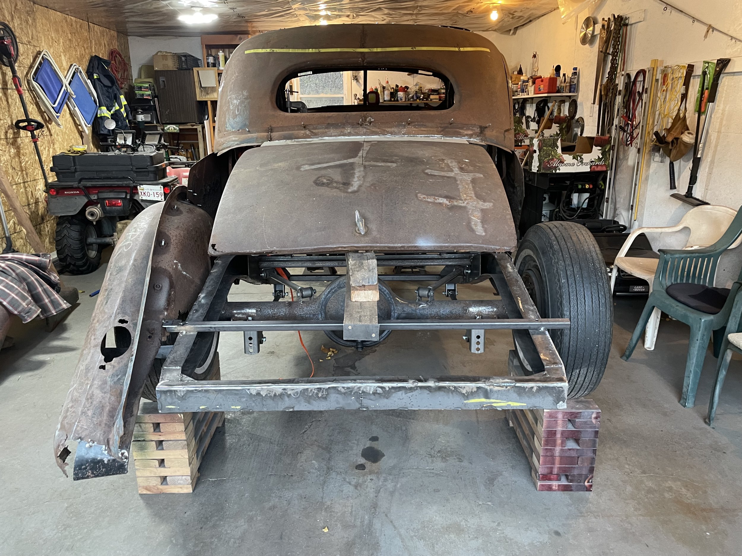

    Was able to get some more work done in the last little bit hard to tell on the pictures as this is all inside the car tying the car all back together. The pillars are tied to the frame built subframe. That’s gonna divide the trunk in the interior compartment, not gonna be built like a 35 looks like inside, but this is a hot rod. It’ll look good but the purist won’t like it. My car my my car my way lol IMG_1216.jpeg IMG_1217.jpeg IMG_1218.jpeg IMG_1220.jpeg IMG_1221.jpeg IMG_1222.jpeg IMG_1216.jpeg IMG_1216.jpeg

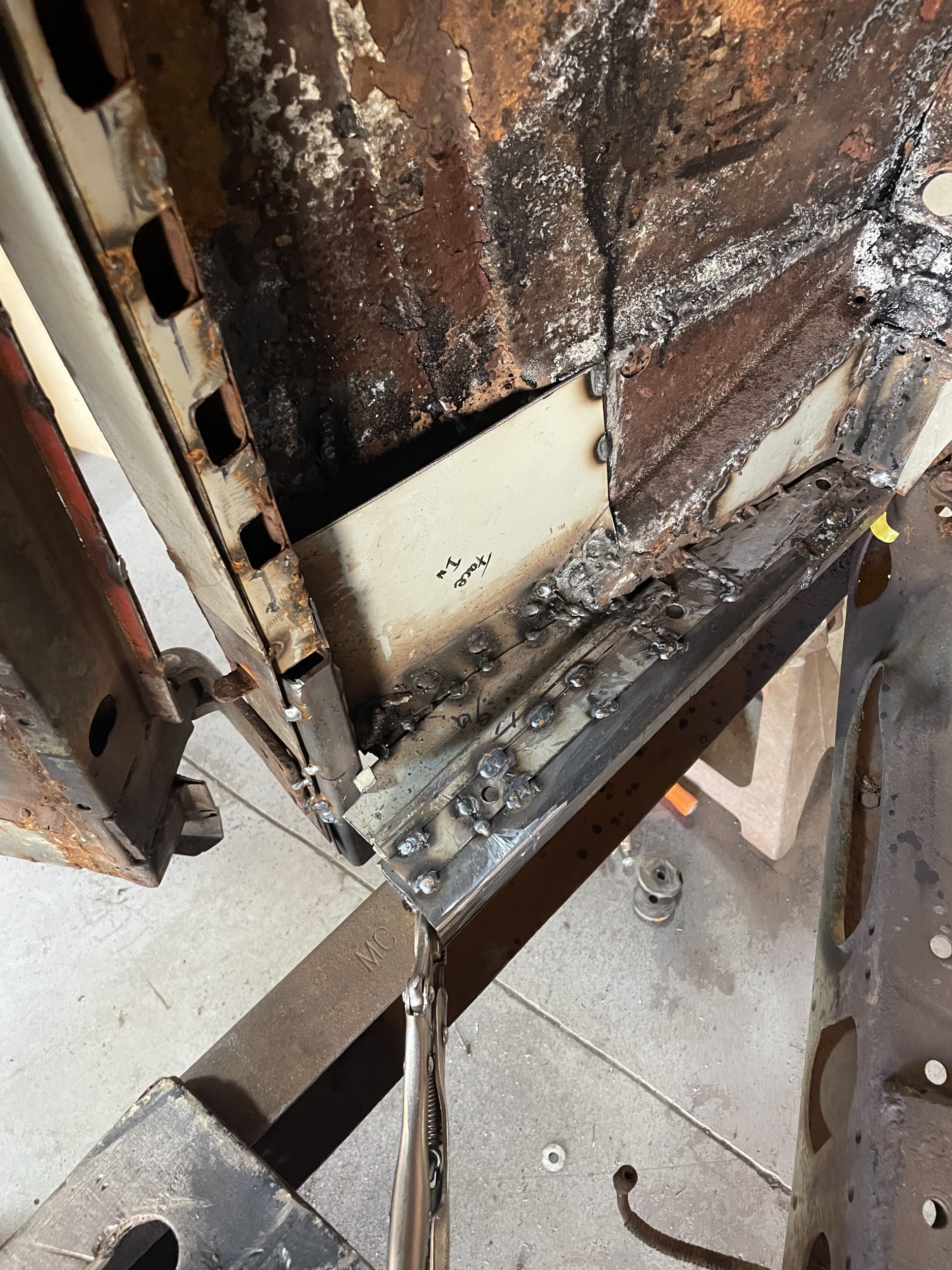

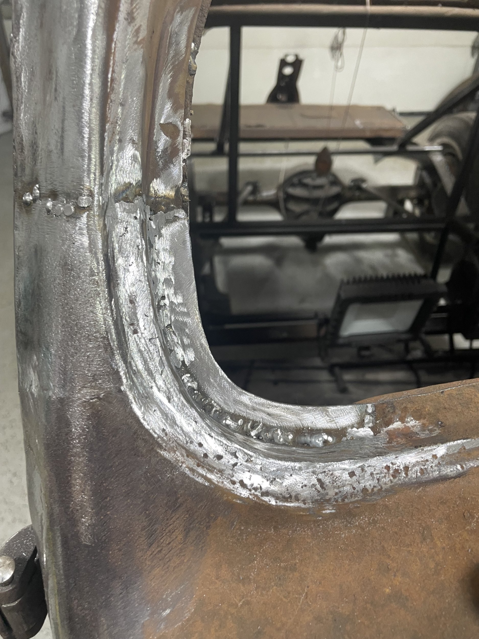

    Out with the old ****py a pillar metal in with new 16gauge . A pillar is very stout now IMG_1223.jpeg IMG_1226.jpeg IMG_1227.jpeg

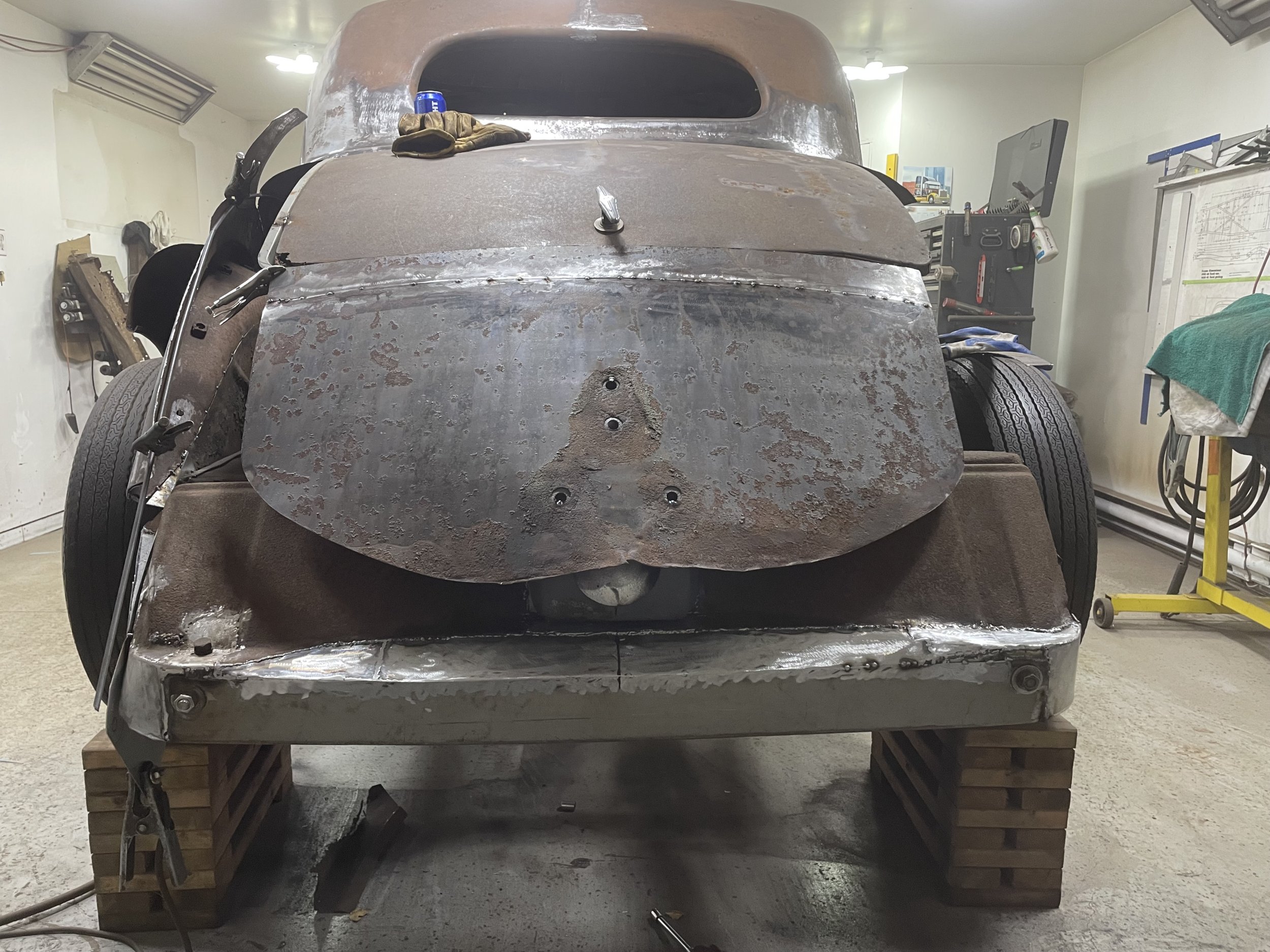

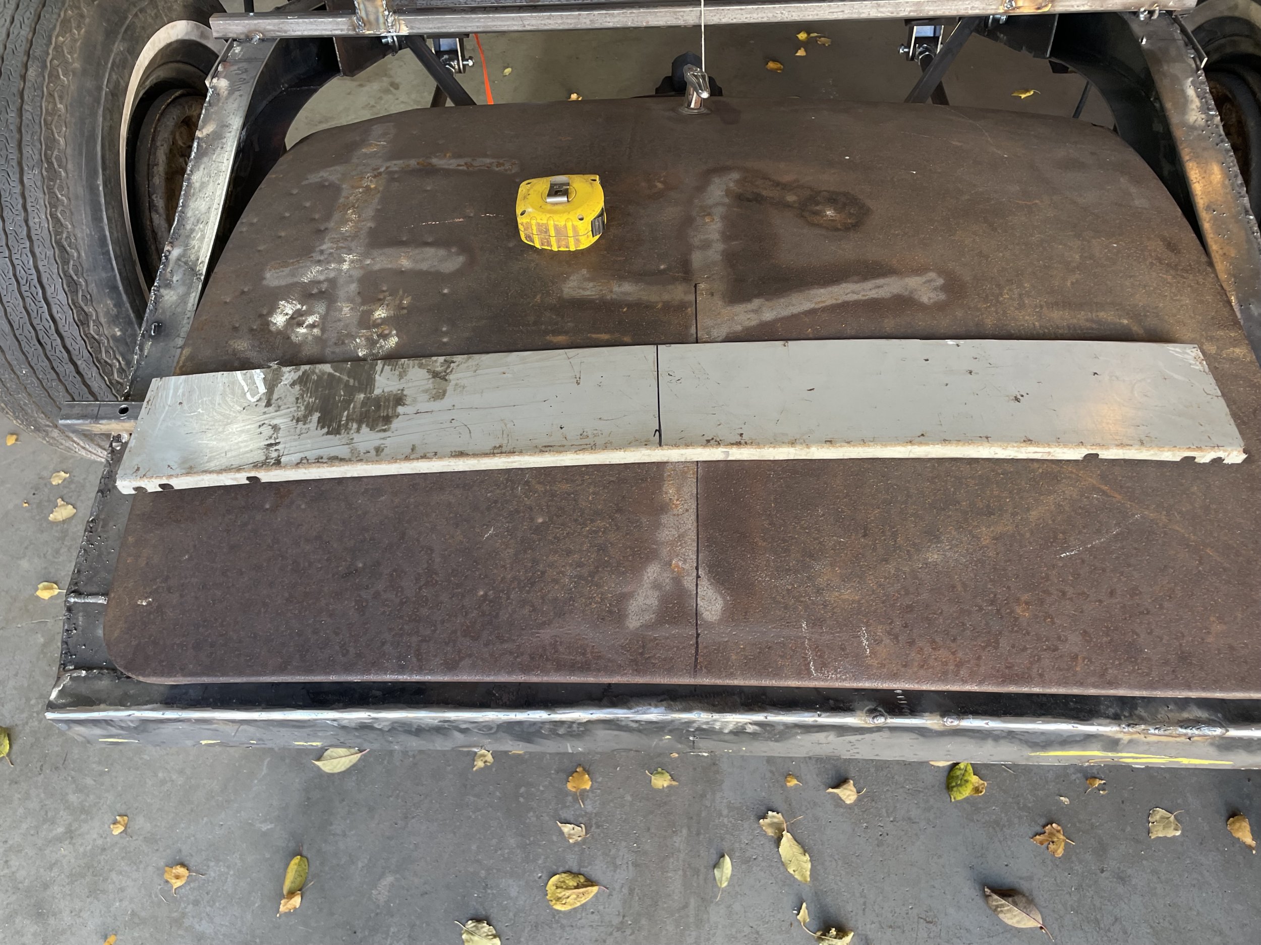

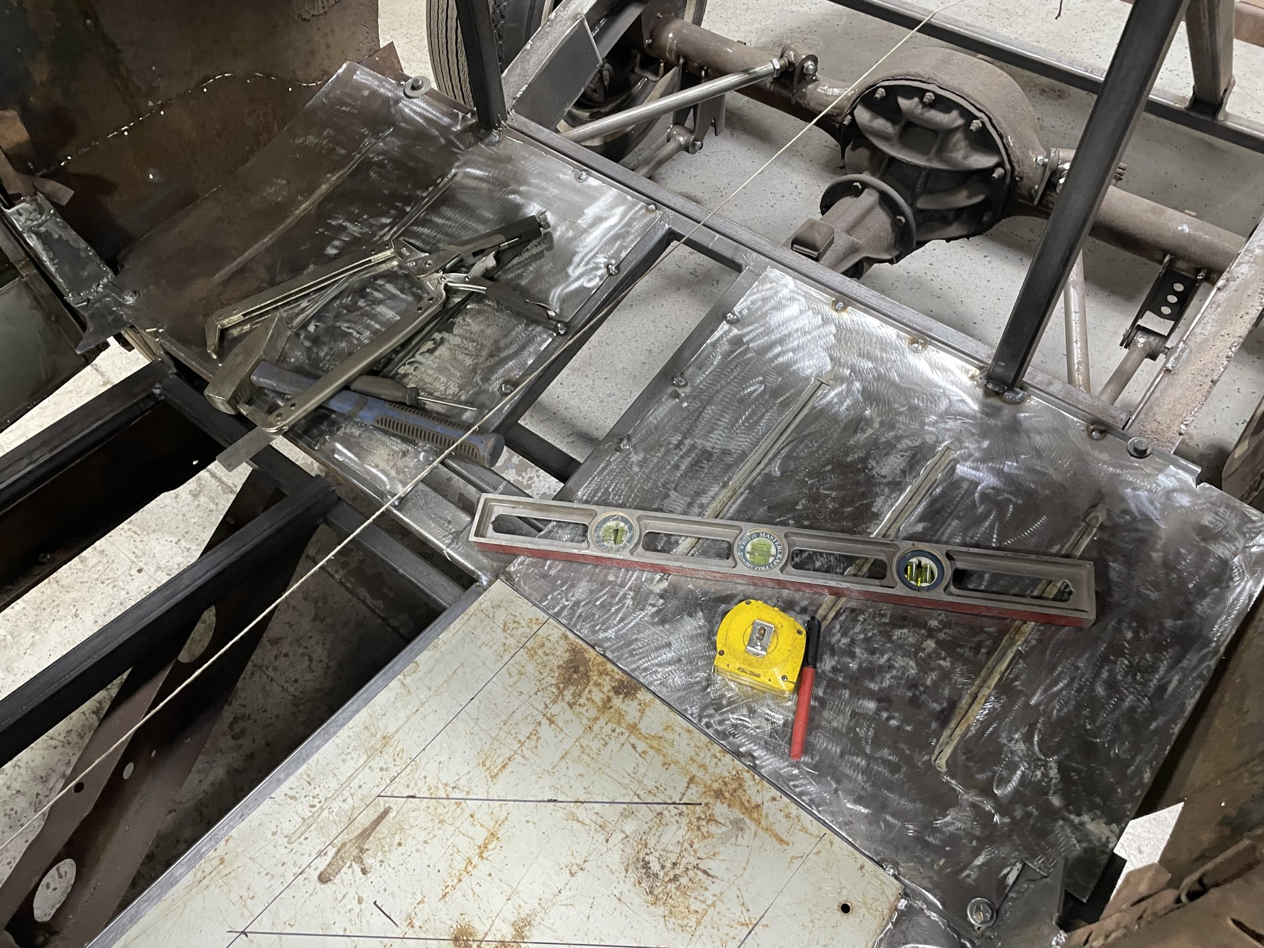

    IMG_1229.jpeg IMG_1230.jpeg IMG_1231.jpeg IMG_1232.jpeg IMG_1236.jpeg IMG_1233.jpeg Mocked up and built the rear catwalk area . Mocked up the trunk lid for inspiration and motivation. Onto something.

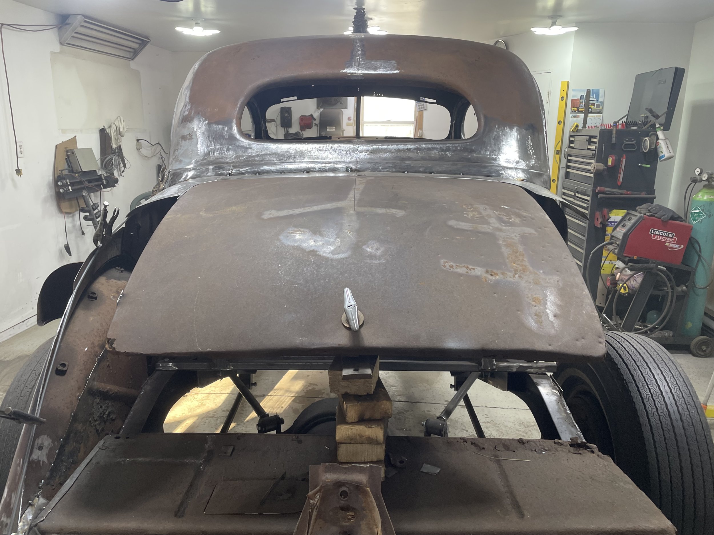

    aw1950
    More mock up today , staring to look in the right direction

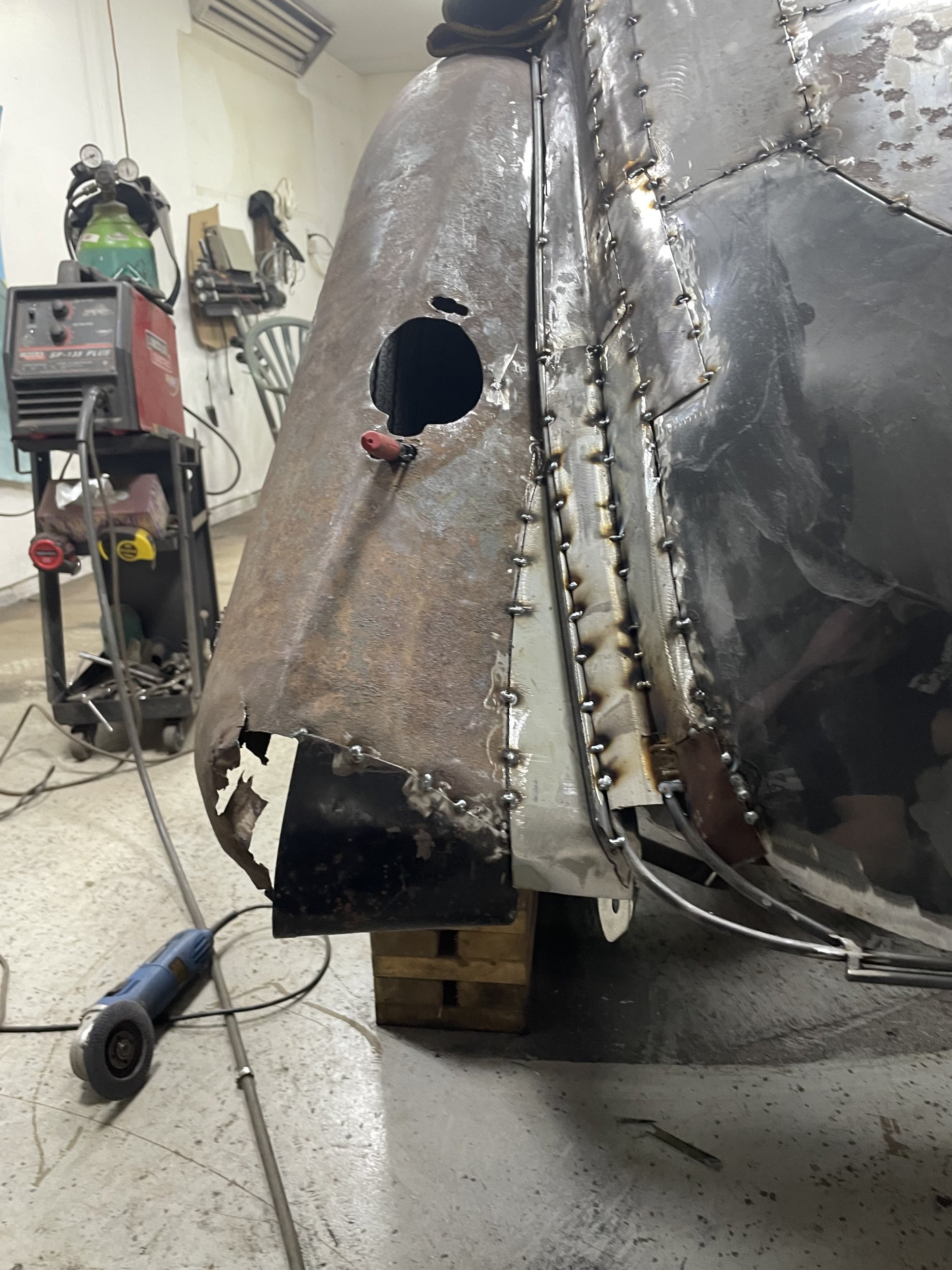

    Posts: 1,511
    aw1950

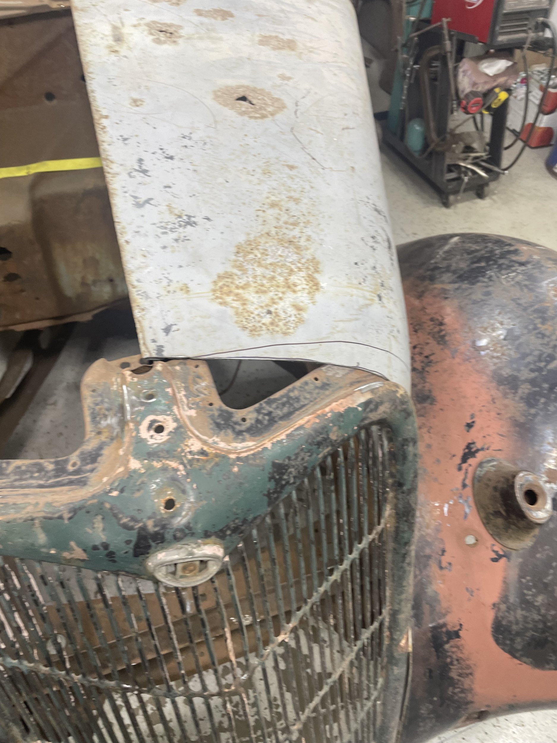

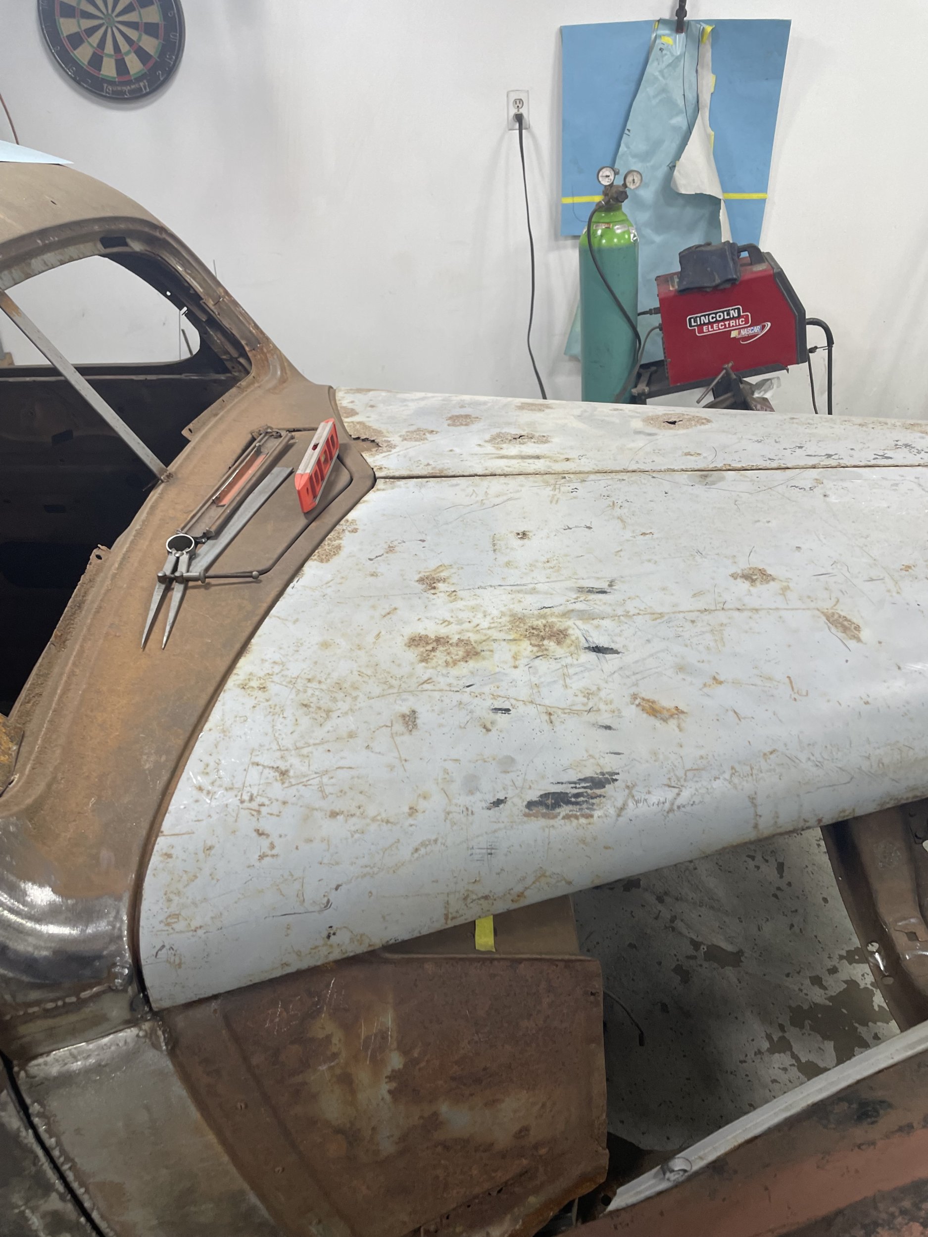

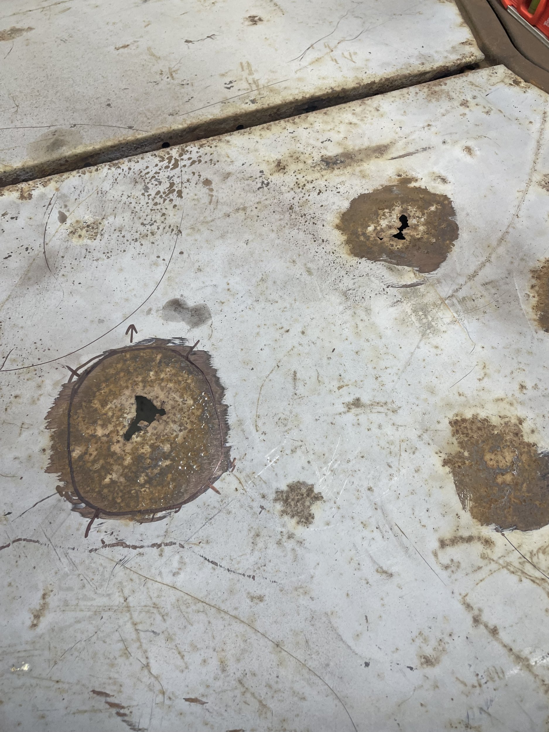

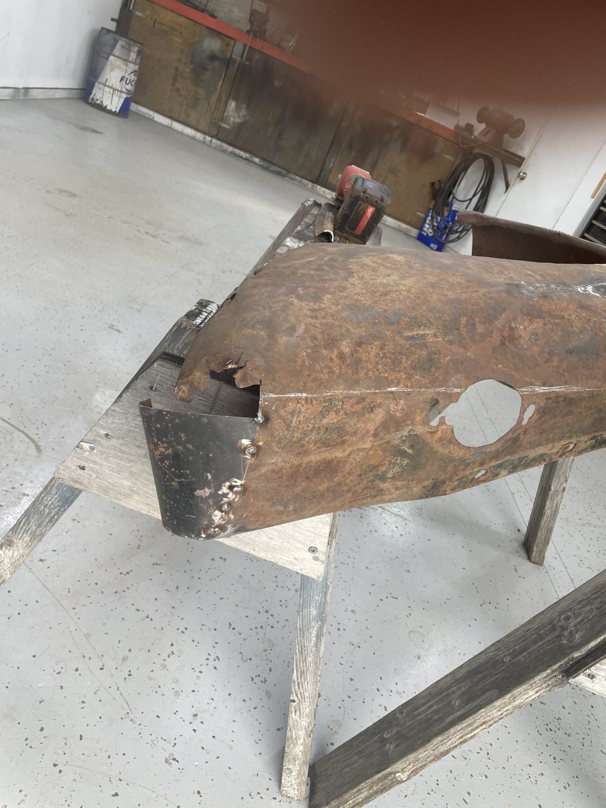

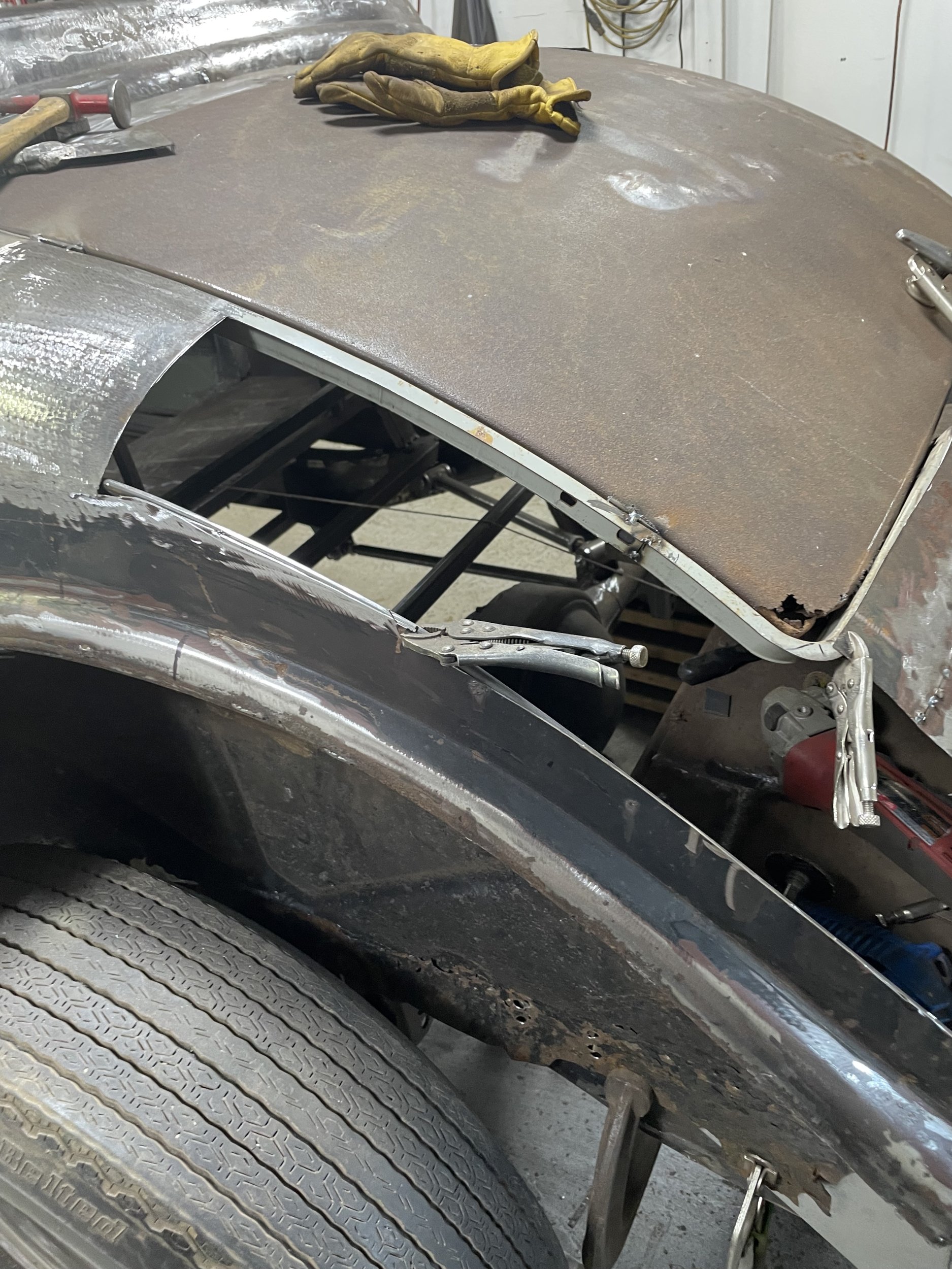

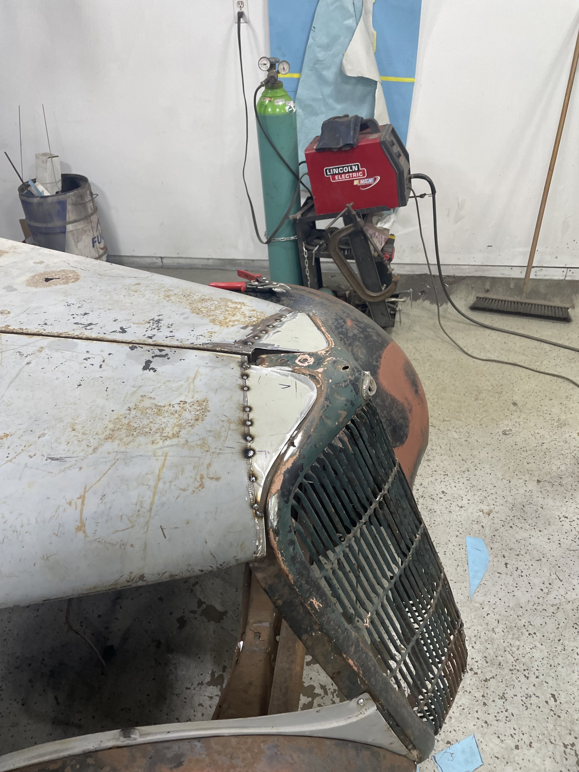

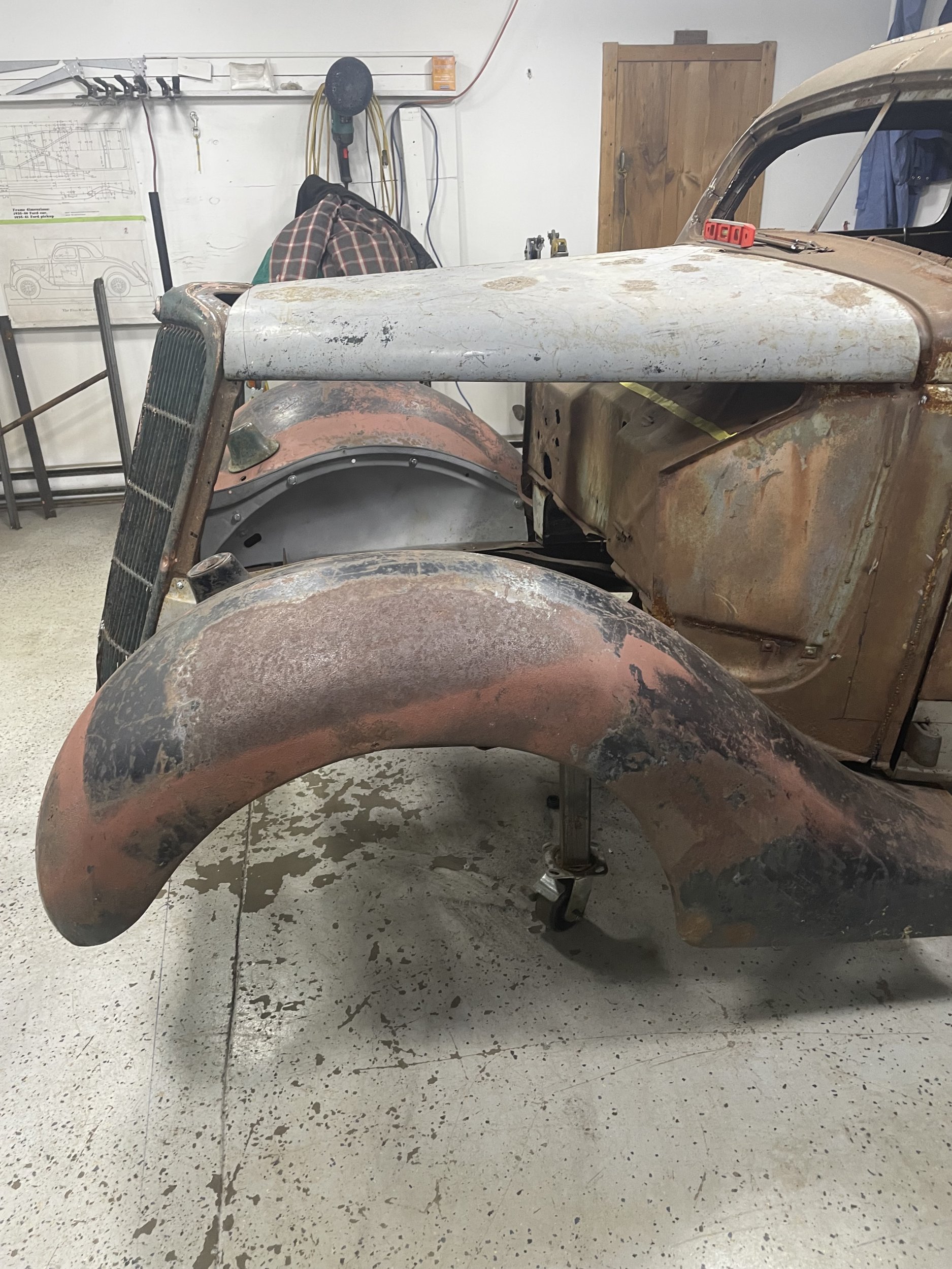

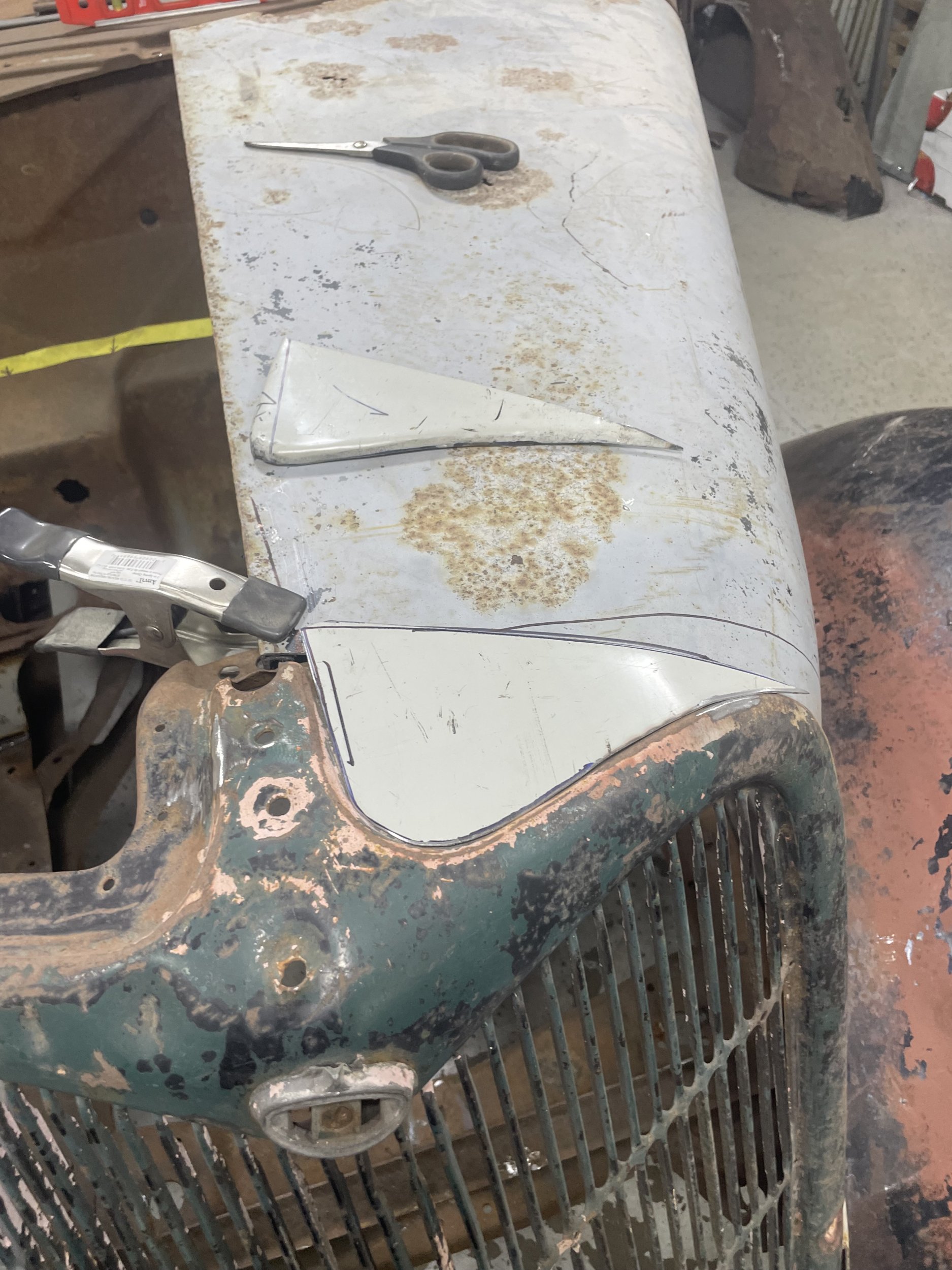

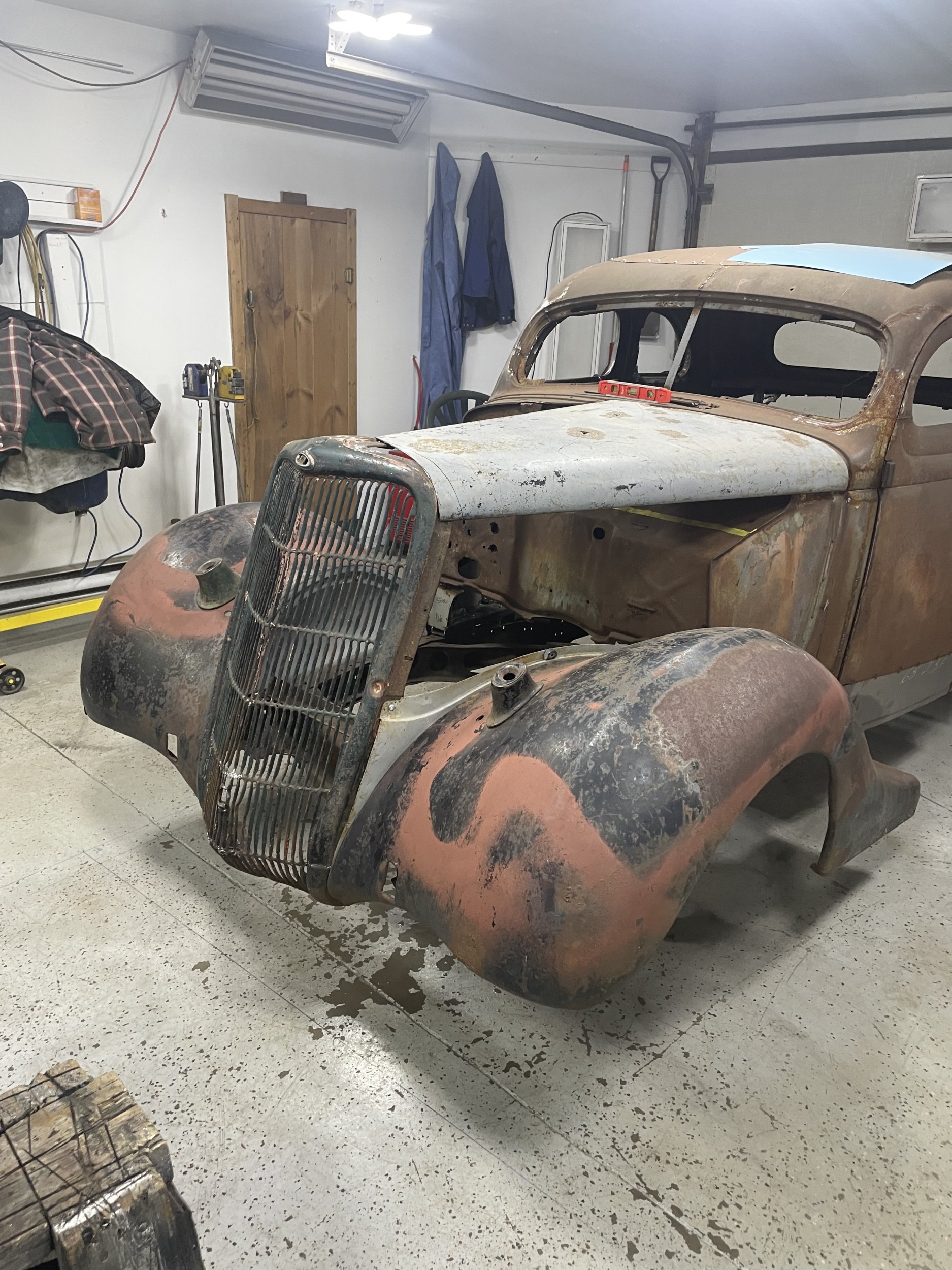

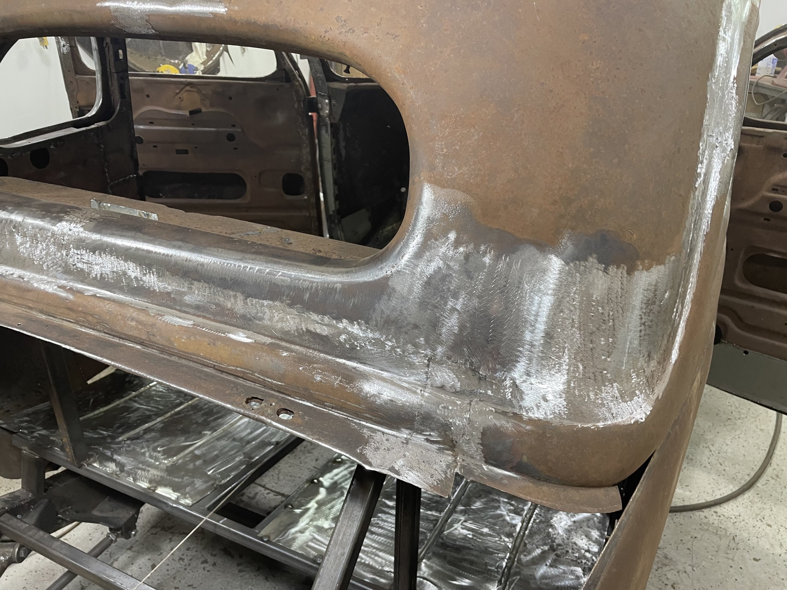

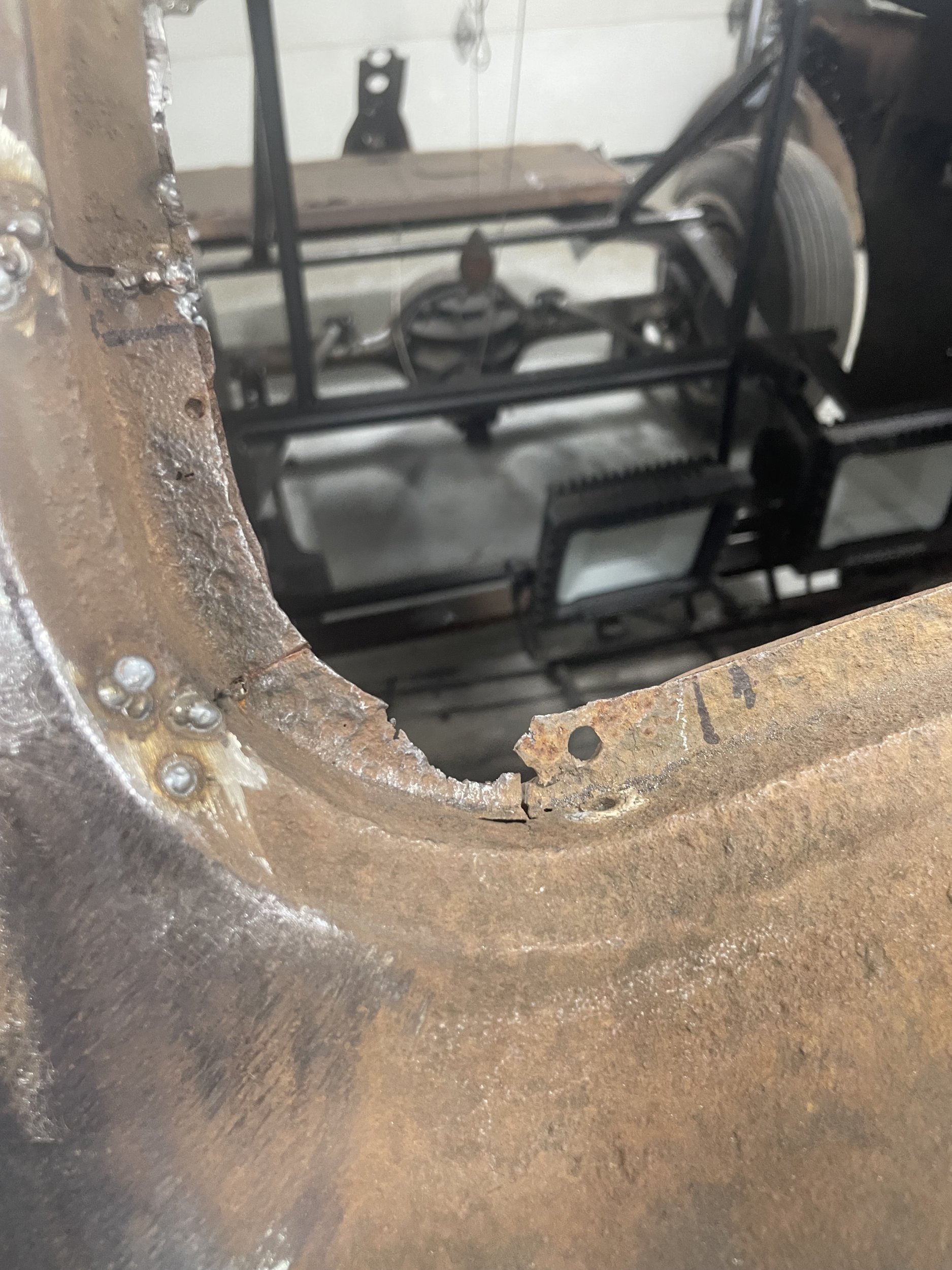

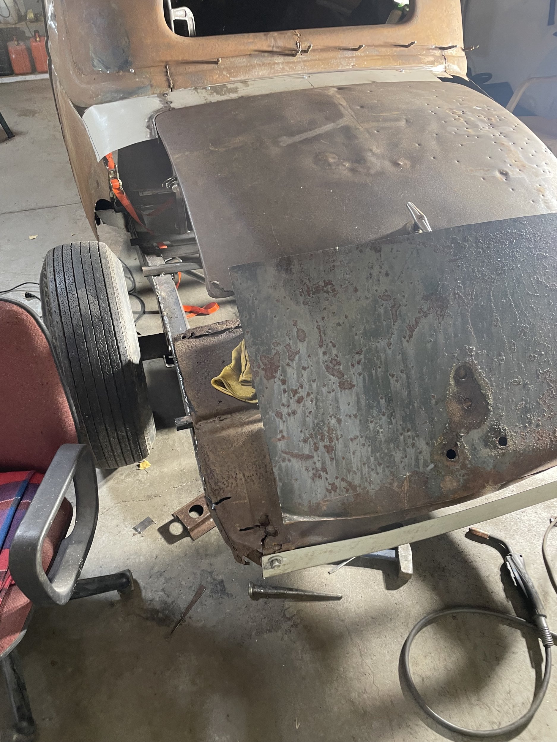

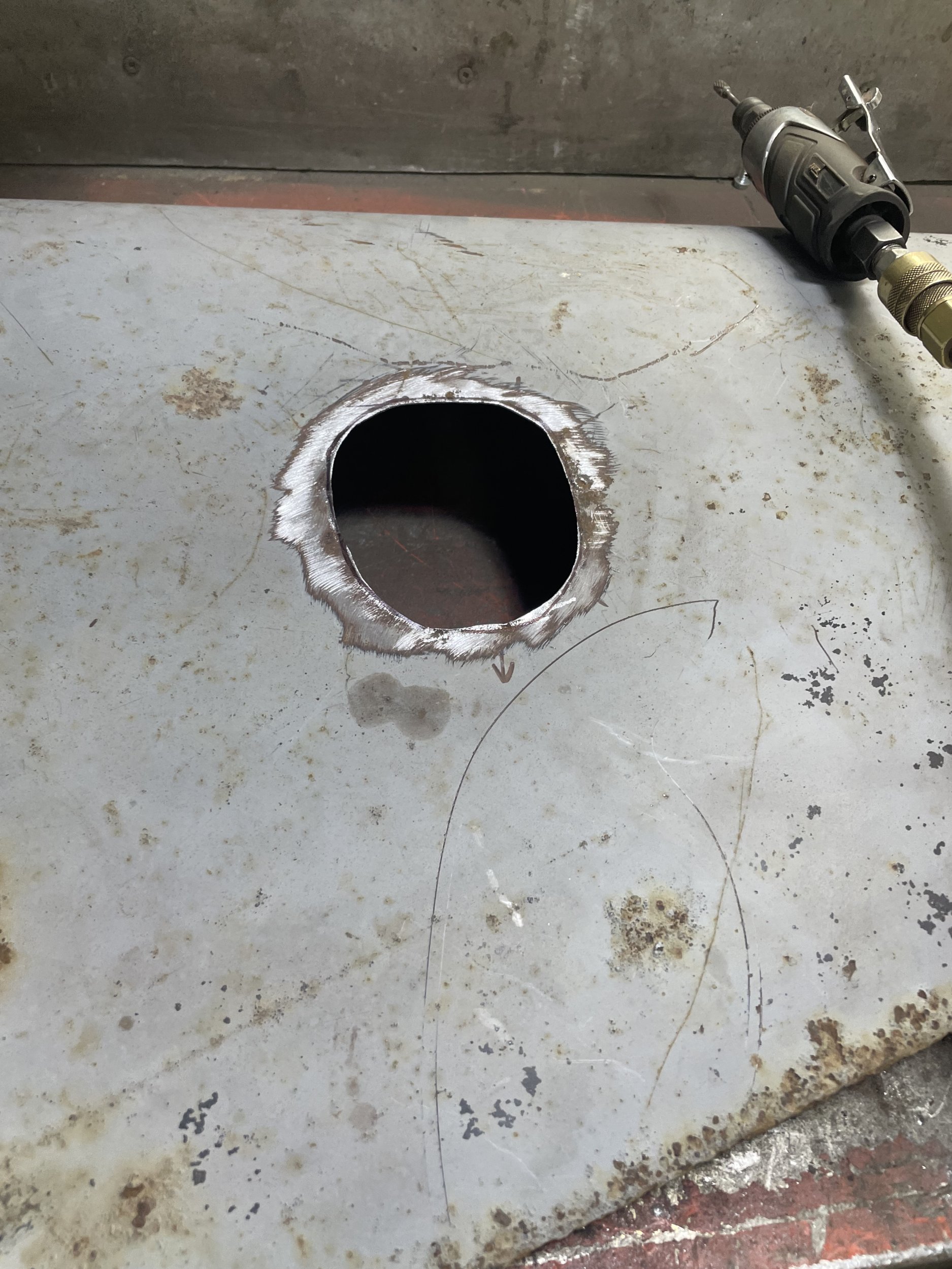

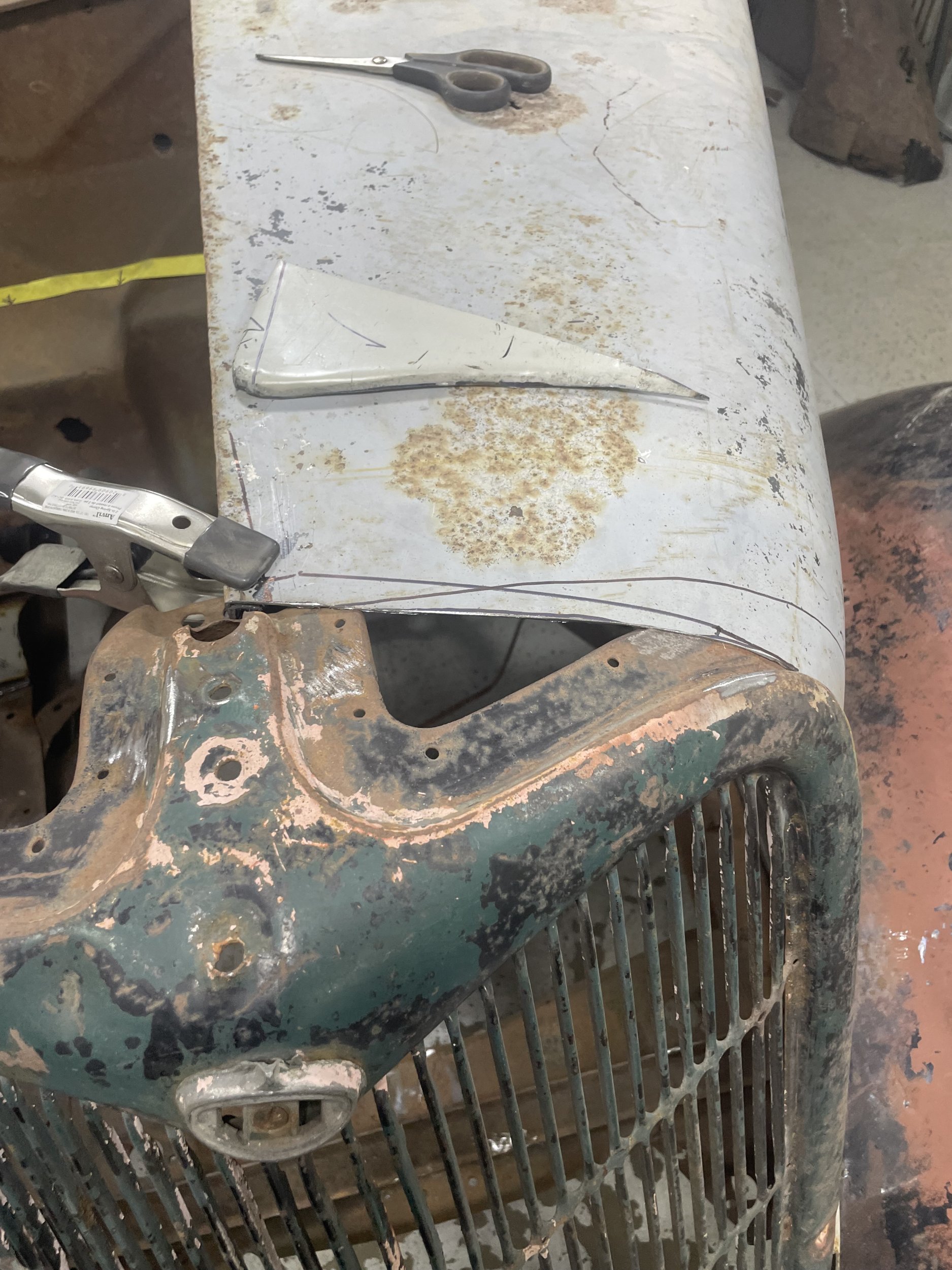

    More done , had to cut down two halves of a 36 hood . Modified to fit the 35 design rad support . There is a hole in the picture first one of two . They are both filled now plus I had to replace about 10 inches of the hood at the back to cowl area . Nice solid hood otherwise . Other pic is a repair on the window opening p***enger side windshield. IMG_1362.jpeg IMG_1363.jpeg IMG_1360.jpeg IMG_1361.jpeg IMG_1362.jpeg IMG_1363.jpeg IMG_1364.jpeg IMG_1365.jpeg IMG_1366.jpeg IMG_1367.jpeg

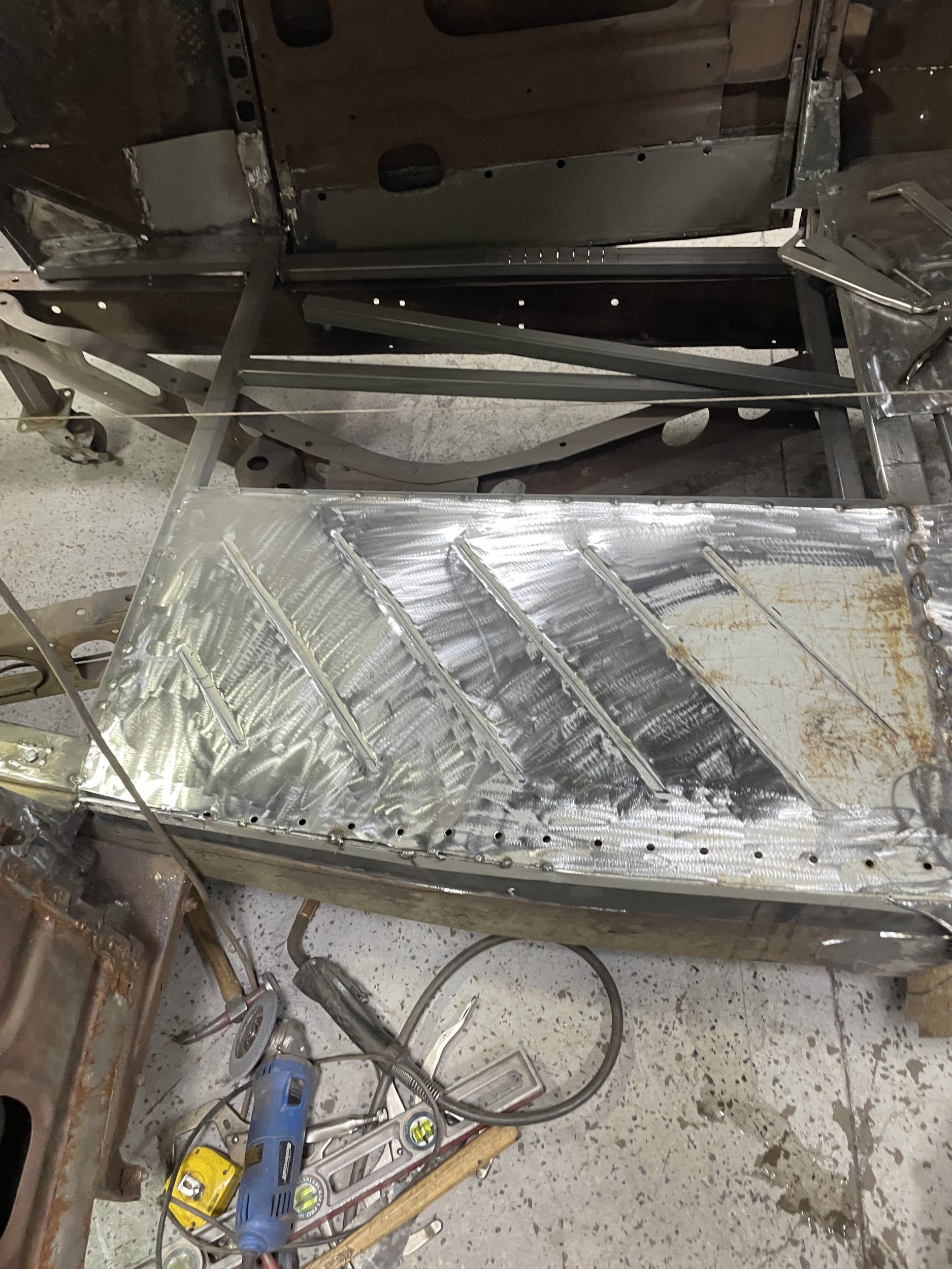

    aw1950

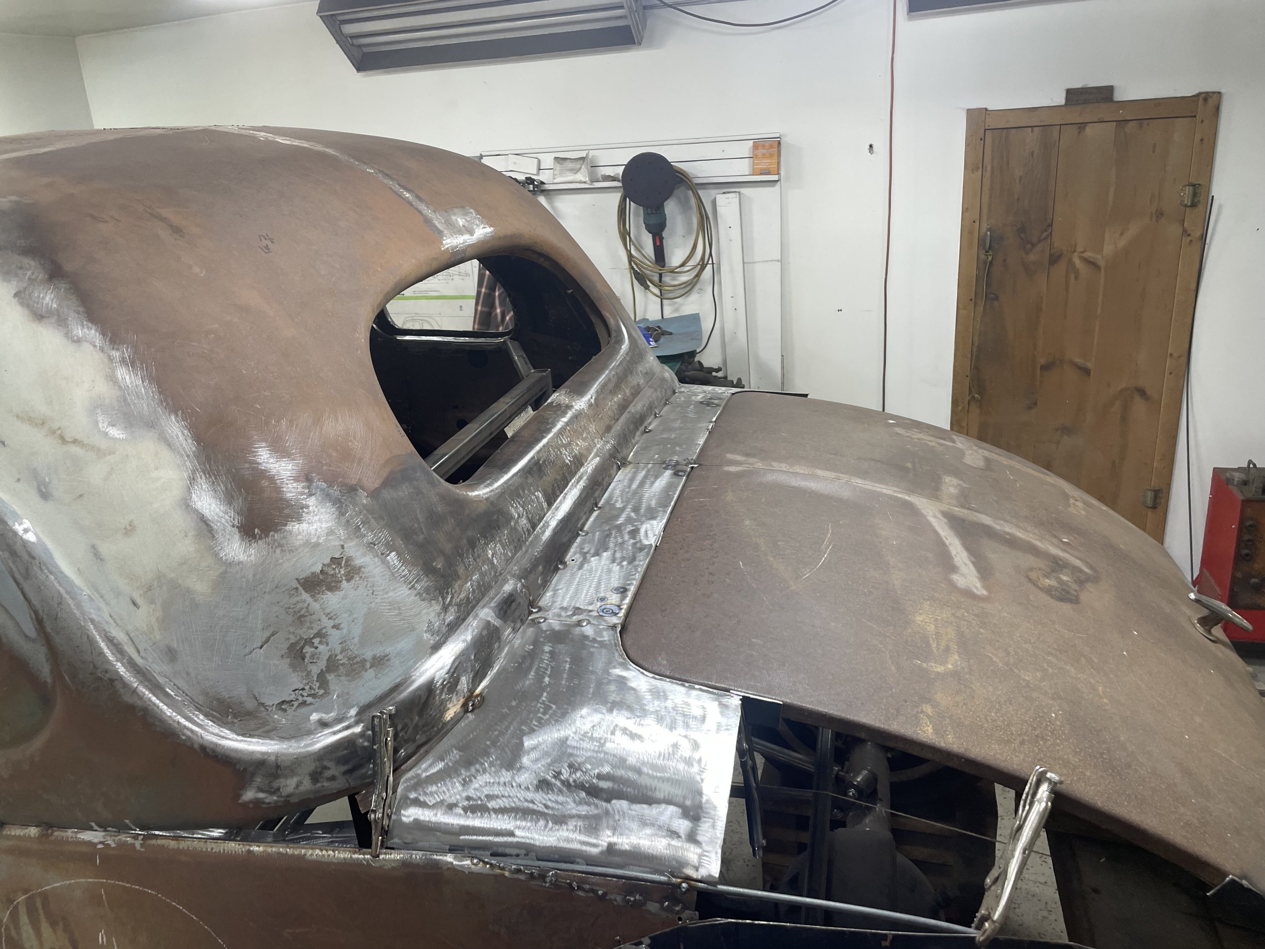

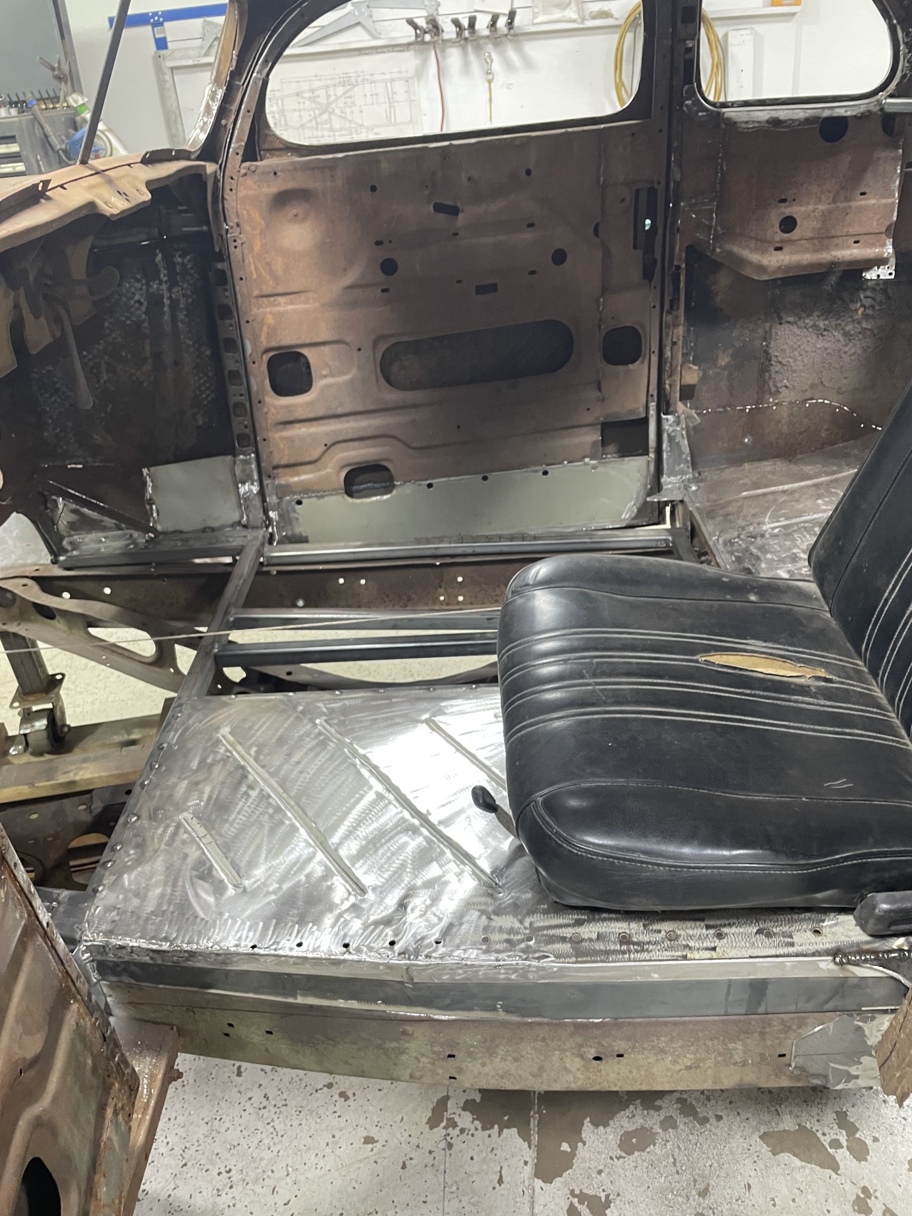

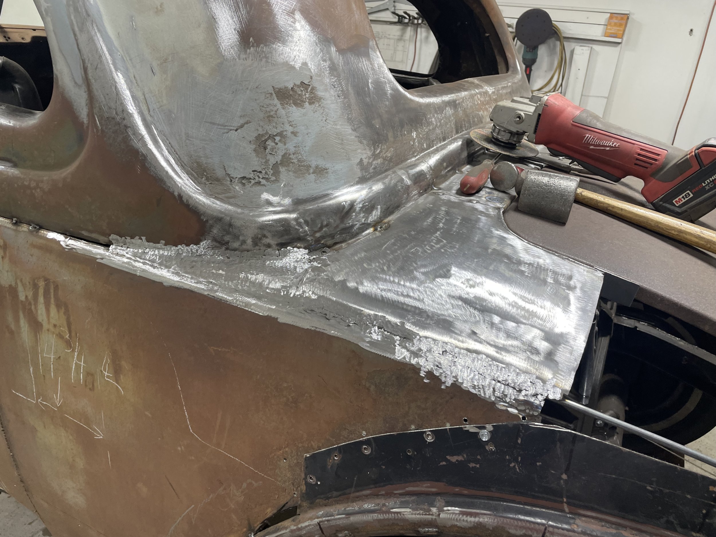

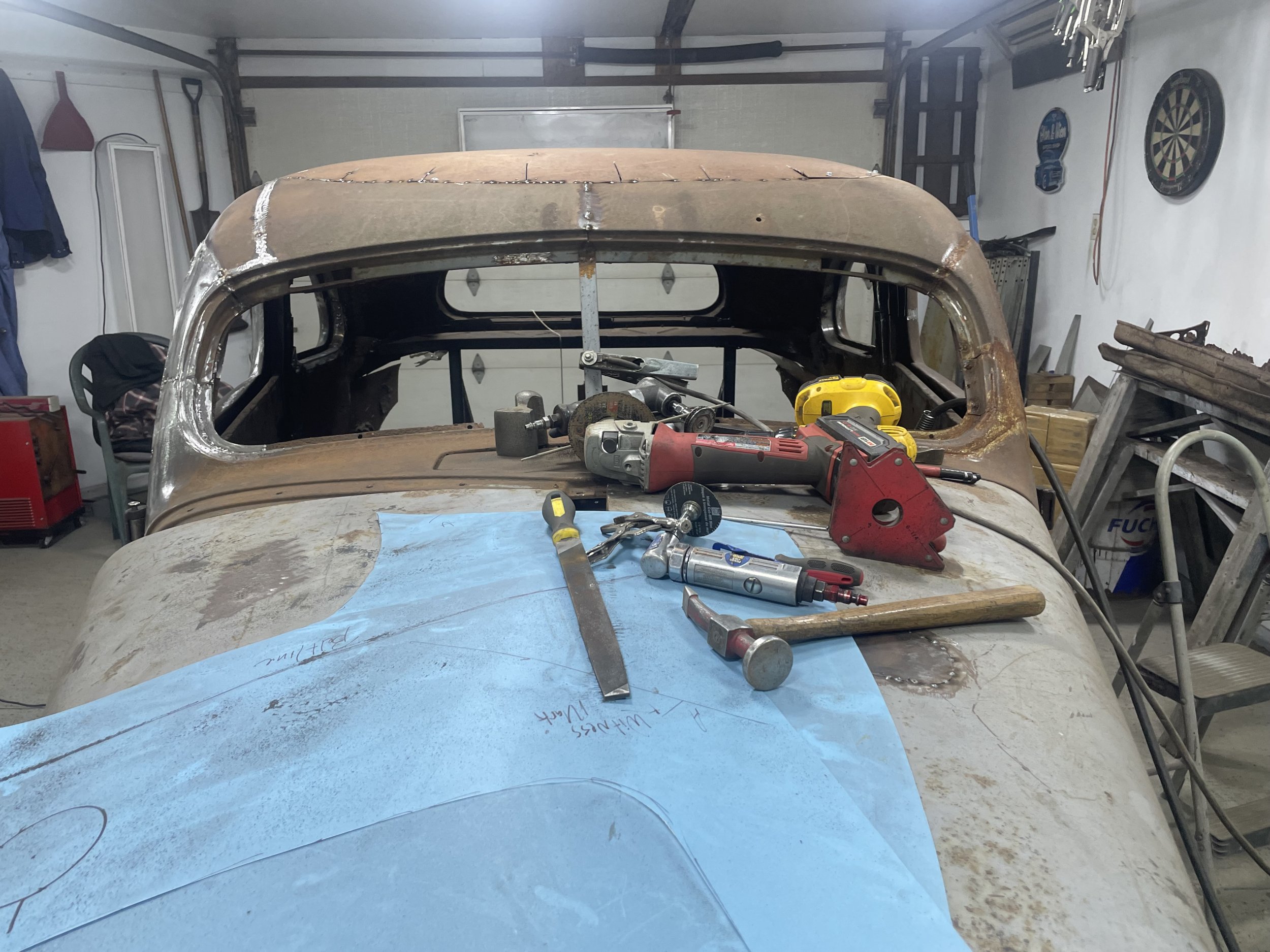

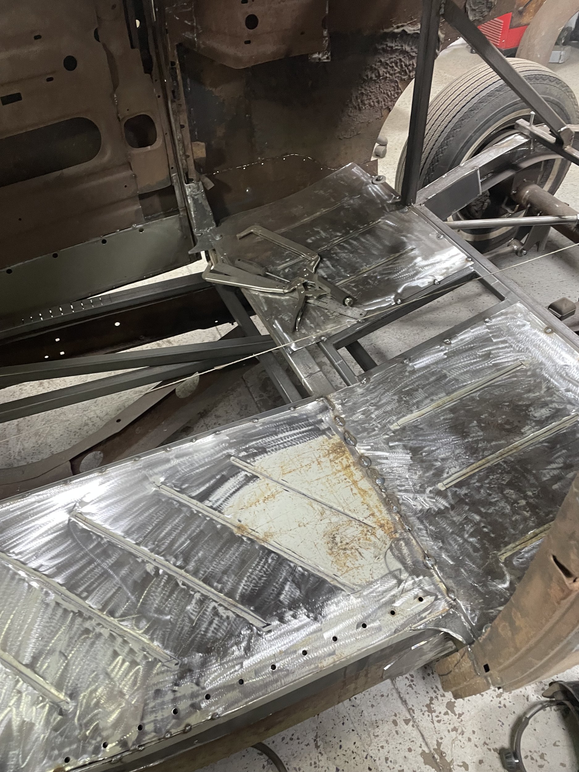

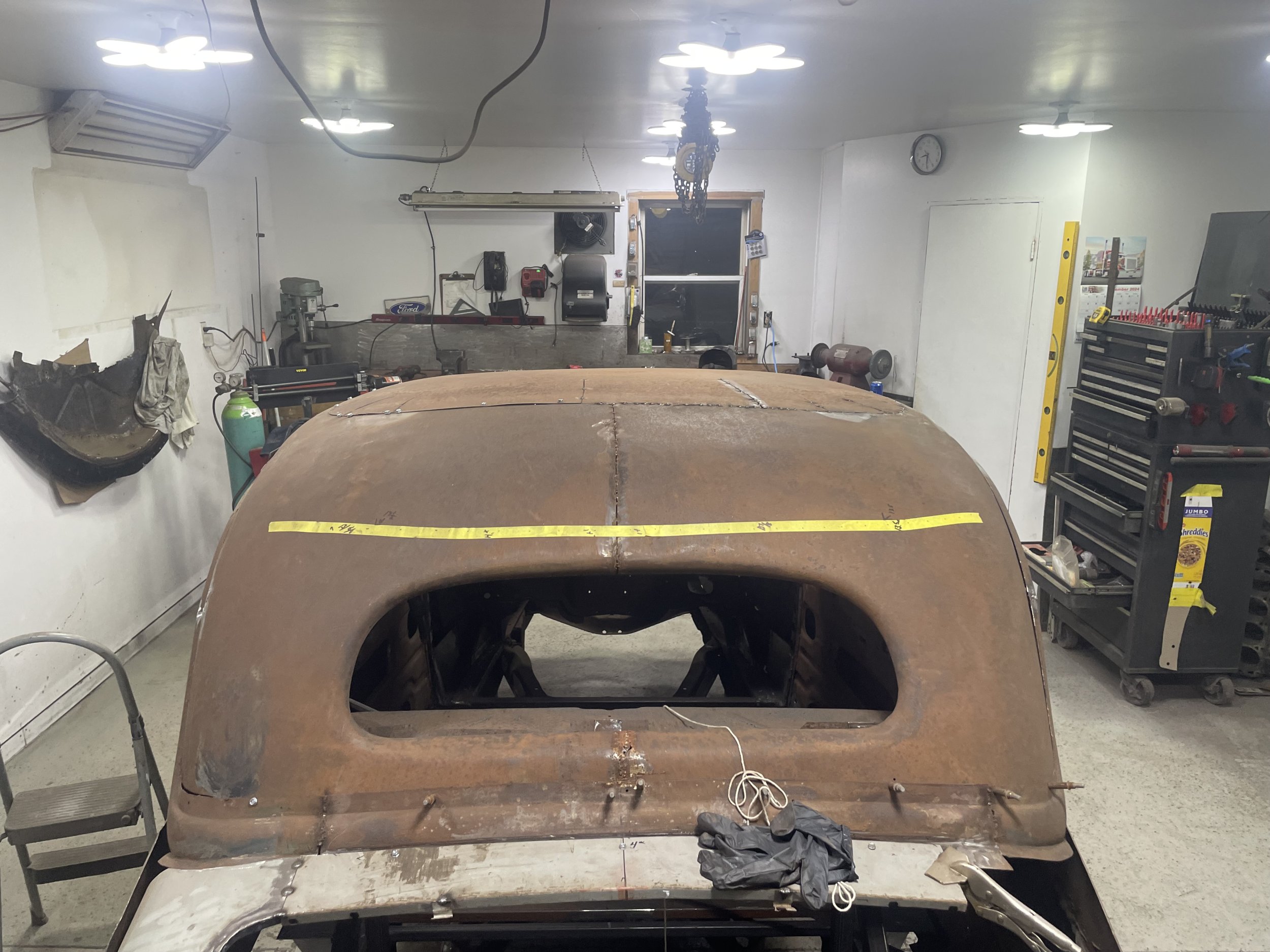

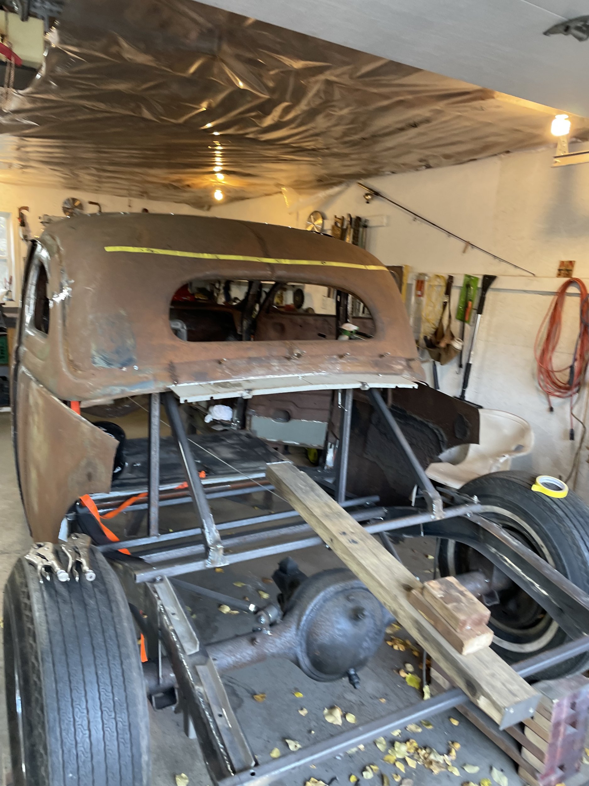

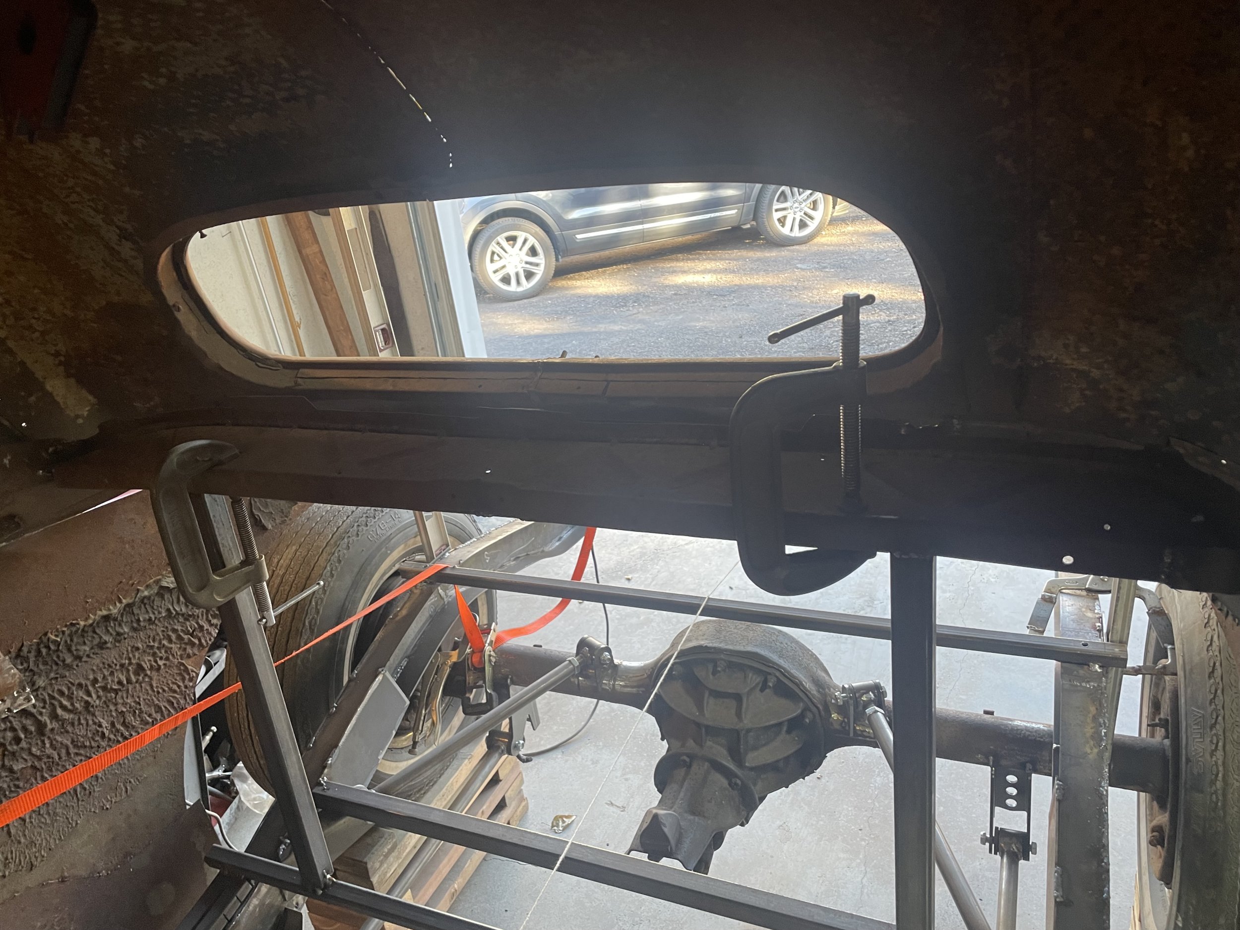

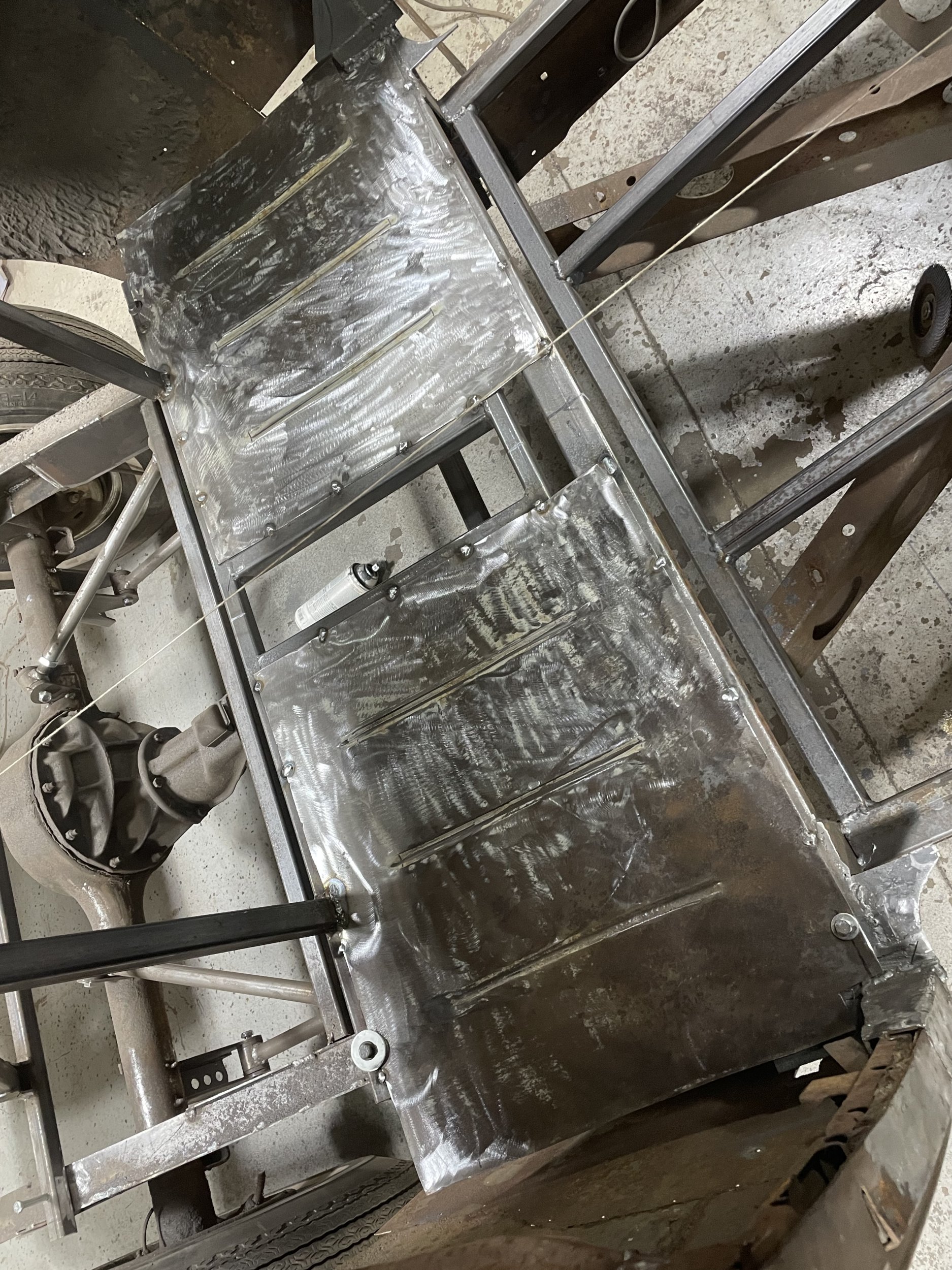

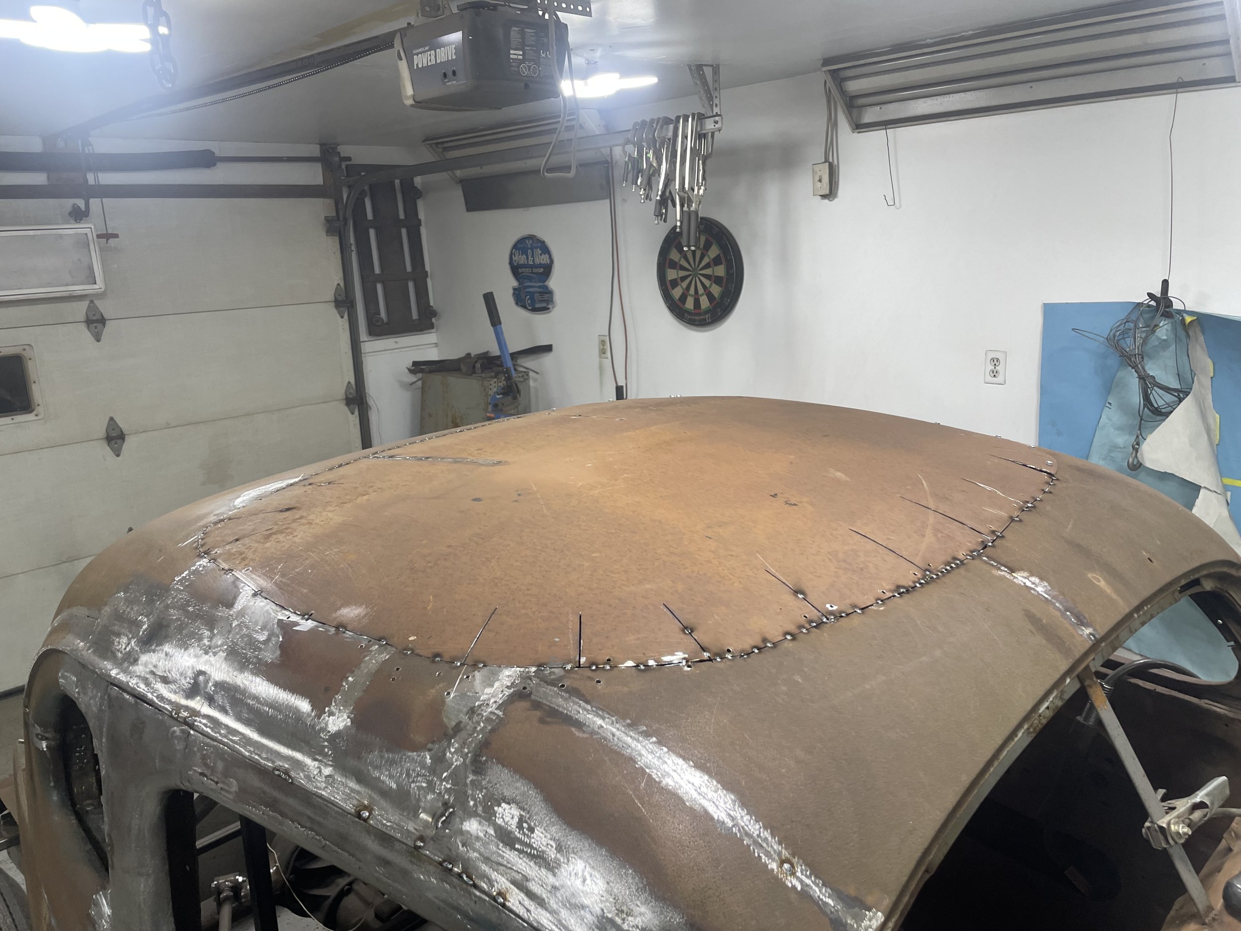

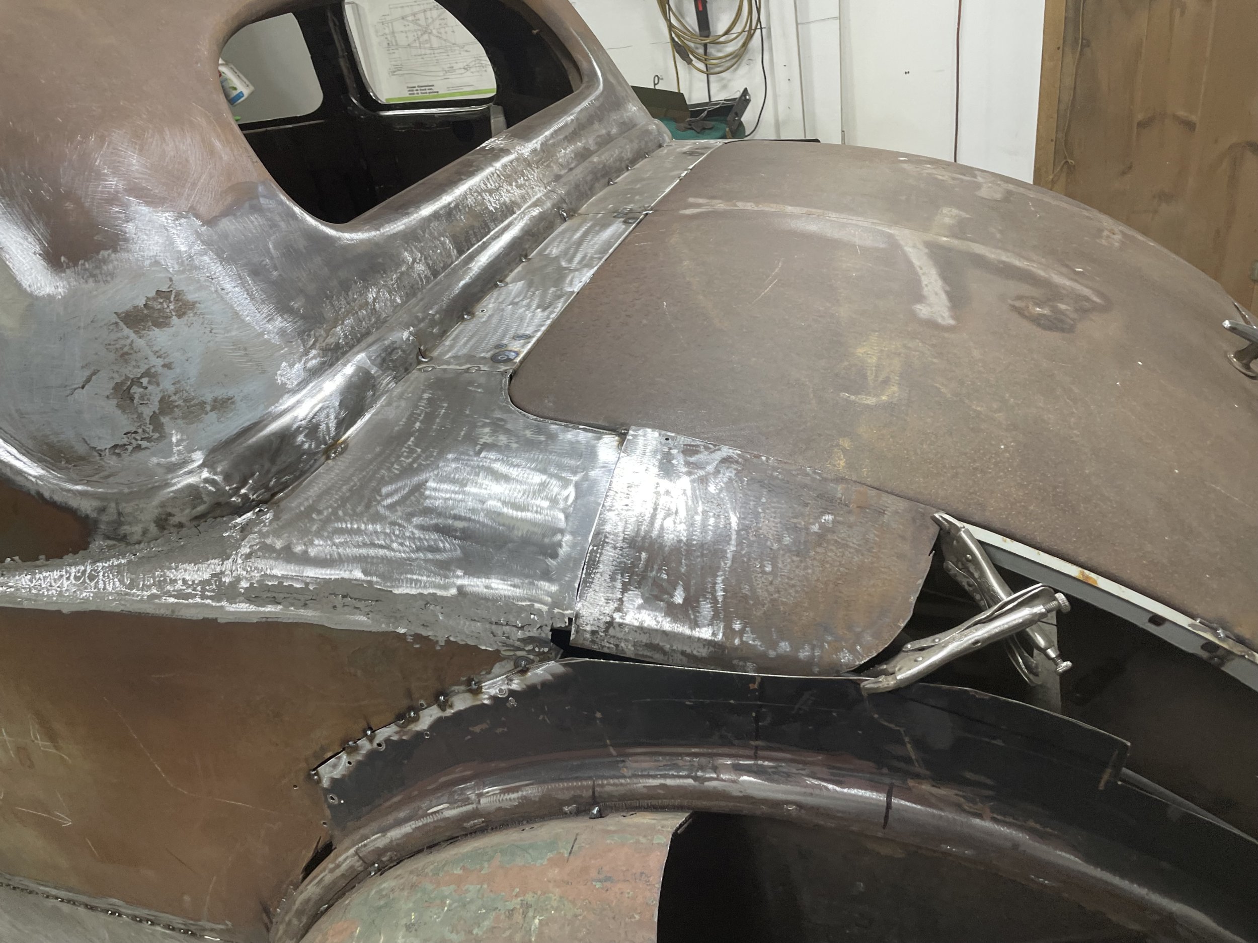

    Been busy , roof filler as all welded in and ground . The whole top is now all welded up after the chop . Made up some floor pans and currently in process of installing . Have a look !

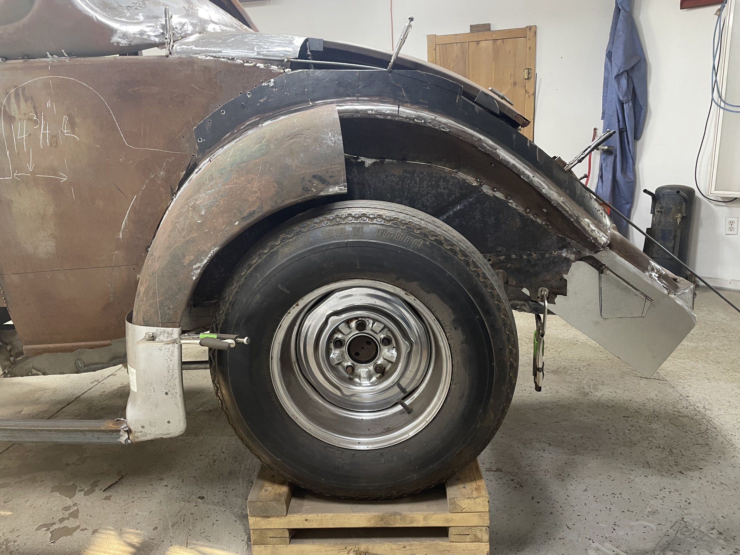

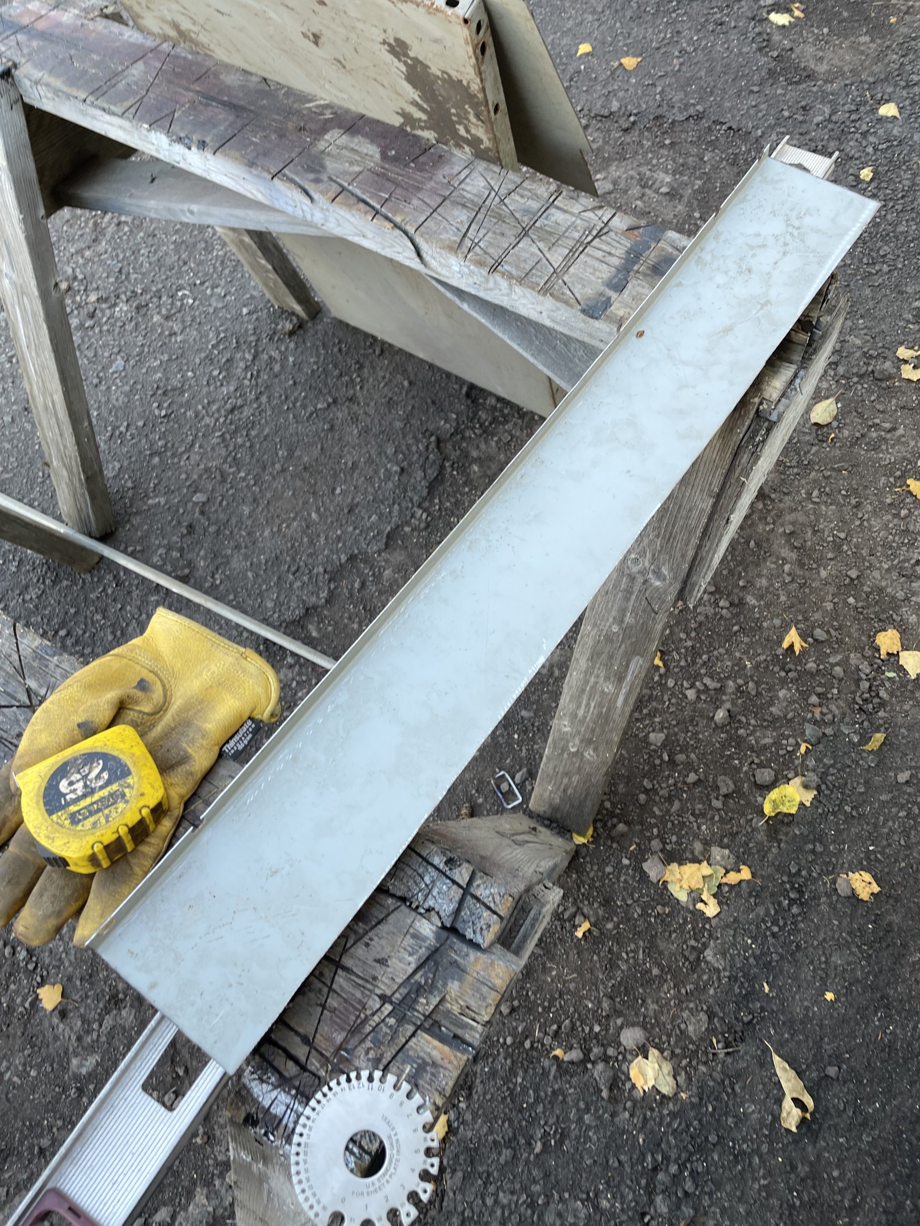

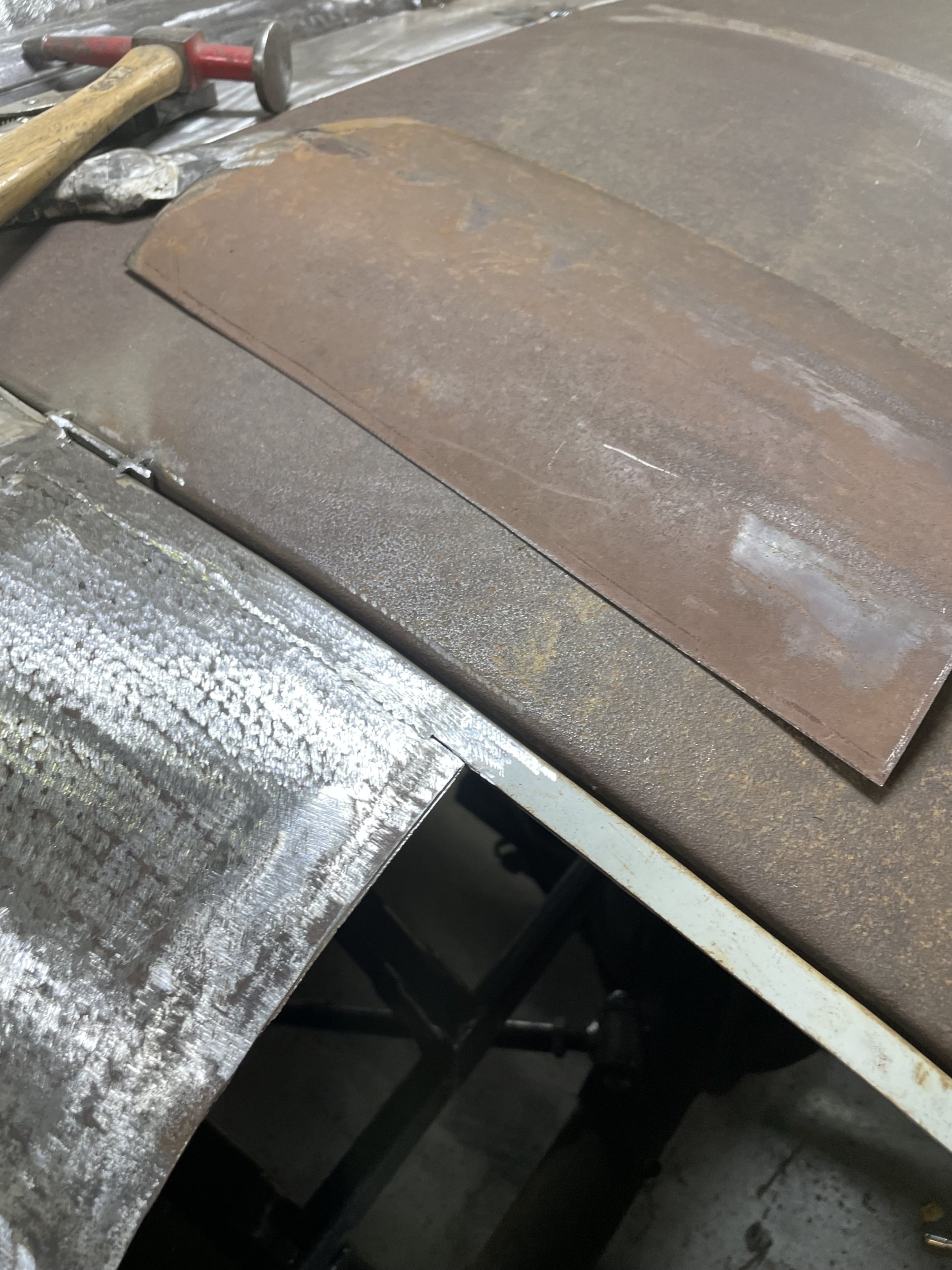

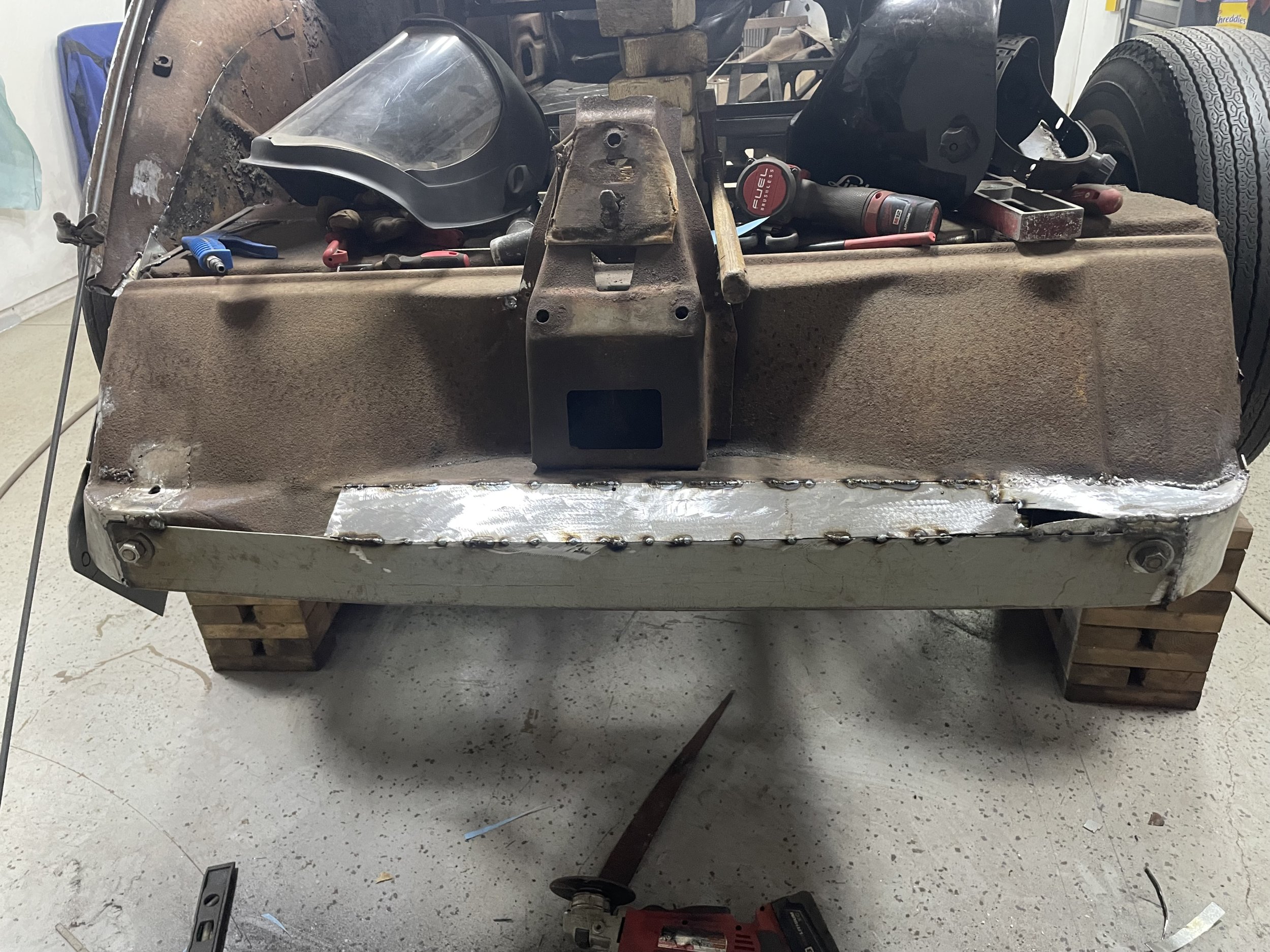

    More updates , starting to mock up running board rear fender and rear apron repair before panel placement
    Squablow and Hot Rod Ron like this.
  24. aw1950
    Joined: Dec 21, 2008
    Posts: 1,511

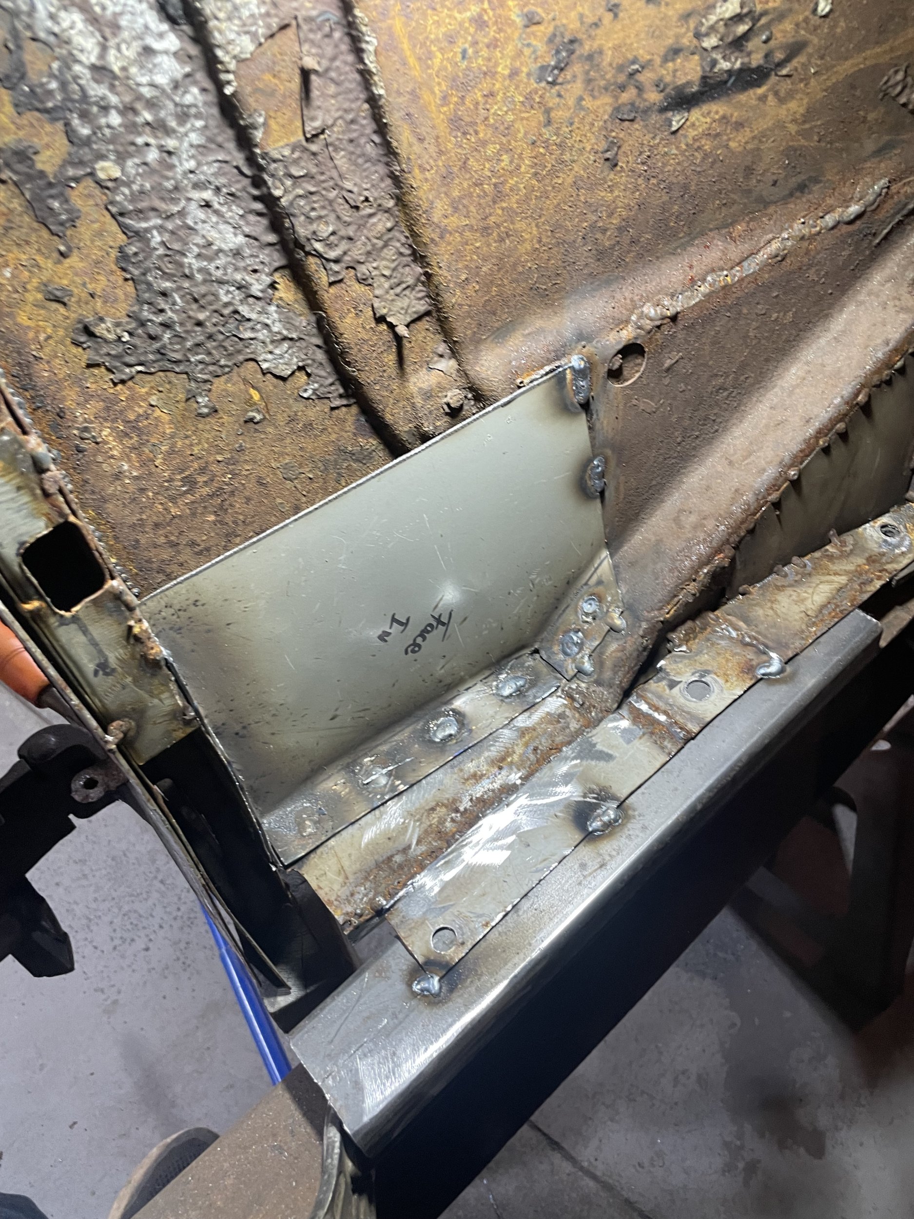

    aw1950

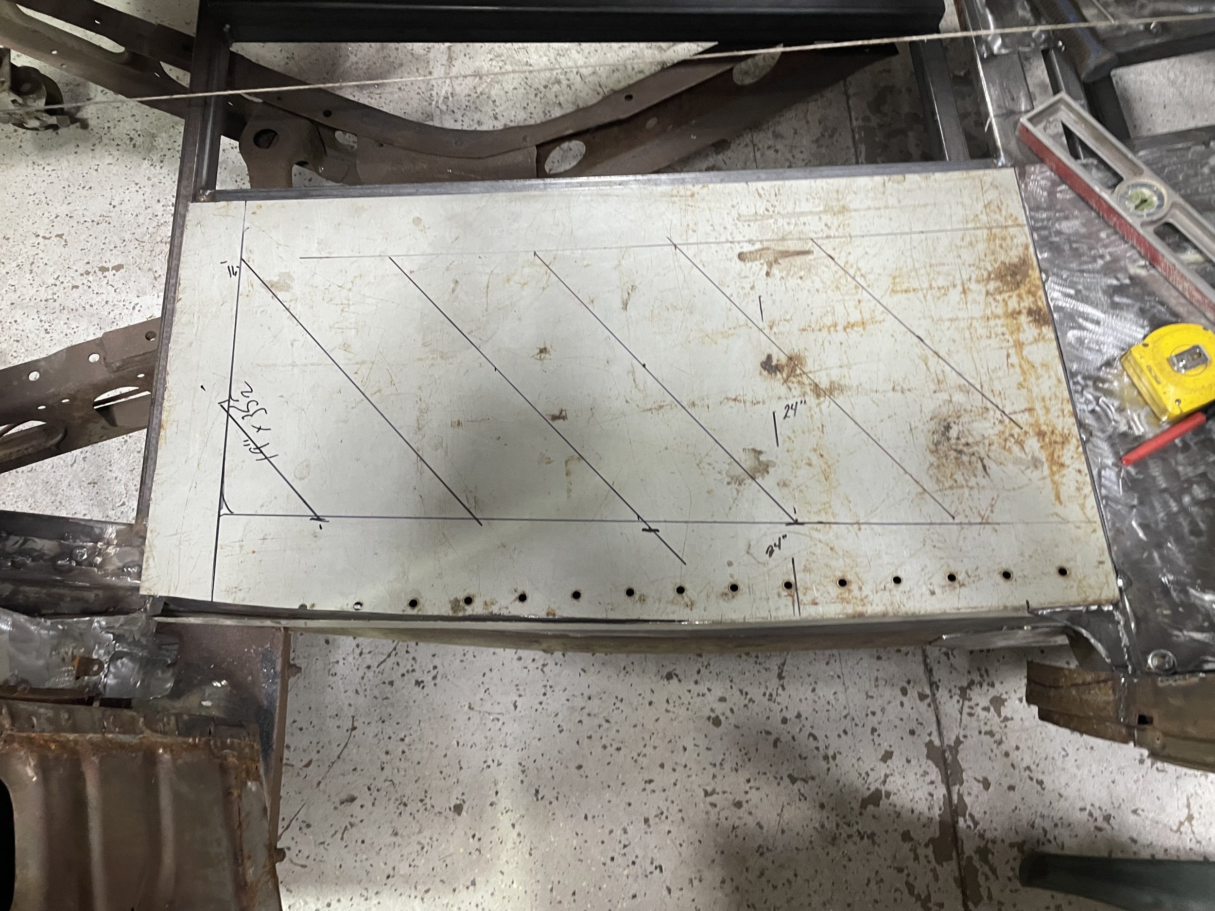

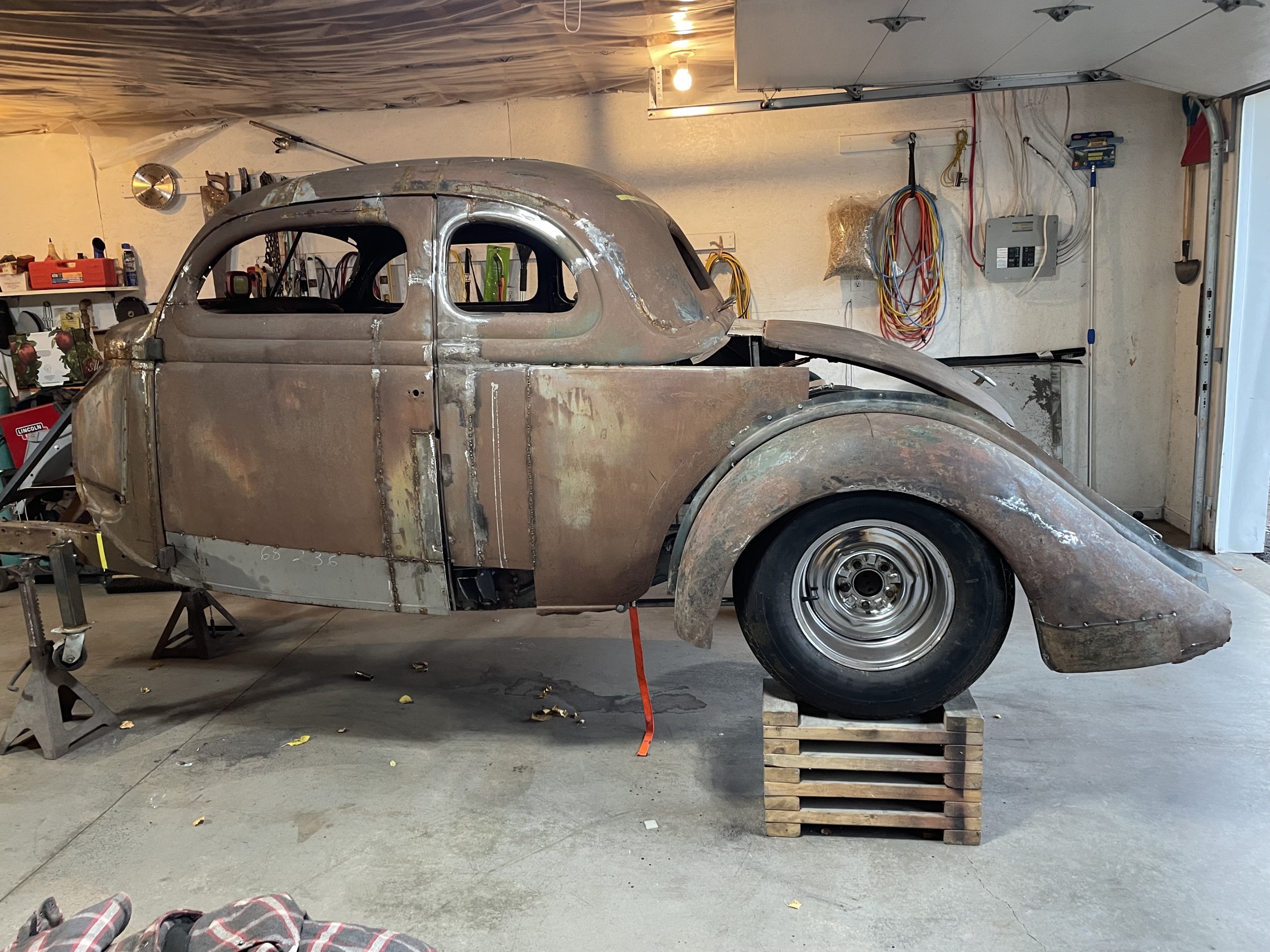

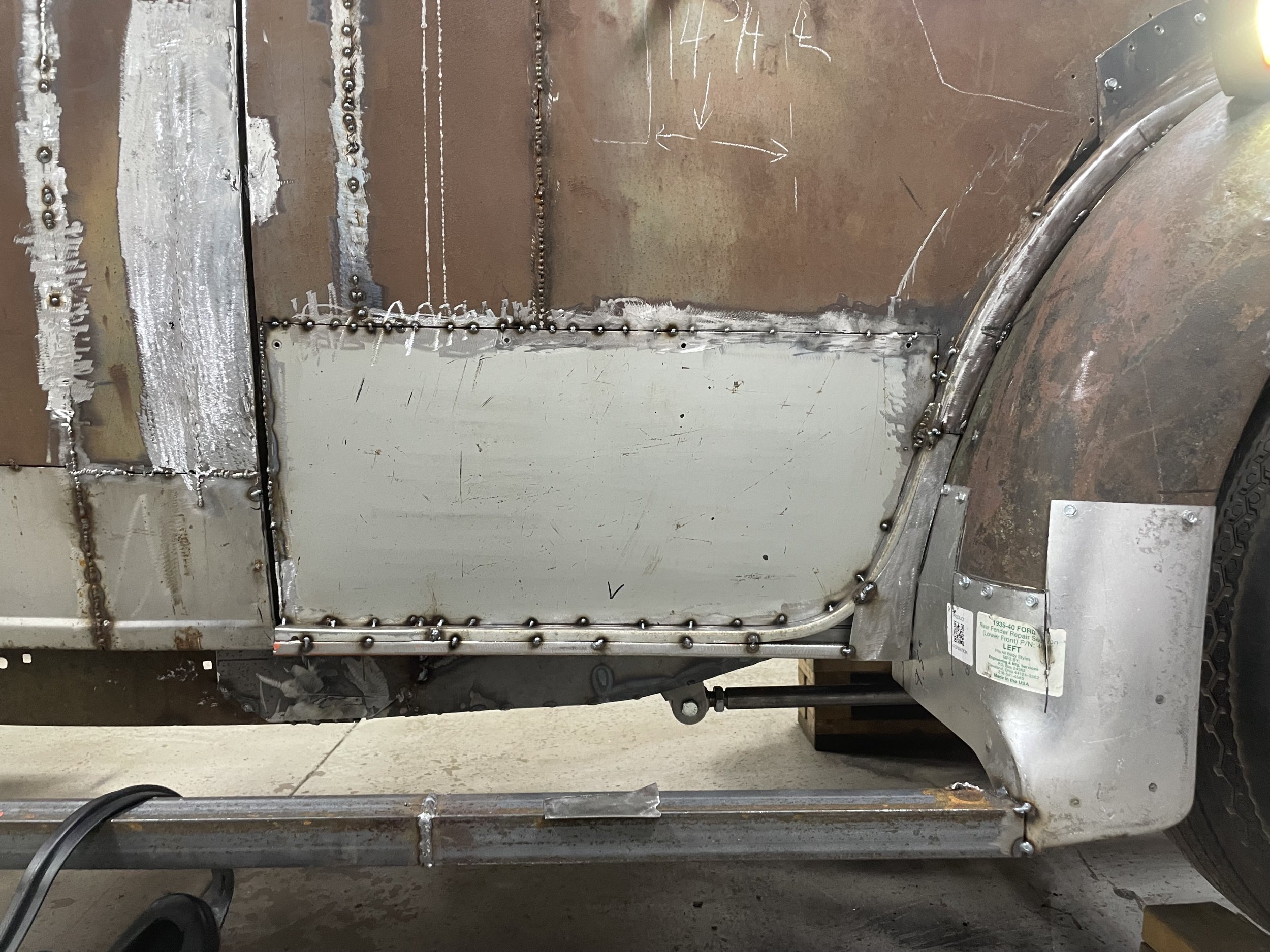

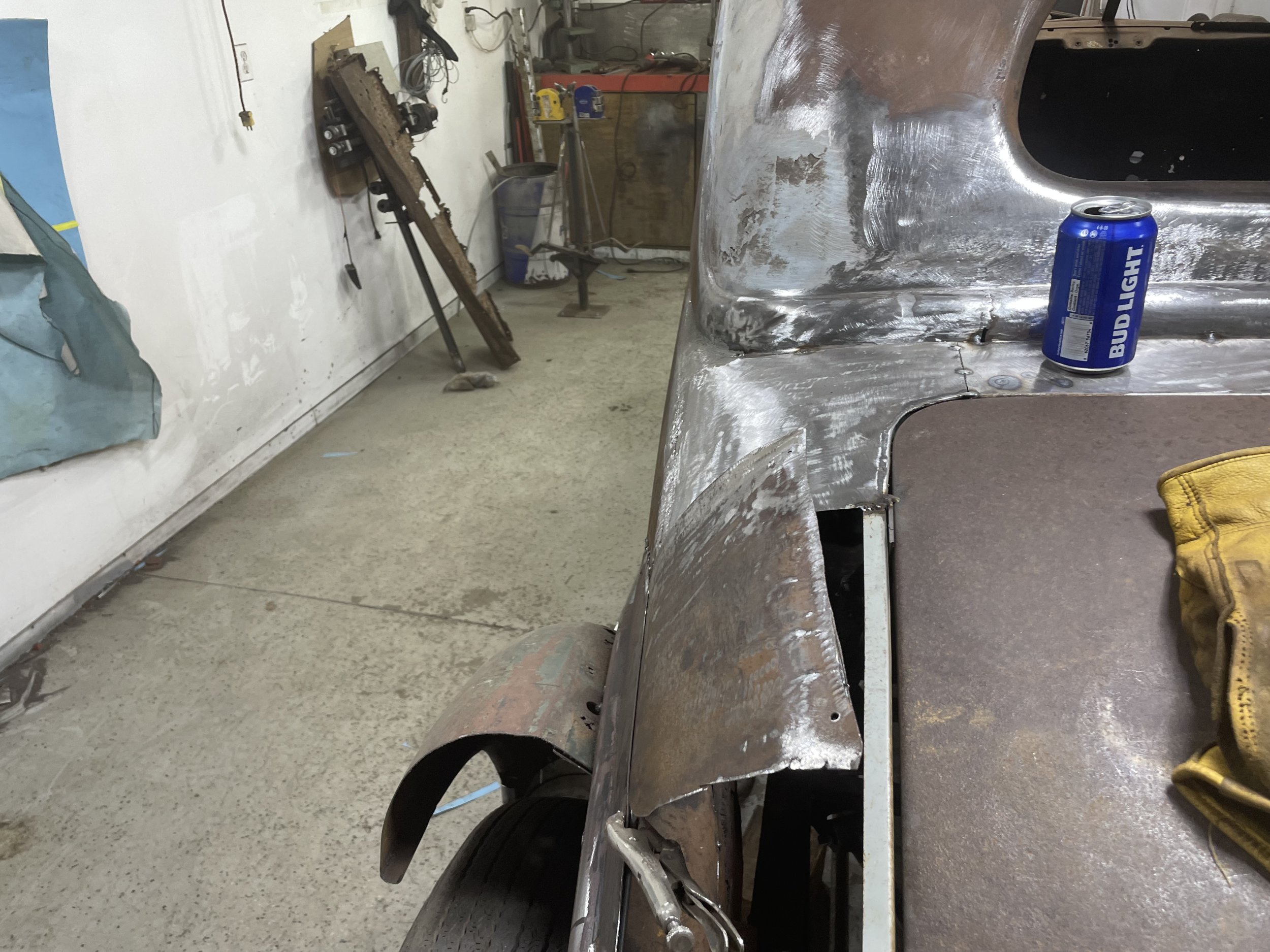

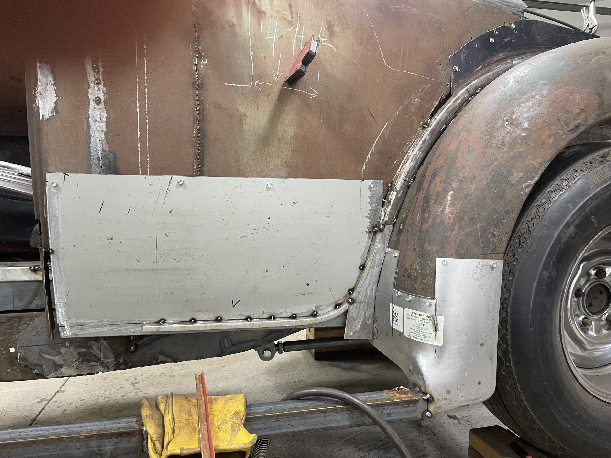

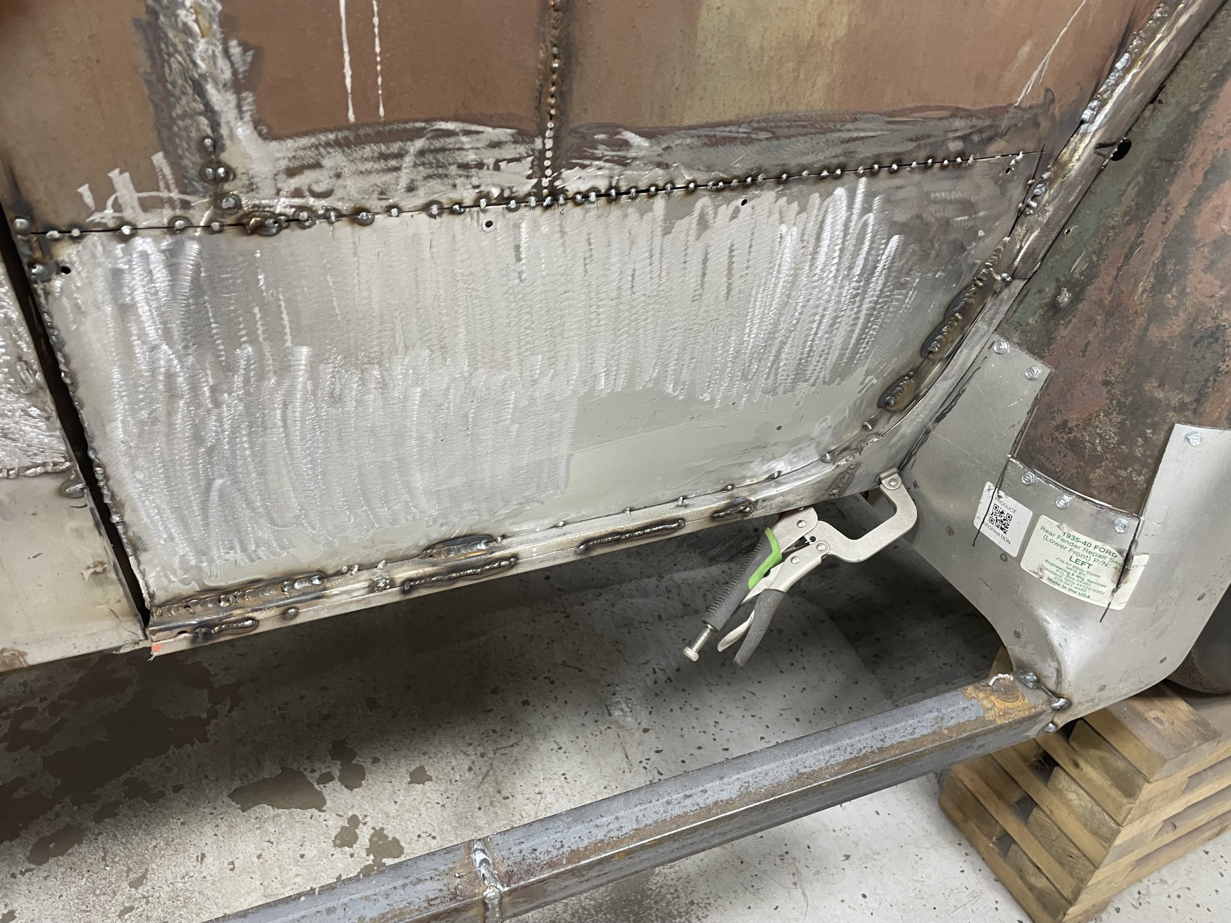

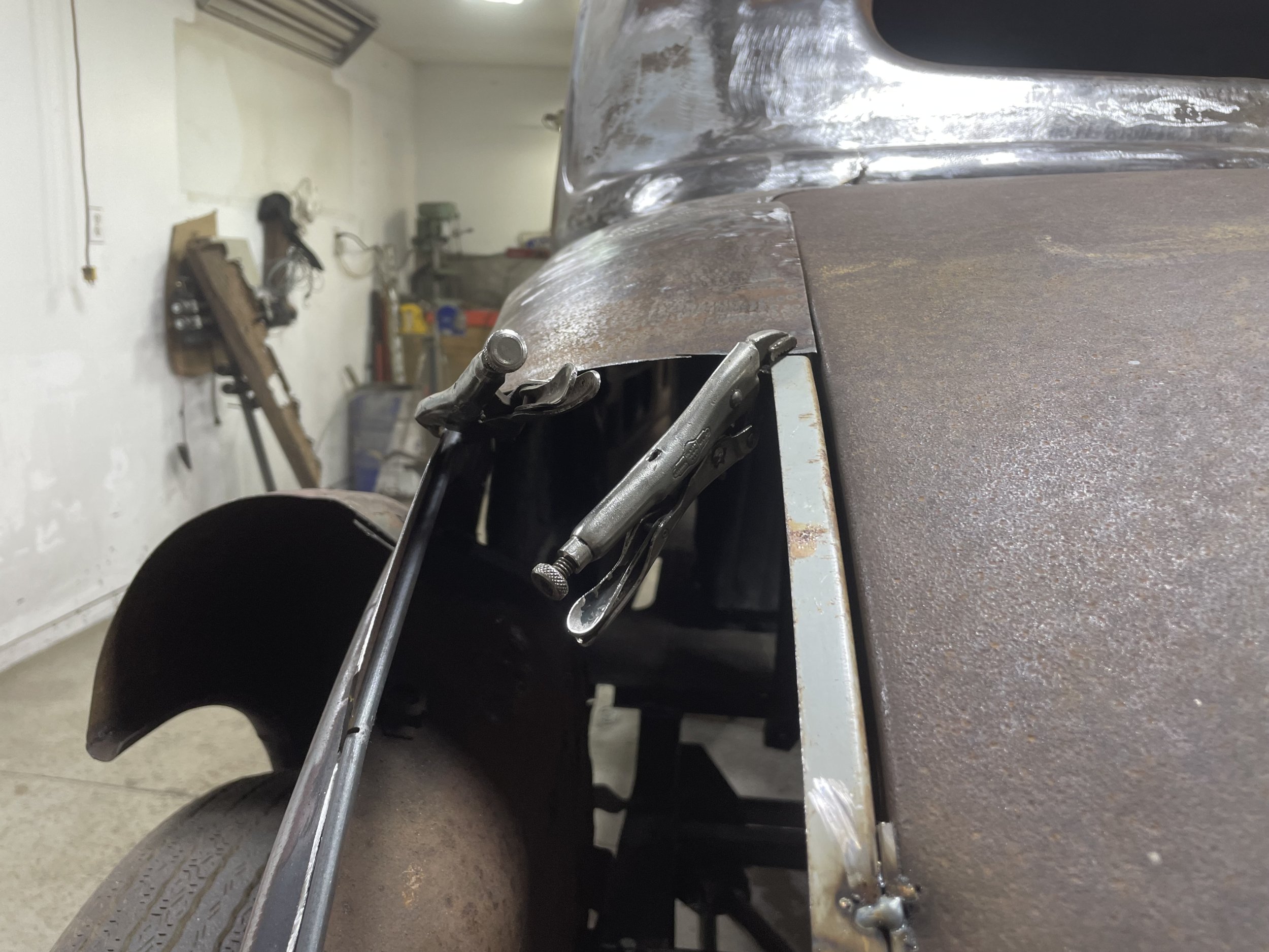

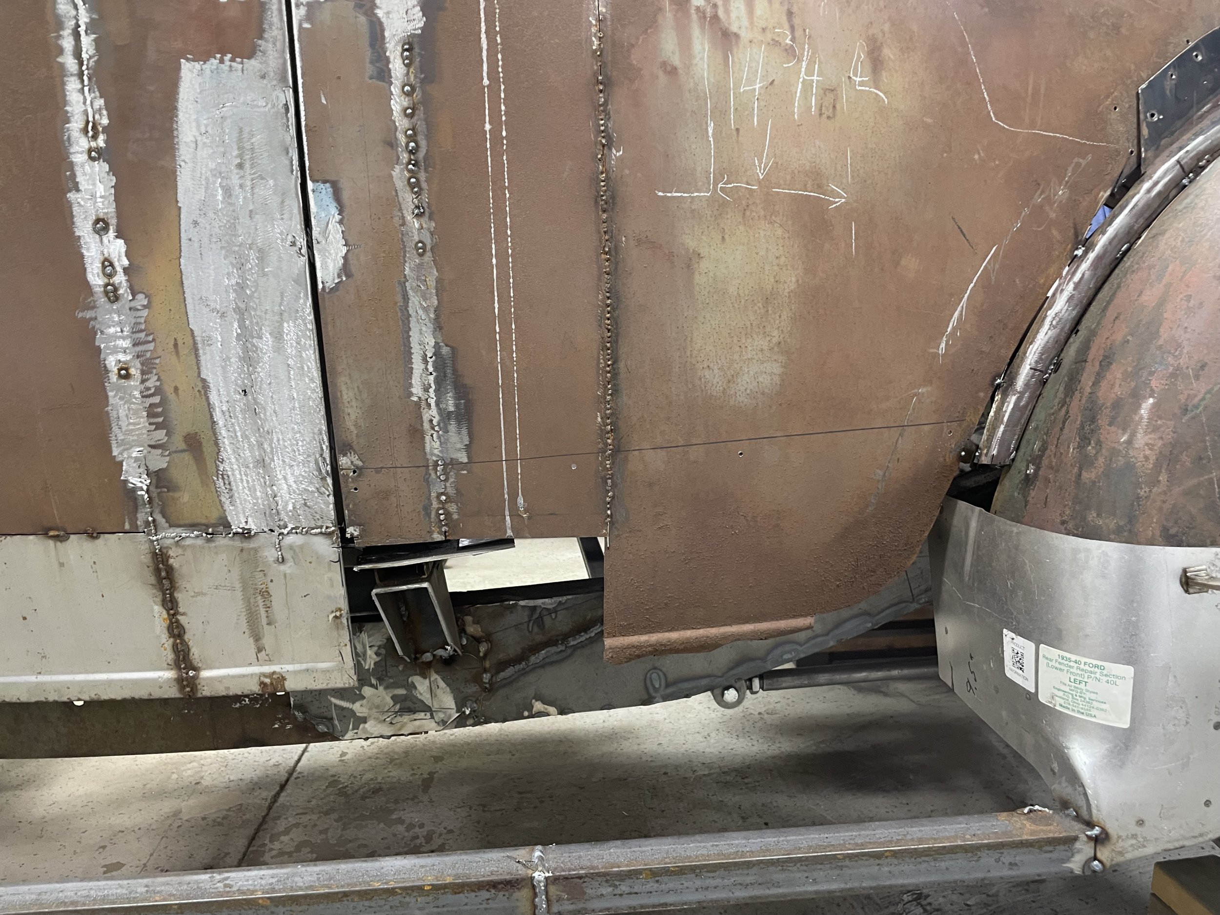

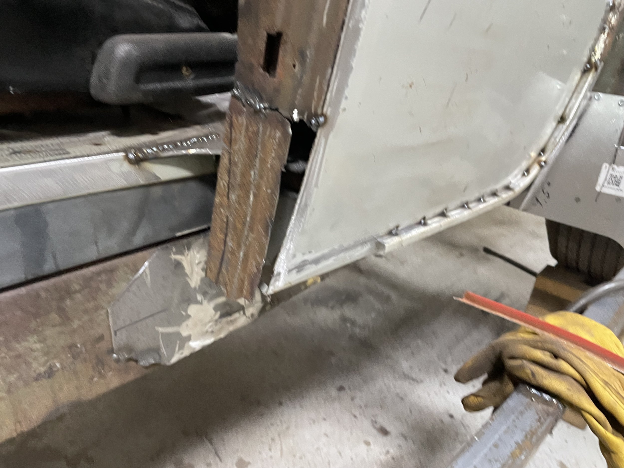

    More done or in process I should say . Tying in the quarter panel from door opening to wheel well reveal. Seeing that I don’t have the correct dies to roll the bead reveals along the bottom I am fabricating them instead . I will weld them on as seen in pictures . Stay tuned .

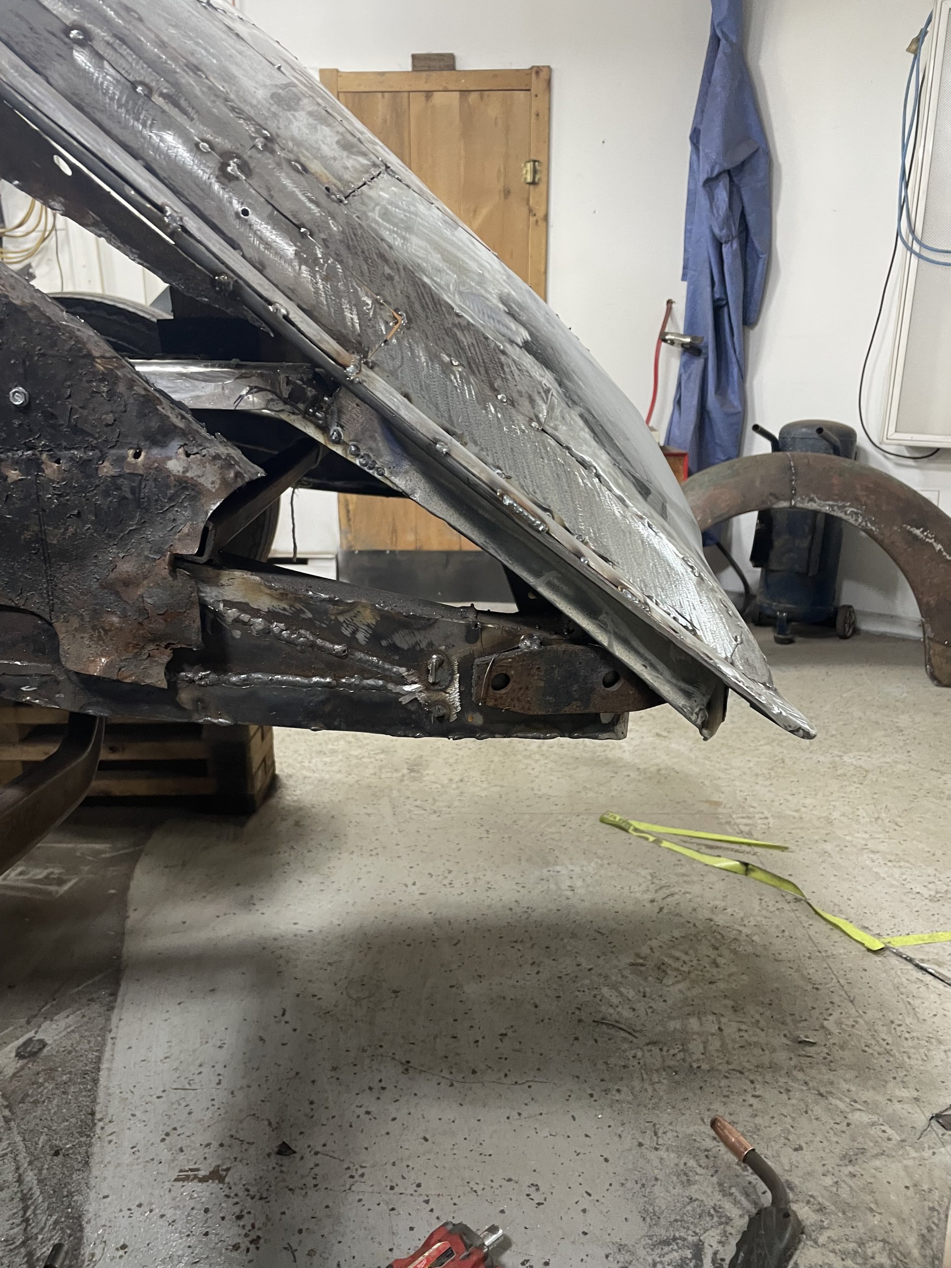

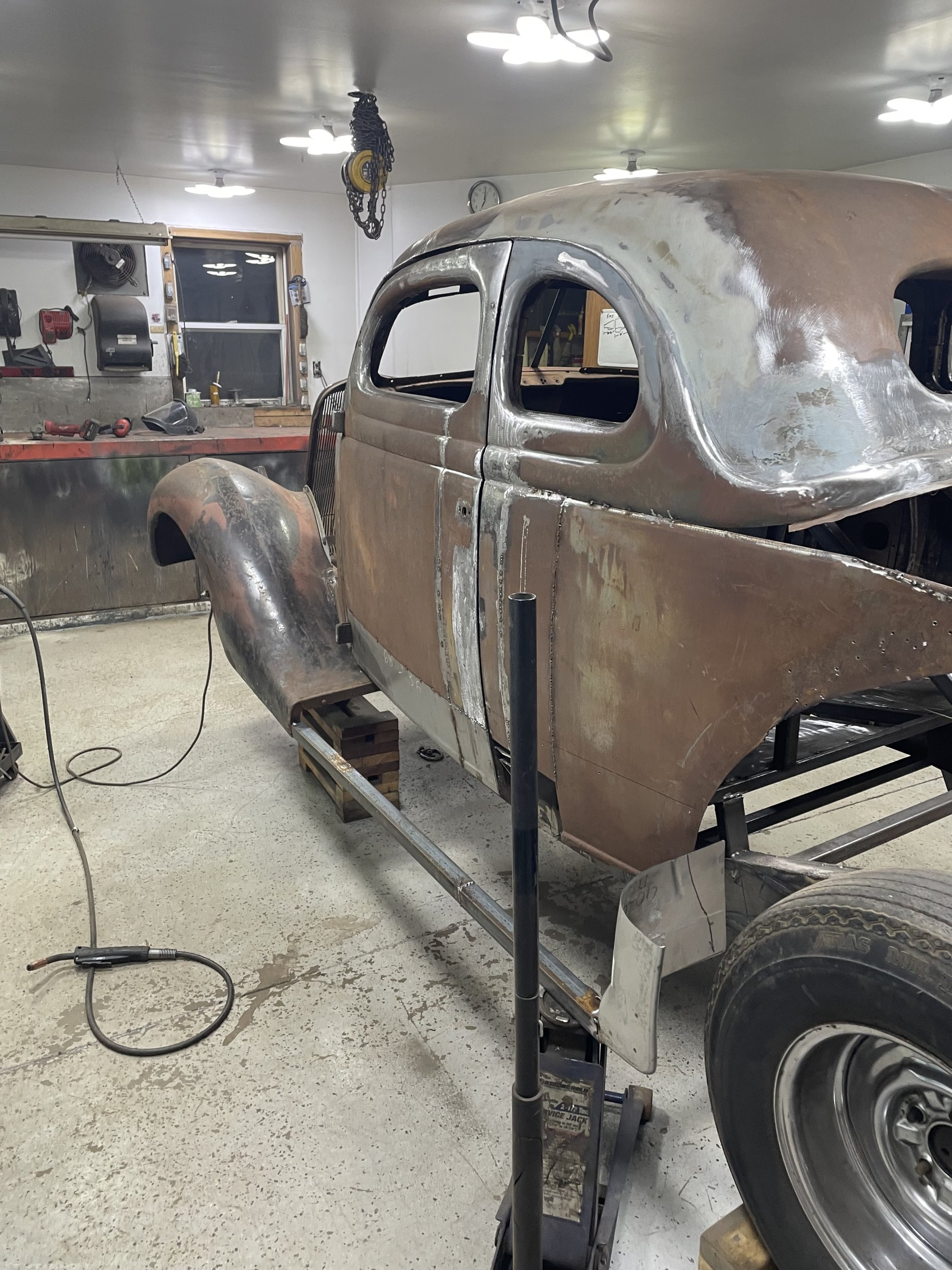

    aw1950

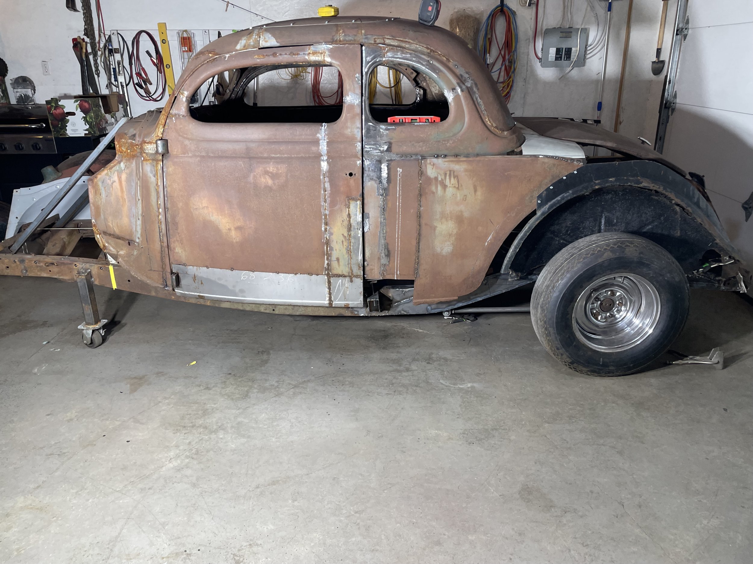

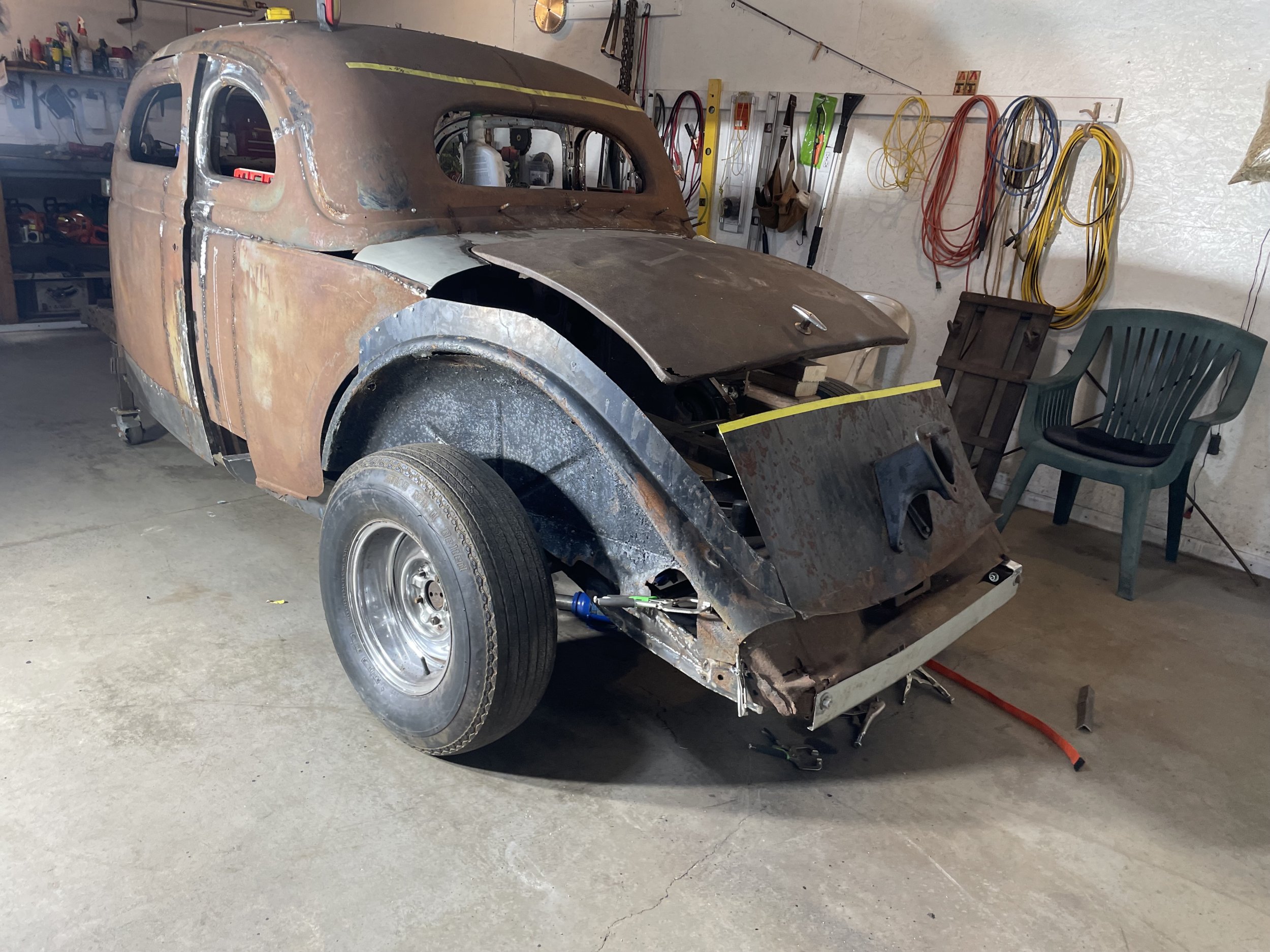

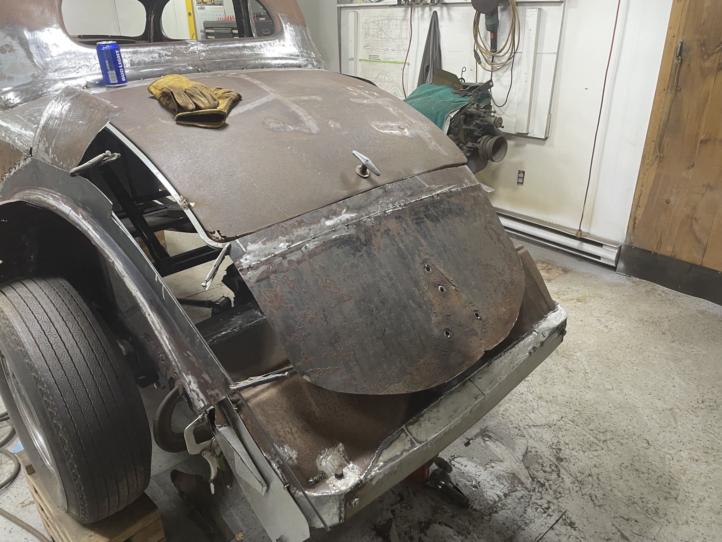

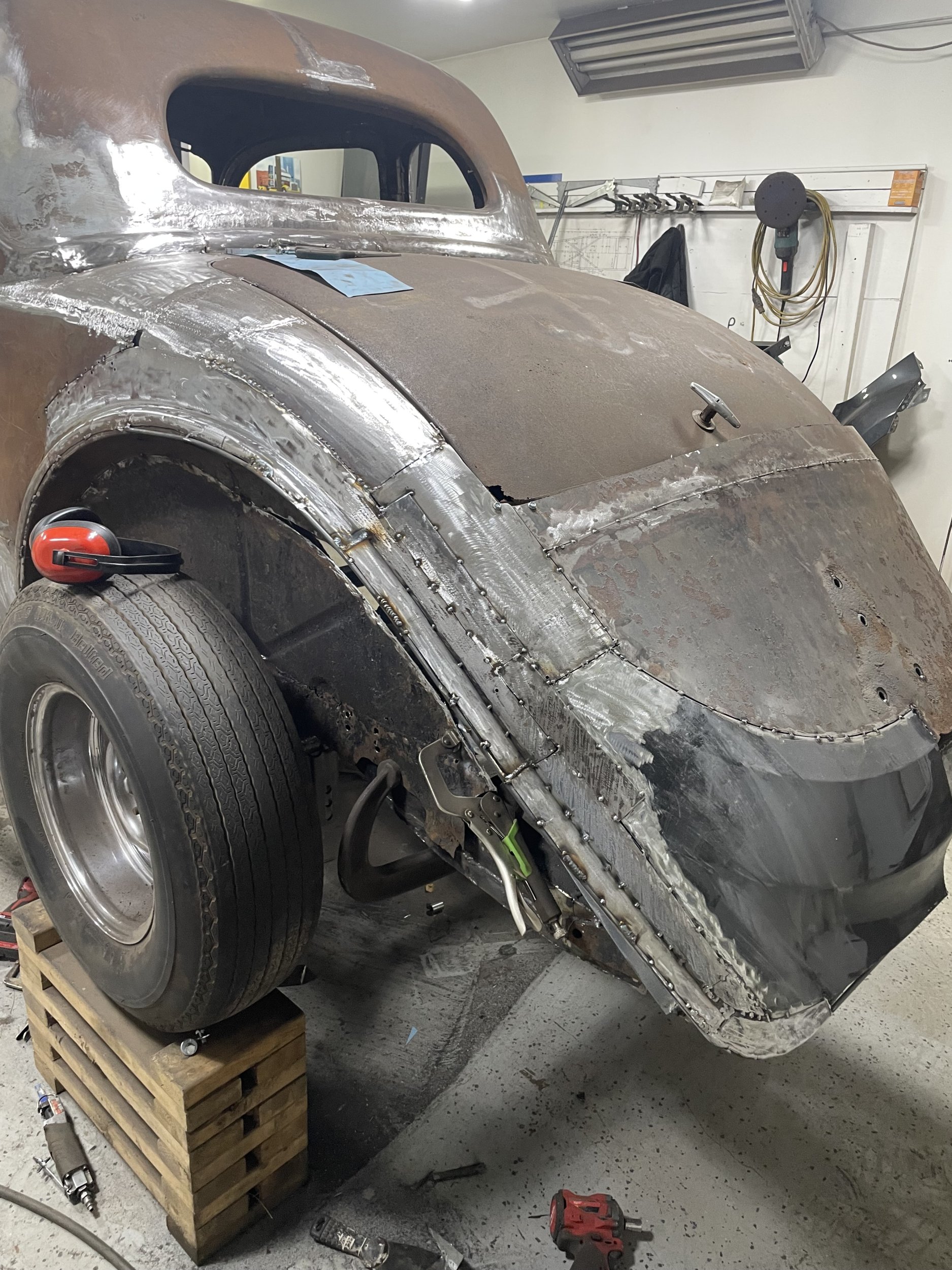

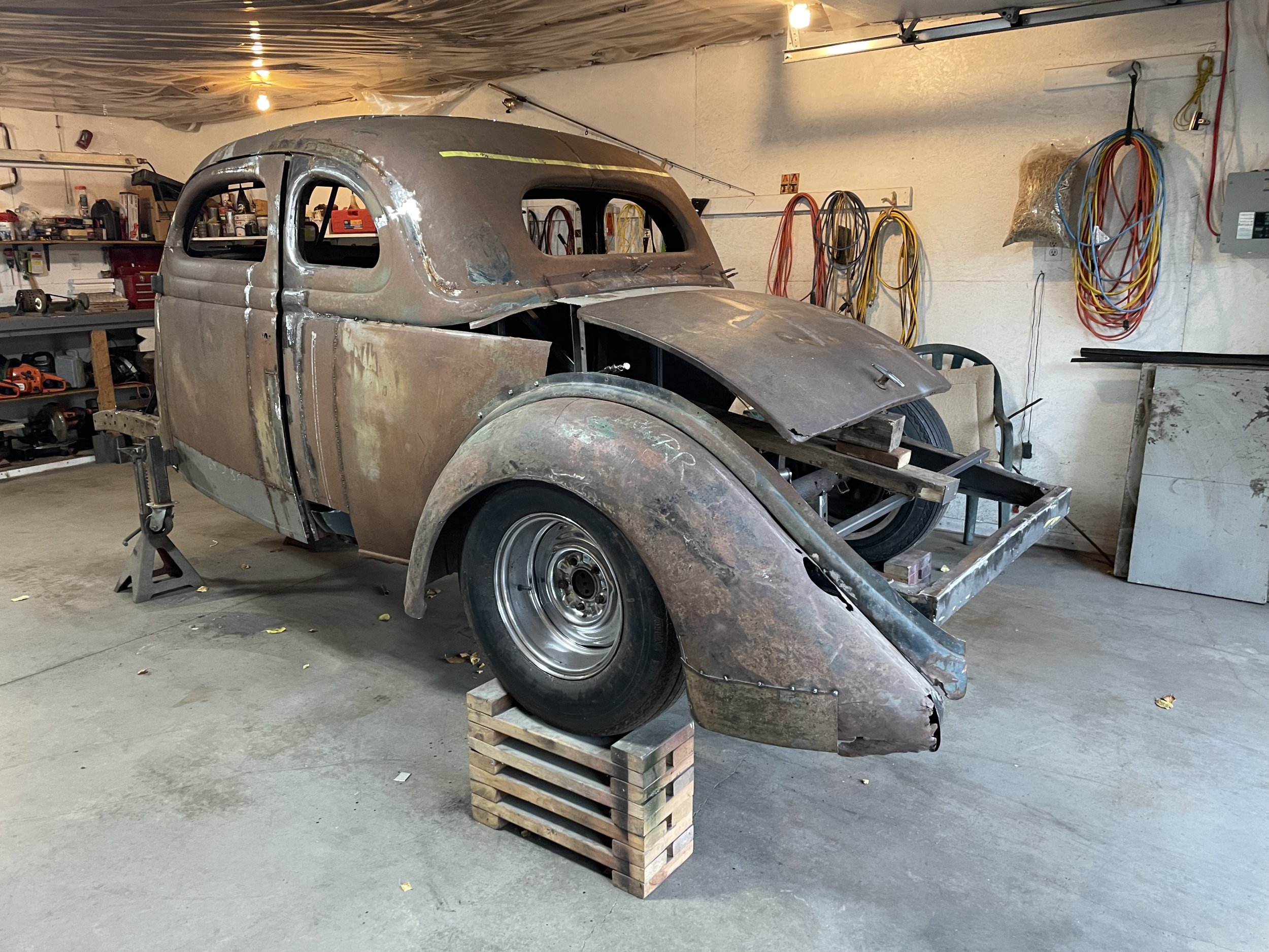

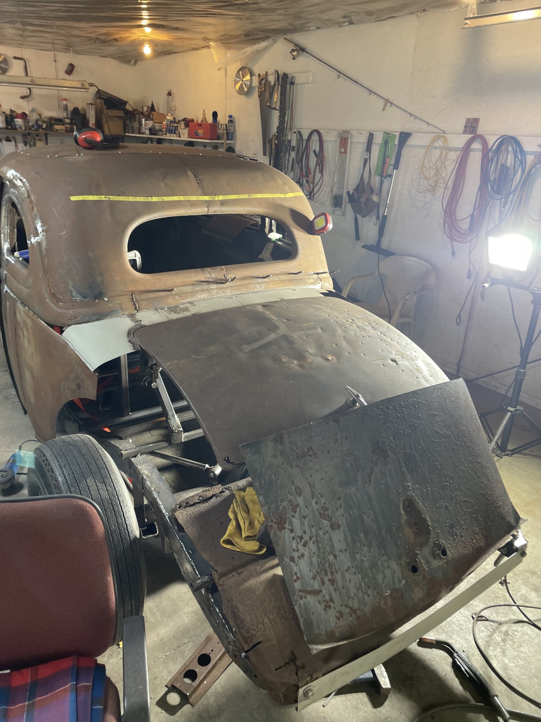

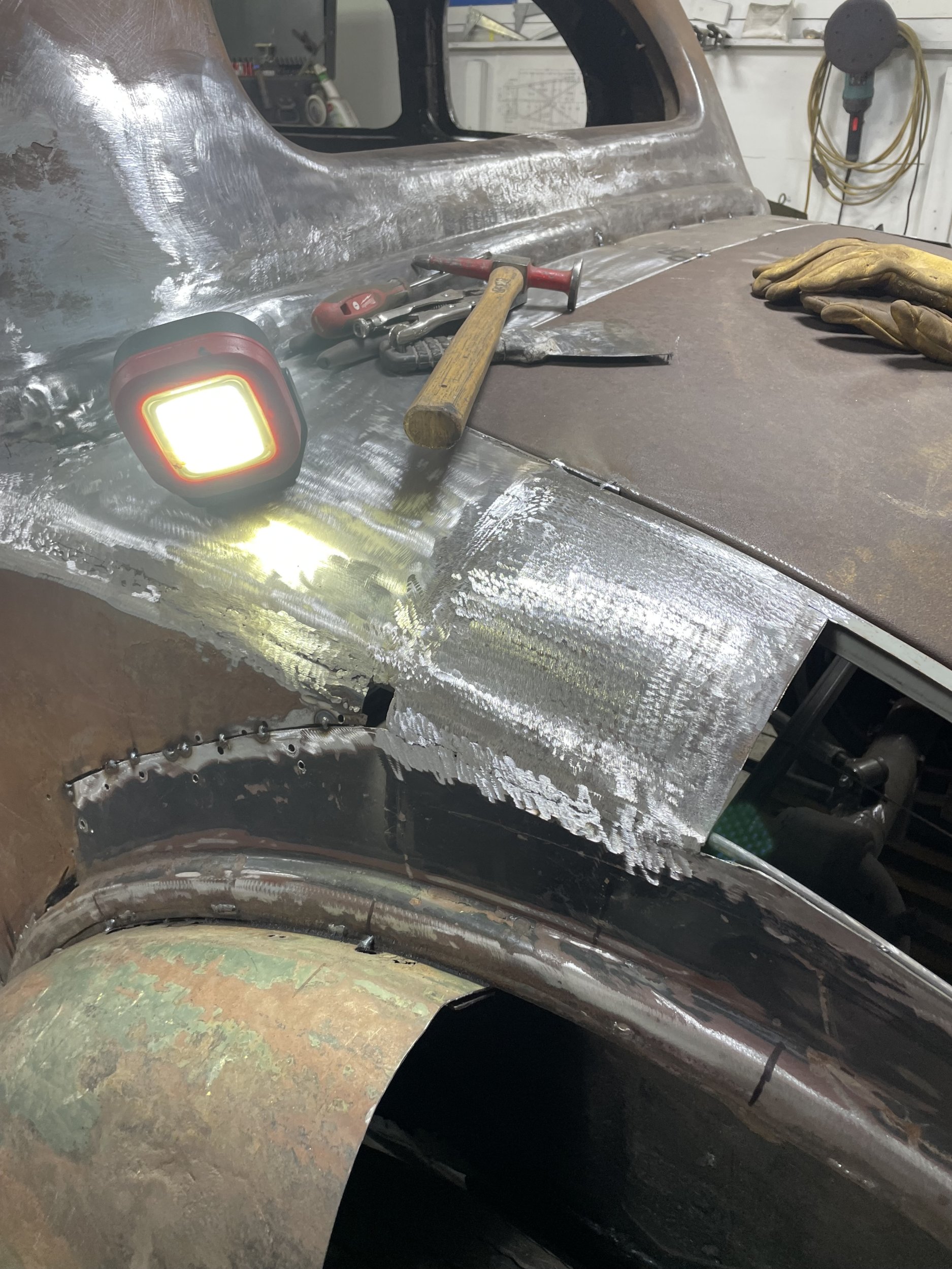

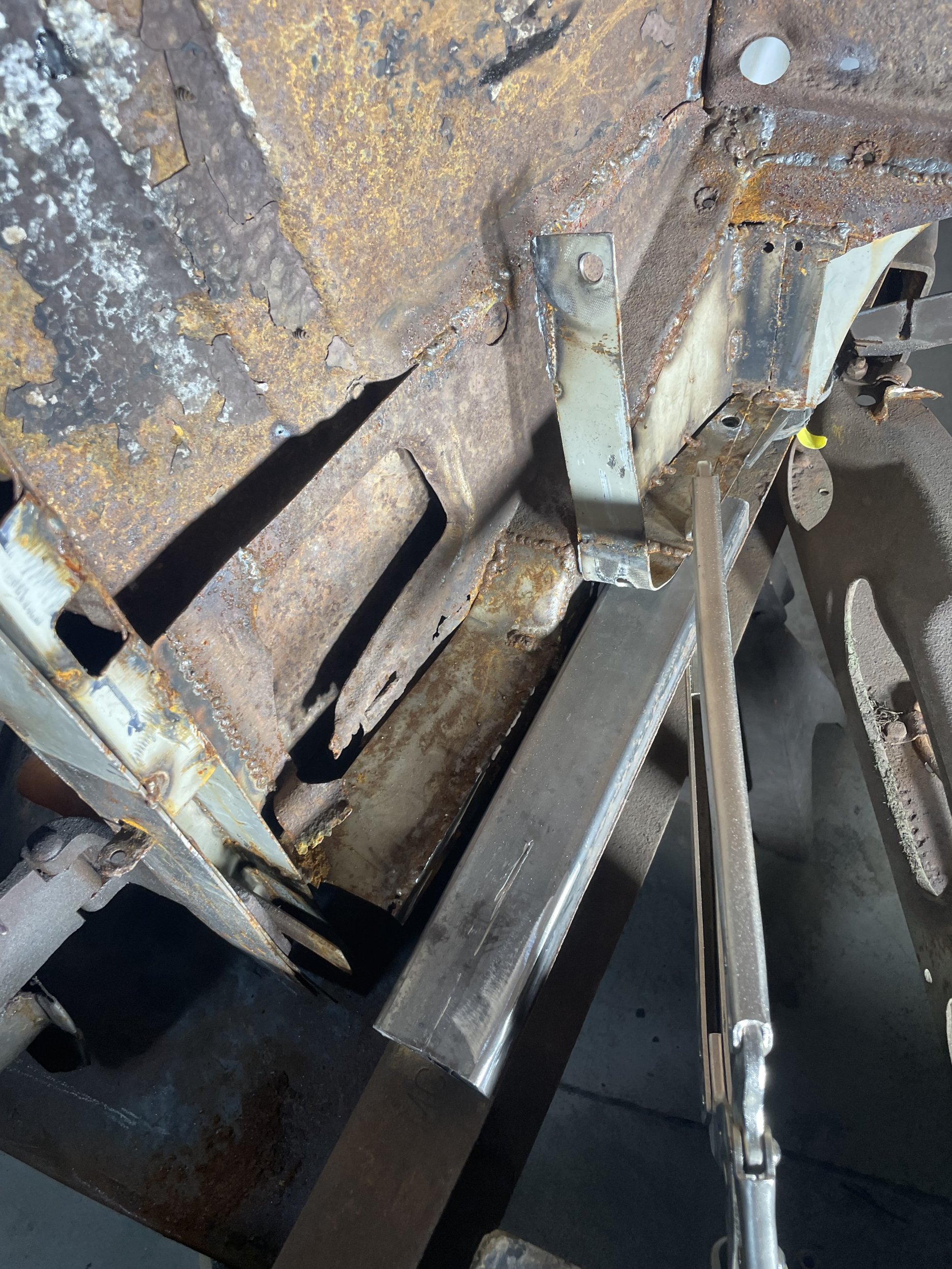

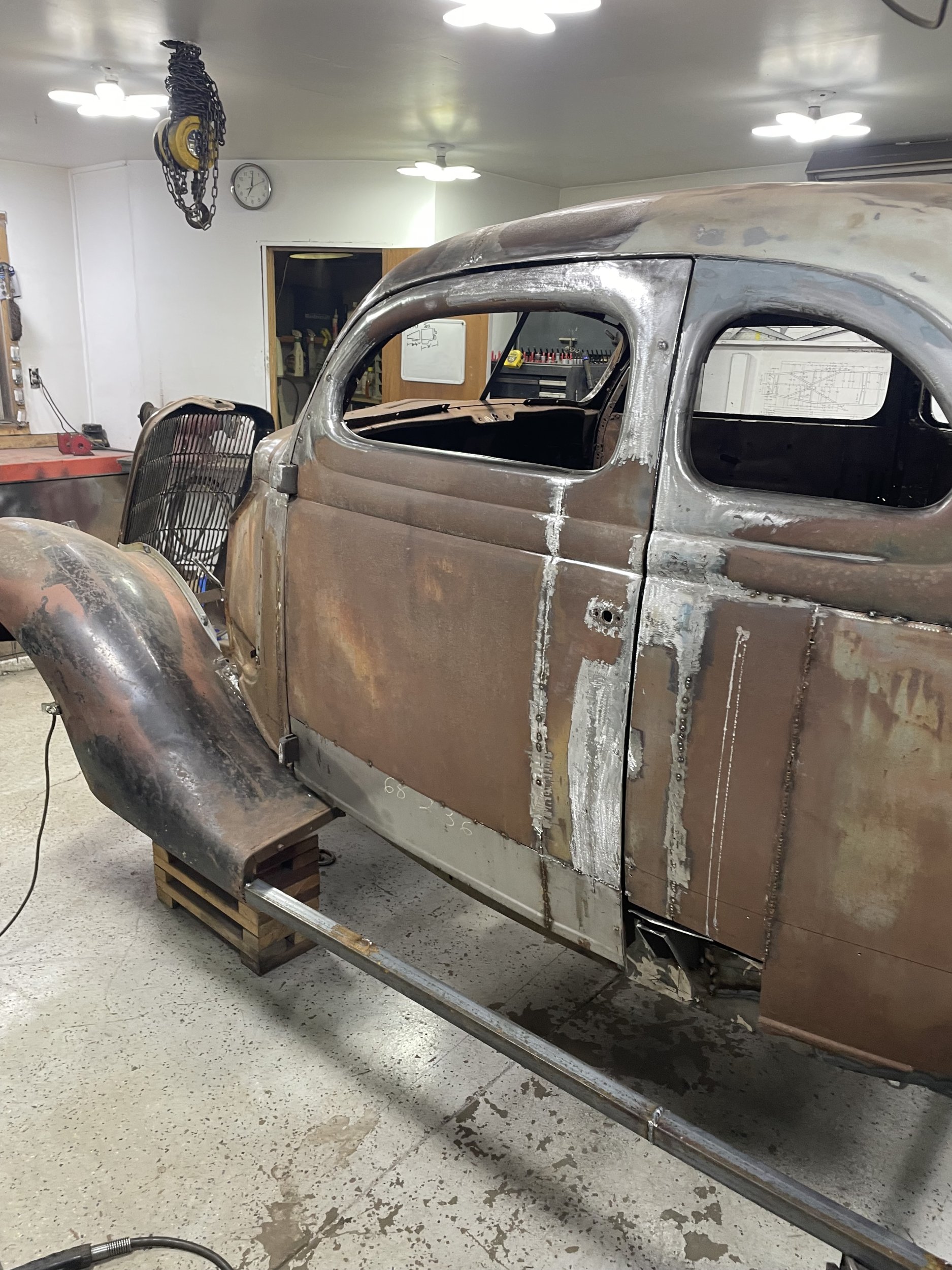

    More updates for you people who are watching along starting to tie in the sides of the car over to the trunk lead opening and using older sheet metal and as you can see in one of the pictures, newer sheet metal from an off topic style of car.
    Remember this car was a two door humpback and I do not have the correct rear section or pieces at all of an actual Five window coupe. So I have to improvise and I will have a one off 35 coupe clone stay tuned. This will be interesting. More updates to come.

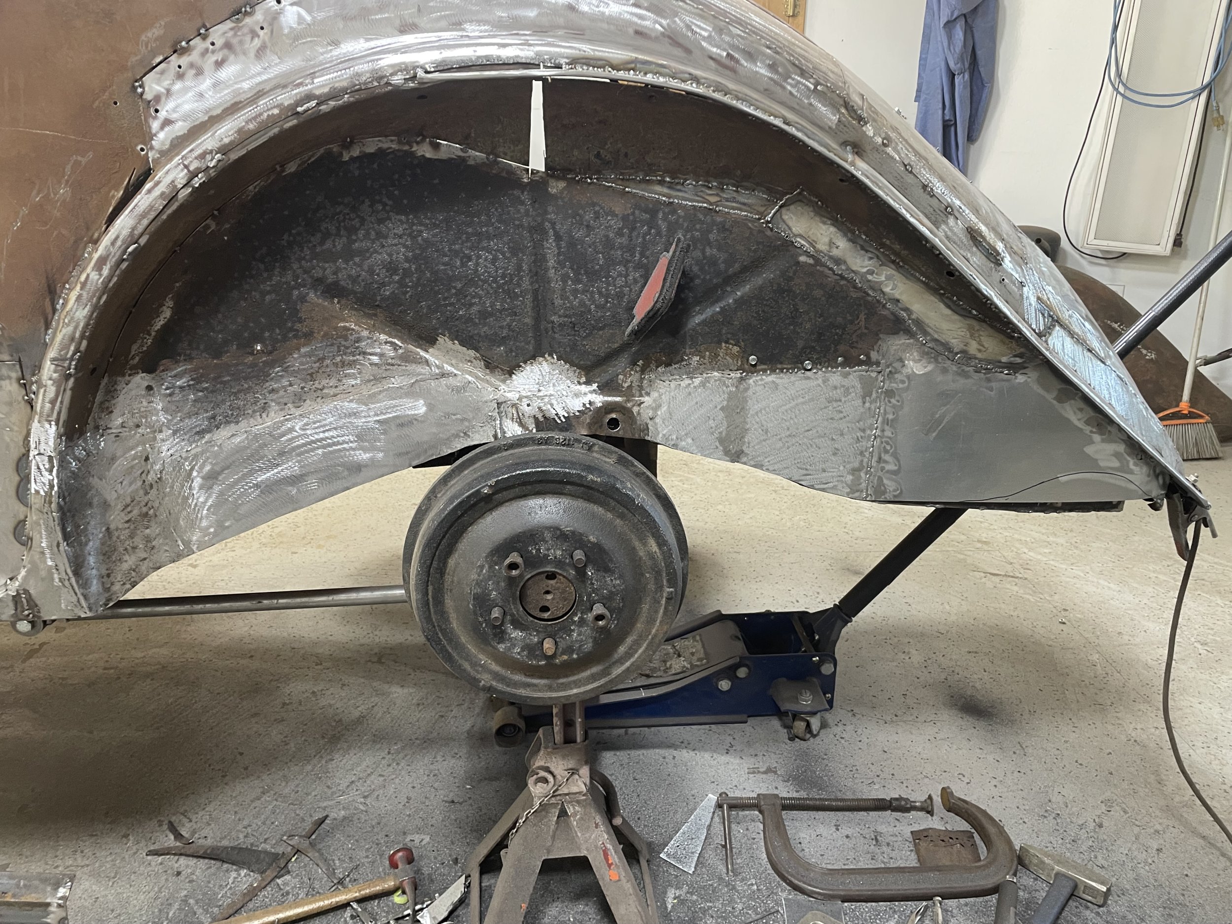

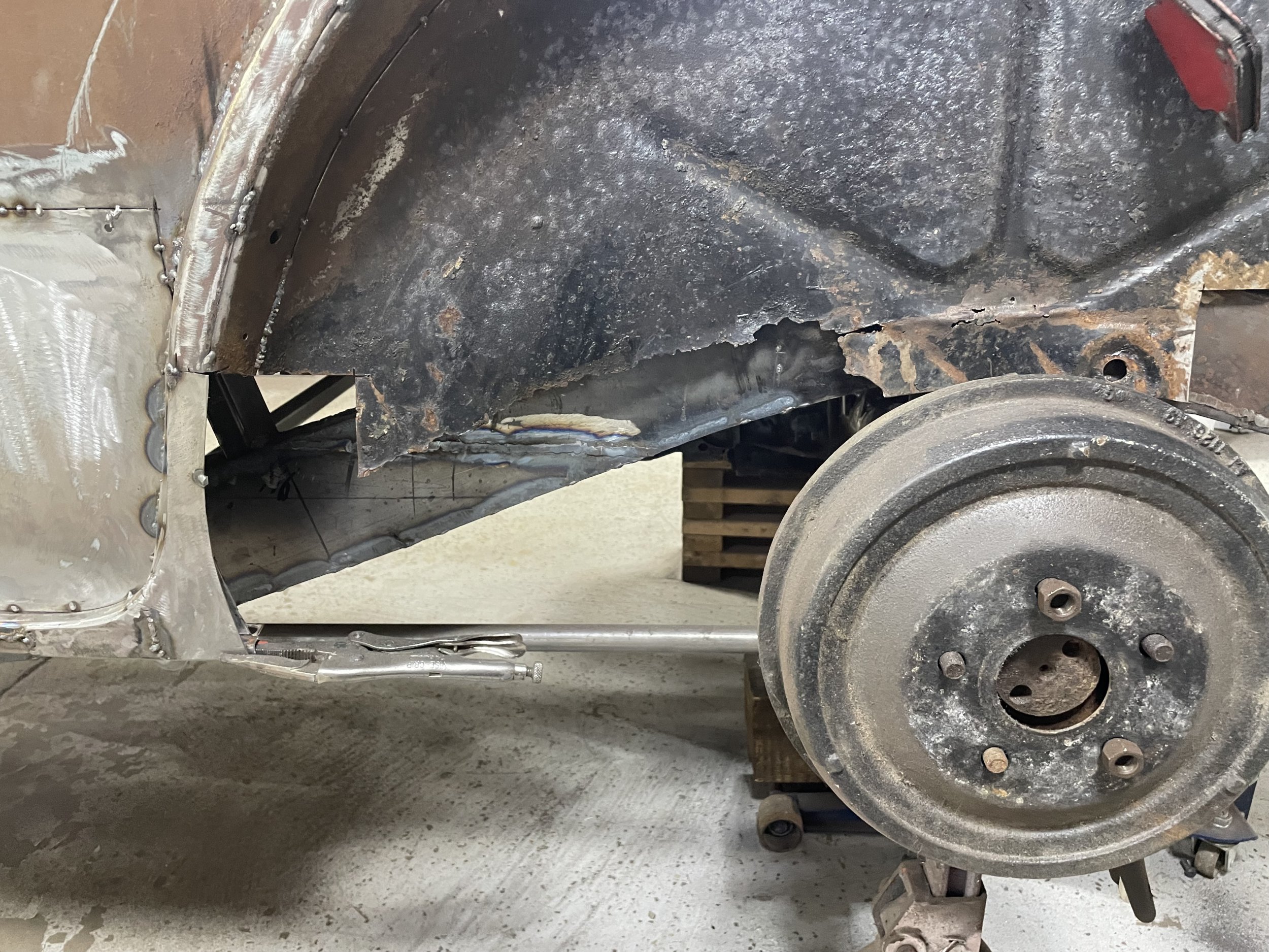

    aw1950

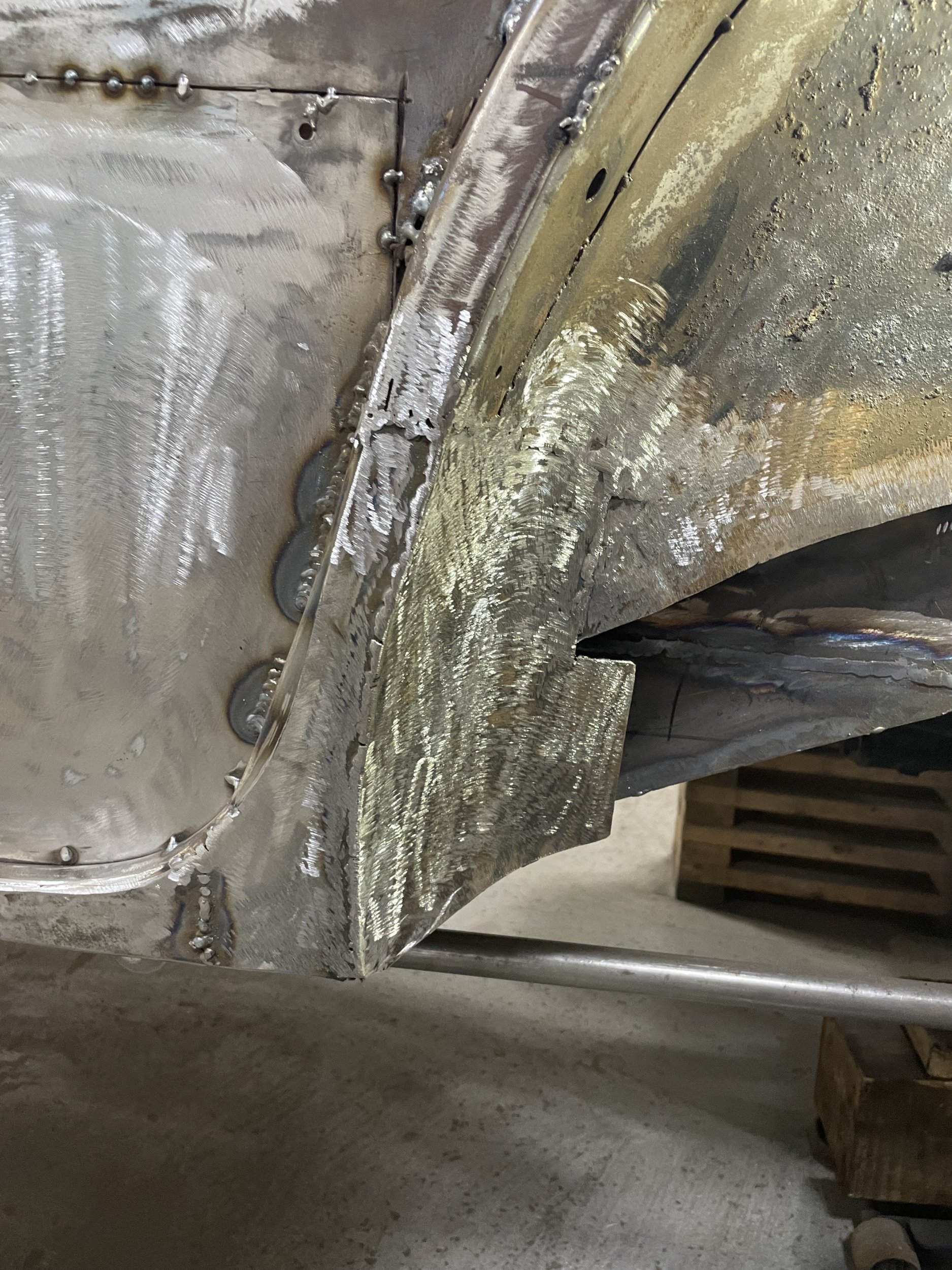

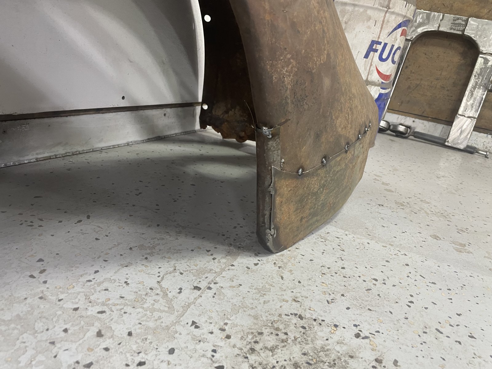

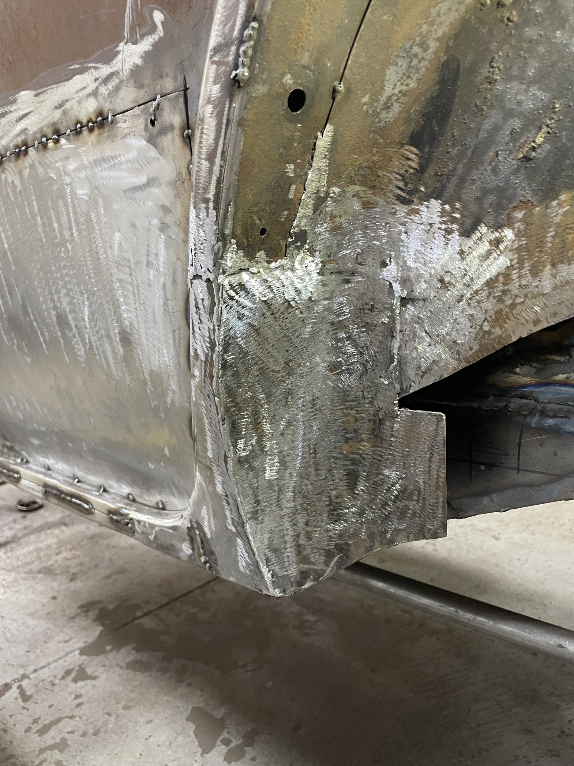

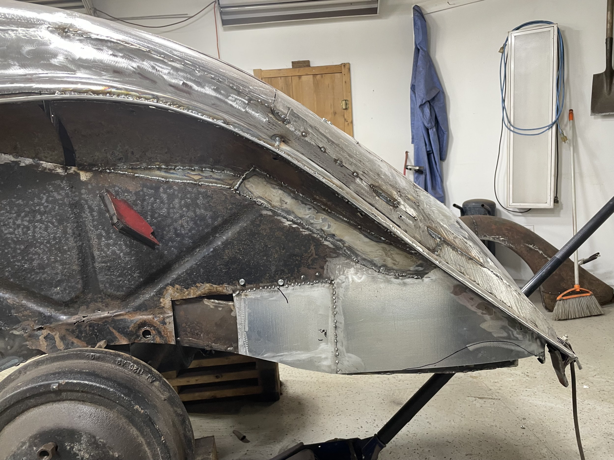

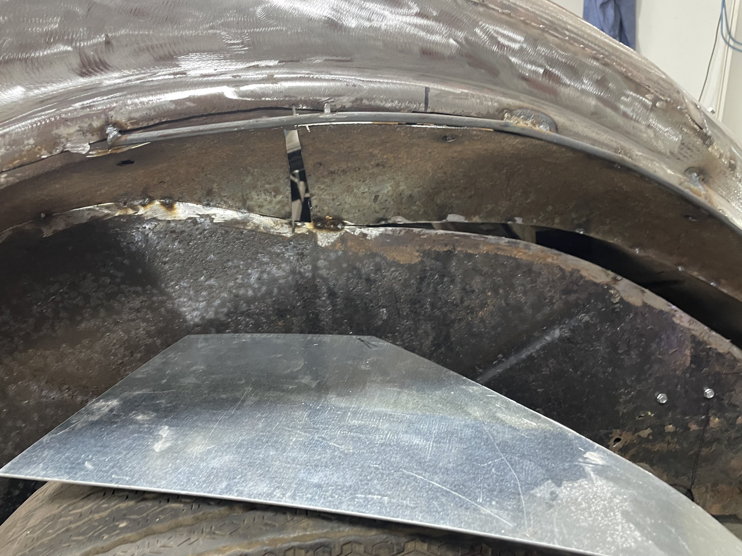

    More showing the repair of the inner section of the wheelhouse . More to come
