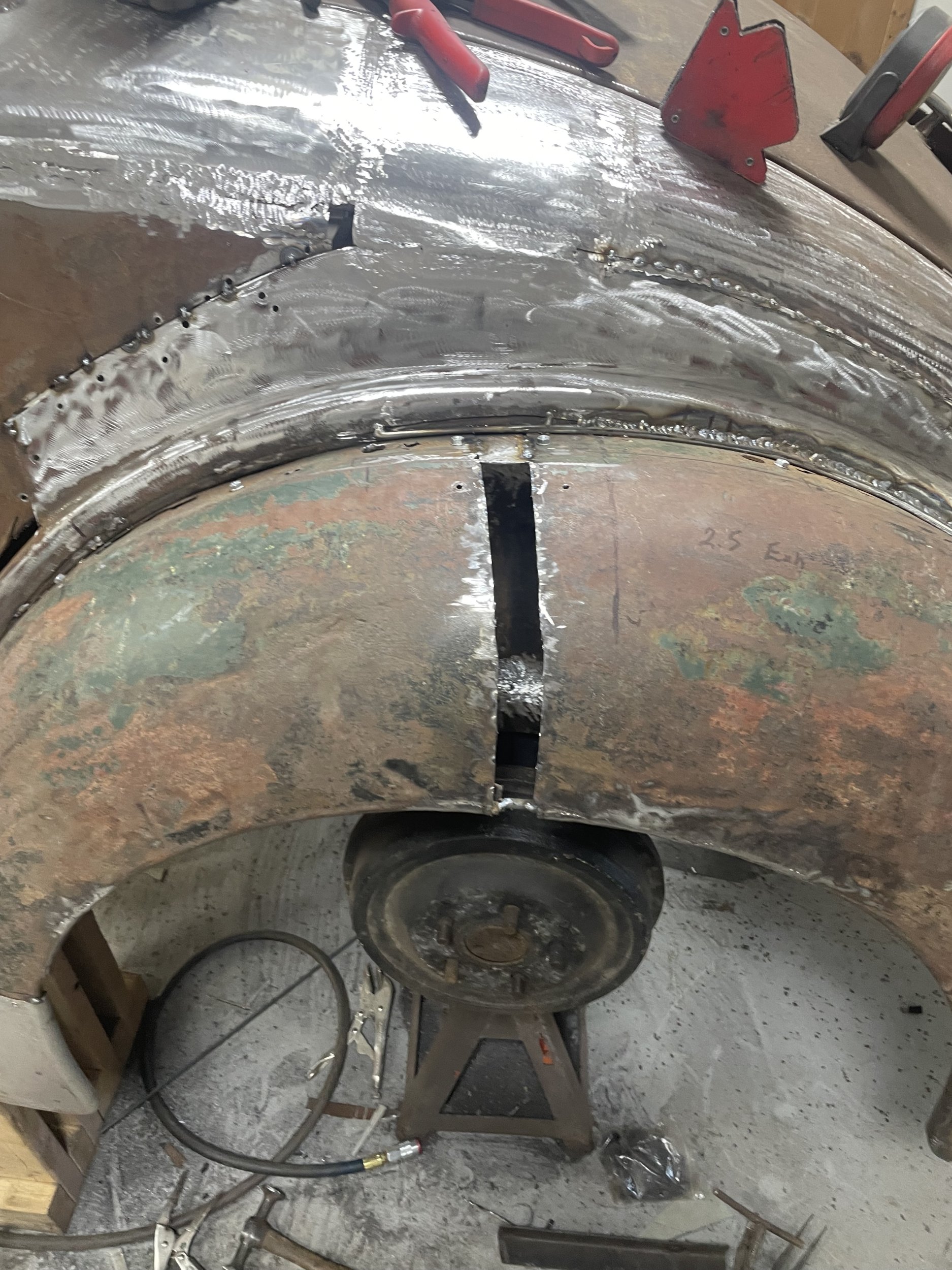

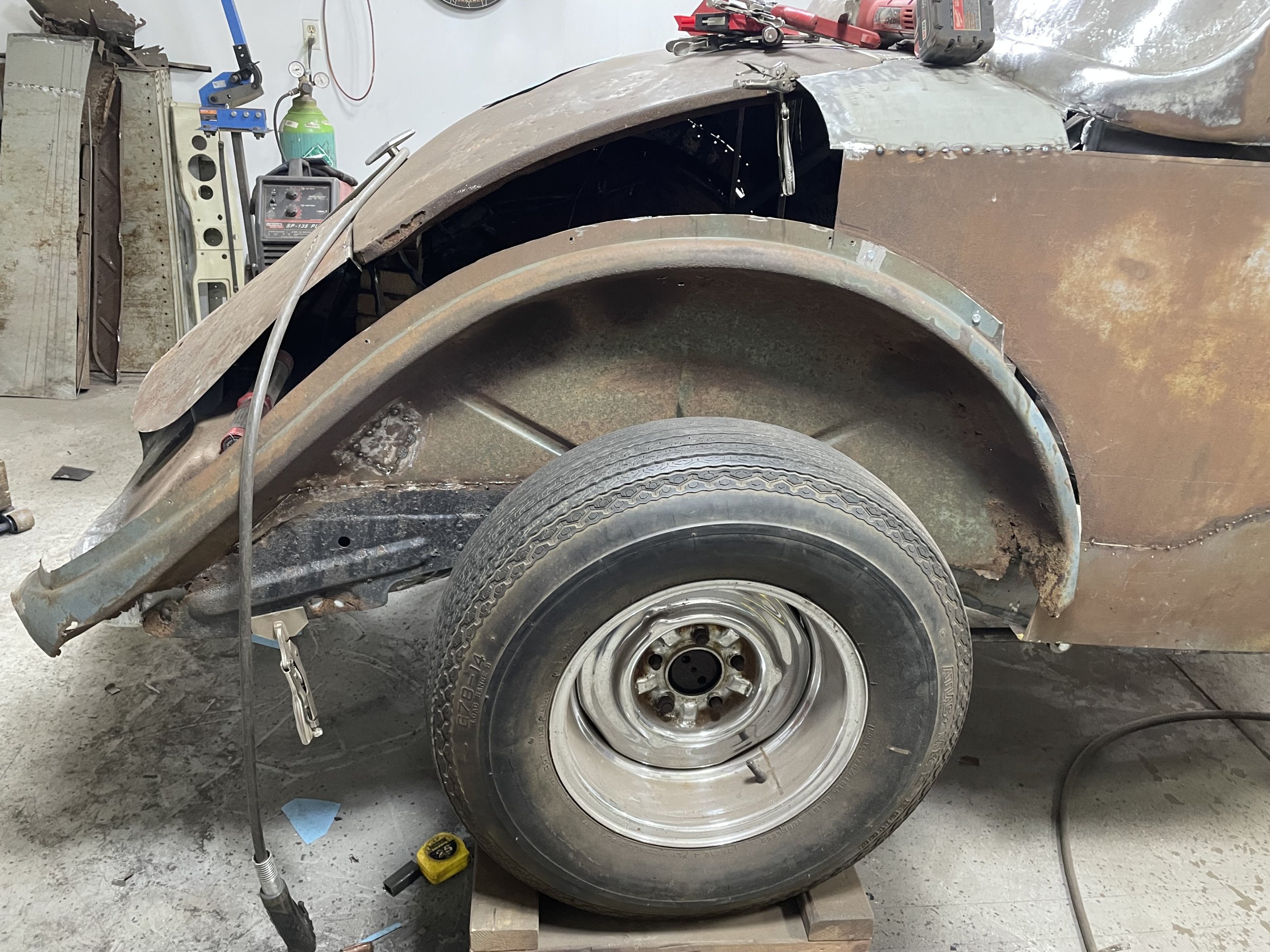

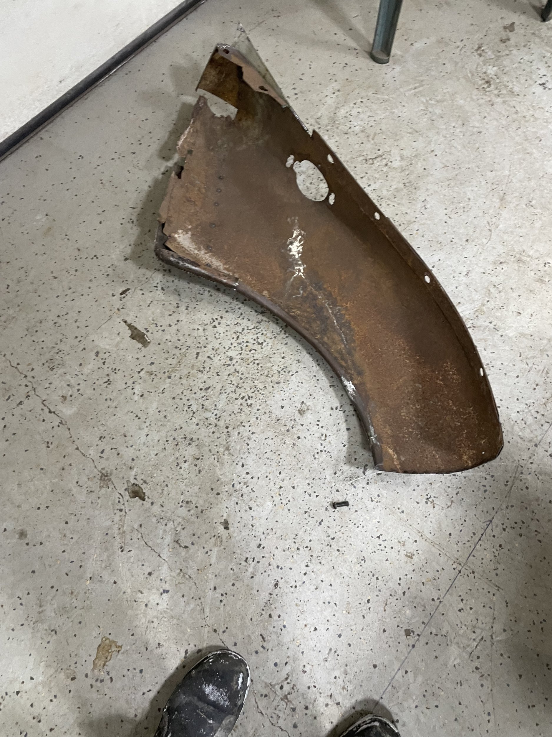

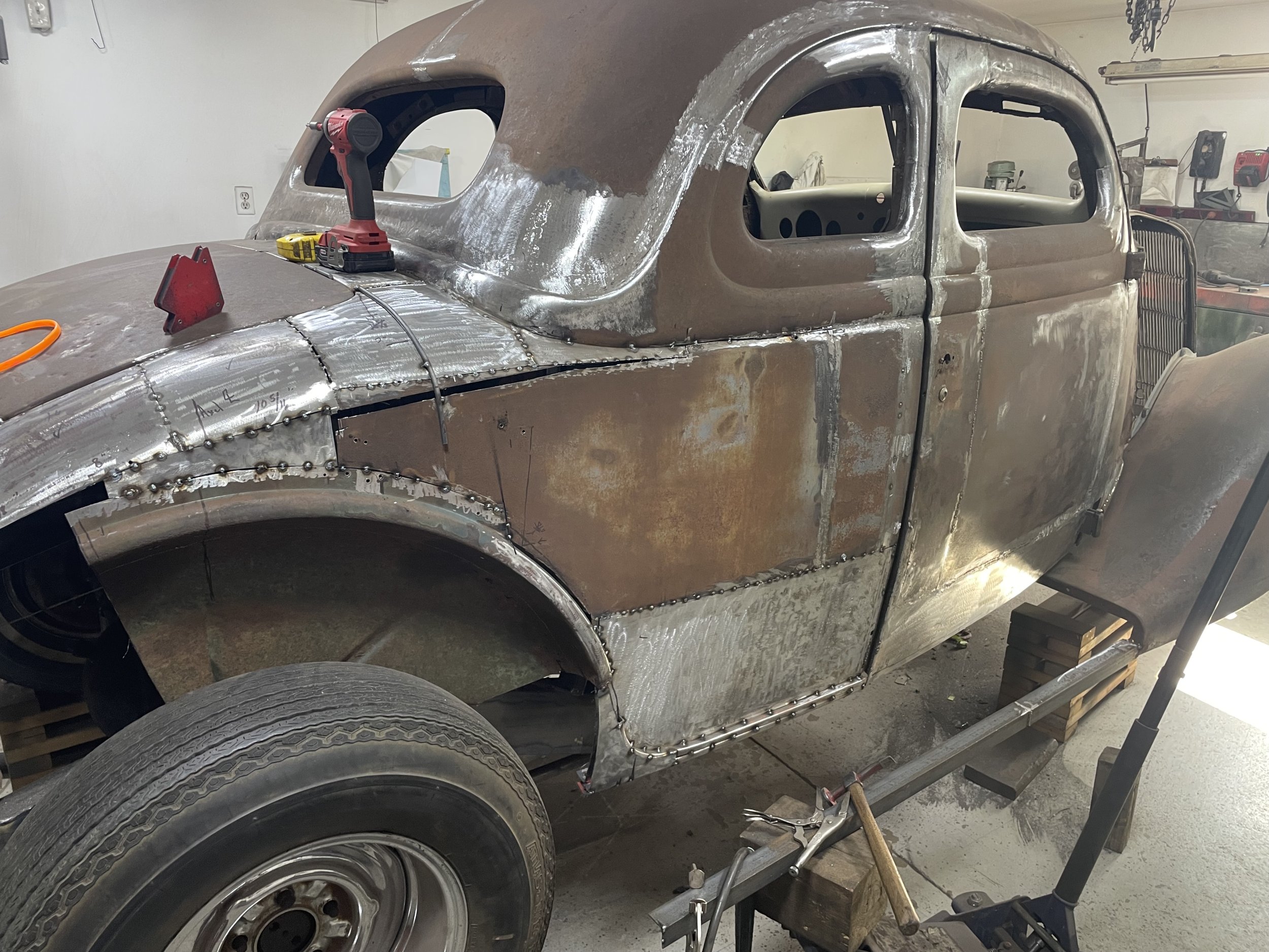

    More updates , fender was cut in half and stretched to fit correct .

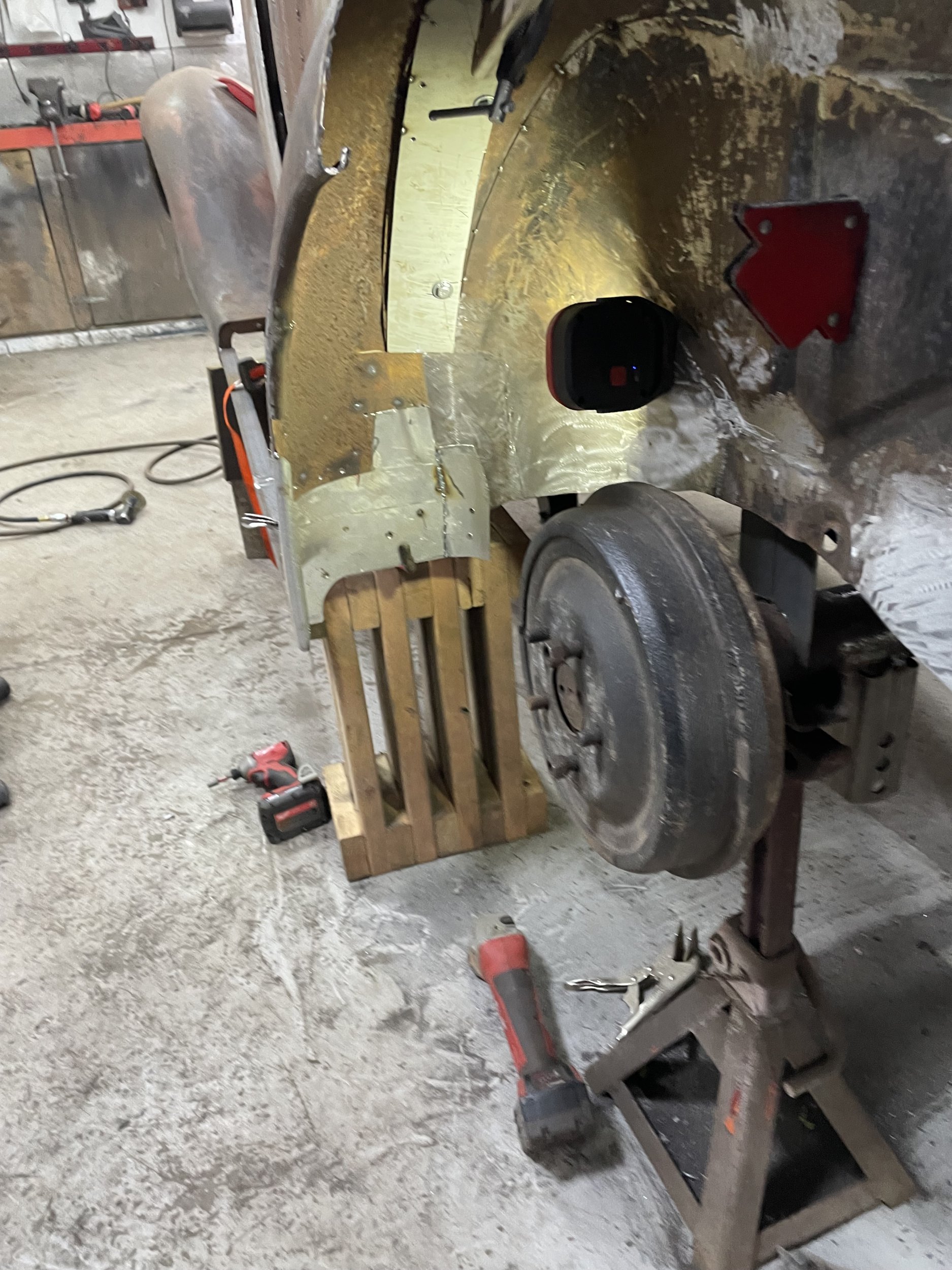

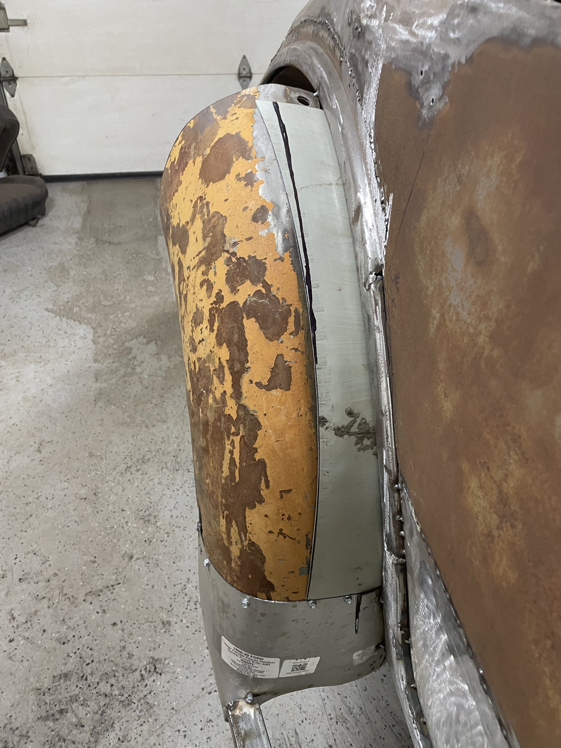

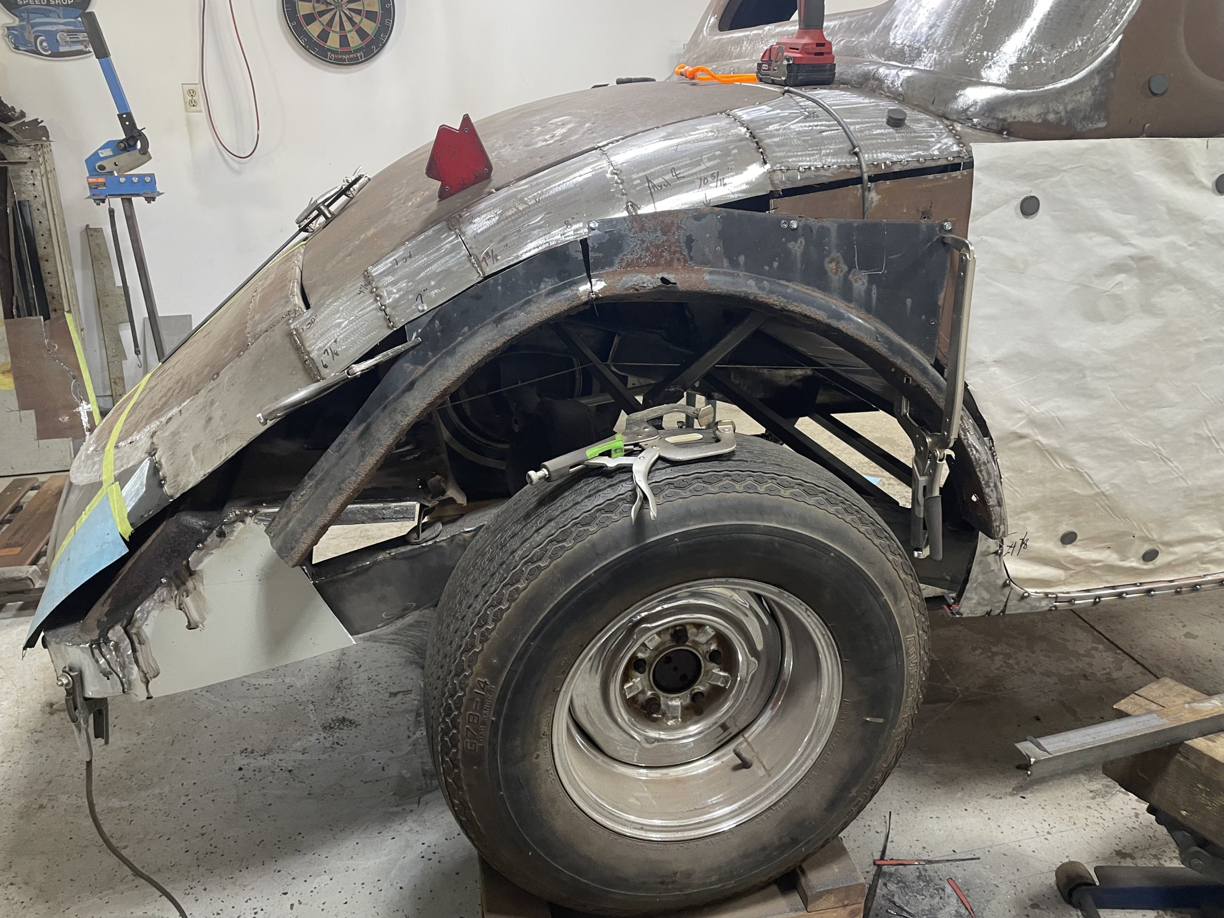

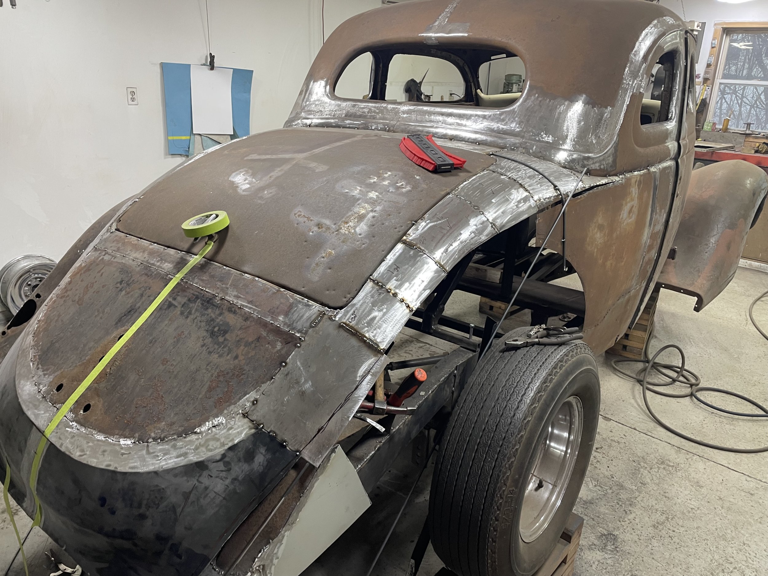

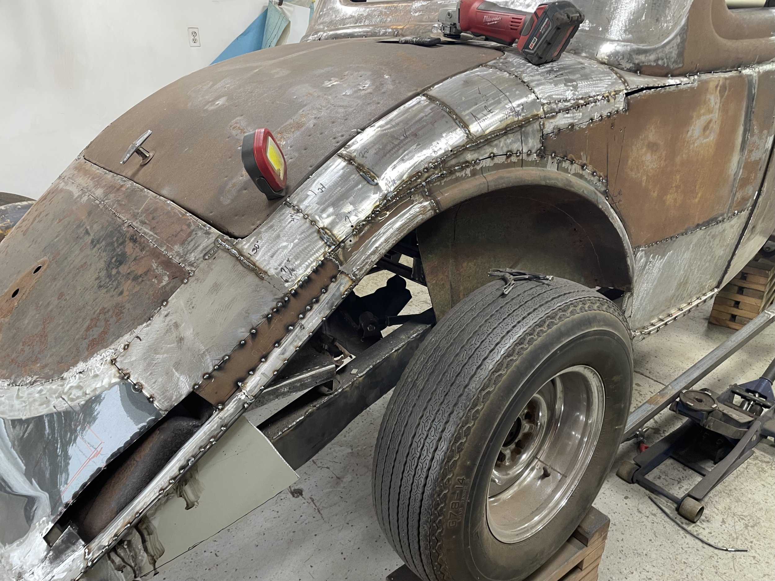

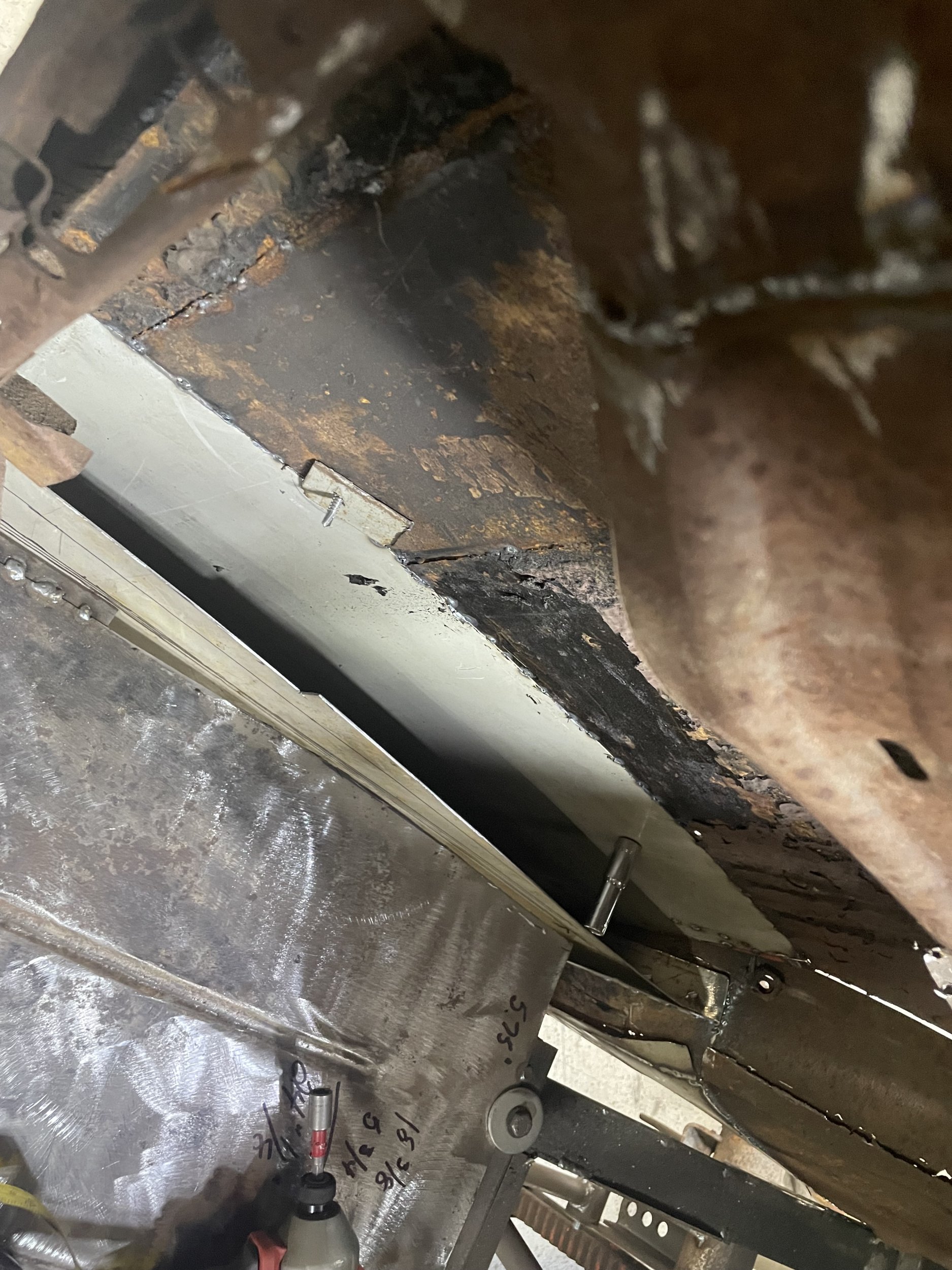

    Update for those following along . She’s staring to get a fat *** . Also starting to tie in p***enger side inner wheel well . Stay tuned more to come

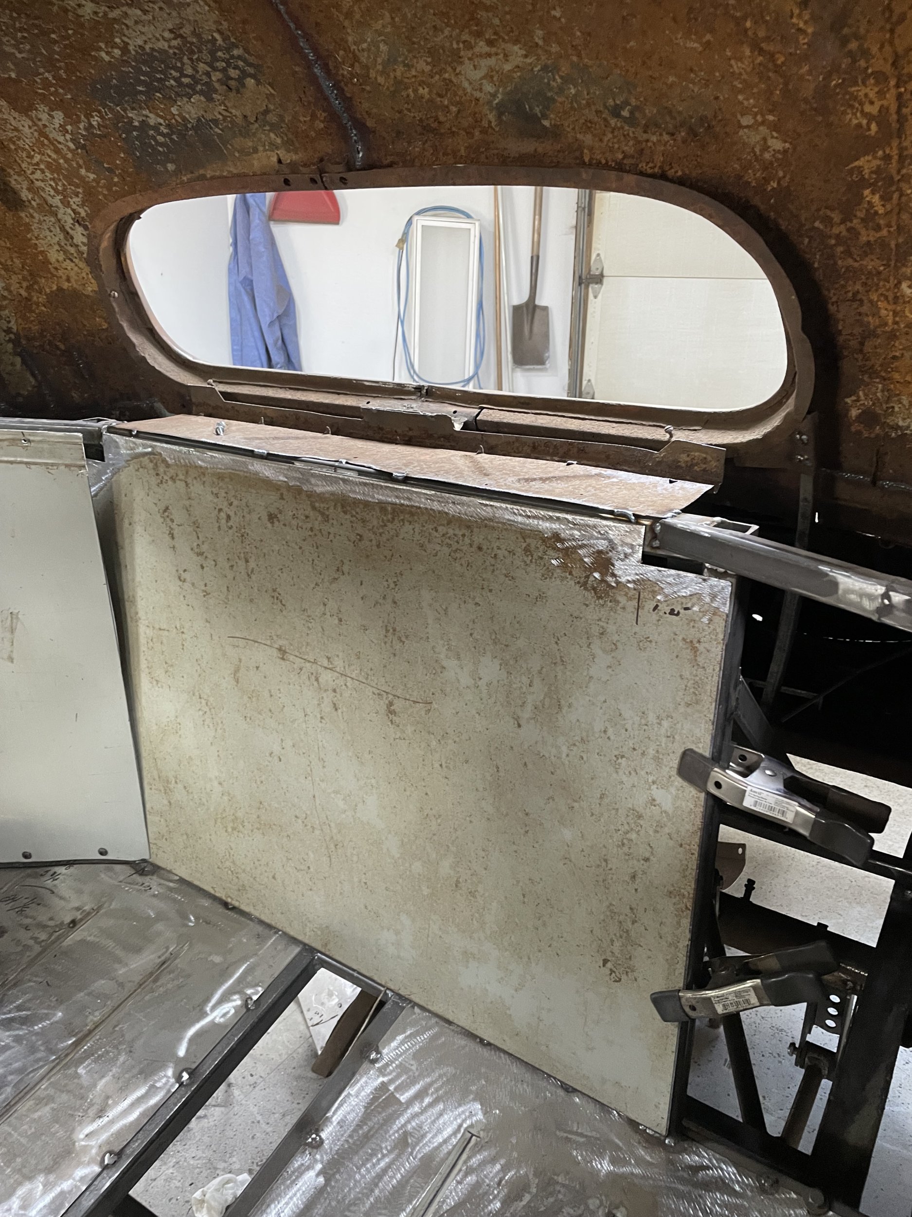

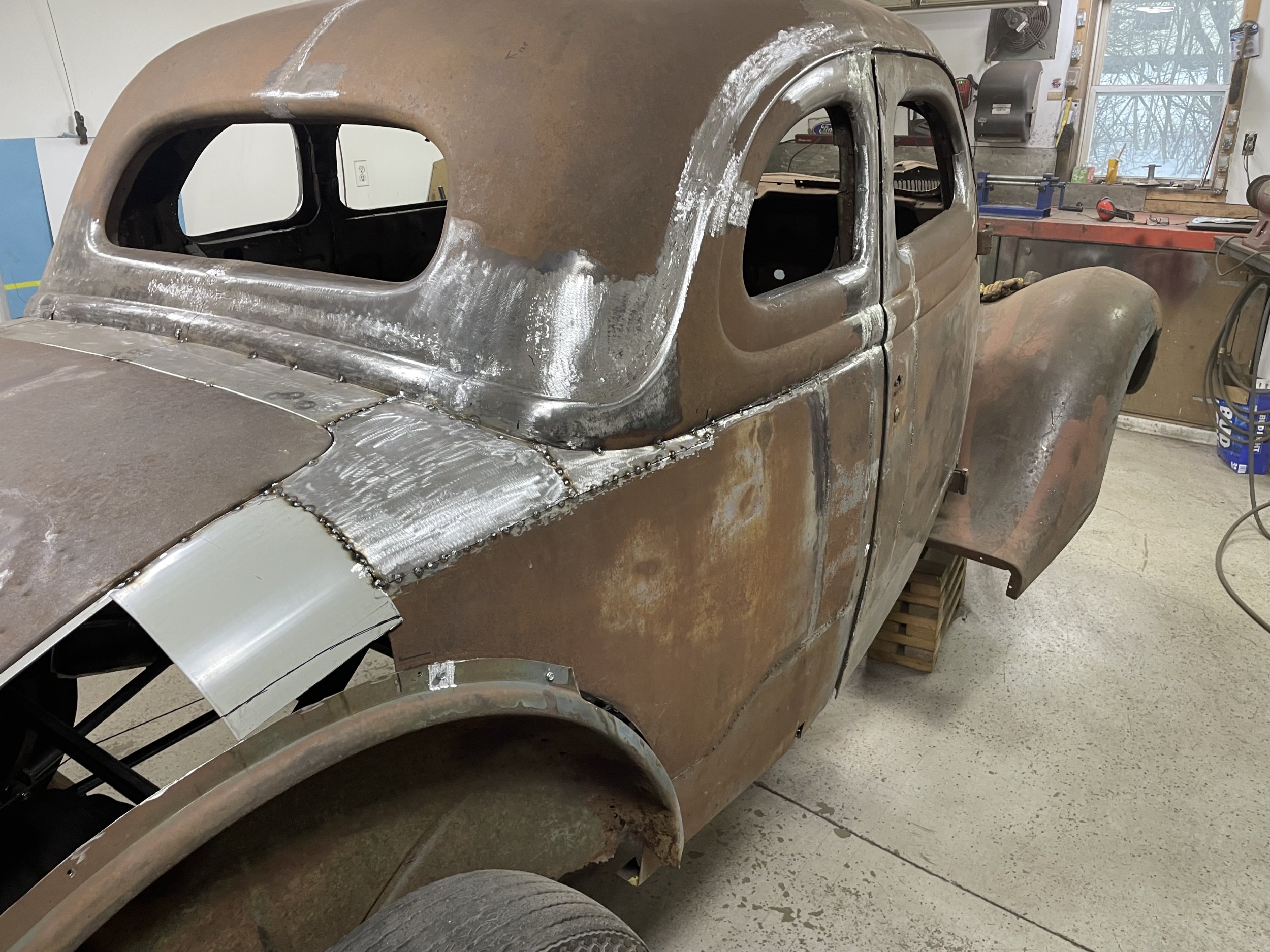

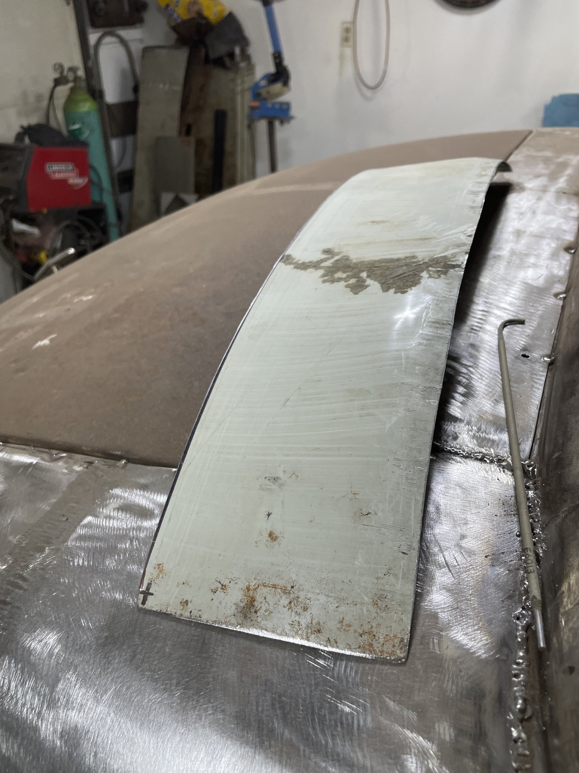

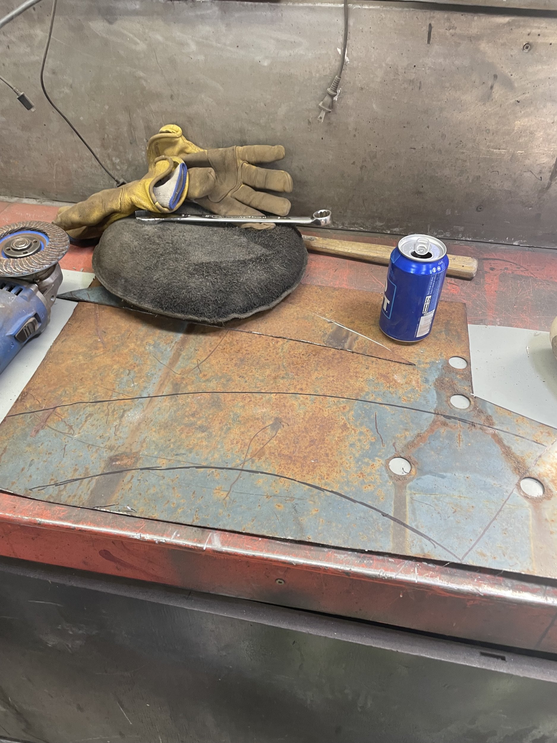

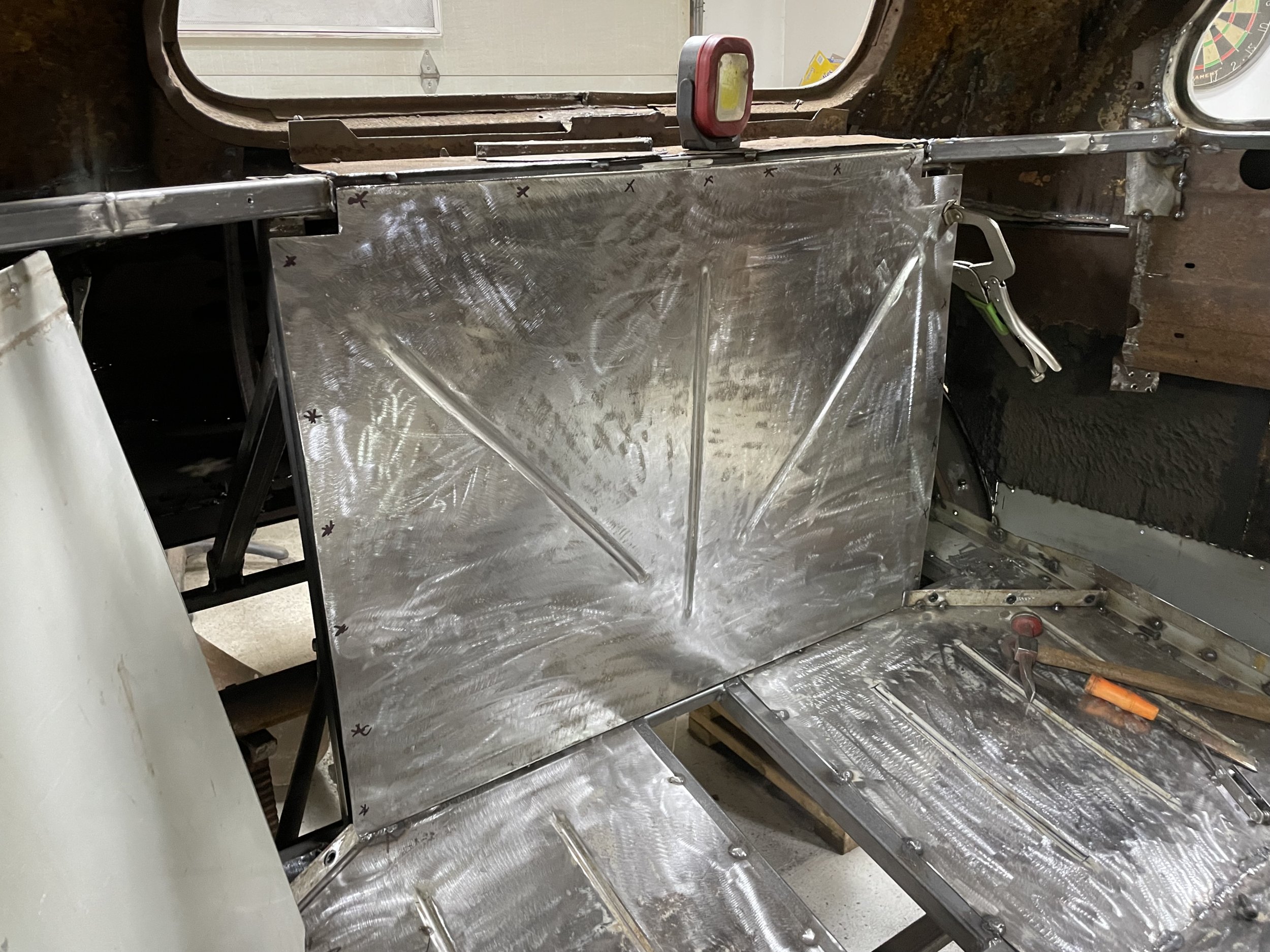

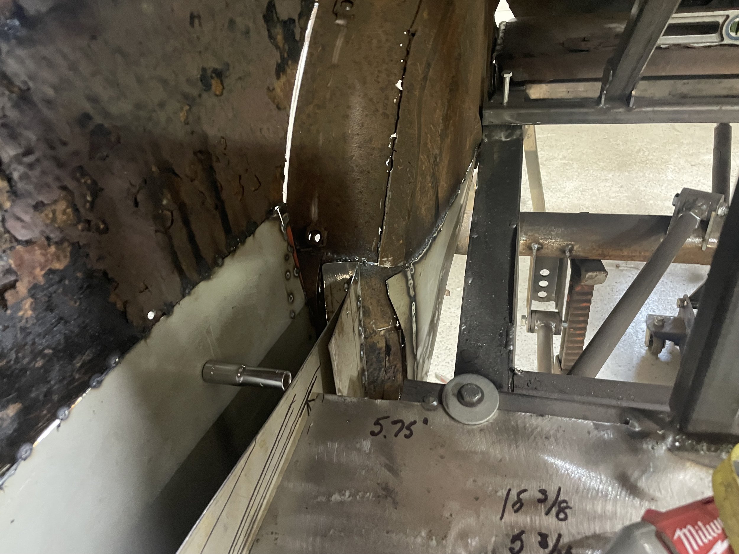

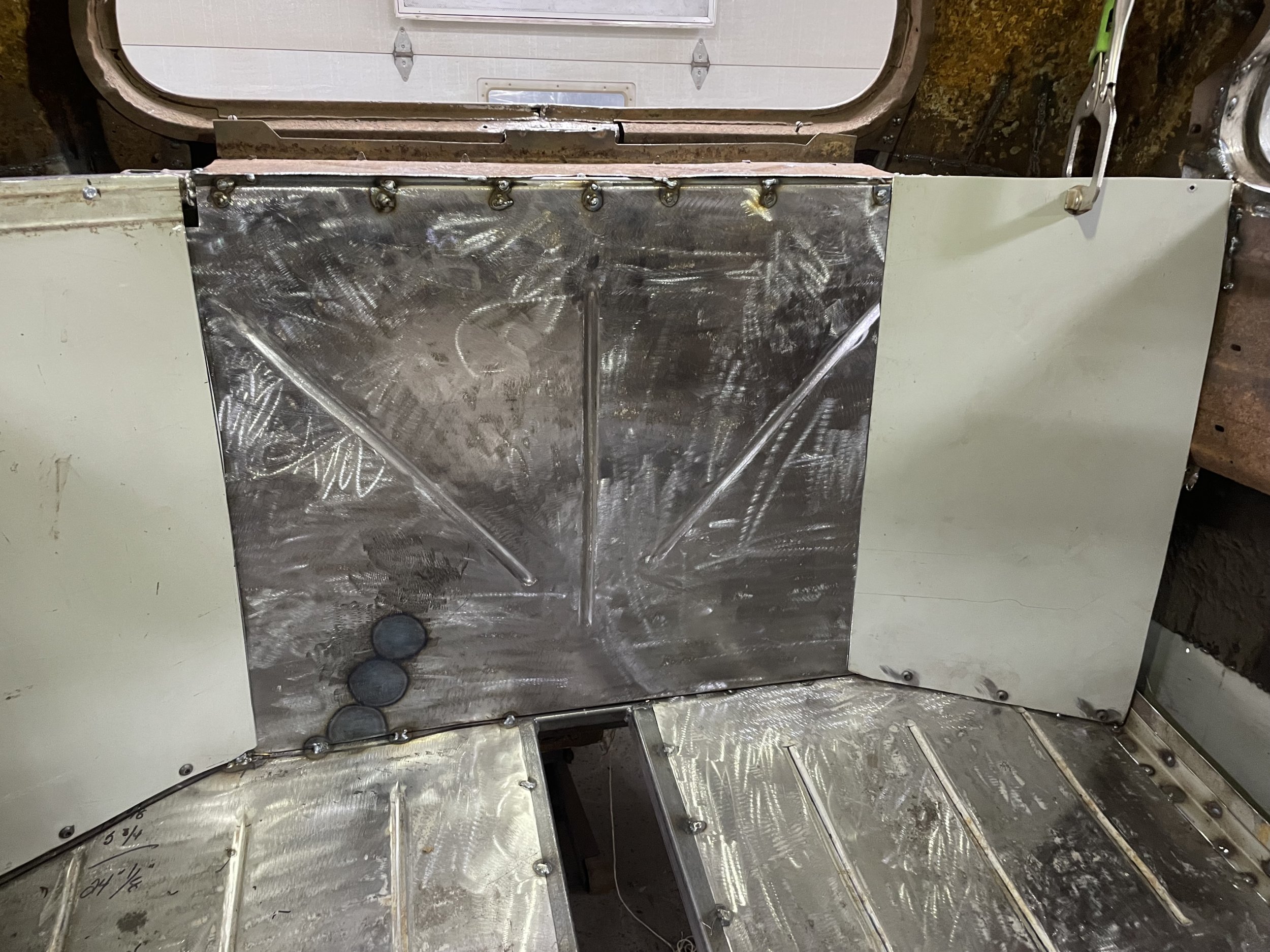

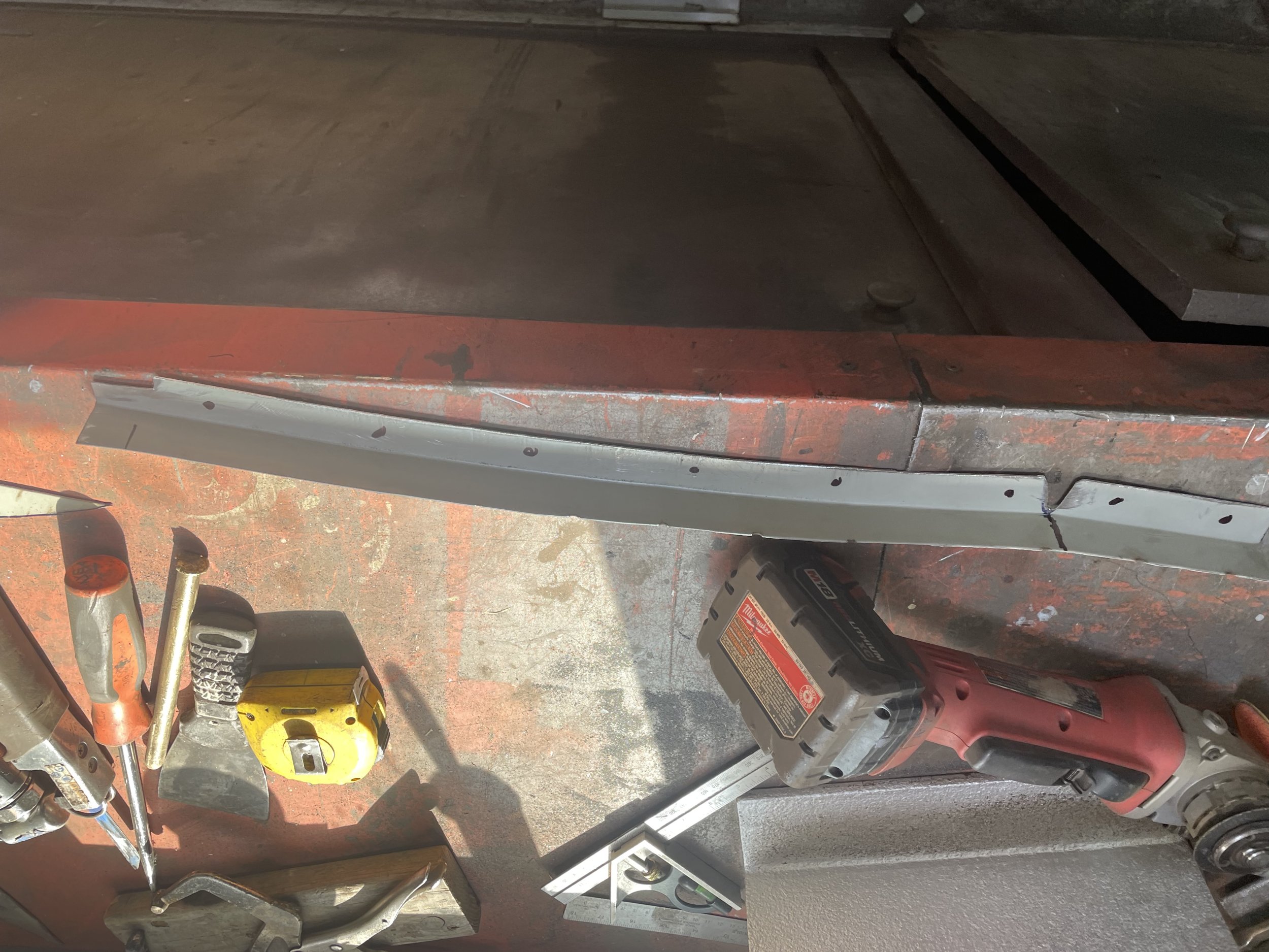

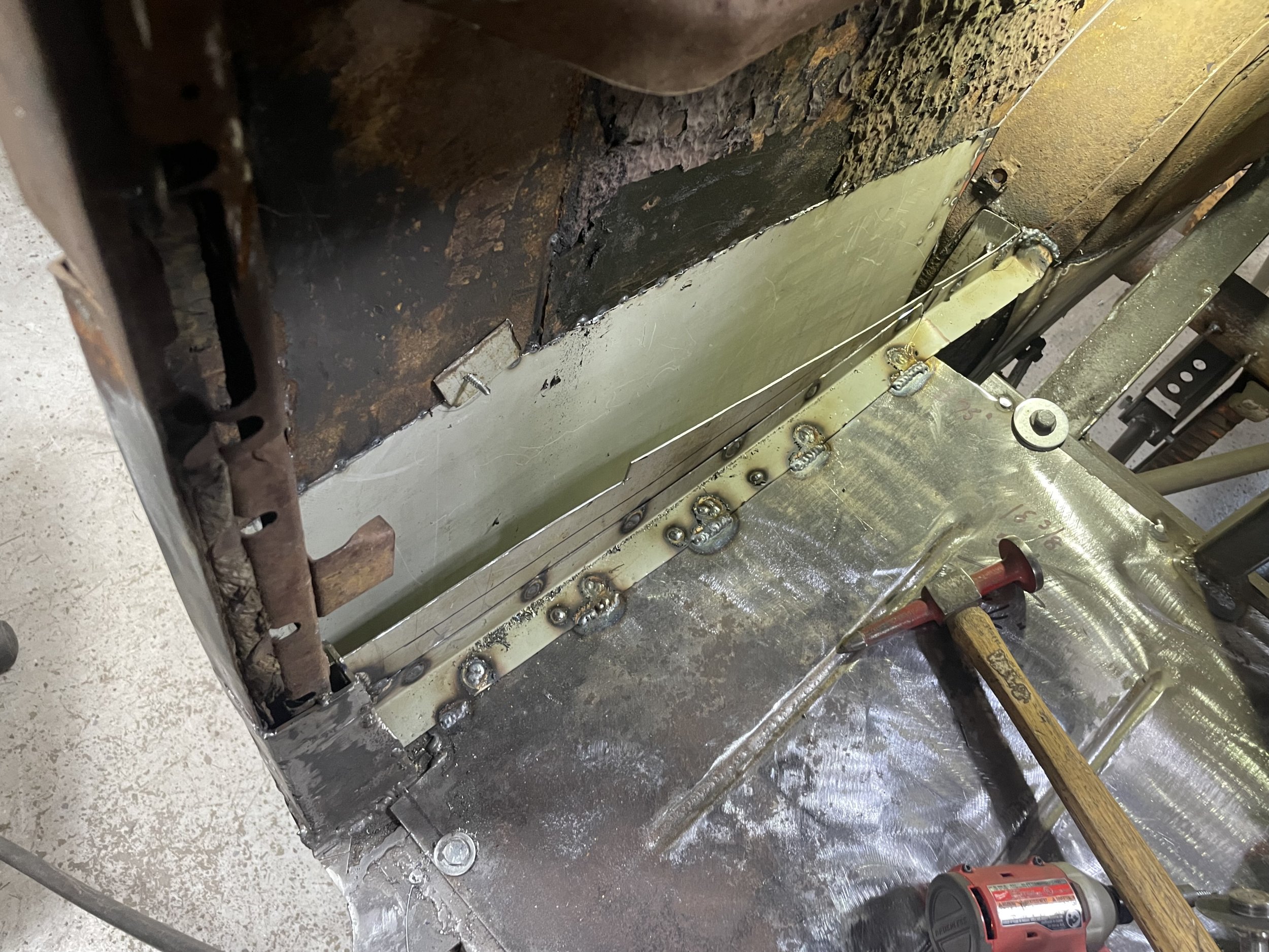

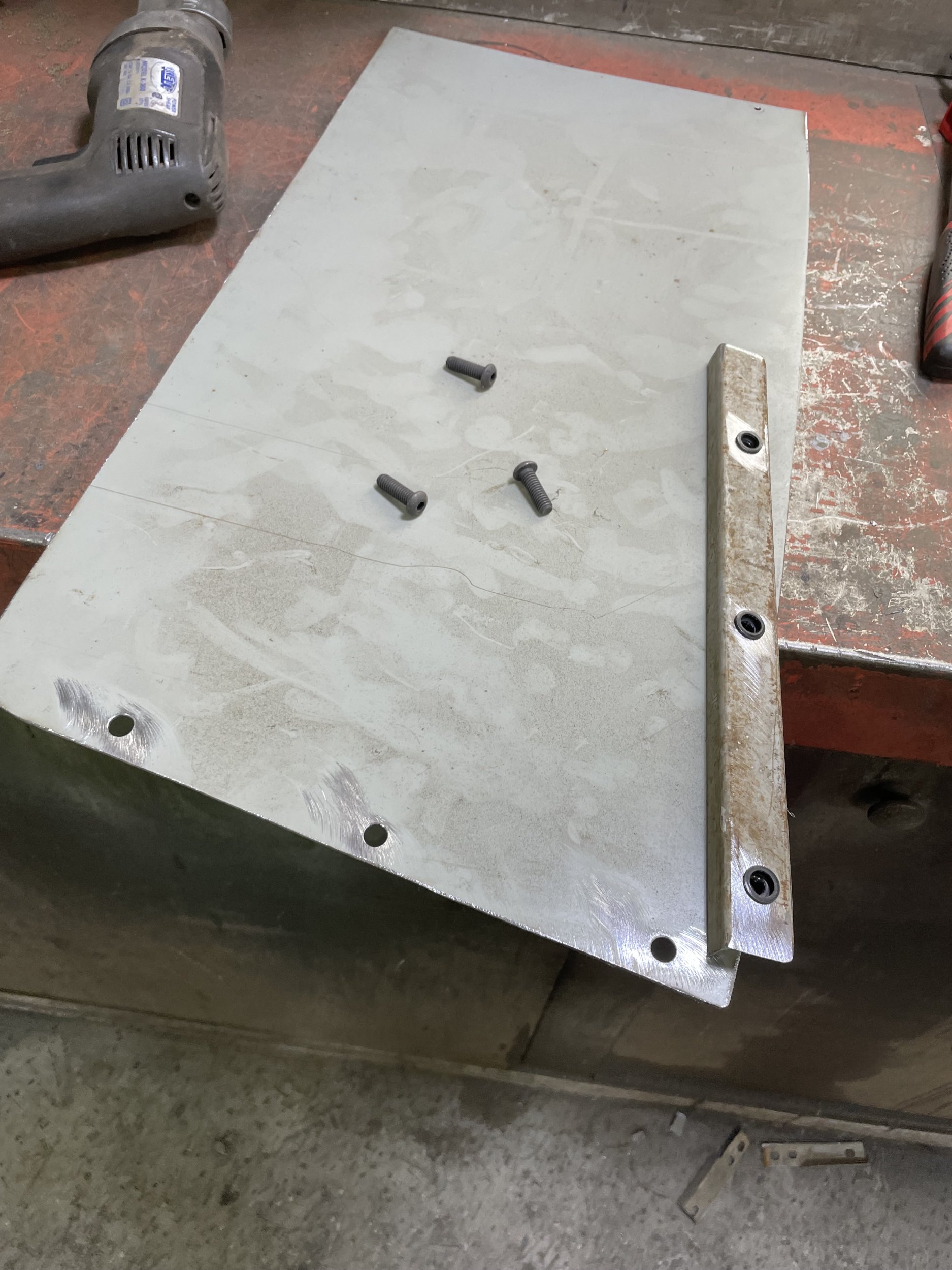

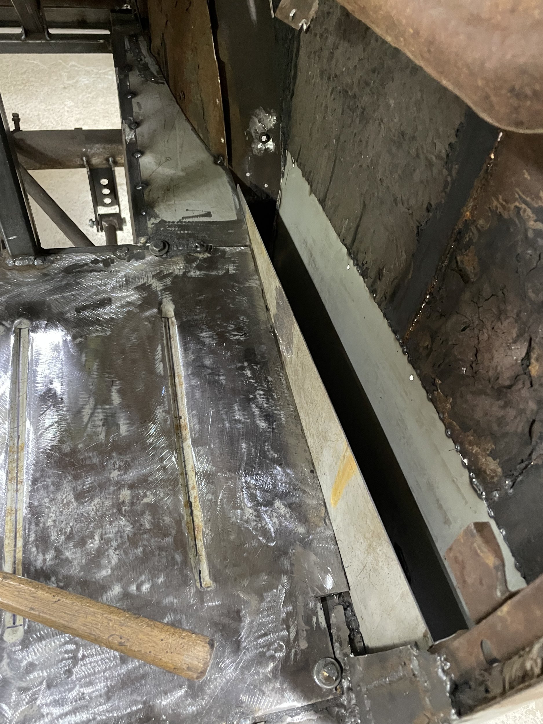

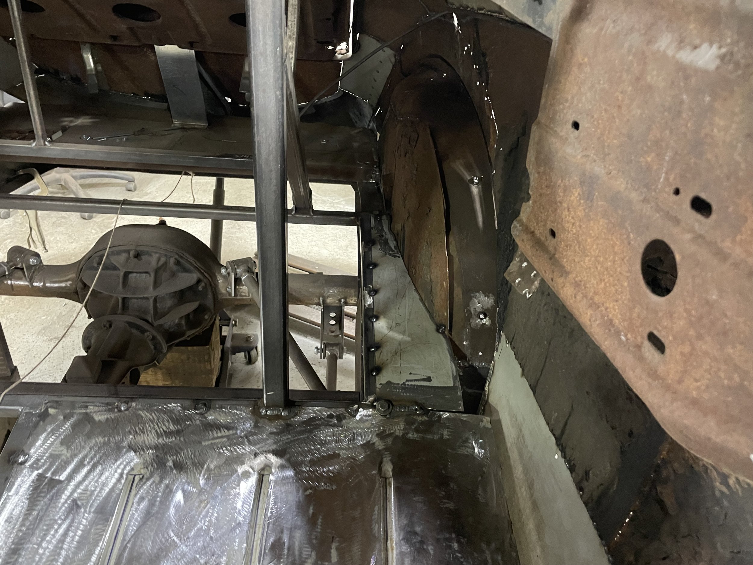

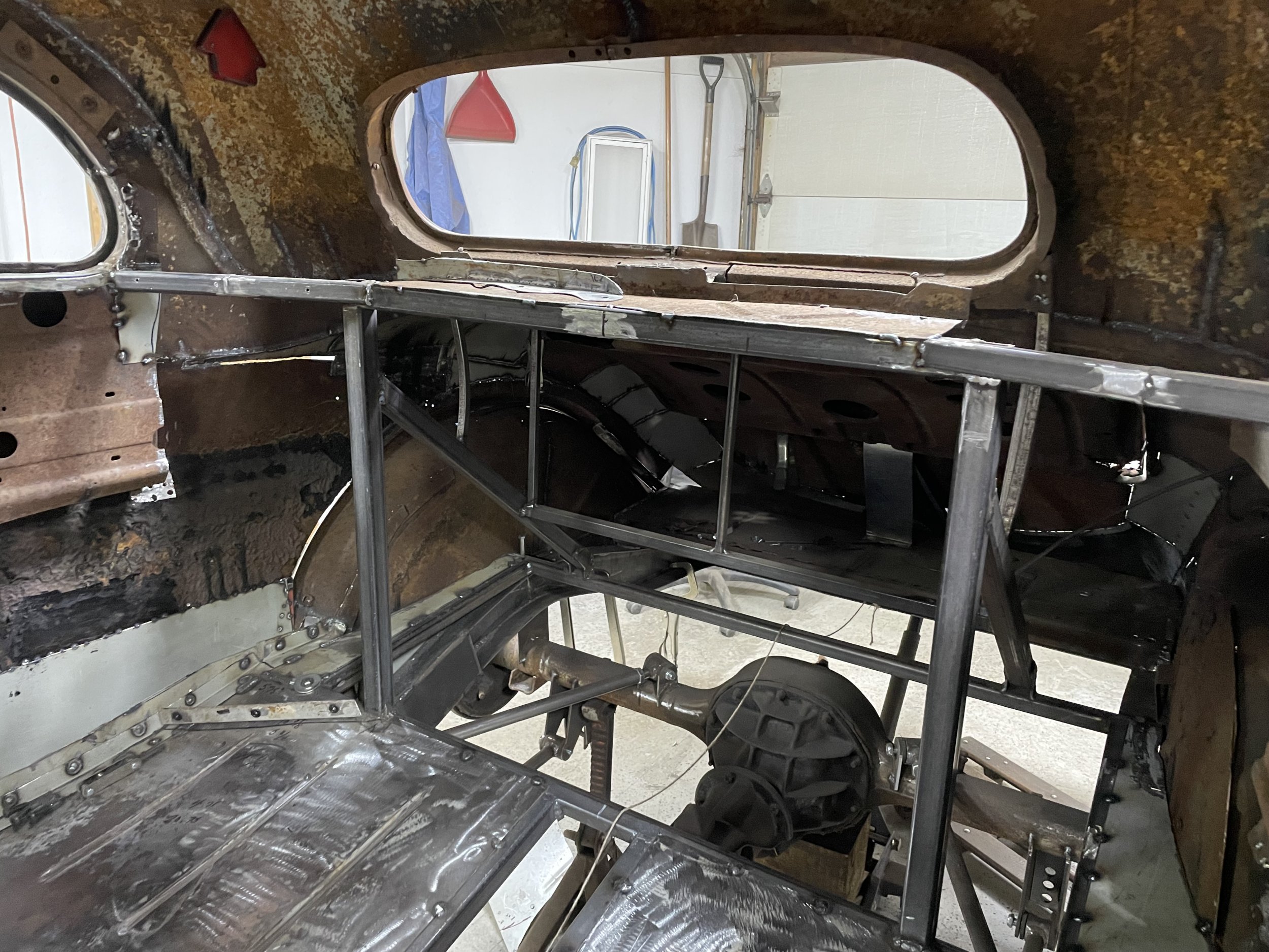

    Some more progress . First few pictures are of the quarter panel tie in along with the front part of wheel arch . Hard to tell what you’re looking at I know but look long enough you’ll figure it out LOL Next pics are of the rear bulkhead framework . I installed the rear parcel shelf , welded in the main centre section of the bulkhead and temporarily installed the left and right panels . Have a look !

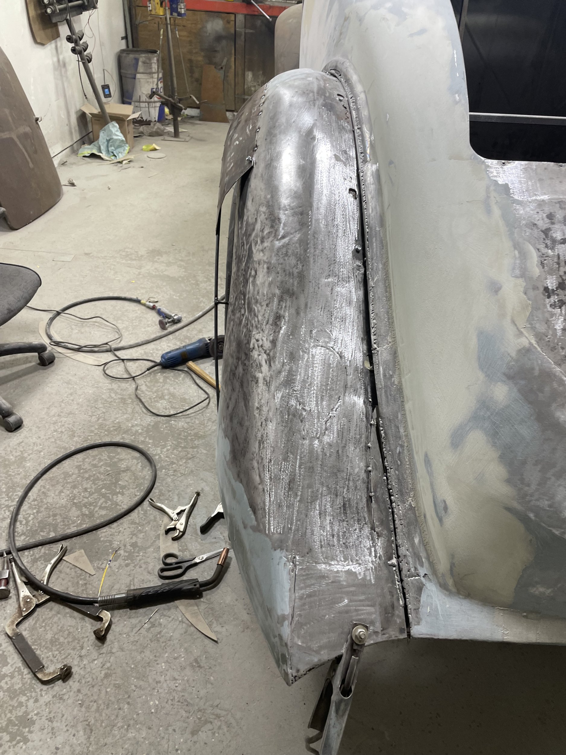

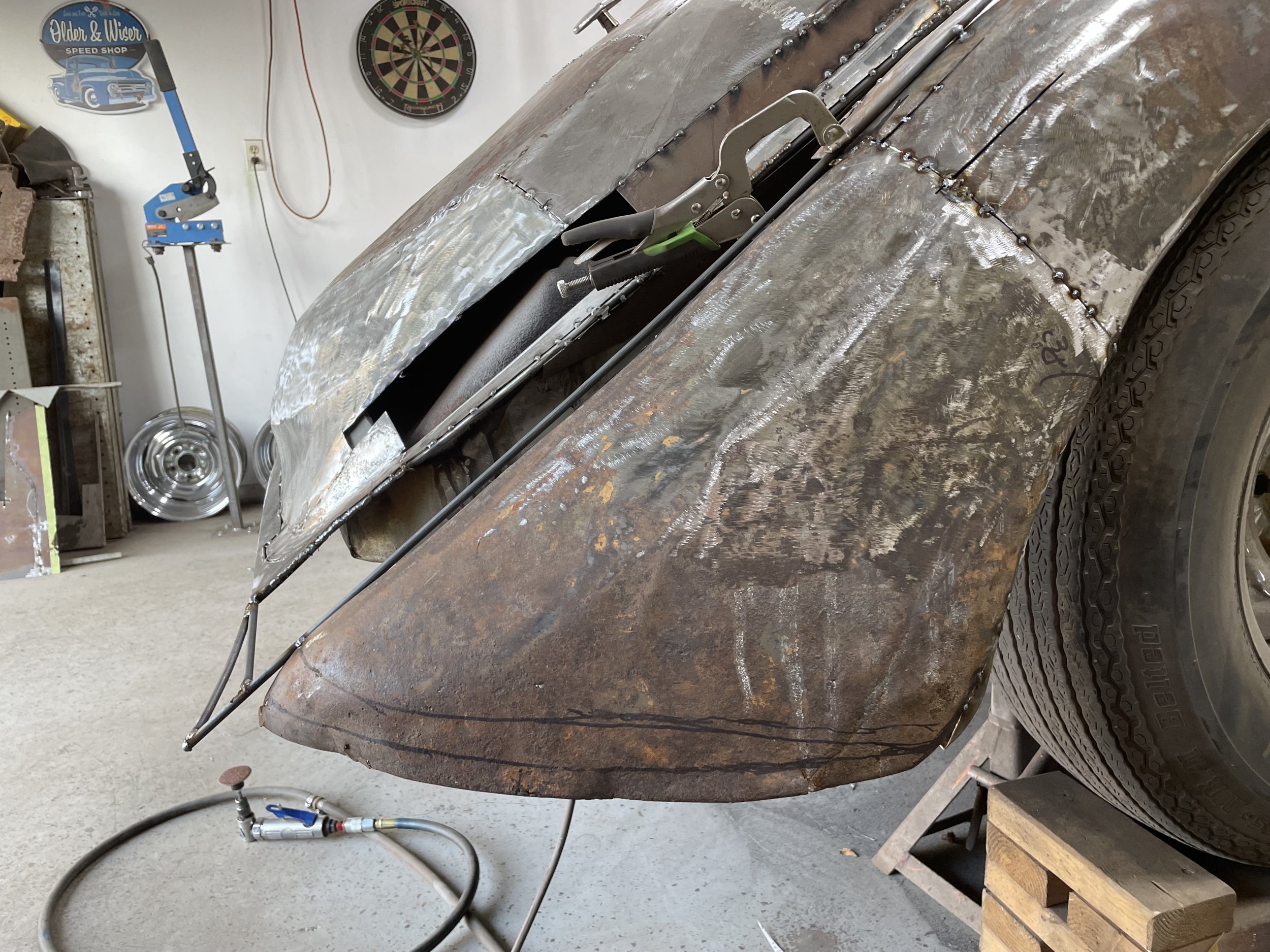

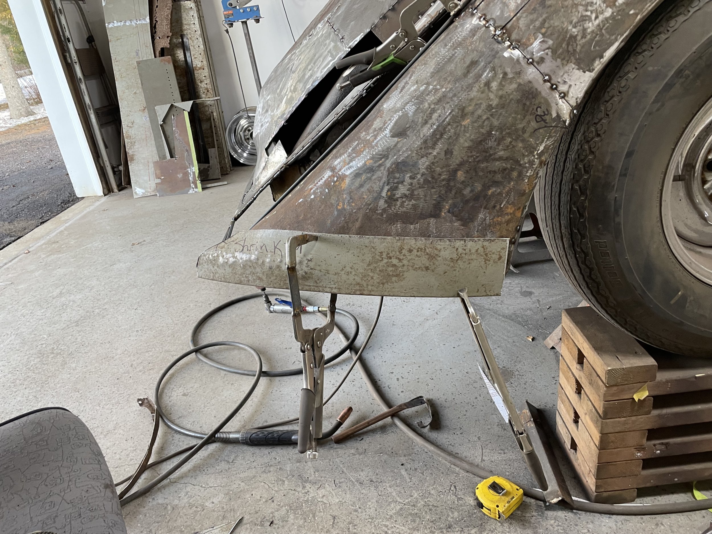

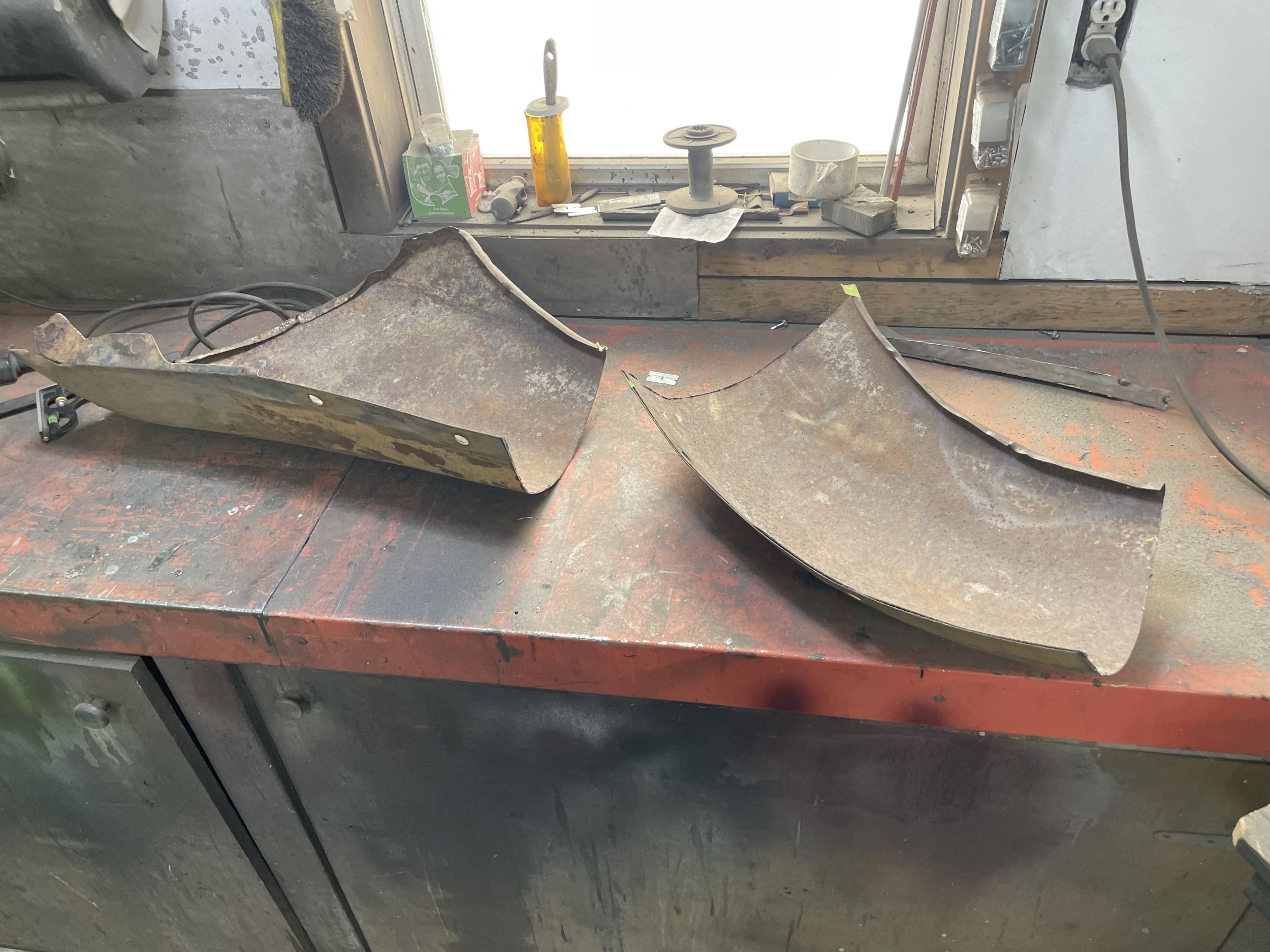

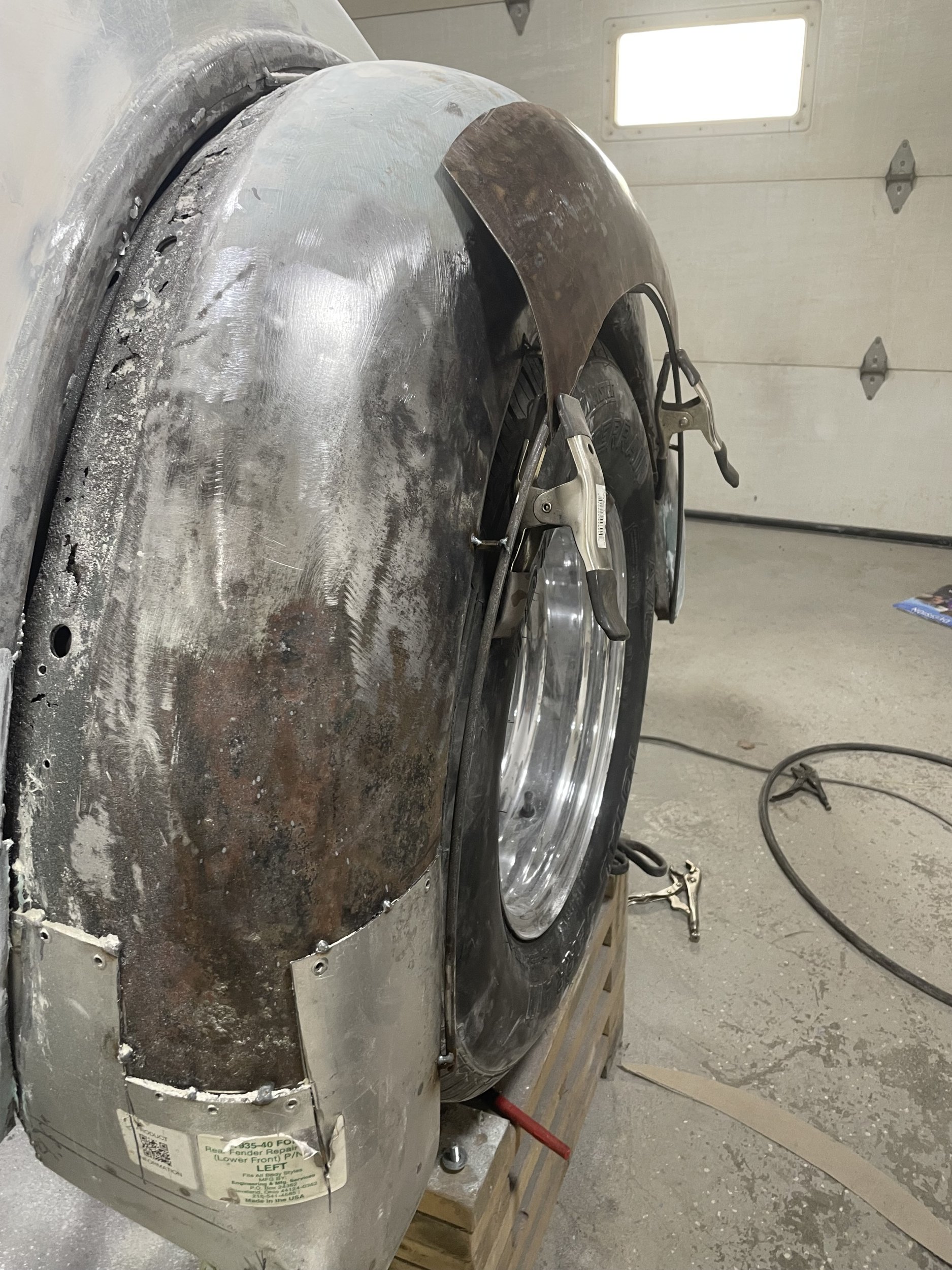

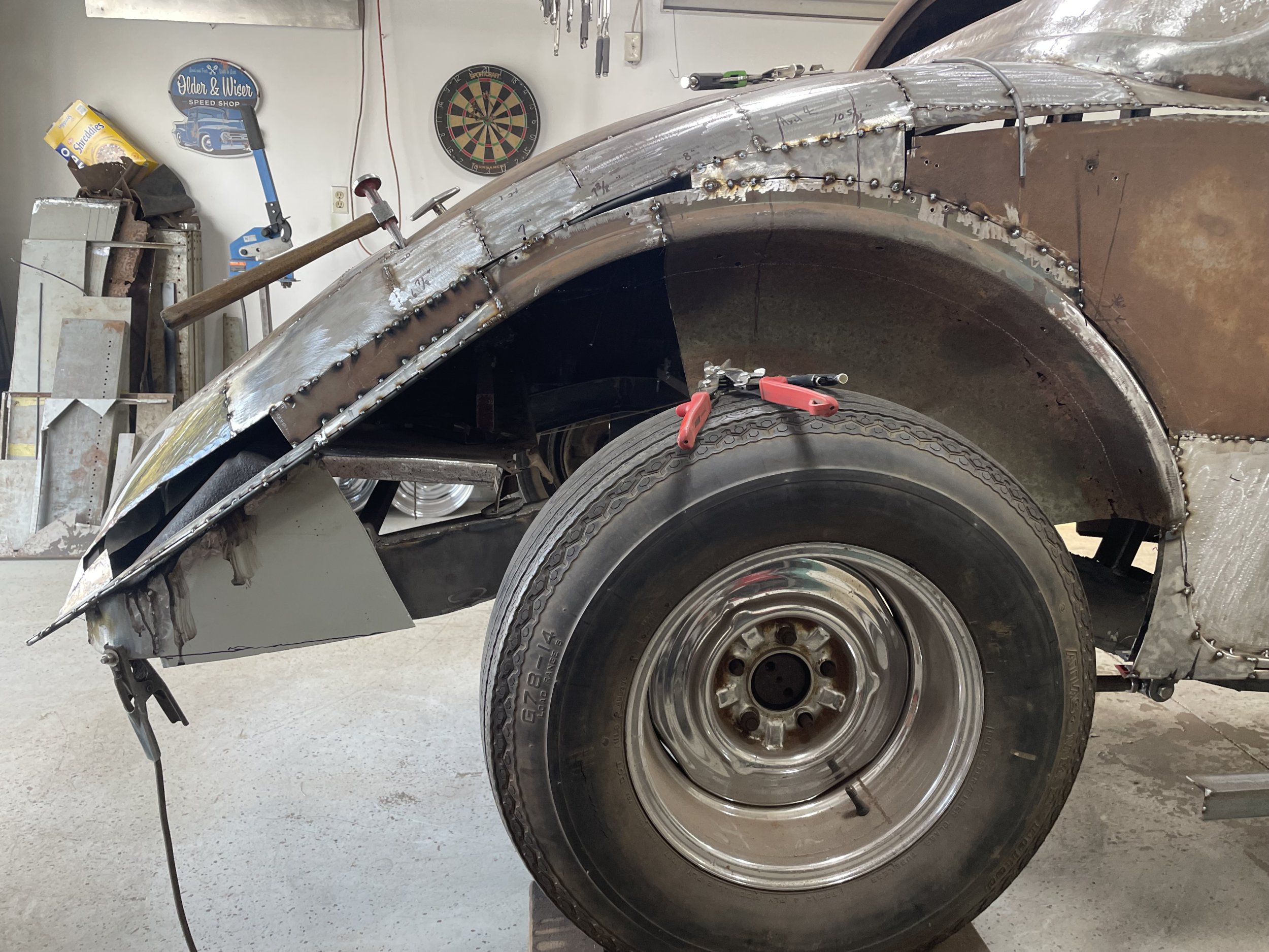

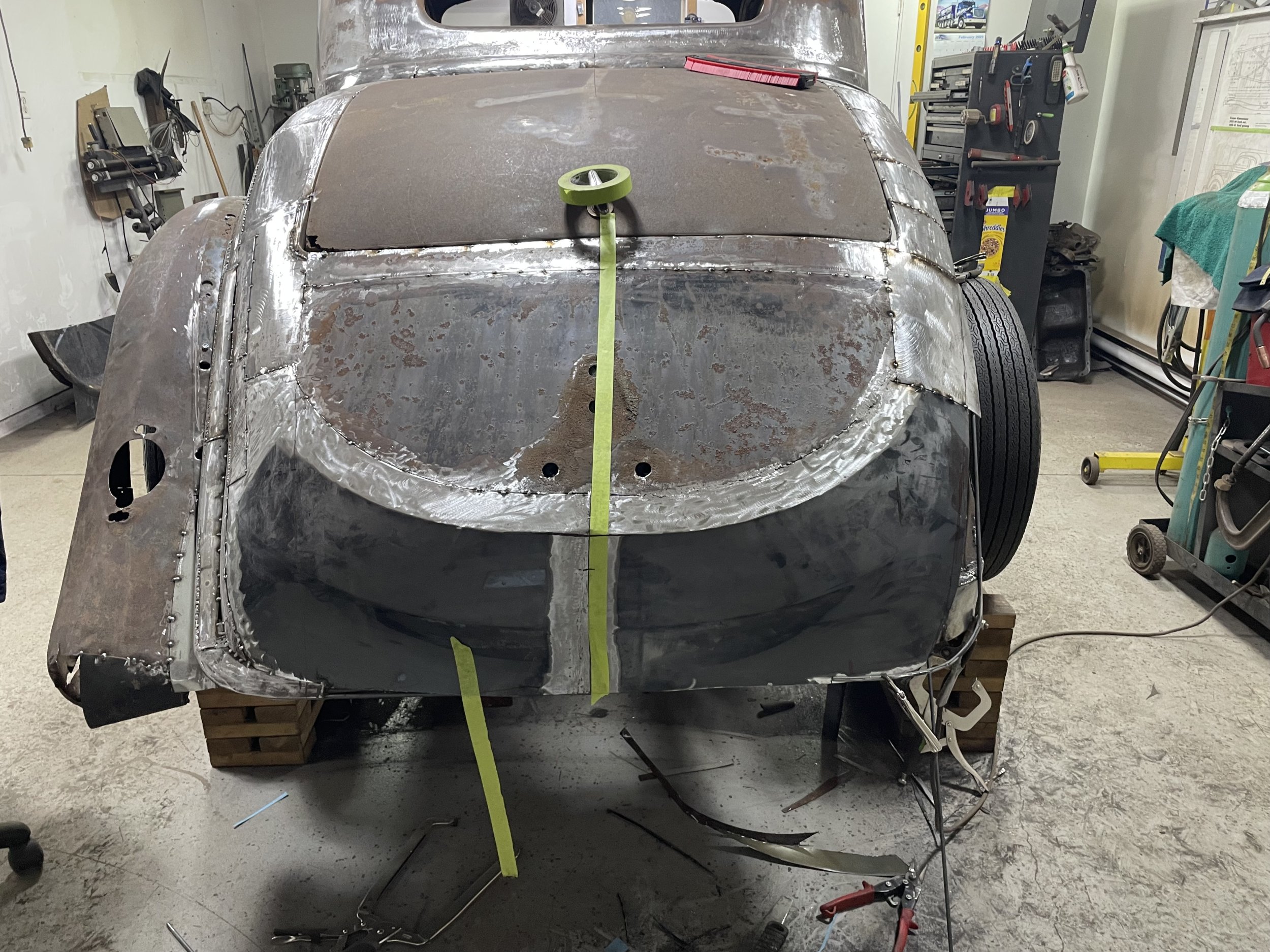

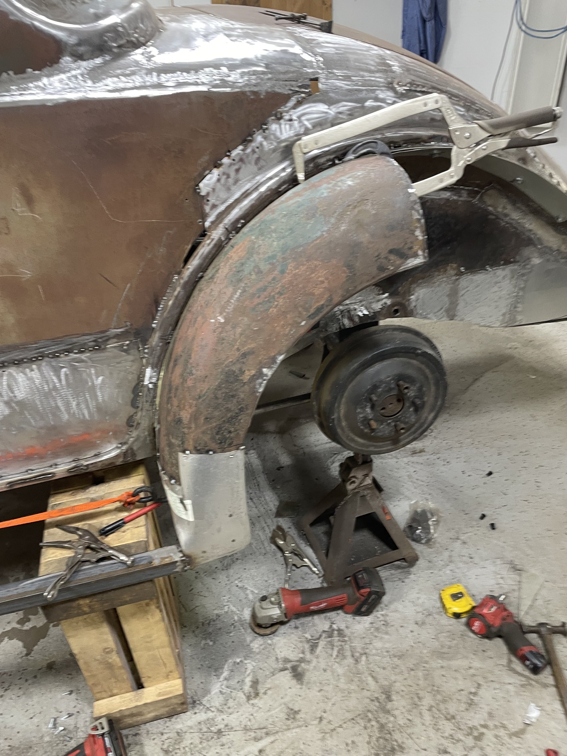

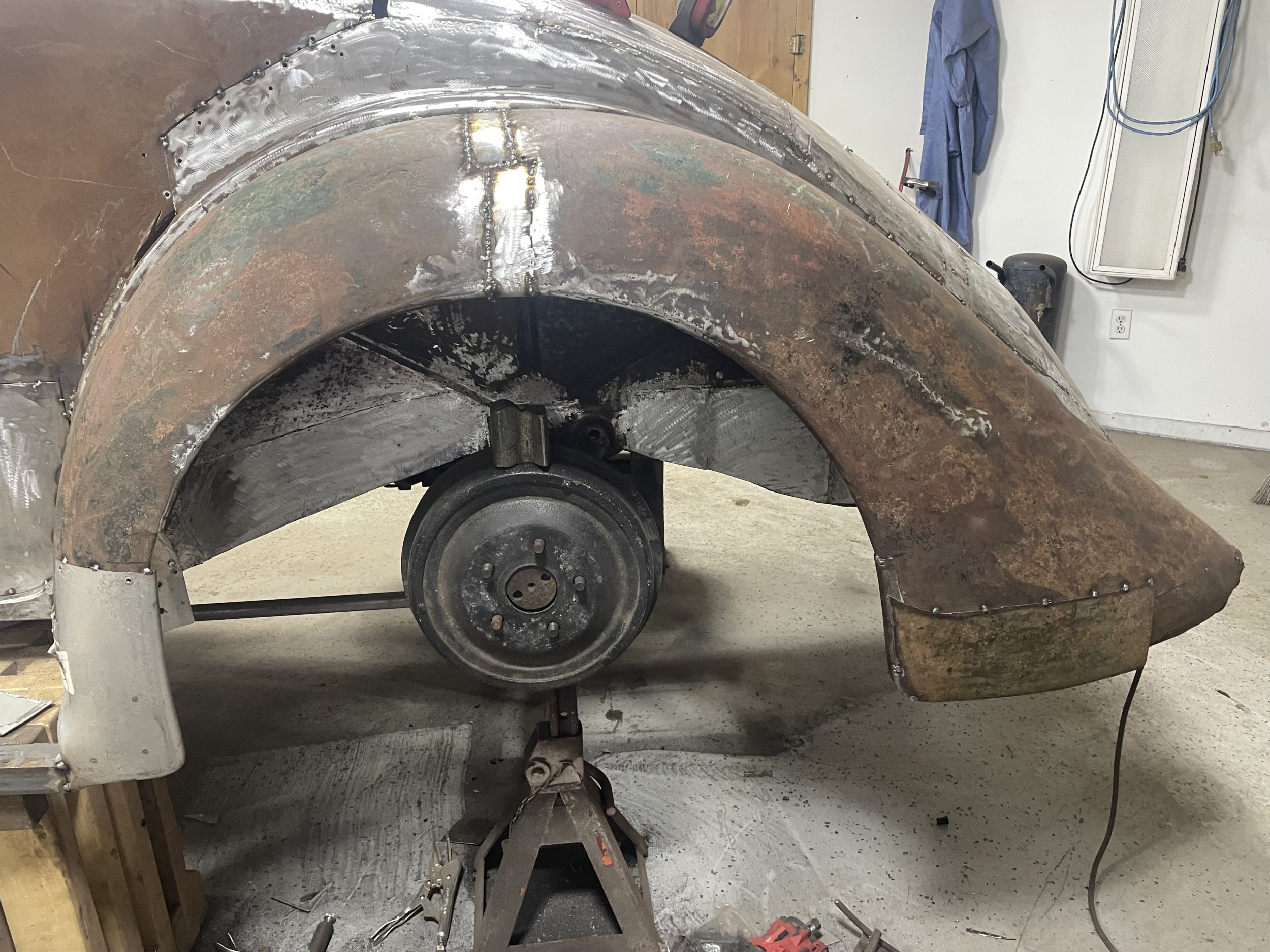

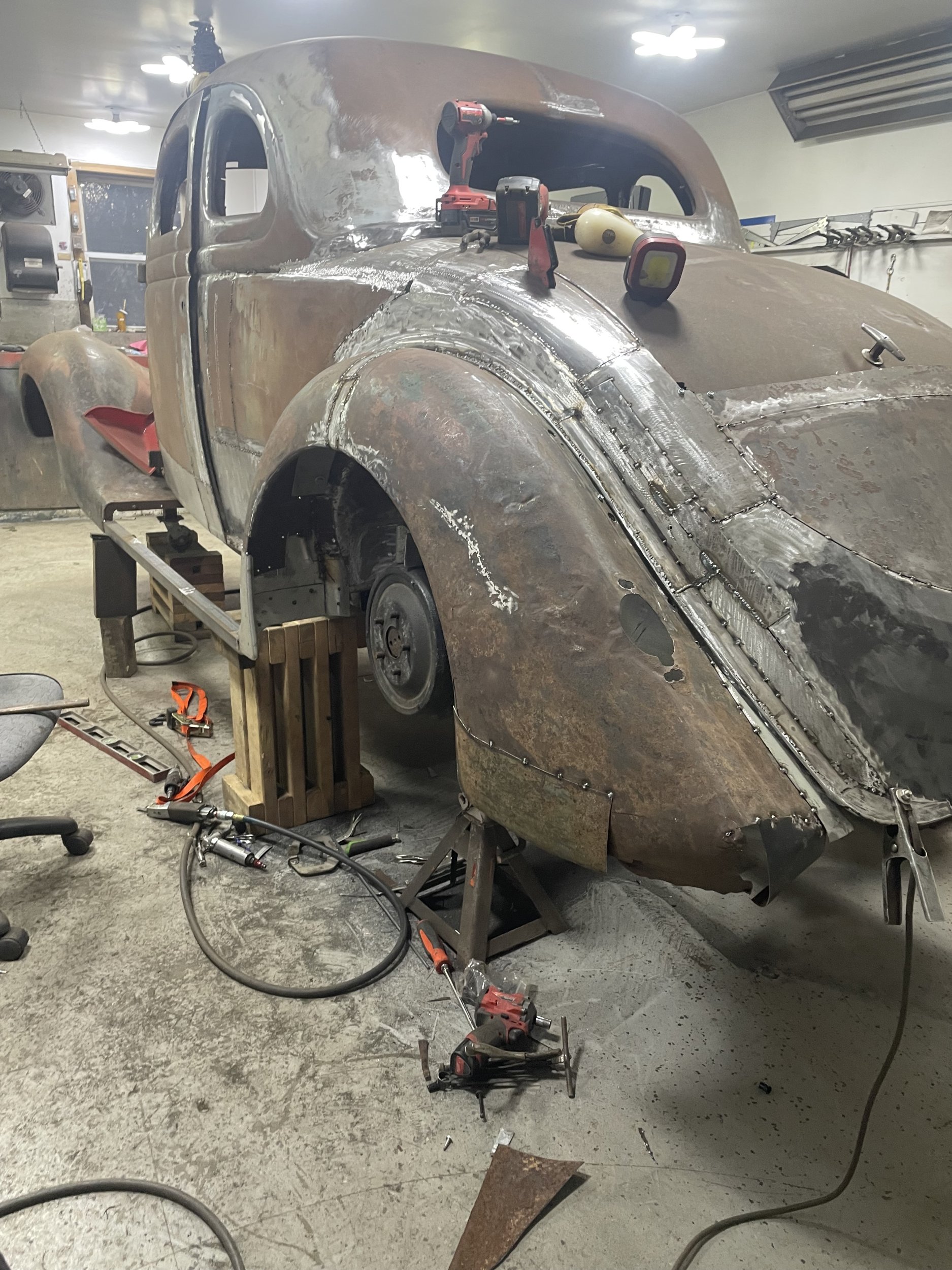

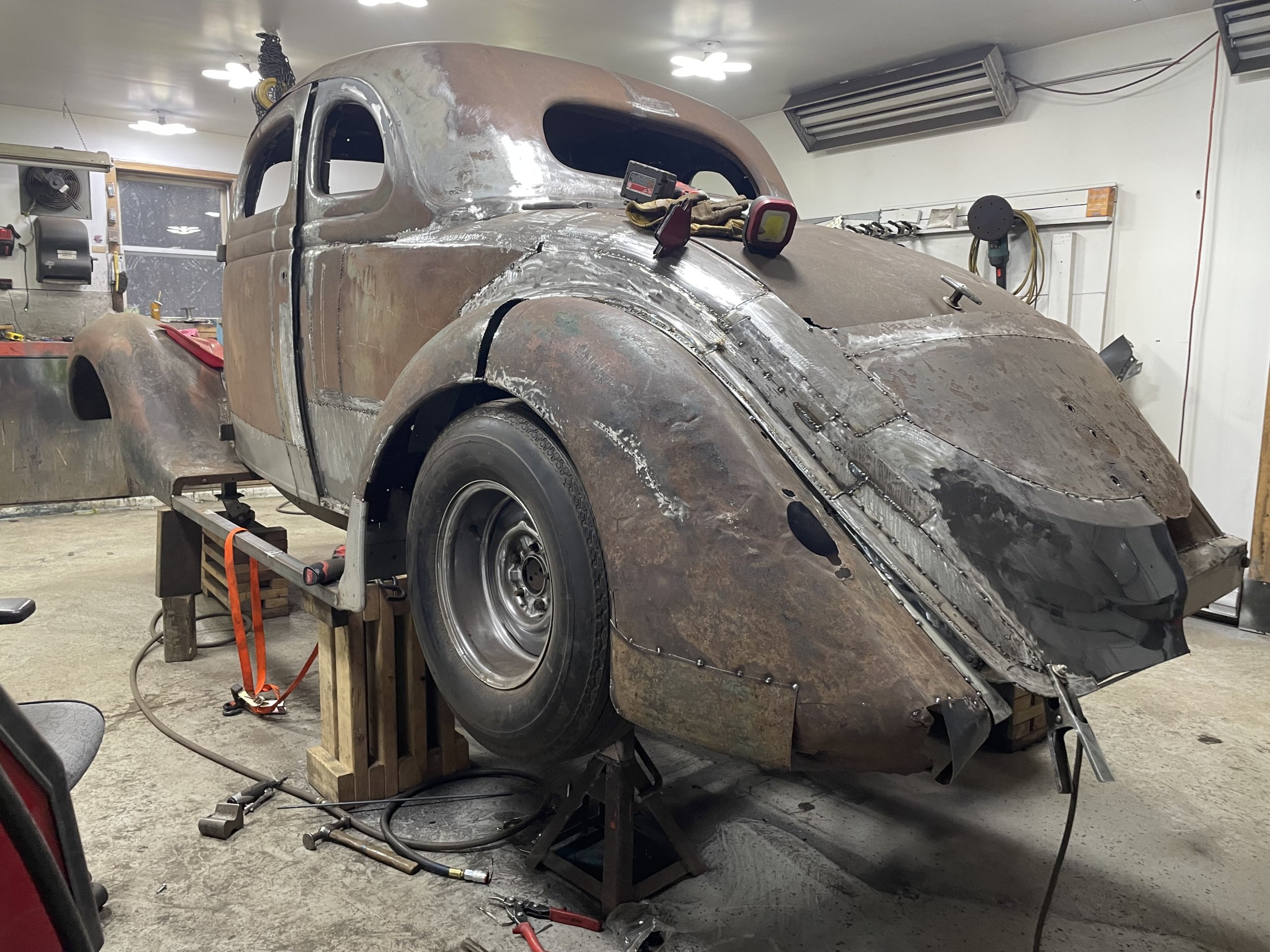

    So here I am in the thick of it now . This rear right fender must be off a 37-40 ford as it don’t fit for s**t . Very fast arc to the profile . So cut,cut,cut it all apart and s***ch it all back together .

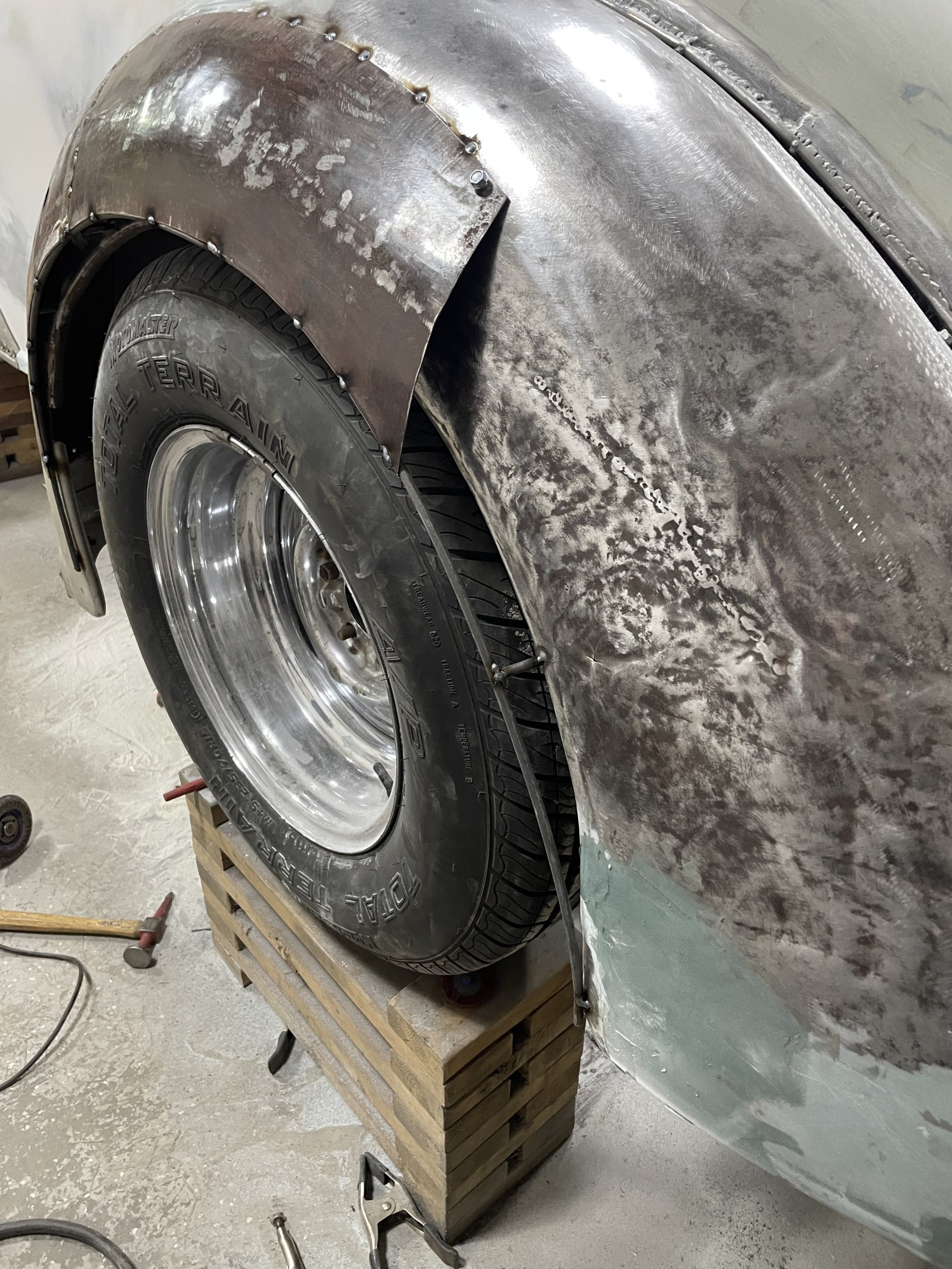

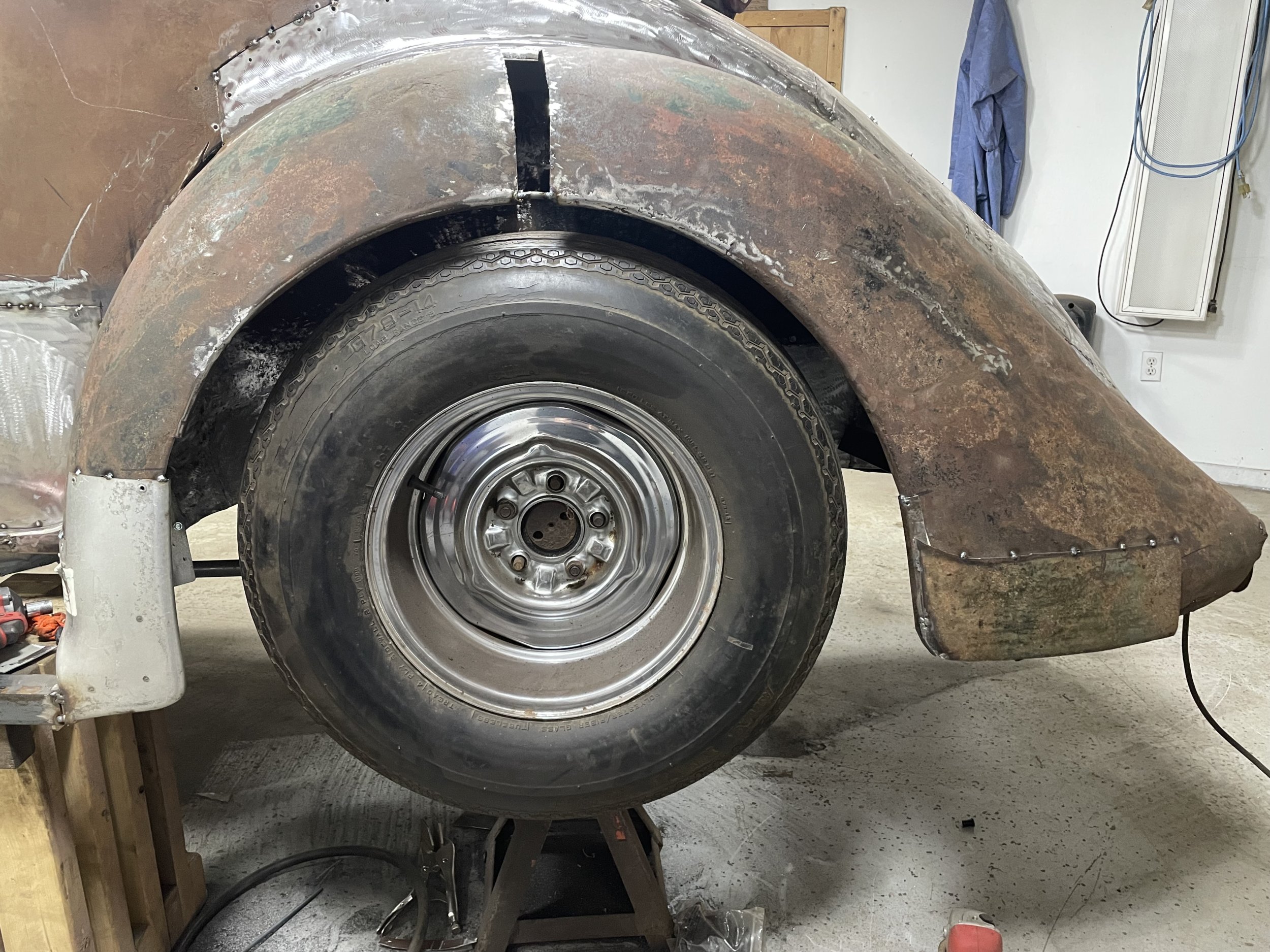

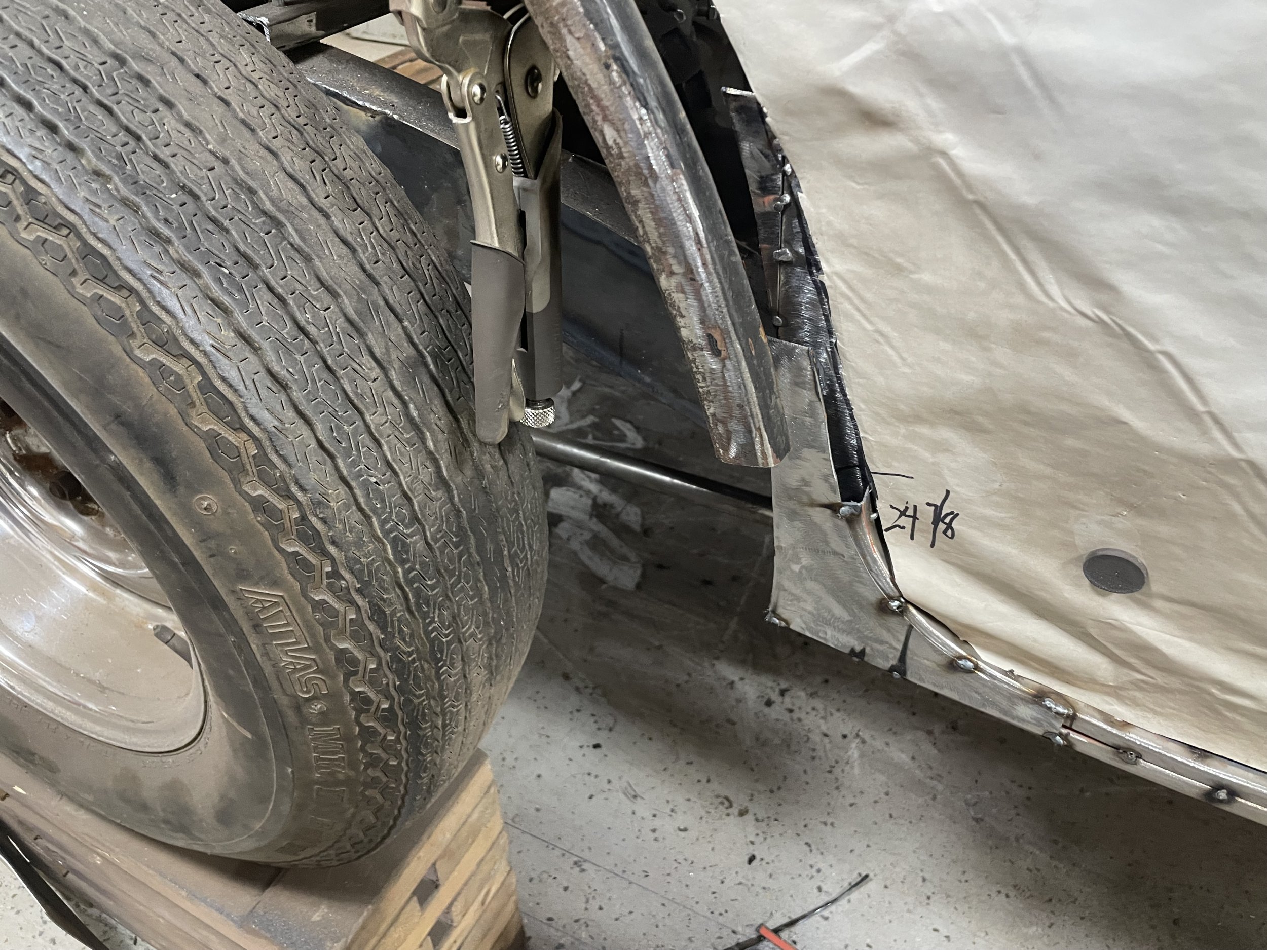

    IMG_1636.jpeg 9F8D5DD9-ECCB-4069-B9EF-AFB0C545E99B.jpeg IMG_1653.jpeg IMG_1654.jpeg IMG_1656.jpeg IMG_1657.jpeg IMG_1658.jpeg IMG_1659.jpeg IMG_1660.jpeg

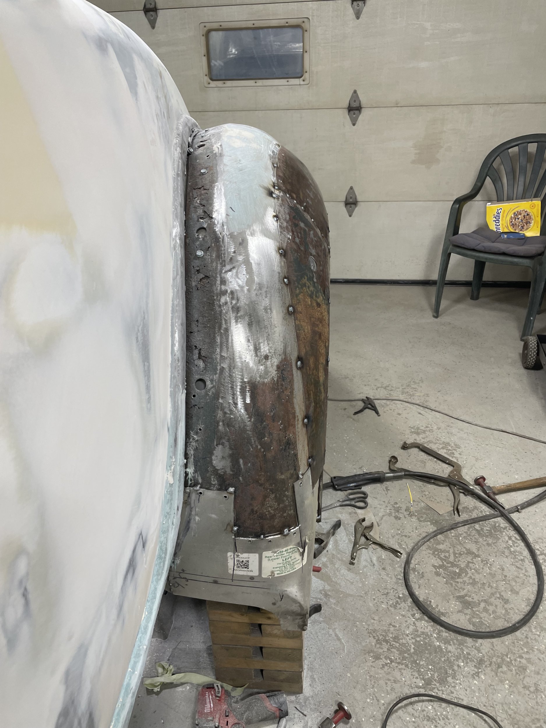

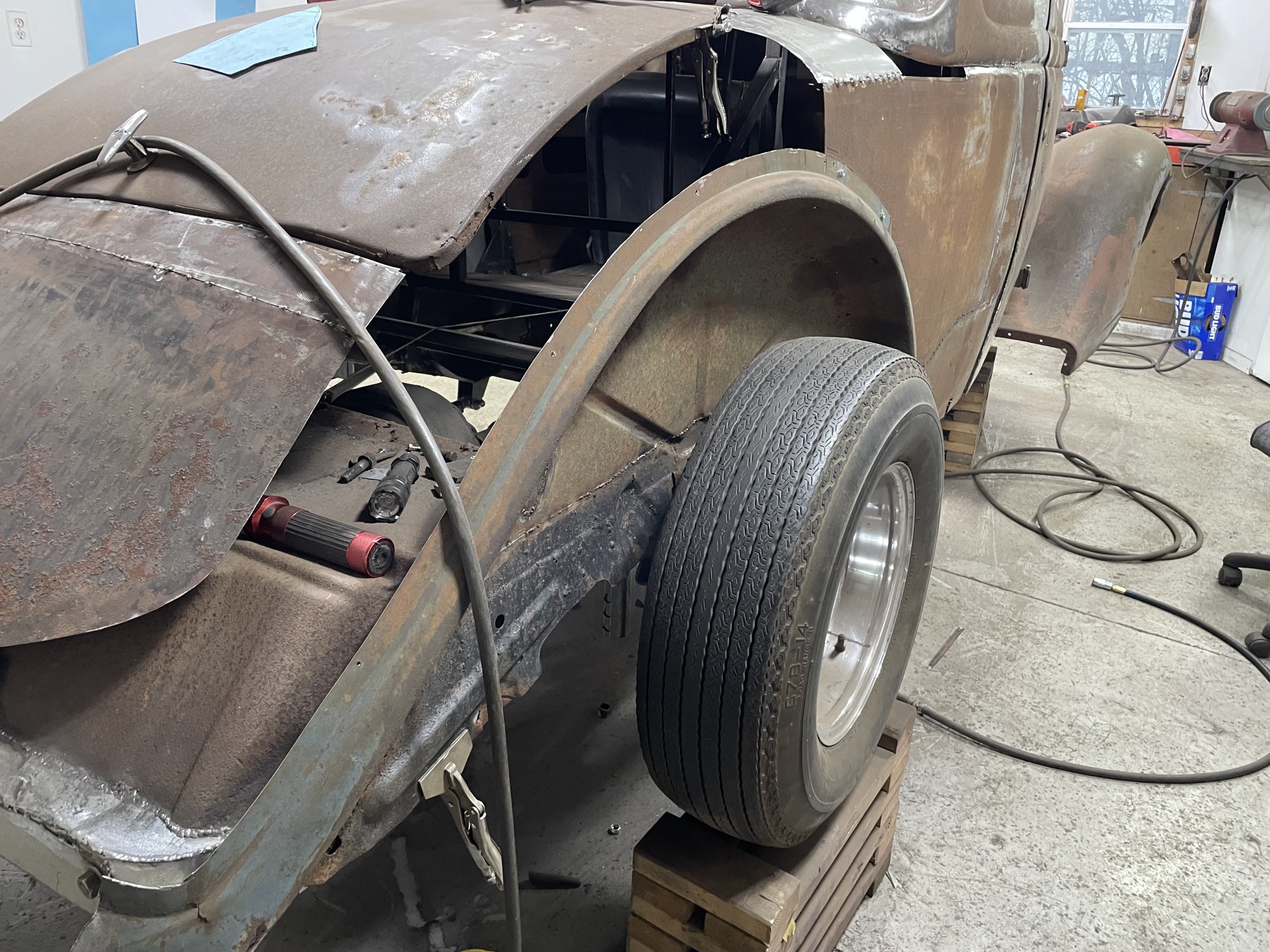

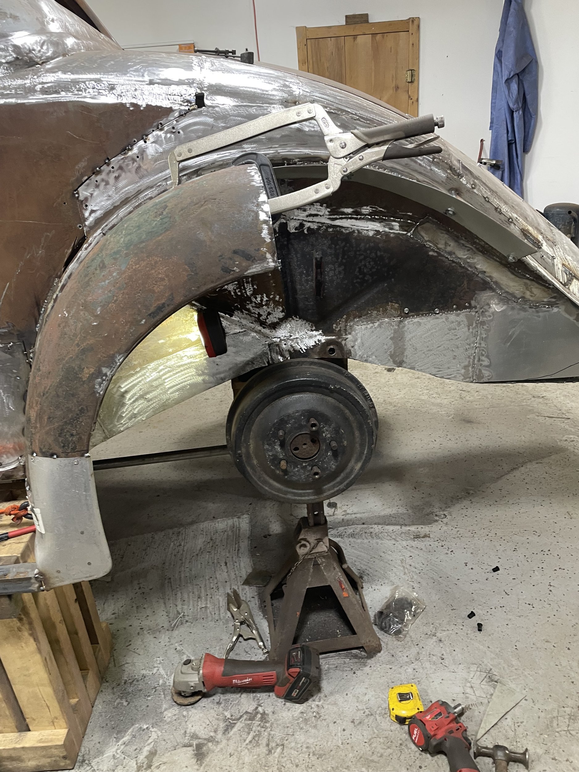

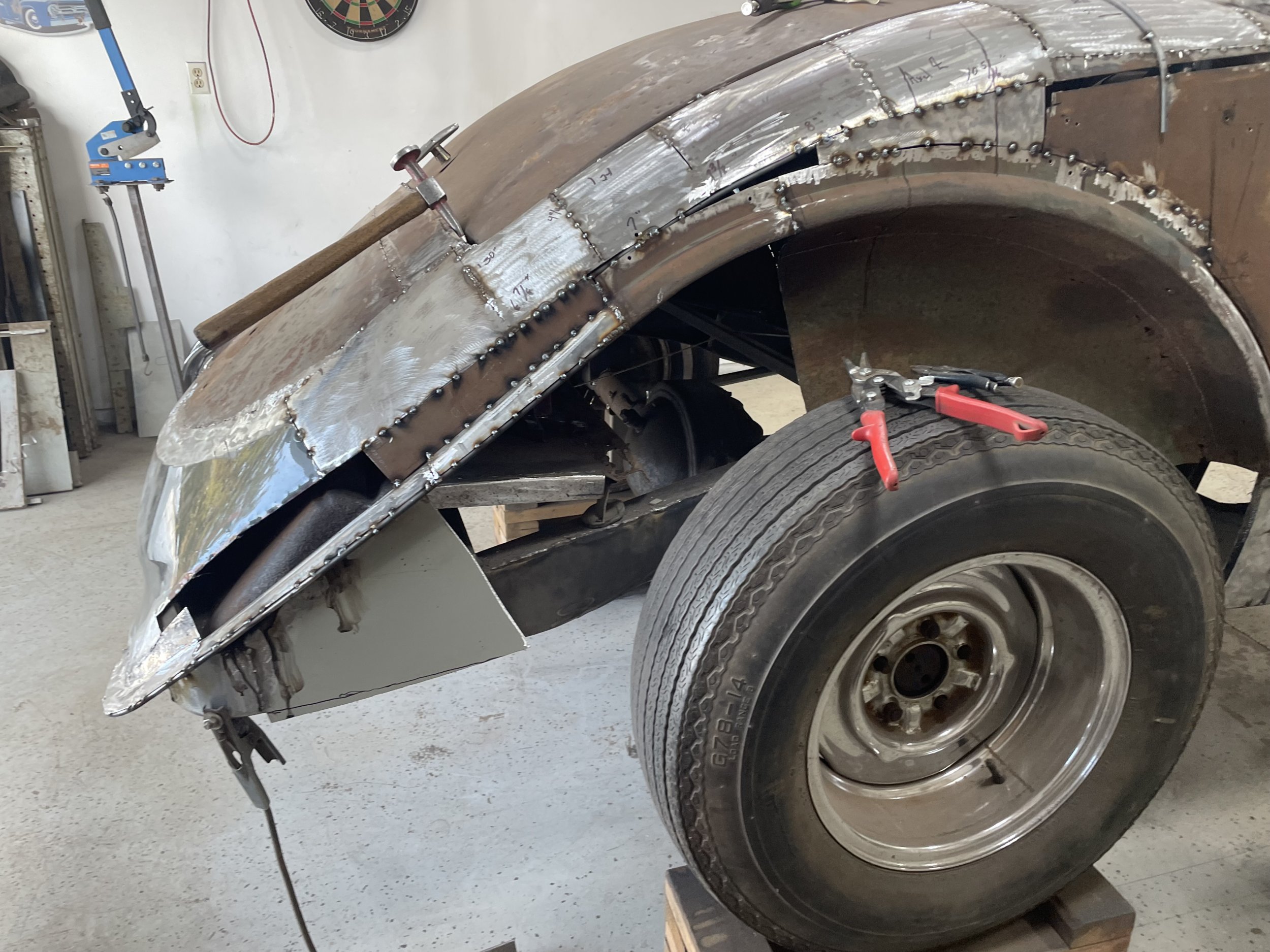

    built a wire form buck on fender and wheeled up new panels to better fit the wheel . Coming along nicely !
