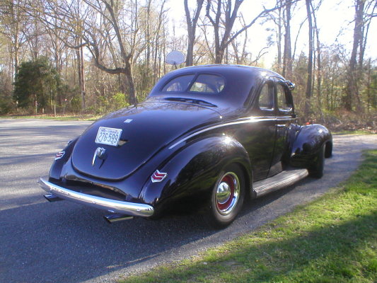

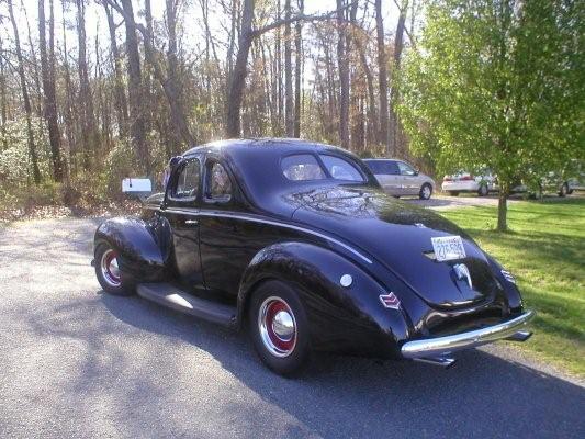

    I agree... I would like to bring the back down to where the white wall is right at the fender line. Using the parallel spring set up is one of my only regrets on the build. I may change it up next winter and use reinforced 36 radius rods and a transverse spring. I am hoping the springs will flatten out lower it an inch or 2.
    No, it is not finished. I still have a bunch of details to sort out. The hood is sitting in the ba*****t and will go back on eventually. But not until I get the motor fine tuned.
    Thanks! Thats a big complement. Your 39 was a big inspiration for my project.

    Your car is dead nuts perfect - personally the rear height isn't too bad but are you using gas shocks? If so, I'd swap them out for the non-gas version - my 40 coupe has the same problem and with the non-gas shocks it does come down nicely. But, I did have to install a sway bar in mine with my rear tires - you will not have to as they are alot skinnier than mine. Again, real nice ride you have there!
