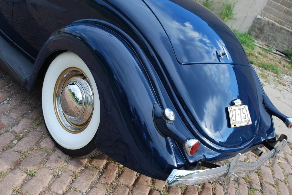

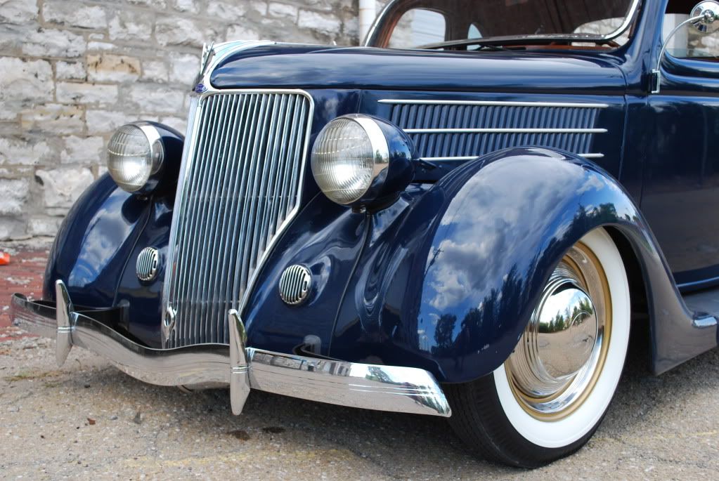

    Another big change was replacing the ****py, ill fitting grille with an original chrome unit. It wasn't cheap... but it made a big difference and I could finally install the hood.
    I also found some original 40 ford accessory trim rings at a swap meet that were in pretty rough shape, but they were super cheap so I bought them and after knocking out a few dings and hitting them with the polishing wheel they found a home on the coupe.
    I also lowered the back end down by building some spring perches that incorperated a lowering block. While I was at it I removed the last leaf in the pack and it rides much better.

  14. PERFECT!!! What size tires you running?? Todd

    Thanks for the complements!
    Tires are Coker Firestones 5.50-16 front and 7.00-16 rears. Mounted on 4"x16" and 4.5"x16" original early Ford wheels.
