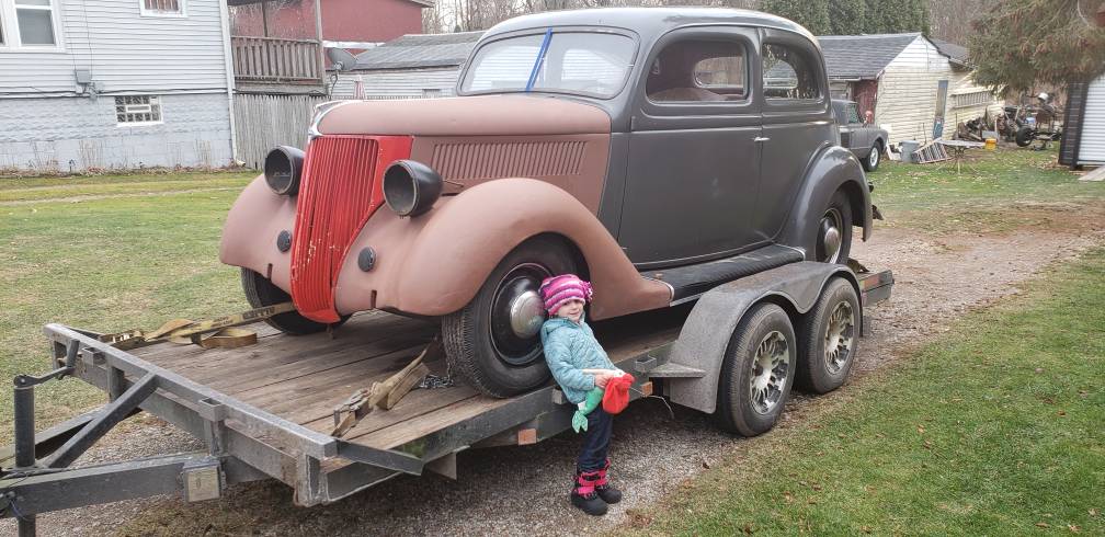

    Im a younger guy that has always had a great appreciation for traditional built cars. I've always been into off topic cars mainly late 60s and 70s but I finally sold one and picked up my dream car, a 36 humpback sedan.
    I bought the sedan as I have two kids under 10 and want to take them out to the shows.

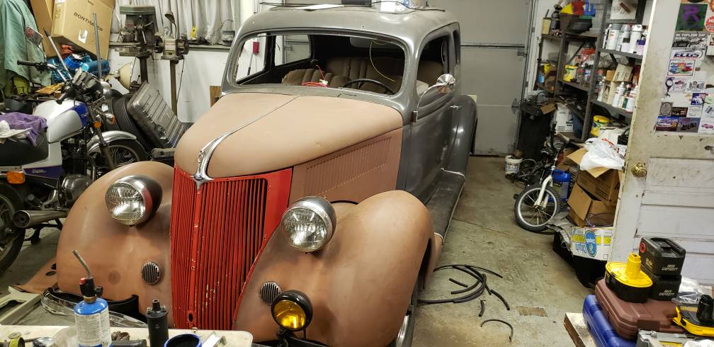

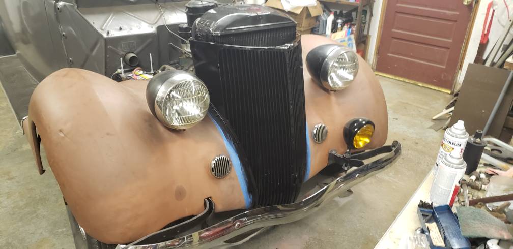

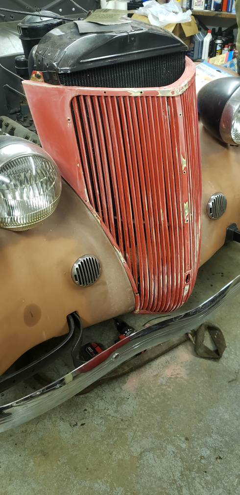

    When I bought the sedan it was all original, front was in primer, wiring shot and interior in sad shape. I've sense rewired it, got the front sheet metal bolted down and started smoothing it out best I can. Here are some pictures. 20191212_155034.jpeg 20201130_204941.jpeg

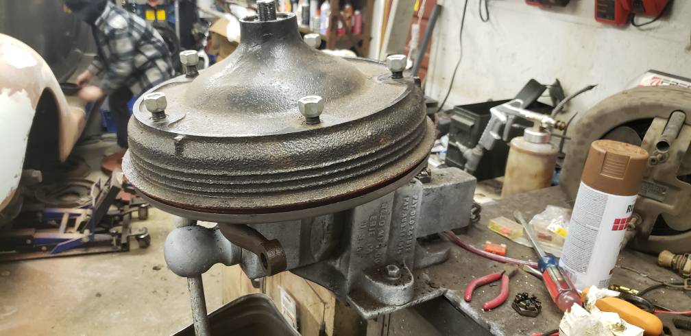

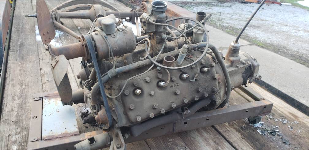

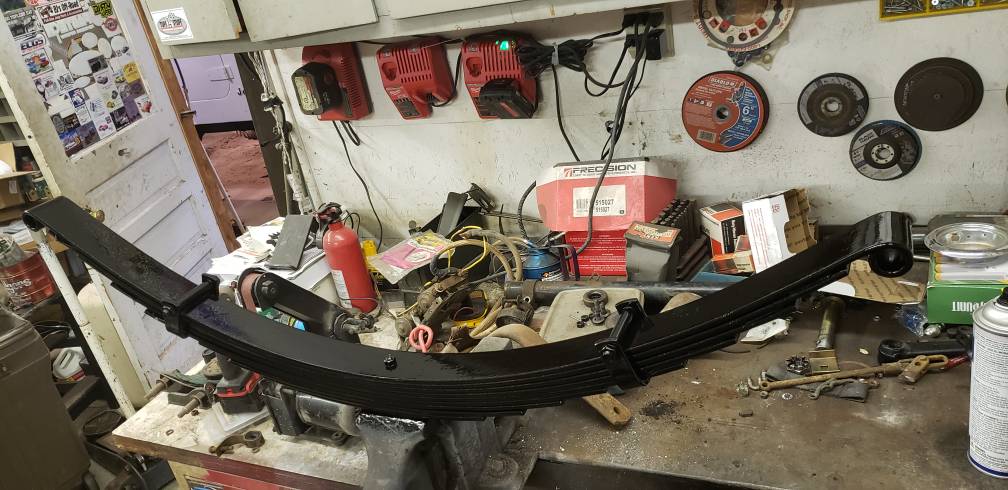

    Some more pictures, the Lincoln brakes i purchased from speedway, going to run 39 front drums and keep my wide 5 wheels, and my latest pickup a 59ab flathead and 39 trans that hopefully will be in good shape and long term will be swapped in in place of the original 21 stud flathead. 20210109_175942.jpeg 20210109_180018.jpeg 20210109_162541.jpeg

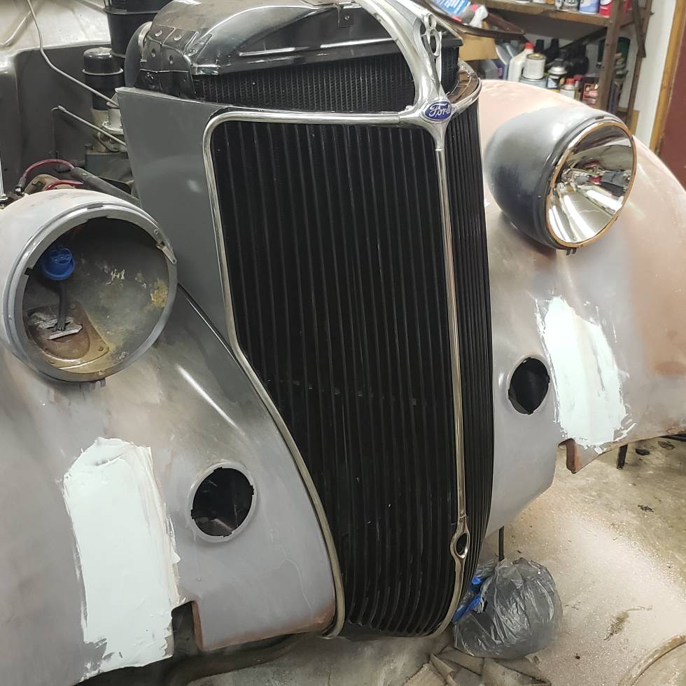

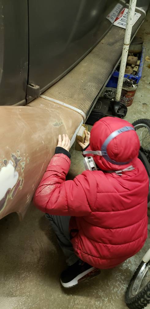

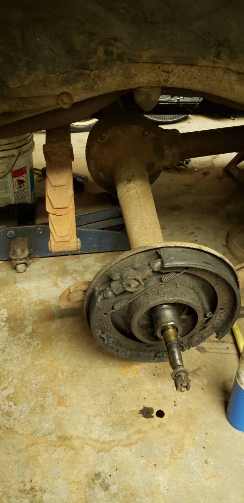

    Another update, got the rear Lincoln brakes, a reverse eye spring for the rear and we have been sanding on the front fenders, here's my 7 year old son sanding away 20210319_201906.jpeg IMG_20210327_231127_038.jpeg 20210321_225749.jpeg

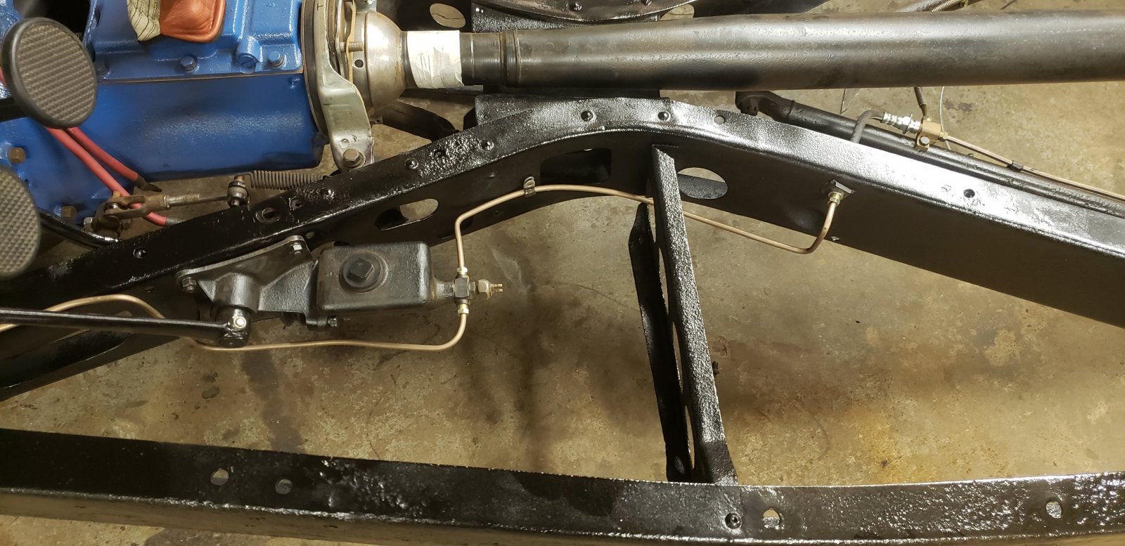

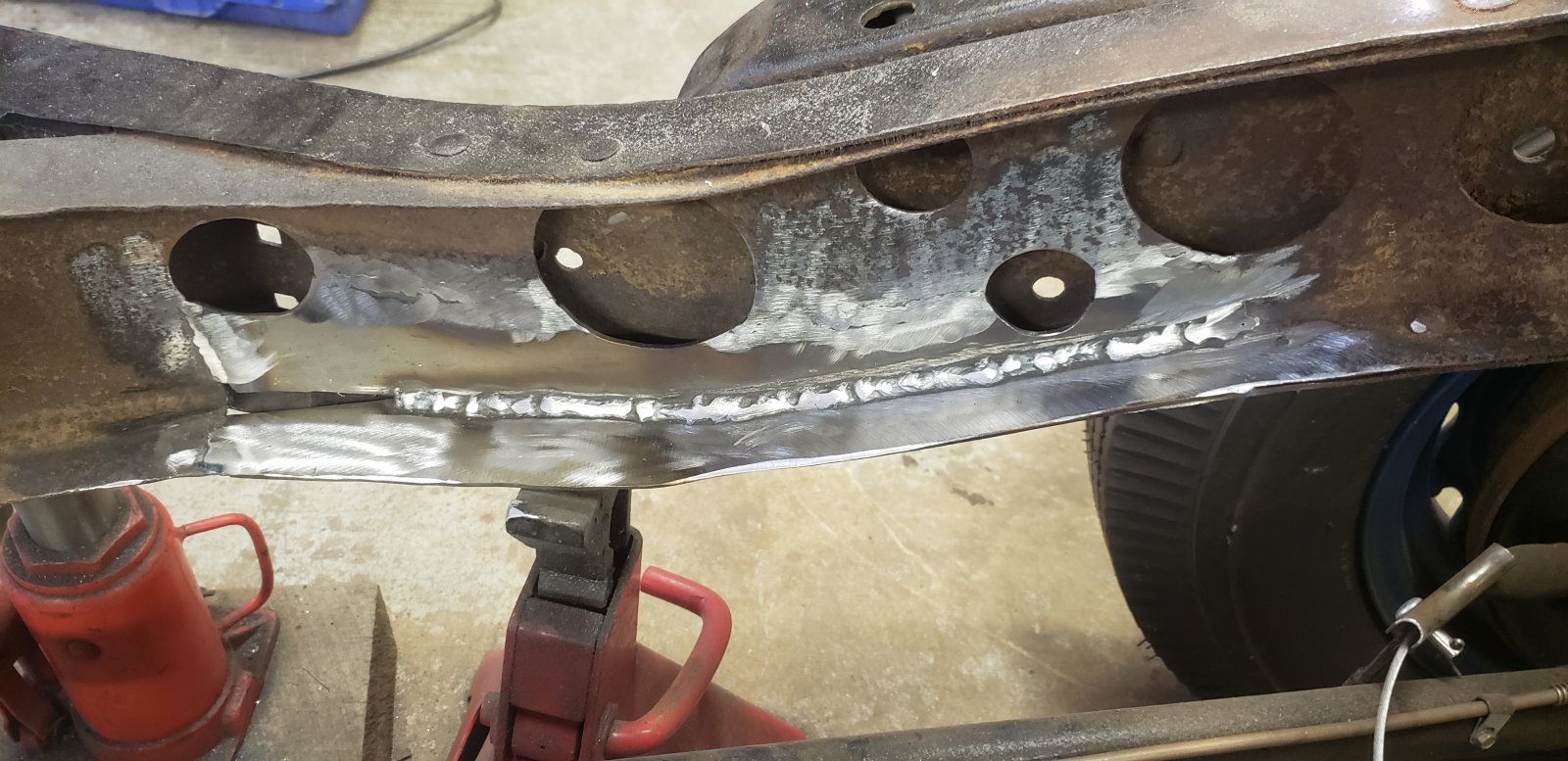

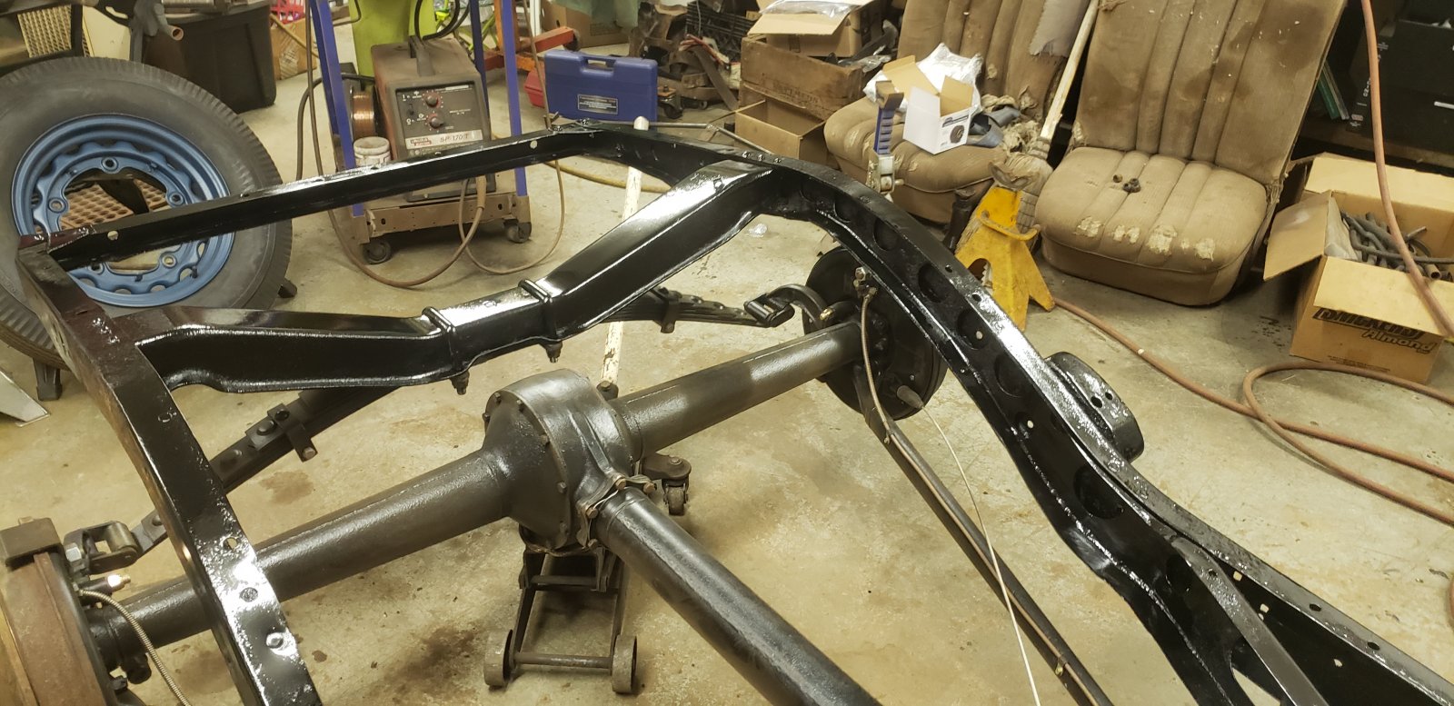

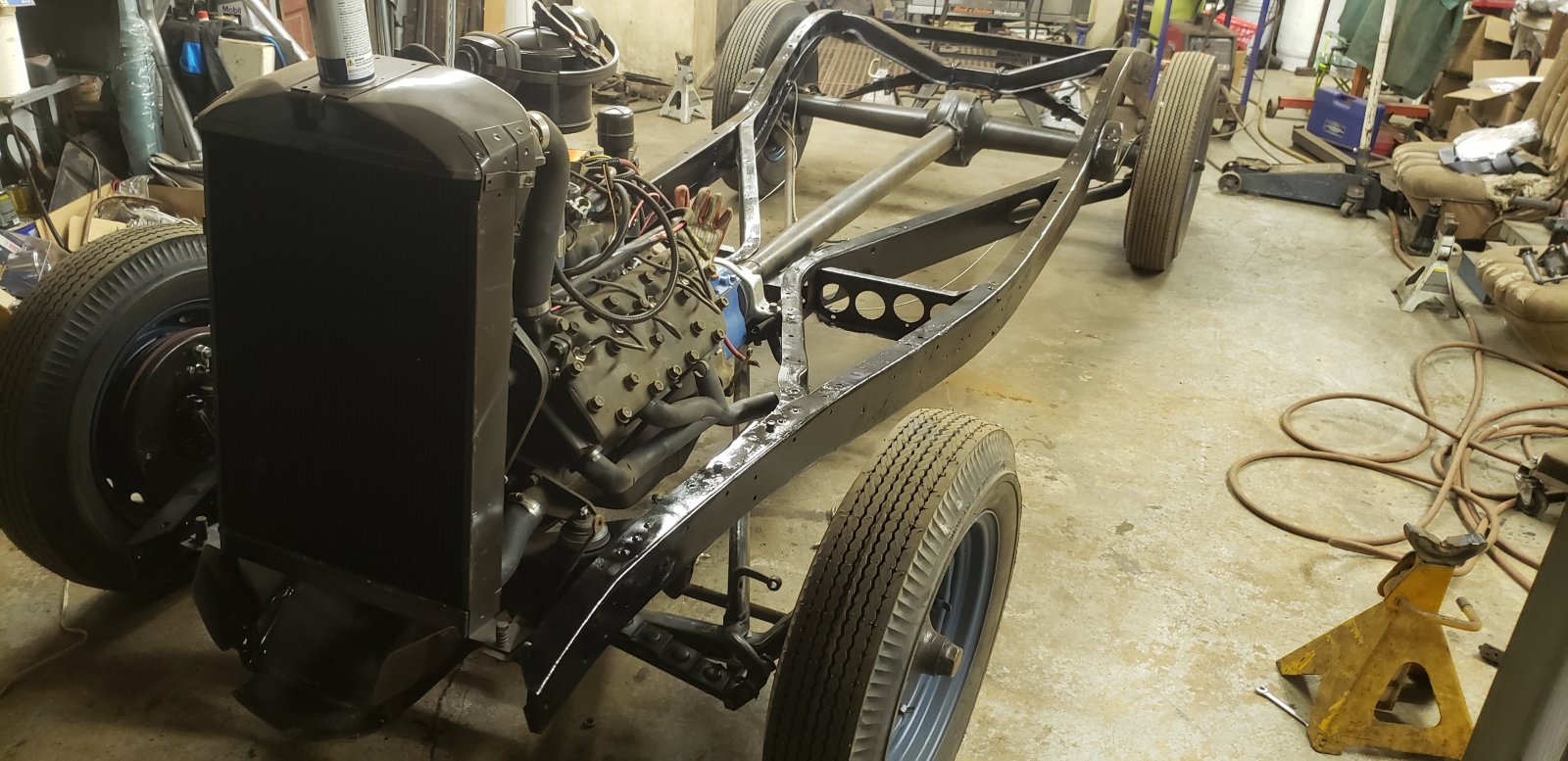

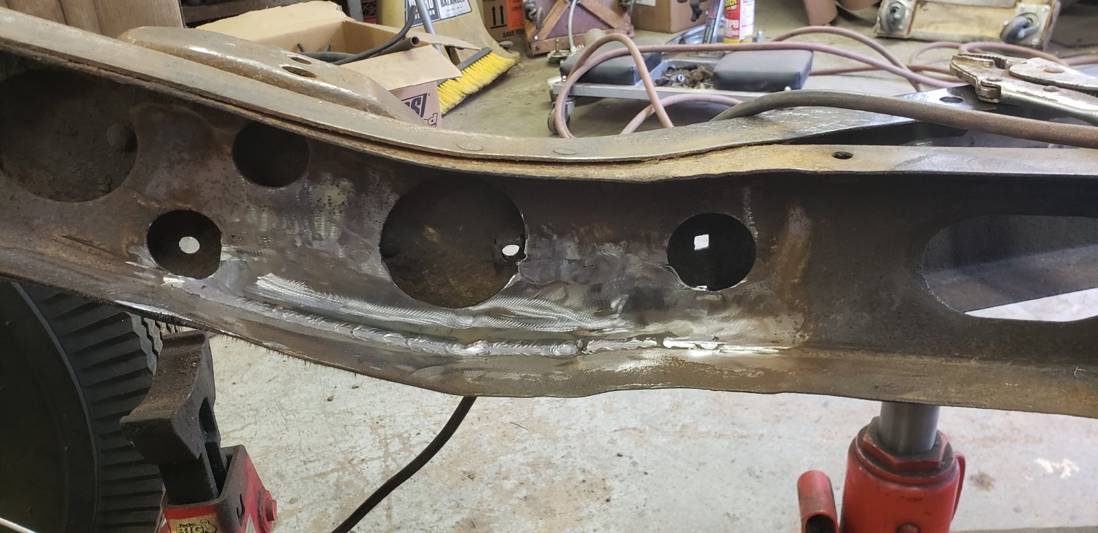

    Update on the build, I found rust in the frame in the comon 36 spots, I pulled the body and started cutting. At this point the frame is all repaired and painted. Exhaust from reds is all mocked up and gas tank is installed. New brake lines are also ran. Currently working on my 39 steering box rebuild

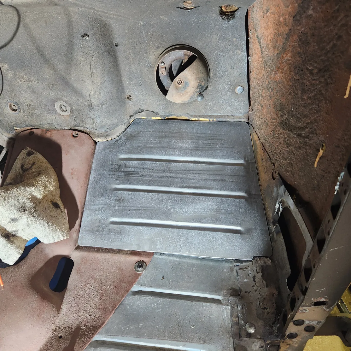

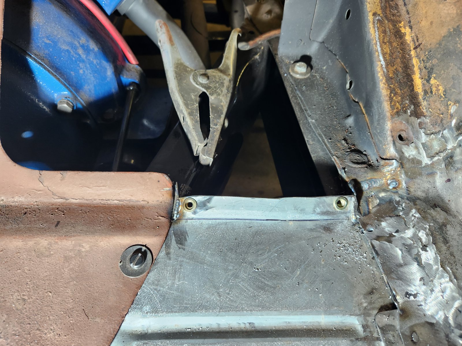

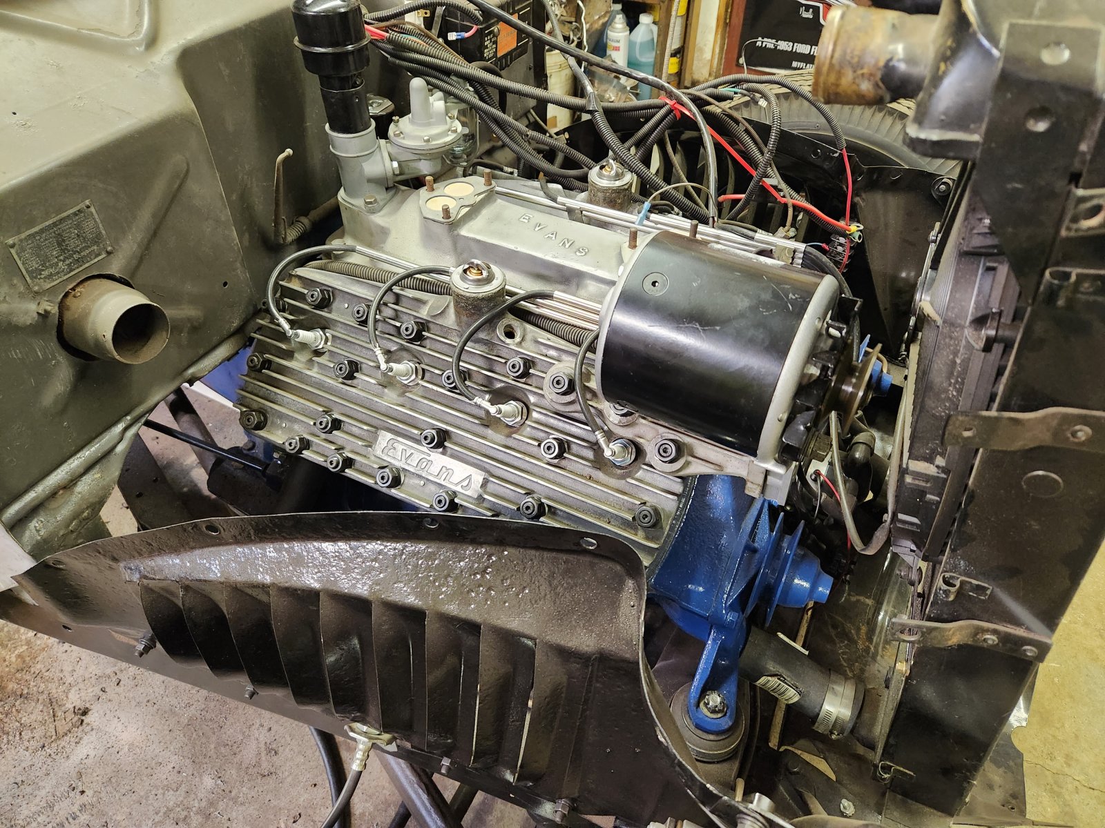

    Sorry for a long pause on updates, I got the frame completely done, but not until after taking it all apart again, having it sand blasted and then top coated with Eastwood paint. Re***embled it and the 59a came back from the machine shop. Then I dived into metal work never done that before but so far I have replaced the floors, repaired the trans tunnel and currently working on the cowl bottoms. 20221231_175625.jpg 20221220_002941.jpg

    Removed the bracing, and main floor is done, on to making the new toe boards

    Tonight I started making metal toe boards p*** side is almost done.

    Tonight I continued on the toe boards, drilled holes for the pedals, fit the drivers side to the car, bead rolled, marked the holes and bolted it down. Then did the same to the p*** side. I need to do some work on the floor where the toe boards meet but very close to being done.

    Last night I modified the floor and finalized the toe boards. Now all the screws work to hold them down and I made a hole for the throttle rod. 20230118_221345.jpg 20230118_231912.jpg 20230118_235128.jpg 20230118_221345.jpg 20230118_231912.jpg 20230118_235128.jpg
