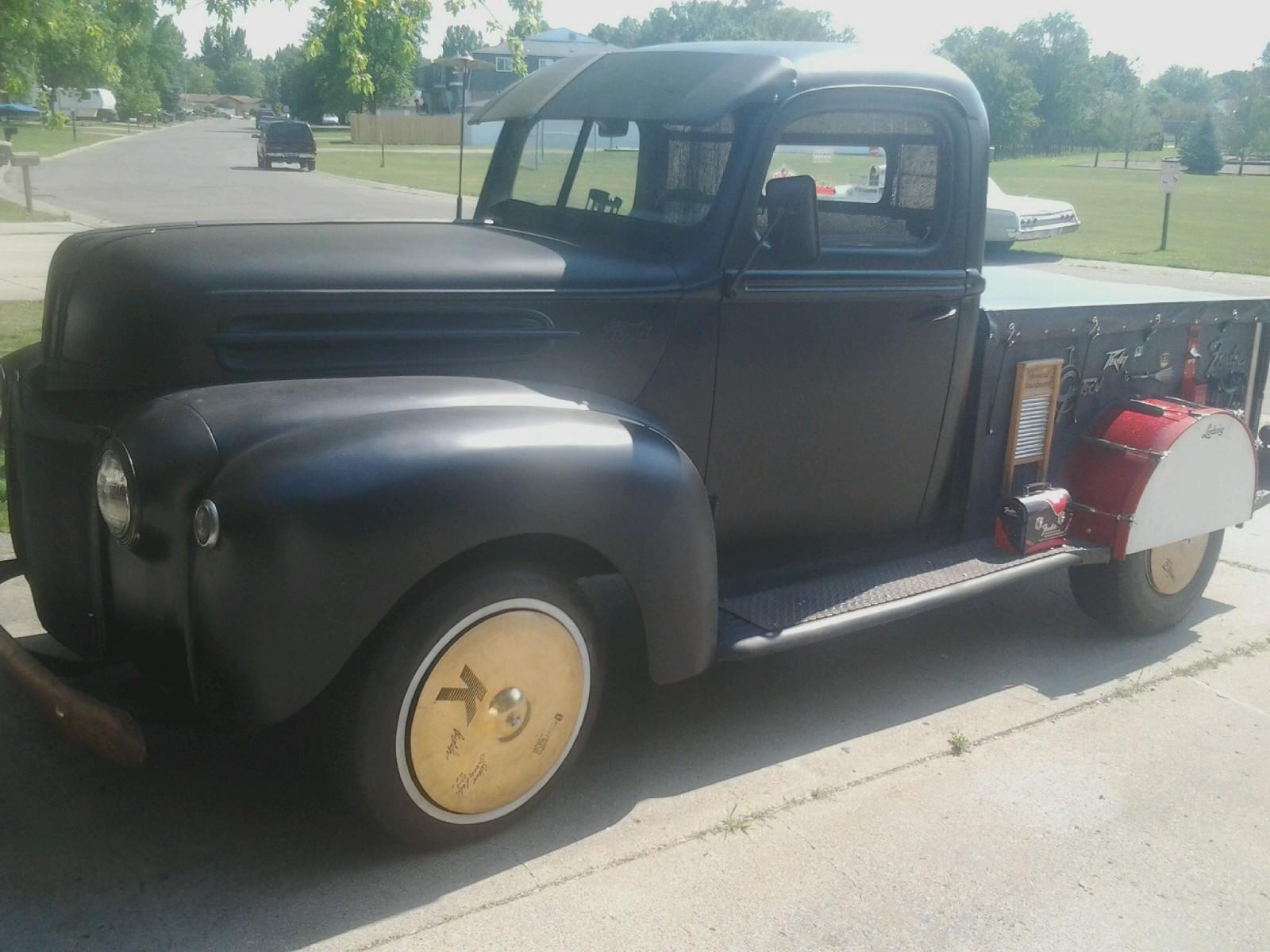

    Welcome fellow COE owner. If you want to go real low and especially to have better driving and stopping, put it on a late model frame. My 49 Ford COE is on a 74 GM reg cab 1-ton frame and has about 10 ft custom flatbed that I built. If you want to haul a car you need longer than 10 ft bed. A common ch***is for a car hauler is the GM crew cab dually pickups. A single wheel can work, but most use dually for better load capability.
    I would not mess with the old suspension and tires, brakes and other drivetrain parts. If you want it low and plan to drive any distance, the later model ch***is is the best solution. Mid-engine with engine behind the cab is a good diea, but it will require a removable box to cover the engine or ramp style flatbed. A longer wheelbase to start such as the crew cab is going to give you sufficient room for a driveshaft. Mine is too short of wheelbase to do mid-engine, my COE has the engie under the cab with a large engine cover inside like a van has. I run a 350 SBC.
    Here is mine, chopped 4 inches, and air bags on front. Flipped axle on back.

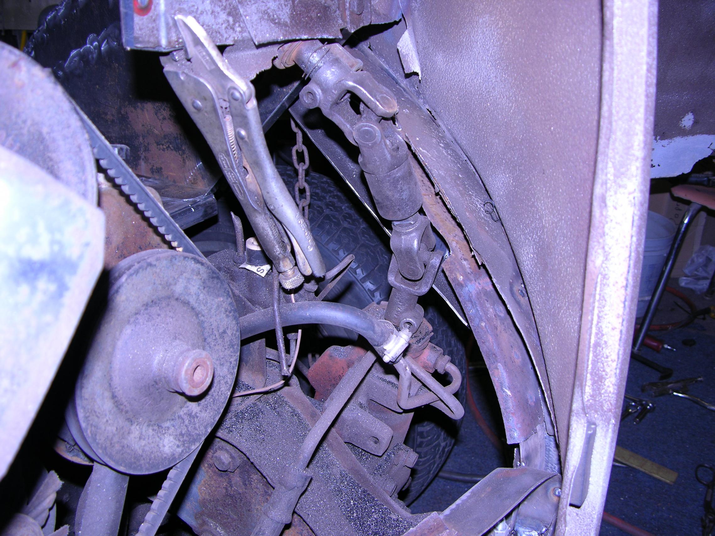

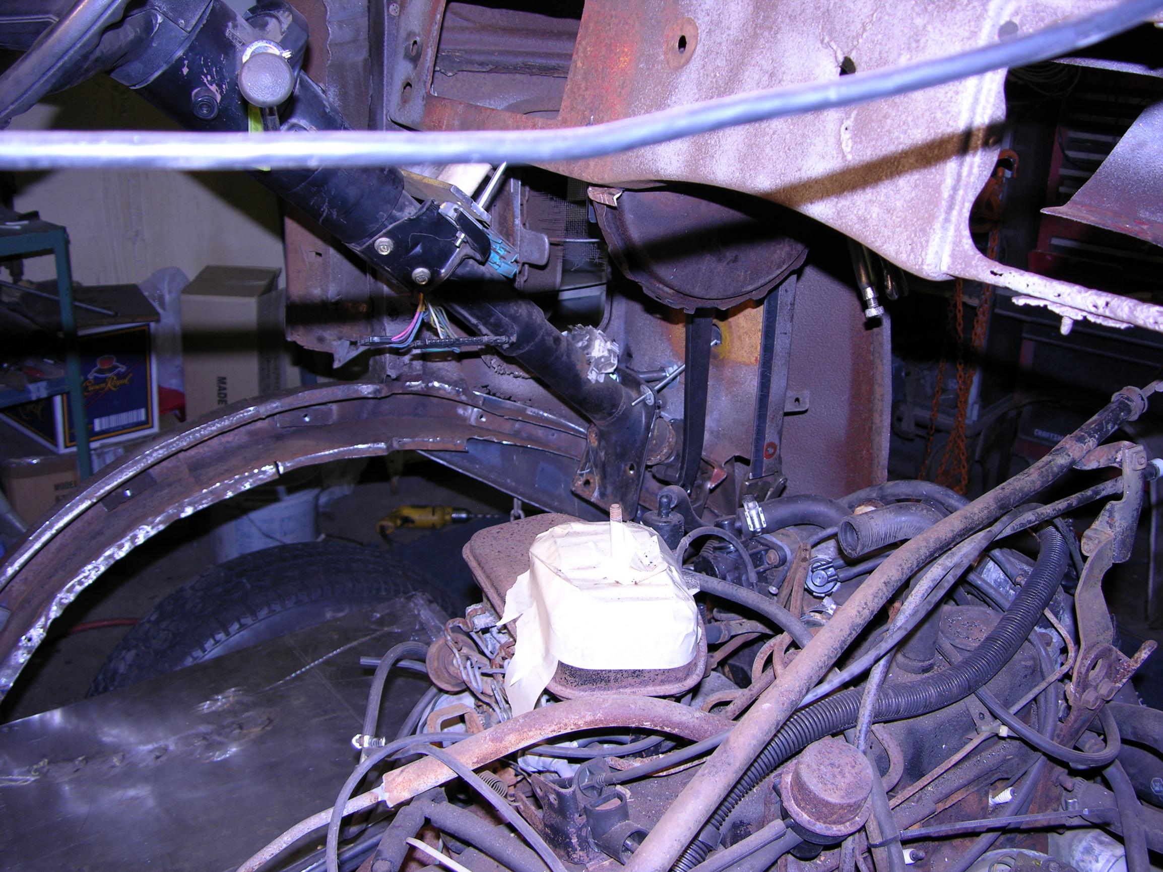

    A 496 is a wide engine.
    A COE is a narrow cab.
    I have a inline 6 in mine and it is tight! (84 Chevan ch***isand steering, stock)
    I removed the inner fender panels and installed a flat panel in place of the curved one.
    I also cut the cab structure in the foot area to make it 2" wider.
