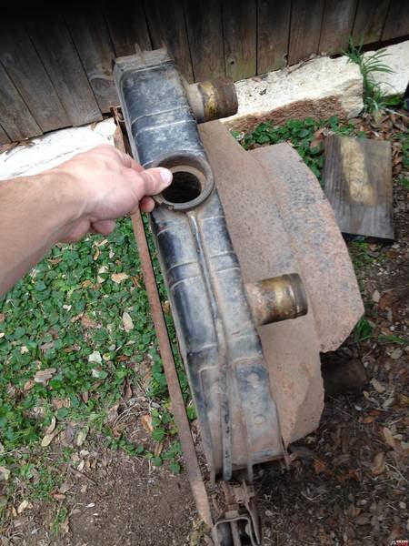

    Is the the stock radiator worth saving or is it too far gone? Not sure if anyone rebuilds these, but I would like to save it for another hot rod project if possible.
