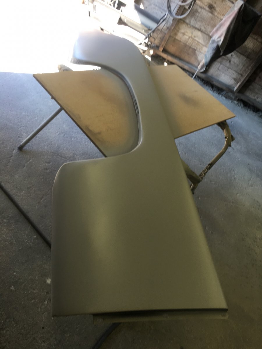

    Rear quarters are coming along & had fun taking the dash apart lol, now need to clean it up and put it back together.

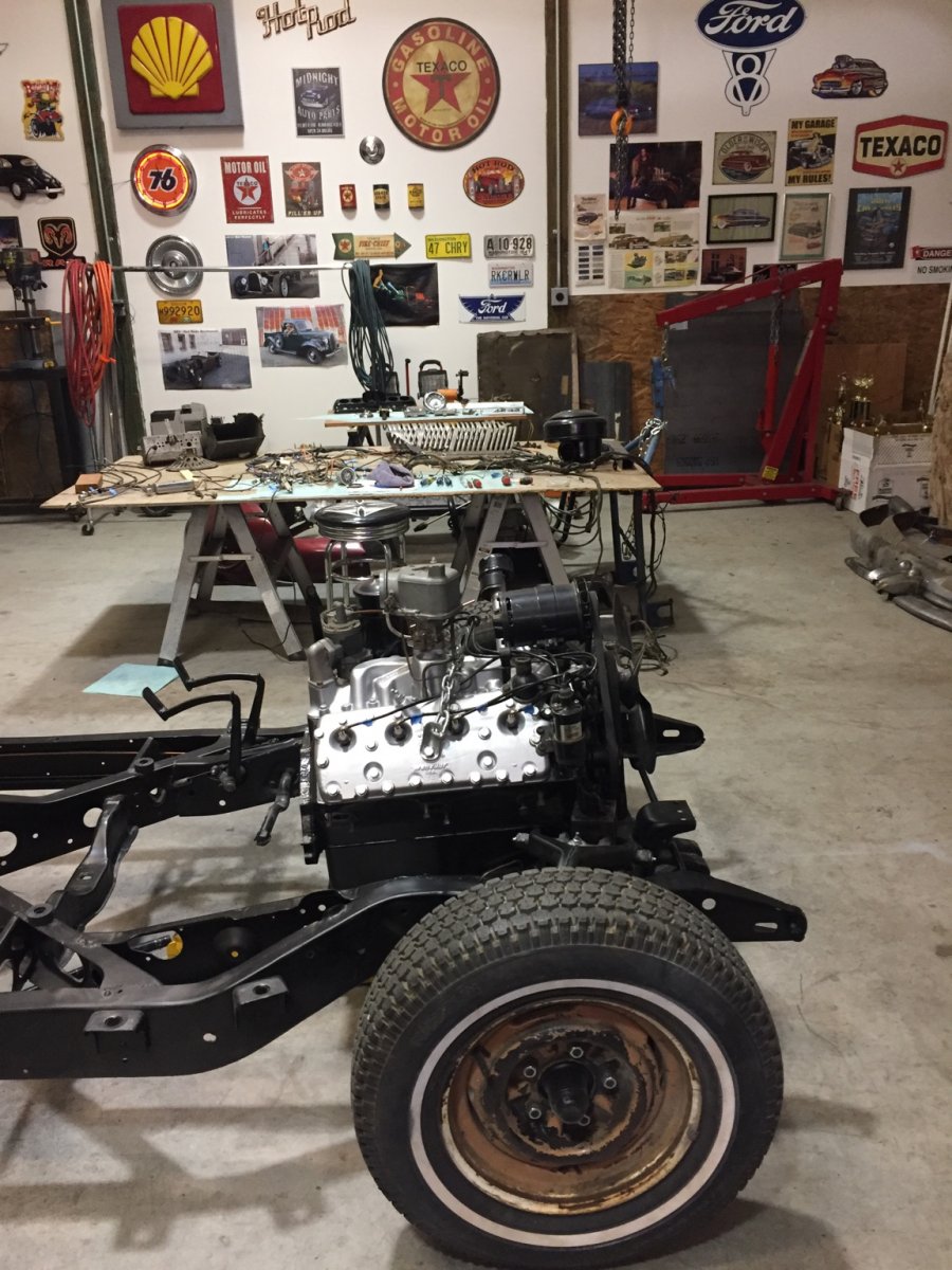

    Got the frame back, going to put motor, trans, fuel tank in then put body back on after undercoating is done.

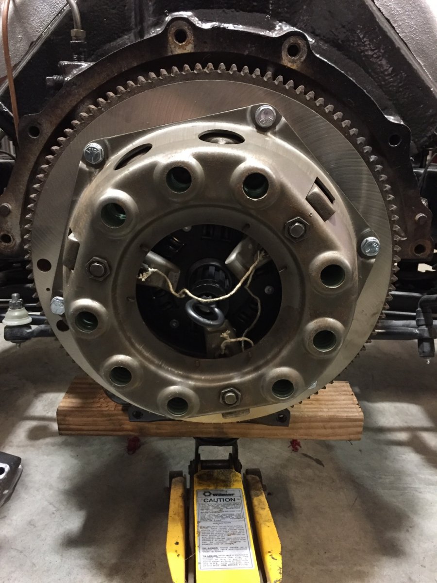

  16. Stock 1949 Mercury 3 speed OD transmission going in. Flywheel, pilot bearing, new clutch, pressure plate & throw out bearing. IMG_1484122075.742555.jpg IMG_1484122100.880977.jpg IMG_1484122117.622221.jpg
