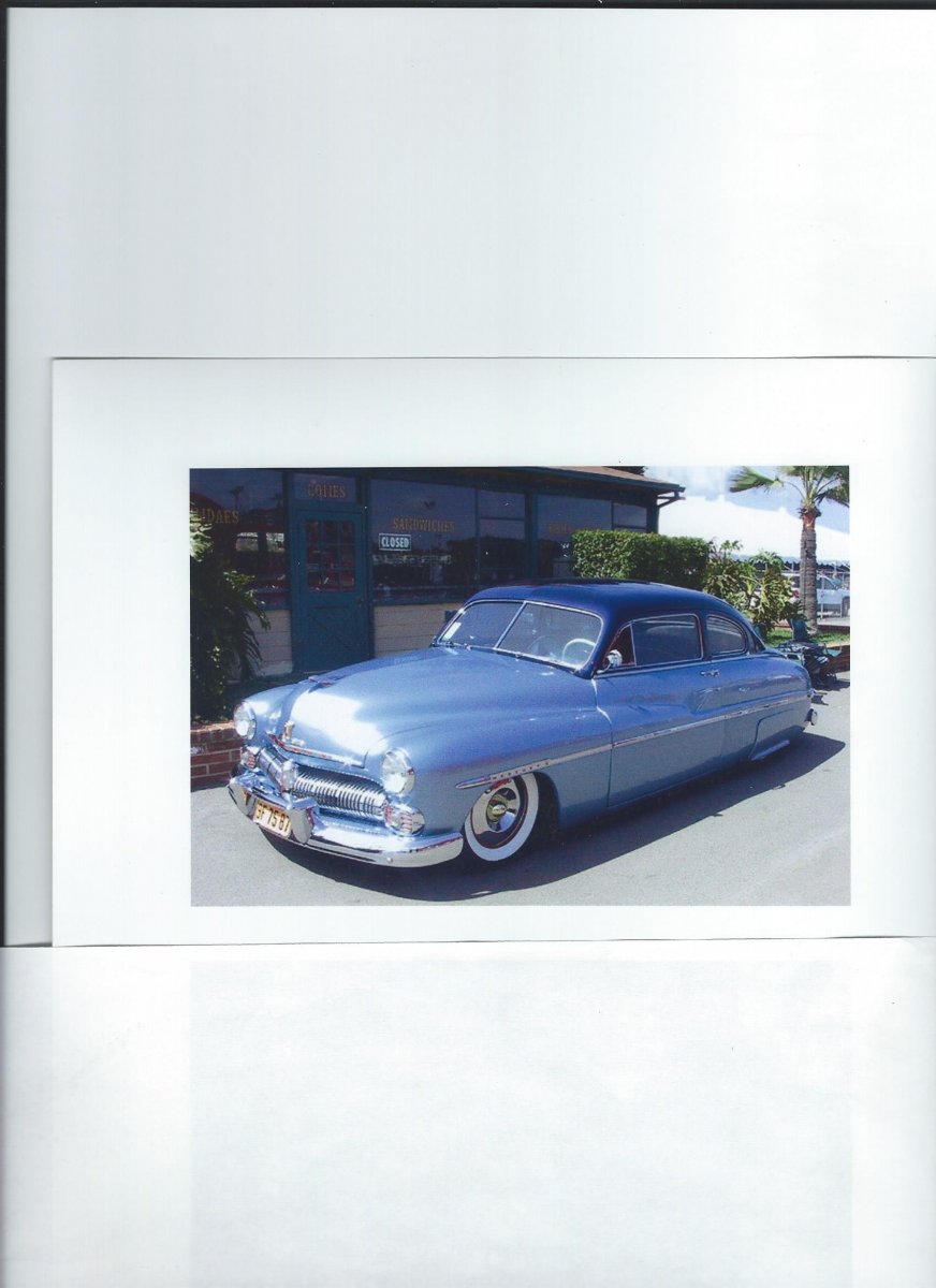

  1. Nice Merc. That's what I started wondering about. Mine looks a little forward but so do some of the Merc I referred back to. Also I want to lower it a bit more in the rear. Will just get some blocks not sure what size yet. Already have 4" lower springs.

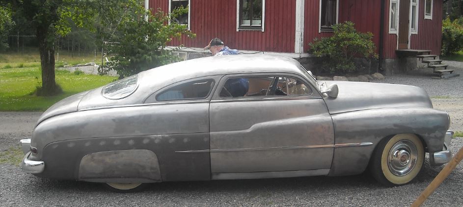

    I advice against 4"blocks , OK OK settle down hecklers , I know 4" blocks are one of the basic recipes in customizing and possibly a quickfix to get the rear down but I see it as a device that can be removed and get back to stock suspension and customizing at its best in non reversible , also it leaves the bottom of the spring too close to the ground and in my opinion 4" is not enough to get down to the wheel rim edge lined up with the rocker level which I think is a perfect level for the rear suspension .... I think a close to straightened leafspring and possibly a 1-2" block will get there and give a more stable side to side strength for the rear suspension . This causes the rear axle to hit the frame that needs to be C-ed and driveshaft to hit the floor , the tunnel needs to be moved upwards which causes the rear seat not to sit right at the floorboard , you simply open a can of worms but to get there to that ride height it needs to be done and still maintain a semi decent ride quality . I don't know if you want to building a full blown traditional custom but that's what I want to build so I try to use stuff that was available back then and minimize the new stuff , still I use hijackers , something they didn't have in the early fifties , its my small detachable deviation from the era that makes the car usable to load stuff in the trunk and negotiate uneven ground .

  4. I like the look also with the fender skirt at the bottom of the rim. I have 49 skirts so it's going to show more rim then 51 skirts. I also have 4" lower springs right now from St Louis Spring a little more weight in the car with gas, gl*** and interior might make it sit a little lower. Maybe just need a 2-3 inch block. I definitely want it a little lower.
