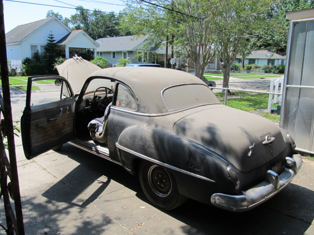

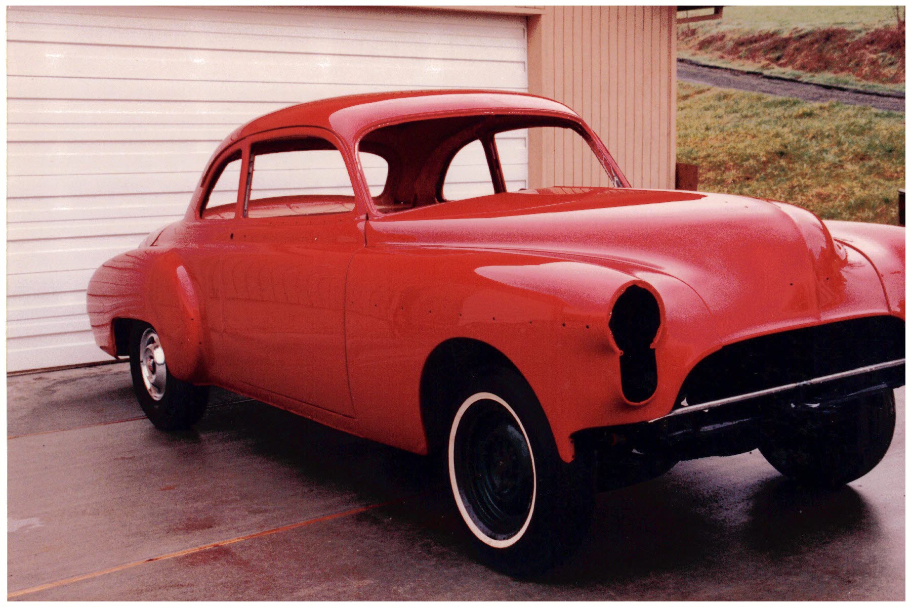

  25. Sky Pilot
    Joined: Jun 30, 2010
    Posts: 697
    Sky Pilot
  26. Baron
    Joined: Aug 13, 2004
    Posts: 3,665
    Baron
    Looks like it's twin :D
  27. Sky Pilot
    Posts: 697
    Sky Pilot
    You doing an awesome job on the frame ... I envy you.... Cant do that heavy stufff no more..----- trying to do a lil repair from the hurricane another set back

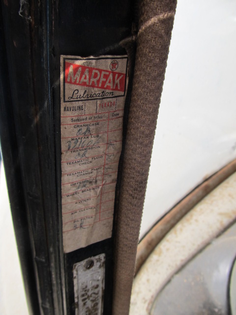

  28. Sky Pilot
    Posts: 697
    Sky Pilot
    61 or 2 oil change sticker ... Been laid up since around late 63---------ABOUT 39 K MILES LOOKS LIKE ON IT

    Ooops i stand corrected the oil sticker is at 32k the car has 36 k from the early 60,s :d
