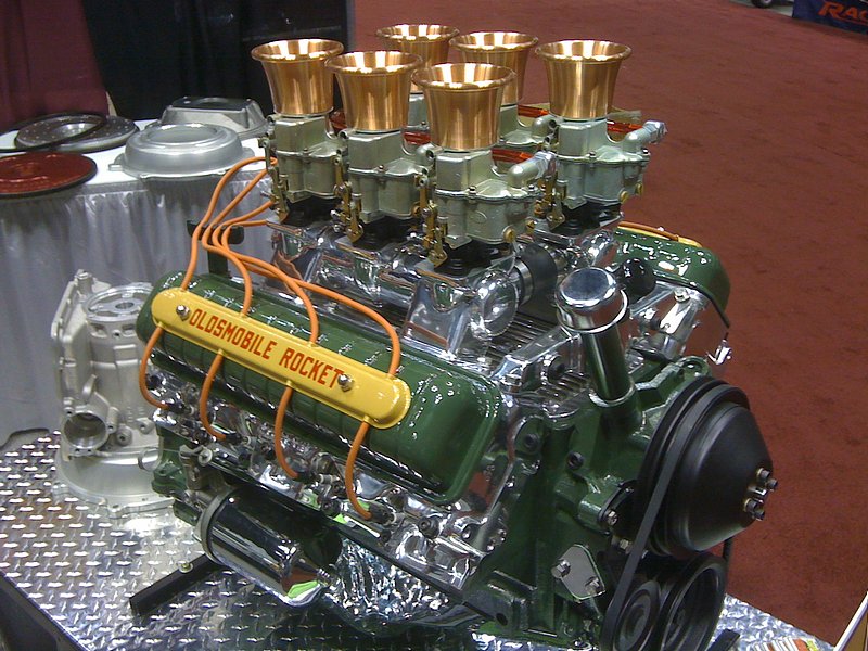

    We just found your Olds Coupe Build... We're also building a '49 Coupe, but making it look like a '50. Built a '57 371 punched .125 to 394" / 6-Log with six 97's and a B&M (Slant Pan) Stick Hydro. We know Marty Strode very well. When and if you need any advice he's your man! We've seen his work now for over thirty years, and Marty is a real talent. Plus he's the hardest working most honest person I've come to know. For any engine parts call Ross Racing in Ohio. Ross & Tony the son have it all. The engine photo is theres, but ours is identical in every way.
    We Love your project... MAGOOZ Seattle, Wa.

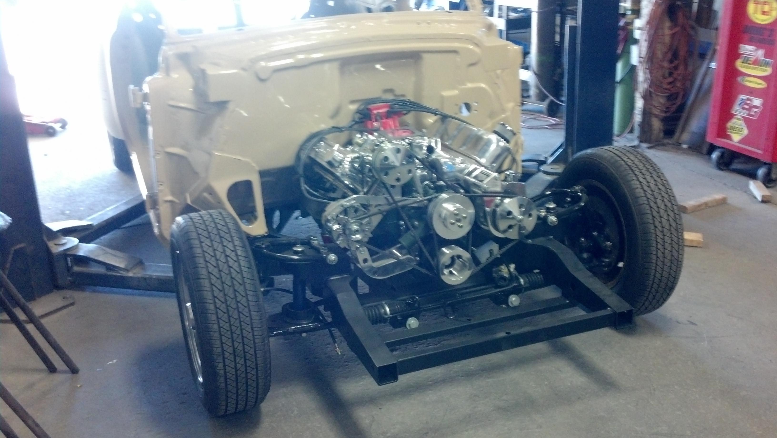

    We have made great progress on my car during the past month.. All of the body work is done, several coats of an etching primer, sanding between coats, them a buff colored primer.
    We paint the cowl/firwall, jambs and trunk area with the finish color, Dune Beige. yesterday.. The ch***is is all done, powder coated.. All of the mechanical's, eng, etc., have been installed onto the frame.. We rolled the ch***is under the body, lowering same onto the ch***is yesterday afternoon..
    As you can judge from the attached pix the Dune Beige color goes well with the engine and black ch***is..
    The modifications we did to the firewall to provide room for the brake peddle ***embly and booster turned out very nicely, if I do say so myself..
    The next step will be to plumb the ch***is for the brake/fuel lines, build the exhaust system..... START THE ENGINE.. We are going to make the car runable before we install the front sheet metal...
