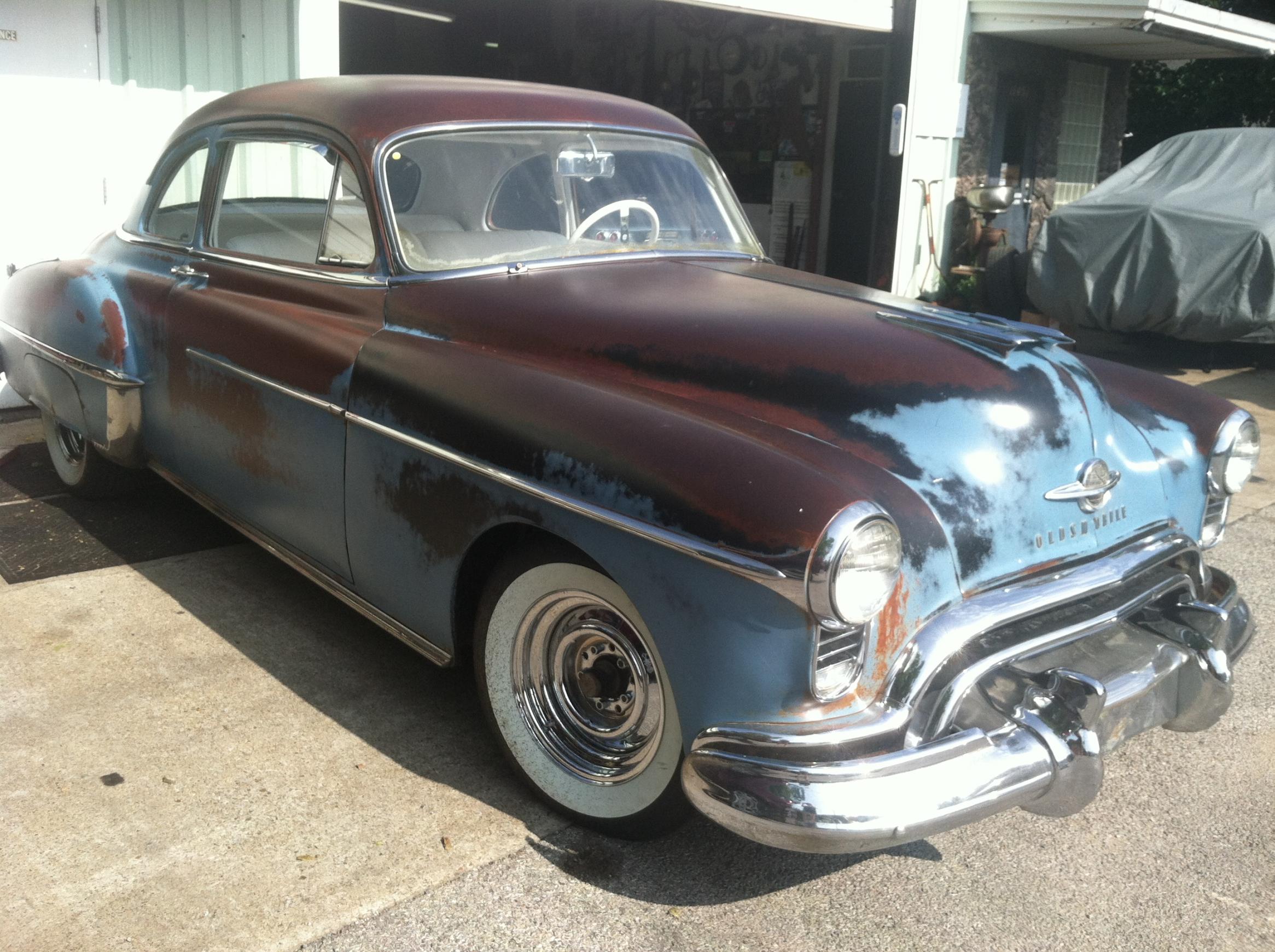

    [​IMG]just not for sure how or what way to go.... Please keep posting updates
    Well one thing......get rid of the electrical tape..!

    LOL the electrical tape! I've heard that so many times, that has been on the car since 1963.... I hate to take it off now.
    I still haven't done a damn thing to the car, I did get it running and took it to the pile up and the rust revival.
    I hope to start doing something to it later this summer or winter.
    I will keep everyone updated once I start.
