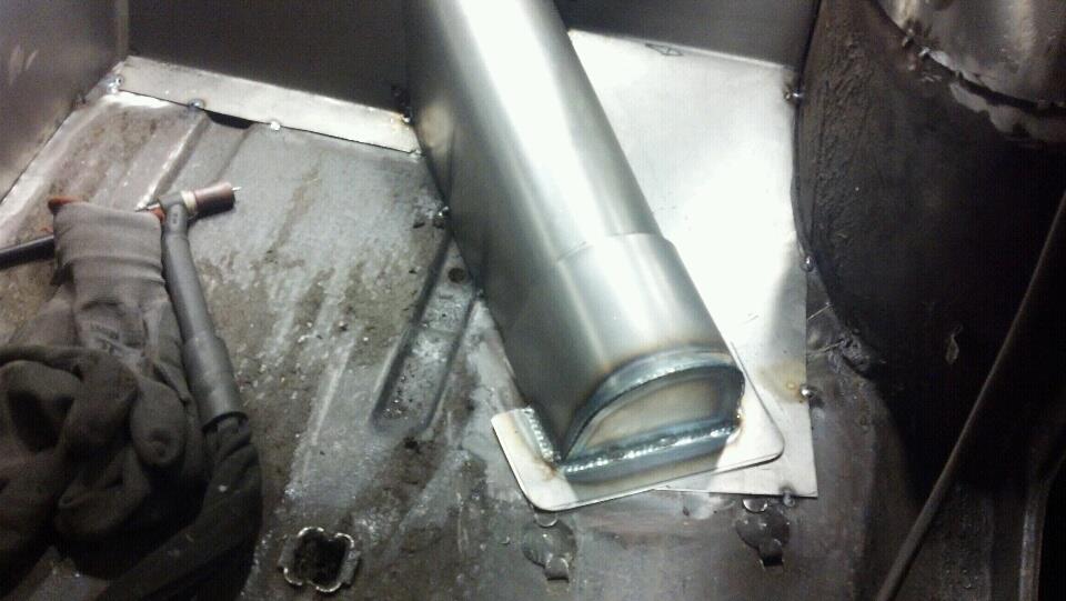

    Thanks to Curt from Hill's Rod and Custom, the floors are getting done. My wife is due in 3 weeks, so I am having to sub some stuff out to get progress moving! It will definitely go low enough in the rear now!:cool:

    More floor progress and fenderwell progress. My favorite part is the cool idea Curt came up with to access the front of the upper 4-bar mount. The little end cap will have some weatherstrip on it and bolt in. Way trick.
