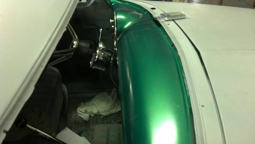

    Got the dash rattle canned with duplicolor green flake,installed my tail lights, punched holes in the bumper for the exhaust and finished the wiring for the trunk. All in one hour bursts while my wife and new daughter slept!
