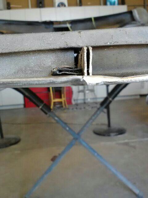

    Got the drip rails almost done. We folded the stockers over then filled and blended them in.

    Thank man! Frank Livingston's car provided the inspiration to try this technique. I think it looks bitchen and it was way less time consuming than doing round rod. Thanks to Kirk at Jennings Kustom & Restoration for giving it a shot with me!

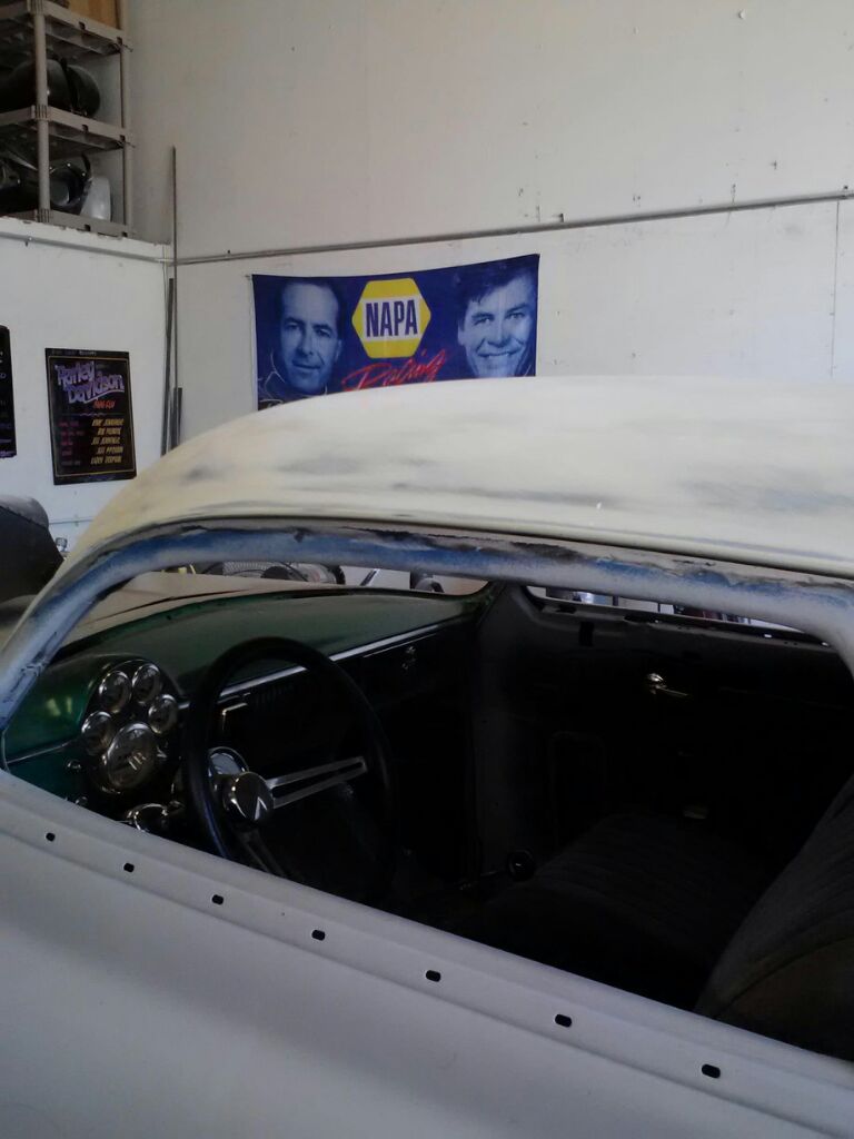

    The bodywork is all done, now we just need to get some blocking done. I think we are going to block and prime the whole car, then finish block and paint the roof and garnish/dash so I can get the interior together. Then come back over the winter and do the rest of the body. Hope to get some pics of it up soon!

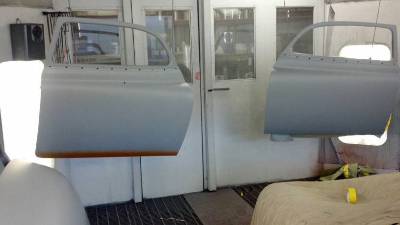

    Some pics of the hood tweaking. Tapering off the peak as it meets the cowl and making the hood fit right.
    Sent from my DROID RAZR using Tapatalk 2

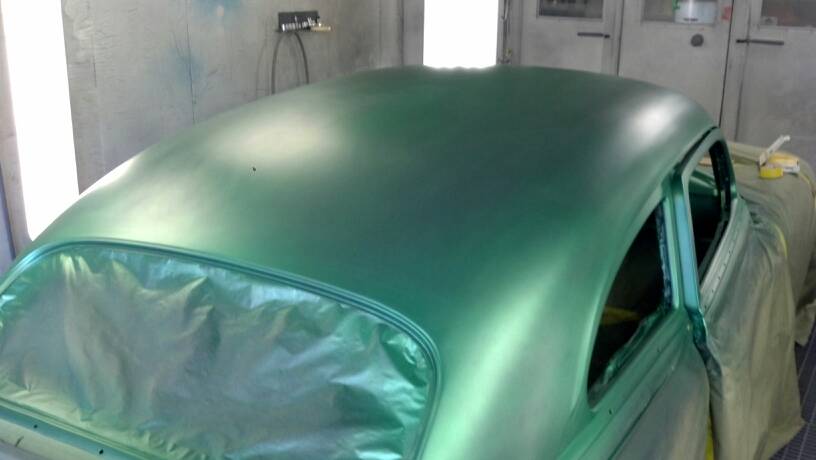

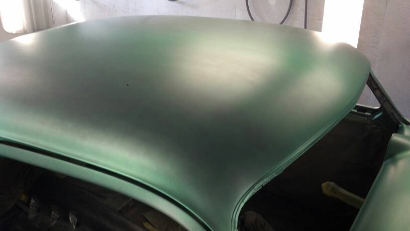

    Got the color nailed. Roof will be done for billetproof

    That color is bad ass! I love it!

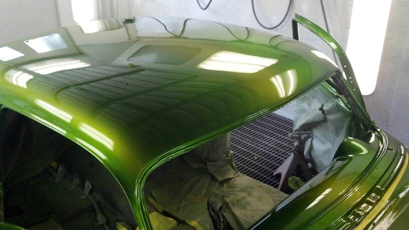

    I got em. They'll be on for billetproof. Color is hok planet green. Faded with black on the bottom and silver on top . Then candy gold over everything. 6 coats. Then cleared.

    Its alive!!!
