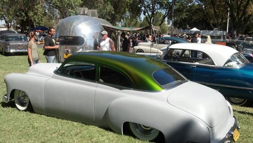

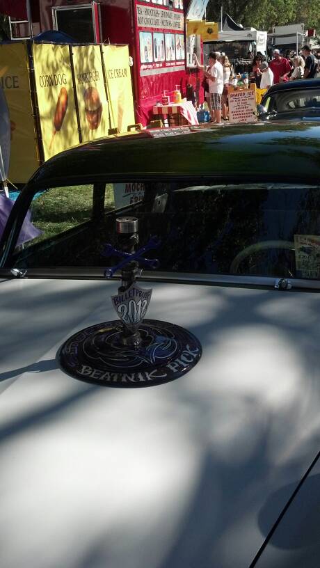

    Some pics from billetproof. I took home the Beatnik Pick award. For me it might as well have been the ridler!

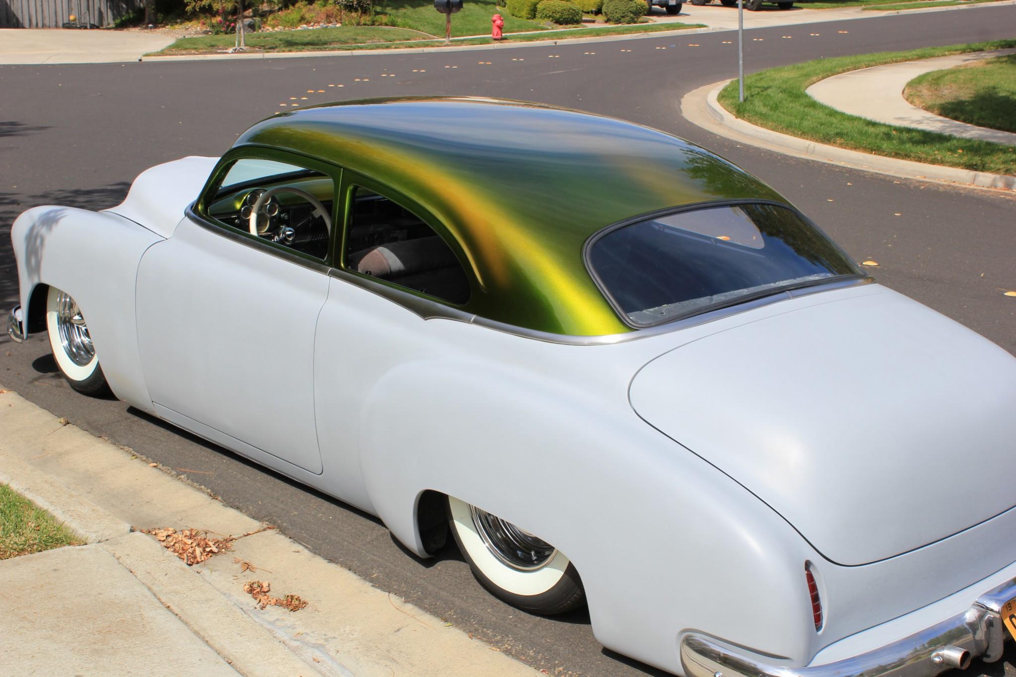

    here are some better, hi-res pics that really show off the color in the sun

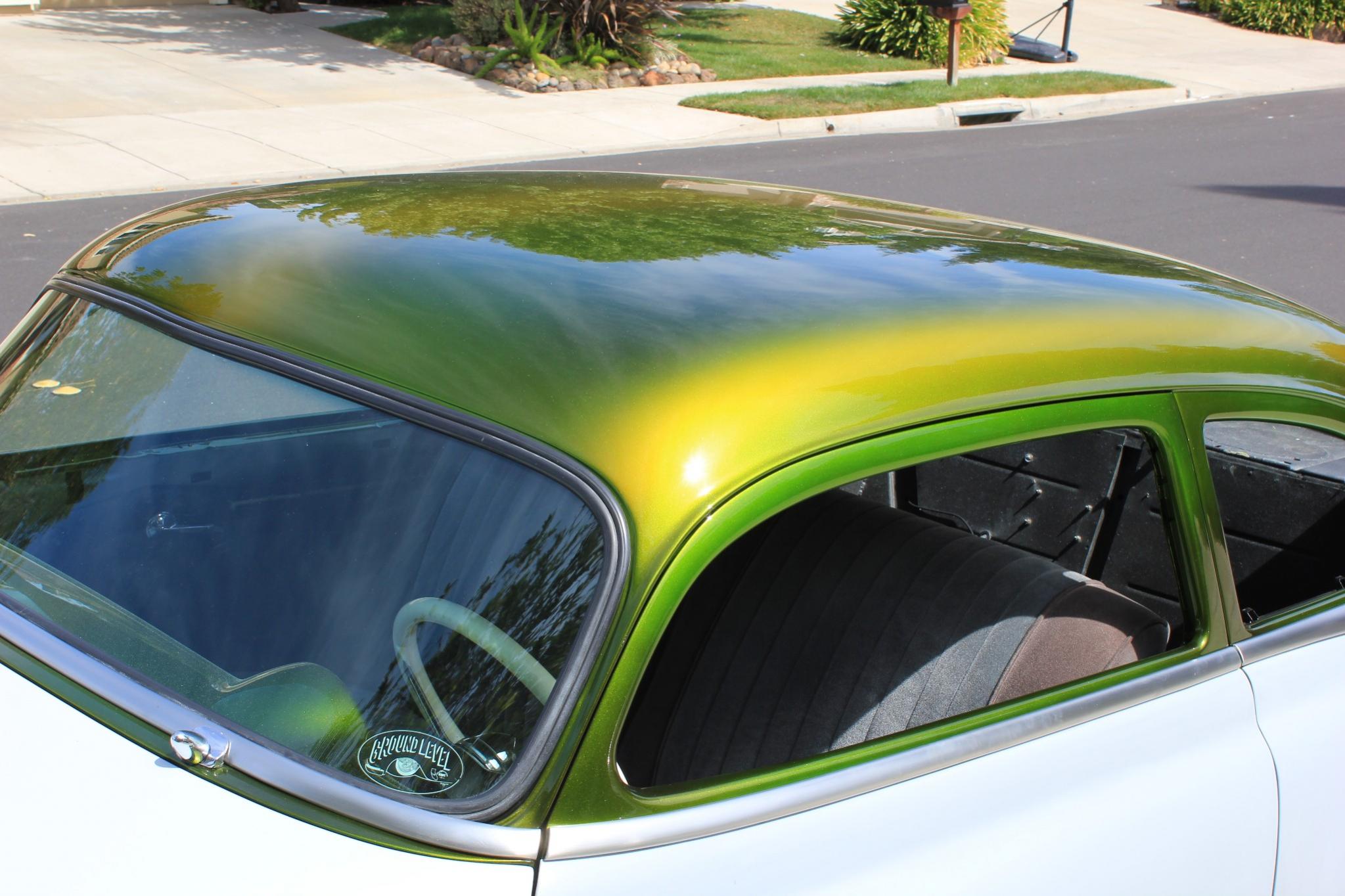

    that top is crazy. my camera didn't know what to do when I took a couple shots at Billetproof. does it have a fade to it or is that an optical dilusion?

    Thanks man! It is HOK Planet Green base. We then mixed some black into it for the fade. Then we added some silver to it for the lighter fade. Then the whole thing got 6 coats of PPG Moss Candy. I still get wood everytime I turn on the garage lights!

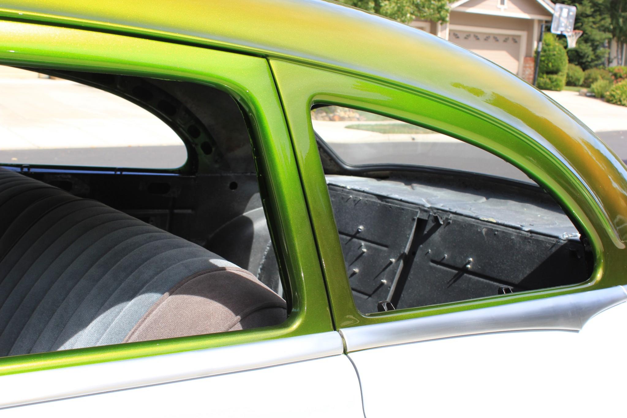

    I modified four-door Pontiac trim to work with mine. It allows me to use stock door trim. BadLuck has the Bad*** 2-door trim, and I believe you need the doors, shark fins and rear trim to make it all work right

    well for my hardtop.. I just bought the door trim and the "Fin" piece from a 2 door Pontiac.. the front windshield beltline doesnt change.. the rear i just had to shorten because my roof moved forward when we chopped it. So it wasnt a difficult installation.. difficult part is finding them in good shape!
