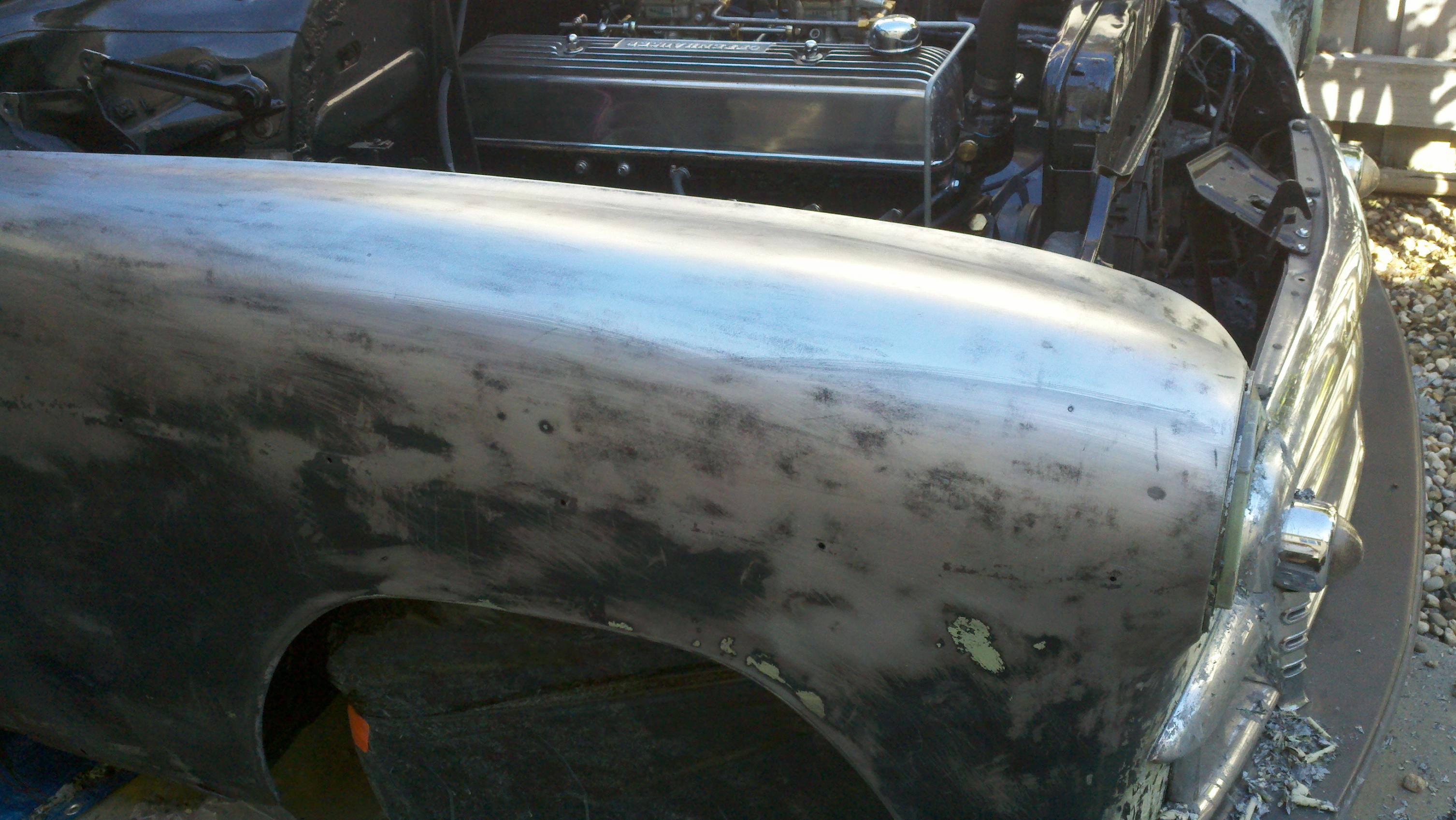

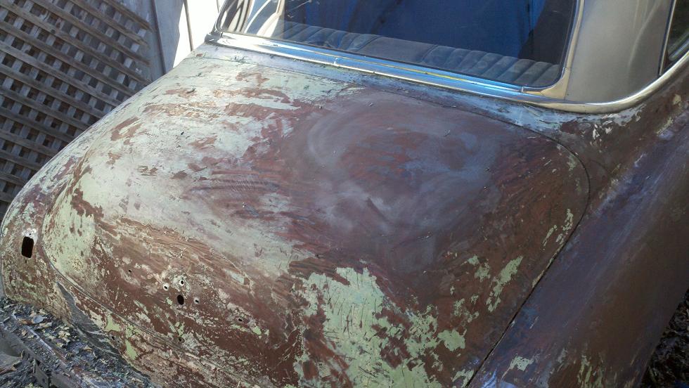

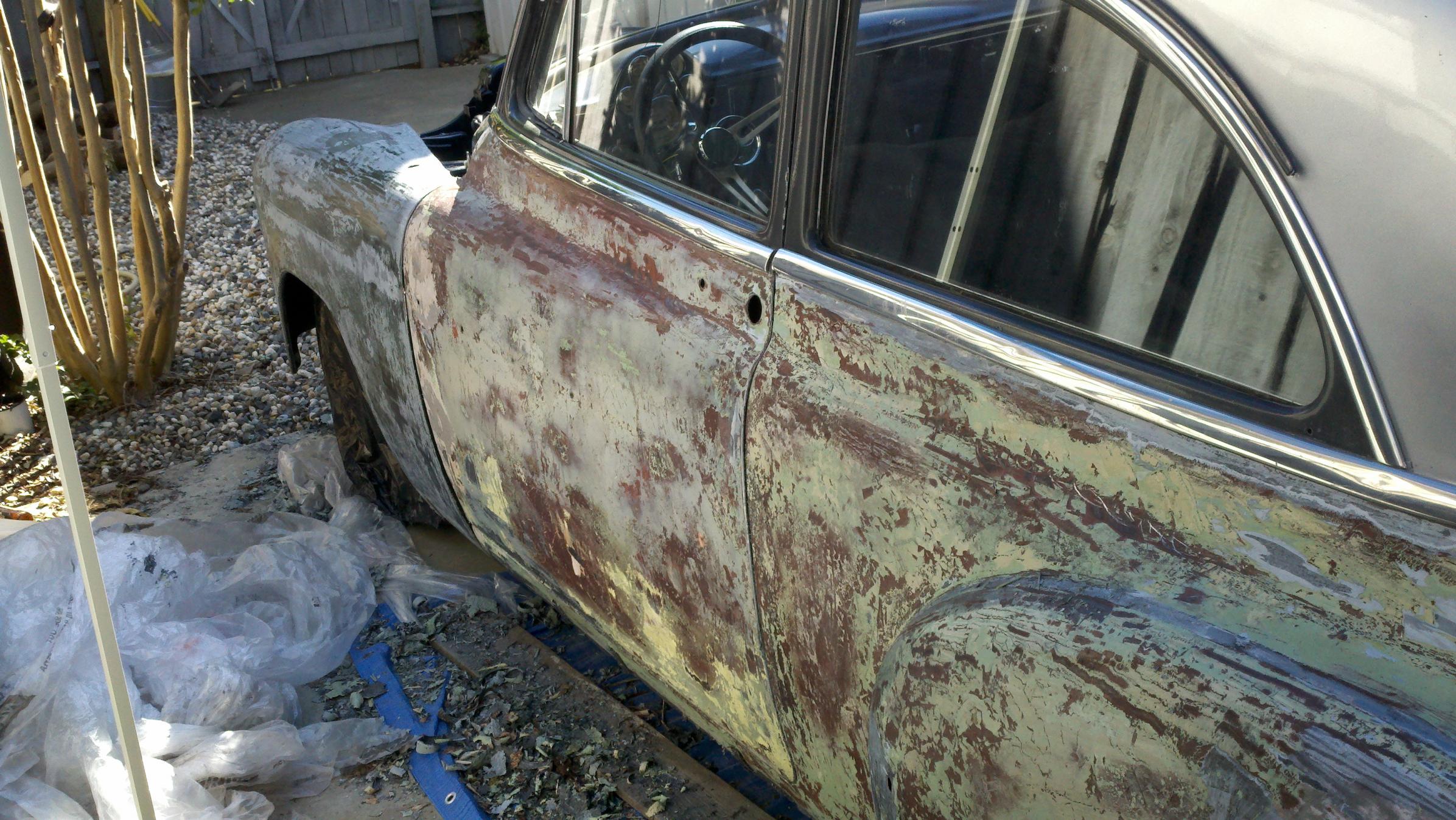

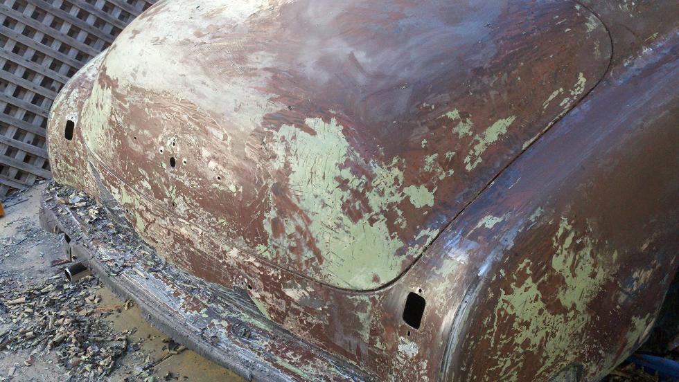

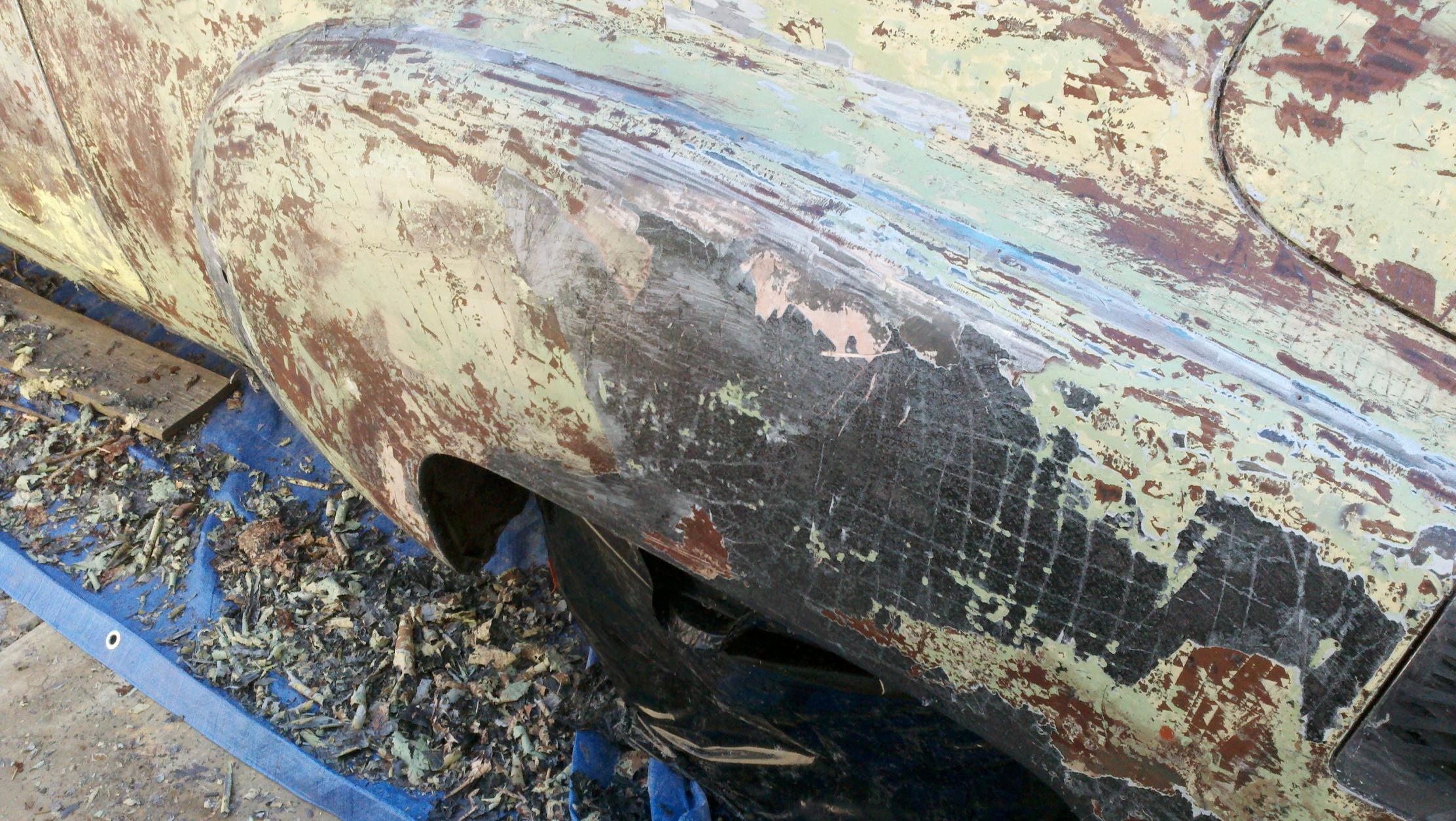

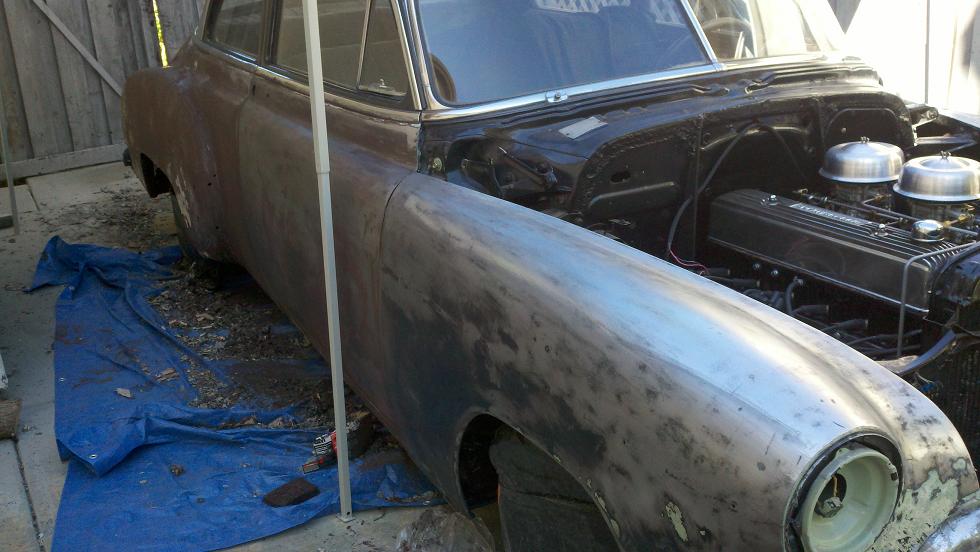

    This weekend I decided that all the old paint had to go. It was poorly shot, and was a little too glittery for me. I am gonna rock it in bare metal for the summer while I do the other body work on it.

    The good news is that I found very little evidence of rust. Some in the lower outer fender, a skim coat on both doors (but just a dent under it). Some skim on the panel below the trunk, but no rust. LF fender is not original.

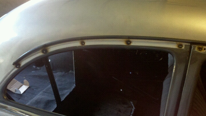

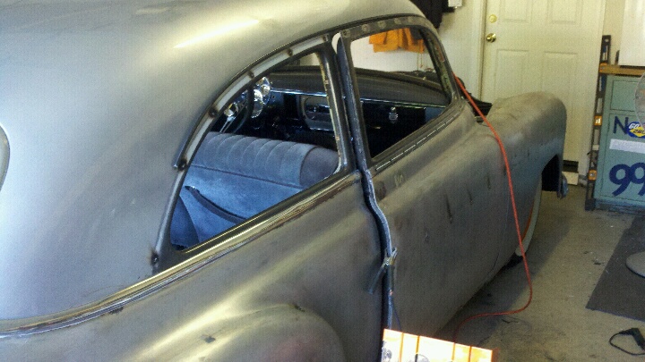

    So this week I decided to chop the car. I am thinking 4" front and 5" back with kicked B pillars and an extended catwalk. I made a deal with a guy who does it for a living to do the cut and tack, then do all the garnish and windows for me. I'll do the grunt work along with my welder buddy who owes me some favors..
    Got the headlight Frenching alsmost done and spent the weekend filling holes and stripping the interior to prepare for the chop. I am getting pretty decent with the welder, but patience is not one of my virtues, so I have to be careful

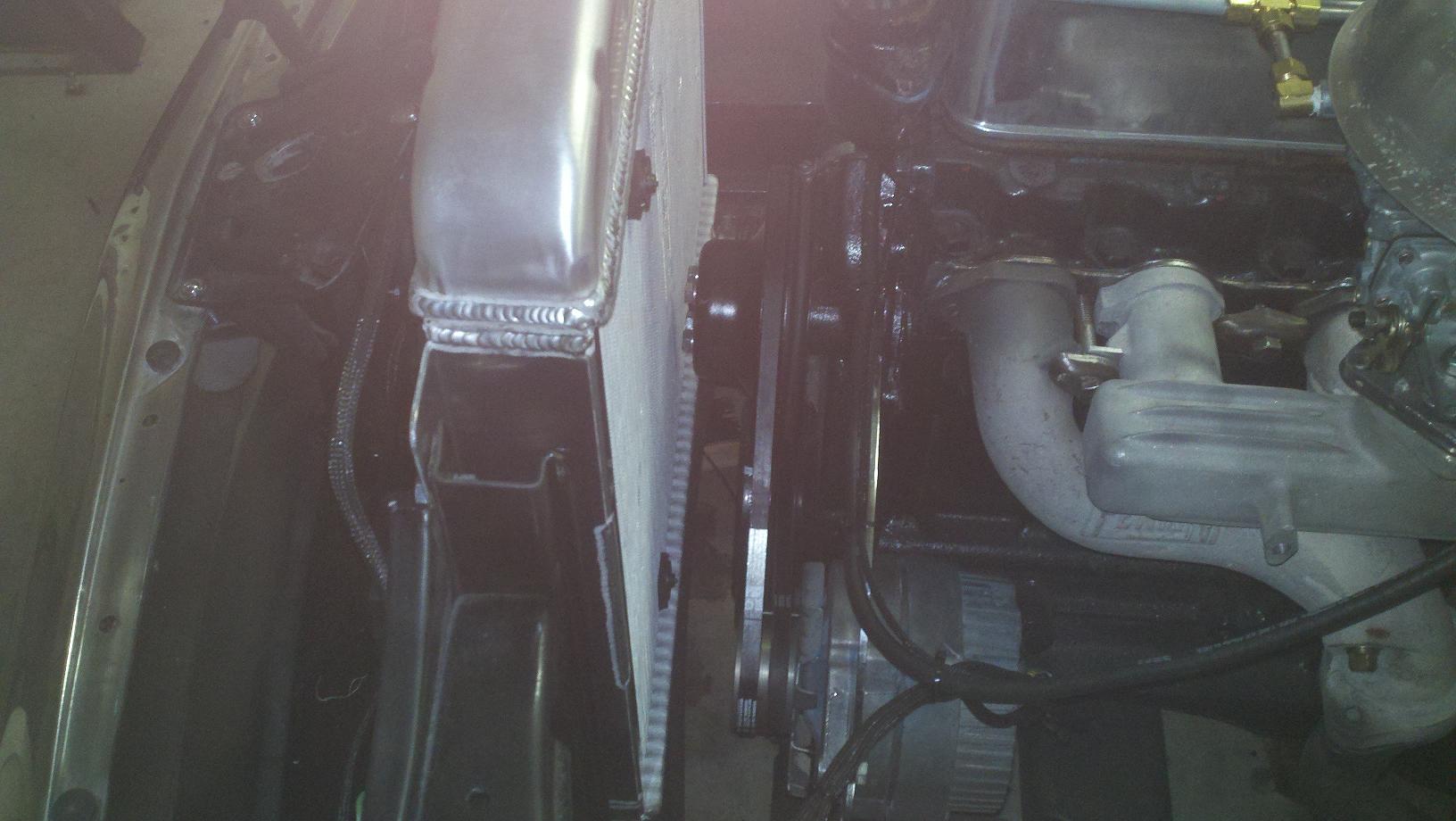

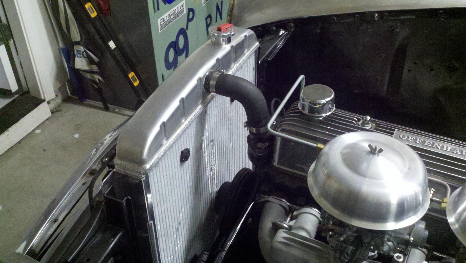

    Got some more done over the weekend. My "Drop In" Aluminum radiator would have probably worked on a 216 car, but not for me. I took the water pump off, shortened it as much as I could and still get it aligned (about 7/8" or so) and I still could not squeeze this thick *** radiator in there.
    I ended up moving it to the front of the support and re-doing the hoses and whatnot. I wired in the electric fan with a relay and temp switch so its brainless and protected.
    I also got the rest of the driver's side holes rough welded. Going to grind everything down tomorrow night and see what I have. I am learning alot about welding..
    Looks like we'll be starting the Chop on Friday, the 12th. Wish me luck, I want to get it together enough to drive to Billetproof on Sept. 17th. Pretty aggressive, but I like a challenge.
