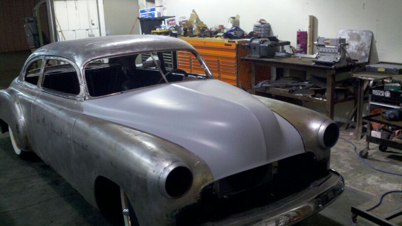

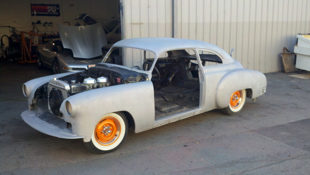

    Got it to the shop today cut out the supports and got the hood on it. Test fit the headlight too,looks *****in. Removed the rear window too.. trying to get it in sealer on Saturday .

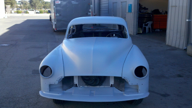

    Torn down and cardboarded up. She's going to get dusted at the media blasters so I can seal it Saturday

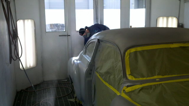

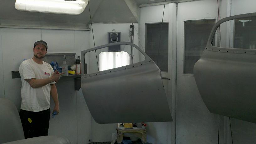

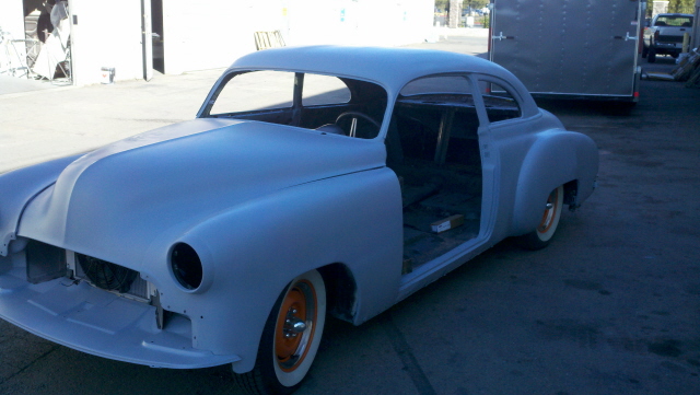

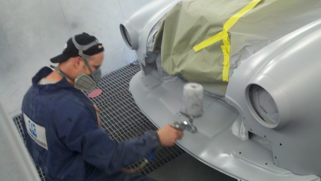

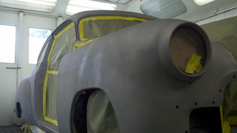

    Alright, here we go. I even included some pics of me with a spray gun in my hands...thats the only thing scarier than me with a welder in my hand:rolleyes:
    The blaster did a great job, Brian and I cleaned a couple of little things up, I finally removed the center pillar from the windshield opening and we got to blowing it out.. Damn that media get EVERYWHERE!!!. Took like 1.5 hours to get it pretty clean, and I still got some **** coming out while I was spraying.
    We even had enough time to get the hood, decklid and one door hung before we had to bail. Should be in decent shape by the end of the week, then I just need to get at least the new gas tank in it so I can take it to Tri Valley gl*** for the windshield.

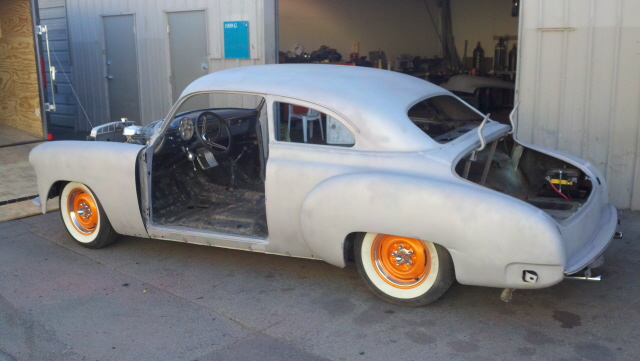

    New tank and modified trunk floor done. I have a very nice spare tire well that I saved if anybody needs one.

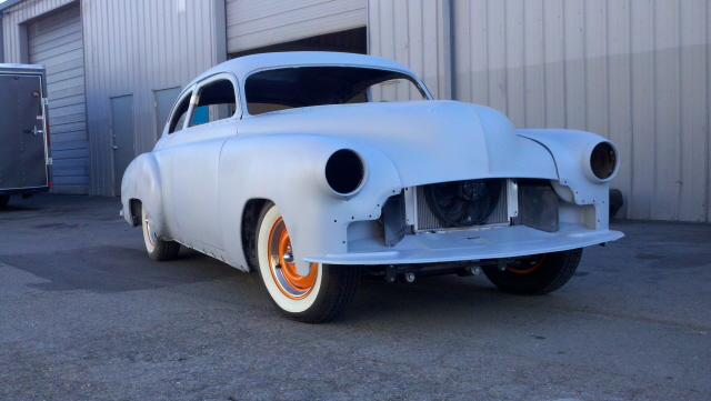

    Need opinions...drip rails or no? I have been wanting to keep them, but now I am thinking that the car might look smoother without them. Thoughts?
  29. todztoyz
    Joined: Jun 21, 2008
    Posts: 176
    todztoyz
    Erik, what did you do with the gas tank? Looks like its sitting on the tank flange in the pic. Looks good. 1 vote for drip rails.
  30. LeftCoastErik
    Joined: Apr 23, 2010
    Posts: 907
    LeftCoastErik
    Yeah, its a mustang/universal tank from TanksInc. Designed to mount on the flange. Removed the spare well, and made a piece to fill it in. Trimmed it up and its good to go. A little wider, but not as deep so I gained a bunch of ground clearance for the bags. Thanks for the vote on the rails!
