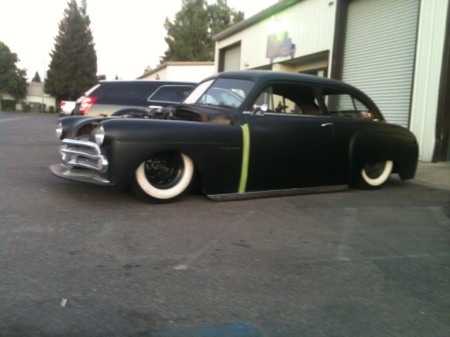

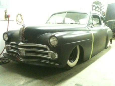

    Finally ready to do some more work on the 50.. new round of modifications include *a new stock floor body drop frame using a 1 ton dodge truck front clip w/ either 2x5 or 3x5 box tube rails 1/4" wall & a 5.9L ***mins 6BT turbo diesel and 5 spd trans..
    My 50 wayfarer as it sits..
    $350.00 dodge ram350 utility truck w/ a blown rear axle and a perfect running 5.9 ***mins 6BT
    Pot o gold... ***mins 6BT turbo diesel

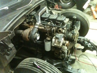

    5.9 ***mins set in place
    Motor mounts for the ***mins and where I spliced in the s10 front clip..

    Thanks for all the comments guys progress has been slow on my 50 been busy with customer cars (49 Chevy fastback and a 61 c-10) & low on $$ so my car is kinda on hold.. But there has been progress since the last pics the frame is finished and painted and the body is back on... still gotta build a new firewall and trunk floor .. Also need to have a drive line done and figure out a radiator.. As for stoping it it has a s10 truck front suspension so it had discs up front (kinda small discs) & I'm gonna be runnin discs in the rear as well... from there if it needs more ill put a BD exhaust brake on it & that will deff be enough..

    It was way worse before I pushed the motor back into the firewall.. but we'll see what happens it was the only halfway beefy front suspension that fit the car width wise & would fit the ***mins between the rails..

    THANKS MAN!! I'm hopin it will work out.. on the ***mins swap forums there's a few guys with the same motor put in s10 pickups the ones talked to say they haven't had any probs so far.. With over 2k miles on one of em.. We'll see tho..
    As for the air bags I'm runnin slam specialties RE-7s on all 4 corners & in the front they lift @ about 95psi full lift @ about 115psi & that's pretty close to the psi to lift a s10 pickup... the motor is 11" back from where the original motor mounts so a lot of the weight is off the front suspension.. Before I moved it back it took 165psi to lift

    man this thing is cool. I had a 4bta I wanted to put in my 49 coronet but i ended up putting it in a 91 suburban. Very cool build. I put a p-pumped 6bt in my 95 chevy crew cab dually and it's a heavy motor. I would see some problems with the weight on the front end after awhile. I would definately try to go to a heavier duty lower ball joints and maybe custom built arms. Those motors wear out dodge front suspensions and those trucks were designed for that motor.
