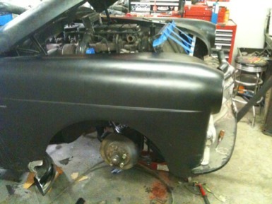

    Progress been slow again been a few months since I've worked on the 50 but I'm bout to get back on this thing full speed here's a couple new pics from the other night.. Got it moved back into the mix at the shop & got the exhaust started.. ImageUploadedByTJJ1327704464.481874.jpg

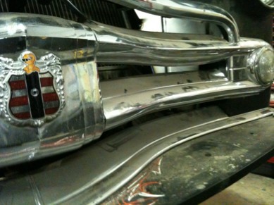

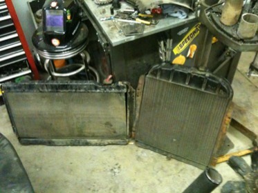

    Took a trip to the junk yard yesterday & got a a hydro brake booster help a LiL with the stoping & got the front end all lined up and bolted back on lastnight.. Now just tryin to fit a double sized radiator in the front of this thing & fab up a new core support/ front body mounts..
    Front end all lined back up
    ***mins radiator on left, stocker on right
    Gotta angle it a LiL for hood clearance
    Custom bend to get the radiator around the upper a arm

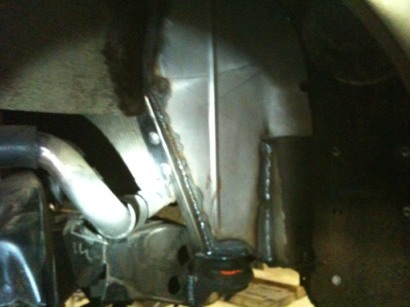

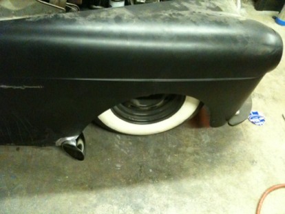

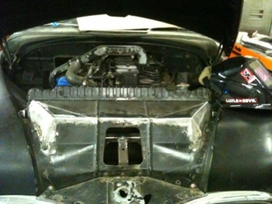

    Got a LiL done in the last couple nights.. Front body mounts. And new core support and the radiator is mounted now gettin the big *** radiator in was a LiL bit of work...lots of cutting...
    ImageUploadedByTJJ1328288499.481022.jpg ImageUploadedByTJJ1328288577.541421.jpg ImageUploadedByTJJ1328288676.262037.jpg ImageUploadedByTJJ1328288714.900491.jpg ImageUploadedByTJJ1328288750.165113.jpg ImageUploadedByTJJ1328288783.174542.jpg ImageUploadedByTJJ1328288812.001142.jpg

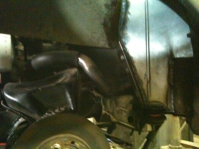

    LiL more progress on the 50.. Almost done with the front end (body mounts core support & steering) of the car.. Here's a couple pics from the last few days.. ImageUploadedByTJJ1328548336.625483.jpg

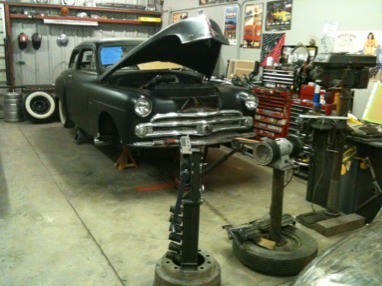

    Ehhh not too much progress on the 50 $$$ got a little Low again so it's kinda been on hold.. But I have finished the (removable) trans tunnel and driveline tunnel also finished fillin all the giant holes in the trunk... And started installing the rear disc brakes So my list is gettin smaller time to figure out a firewall and get the pedals n booster mounted.. Here's a link to a walk around vid on YouTube showing some of the interior sheet metal work..
