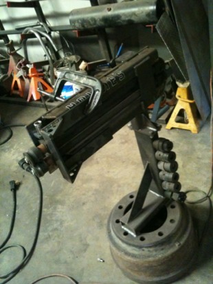

    Modified harbor freight bead roller..
    ImageUploadedByTJJ1338488874.923194.jpg notches all covered..

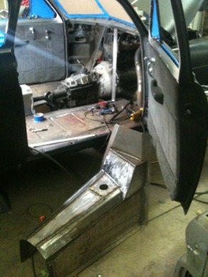

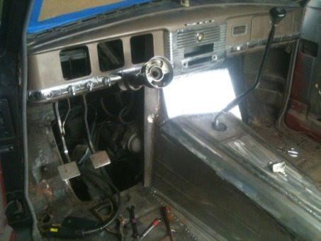

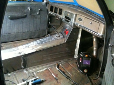

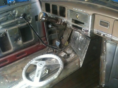

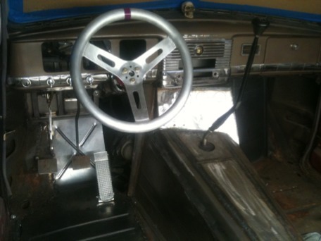

    start of the removable trans tunnel
    Trans tunnel all finished..

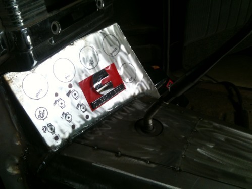

    close up of how my gauges/switches/ starter ****on will be setup
    Dash and trans tunnel pulled out it has to be removable so that I can service the ****** later because it sits so high up in the car so the car can still lay out..
    That's all I got for now..

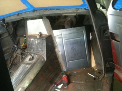

    Been busy with other peoples projects but i started to fill in the p*** side of the firewall not too much foot room over there but that's not really my problem haha..

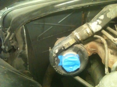

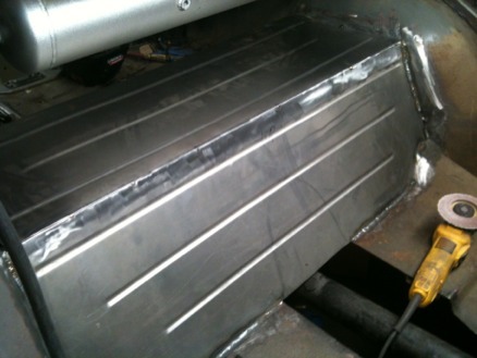

    Few more updates on the dodge.. Been doin a lil work on it again since I got some spare time & spare $$$ haha.. Got the p*** side of the firewall about done just a LiL more grinding.. Also made a nice speedway order(all my adapters, fittings, and hose to make my power steering and Hydrobooster.. Gettin closer only real fabrication left is the steering, pedals, driver side firewall and bumper mounts here's a couple pics..
    p*** side
    P*** side of the firewall.. Had to push it back 11"
    Driver side that needs to be filled in still..

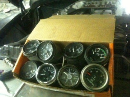

    Gauges outta a big rig for the 50 for $50..

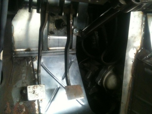

    Heres a couple new progress pics from this past week.. started to modify my stock steering column to accept the sweet mfg quick release hub.. got the clutch & brake pedals mounted and started on the driver side of the firewall.. Also got the Hydrobooster mounted up on the firewall.. Still gotta replace a rusty floor pan on the driverside and brace the back of the firewall where the booster is @..
    Steering column shortened and bolted up pedals from the donor truck
    Brake and clutch pedals mounted.. Gotta move the pad on the brake pedal over bout a 1/2"
    First piece of the driverside firewall in W/ the Hydrobooster fitted

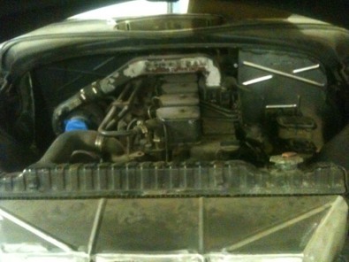

    Front view of firewall kinda gives u an idea of how far back I had to push the firewall to clear the motor..
    Another front view

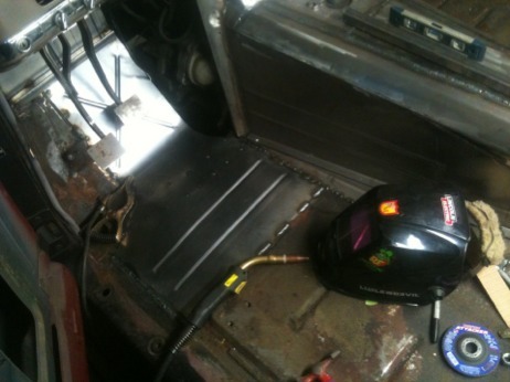

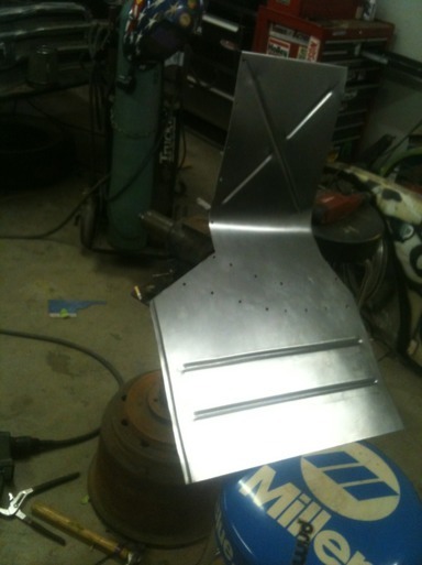

    LiL more progress on the dodge had to fix some rust in the floor so I could even attach the new firewall.. So i fabed up a patch panel & Braced the back of the firewall for the Hydrobooster and clutch cyl.. (still workin on the clutch cyl... That's actually tonight's project) also got the steering column shortened and modified to use a q/r hub and u-joint on the other end.. Gonna have to get creative with the steering linkage got a stack of sweet mfg u joints so lets see how this works out..

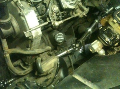

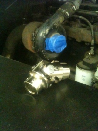

    Since i finally fount the u-joint that fit my steering box I got the steering linkage all dialed i... it's deff I tight fit runs straight through the vacuum pump o n the ***mins.. I'm eventually gonna get a vacuum pump off a 94-99 motor and it will clear up a ton of space.. But this works till then.. Spins super smooth no binding at all.. Also got the clutch pedal working.. here's a couple pics..

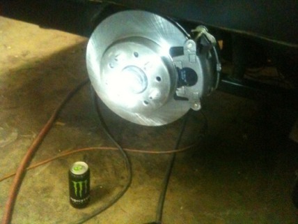

    Benn goin like crazy tryin to finish all the little things on the car.. Here's a few more progress pics the rear disc brakes have been givin me hell I shoulda just got drums.. On the plus side I thought my 9" ford rear had 28 spline axles but when I pulled it apart to change the axle bearings I found that it actually has 31 spline axles that will handle the torque (400ft lb) of the ***mins a lot better

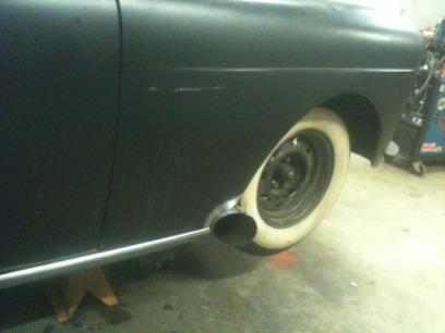

    Exhaust tip solid mounted and rocker trim modified
    Rear brakes ready to mount
    Rear discs installed..

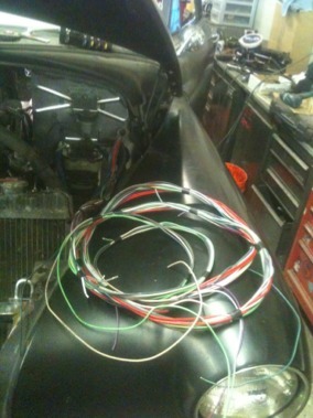

    Wiring has started.. ( not by me)
    My buddy Adam gettin down installing the mr roadster harness from speedway..
    New fuse box behind driver side kick panel

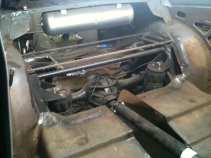

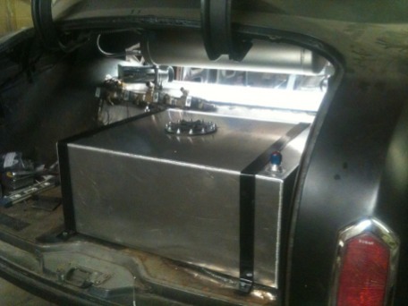

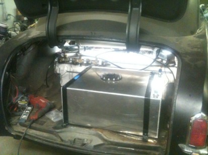

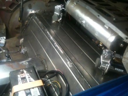

    Got the fuel cell mounted in the trunk also got the air tank viair 380 compressors and SMC valves mounted back there

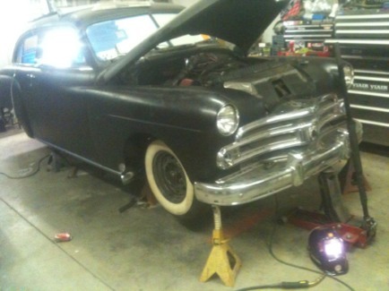

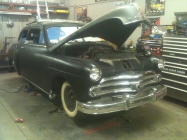

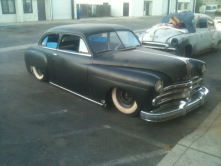

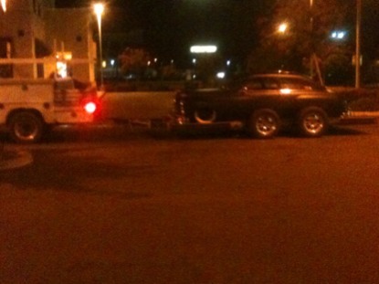

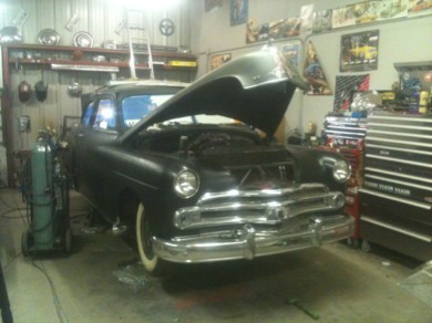

    Here's a couple shots of the dodge on the ground outside the shop.. Pulled a 37hr shift on it at the end starting thurs night till sat afternoon.. Tryin to make it to a show to hang out with some out of state club members & surprise em by Rollin up in my 50 but about 50 miles out my clutch master cyl gave out.. Almost made it.. But **** happens..
