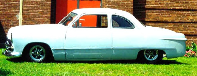

    I flipped the stock spindle suports on my 49...heated and bent the steering arms down and mounted the sbc high enough to clear the oil pan with the tie rod.
    I also used cut coils and lowering blocks. Replaced the original sway bar with a 70s 1.25" trans am/Z-28 bar.
    I had to do some floor work to get the raised engine/trans and drive shaft to clear ok. ...at first I used older bias ply tires on 7 inch cop car wheels but like your car, it dodged all over the road. I switched to radials and old E-T wheels and the Car drove like a slot car! Was a joy to drive.
