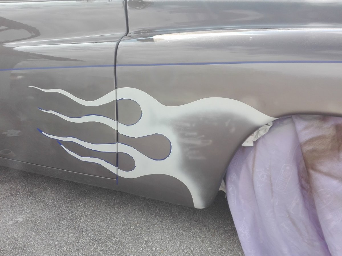

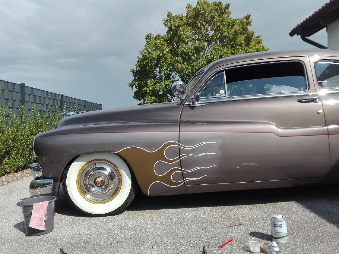

    Haven't updated this thread in a while, so here we go:
    After I had caused a "tender touch" between the Mercury and my father-in-laws 1955 tractor (my fault - never move your car around in the workshop in the night after some beers), the flames on the p***enger side were scratched.
    I drove the car with the scratches for a while but got fed up with people asking me what has happened.
    I was never very happy with the ghost flames on my car, so this was a good opportunity the change the flames to a more end of 5os style.
    As the paintjob on my car is not perfect anymore, I decided to give it a try and repaint the flames myself.
    First I sanded and filled the scratches:
    Then I touched up the damaged paint outside the flames with my airbrush.
    Then I painted the outline of the flames in Ivory.
    Finally I painted the flames in a very dark greenish gold:
    The same procedure on the unscratched drivers side:
    Then some layers of clear and blend in clear coat. It depends on the light but most of the time the touch-up of the scratches can't be seen. I'm happy with the result.

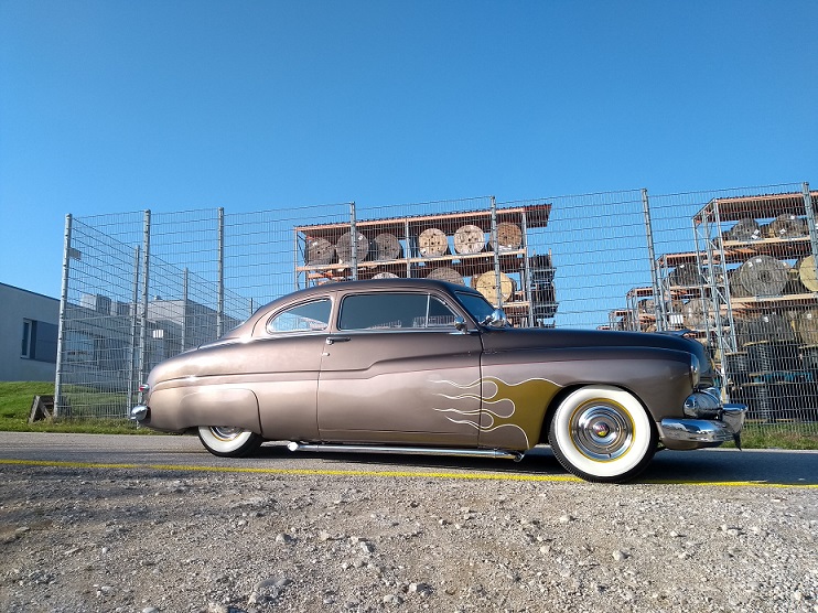

    Side pipes were on the car when I bought it but I had taken them off years ago. Last week I put them back on for a change and I like it. Gives the car a late 50s vibe with the flames.
    Took the car out for a last ride today before winter. I enjoyed it a lot.

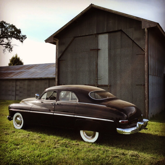

    Yes, Jerry Quesnel's is one of my favourite mercs, but I do not have the balls to chop mine.
    My car was originally sold in Austria in 1950 and is one of the very few Mercs from that time that has survived. In fact, I only know 1 other example, a 4-door 49 that was also originally sold here. The 49-51 Mercurys, that you find in Europe today, were mostly imported from the US in later years.
    So I keep it a mild Kustom and most work can easily be returned to original if anyone wants to.
