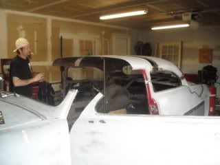

    Lets cut the roof off...thats the easy part! It took 2.5 attempts to get it correct :)
    It was that close...

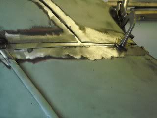

    First attemp at the roof was a little tough...there was a lot of gapping between the pieces of the roof.
    The chop is a 5" chop at all three points! Basically a square chop (like a late 20s early 30s car) on a curved roof from the 50s. The 49-51 Shoebox has 3 distinctive curves/archs...not the best for a square chop.
    We measured, measured some more and remeasured some more...finally I figured it out! The tape measure was the problem! Seriously, I just tossed the tape and went with look and feel.
    Thanks to my dad and a spool of bright pink twine...it seemed to be coming together. But the gaps still didn't give me the look I was wanting.

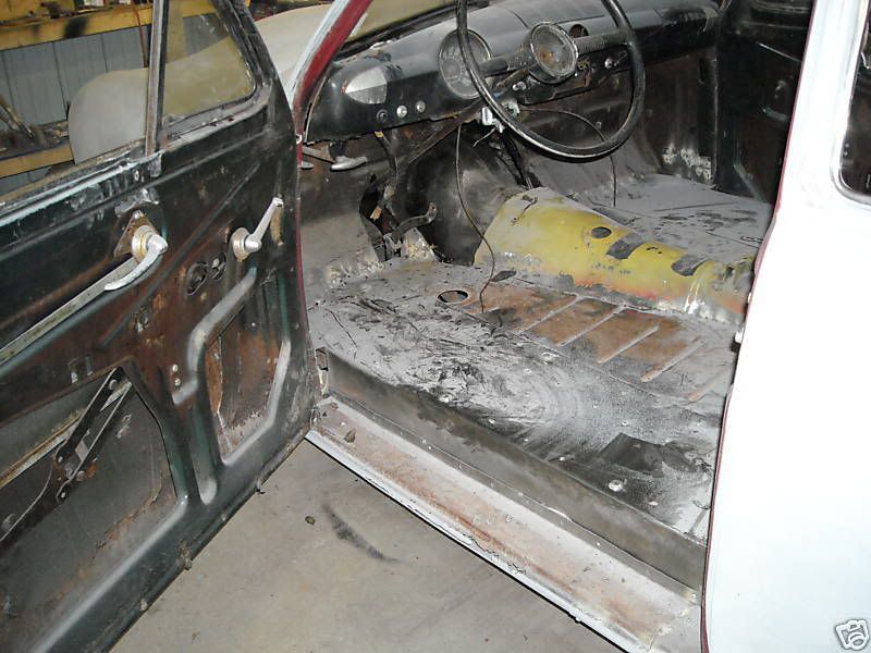

    I originally had a 4" channel but it was terrible! Sounded like a soda can when you got inside. The floor ended up being unsalvagable...so when in doubt, cut it out!
    Yes...I sat the car on the rockers and cut the floor out completely! Then I started bracing up the body with a stick frame.
    Once the front was square, it was time to start bracing front to back.

    Like I said...the floor was shot and one night I was look through old pictures of projects, thats when I came up with the idea of doing a laddered floor. So once it was square I started building the tranny tunnel and bracing it throughout...I might be a little over engineered.
    I later realized that the stock tranny tunnel on the frame would be too low...so I fixed that with a new taller one, you'll see that in future pictures.

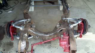

    Speaking of the frame...I am building this to drive a lot! I have 3 small kids that will be in it, so I wanted it to be solid and easy to control. Therefore I went with the S10 front clip option instead of paying out my ears for Jamco...plus I wanted to be able to lay it out flat with the air ride.
    This part I actually measured a couple of times...and with the help of my good friend Craig, we got it put together pretty nice.
    Rear with stock leafs and axle
    Front with S10 squared and secured in place
    Rear is stripped and about to plate the front

    After the front was plated it was time to start on the air ride. Since this wasn't a bolt on rear end, it took a few different mockups for it to get good. As for the front, that was part of the benefit of the S10 clip...the front was assemble (for the most part).
    I decided to use an S10 rearend (it was there free :D ) and it made the bolt pattern and width match up. But to get it low, really low I had to make a sizeable notch in the rear. I wanted it to look a smooth as possible and didn't want a huge square notch in the way. So I played with it a little. ***Note that all of my metal work is done with basic tools, I don't have a plasma cutter so all my cuts are by hand shear, chop saw, sawzall and grinders..
    Enjoy the crazy!
    Front end with tubulars arms and bags. There was some additional cutting an modding on the front clip but it will lay the frame flat with a 28.5" total diameter wheel/tire combination.
