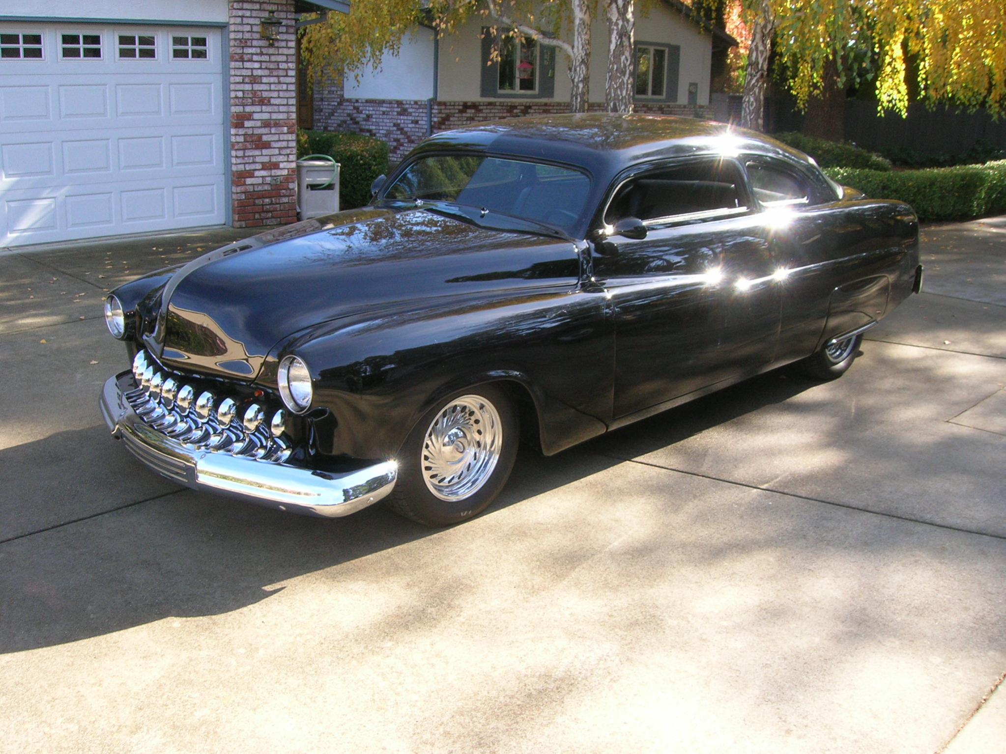

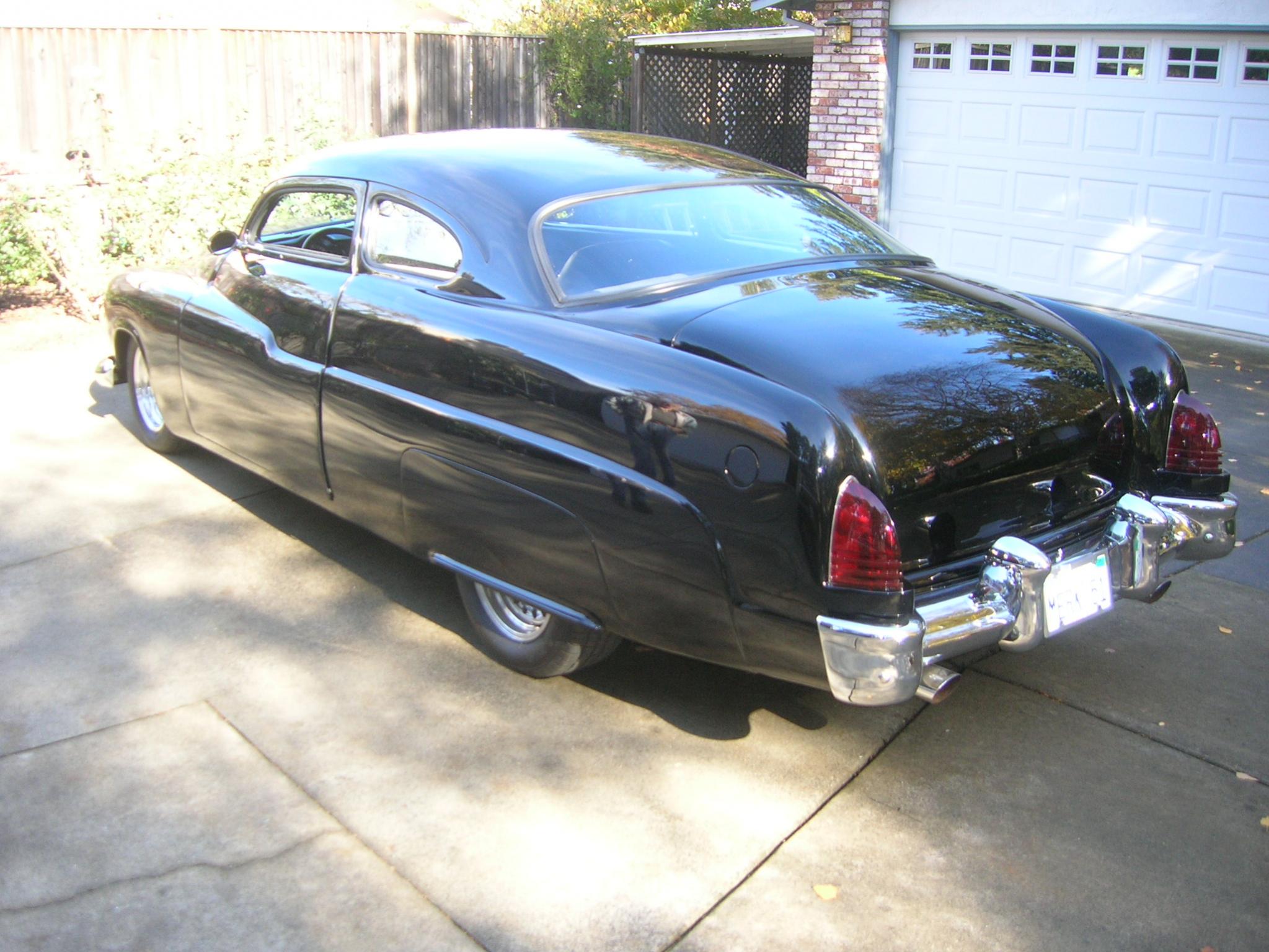

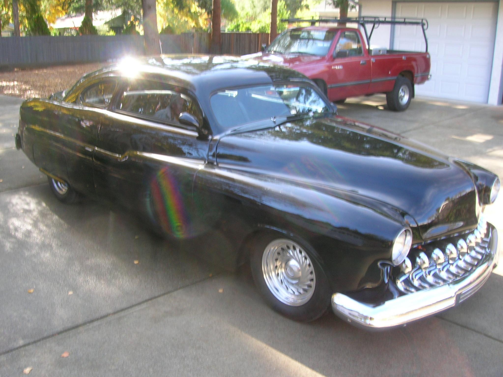

    Nice car and a nice model to begin with. The '51 Merc's are a stand alone car body to me. Attached are photo's of an old Boyd Coddington '51 Merc that is now in Napa, CA and due to unknown reasons is for sale again.
    Normbc9
    Aussiepete. likes this.
