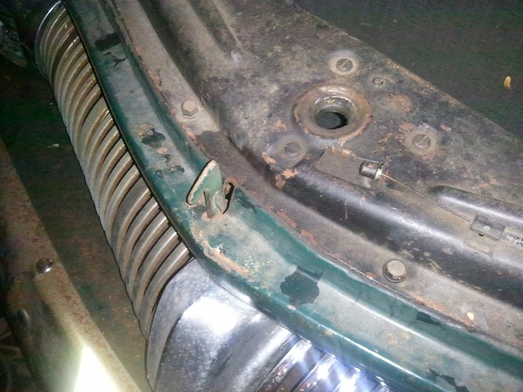

    I somewhat freaked after reading things and had to go look- Had the safety latch "groove" been filled in? And,does it have the provision for the catch latch itself? Not an expert by any means,so do not know if some came with/without. You can buy the catch arm,but mounting? Just checking. Enclosed are a couple of pics for reference.....Let me know if you need more shots-M
  8. Hey Mike thanks for the pics I haven't looked at the underside of the sheetmetal yet. From your pics it looks like the latch is bolted just underneath? Or what is that black plate to the left of the latch?

    John- Your 3 screws going thru around the hood popper catch-it bolts undernieth..... The parts you bought are correct,but if theres no provision there,your gonna have to drill bud.Mine's spot welded to the underside. No sense in welding it as your painted,just a couple of shiny ****on heads should do it.!.!. Hopefully when you "groove" for the safety arm,you'll be spot on. I would recommend trying to have one with the groove to look at for reference,but if not,I can take pics and measure as best I can!

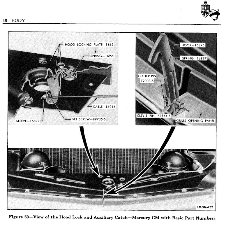

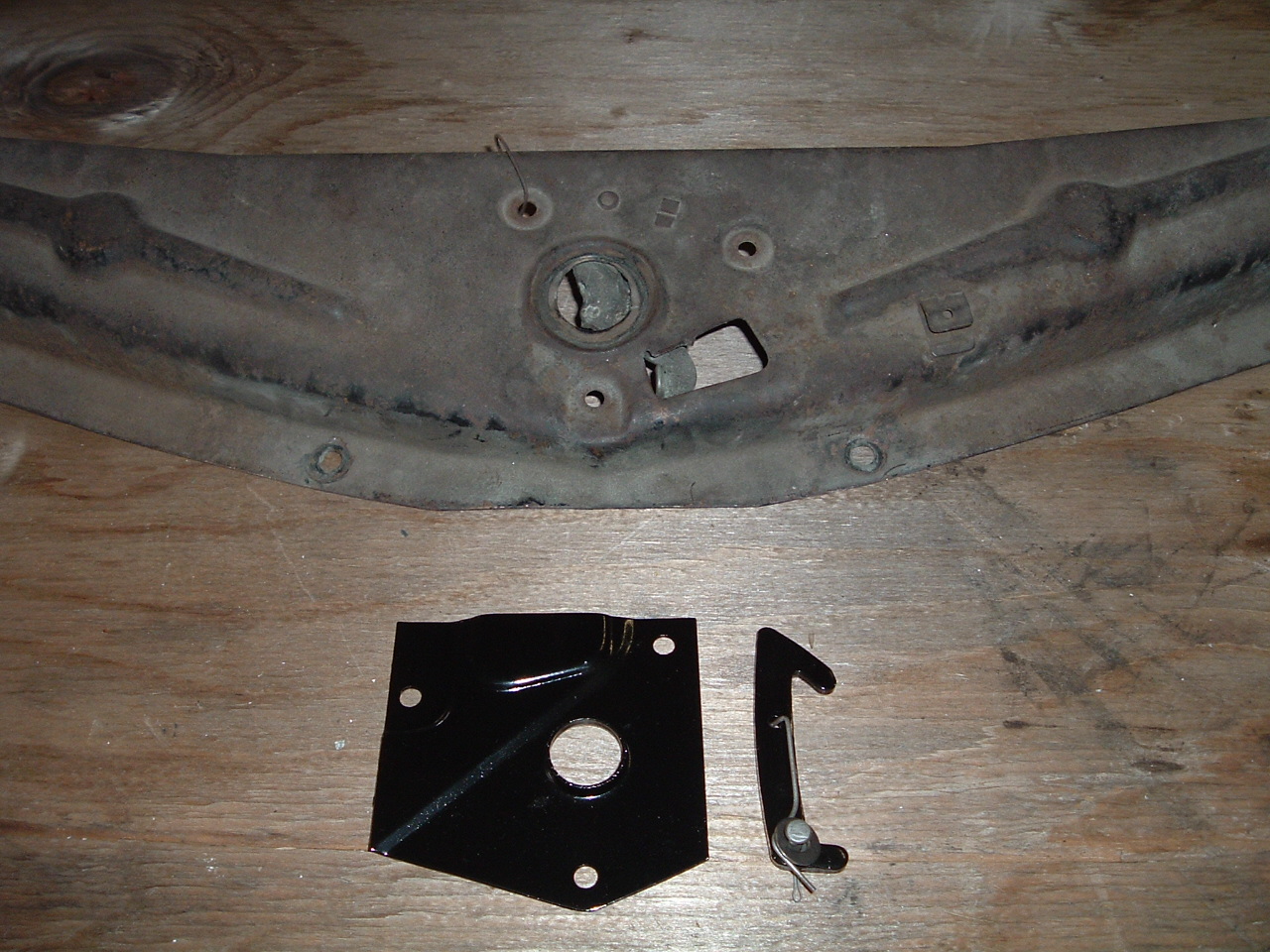

    Hey John. I took a couple of pics of my stock 50.
    I think the latch hooks into that circular opening
    I'll also see if I can extract a page from the OM.

  11. You guys are the best!! I totally get it. Yeah I'll look for the slot in the underside of the hood or will add one, and I'll plan to bolt the bracket. Mike you said three bolts, I'm thinking this little bracket will use two right, just one on each side?

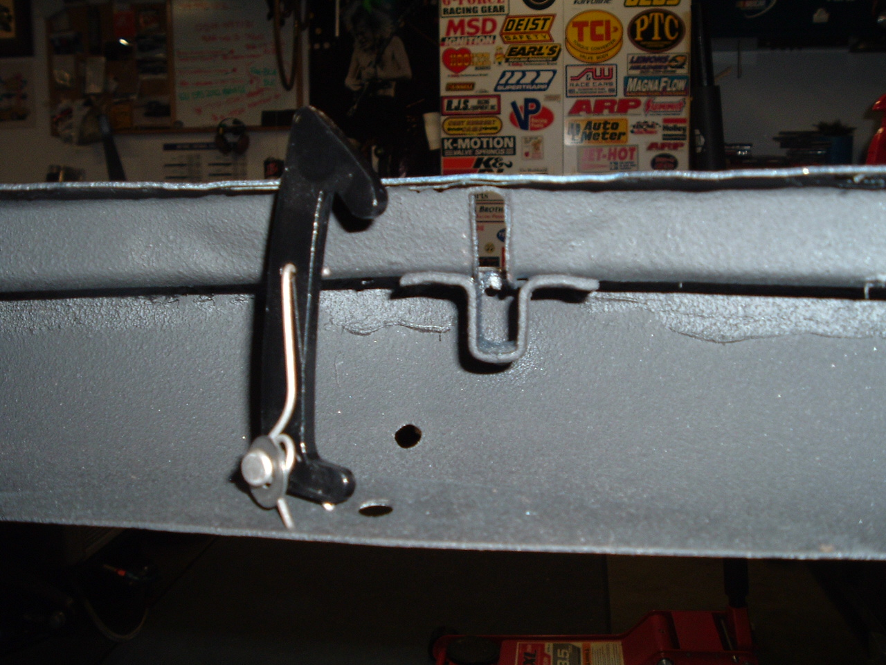

  12. Jim J
    Joined: Jul 11, 2011
    Posts: 87
    Jim J
    one more.

    I looked at my hood has I think those holes. Is the latch actually off center, or centered?

    definitely off center.
