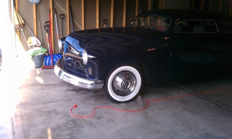

  1. Mr48, actually the builder shaved the safety catch because he welded in roundtube inside the nose....
  2. FWIW, I drive Miss Mercury last weekend, drove fine but the hood thing makes me nervous so I never went above like 40 mph. :)
    Hopefully can add the safety latch sometime in the next 30 days. And hopefully the hood will adjust down without needing anything replaced.

    An Ex is a former and a Spert is a drip under pressure but I think I could qualify as experienced or something there abouts. The front hinge is pretty much straight while observing from the front. From a side profile, it doesn't straiten out before stop contact. It still has a slight V to the rear. From what happed to your car I'd figure that the very bottom of the front hinges could have bent a bit toe in due to the upward force it they took. When the fender bolt location bowed up it would let the lower tip bend just a bit. The up stops on the upper hinge parts may be deformed from the force they sustained. The fender & inner panel areas affected by that jolt may be a real bear to get back into the correct position. That is likely what is holding the rear of the hood up so much or at least a good part of the problem. The hood reinforcement panels where the upper arm attaches might be a little misshapen too. The upper points stressed down and the lower points stressed up equal hood high at rear in the hood down position.

    I think many of my hood issues are similar to yours. I think my front hinges are bowed and I know for sure my fenders are pulled up at the hinge bolts. Reading through the other merc hood alignment thread, it might be possible that new hinges and bumping the fenders back down may get us most of the way home. I have new hinges already, but have not put them on. The other thing suggested on that thread was the rear hood spreader being tweaked out of place. Mine was all cut to goof to make room for the really sweet "portholes" in my hood, so I have a new spreader, too. Your hood doesn't look bent all up like mine does, so hopefully new hinges and getting those fenders back down will get you all squared away.

    Back the Mercury. I haven't had a chance to bring it to Paul who painted to adjust the hinges, but I need to as well as add in some sort of safety catch cuz I'm scared to death of that happening again.
    My current fan/radiator setup is not going to cut it as it gets hotter. Maybe some folks don't mind to see the temps sitting at 200-210F, but I get nervous. Once I pay off some window stuff my next stop is to change the radiator and maybe go to a bigger fan.

    John, my hood is whacked almost identical to yours. I just got a set of good hinges back from ChromePlaterJosh and plan on installing them shortly as well as trying to tweak the fenders down a bit to see how close I can get to being back right. I'll keep you posted on how it works. Hopefully we can fix our hoods with minimally invasive intervention. ;)

    Hey John, have you gotten your hood straightened out yet? I just walked in the house from messing with mine and I am happy to say I finally have a hood that is in the ballpark. It's not 100%, but I'm 75-80% there, which is pretty good considering how out of whack it was. It now closes flat, although my gaps are still pretty off and there is still some straightening that will need to be done, but I'm not in a position to mess with a bunch of sorting out bodywork at the moment.
    I took pics of what I did so I can show you, but they are still on my phone at the moment. I'll get them up in the next few days, but quickly, here is what I did. First, we removed the hood and the hinges then we set the hood back on so we could see where things might be bent. As expected, the fenders were bowed up a good bit where the front hinges attach. At the advise of a collision repair friend of mine, I used a chunk of 2x4 and hammered the goof on the fender flange in that area with a bfh against the 2x4. I really wailed on it to bring the flange back down...mine was up 1/2 of an inch or so on each side. While a fair amount of under coating dropped out of the inner fender, I didn't really hurt the fender paint any (not that my paint is anything to be too worried about...but it might be encouraging to know this may not hurt yours) except right on the flange itself where I had the 2x4.This really dropped the bow in the fender back down. We used the hood and the reflections in the paint as a guide to see how we were doing.
    Also, knew the the hood was sprung a bit, the hinges were bent and the brace that goes across the back of the hood had been "clearanced" for the sweet portholes that were cut into my hood, so I ***umed the brace was bent up pretty good to since it had been severely compromised strength wise with the chunks chewed out of it. I had acquired a new brace (it didn't hurt that it had been chromed at some point ;) ), so we removed the hood and used it to get the hood back close to in line. It had been pulled in on both sides at the front of the brace. I used a piece of 1/4 inch plate to hammer inside the hood lip to get it back out. I'm not all the way there, but a whole lot better. Finally, I replaced the hinges with a fresh set I just got back from Chrome Plater Josh. In the end, I think only my front hinges are bent...the rears look to be ok when I compare them to the new ones. There is a bit of adjusting to finagle with the back hinges and I need to do a bit more, but for 3 hours work, things are looking a whole lot better.
    Like I said, I'll post up some pics, but I wanted to post quick to give you some ideas about how to look at yours and see where you are at and what might help. :)
