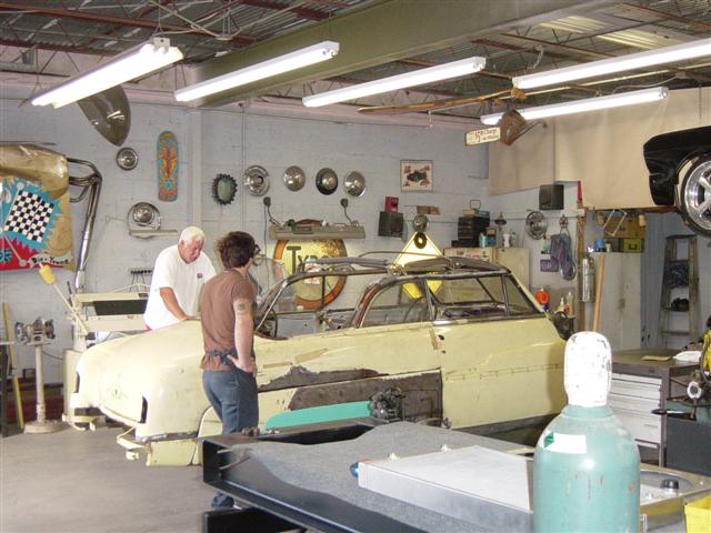

    John, I think that the rear fender line you speak of is stock on '51 Mercs, but is usually hidden by the big stainless trim piece that goes in front of the bumper.

    My car has this line. My rear quarters at welded on all down the body line except to this part. As a matter of fact, the stock stainless trim holes are still there on mine...filled with bullets. The holes are above the body line, so as mentione above, as stock, that big piece of stainless covers the line

    Here's the way it is on a stock Merc. It looks like the vertical p**** line has been eliminated on John's 51 - leaving only the top edge of the panel where it meets the bumper.
    That sheet metal extension is what makes lower rear quarter different from 49 and 50's.
    Looks good either way.

    This is interesting, a long time ago I noticed that radiused corner and what looks like a non stock 51 body line.
    Since we are talking about it now, my guess was some time in the last 50 years, someone replaced that section with a 49-50 quarter panel. On the 49 50's, that ridge sticks out just a little bit from the quarter panel where your arrow is pointing, then the ridge goes around the corner and turns into that big (rolled pan shaped) gravel shield behind the rear bumper, which also sticks out from the body.
    On a 51 there is also that radiused corner and then a horizontal line, but on the 51 it's just a gap/joint and the panel above and below that joint are flush, the bottom section doesn't stick out. Just guessing.

    You know, that kinda makes sense. I just walked out to mine and took a quick look. The rear section where John's arrow is is flush on mine as Mike points out. The vertical line coming down is sticks out all the way down, but where it makes the transition to the horizontal line it only sticks out right at that radius and then all the rest is flush.

  22. Okay I gotta get some stuff done here. Where would you guys suggest I bolt the floating grille brackets, #1 location (vertical spot in core support) or #2 (flat welded over sections of the nose)...

    My end brackets are mounted to the bottom of the vent intakes, which is the area you have marked off as this flat spots. I also have a center bracket mounted to the center support behind the hood latch (this support may be something someone added once upon a time and might not be a factory thing). Excuse the dirt and bugs....its been seeing lots of miles. ;)

  25. Okay keep the little seams or weld it complete smooth here?
  26. Skirv
    Joined: Jul 5, 2006
    Posts: 1,183
    Skirv
    I would make it smooth if I wasn't trying to replicate the Sam Barris Merc to exacting detail.

    I would keep the seams. Everybody makes everything too smooth nowadays.

    Another vote for smooth. No real good reason to keep them.

    Make the seam go away...
