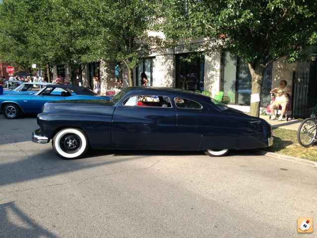

  10. Had it at a local car show on Saturday. Gonna bring it by a friend to finally change out the radiator and probably go back to a mechanical fan. Then gets the grille.

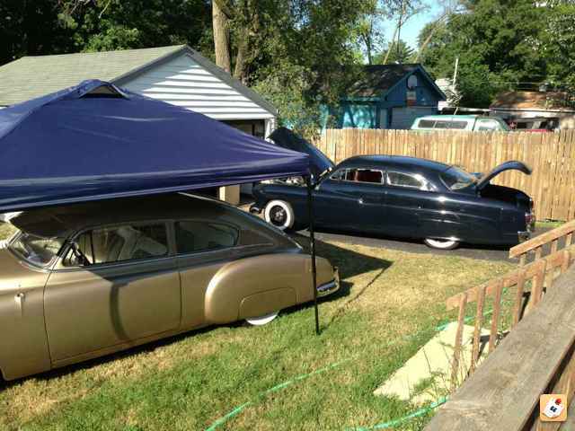

  12. The current cooling system is not cutting it:
    radiator - 4 cylinder Pinto? That's the current guess
    160 stat
    Electric puller fan
    No shroud
    Plan
    New swap radiator
    Mechanical fan
    I could only reuse my electric as a puller if I remove my AC condenser, or how would you mount that?
  13. Over at Joe's house he is swapping radiator and troubleshooting front end wobble.

  23. Dave, a factory radiator bracket (upside down 'u') is going to be installed and then the new radiator is getting attached to that. As for the top-mounted factory bracket, I haven't bought one and honestly don't know if I will.
    Ply, lol. Totally agree. I'm basically doing stuff backwards. I was so excited a few years back to redo the body I skipped over things like mechanical reliability and detailing the engine compartment.
    So right not driveability and reliability are the top priority, and then finishing off that damn grille. Then the interior. We are talking about doing the interior ourselves (couple of guys).
  24. Thanks to my buddy Joe who I shall know forever refer to the Mad Fabber... And Dave, the gray bracket is the factory Mercury bracket, bought it off eBay.

    Radiator, fan, new transmission cooler, hoses.
  28. Big shout out to Joe V, aka KOTC, totally has put my car back on the read. Can't thank him enough. He's still working out some bugs but he's addressed a few issues that have really kept me from driving the car too far due to chronic overheating issues and some other things.
