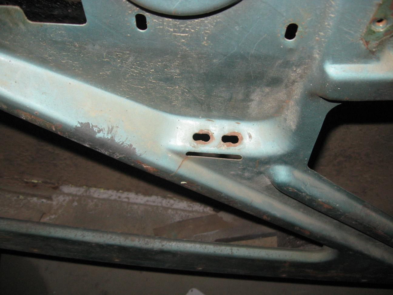

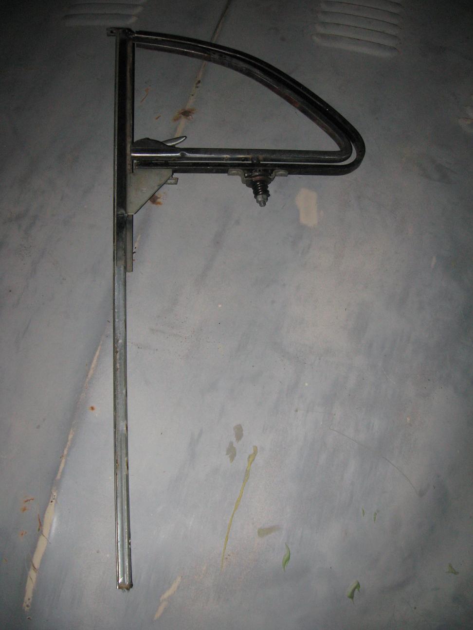

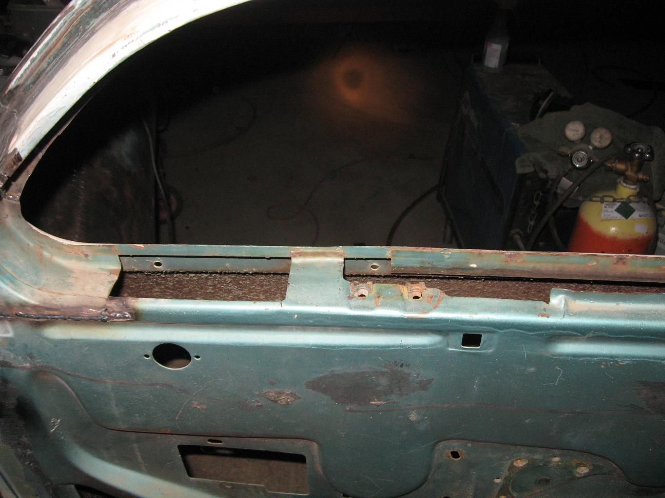

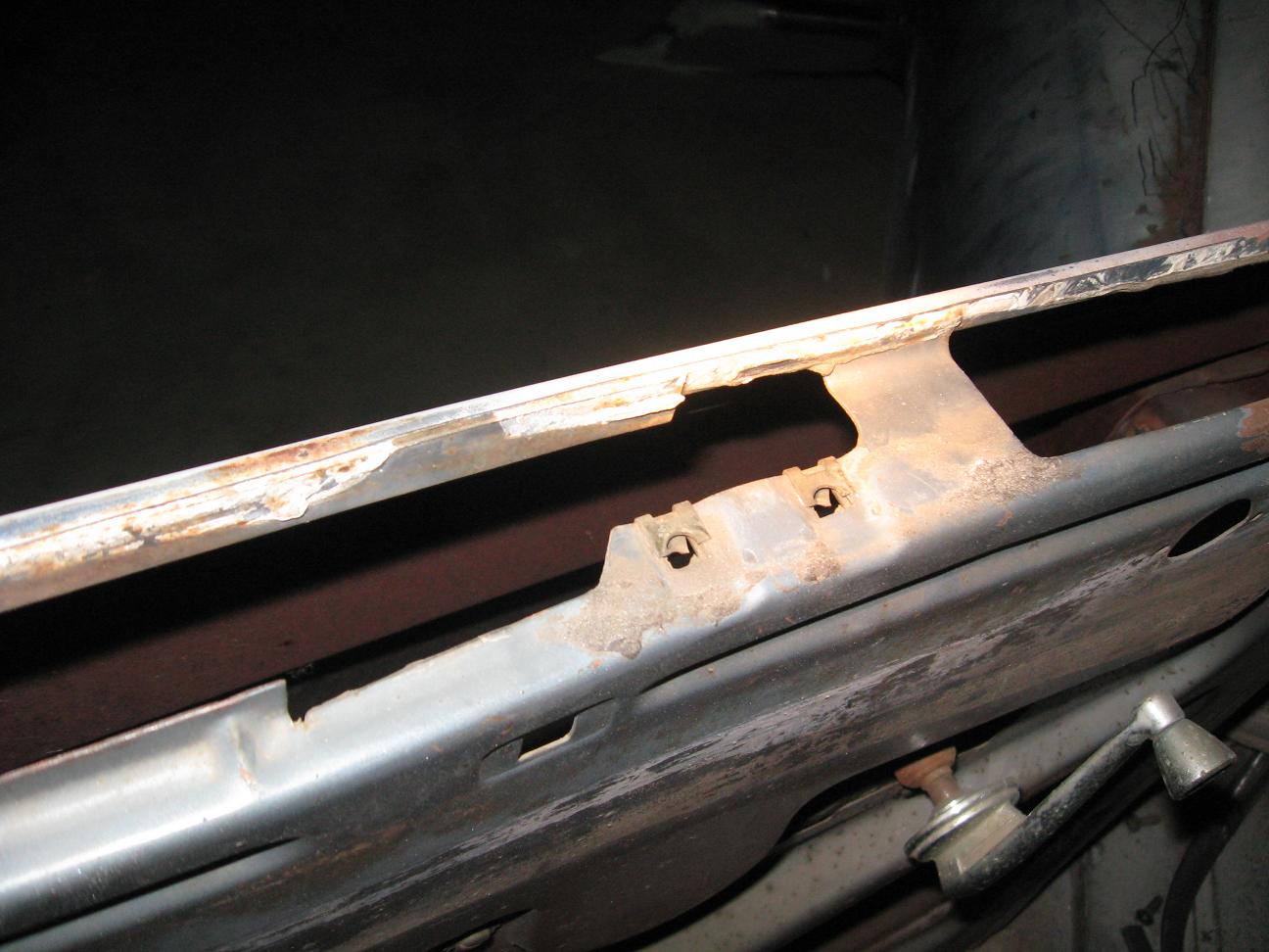

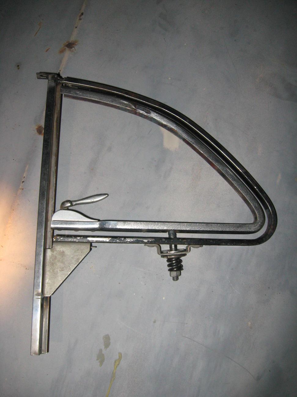

    Since you guys suggested I should get the right stuff, I got some from Bill Papke. I'm worriedy about my doors, anyone have a pic of what the vent windows attach too?
  15. slddnmatt
    Joined: Mar 30, 2006
    Posts: 3,685
    slddnmatt
    they attatch to the one hole at the top of the division bar, that you will have to drill and but a small screw in. two screws at the base of the window opening and two at the bottom of the division bar. your division bar should only be about a foot long. when you add the new rigid run channel to fit in the division bar, the lower bracket gets riveted to it. the rigid channel is held to the division bar by either rivets or bend tabs that come with the division bar seal kit that you will need. i was messing with these tonight.
