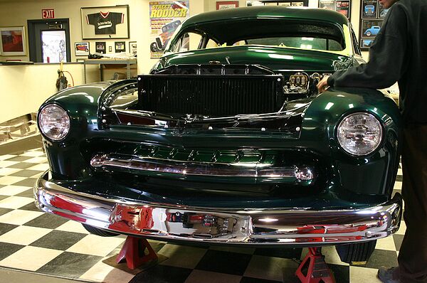

  8. Here is my primary plan Chaos, took a pic just for ya:
    Here is another possibility:

    I'm starting to like your lower option.
    I have a 55 desoto for mine, but I'm thinking about doing something that is simpler. Single bar and some markers maybe. I'll see what you come up with for a little influence.

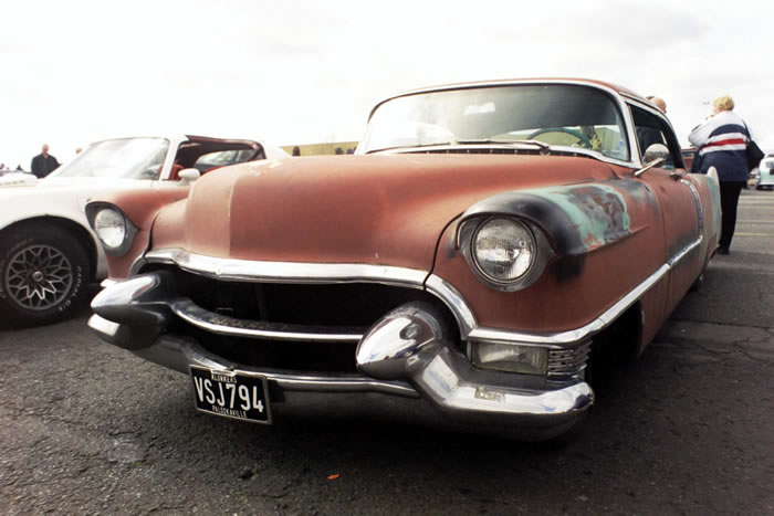

  15. The upper pic has '51 Ford grille parts, to make this:
    The lower is supposed to be from a '55 Cadillac:
  16. And Bob he's in SC, that's where my car came from.
  17. I vote for the Sam based one John. I think the lower one will be a bit too dainty in that opening. It would work if your car had a surround on the bottom as well at the top like the Bettancourt Merc, but I think yours cries out for some beef to it.

  19. Yep, I think the latter one will be too thin too but it shouldn't take that long to fab that one up for fun.
  20. I look forward to seeing both. I like the fact that both your options are fairly straight forward and not overly busy.

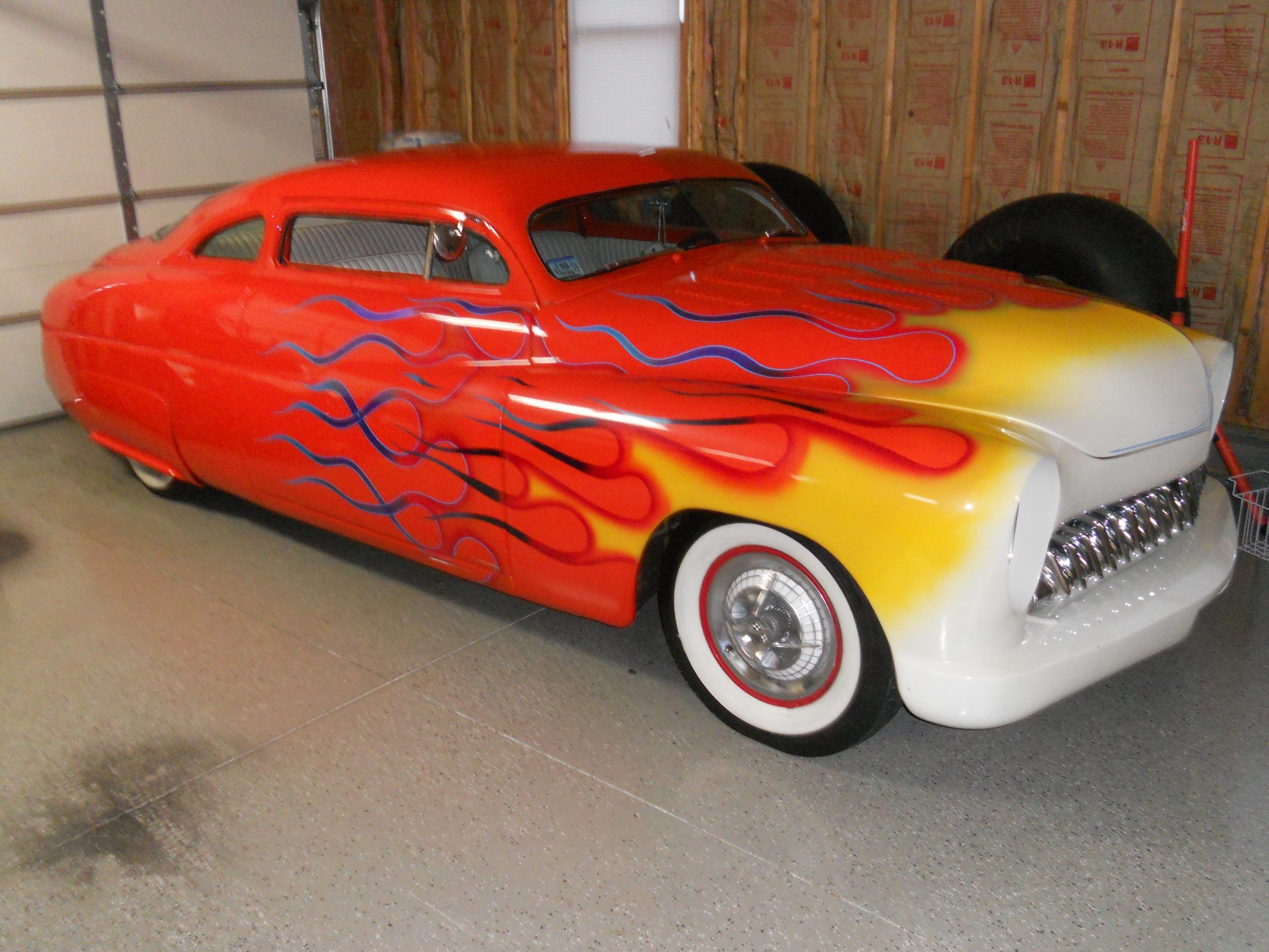

  27. The "Sam-grille" and a set of Cadillac sombreros ;-)
  28. For sure the Sam grille but not sure about doing Sombreros anytime soon, I gotz to pay for some paint and chrome work to finish this other stuff.
