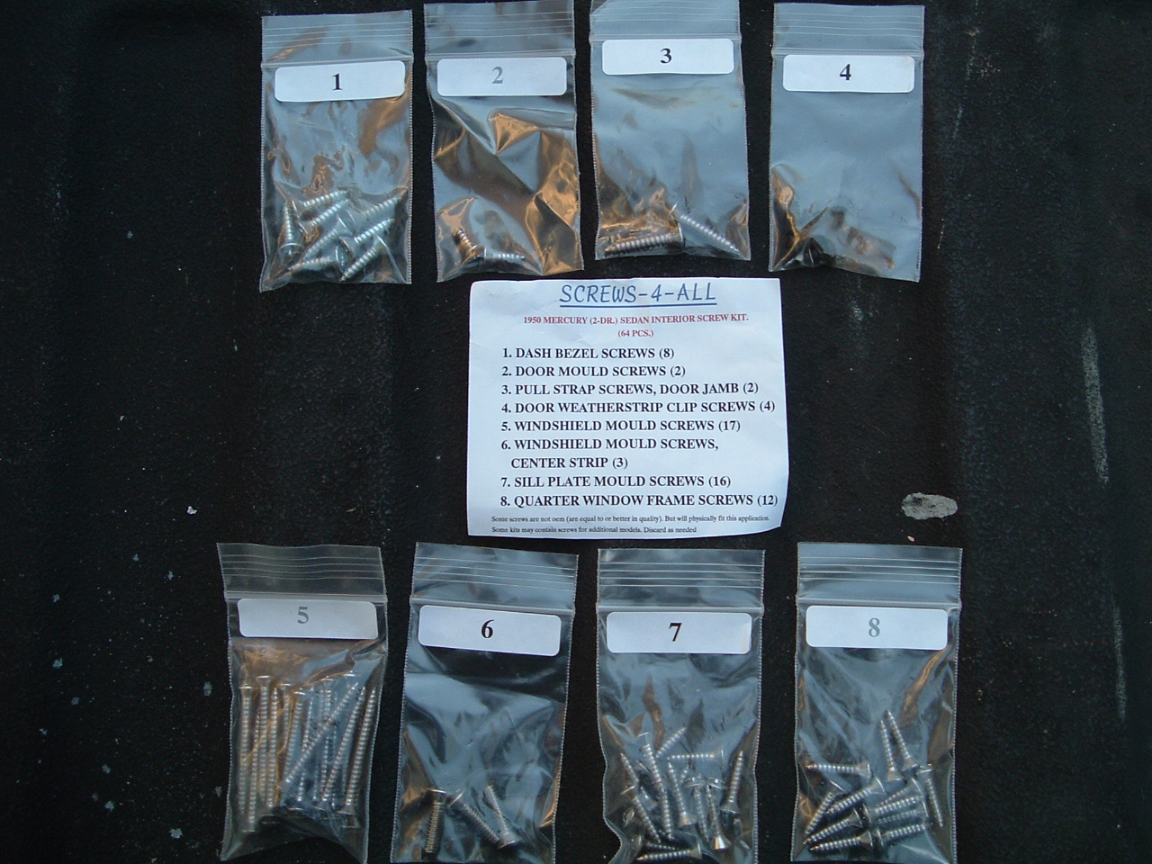

    John- Here's the screw kit we were talking about. I guess they're under "Screws 4 ALL"on e-bay. Still working on the wing rubber stuff.....=fun:cool:. Anyways- hope this helps out.-M

  15. Awesome, I totally need that screw kit, I have nothing for the window mouldings and bunch of other miscellaneous stuff.

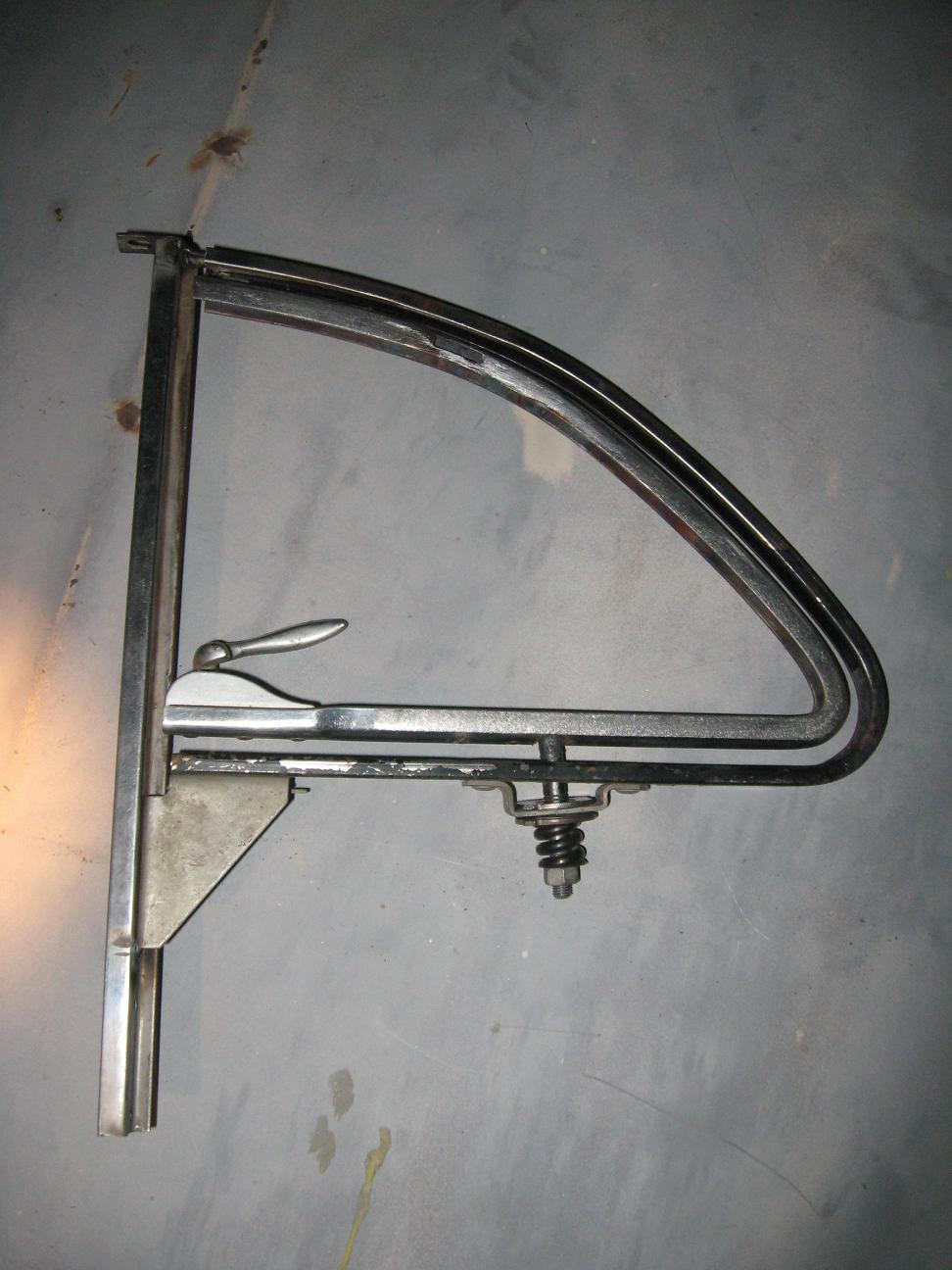

  21. I started trial-fitting the wing window seals, as well as talked to Matt Townsend the Merc guru... The vertical seal that attaches to the division bar appears to get glued on (Matt), as it has no holes for rivets or tangs to bend over. I think I know how it goes, though I need to see a pic of a stock one in the window before I crack the glue open.
    I still need the vertical window channel which then I can cut down and rivet into the frame, as well as rivet or bolt in the lower bracket that bolts to the inner door skin. I hope to have this stuff in my possession this week and then to put it largely together soon.
    I'll have to shorten the rubber if I want to keep the OEM-style upper and lower holes for the pivots:
    This bubble gum weld I think is visible when it's all together, I will have to fix this or start with a new division bar. I'm gonna swing by my buddy Intmd8 who can tig stainless to see if he can fill this in, and then I can get that corner repolished by Tino @ Courtesy Metal Polishing in Villa Park... Jim (Intmd8) noted earlier that the welder may have burned through. I do have two more division bars so if I have to start over I can do that too. I can't have that ugly *** weld visible on this car.
    Ughhhh... wtf:

    john the frame work is suppose to come close to ****ing up against the division bar not go over the top. your missing the little connector piece that connects the two together. you can make one out of some sheet metal, that will let you run a screw up into the door top to hold the frame work in place. the little metal connector will have a slight step to it to fit right. you might have to use your other division bars that **** might show... the verticle seal kit usually comes with rivets, you clamp the seal to the division bar and drill through the excisting holes into the new seal. you could glue them too, im just not a big fan of glue..

    John, looking at Matt's picture, it looks like the division bar needs to come all the way to the top and the piece over the window needs cut back from off the top of the division bar...if that makes any sense. You might need to use your other division bars and have them cut that 1/2 inch or so longer instead of shortening it.
