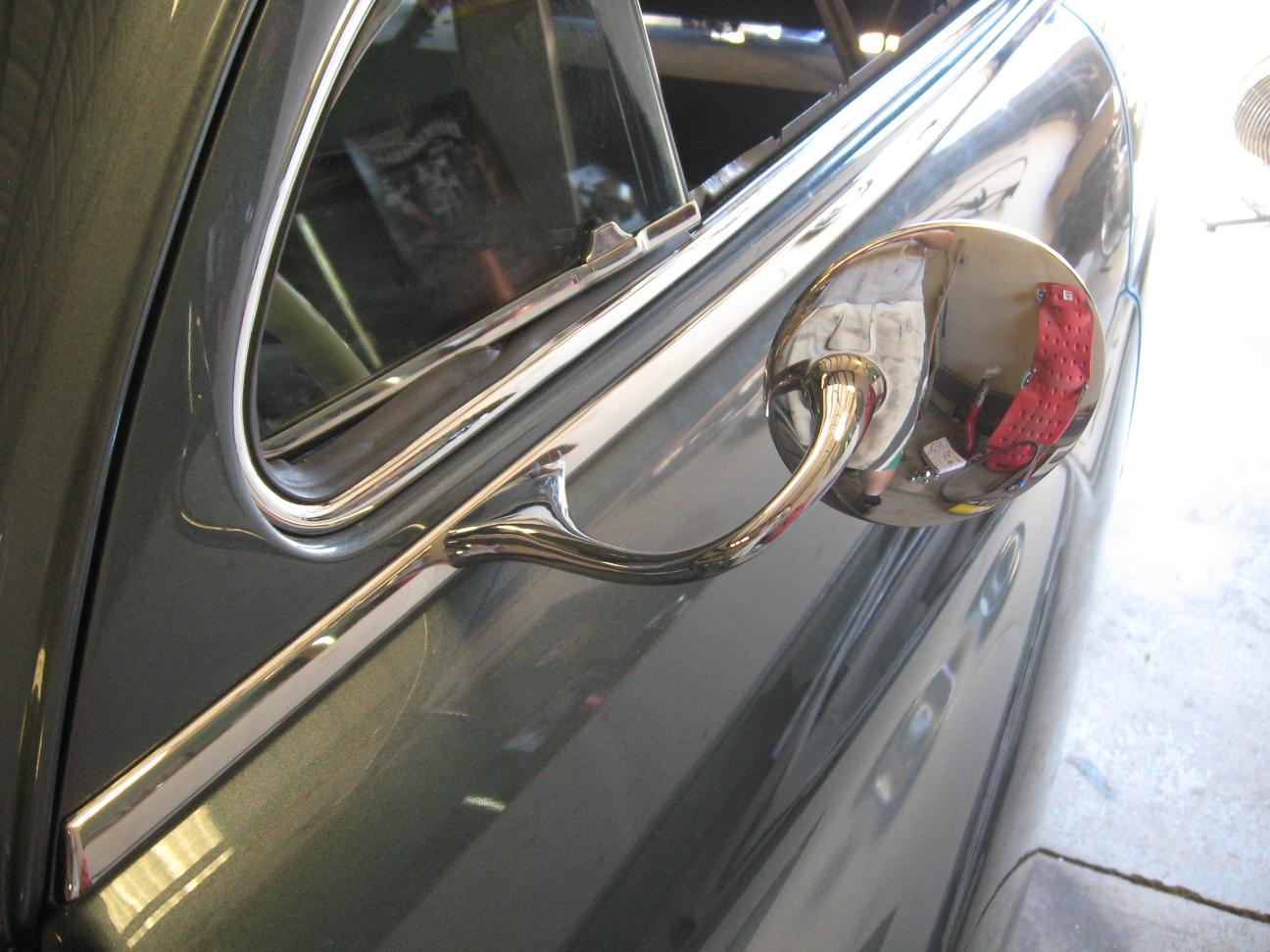

    The mirrors on Bobs car are the ONLY ones I would consider for a Merc.
    John, as long as you don't mess up anything from here on out, your 'ol McDonlalds Merc is gonna look killer.

  2. Meh. Maybe I won't run mirrors.

    you could find a p***ing mirror to be a little different, and on the 49, they are off of a 48 ford, shoebox ones are also pretty slick like Drefus posted
  4. Dunno, peeps are pretty easy for now. I'll have to live with the car before I start drilling holes.

  7. You can run the small mirrors up high next to the top of your wing window and it wont **** up your paint. I ran one for a long time and it did no damage.You dont need to drill holes in your body to run a mirror.:rolleyes:
