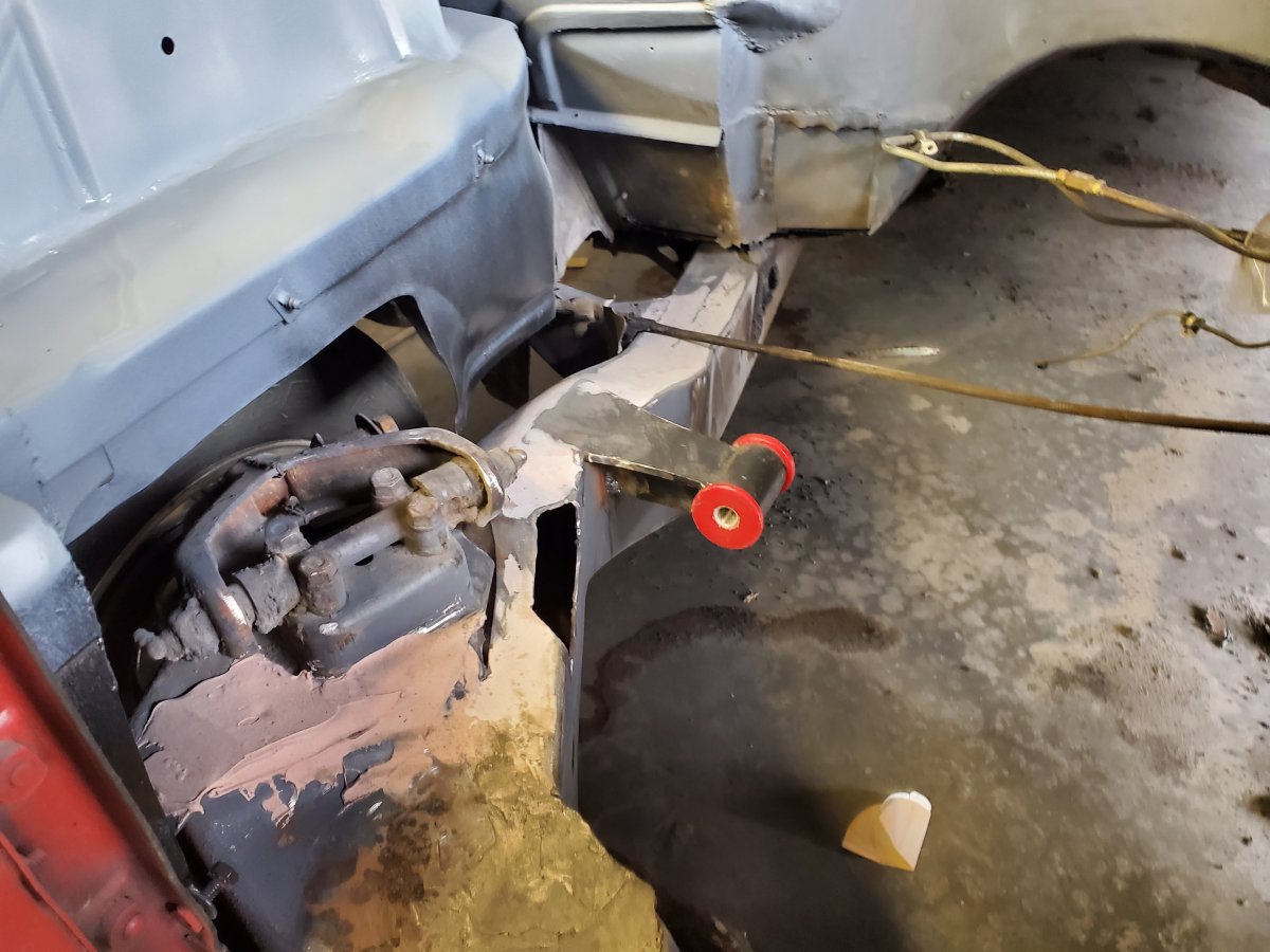

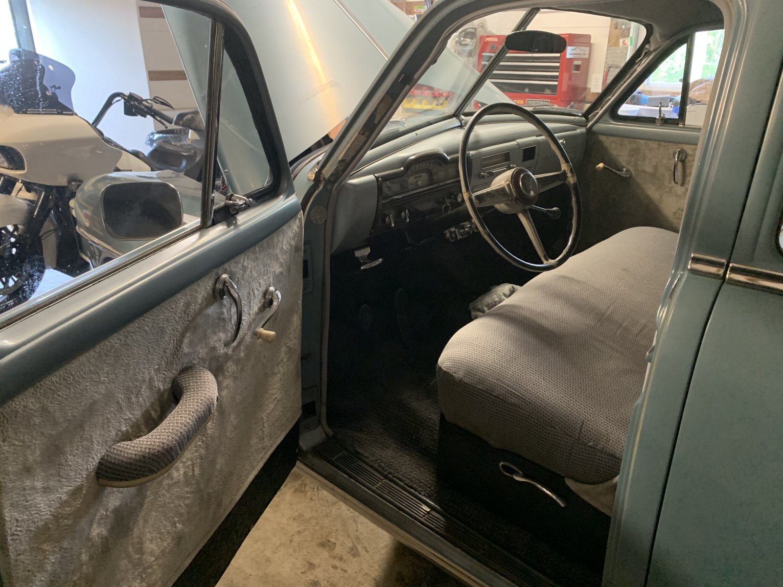

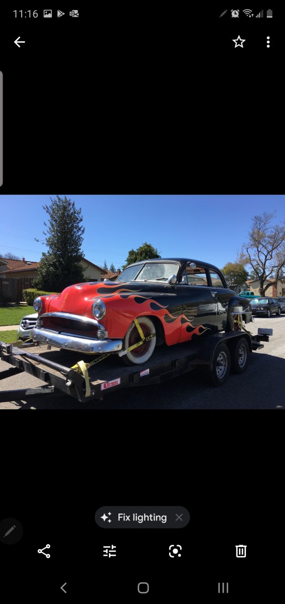

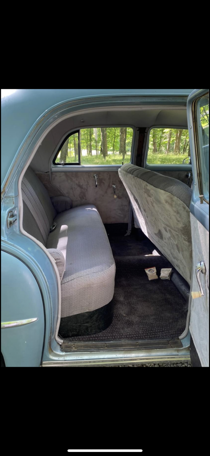

    Hey Guys! I introduced myself on HAMB earlier today and have committed to show you all the progress of my 1951 Plymouth. Just for the newbies who are even contemplating beginning a project, I am not rich and I most certainly do not know everything about old cars. I DO have mechanical background both in personal and career aspects. I am also gifted with a big shop and personal space for my car with air tools and a lift, which some of you might not have.
    So without further ado, here is my car. And some brief history.
    I purchased the car about a years ago from an older (not old) gentleman in San Jose, CA. He bought it 10 years prior off of ebay (who does that?) I purchased the car with a SBC 283ci (64 nova) and a 3 speed manual trans (floor shifter) with a 10 bolt chevy rear. The car (when I took ownership) had not ran in more than 10 years. So what did I do? I got that thing fired up. New gas tank, new lines, new pump, and fresh gas and it did the trick. I drove it around for a couple months, went to the Good guys car show in Pleasanton, CA. It was great. UNTIL.... I was ready for more. The engine ran great but 3 speeds isn't very nice on the freeways. When I decided to begin my plan of attack, I started to notice some really cool but not professional "tricks" the previous owners did to make the SBC fit in there.

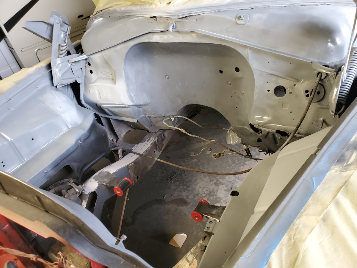

    Fast forward to today, I removed the complete drivetrain and am currently setting it all up for a SBC 350 4 bolt main to a T5 manual trans and a mustang rear end.
    I have learned pretty much everything I can about this particular car and I love it. It's got great bones. I'm insanely particular about my firewall.
    ***huge side note***
    My firewall was modified to put a SBC in and moved back about 3-5 inches WHICH IS A HUGE DIFFERENCE FOR STEERING. I highly suggest anyone do this to avoid any problems with that. I have so much info on how-to and such. Please feel free to ask.
    The pictures I am posting are a bit cluttered. Some are from when I first got the car and how it looks now. Enjoy! 20190803_072117_IMG_5030.JPG 20190426_212528_C71A1CD9-8629-4B2B-B043-237E567E5DC1.jpg 20190803_072117_IMG_5030.JPG 20190426_212528_C71A1CD9-8629-4B2B-B043-237E567E5DC1.jpg Screenshot_20191231-111645_Photos.jpg Screenshot_20191231-111659_Photos.jpg Screenshot_20191231-111747_Photos.jpg Screenshot_20191231-111755_Photos.jpg Screenshot_20191231-111813_Photos.jpg Screenshot_20191231-111830_Photos.jpg Screenshot_20191231-111848_Photos.jpg Screenshot_20191231-111747_Photos.jpg Screenshot_20191231-111848_Photos.jpg Screenshot_20191231-111830_Photos.jpg 20191225_121317.jpg 20191225_121309.jpg 20191225_121258.jpg 20191225_121314.jpg

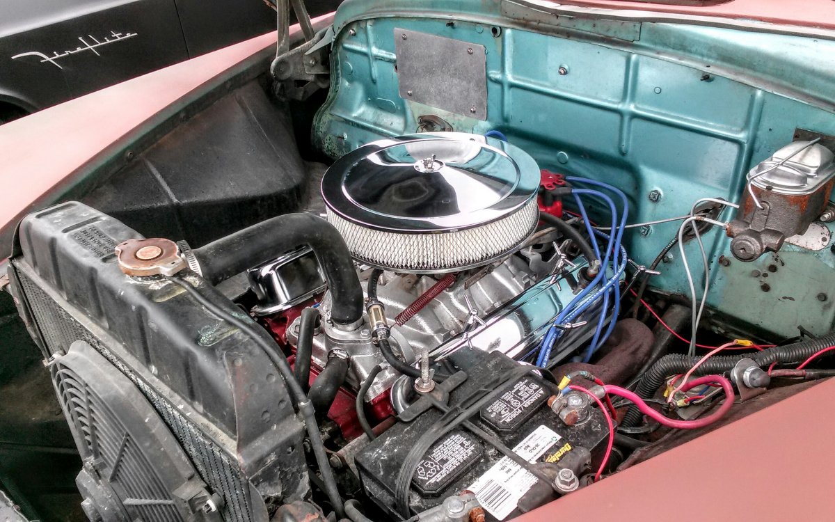

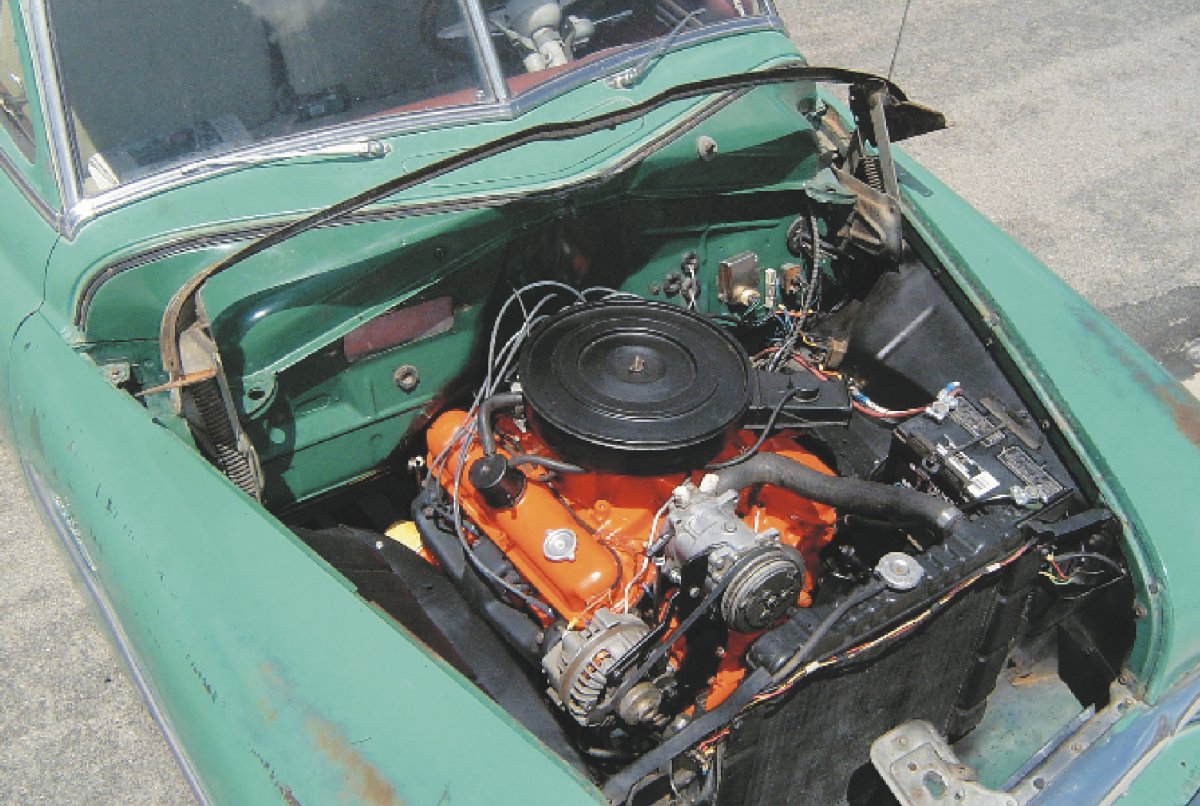

    I can't figure out why the firewall had to be moved so far back. I put a 318 in my '51 and only dinged back a corner about 1.5" to clearance the passenger side valve cover.

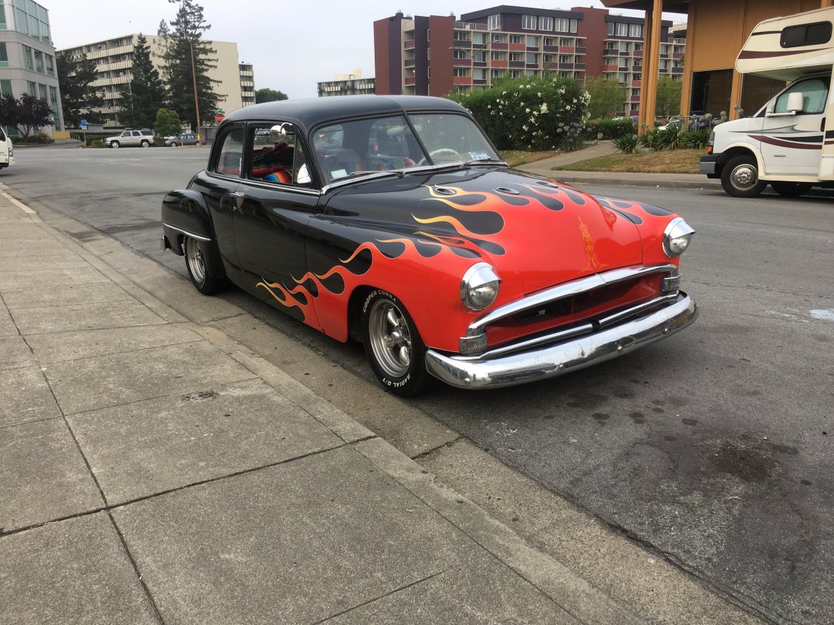

  3. I had a 318 in a '50 Dodge and didn't have to recess anything... 0519181041.jpg
  4. Really nice looking car though...

    WOW, those cars are super nice. yeah, looks like you guys didn't have to modify your firewall but did you guys have to move your radiators forward? or maybe used an electric fan. instead of a mechanical one? what about steering ? do your original steering boxes clear those v8s? I'm going with a rack and pinion on mine.

    I guess it's not so much that the firewall HAS to be recessed back. but it helps with steering and also using a mechanical fan if you're opposed to an electric fan. As you can probably tell by my photos, I'm spending a lot of time on the firewall. all of the weld marks will be near impossible to see. I don't want them exposed. I want a smooth, clean, glossy finish.

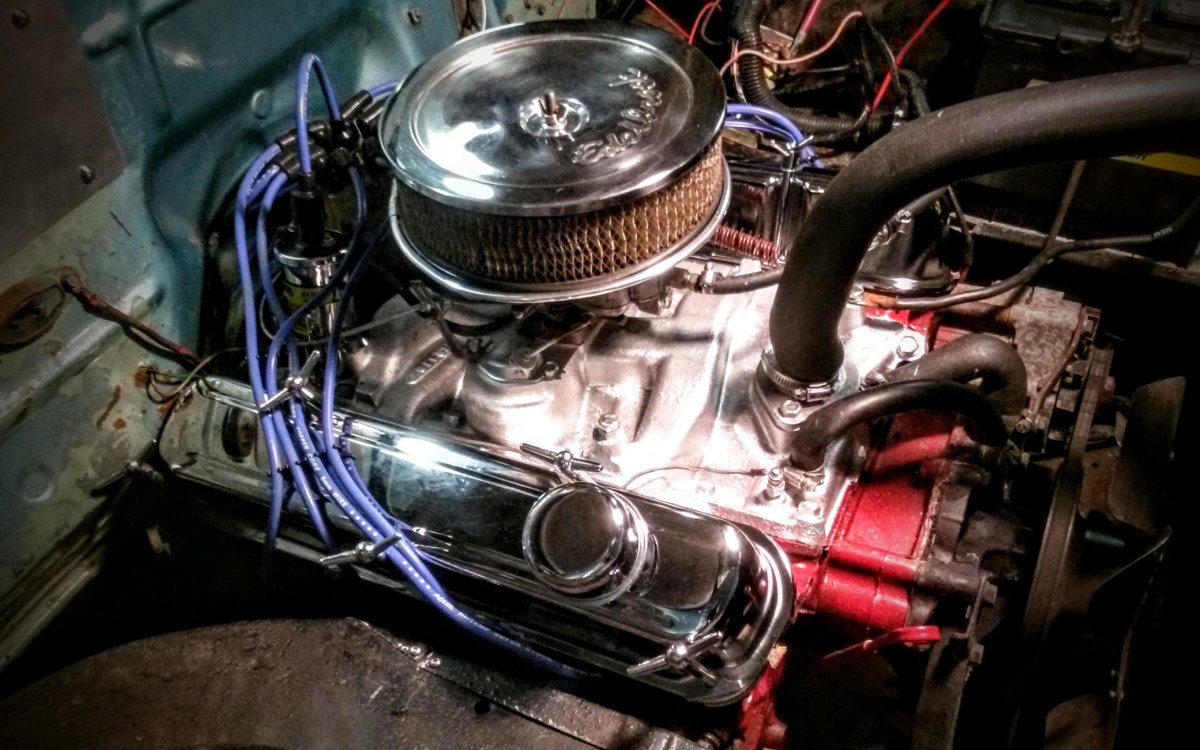

  7. My 318 was moved 2 inches towards the passenger side to clear the steering column. I did have to modify the passenger side wheel well to access the spark plugs... 0121171629a.jpg

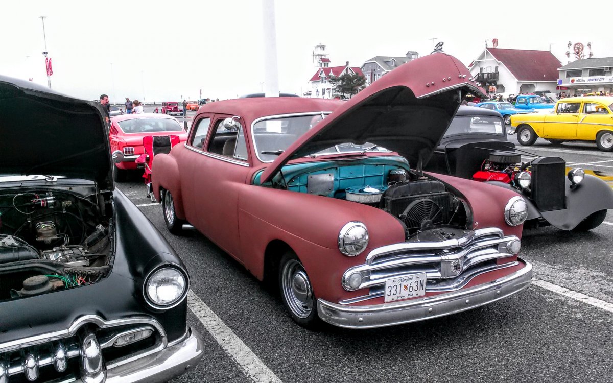

  14. Mine had both an electrical and mechanical fan. The stock mechanical fan was really low on the radiator so I mounted an electric fan on the top half... 0519181041c.jpg

    From what vie gathered doing the SBC conversion on my 1951 Cranbrook, you have a couple of options. You can either cut the firewall like I did in the pictures above to move it back some inches so that you can accommodate a electrical/mechanical fan or you can leave the firewall as is and move the engine forward a bit but then for the cooling system, you'll need another solution. I'm not too familiar with the Cambridge so no help there.
    As for the engine mounts, i just welded mine to the frame, its easier than having to drill holes. plus this thing will always have a SBC from now till death. The cool thing about the way mine ended up was that with the firewall cut a bit and the engine back some inches, the rack and pinion i installed fit perfectly under the sump of the engine. its a perfect fit. My 1951 does not have any front sub frame or anything like that . it has the stock frame. so i had my metal guy fabricate some mounts for me that i found online. they were made for a 1951 Chevy but with very MINOR adjustments, i was able to use them just fine. i can send you pics so you know what I'm talking about.
