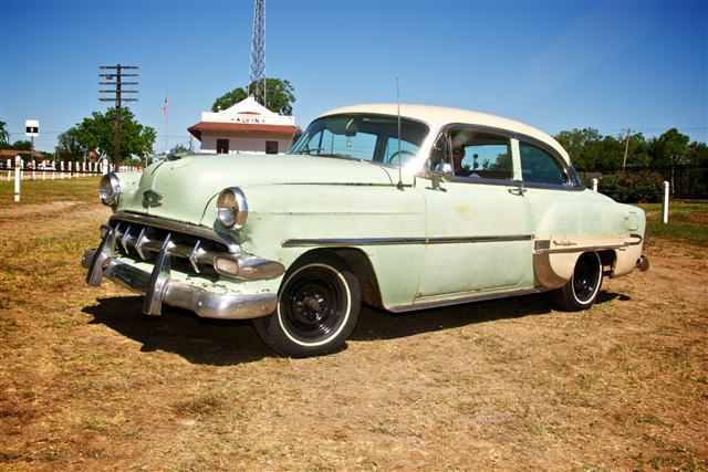

    this is the 54 my dad gave after i kept bugging him to give it to me so i can get it running again. after five years he finally caved. my dad is 89 years old and still drives his truck.

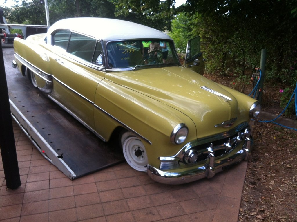

    Just a quick update on my phone HAMBERS.
    The chev finally arrived at my house last Thursday!!! It did not go smoothly as the photo indicates. But I am far from disappointed. Everything I expected in the car :)!!!!!
    Currently bleeding all four drums. Will uploaded alot of tomorrow morning.

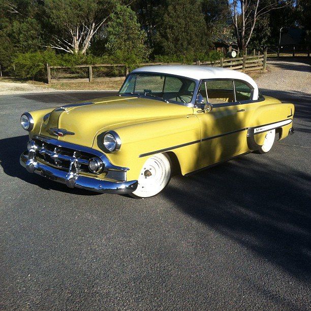

    ok, so heres a bit of an update:
    The chevy has finally arrived. However this end of the journey from the states didnt go to well.
    At the last minute i found a car carrier and was given an awesome quote. After being stuffed around by the warehouse, and finally being allowed to see the car, he rang me with the news all tyres had been let down and its currently sitting on blocks. Some shipping companies let the tyres down for transport, however, mine didn't. so i am really unsure as to what happened there. Being tubeless, they had popped out of their seat, which meant dragging the poor chev on the trailer. A very cheap quote quickly turned into a alot of money for transport....
    once it arrived at my home, i immediatley took the the wheels to bob jane the next day. $40 and all four tyres were refitted and balanced.
    so far i have:
    Flushed the radiator-new coolant-should still need a professional clean
    replaced the plastic fuel filter with a much nicer steel one
    fitted frog mouth air cleaner
    cleaned both front control arms-re greased all grease nipples
    cleaned and re-packed both front wheel hubs
    cleaned up the white walls with JIF
    mounted a battery holder-didnt come with one
    the bad:
    alot of the front end - bushes etc should be replaced soon
    found my first rust spot-left hand front chassis rail
    front bumper bar is welded to the chassis on the left side
    battery cables need replacing asap
    "american" lowering blocks
    leaking rear shocks
    two holes in the muffler
    I have tried bleeding the brakes with not much luck until today we got underneath and checked the hoses-looks like the fork lift has crushed the rear hose-new brake lines coming asap(hopefully)
    OVERALL I AM ACTUALLY REALLY HAPPY WITH IT.
    i havent been dissapointed with the condition yet-besides what the warehouse unpcking staff have done.
    heres some photos from the last few days.

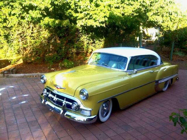

    Update: the mad thrash to kustom nats(I leave Thursday week) is I'm full effect. Yesterday was a seriously good day. New plugs, new leads(two trips to Repco) installed a pertronix electronic ignition, fitted eye lids and fitted an offy valve cover. Pretty chuffed with myself that I made it fit(I am far from being a mechanic) had to hand file the thermostat housing so the end of the valve cover would fit(it's a snug fit)
    Not a whole heap of work, but for me, I am stoked! ImageUploadedByTJJ1356849183.878974.jpg

    Quick update: new exhuast/straight through muffler fitted. New legit lowering blocks fitted. It now rides in the bump stops. Will do just for this weekend.
    Cut-polish-wax. Came up a treat. Few little things tonight and we are off! ImageUploadedByTJJ1357086587.336811.jpg ImageUploadedByTJJ1357086605.319260.jpg

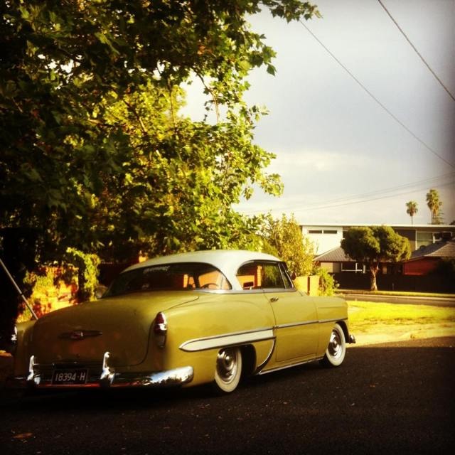

    Some recent photos!

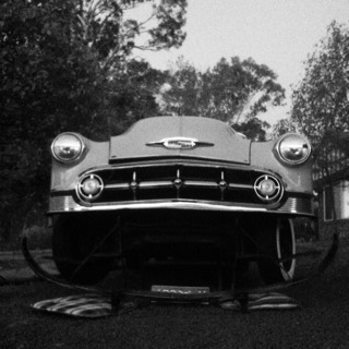

    Back into it.....just! This hand is killing me..
    Fitted the front bar only to find it is way off centre. One side sits way further out than the other. Has anyone come across this before? How'd you go about aligning it again?
    I have spaced one side of the bar mout with a decent sized washer, but it's almost an inch or two out on one side.
    Have thought of grinding out the mounting holes on the bar supports so I can adjust backwards and forwards....
