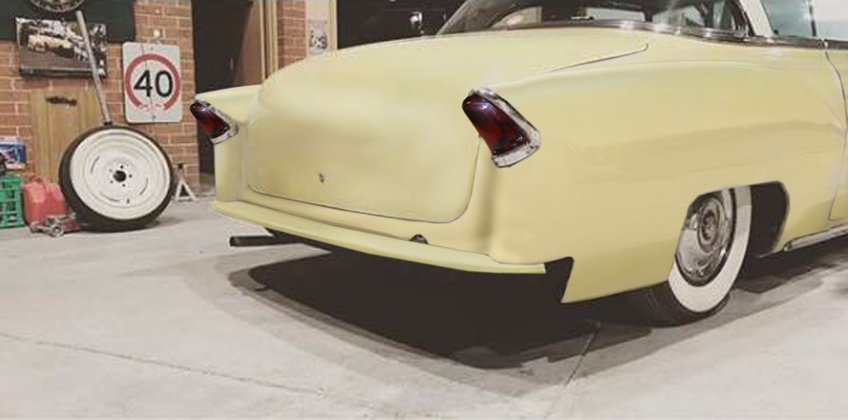

    55 chev tail lights!!
    This coming weekend marks one year since i bought a pair 55 tail light bezels and was sold on fitting them one day. 12 months later their in!
    Some very close friends pitched in bought complete 55 lights for me for my birthday on one condition. There In before christmas.
    Benny and i searched the web to see how others fitted them, and we both found a purple 55 nomad that had them laid over. We were sold.
    Benny is genius. If you're in melbourne australia, please hit him up if you need panel work done.
    We made our own quarters/buckets. I couldn't afford to buy rear 55 quarters and after the end result, i'm glad i didn't!
    I'm now currently looking for a 54 chev front bumper bar to put on the rear. It matches up to the extended quarters so much nicer!
    Enoy the rant!

    I didn't see that coming...A walk on the wild side!
    (BTW, I took the liberty of taking your car over to the Photoshop thread to see how Buick lenses might look.
    If anyone tackles the conversion, I'll bring it back to compare.)
