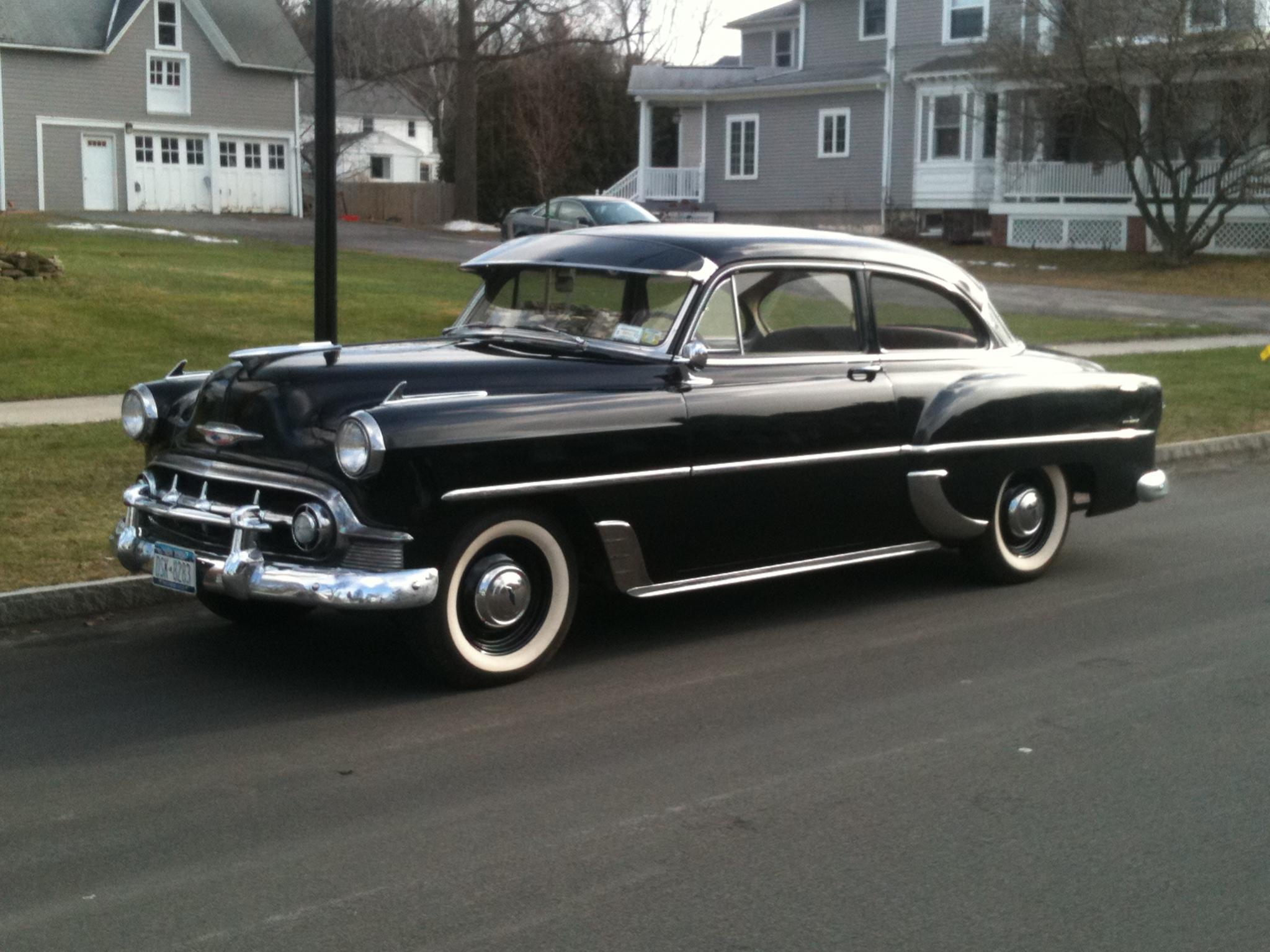

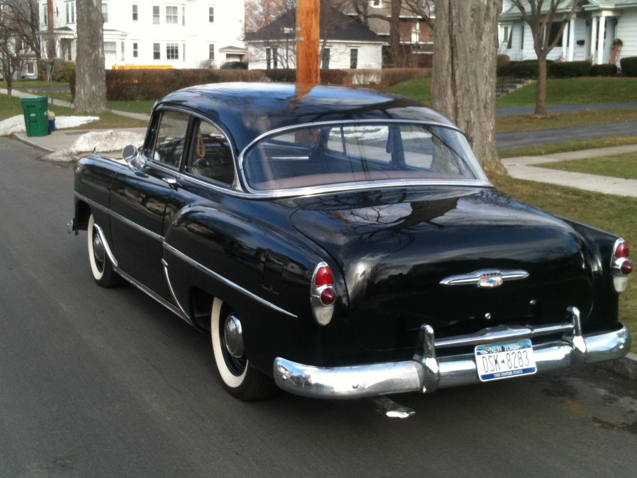

    ok.. well I got an all original stock 53' chevy a few months back... super clean and i totally love it! Probably my favorite car I've owned. Anyway I'm building a mid 50's hot rod outta it... so the first thing i did was lower it.. I used posie 3" super slide drop springs in the rear and then made my own 2" blocks. I had to make mine because I ordered the springs for a late model rear, because I plan to use a 1955 chevy rear(i already own) in the future so I had to make a set of block that could relocate the original rearend in the proper location. More updates to follow, but here is a photo of before and after... its not slammed but if you have seen these cars stock.. you know how high they really sit. Thanks!

    well, aside from cleaning up and painting a few things, underside/motor ect... I plan to swap in a set of 3:55's from a powerglide that i have. If that works well I will leave it alone for now..as far as the running gear. I was originally gonna swap in a 55' chevy rear that I have with 3:36 and a full syncro 3 speed. but if the 3:55's work fine, I'll leave it. I have started to aquirer some vintage speed parts... I have a McGurk intake, a 54' Corvette split manifold, and a set of holly carbs... I'll probably hook that stuff up to this motor and possibly get a mild cam too. Along with a pertronix unit.. I want to build a 261 for it some day so I will transfer the speed parts over to that motor and actually get a little power outta her. When I first got the car I was gonna build a mid 50's period style custom but I was happy to find the paint cleaned up great with just a quick wax job... got lucky. But this is gonna be a real driver... spring to fall. Not a piece of garage art like my last car.

    the front is actually stock...prolly an inch or 2 of spring sag..but the pics aren't doing it justice. When the salt is all gone I will get better photo's of it posted. 3-4 months to go. Interior is all stock and there but the seats will need to be cleaned if possible...

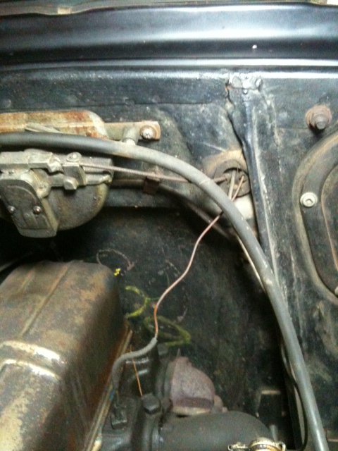

    Quick update, car is now over at my pop's shop(that we just finished building). Was planning on repainting the firewall and inner fenders but after some time cleaning them I decided to leave them original... still has chalk marks from the factory and I think thats kinda cool. It's not perfect but cool none the less. I will be pulling the motor to replace a few seals and give the motor a fresh coat of paint... I think that can stand to look nice and clean. I'll post some progress photo's as I go.. been waiting to work on the car... finally have the space and time!!

    here are few new pics... 2 of the chalk marks i found and then the inner fenders i was able to clean with some cleaner and rags...
