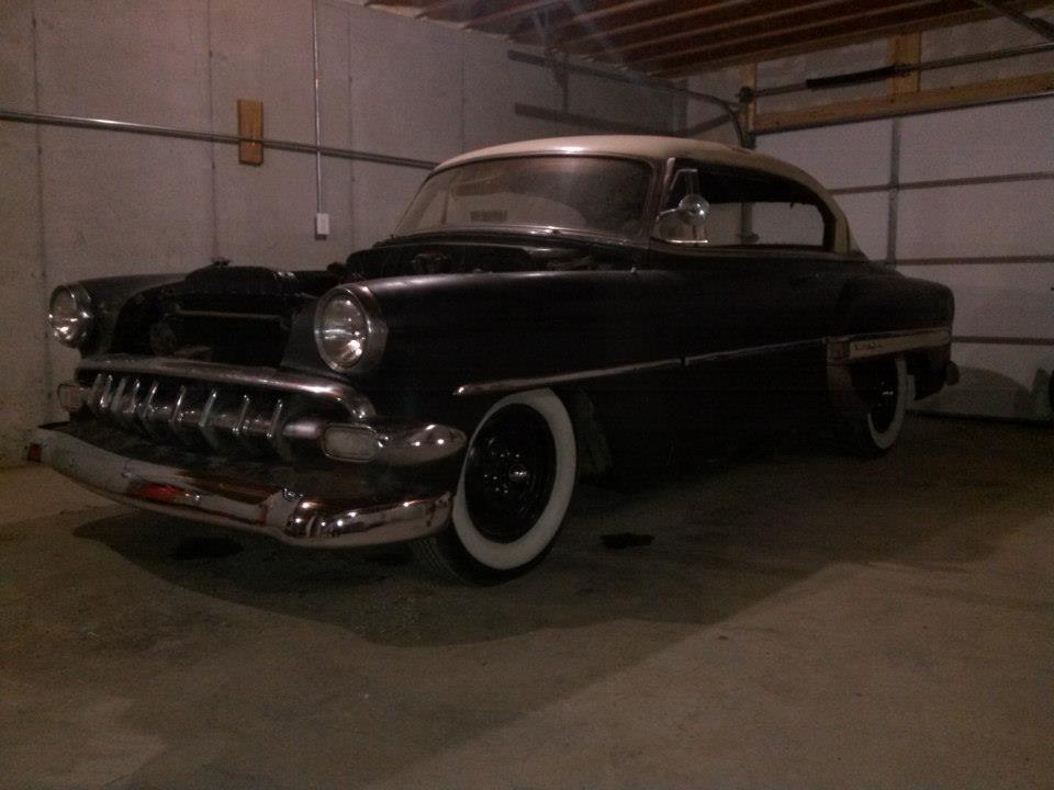

    It's been a while since I've had a project that really had me hooked so to speak. In the recent past I've had a Rambler Wagon and a rusty 53 Chevy sedan along with some various projects that have come and gone. Yet, about a year ago a friend called and offered this 54 Hardtop. At the time I wasn't looking, but hardtops arn't very common around here in the 53/54 Chevrolets. I took a look and a deal was made. I've spent the last year getting it mechanically solid. I've also gotten the missing trim and lowered it. The plan for the winter is to work on some patch panels, give it a fresh coat of satin, and possibly a haircut if time permits. This weekend I've been working on a c notch install.
    I have to say, it's been a while since a project of my own has really excited me. This cars' lines though have my custom juices flowing again!

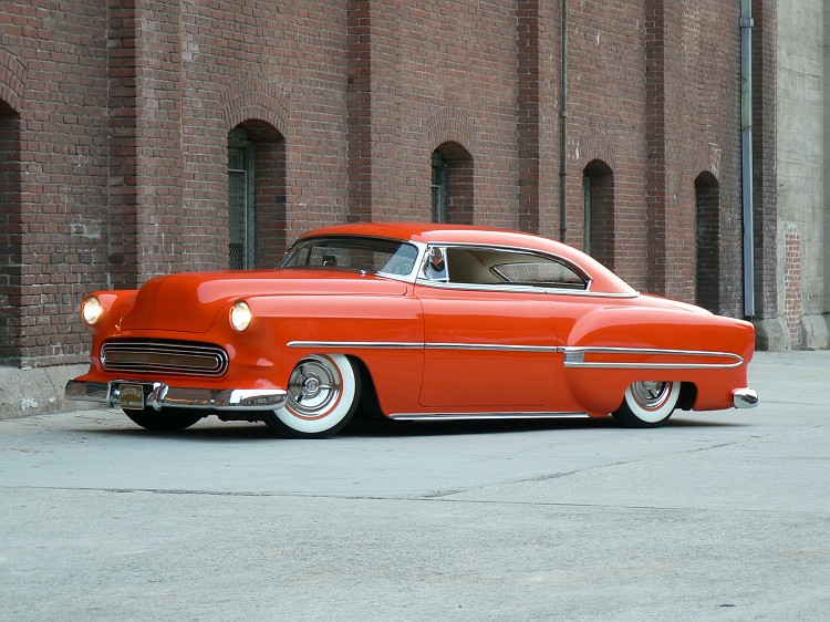

    This Bob Cota built 54 is my favorite chop of all the hardtops I've searched.

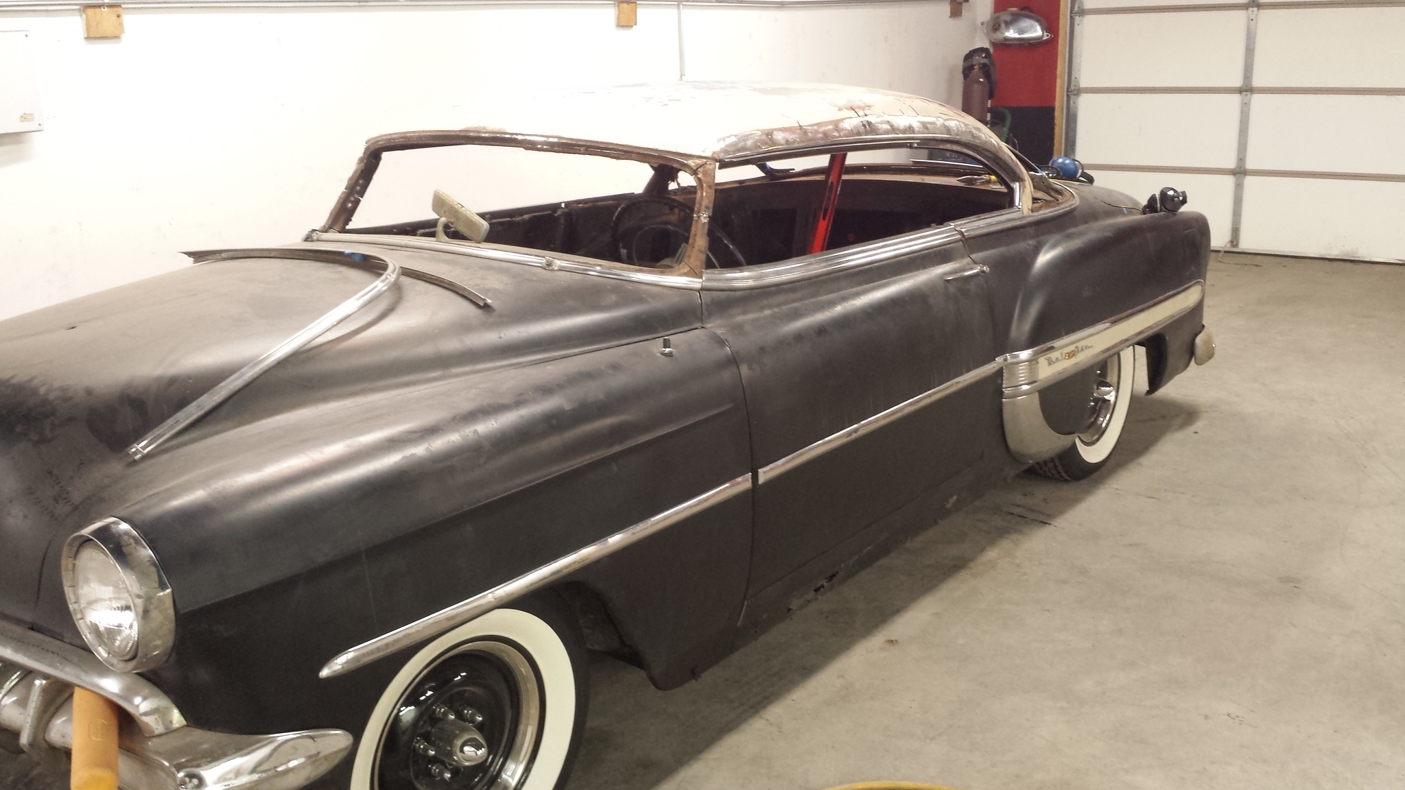

    I got quite a bit of time this weekend to work on the chop. I took 2.5 inches out of the A-pillar to get it to this point. To me, it doesn't take much chop to make the hardtops look proportionate to the rest of the body. I'll be using a donor rear window that I have, similar to the Cole Foster 54 hardtop.
    Thoughts? Suggestions?

    IMHO.
    2.5 is plenty on a hardtop.
    They get smaller real quick when the rubber glass and trim go back in.
    Thinking of fosters car...did he change the c- pillar to a buick olds style. Removing the dog leg?

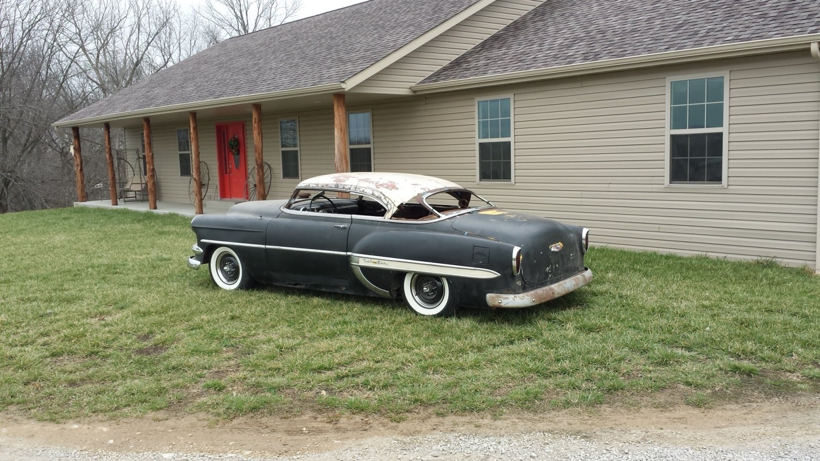

    So after a couple months of down time, I've got some progress made. Roof is now tacked in place and I'm working out the relief cuts in order to use the donor rear window. 20150305_205236.jpg

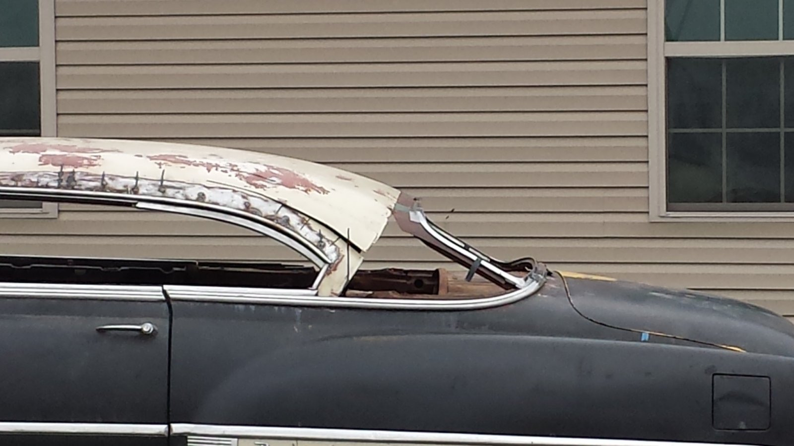

    Another angle showing the new flow of the roof line. The biggest challenge in using this earlier Chevy window is having to reshape the crown in the sail panel area to match the donor. I've seen this window used on a sedan that was chopped and the stainless moulding around the window matched the existing beltline moulding. I thought it really gave the chop a factory appearance. I'm hoping to pull it off on my hardtop as well. 20150305_205852.jpg

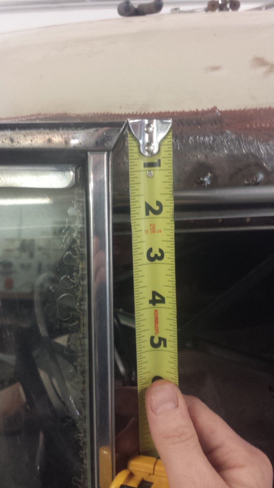

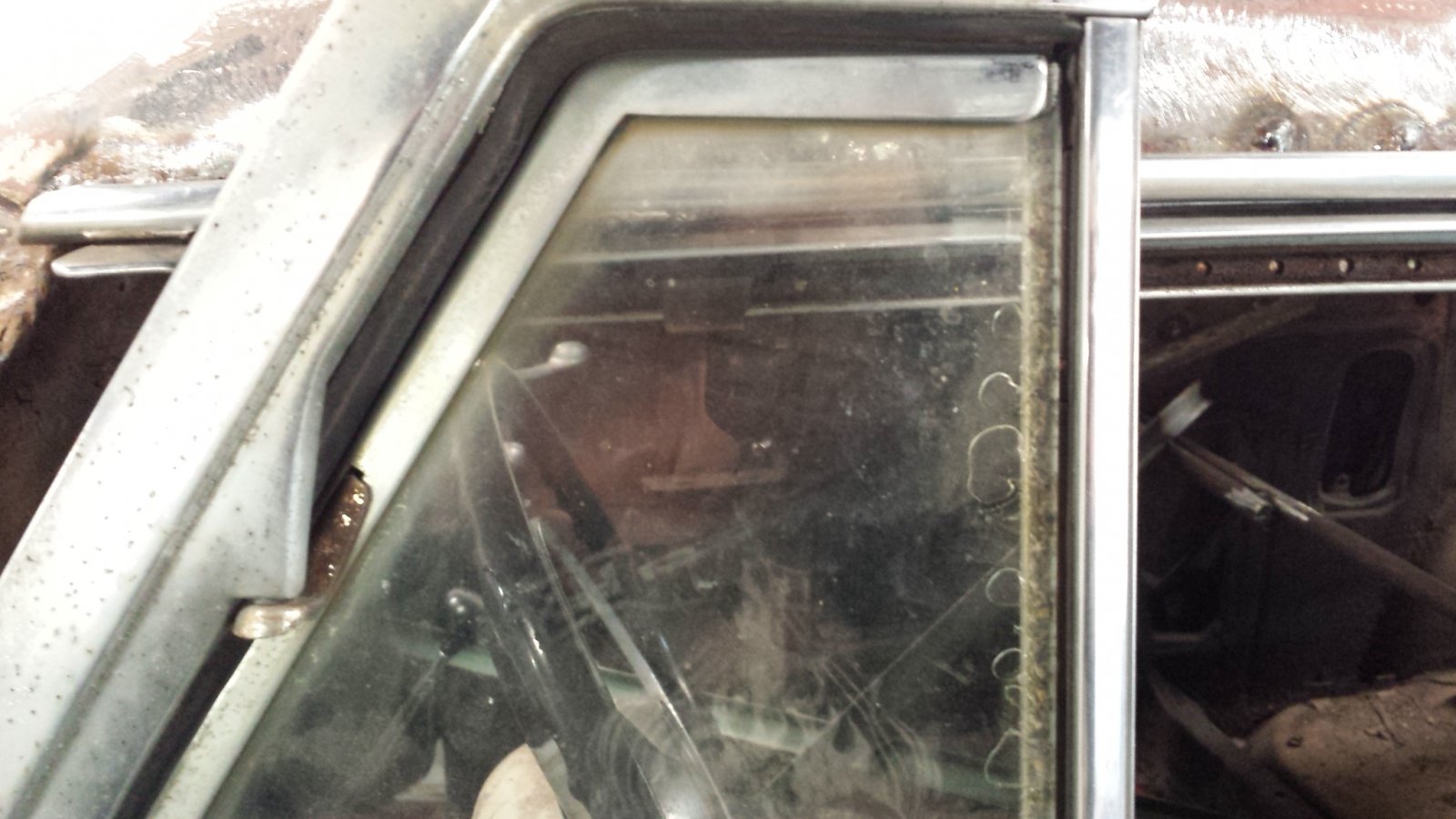

    Leebo, you really sparked my curiosity on this...... I mounted up the stock wing windows. It looks like I will need to lower the top of the vent window frame 2.25 inches. Let me be clear, I took 3.25 inches out of the A pillar. Doing that amount out of the A pillar gave about a 2.25 inch vertical drop of the roof. So your initial plan of going 2.5 inches vertically turns out to be very close to what I did too. 20150306_152650.jpg 20150306_152318.jpg 20150306_152424.jpg

    Ok. My mind is blown on this. When you going to cut the wing frames? I'm curious if you have to take 3.25 out of the frame to get it to correspond with the body. Are you cutting above the pivot as I mentioned?
  26. Merge
    Joined: Oct 7, 2004
    Posts: 379
    Merge
    Yes, I will cut above the top pivot point. Notice in the second picture where the top pivot lands. There is room to make a cut and then slide the top frame down and joint together.
    As far as the dimensions go, think of the triangle we have. The longest leg of the triangle being the 3.25 inches. The vertical leg being 2.25 inches and the horizontal 2.25 inches. (A squared plus B squared equals C squared). With that said, you could use the Pathagorean formula to figure out the maximum amount of cut you could make on the A-pillar and still not interfere with the top pivot. In my opinion, I wouldn't go any more than the 3.25 because the roof will start to look out of proportion.

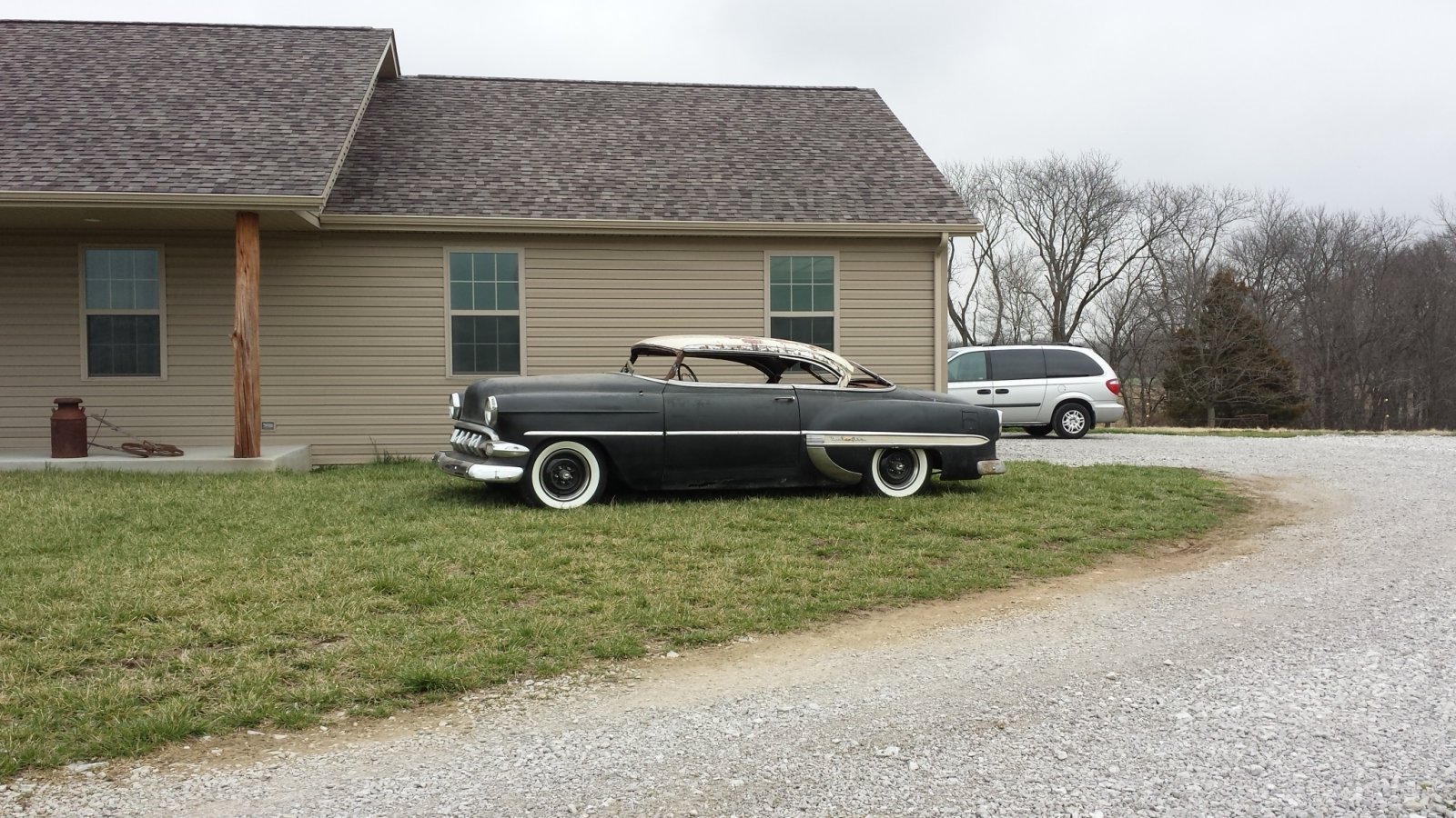

    Got a chance to pull it outside and have a look at the new roof profile. I'm pretty happy with the way it is coming along. Hope to get a chance to do some welding over the weekend.

    I like the pie cuts. They'll help you resolve that corner where the top meets the deck.
