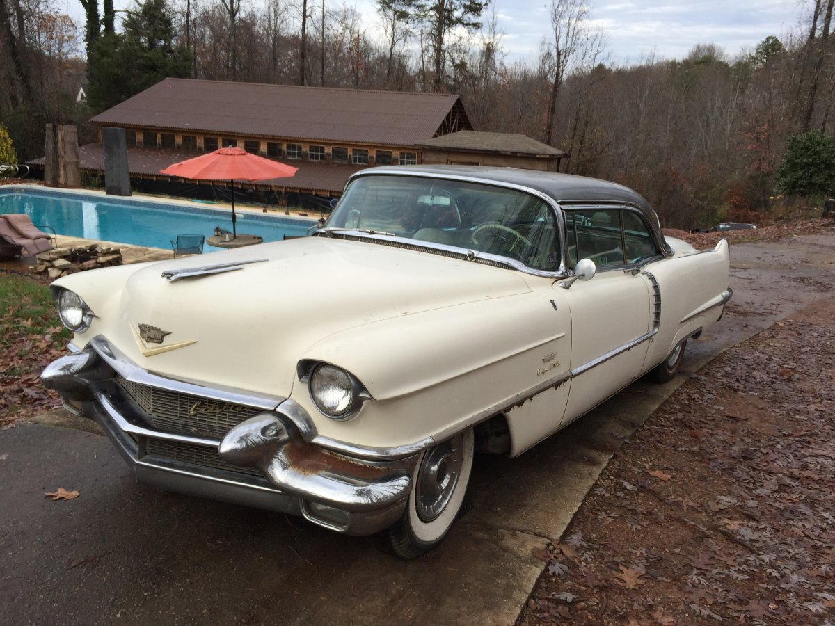

    image.jpeg Figured I should make one thread pertaining to this car than a bunch of random other threads.

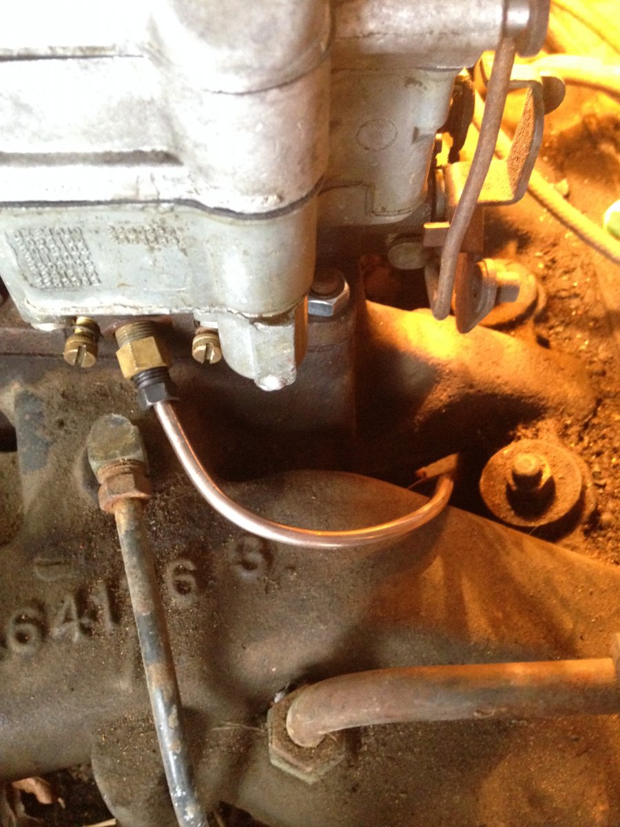

    The car is a 1956 Cadillac Coupe DeVille. Body is mostly solid, but the floor has some holes in it. The original 365 v8 was bad so the previous owner swapped in a 365 from a low mileage sedan he told me. Its missing the generator, air cleaner, and brake master cylinder/booster.
    I rebuilt the carb, points and condenser. Tried to fire it up but the keys dont work. Not sure if its just locked up or what. So Ive been hotwiring it with a screwdriver.
    When I first tried, I tried and tried and nothing. Would get the occasional fireball out of the open exhaust. My father in law who was an old mechanic for many years helped me determine that there was little to no compression in the cylinders. The original owner left it open with no carb on it and the rings I think got stuck a little. So I removed the plugs and put a 50/50 mix of ATF/brake fluid down each cylinder, loaded until it was dripping out each hole. Let that sit a couple days, then manually cranked it to get all the fluid out. Cleaned the plugs up and I was able to get it to fire after a couple days.
    Right now Im byp***ing the old cruddy fuel pump and just loading the carb with gas. It will run varying times 2-10 seconds but shuts off quickly.

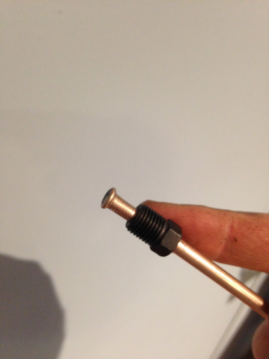

    Most of the vacuum lines were broken so I taped off some and bought a flare kit and learned to make lines.
    Here she is next to my 50 series 61 sedan
    The car needs everything redone.
    These master cylinders rebuilt, with core charge are $800. Purely ridiculous so Im going to put in something else and make it work.
    My budget is low so the build will go slowly. I want to get it running decent enough to test the drivetrain and see how it acts. Being that its not a numbers matching engine, and it had low compression, AND that rebuilds on this drivetrain cost 5 times more than anything chevy, I might consider ditching the whole thing, finding a junkyard 454 from a truck, upping the compression, and a new trans so I can reliably road trip this thing in overdrive down the highway at 70 mph. These transmissions Ive heard can be problematic, and if you have the money even, finding someone who knows them well to rebuild is also tough. I know a guy who spent more than I have in both my cadillacs getting his engine and trans rebuilt, only to have issues. I cant risk that. I genuinely want to drive this car, and have no issues driving it any distance.
    So right now, I'll go about testing the current 56 drivetrain with minimal investment just to go down the road and see. If its strong I'll keep it, otherwise Im going to build something dependable and reliable, and not spend caddy money on it.
    My 50 is all original numbers matching, and Ive spent a lot reworking various components, but its not geared for 70 mph, and with the original engine and trans I cant go distance without being nervous as hell I wont make it. This 56 I want to be turn key, no issues or unknowns.
    Thats all for now!

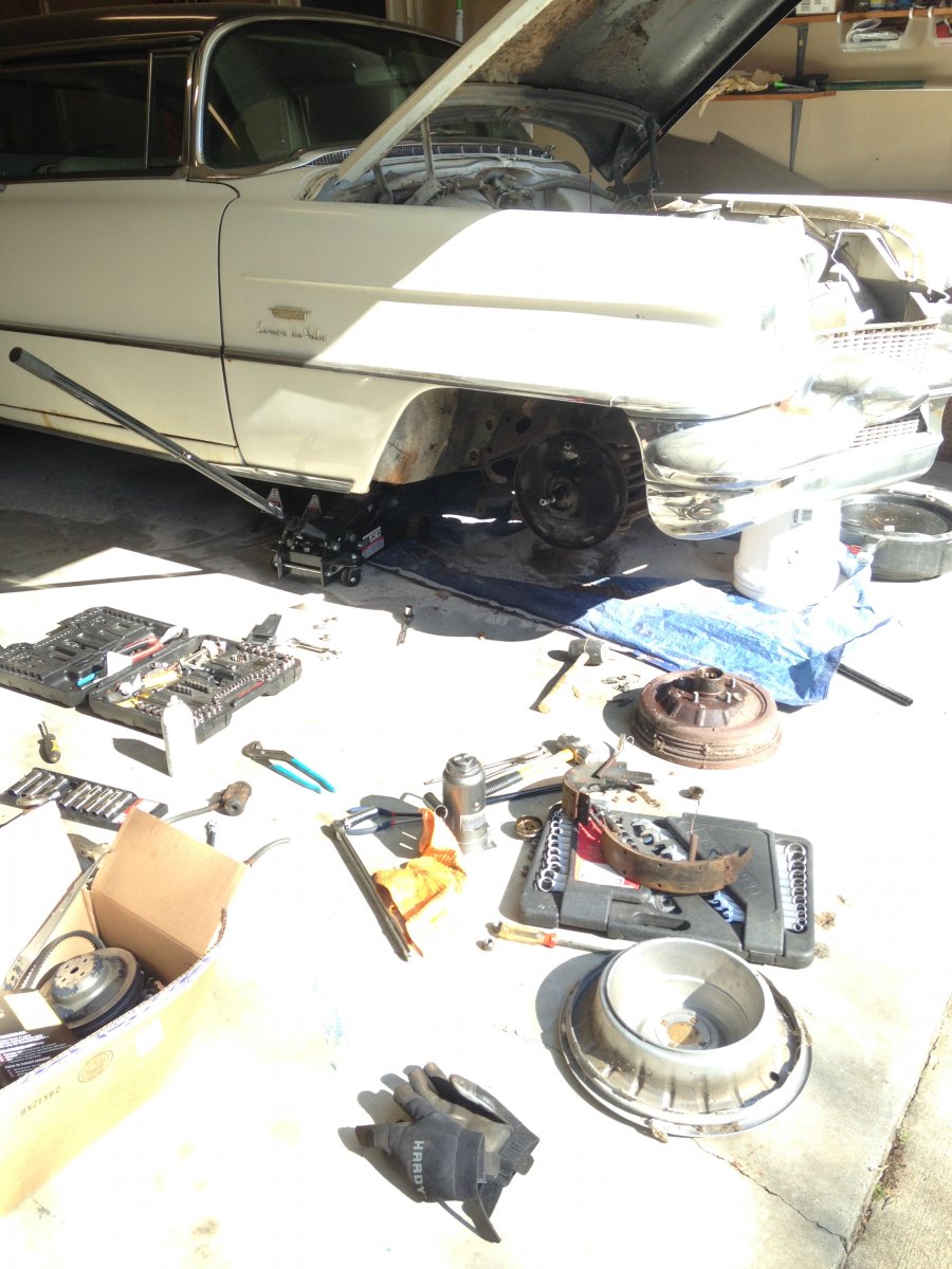

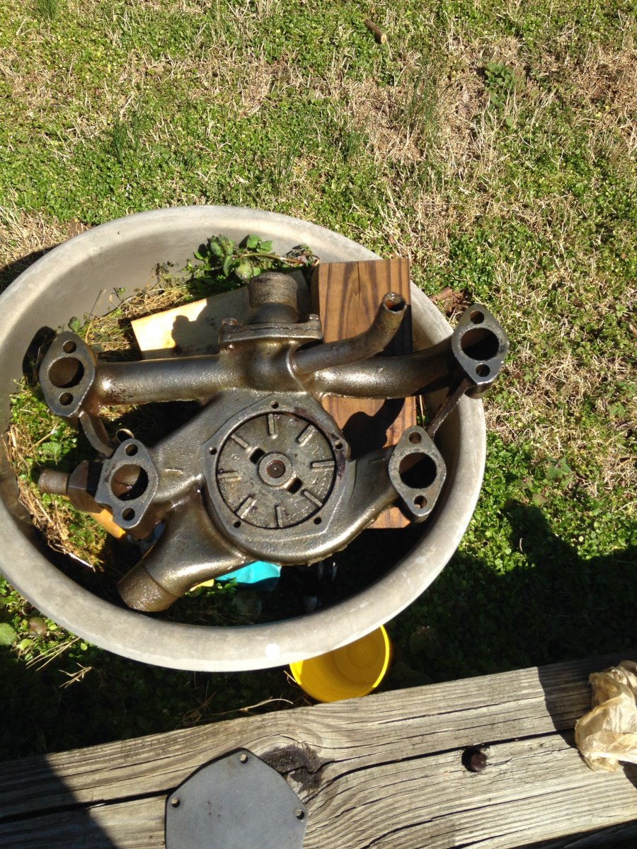

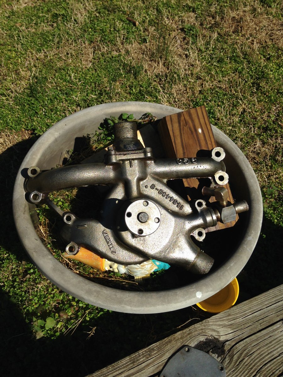

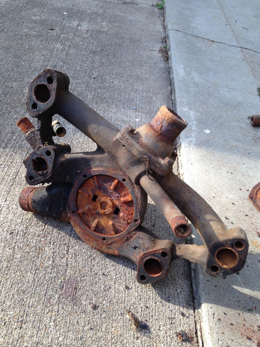

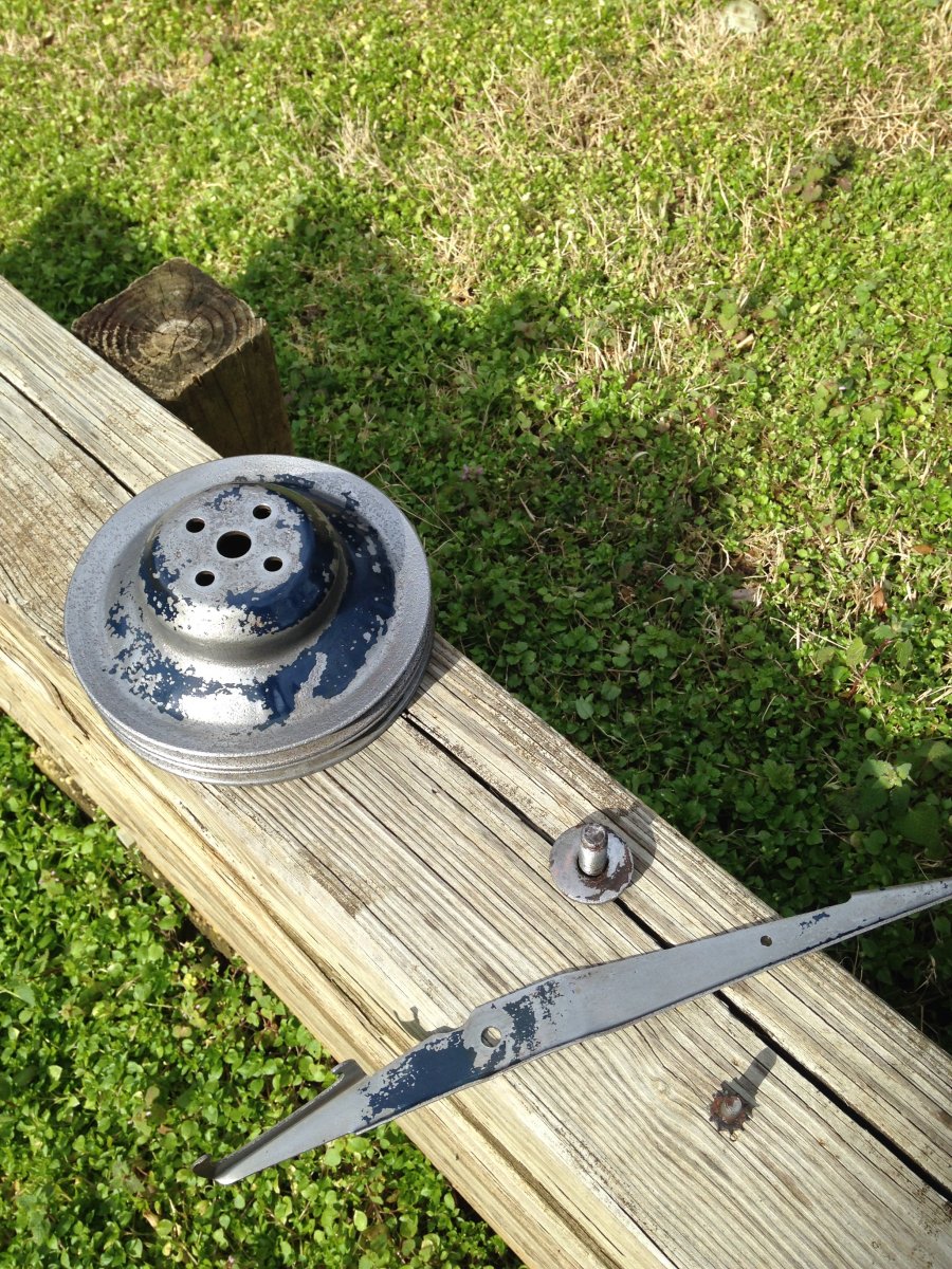

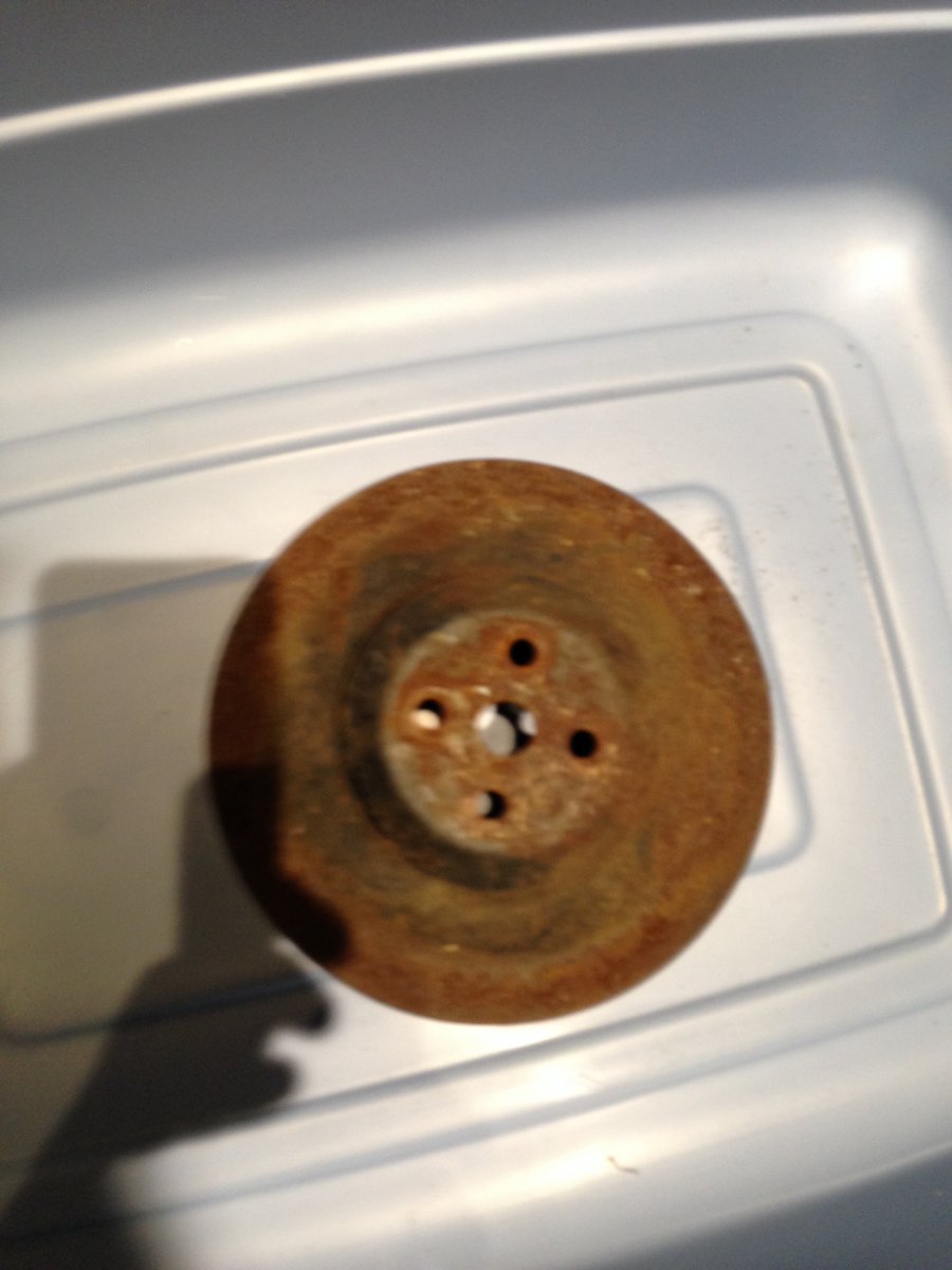

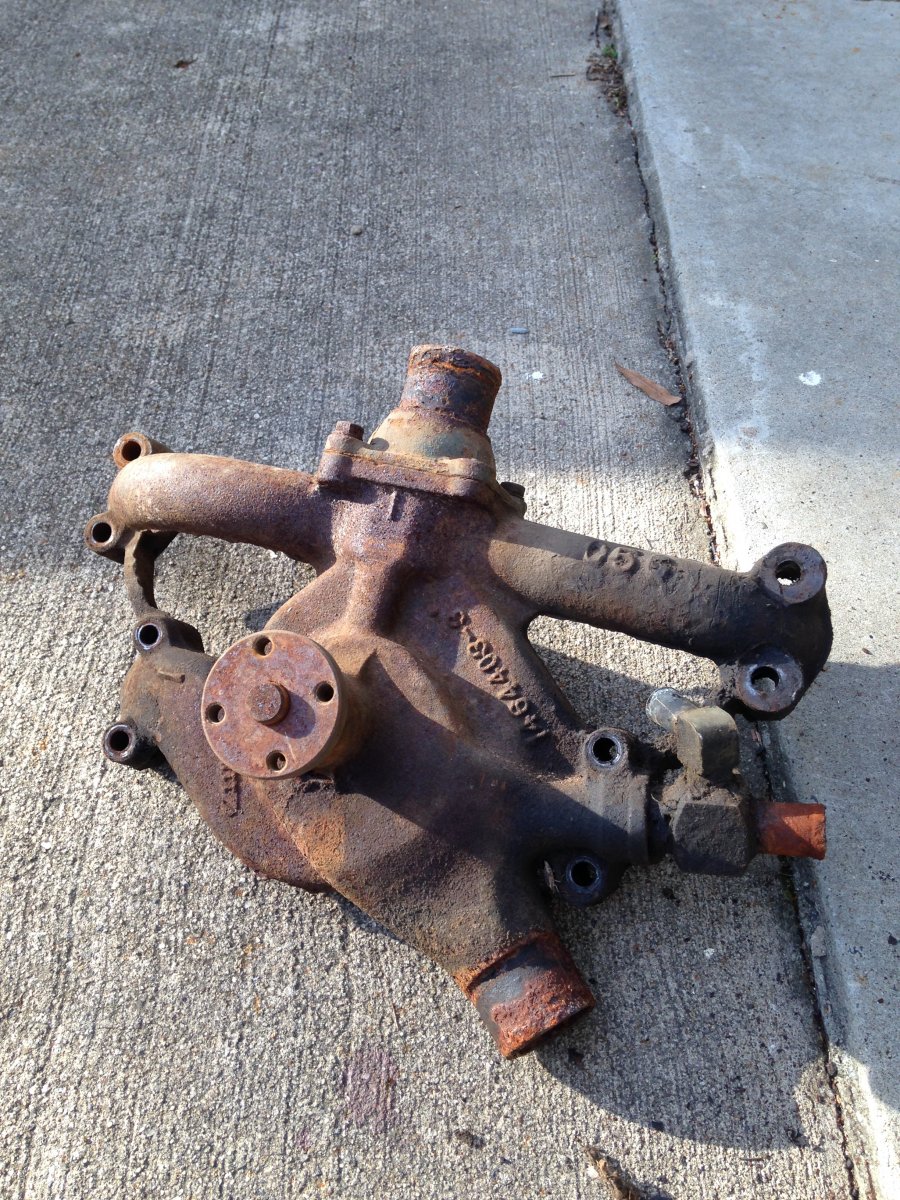

    Well I cleaned up the fan pulley and water pump and their hardware with a 2 night soak in white vinegar and a lot of steel wire brushing.
    Changed the oil - took a screw driver to pop the black sludge "gasket" shall we say. Nothing came out initially when I undid the oil pan plug. Couldnt warm up the engine yet, no cooling system in place.
    I imagine the water pump will need to be rebuilt.
    Put on new spark plugs and spark plug wires, old stuff was nasty.
    New fuel pump is on its way.
    While under the car I realized the PO left the trans support out when swapping engine and trans. So I'll have to make a new one. Joy!

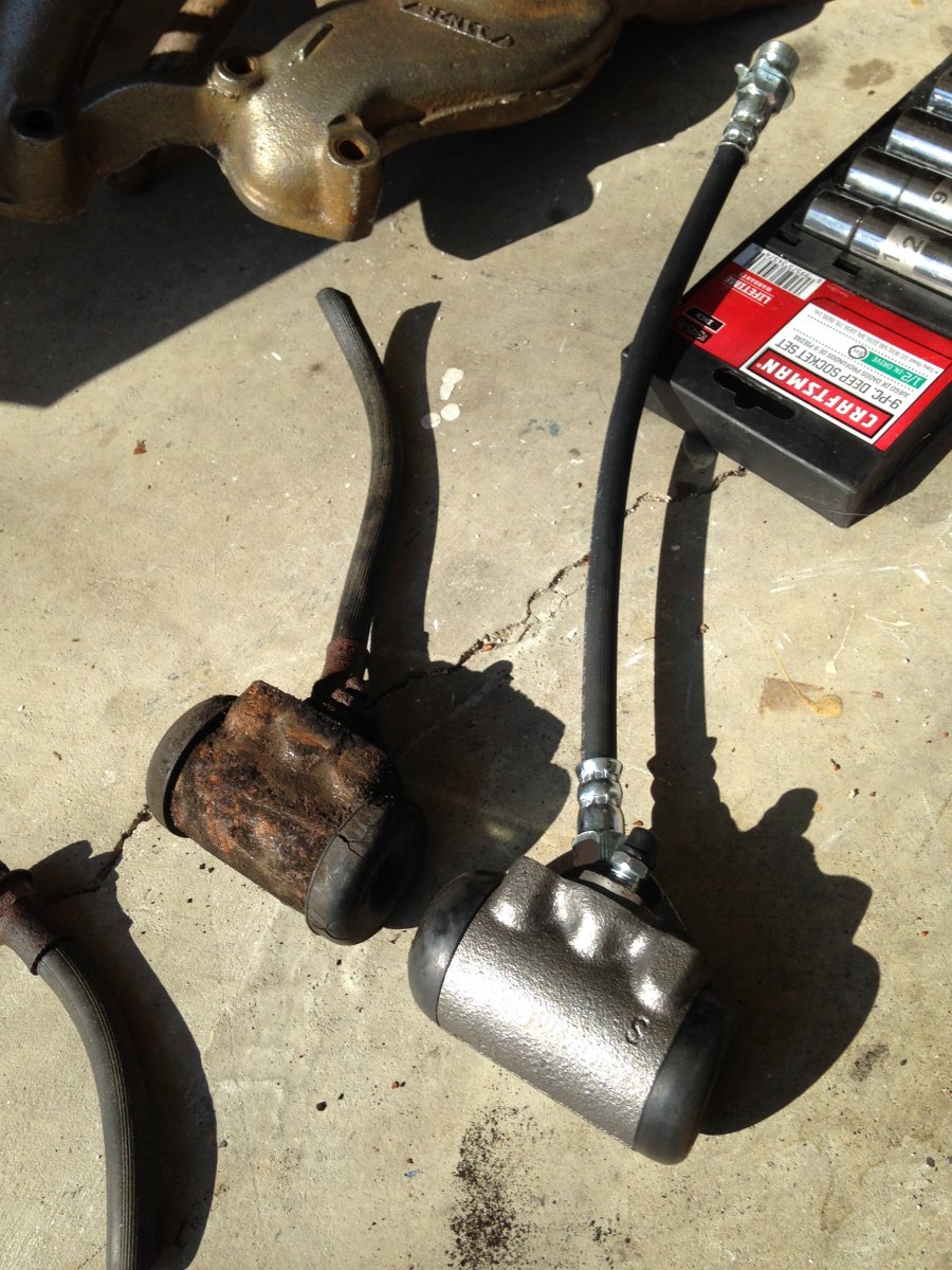

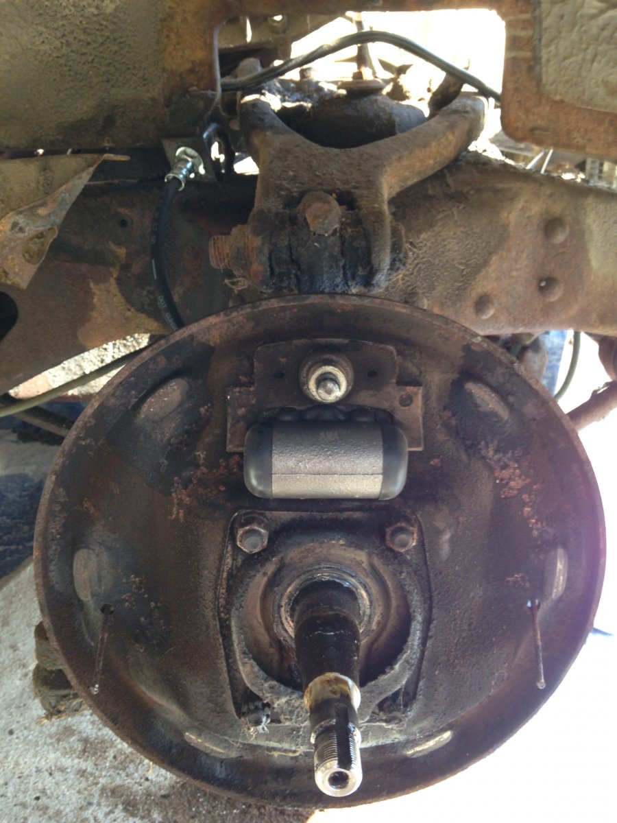

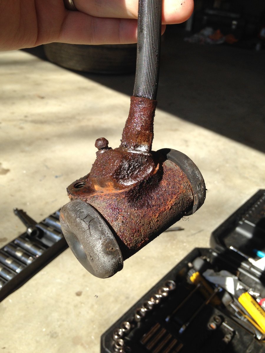

    Installed new fuel pump, wheel cylinders, hoses, and U joints.
