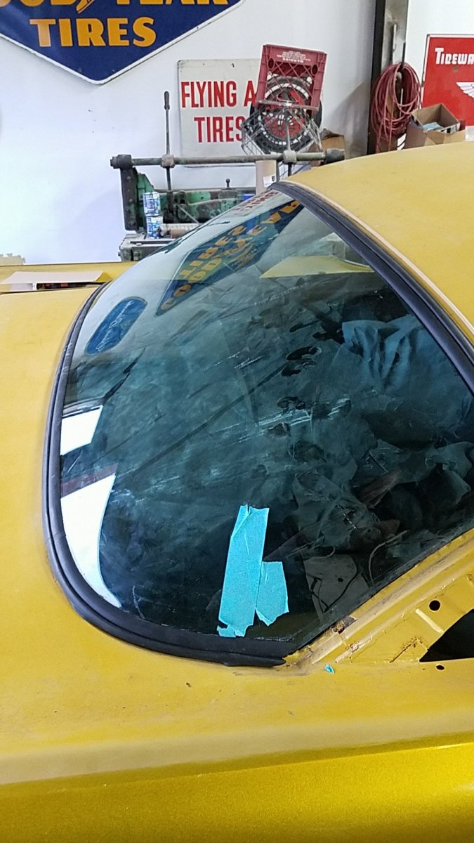

    I discussed this same issue (chopping a car with curved front gl***) at length with Mark Wojcik (Chopolds on the HAMB). He built a pretty heavily whacked Olds with a chopped 57 Olds roof, and his theory is that you can't chop a curved gl*** car much more than 2" or so of vertical drop with the stock windshield. What you can do is start to lay the gl*** back and simultaneously cut off a bit of the top edge, but mostly the sides so the gl*** will lean back. But cut too much and the gl*** will pull out of the channel and there will be a gap. This was what Mark hypothesized was the reason for the trim Barris added to the sides of the windshield on the Kopper Kart. The truck had been chopped too much to make the gl*** fit so they had to hide the gap. But nowadays, even if the factory gl*** can't fit, you could make a template and there are companies that will make a custom piece of curved gl*** for you. Expensive, but will get the job done and done right. Awesome car.

    In fact the gl*** is going to be a challenge for sure. Needles to say, I know a few good gl*** people and I have one of the best in the business close to me, Tony Gomes of Tri-Valley Auto Gl***, in Livermore, Ca. Tony helped with the actual chop of the car and has a good idea on what it'll take and we've been in conversations recently to get it underway and taken care of sooner, rather than later. I'll keep you guys posted. In the meantime I'll post some pics of how the car sits now.

    Well! That is the money question.. lol. However, I do have a good buddy of mine, Tony Gomes of Tri-Valley Auto taking a look at this. He's familiar with the car, the chop and the process to get the gl*** done. Hopefully soon we'll see this take place. Stay tuned.

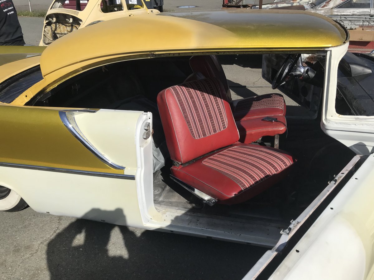

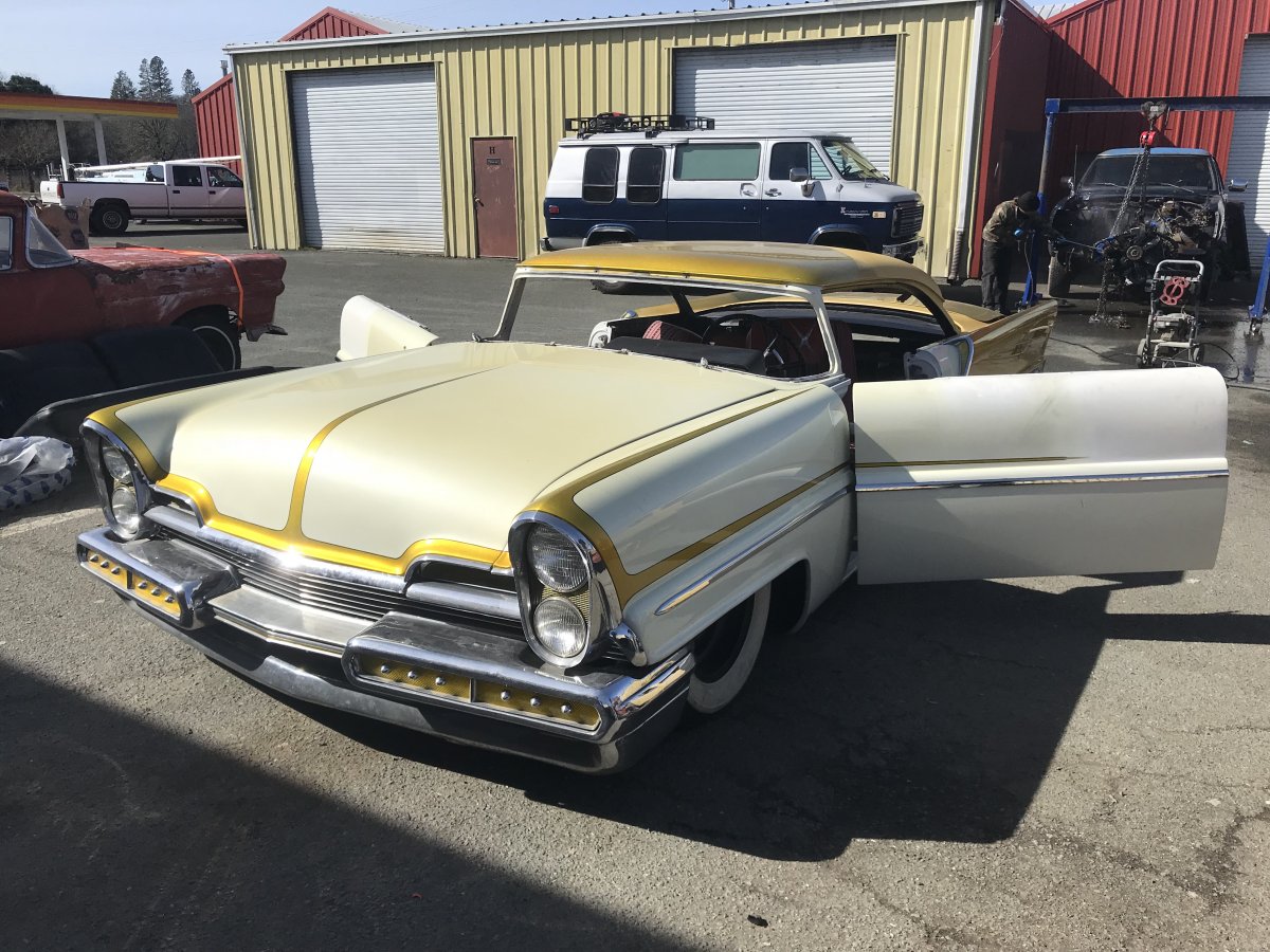

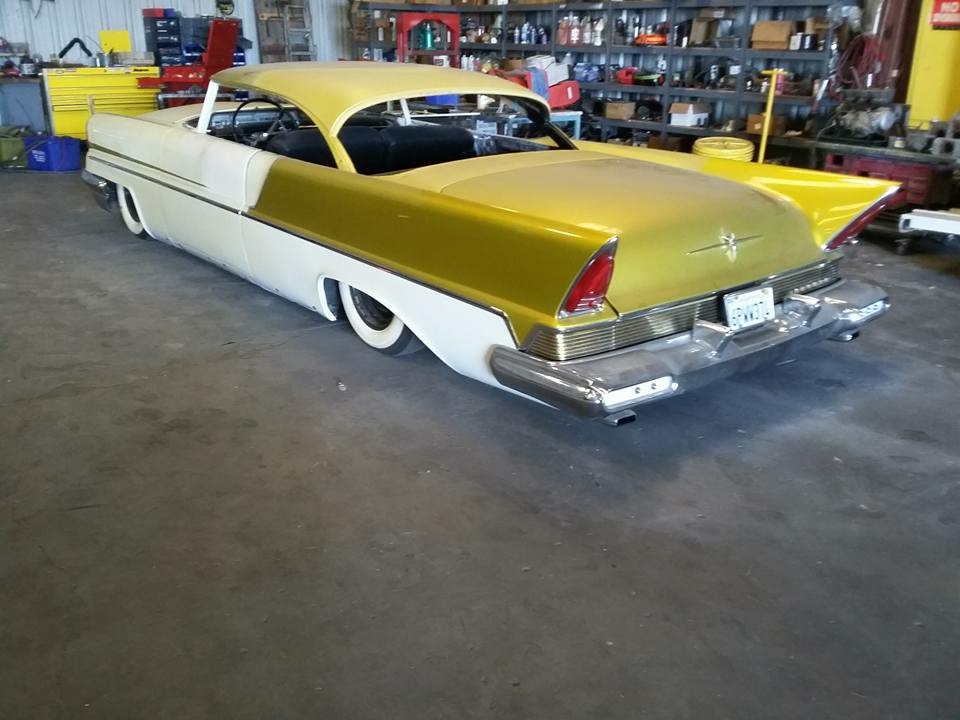

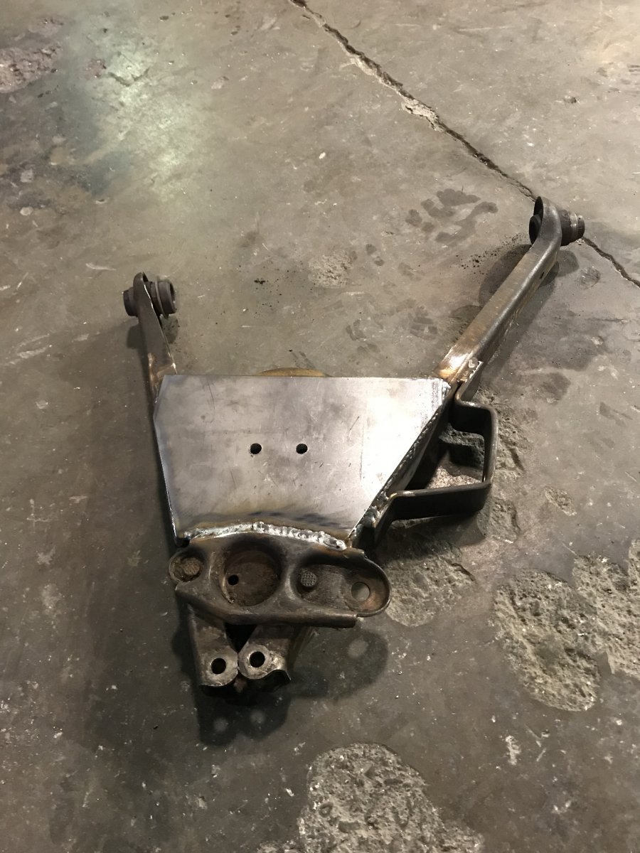

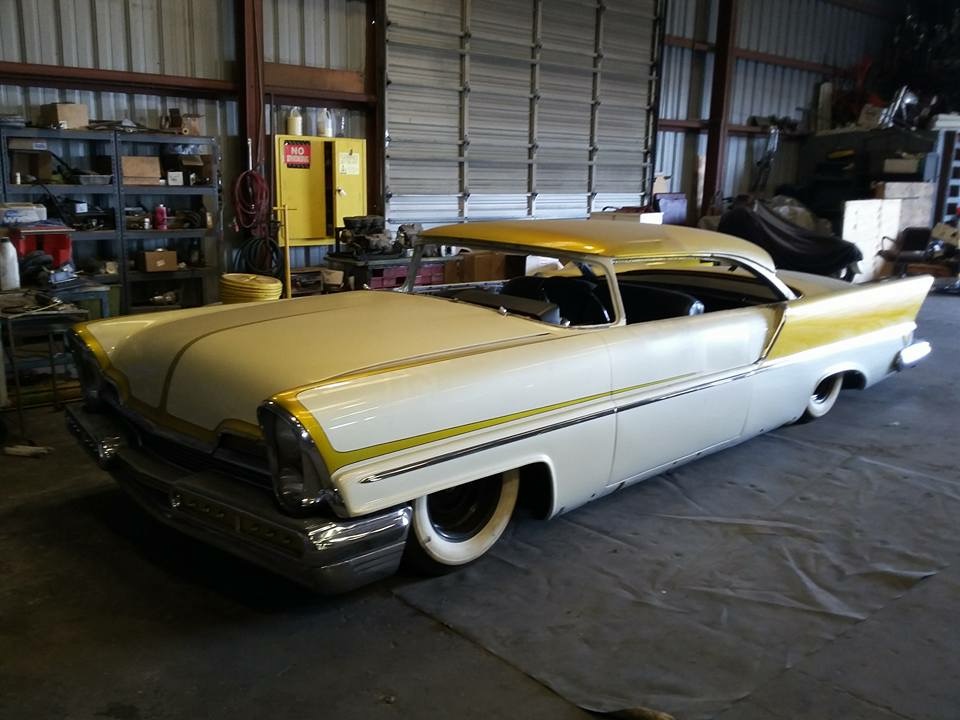

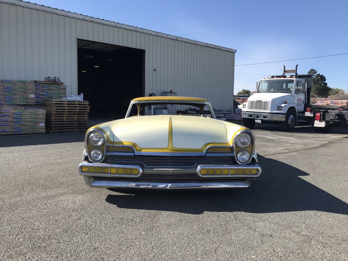

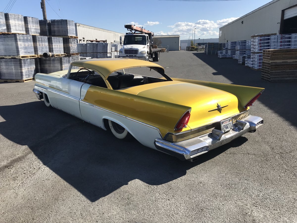

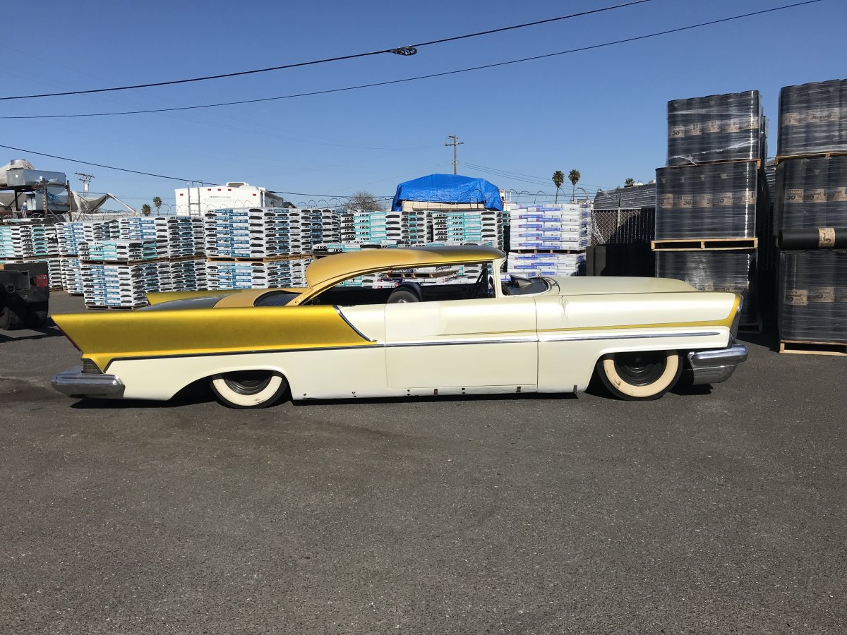

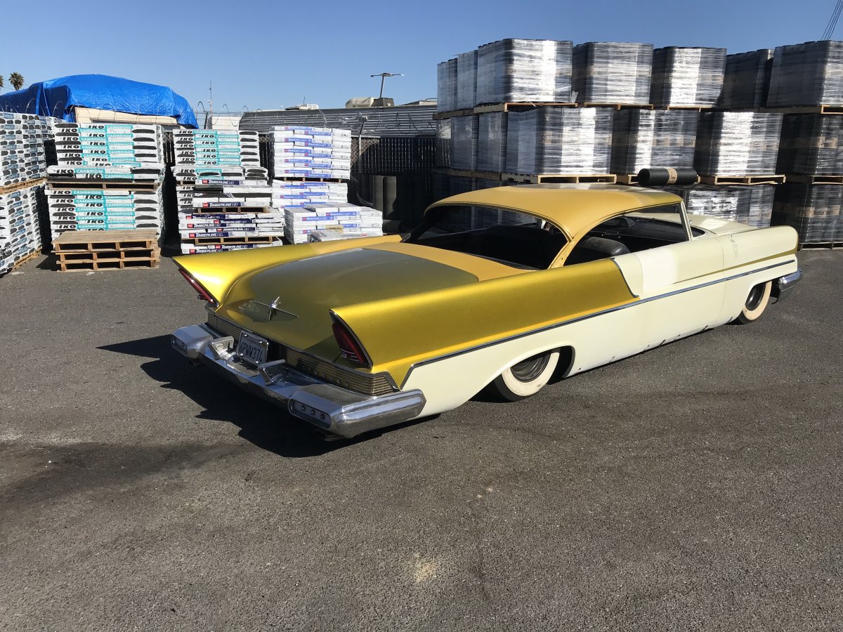

    IMG_9794.JPG IMG_9795.JPG IMG_9796.JPG IMG_9797.JPG IMG_9798.JPG What's happening citizens of Kustomsville?!!! Little by little been chipping away at "Sunsation" had a few set backs, but she's well and on her way to completion. With the help of a great friend James Williams and Darryl we're making progress towards getting her fit for the next phase. Here are some pics for everyone to enjoy... The road to Kustomsville continues... Keep it Humble and keep it Kustom!!!

    That's got the right look.

    I've fallen in love with the car. Can't wait to start my own thanks to you. Get er done.

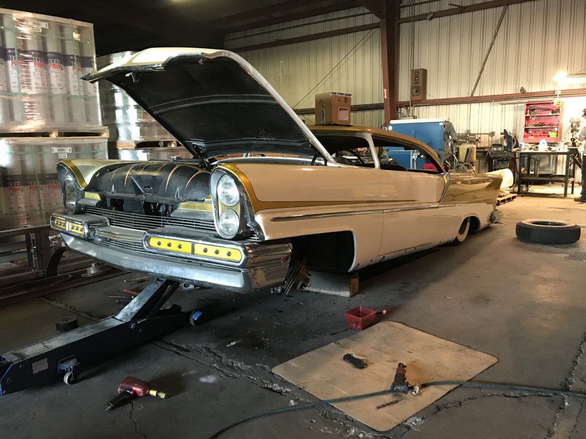

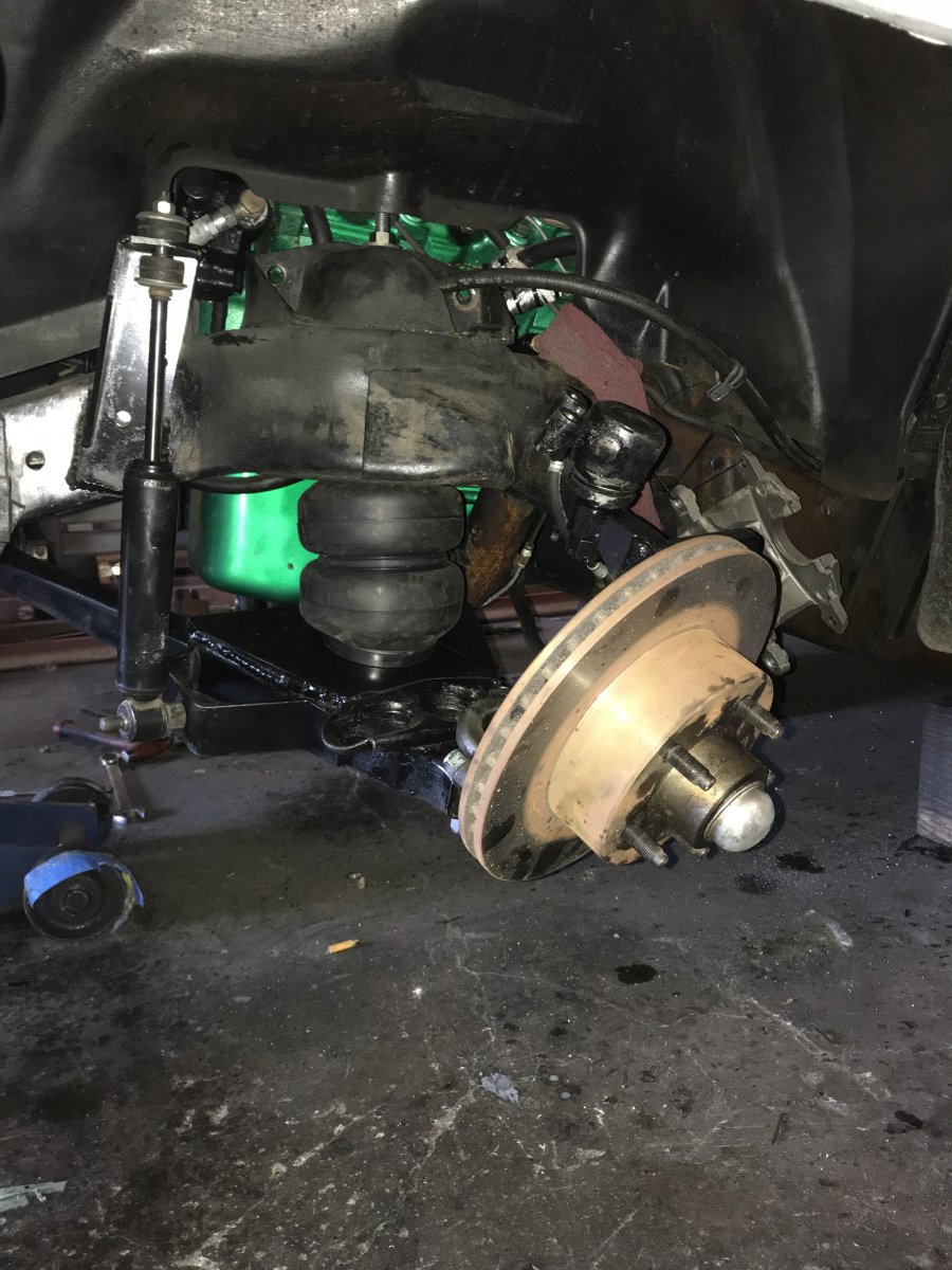

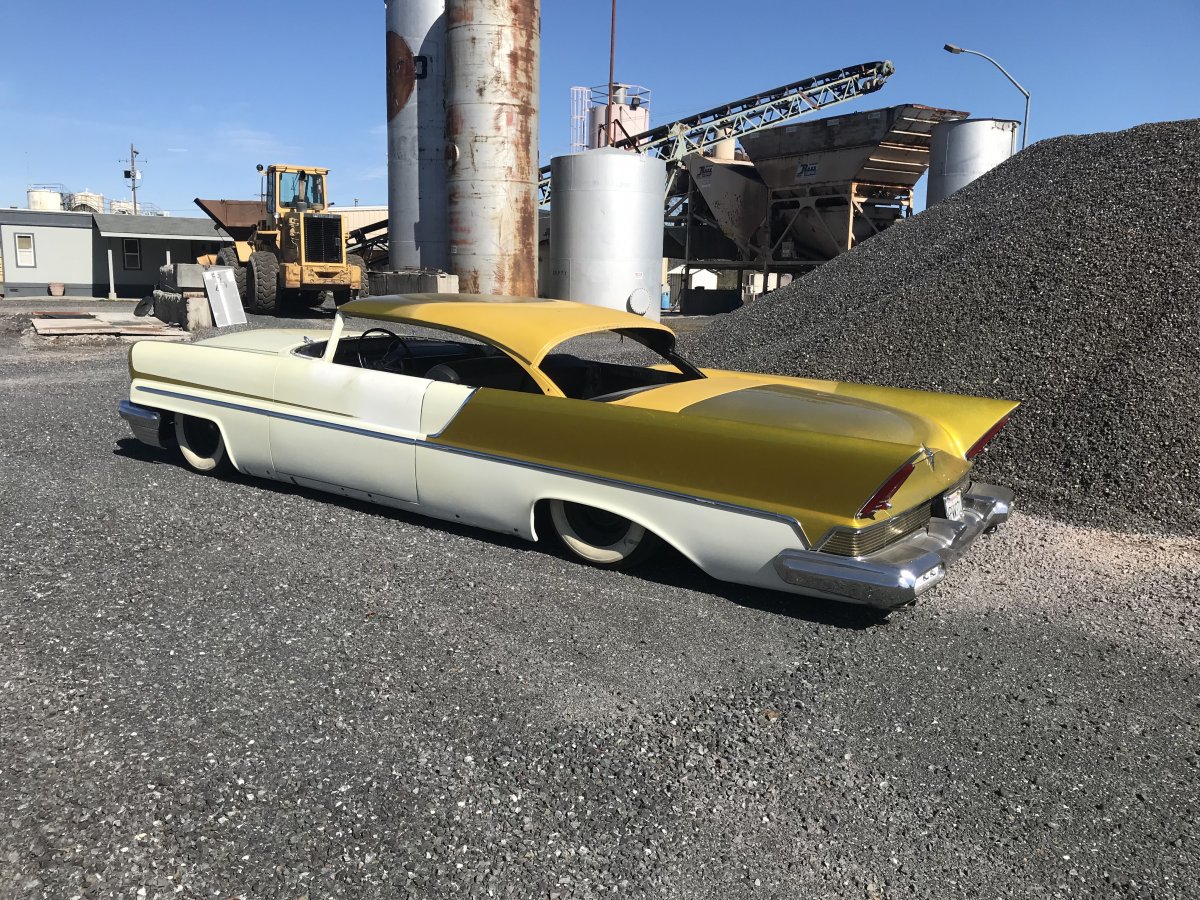

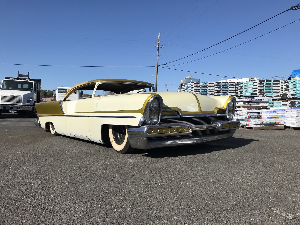

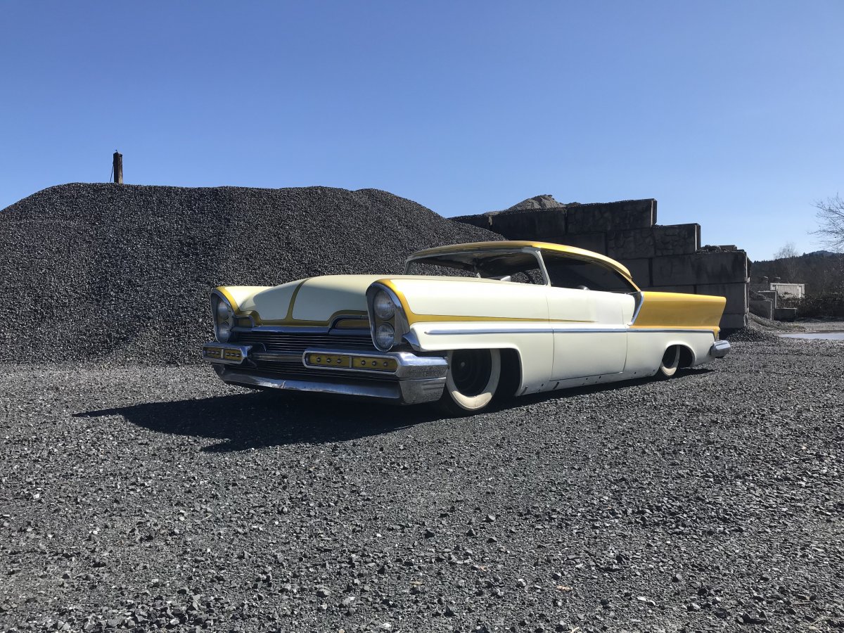

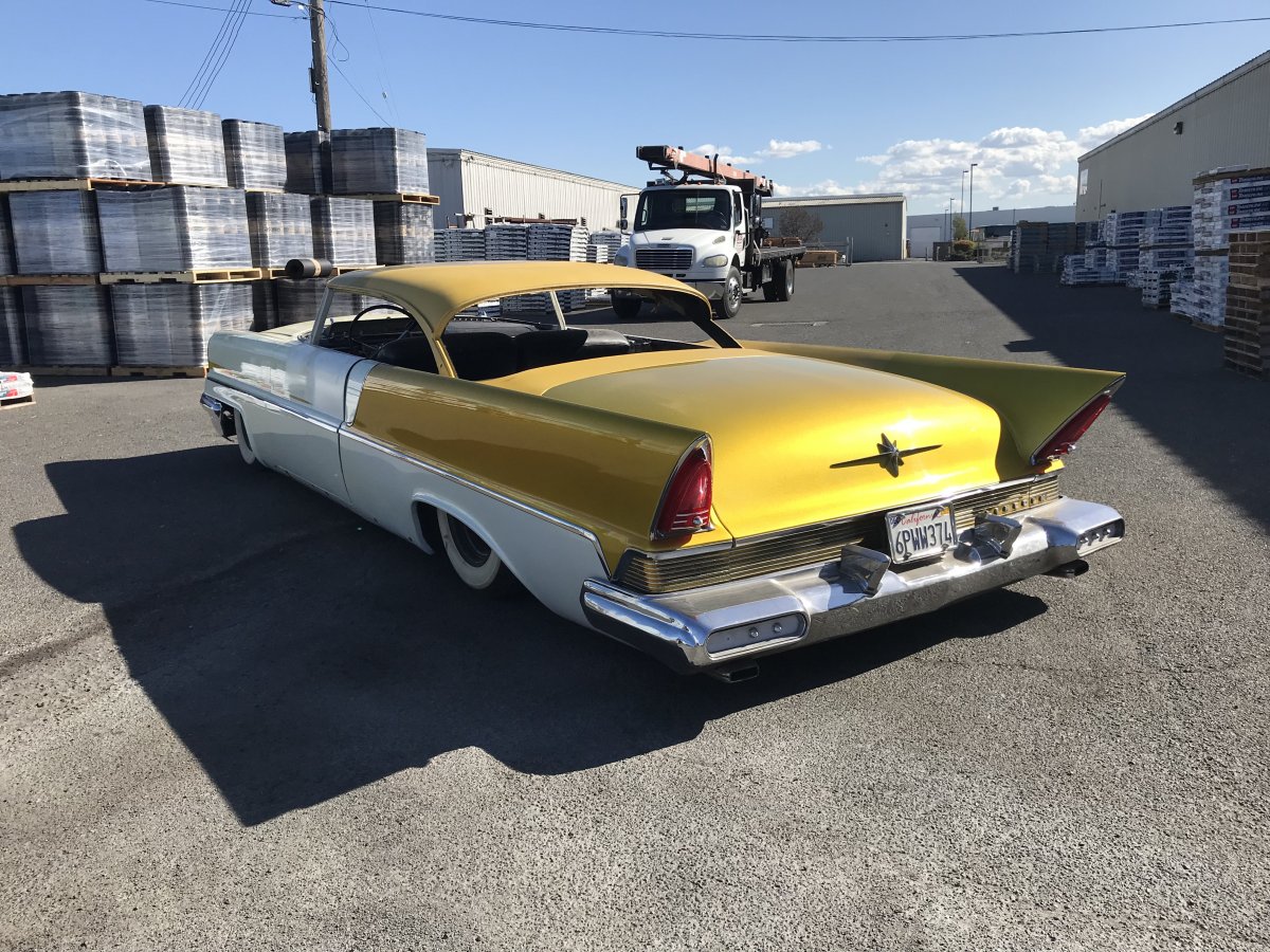

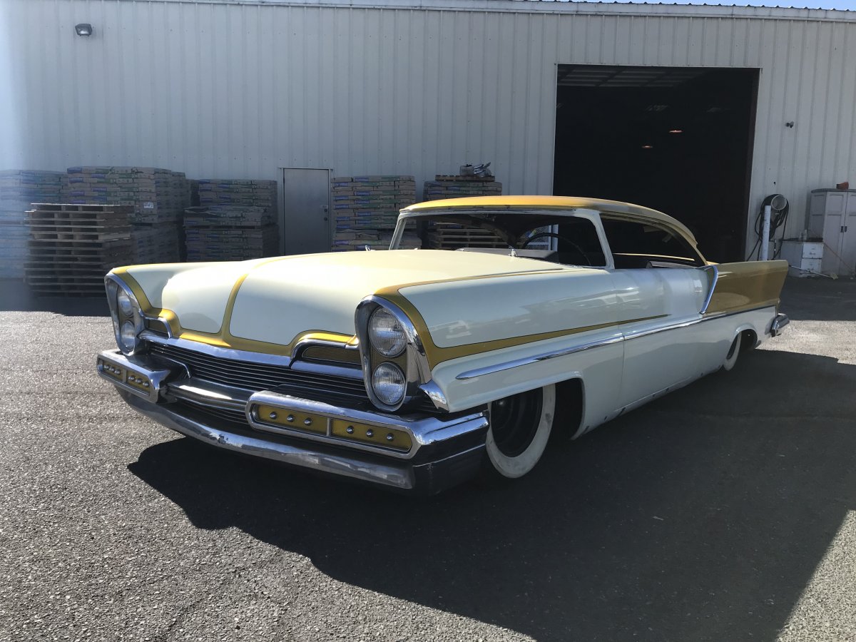

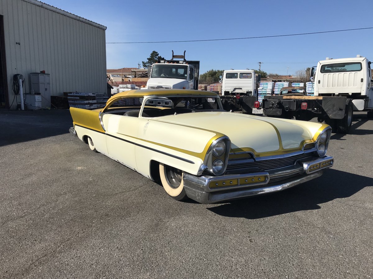

    Slow progress is better than no progress... Sunsation’s coming along and finally making forward movement... BIG thanks to my good friend James Williams and Darrell for all the help I’ve recieved from you both these last few months to get Sunsation going. Both are cl*** acts!!! Without you two, my car would still be a sitting duck lol. Let’s keep moving towards Kustomsville. Now for Jeff Spence at Kustoms by Spence to do what’s next on phase 2. Thank you from the bottom of my heart! Keep it humble and keep it kustom!!! HFFH

    I didn't visit the H.A.M.B. for a long time so I missed this beautiful Lincoln. I was pretty dissapointed that all the pictures are being held hostage. Any chance you could repost a photo of what it looked like at the start?

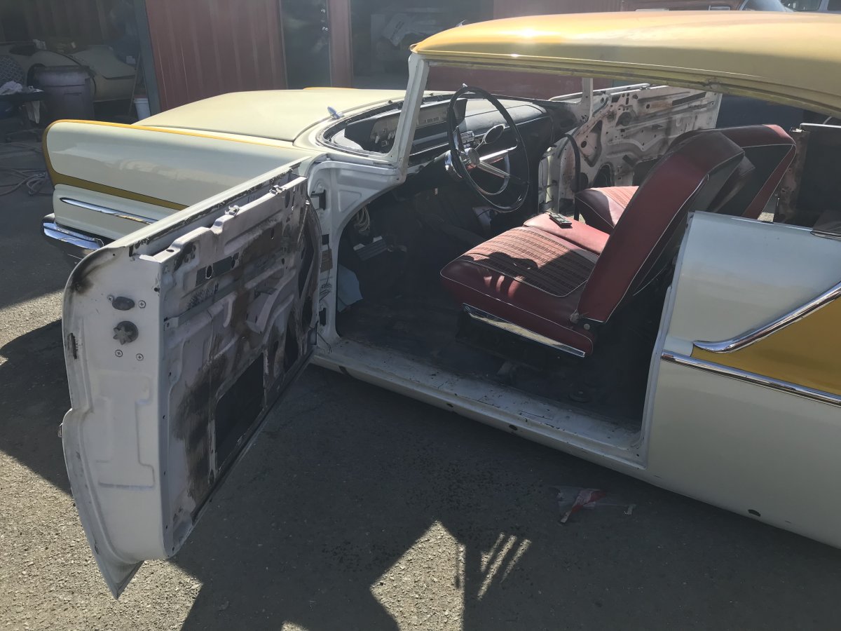

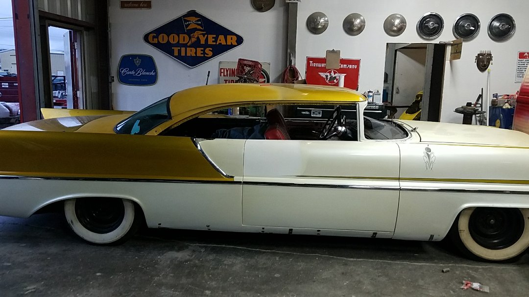

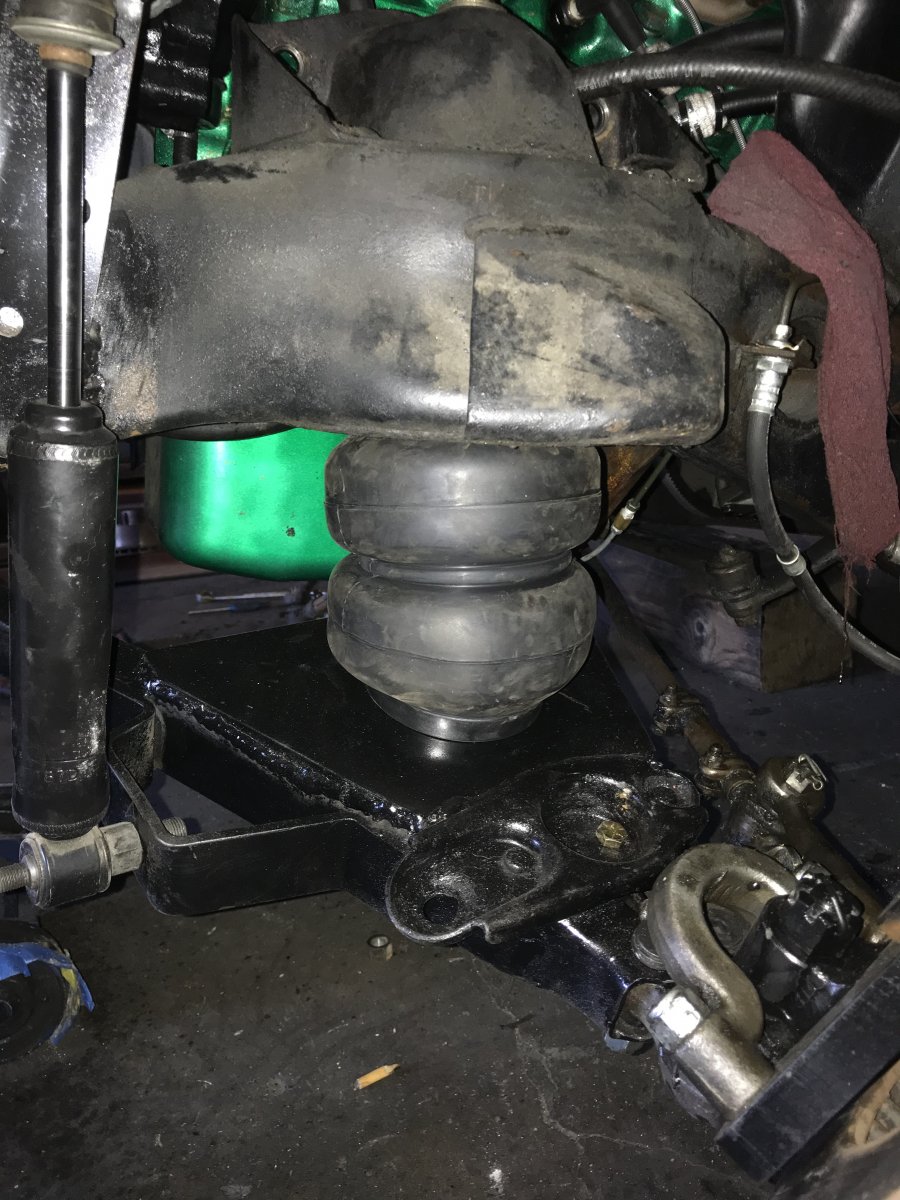

    A61143C6-DE1D-41E0-8FB6-FCD55857343F.jpeg BF205303-1473-4B28-985B-1027EC145EFA.jpeg 72526E32-E8F4-4F05-A96F-EFEEACFD5325.jpeg 0B638928-20BC-493D-BD3C-F7FD5B9B9E2B.jpeg A10144E6-78F8-4B6C-AF4F-91ED772874AC.jpeg 7FD9B950-9749-419C-92E0-AA018E0D97C0.jpeg CC7DBBE0-A4D0-4156-A39B-83F15EFB2E27.jpeg FCEA02C7-E1D1-4F57-A127-0EDB66B7297D.jpeg 35D0B8BA-F3D2-4EC1-AF0D-2CF331F361E1.jpeg What’s up citizens of Kustomsville?! So as with the previous post, the progress is in full effect with Sunsation, slowly but consistently for the time being. The new update to get her closer to the vision is the bad*** factory option swivel seats. I had already fabricated a set of swivel brackets and was thinking of adapting them to hold a pair of TBird seats but still I was looking for more of a timeless kustamization so when I saw the opportunity to grab these seats I did. For the record, I had to buy the entire car just to cannibalize the seats out of it and sell te car afterwards haha!!! Anywho, the progress continues, the gl*** should hopefully be done by end of March and the road to Kustomsville is well on its way to make the Santa Maria West Coast Kustoms Trek! Keep it humble and keep it kustom!!!

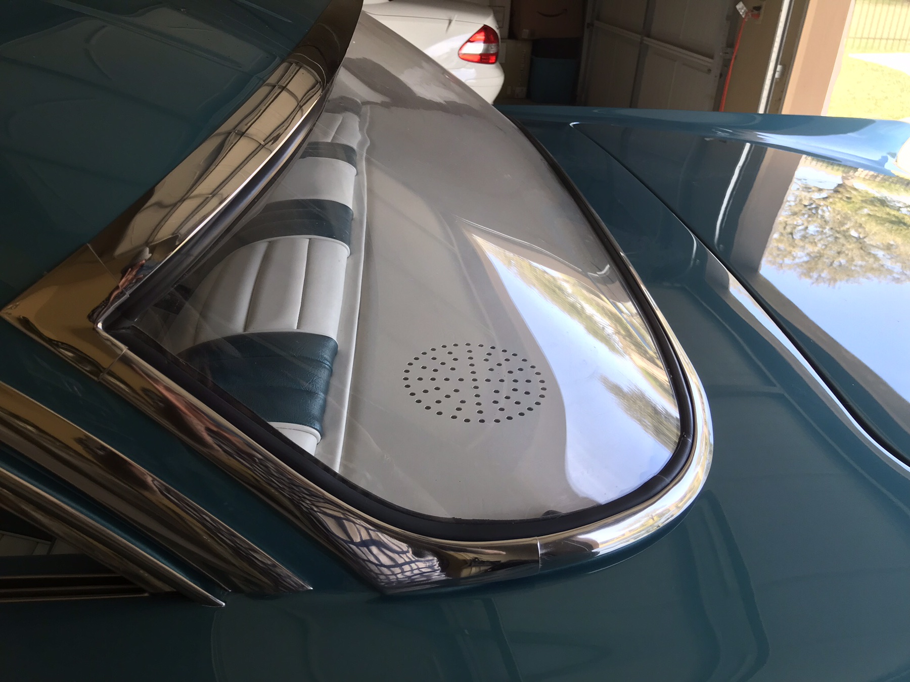

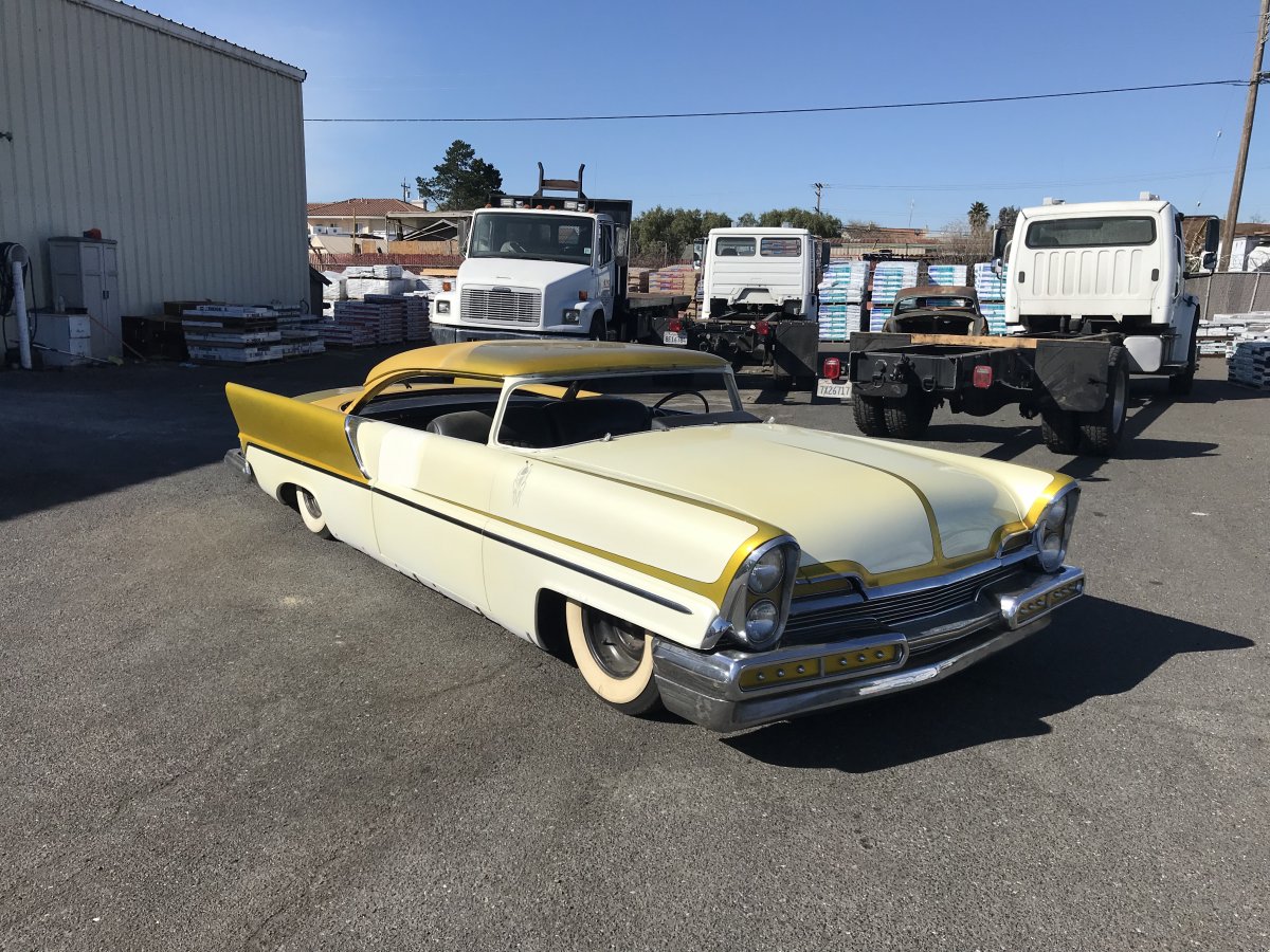

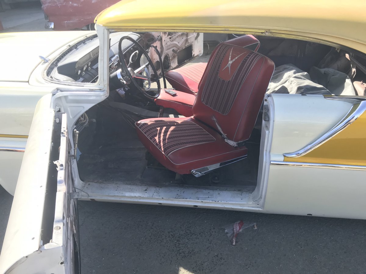

    C4E319F8-6232-497A-A5E9-E11CF5FA8C80.jpeg C624DA11-2BDD-4743-B994-5D5847568345.jpeg EDF41394-DC6F-4116-A857-D1385A9A8BC3.jpeg Btw, I know gl*** is going to be a challenge and my gl*** person, Bernie of Bernie’s Custom Gl***s knows this first hand. Not only is th gl*** cutting a challenge but finding the windshield and back window gaskets are an impossibility to find. I got lucky and found one of two windshield gaskets supposedly in the whole country, but the back gl*** gasket is an impossiblity to find, none are in existence supposedly. So what do you do when something doesn’t exist, you make and kustomize one. Thanks to the great thinking of Jeff Spence and Dave Hitchinson, who’s doing up another 57 Premiere I owned and sold to my friend James Williams, they made something that will work. This is the the rough draft of the gasket. Keep it humble and keep it kustom.

    You parted a '60 Dodge to get those seats? You butcher! ;)

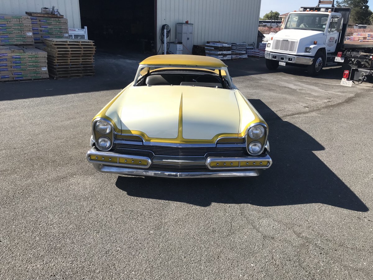

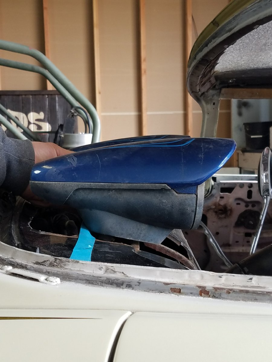

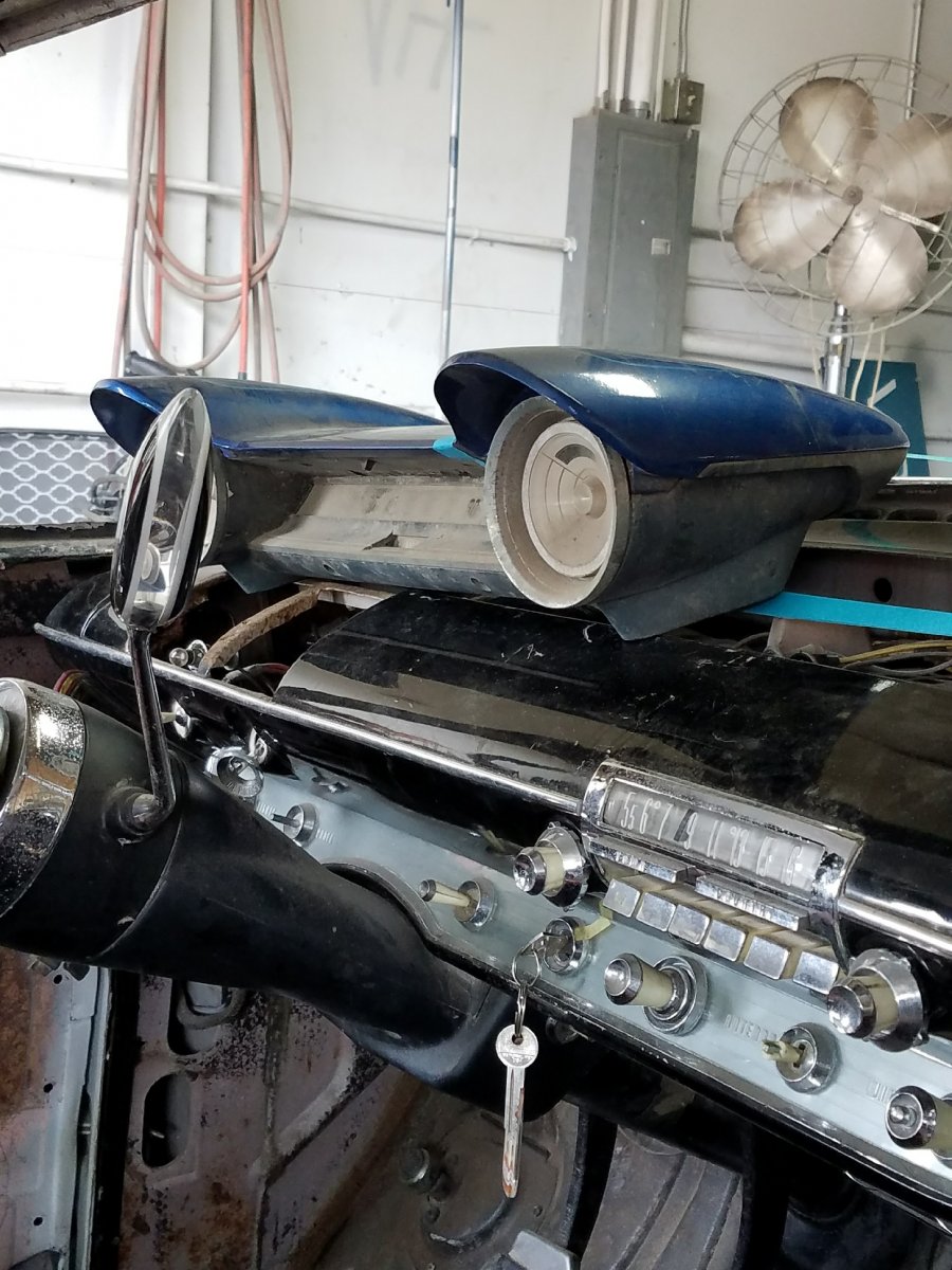

    Well, the road to Kustomsville continues for “Sunsation”. To me the gauge cluster on the 56-57 Lincoln Premieres and Capris was put there as a poorly executed afterthought and does not look like it belongs. So, the next Kustom touch is the dash. Out of my two top options, I feel the ‘61 Plymouth pod looks organic, and at home; not to mention it looks space age and futuristic as hell. Which makes it the more fitting for the buiLd. Jeff at Kustoms by Spence is doing me the honors of making the mods and adaptations... stay tuned for more to come... What are your thoughts?... Keep it humble and keep it Kustom... HFFH

  19. First comment, been liking everything I've seen so far, but I think I'd drop that gauge cluster down an inch or two into the dash somehow. And maybe a different steering wheel? I'm kinda seeing one of those 'square' Mopar wheels to go with the dash....

    Yes sink it into the dash and fill the seams.

    It's definitely going to be dropped down, this is the rough idea. As for the wheel, I had one and it's up in the air if I do a square wheel or not. Although I'm a huge fan of them.

    Definitely going to be sunk down a bit, this is the rough idea.
