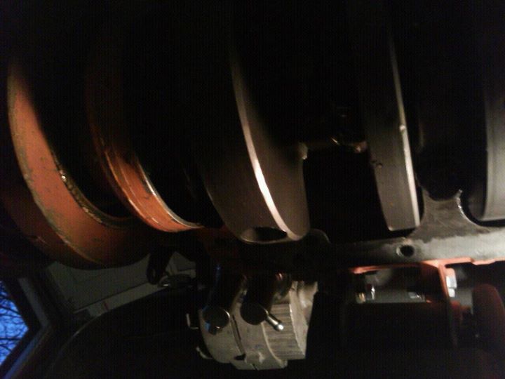

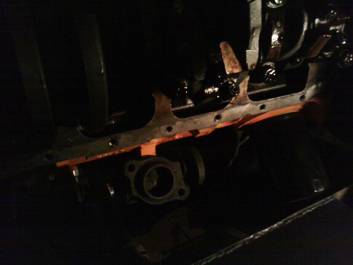

    Well spent a full day wrenching on the truck with my girl and loving every minute of it. We both had greasy hands at the end of the day.
    Took the core support off, moved the steering arm down so I could drop the oil pan..see the dipstick broke and I wanted to see if it was in there..well didn't find it so maybe it was already broke..dunno...anyways here's some pics.

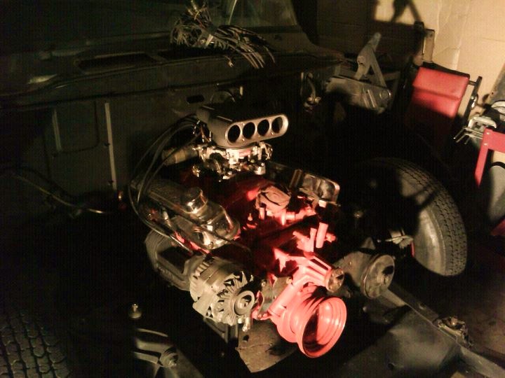

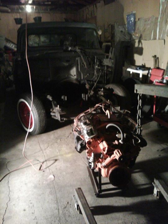

    Pulled the engine out tonight. Going to start cleaning up the engine with some Ford red engine paint. I got as far as removing the exhaust manifolds then had to go get a cough cough valentines gift.. ;)

    No I'm not talking about the girl. I'm talking about taking my engine out. I'm so close to having it driving and now I gotta get an oil pan gasket and ughh, just wasting time/

    I guess so.. lol, I just wish I would have thought about that before. Now I have to buy a new intake gasket kit. I'm just wondering since I am taking stuff apart and repainting, should I remove the intake to or just leave it alone? I did buy some chrysler red engine enamel.

    If the engine ran good before I'd suggest not messing with the intake, just put the engine on a stand, install your pan, then clean and paint the whole engine. It can also be a bit of a p.i.t.a but it'll be worth it if you take your time. When I paint an engine I stuff clean rags into the ports, fuel pump hole etc to keep overspray out.
    Another thought, port sealing is important but just s****ing all the paint off the flats leaves exposed metal and looks kinda ****py. I've set a gasket in place, scribed round it and s****ed off just where the gasket has to seal with a single edge razor blade. This can be tedious but it'll insure a good seal.

    I slapped the engine back in! Still gotta buy a pan gasket and do all that **** but it's not hard to do while underneath.
    Alot deeper red in person..

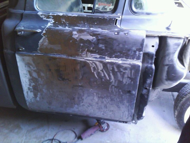

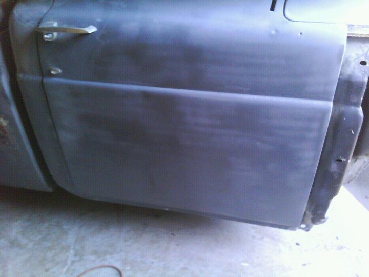

    Well yesterday I started taking panels of the truck down to bare metal. I did the door with an 80 grit flapper disc on a grinder..works good..and my girl was there to learn!..:)
    Also on the door only found two dents and a little rust hole in the bottom corner..all good.

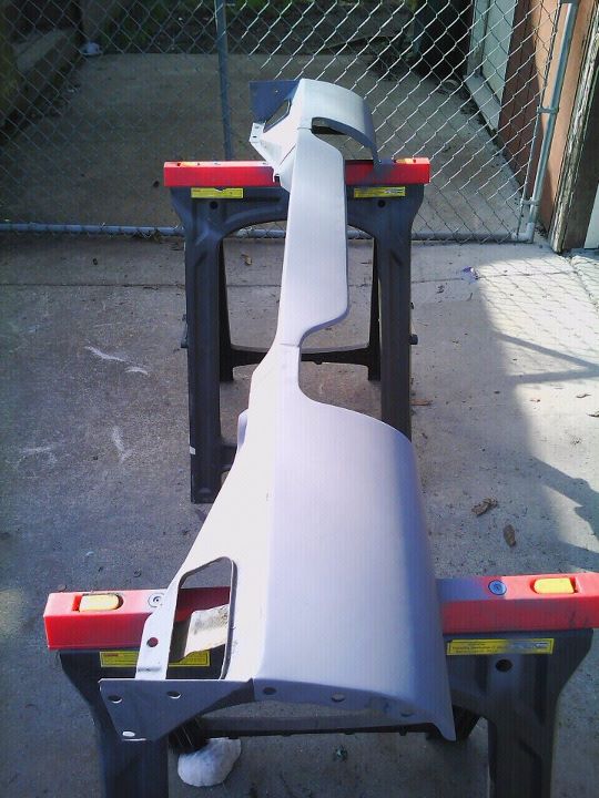

    Today we sanded down the fender and primed, then the splash pan..busy weekend.

    After school today it was really freakin cold and rainy. So what do I do? Go out in the garage and work! haha I sanded the door down and my girl sat and watched..I made sure she was warm and she was happy :) Gonna have her try the grinding in a couple days..
