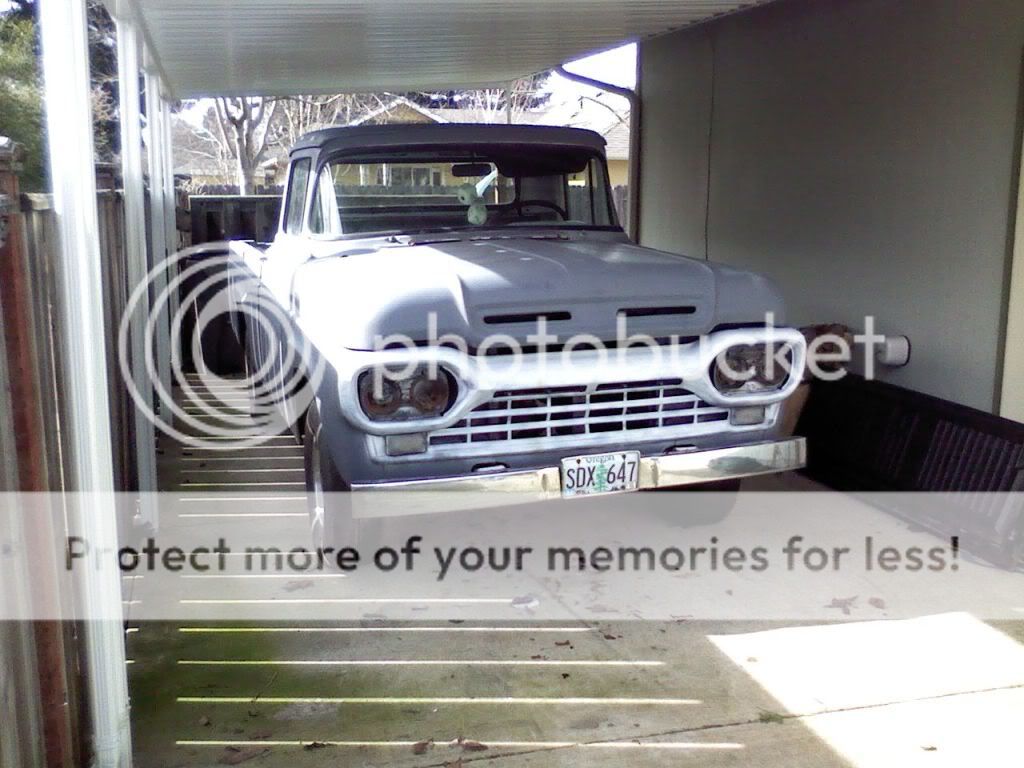

    Got alot done this weekend. Me and Anythinggm trailered it over to his house where there is a flat concrete driveway with a carport! Which makes things alot easier...
    Then we got it rolled back into it's temporary home..
    Then we had to go to his church's yard sale and help haul stuff over to the church..took several hours and after dinner we came back. Put the big lights up. it was VERY cold as we were working..
    Got truck on stands so it's level, unbolted hood and fenders, started removing stuff I'm not using from the firewall and fender wells..
    Next weekend we will find the centerline and start cleaning up the frame and clip for welding and such..Cheers!

    I used to do front end stuff, many F100s with Mopar front end grafts. Be careful when you place it, make sure there will be room for positive caster adjustment. Most get welded in without considering that, and handle like a fat man riding a tricycle!
    As for your 318 engine and 904 trans: Good choice! (if you're thinking about replacing it with something else, drive it awhile...you'll love the 318.)
    If you change the rear axle to a Ford p***enger, (it's already a 9", why change it???)
    but I say if you do, the Stude wheels will fit. Not sure if the center hole will clear the front hubs on the Volare discs, but the pattern is the same, 5 on 4.5".
    You may know this, but just a reminder...GO JON!!! We are with you.
