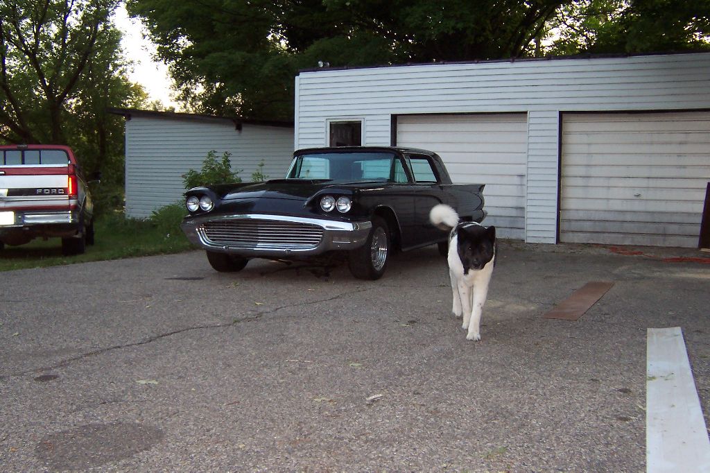

    So i got a little more done over the weekend. We were able to get the drivers rocker and fender in primer. I wasnt able to get the p***enger fender or rocker patch done this weekend unfortunately. But we did lower the car and push it out of the shop for a quick photo session. I used aerostar front springs in the front which dropped the front end almost a full 3", which Im happy with. The rear however is a different story, we made 2" blocks and took a leaf out of the rear, but it is still sitting way too high. It needs to come down another 1.5".

    I'm not very familiar with these birds but are you sure the rear shackles didn't flip when you took the leafs out?

    How are the rear spring shackles? Looks like they might be "flipped". The springs should be above the steel U.
    Lowering the rear end of the car can be done by removing the steel U and boring a new rear spring mount through the frame. Did that on my son's 59
    It does require pulling the tank to drill the holes.

    I was going to ask you guys about the shackles, because I thought the same thing and the rear didnt come down a full 2". I was pressed for time when we pushed it out to take a look, but thought the shackles looked flipped. This was something I was going to address next weekend when Im back in the shop.
    movin/on any chance you have pics of the new mount you made on your sons car?
