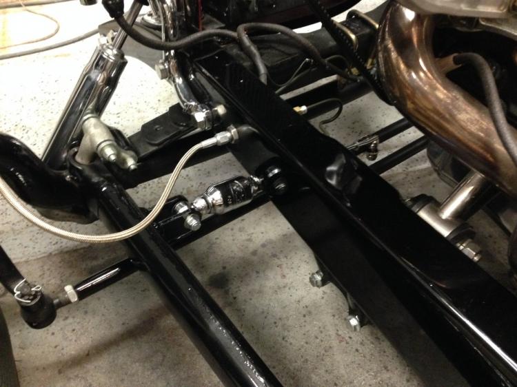

    long weekend... after I got everything back together and back on the ground I pushed on the body and had a lot of side to side movement. So, back under I went and as I was pushing the body from under neath I found a big problem. I think this and the shock angle being off was more than the shock could handle. All four rubber bushings in my rear pan hard bar had got brittle and basically disintigrated. Thanks to baker53 we put some newer ones in. I ordered some poly bushing so hopefully this will eliminate this problem in the future.

  3. olskoolrodder
    Joined: Aug 14, 2009
    Posts: 917
    olskoolrodder
    this was a Speedway pan hard kit. It was included in the package deal when I bought the car so no idea on age. I ordered the poly kit bushings and sleeves from Summit Racing.

    to eliminate my death wobble I had to change the old bias plys in the front. They sat so long during the build I couldn't get them to roll out without hopping. I also added SoCal's steering stabilizer while I was at it.
