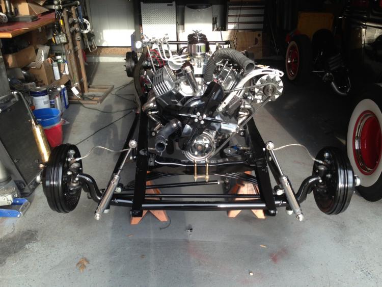

    not much to report, picked up and installed my narrowed rearend, narrowed by 3" on each end. Thanks Pyle Bros. in Baytown. Picking up wheels today from painter. Taped off frame and started sanding it. I plan on re-shooting it this weekend. First time painting with lacquer, lesson learned, put many coats of clear on and do not block and buff like you would with urethane paints. It is very soft and you can burn thru it very fast. I also started upholstering my seats. Should have them completed tonight. So, here are some pics of the changes so far.

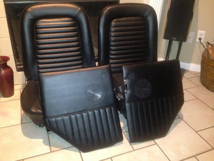

    busy weekend... picked up painted wheels today should have it back on by tonight. I finished my seats this weekend and sanded and taped off my frame and components and re shot them in the same black lacquer and clear coat. I put quite a bit of clear on this time. Hopefully the last of the painting. My body and paint guy said he was going to start on the body next week..

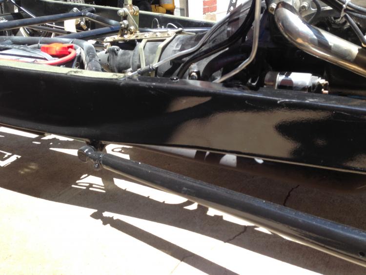

    A little update... I blocked and buffed the frame, noticed the black looks to have wrinkled under the clear coat. Not sure why it happened but, too tired to do anything about it. Found some cool Offy risers now my throttle cable can run straight horizontally to the carbs. The body guy sent me a few update pics... hopefully 2 more weeks.

    started working on my interior panels... one down 10,000 more to go!

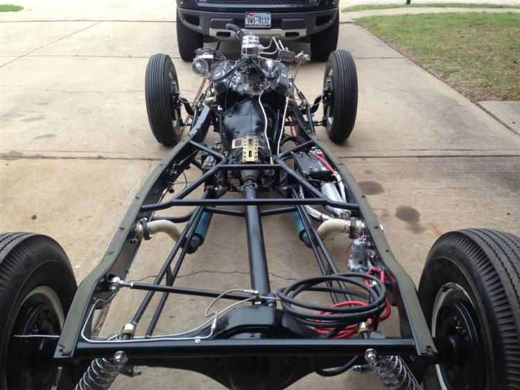

    Awesome looking dash with the floor treatment looks good. I like the idea that you went with a highboy style with the body on 32 rails. You should listen to the guys here and put some flex in those fuel lines, it's better to be safe then sorry. I know how guys hate to do something over! I would change over to a Model A rear spring now and not have to live with the coil overs, I don't like. Your doing a great job on the sedan.:D The added rubber in the fuel lines looks good and now it's safe.

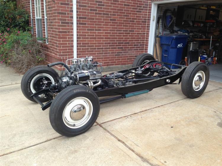

    thanks... I redid my vacuum and fuel lines in 3/8" stainless. I'll upload pics later. If nothing else the stainless looks 10x better than the aluminum, in my opinion...

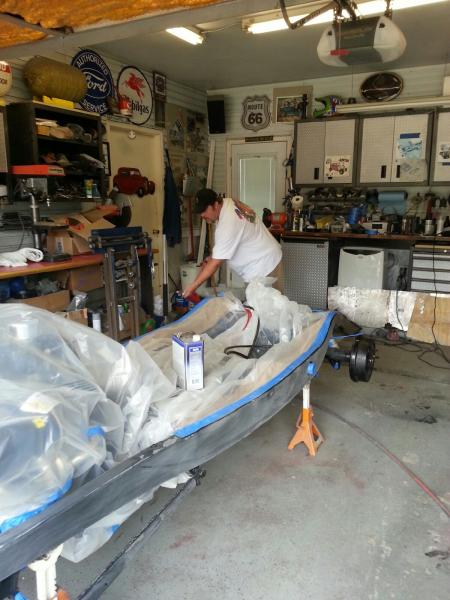

    One step forward, 10 back... The paint I sprayed on my frame a while back is having problems. I think I reduced the lacquer to much then covered it with clear before allowing it to fully dry. It is completely cracked giving it a horrible wrinkle paint look. I decided last night to sand it all off and I found that the black was still wet, as suspected. Once I get it striped and taped off my painter nicely volunteered to come to my house and prep it and spray it.

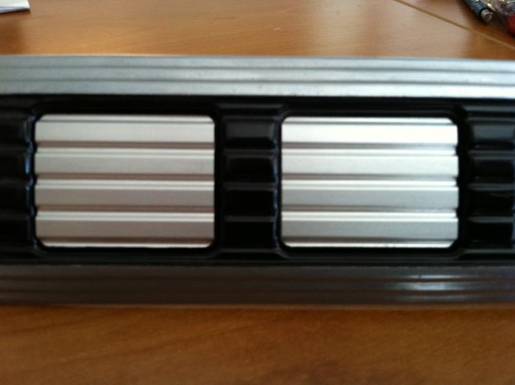

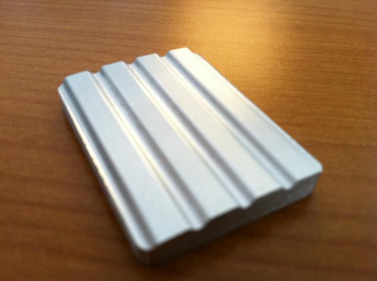

    ok... final update before I get the body back from paint and my parts come back from chromer.

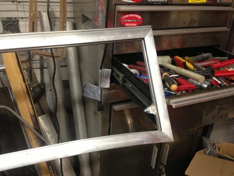

    chopped and re-welded my windshield frame (thanks Gary) and started polishing it. I used a flat file to shape the corner, hopefully there is enough weld left.
    ch***is stripped, hopefully for the last time. Should get painted Tuesday evening.
    I had a machine shop make 4 parts to block off the original gauge openings in the Mercury dash. They have a tapped hole in the back and a bar with 4 holes that will keep the parts in place. I will paint them black to match the dash trim. Thanks Tony @ South Texas Machining - Alvin, Tx.
