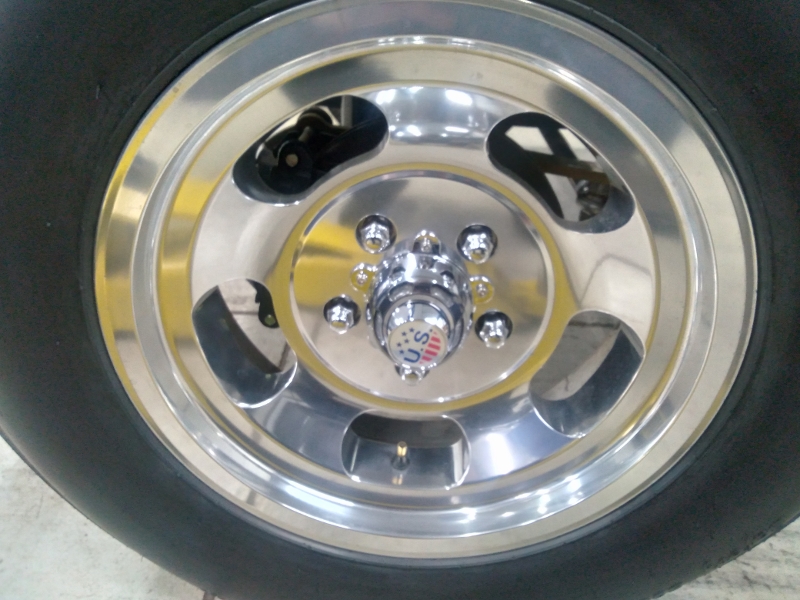

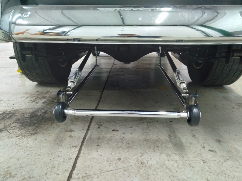

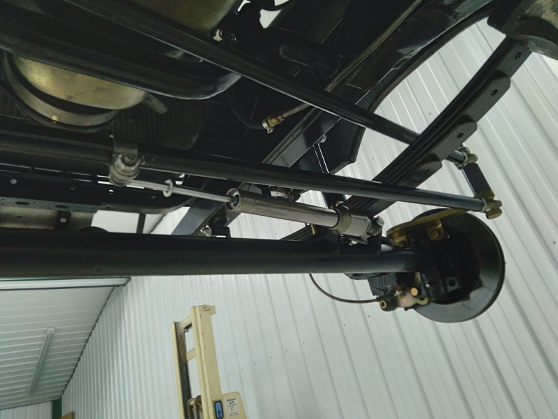

  22. Long delayed update :
    Finally got Stubby on the lift to see what was going on with the front end. Turns out the bolts holding the steering to the p***enger spindle were loose. This was caused I believe by the fact that the kingpin on that side has some play in it. I will do kingpins on it, but not right now.
    While I had it on the lift I installed the steering dampener, the training wheels, cleaned the inside, different shifter handle & new pedal pads. I also spent almost 6 hours polishing the wheels, because the guy I bought it from cleaned the tires with something akin to acid, etching the aluminum!:eek:
    The next few days will be high 40's/low 50's & sunny, so I am anxious to take it for a good blast now that I know it is a little safer (as in hopefully no death wobble now)
    God Bless
    Bill
    https://www.jalopyjournal.com/forum...ar-transport-hauling-open-or-enclosed.614419/ 20240202_113209 (800x600).jpg 20240202_113222 (800x600).jpg 20240205_213712 (800x600).jpg 20240205_213741 (800x600).jpg 20240202_134822 (800x600).jpg

    SS327
    Bill, I’m not a big fan of that tall stand-off from the steering arm to the cross steer rod. I have seen a bolt snap and I have seen a steering arm break from metal fatigue. Not sure what I would do to correct it but I would look seriously at doing something. Maybe boxing the arm so you could use 2 shorter bolts?

    @SS327 ...I thought the exact same thing! This is the 1st opportunity to see the front suspension in the air with the wheels off. That stand will stay on my mind & will try to fabricate something better as you advised. The roll cage will probably have to wait until next winter as I only have 3 weeks left before I get back out on the road & I want to finish up the Nash + get the GP done enough to drive it over for the out of state inspection, so I can transfer the ***le, etc.
