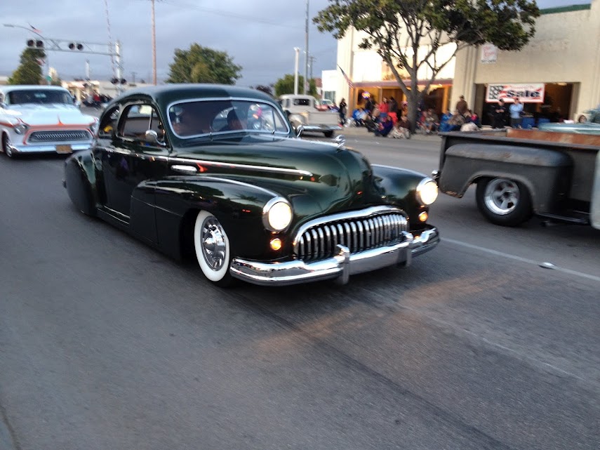

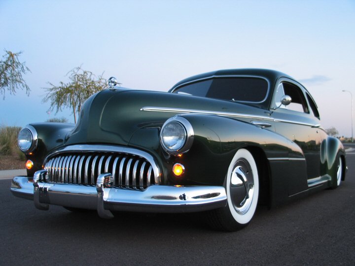

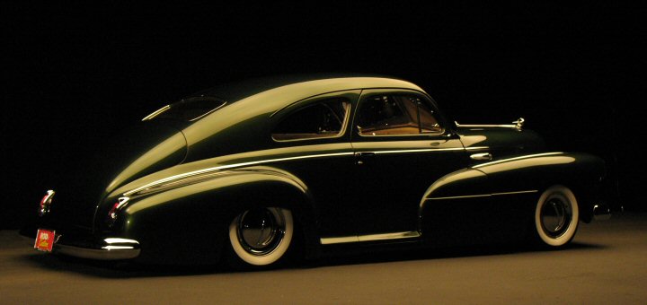

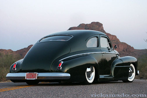

    My attempt to add some cl*** to this.

    Glen is that your car?

  18. Koderboy
    Joined: Jun 30, 2012
    Posts: 50
    Koderboy
    from Monroe ia
    I had one idea in my head but after seeing the pics glen posted i think ive changed my mind

  20. Glen
    Joined: Mar 21, 2001
    Posts: 1,789
    Glen
    it was, i sold it. The new owner is in california.
