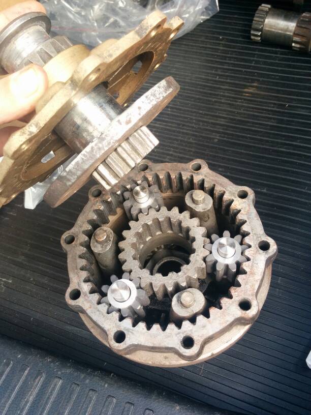

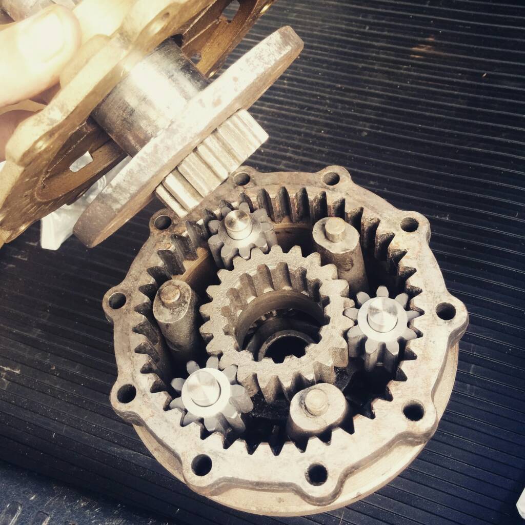

    Its been quite some time since my last update...but a lot has been going on. Now thankfully I can bring you guys up to speed.
    I have decided to go ahead with a few changes, additions that have been stewing for quite a few years.
    The first and most important is the Ruckstell 2 speed axle. These were accessory 2-speex sliding gear/planetary axles for Ts that offered a low ratio and standard. I have been hunting for one for years....but all have out of my price range.
    6 months ago, a good friend and fellow T'er brought me a milk crate with some Ruckstell innards and two cracked housings.
    "Its a start" he said as I dug into my new goodies.
    The housings were pretty rough...one more so then the other, so I used to really bad one to patch the other...which has cracked around the drive shaft mount. Since the housings are Steel and not iron, it was easily welded in.
    Now that all parts have been scrounged I am ready to ***emble. I will of course have a large update outlining removal, ***embly, and installation.

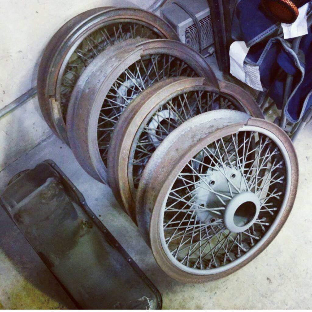

    The second important addition is the new wire wheels.
    Since the beginning, the design always called for a set of Buffalo or Dayton wire racing wheels, very stylish and popular for the period and a traditional and well built gow.
    Sadly these wheels have always been unattainable... Until a very good friend offered me a very nice set of 19" Buffalo pin-drive wires...complete with snap rings!
    I have yet to blast and paint them....but I have all the adapters done and all new hardware. Hopefully we can get the mounted and on the car soon!

    The wheels also came from a similar situation... A good price from the super nice guy I bought my 1916 Hupmobile from. They are NICE. the look nasty, but the clean up like new.

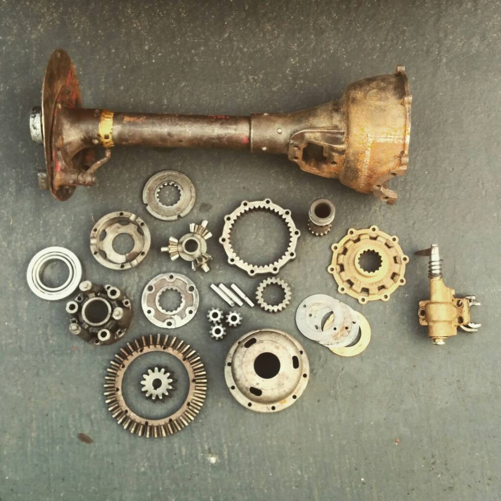

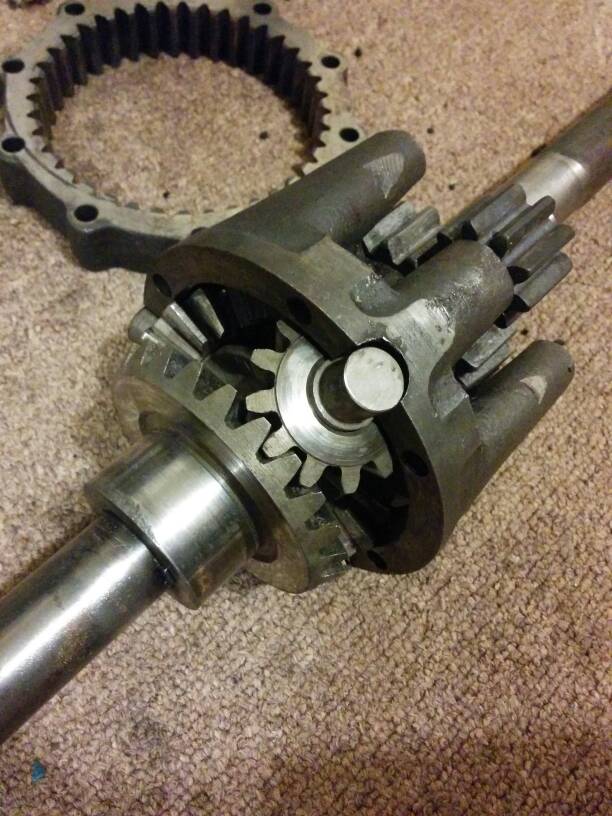

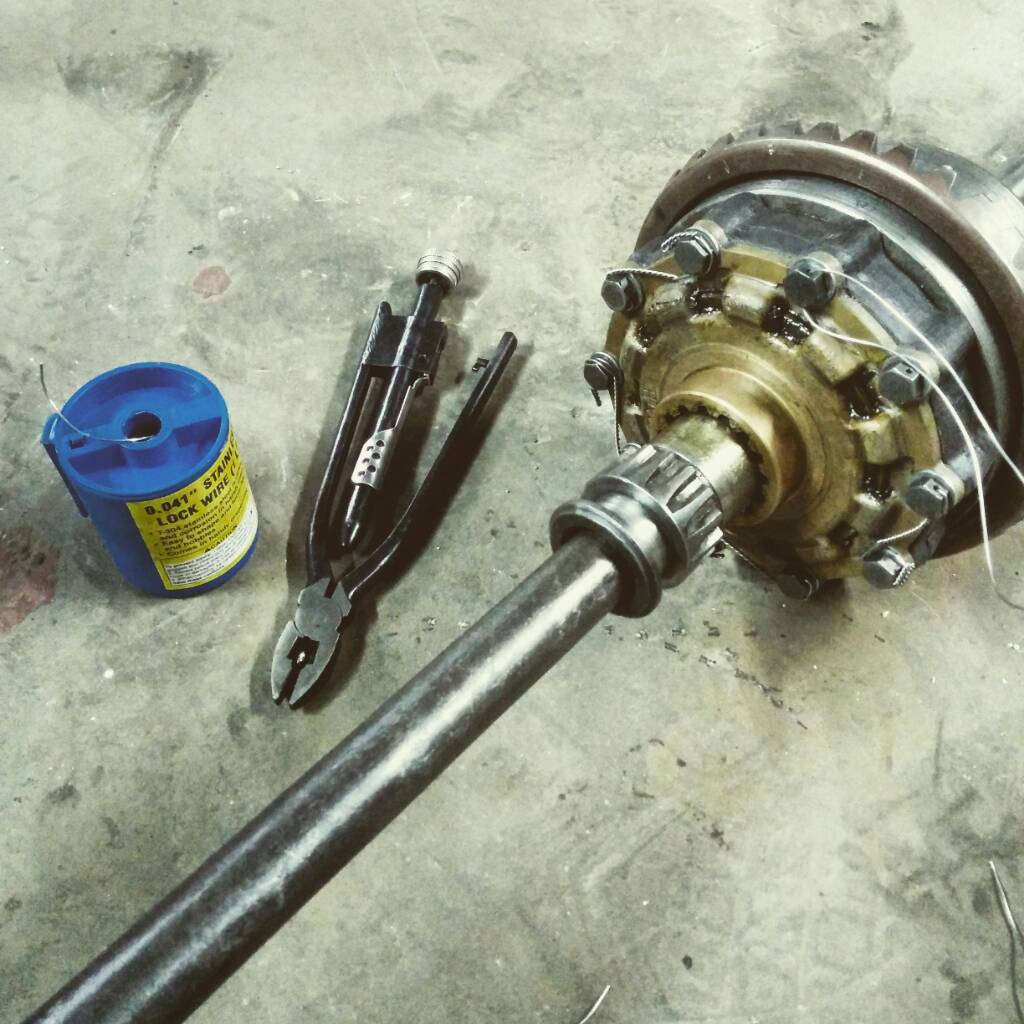

    So last time I posted an update, I was working on ***embling a Ruckstell 2-Speed rear axle...something I have long lusted after for the T.
    The Ruckstell axle was first devised By Arthur Baker in 1915 and sold as the "Perfecto Axle". In 1918, Hall-Scott purchased the rights and licenses to the Perfecto axle and the project of improving the design was given to Grover Ruckstell... A brilliant engineer. They were sold under the Ruckstell name well into the late 20's for $62.50.
    The Ruckstell is essentially a sliding gear, planetary transmission stuffed into the rear differential. An ingenious design. It has no neutral, just low and direct (ring and pinion ratio).
    Since Ruckstells are on the more expensive side..... I decided to piece mine together.
    I was able to acquire all parts needed from friends and had the whole thing ready to go in no time!
    Last week, I started ***embly...
    By Friday... Everything was ***embled and ready for safety wgearing 1432138135123.jpg
    Then, after much struggle at 1:00 am.....I got the axle halves ***embled and ready to install.

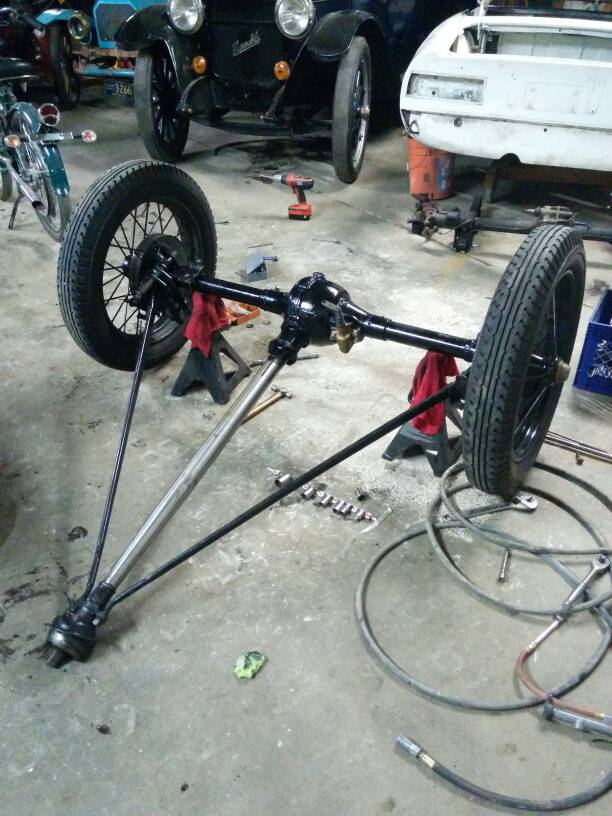

    *side note* - since day 1, one addition I had always intended was 3:1 gearing. I finally got a set from a good friend and put them in. Since the pinion is larger then the standard pinion..... You have to split the rear axle case to put the drive line in. Single handedly.... Its difficult.
    Saturday was the big day for installation... And a few other repairs...
    A few weeks prior...I had snapped a brake rod...so I made all new ones:
    After nearly 16 hours of fighting it ( springs that don't line up, shackles that don't fit, axle housings that were fixed wrong, missing hardware and a jammed shifter) the Ruckstell was FINALLY installed Sunday morning about 3 am.
    Sunday, a good friend came up from CA....so we took it for the first test run...
    It ran out fantastically!
    It REALLY wants to run now. The 3:1 gears make it a completely different car....with SO much more power and speed. Its effortless at 60 :D
    More testing and the shift linkage setup coming soon, so stay tuned!
