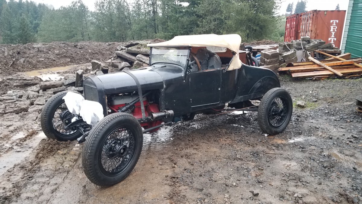

    Its been sitting on that back burner for almost three years now, up on jack stands (Sad, I know). The worst part is, its been exiled to my buddy’s shop (cause he has the room I don’t) while the last two big builds were going on. His shop is new and he has not had the floor poured yet, so its just gravel. This winter while I was up there, I noticed the moisture had really taken its toll and done a lot of damage.
    Last weekend, I made plans, cleared so e floor space and brought her home for cleanup, reactivation, major service work and a face lift to get her back to “Fighting Trim” again.

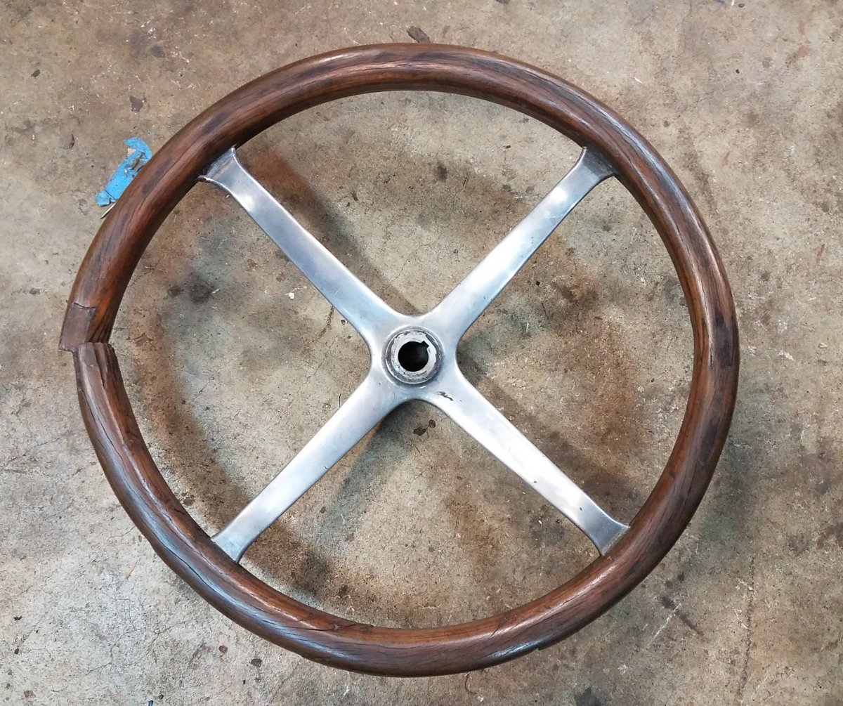

    The biggest deal is the steering wheel. The moisture trapped in the building warped and buckled the steering wheel, splitting one of the finger joints. It will take time and patents to repair.

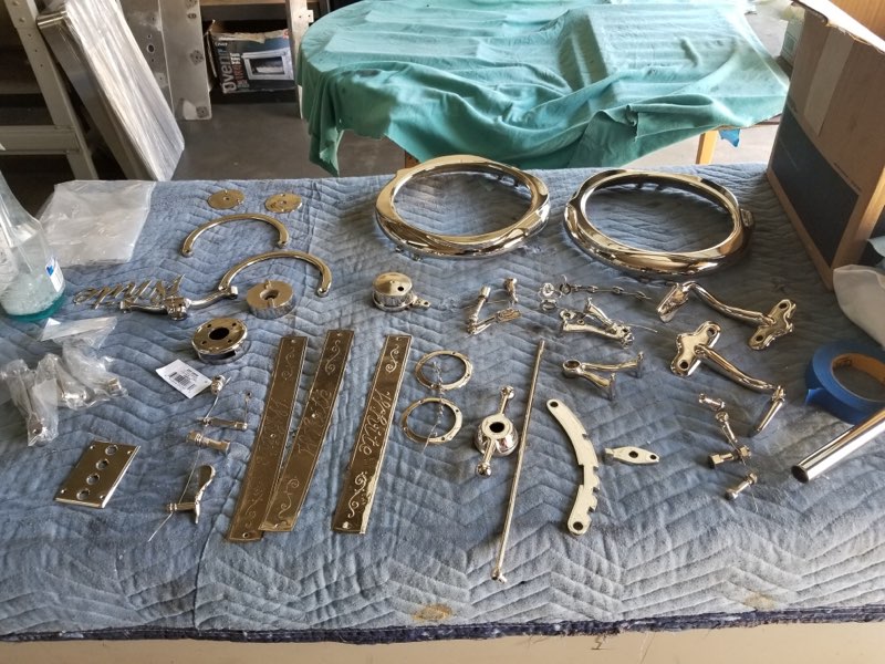

    A lot of the old, surviving nickel plate work is also nearly gone, so most of that stuff was sent off to be replated. I also ordered a set of Muroc Mfg. Co. stacks for it, to replace the frog mouth scoops I used when I finished it in 2012.

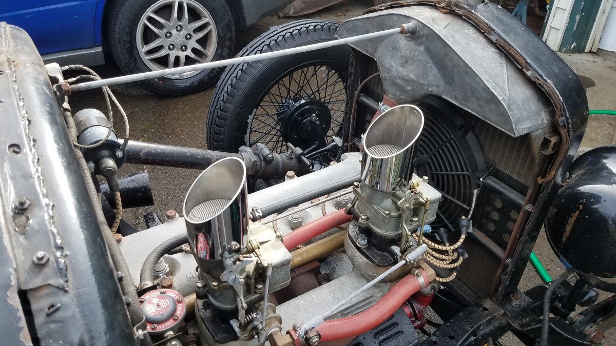

    Update*
    So I got all the Nickel Goodies back for the roadster the other day and I have to say, it really dolled the old girl back up! I did the headlight bezels, Moto-Meter, Cap, thumb screws for the windshield, thumb button for the Ruckstell shifter, Steering wheel hand throttle and spark levers, etc.
    I also fitted it with a pair of Muroc stacks from Muroc Mfg, Co.
    I also pulled the Steering Wheel and brought it in the house the let the dry, warmer air work it's magic. The it actually worked quite well, and its almost round again. Yesterday (amid quarantine boredom) I strapped it up with Cargo straps to keep it together and pull it back round the rest of the way and glued the hell out of it. Next is a good coating of Poly Spar Varnish to seal it against moisture.

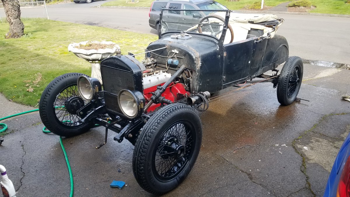

    It's looking good. What size are your front tires?
    Stogy and kidcampbell71 like this.
  14. MrModelT
    Joined: Nov 11, 2008
    Posts: 2,745
    MrModelT
    I'm running 4.75/5.00 - 19" Lucas tires on all fours...with those M.W. Co pin-drive split rim Wires. Same size as a '30-'31 Model A.
